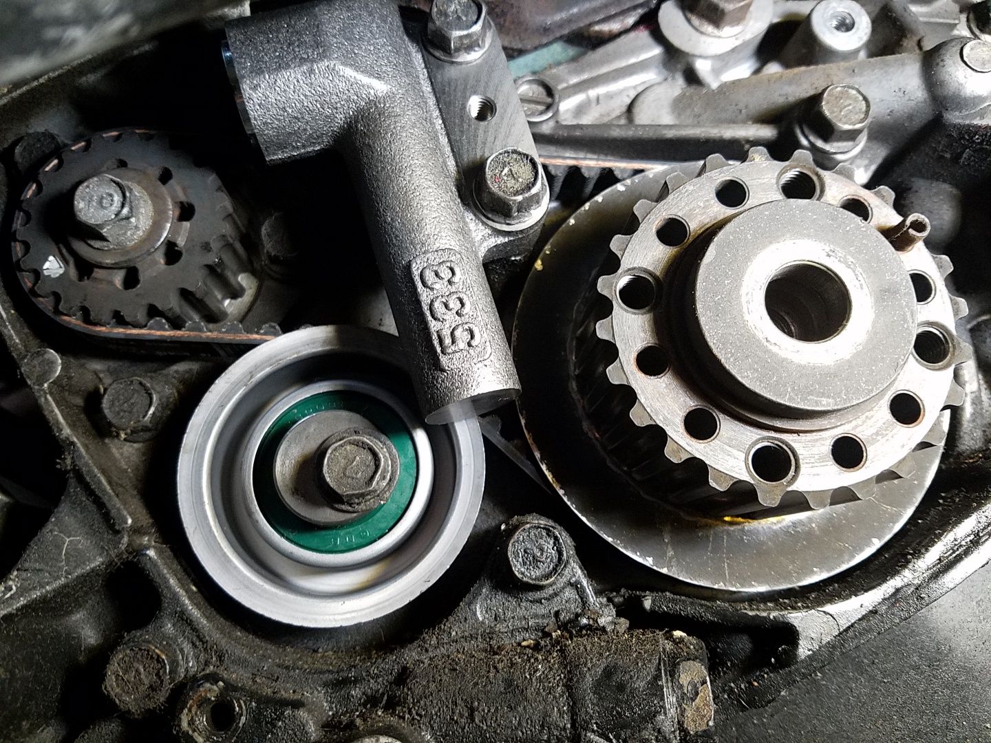

I had to find a needle to bleed those dam 1g lifters and didn't have a set of 3g's laying around like all of the other stuff. SO....

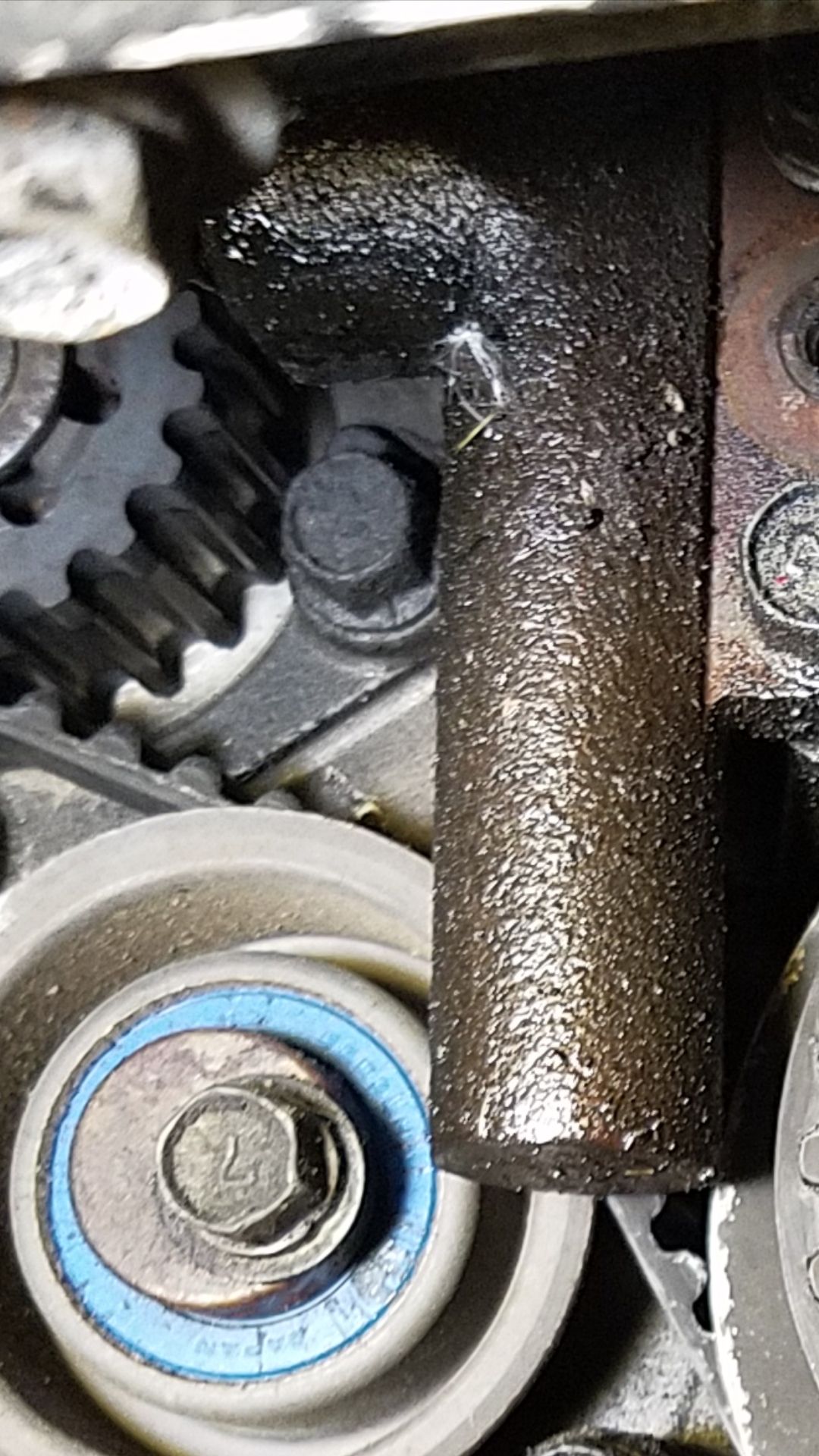

The hydraulic tensioner was so blown out so bad that I could press it in and out with my thumb and forefinger, in, out, in, out. This surely has to be a blessing.
More to come as I go, its cold as a Witches Tit tonight so more pictures of the new balance shaft belt and the crappy aftermarket tensioner this weekend and the cams. (Yes I bled the lifters) :thumb:
ALWAYS use OEM tensioners, regardless of belt choices.

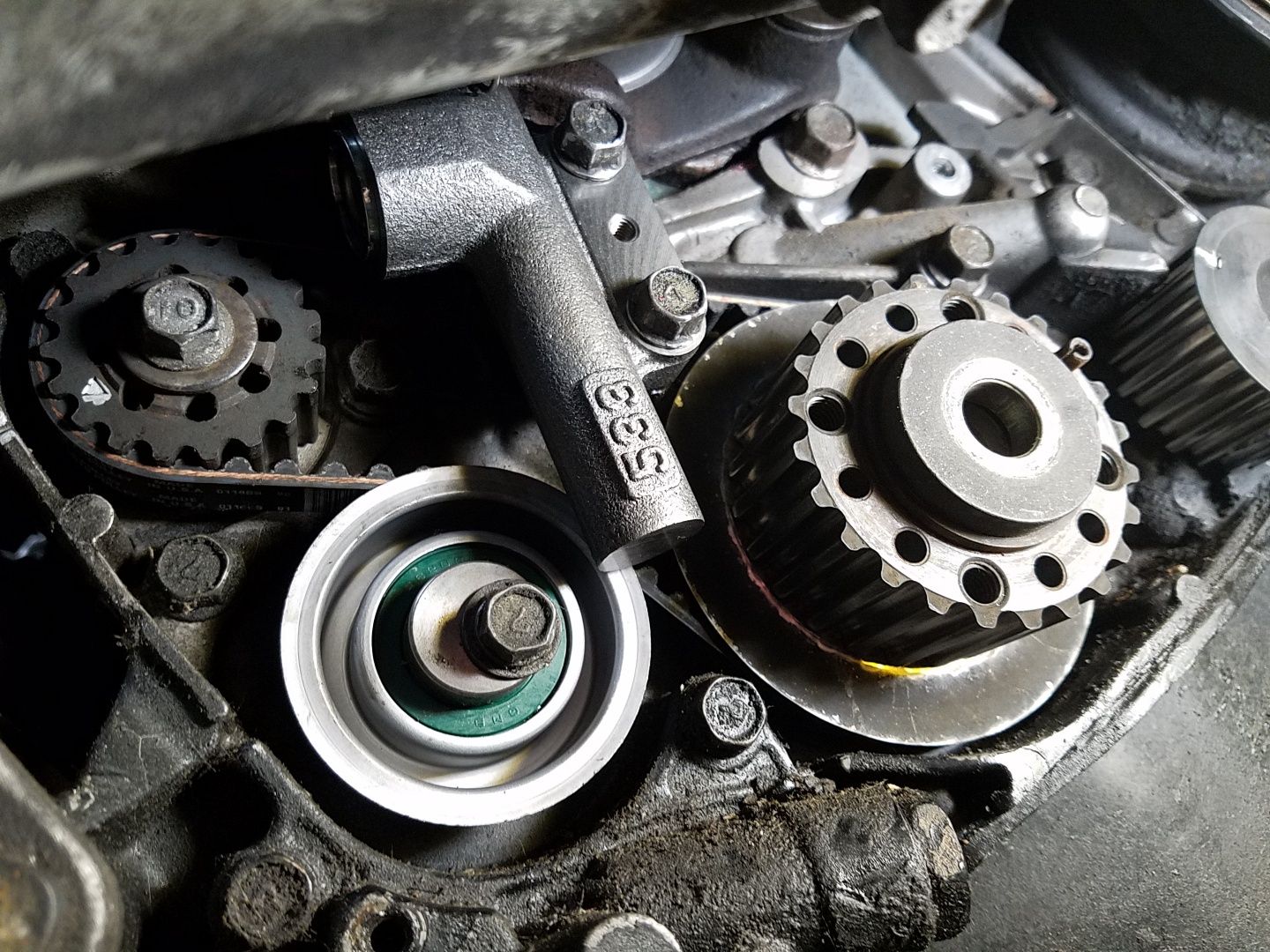

New balance shaft belt on along with the new OEM hydraulic tensioner for the timing belt. Getting the cams out and bleeding lifters so I don't have any snags after putting these HKS 264/272's in along with the other "goodies". Hoping all goes smooth as I transition her with these "leftover" parts. (and I do have ONE spare HX40....hmmm).

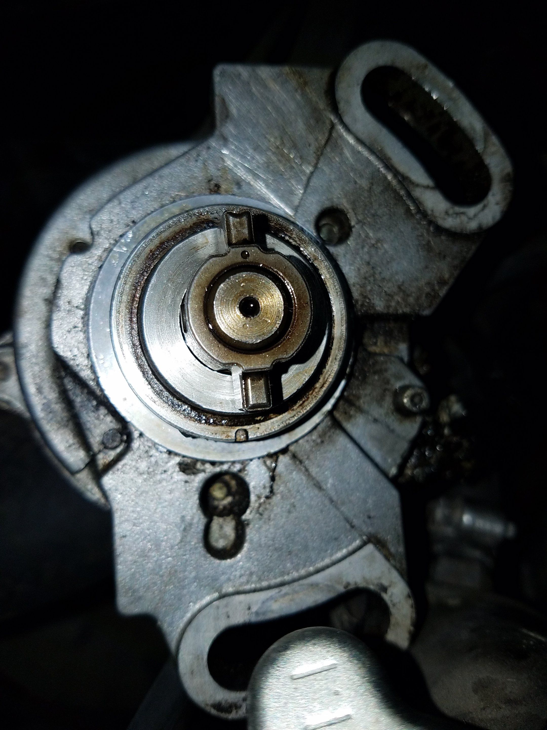

Ok crowd, here is the LATEST ODDITY (I know, its a DSM).

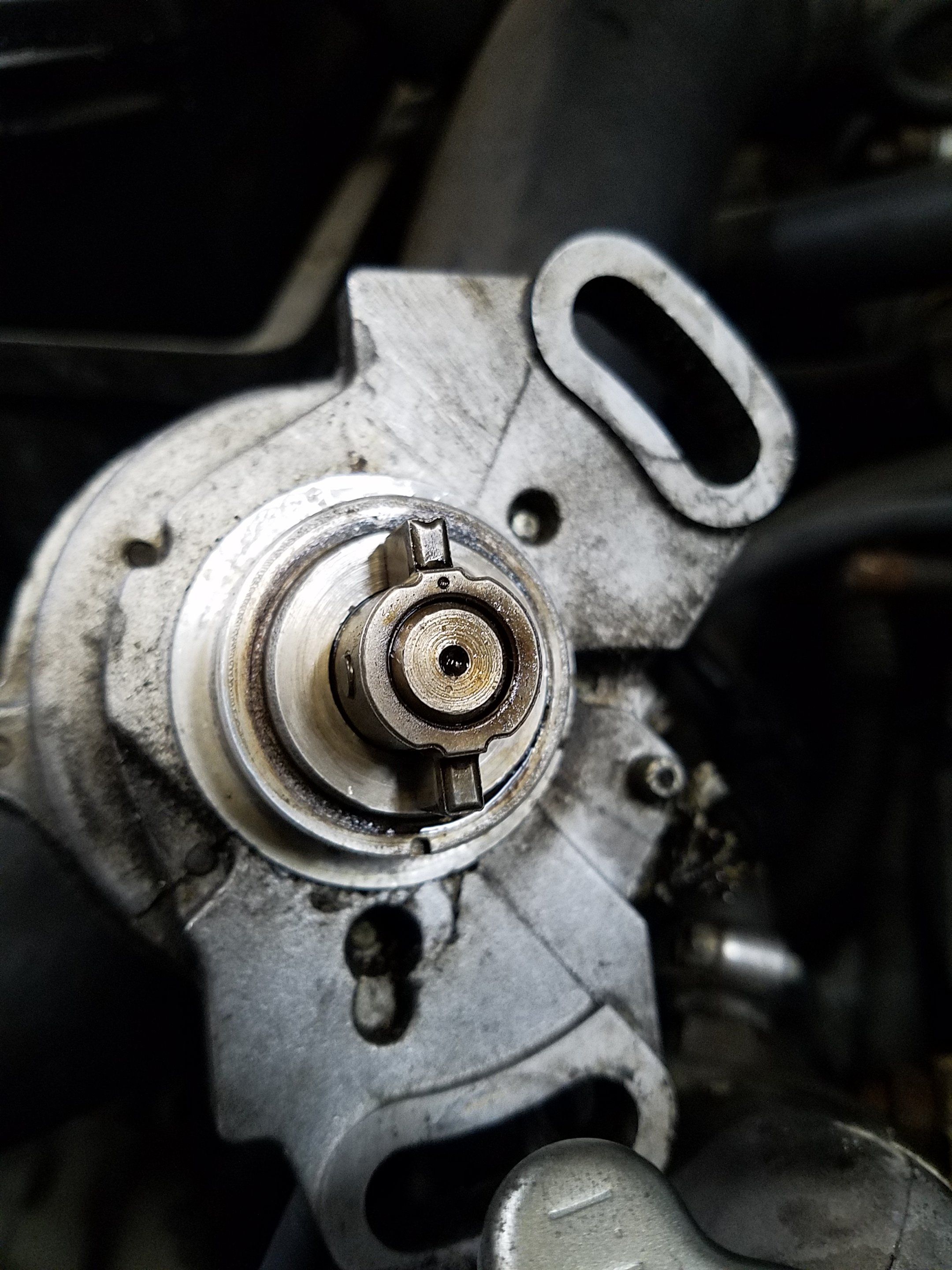

Soooo, when my son pulled the CAS out when I was changing cams, I had to look twice at it.
See the picture.
The motor is on TDC and all marks were correct down low and off a bit on the exhaust cam only.
Look close.....something isn't right and I spotted it immediately. Mind you all, this car drove around town and I finally drove her into the shop for a timing belt job.

Pretty sure that means incorrect injector sequencing right? But will run 180 out bc its waste spark?
It was running, but the funny thing to me was it was running rich. You could smell the richness. I think it was firing the spark before the microsecond injector pulse.
Just a speculation from this end.
IDK how the CAS times all of that or the ECU dependent on it.

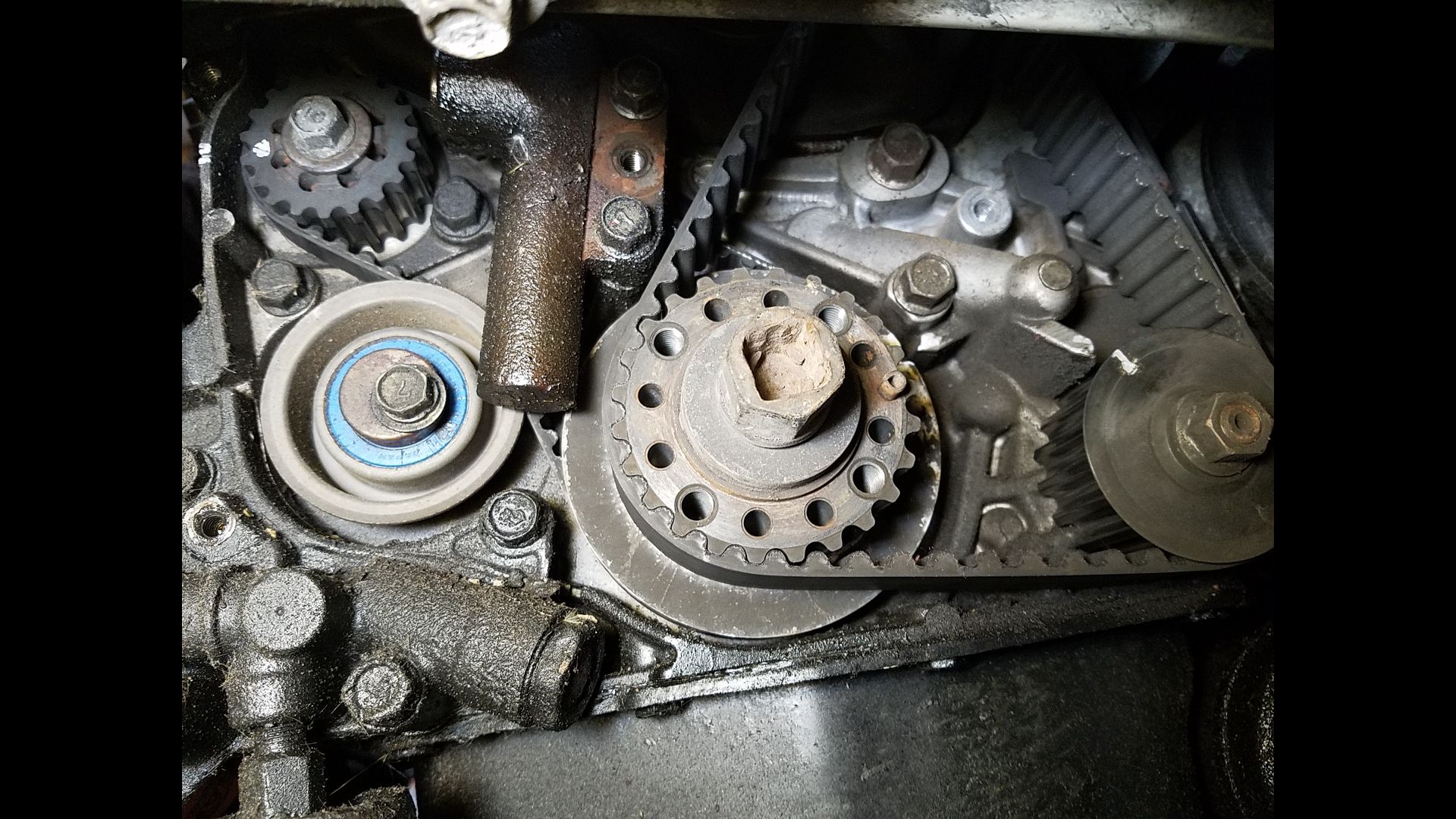

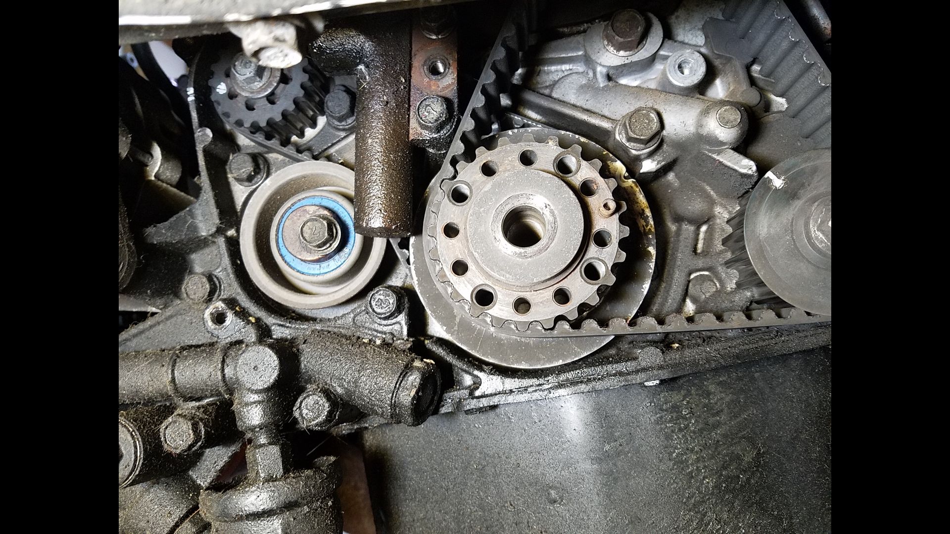

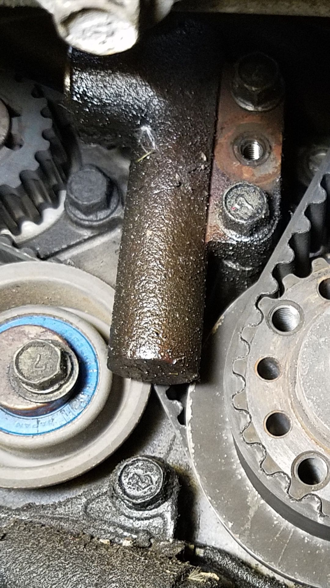

Oh shit.....it's on the car. I MIGHT be able to see it but it was a fresh Mitsubishi package. The old one was an aftermarket job for sure. I have the tensioner tool still in and I have it perfect to slide the grenade pin in and out. Why? Would the date make a difference on the OEM tensioner?
I plan to put a short video clip of the old one with me pushing the pin in with my thumb and finger, and oil all over it. So thankful I opened it up. i should have it back together today after it gets a bit warmer, its cold here in Kansas this morning so the shop will be cold too.
This sure doesn't seem like it is good anymore since I can press it in by hand and its covered in fluid.

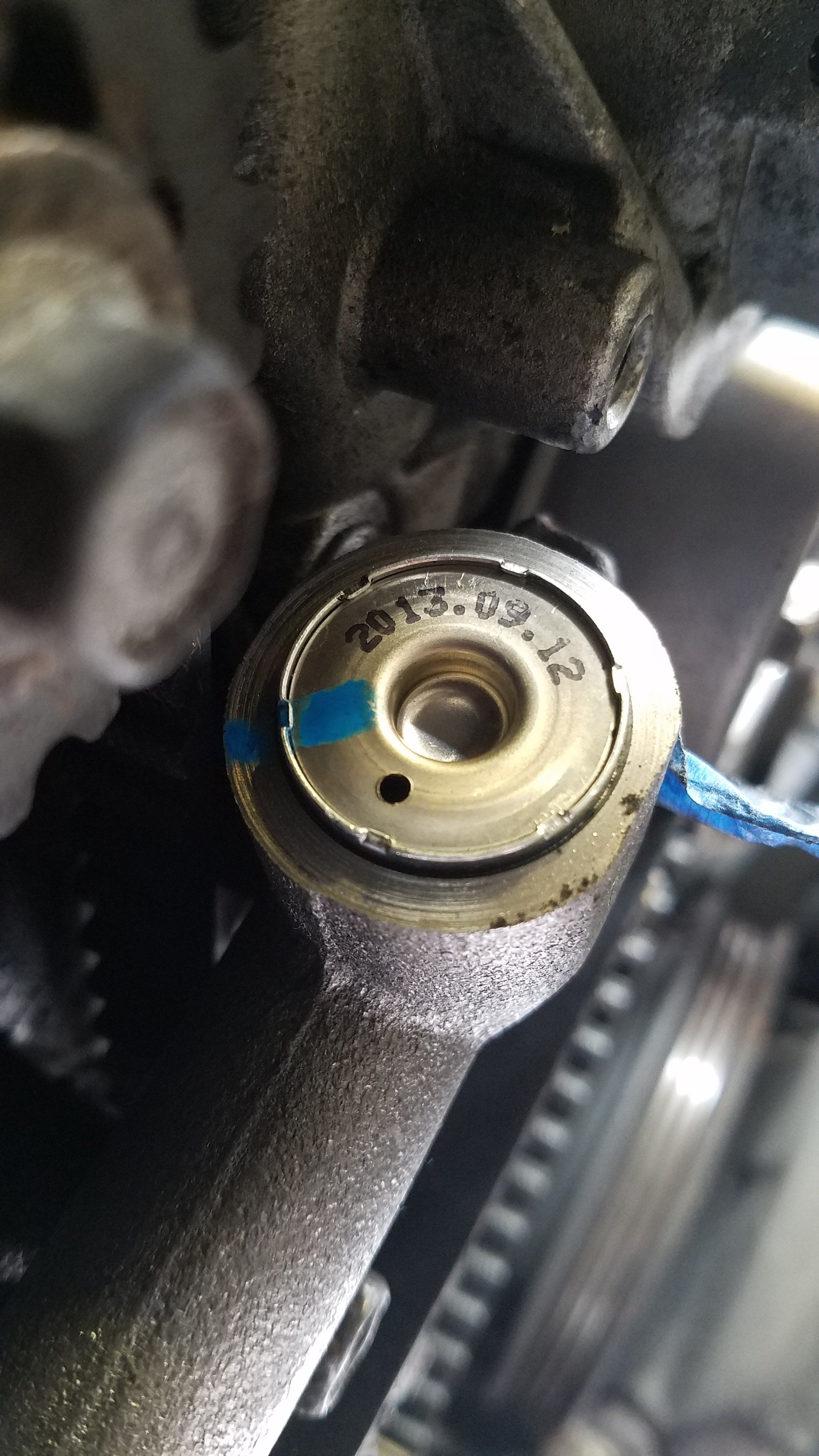

Well the tensioner I bought in December 2017 has the date 2015 stamped on it. That worries me. I've been wondering ever since if 2015 was the last year they made these things. (Tensioner for the 6-bolt, MD164533). So I'd love it if somebody could verify a 6-bolt tensioner with a vintage newer than 2015.
Yeah that rod going in so easy looks way wrong to me. The "old" OEM tensioner I took out of my car, which wasn't that old (has the year 2011 stamped on it) is still in pretty decent shape. So I did some fooling around with it just to get acquainted, and I found I had to use a bench vise to push that rod in.

Flipped the CAS 180* while I was there. Set base timing and have STFTs within 5% so I really feel like I saved the cars life. Much more and she would have surely bent valves and killed the car.

I saw no red stains just clearish fluid on that shitty hydraulic tensioner.

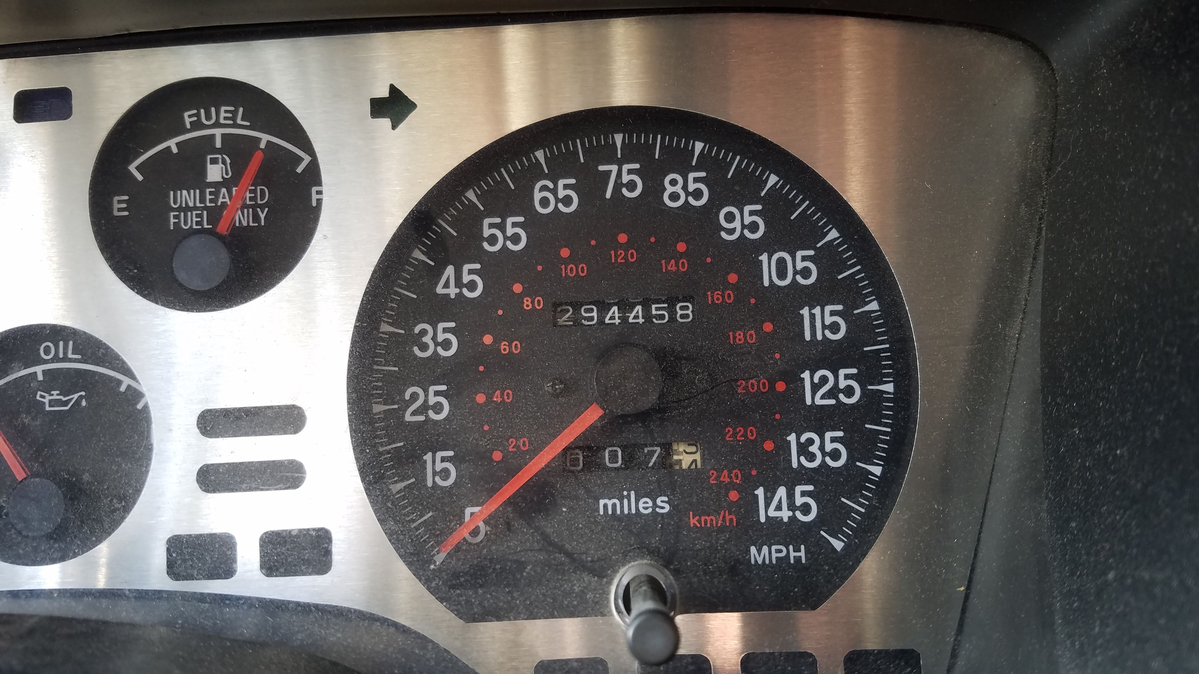

I have a picture of the date on mine since you brought it up.
Sorry I had forgotten about your question.

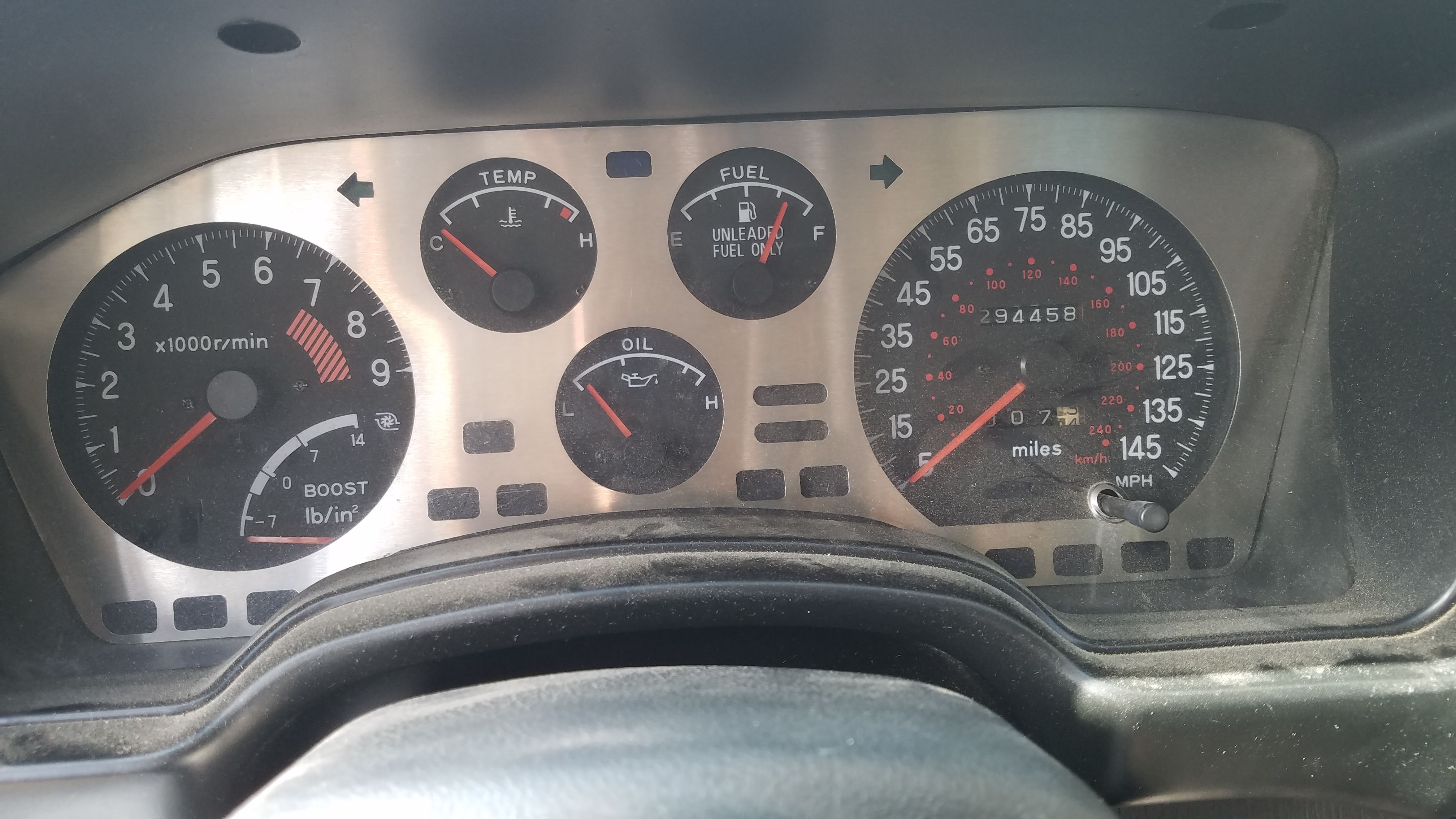

Here's the dash with a SS cover. I didn't like it but it kinda grows on you.
I don't know if it is the original dash cluster or not. That's alot of miles on the clock.

2013? What??
Thanks for the good picture though. I really appreciate it.
When did you buy that one? And who from?
It came with the car. Was bought at least a year ago. Idk where the man got it.
Oh ok, he might have had it for a while then, or whatever.
Thanks for the info!
