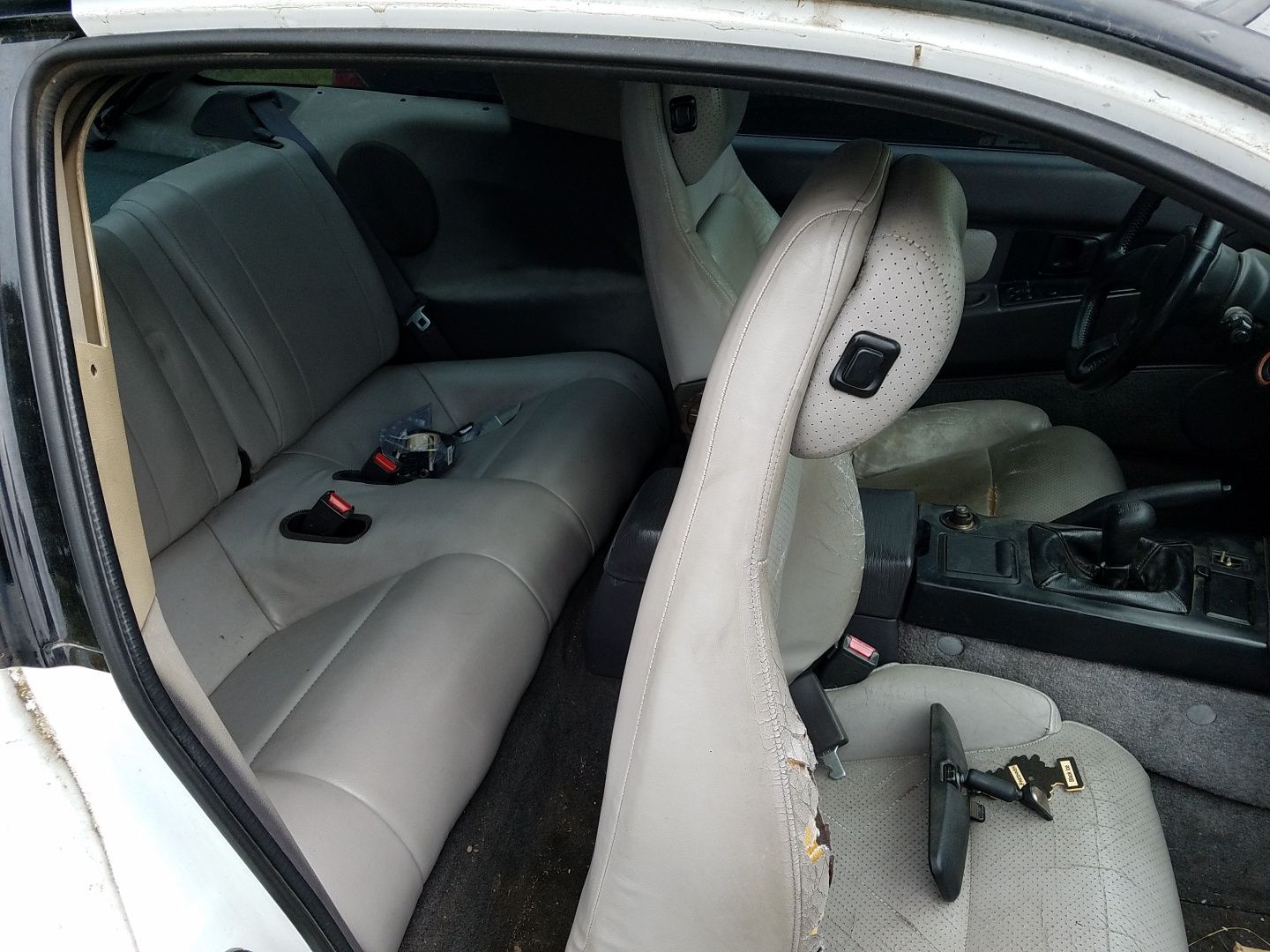

Mine has leather seats too, and torn the same way. I’m likely to get one or both reupholstered, but $950 a pop. Ouch! Is your rear seat also grey leather (vinyl). Mine is fabric, I suspect from some donor by a previous owner. My door panels do have the grey vinyl, though, so pretty sure the seats are stock. Are you leaving yours be, or plan to restore/replace?
Leaving be for now. All Leather interior but a different design than my 90 Laser has in it, which is grey leather also, just different designs.
$950 is a lot. I haven't asked a upholstery shop about them but probably will sometime in the future. It is a pretty clean car once we got it all put back together.

Yeah, I think most dsm owners think of $1800 in terms of how much faster the car could go, not nice seat covers. Over half the cost is just the leather. One of the few mods I have discovered on my is a short shift kit, but the one in your photo is like "extra"-short shift! It barely rises above the console.
My interior is so disassembled right now that it's nice just to see one whole. Inspiring! Thanks.

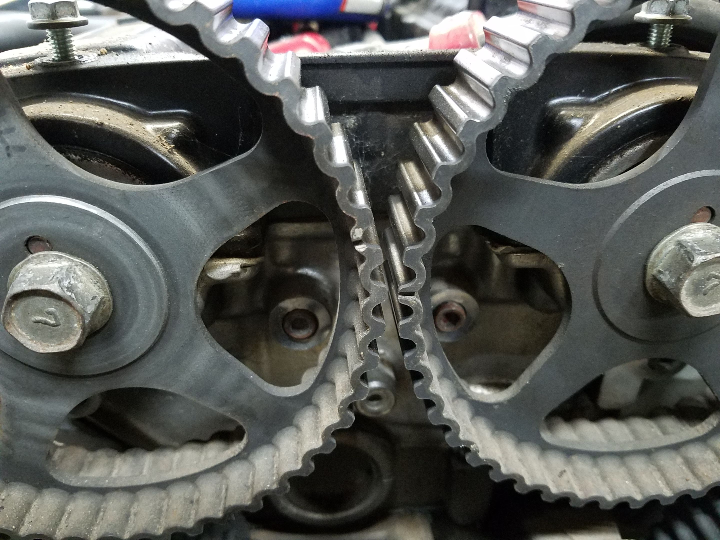

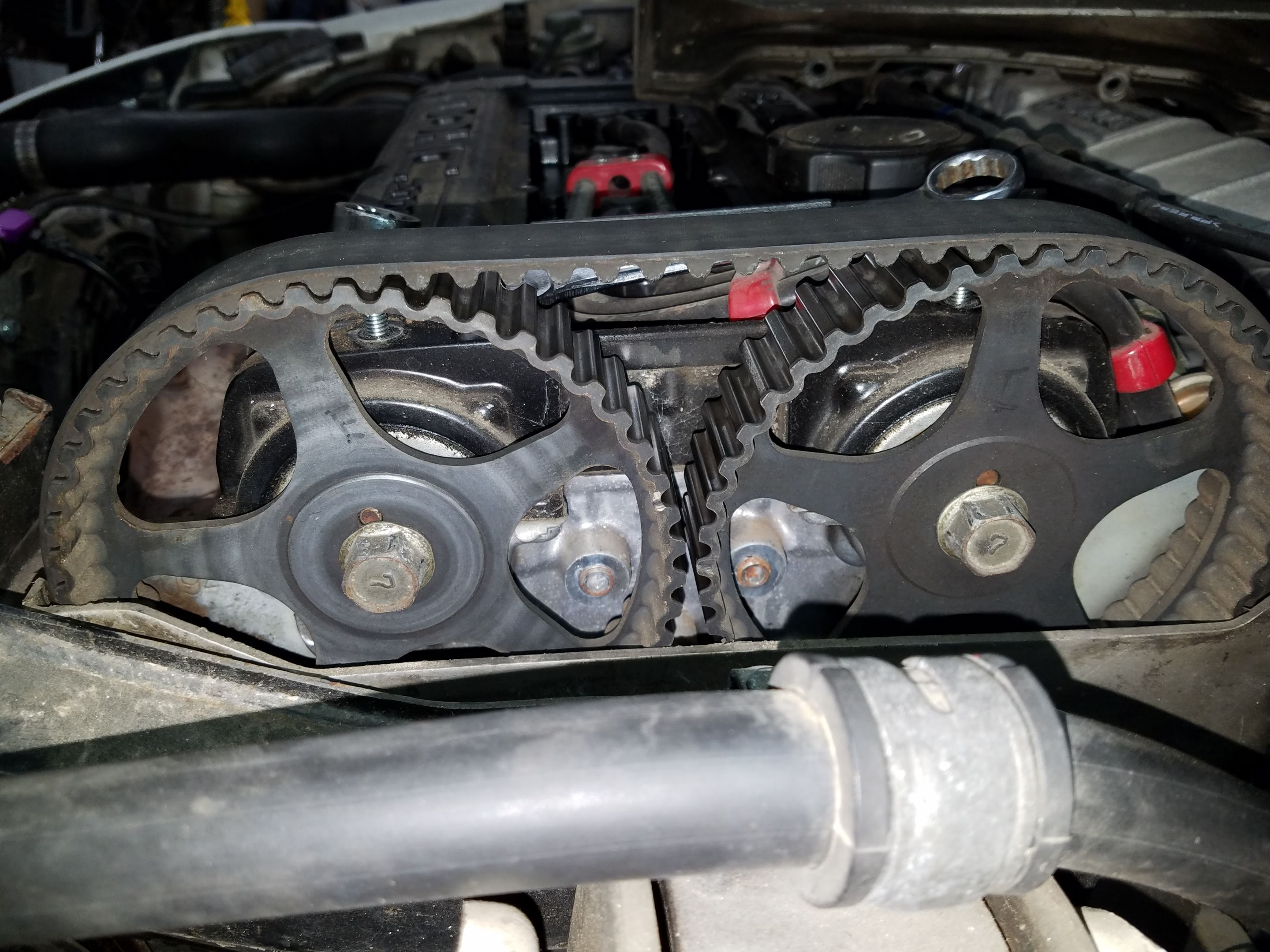

Well, it is time for the timing belt, adjuster, pulleys and water pump (and some other super secret stuff), so I pulled the ole gal into the shop and got her up on TDC. Had to try twice because something just wasn't right. What I have found is....well glad I found it. The balancer is on TDC in this pic.....
Someone has been in her before because I can read the number 167 on the belt and that is the Gates #.
It appears to be 2 teeth off on the exhaust. It is definitely not correct. I hope I have just saved her life!
Stay tuned! Lotsa fun to come!

I have just sent mine to be reupholstered in factory-matching leather. Might be a few months till I get them back, but I will send some photos when I do. As for the misaligned cam timing shown above, makes me wonder what other surprises await you. I've found plenty in mine, often leaving me scratching my head, and saying "WHY?!!". Getting the two sprockets lined up should have been the "easy" part to verify. Fastener torque and many other parts of proper assembly cannot be detected visually. This drives me crazy, and is a source of my mechanical addiction: have to take more apart so I can put it right....

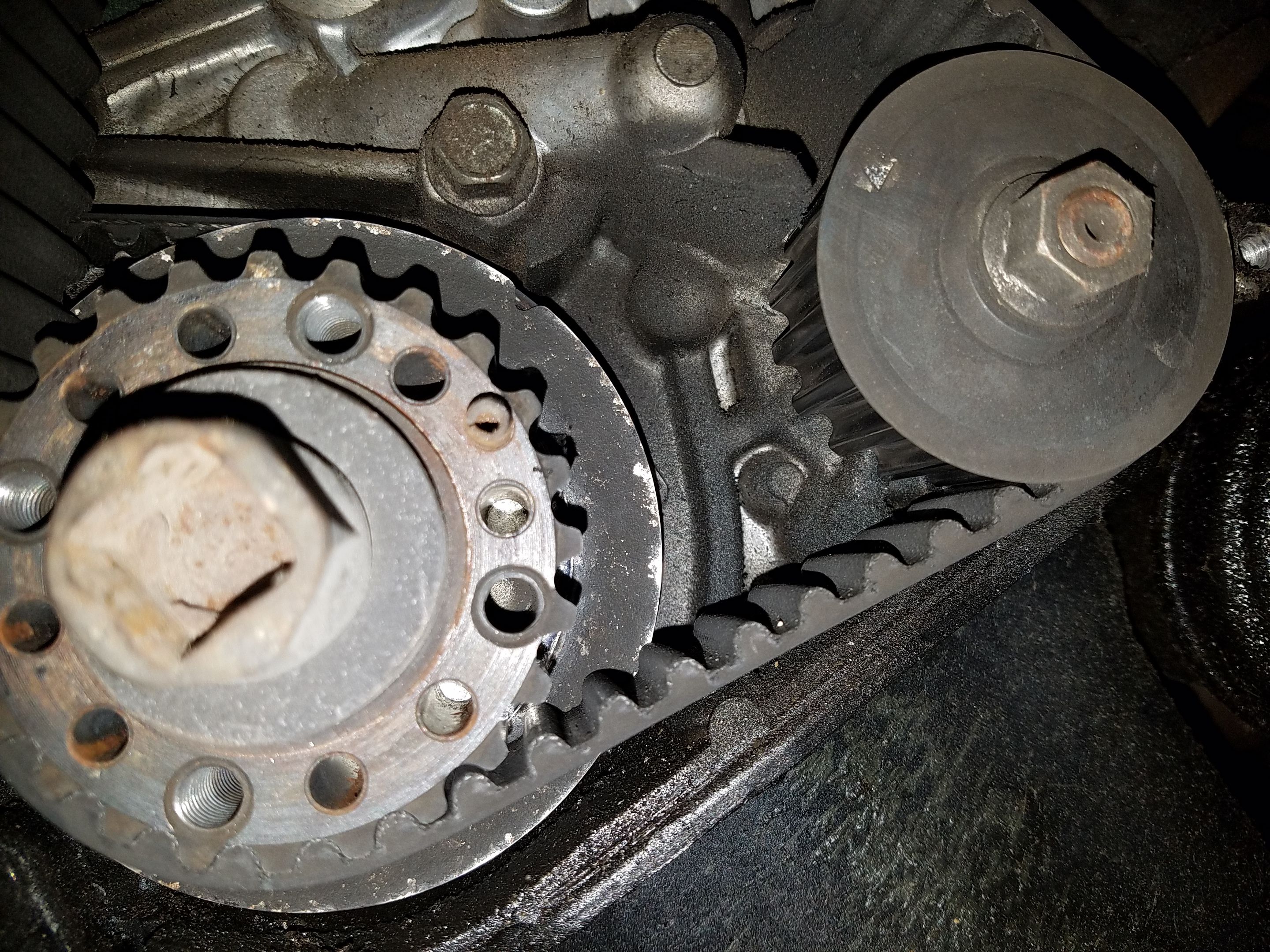

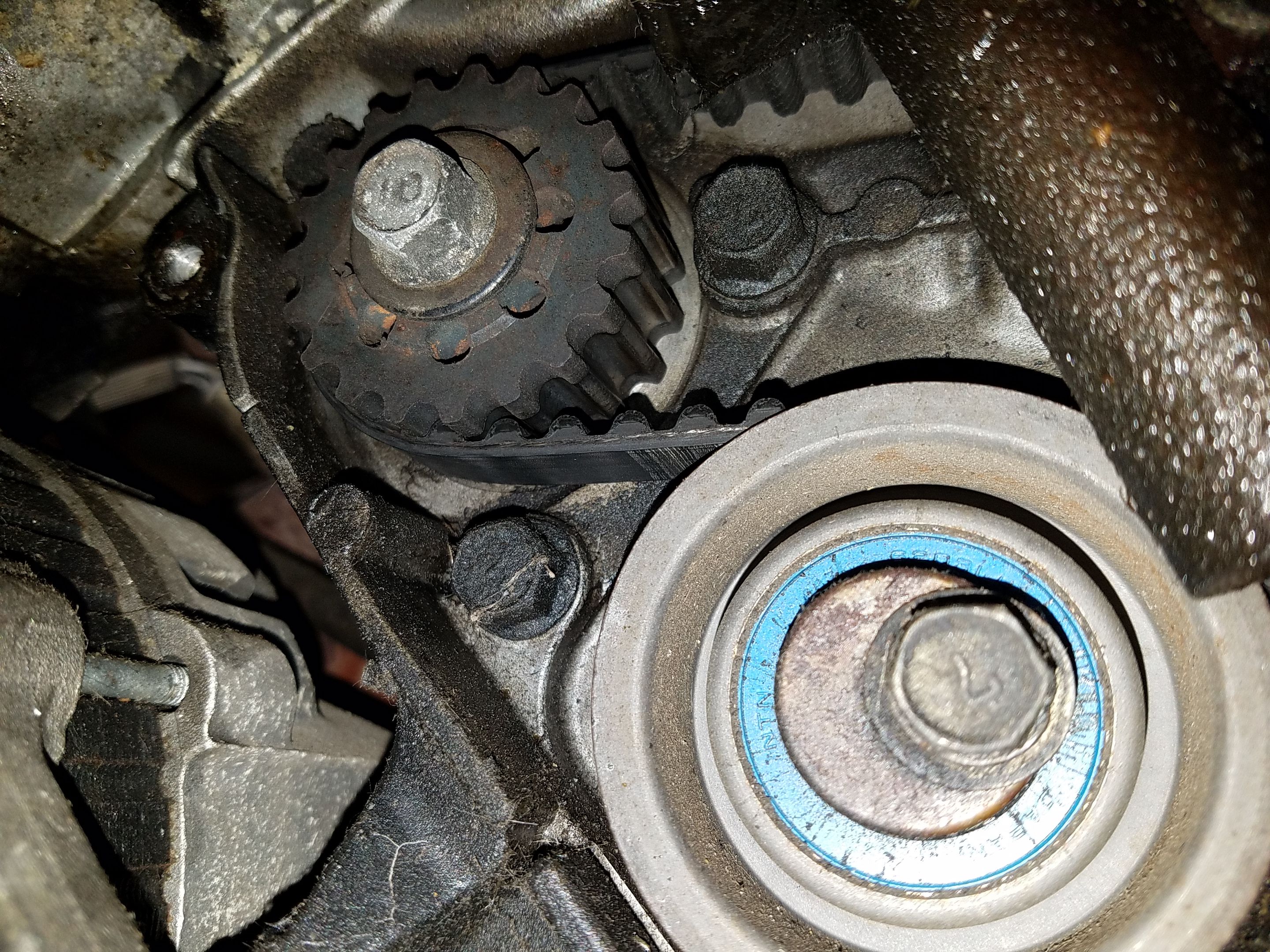

Well guys and gals, sure as hell, the car was running with the exhaust cam 2 teeth off. I have all the front covers off and everything is ligned up fine below but someone has DEFINITELY been in here before as it has the replacement idler pulley, not the original 1990 one and its sloppy so its been awhile. Belt is tight so it hasn't jumped. They tried hard but.....well not everyone was meant to work on and understand a DSM.
Pictures are what everyone wants to see.

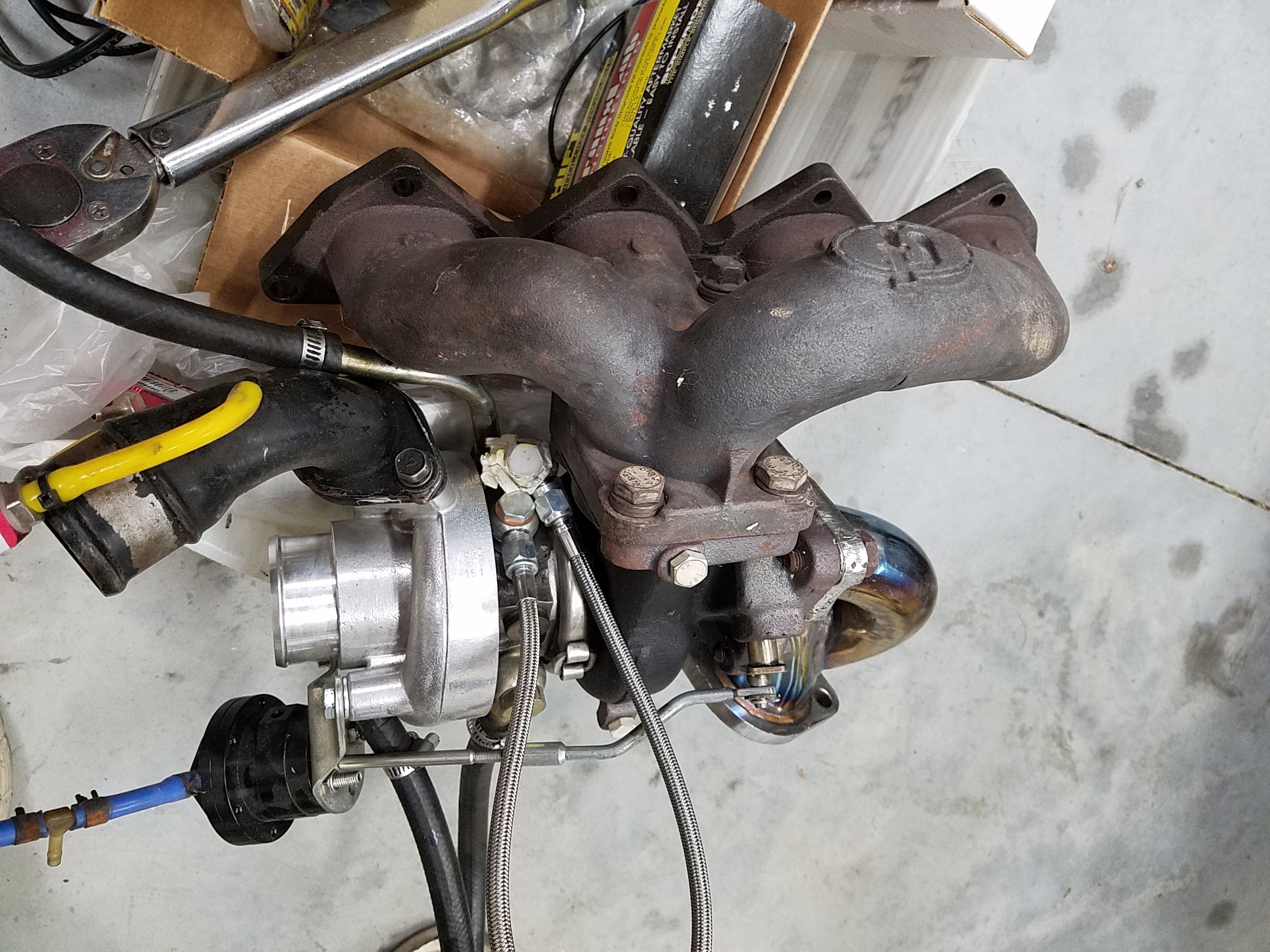

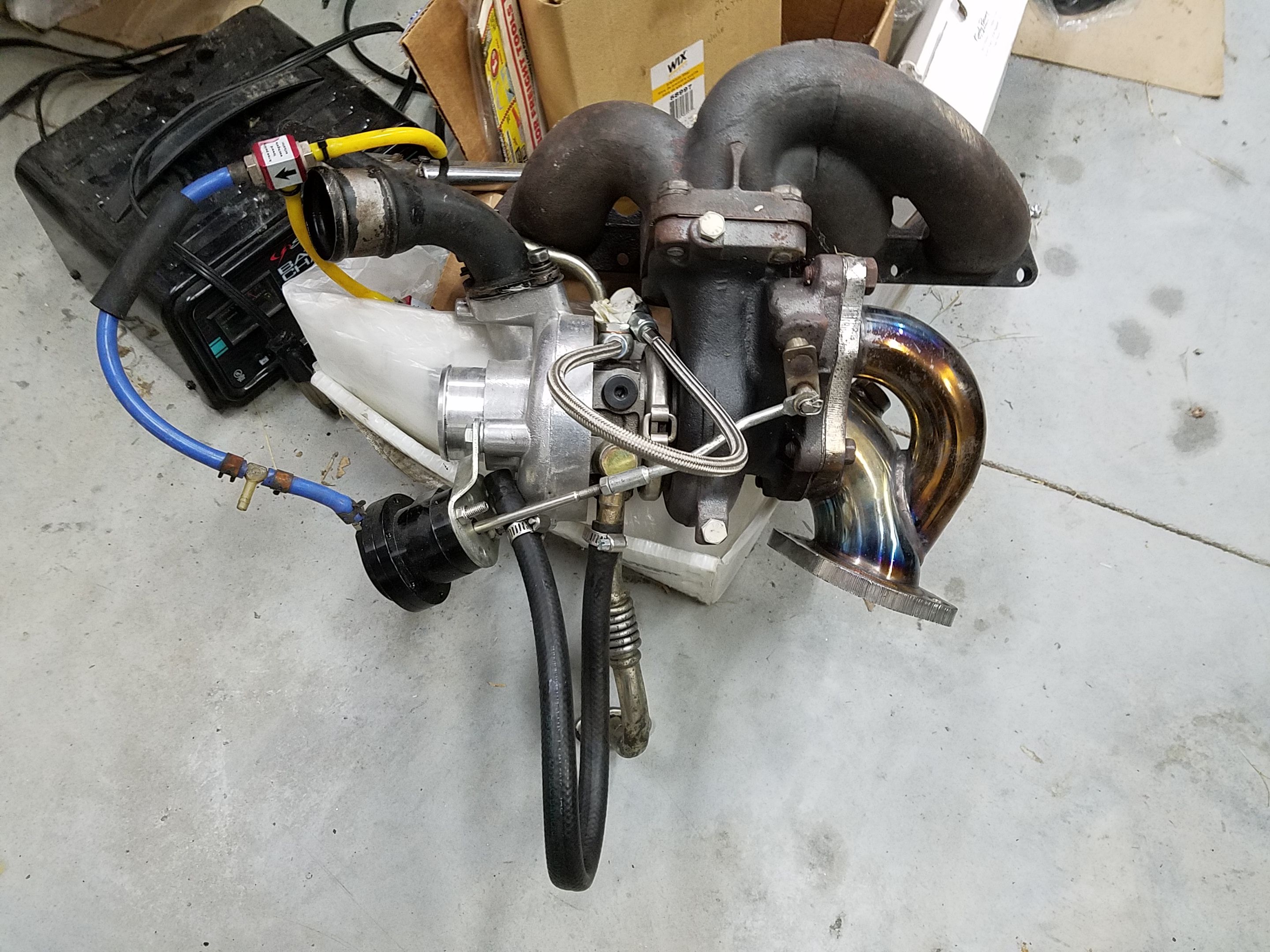

I'll be putting the HKS 264/272s in along with FIC 1120s and my FP mani/16g set up while it is apart. Hate for the "excess stock" to just sit around, so now the secret parts list is out. The VRSF FMIC will be going on also.
Just so everyone knows, this car drove around town and into the shop just like this!
I couldn't tell it was off, just low on power and I figured that I was just used to my HX40 power. NOPE.
I am looking for a weird, come and go noise or rattle if you will and haven't found anything yet but the noise was in the front timing area which is why the car is tore down in the 1st place.

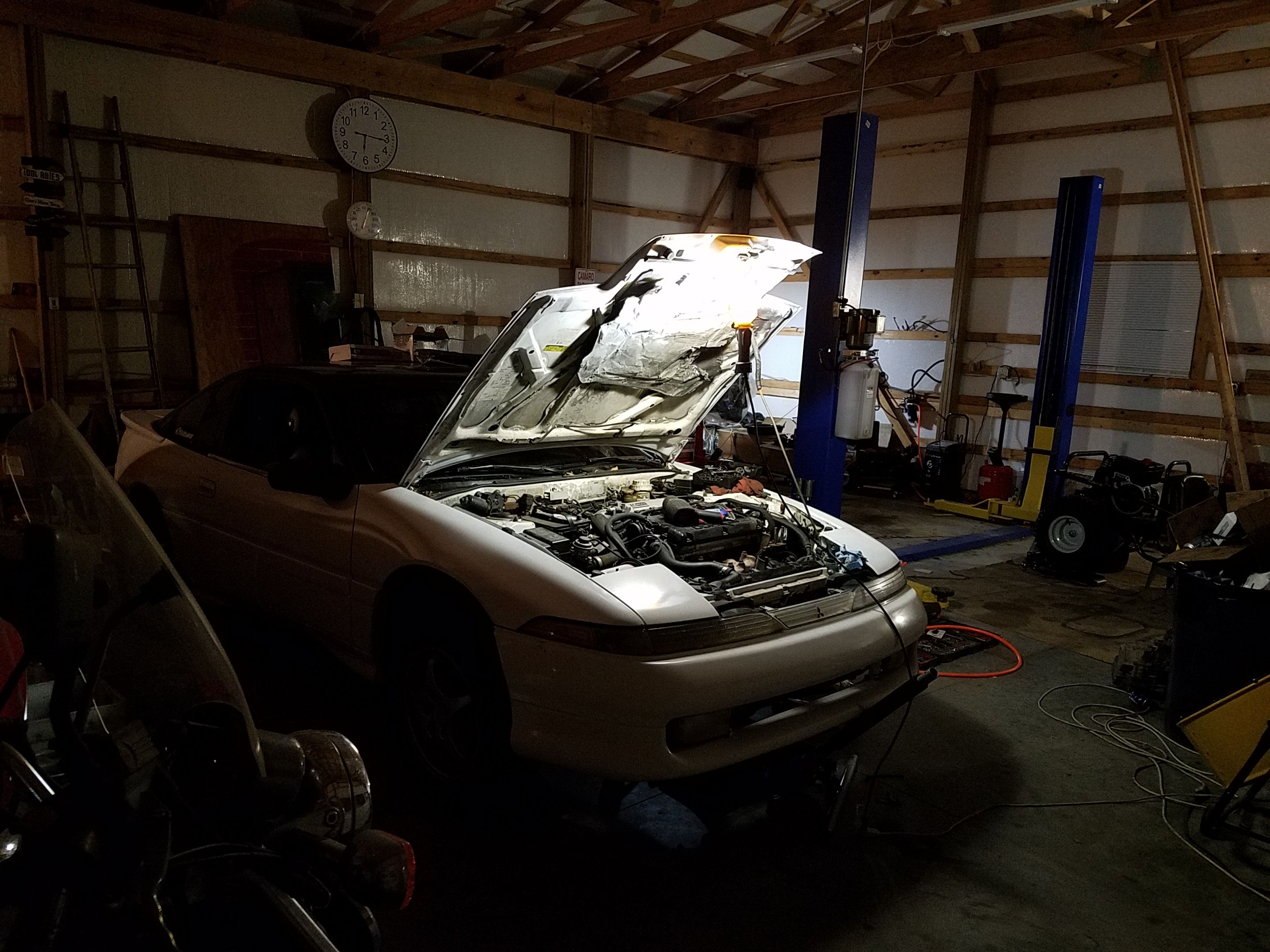

That shop or garage, is that at your house?
That is my shop, at my house, that I had built last year. 30x40x12. We put the lighting, plumbing and lift in ourselves.
THAT is a blessing right there, a nice shop!!! :thumb: (its a bit messy but my sons and I WORK in it, we don't have parties and play cards, LOL)
Yeah that is really nice. 30 x 40 is twice the floor area of a 3-car garage. It looks like it is insulated too.
How much vertical space do you need for the lift? What make and model is the lift? Is it working pretty well?
I have 12' ceilings, no ceiling in it but that is the height of the rafters. My best friend built his at the same time, same shop but different orientation on his door. He was going 10' high but I mentioned we didn't want to push a car thru the ceiling so he went 12' also. His is spotless, and a party place. Mine is a work area!
It was a "Pole Barn Kit" from the lumber yard for $13,000 plus labor/cement/misc (another 10k).
Here is the lift I have and he has and they work wonderfully. Very minimal assembly, most is pre-assembled. Just secure it to the level floor
https://www.bestbuyautoequipment.com/auto-lift-tp9kfx-9k-2-post-floor-plate-car-lift-p/al2-9k-fx.htm
For that price, you almost can't pass it up if you have room.
