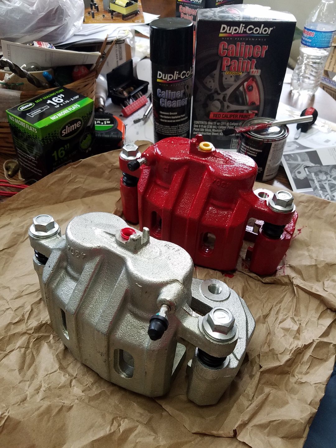

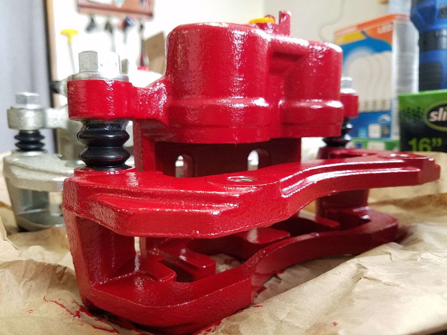

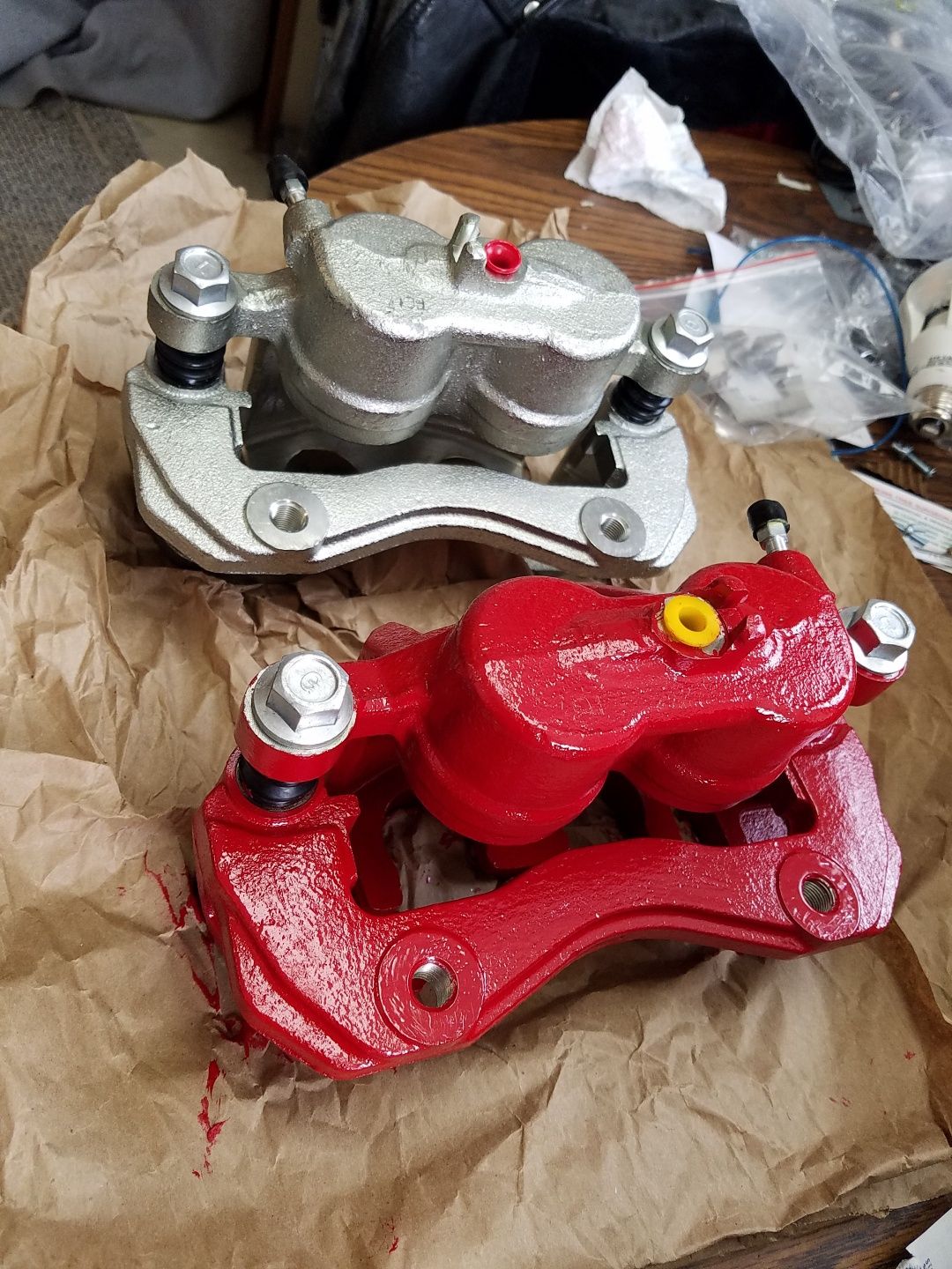

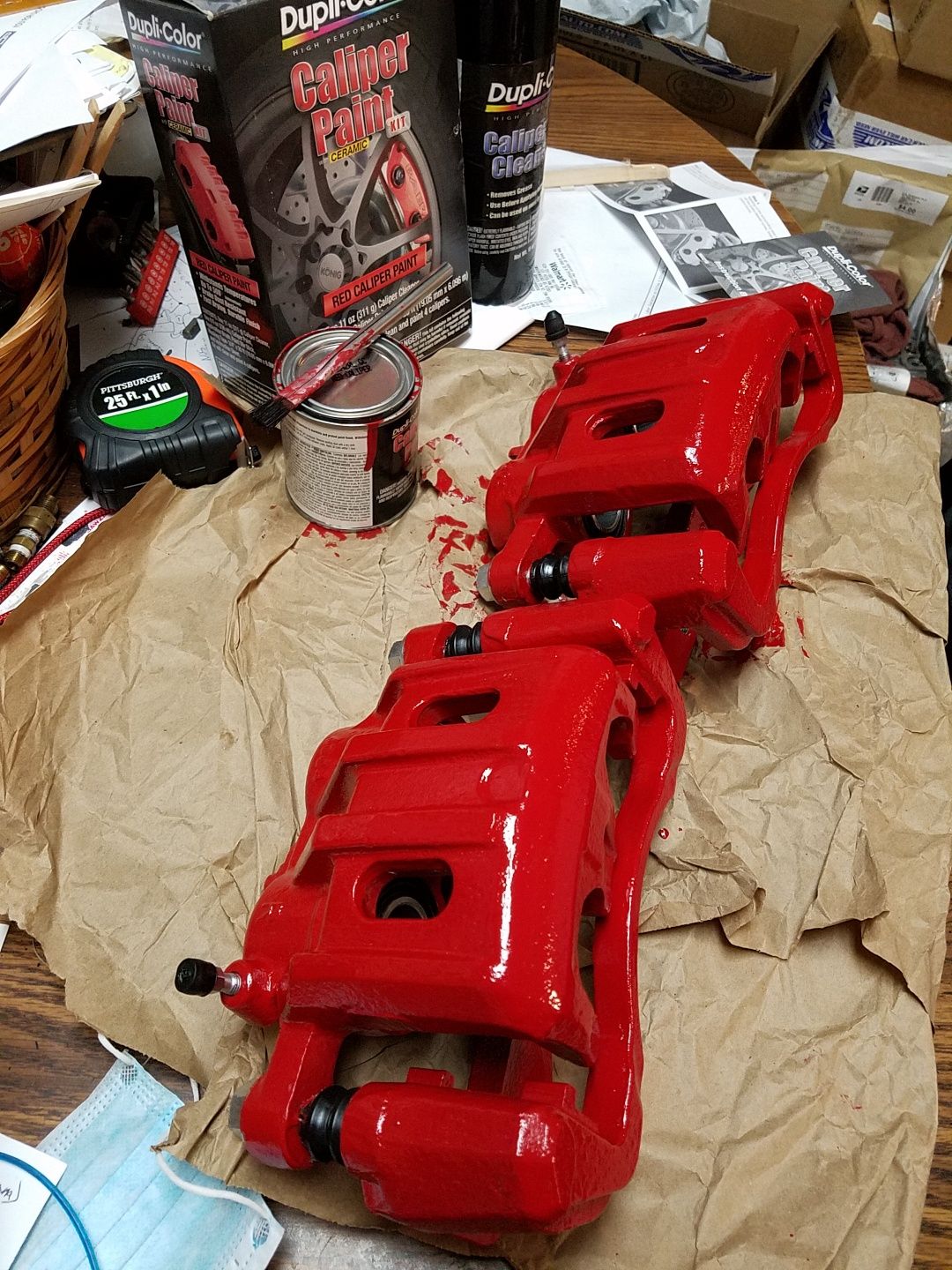

Well I wanted a set of "big" brakes, dual piston front calipers and my source for them had dried up with the powder coated units but I snagged un-coated calipers and bought a caliper paint kit and got busy. It is surprising how good it looks, drys pretty quick for a second or 3rd coat and I have enough paint left to do 2 more calipers, maybe on my DD. :thumb:
I would recommend the Dupli-Color kit I used if you want colored calipers, it was around $28 at my auto parts store. I wanted Red for sure but they do offer other colors, I didn't pay attention to the other 2 boxes though. :ohdamn:

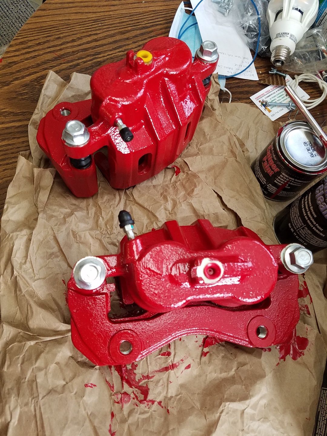

Here is how they turned out. It has PowerStop pads and new rotors (although not drilled and slotted) ready to go on too!

Nice looking calipers!
I’m considering a similar upgrade for my 90gsx. Looks like you went with 2g calipers; Please post an update on the install. They do have rebuilt 1g twin piston calipers available (rockauto, summit). Just wondering how you decided, and what other bits & pieces are required. I’m not personally into having mine painted, but yours came out great. Always helps when the surface has texture, like cast Al.
Start at post #122 I believe! I show all the components and you can get the unpainted caliper setup at Rockauto under 1994 Talon Caliper/Rotor/Brakes or something like that subtitle. Just look at the pictures to be sure they are dual piston.
https://www.dsmtuners.com/threads/1992-talon-tsi-6-4-auto.512178/page-5
I got this kit https://www.rockauto.com/en/catalog...heel+hub,caliper,+rotor+&+brake+pad+kit,14204
and order these hoses
https://www.rockauto.com/en/catalog...1103195,brake+&+wheel+hub,hydraulic+hose,1792
Wagner BH132123 for the hoses and get the banjo bolts I show in the 1st link for a perfect setup. :thumb:

Thanks for the link. So you ordered the 1g twin-pison, but they sent you 2g? Looks like you adapted the hoses nicely.
Also, with the car in blue and those big wheel opening, the red is a nice compliment; Sort of like the rear side marker lights for the front. My car is similar color, but original “turbine- lade” (cheese slicer?) wheels. Calipers are way more hidden.
Seems like you left the prop valve alone, how are the new brakes working out?
They have better grip when I am trying to hold her back for sure. You know, these old hoses may even expand some under hard braking so I am glad I found a work around for the calipers and used new hoses because, yes, they are 2g but work fantastic.
Always glad to help, that's why I posted all of the parts for you. I need to add those hoses to the article so it shows each piece. The calipers will come with brake clips and 2 crush washers, the hoses won't come with them.
If you need ANY tips on doing the conversion the way I did, just hit me up. I am happy to help you over any obstacle you may think you have but I already came across it! :thumb:
