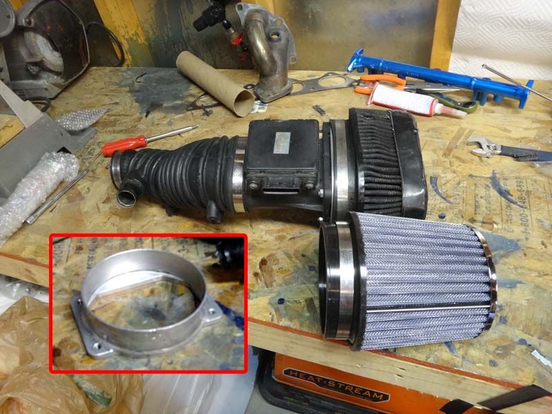

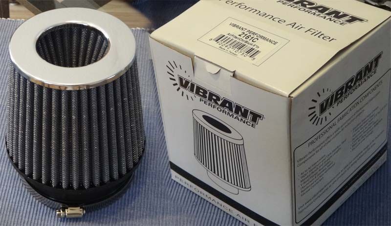

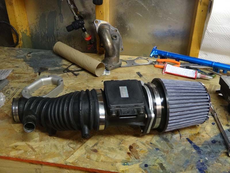

I also finally changed the derpy filter I was using. I ordered this one from Amazon and found an adapter plate here on the classifieds.
http://amzn.to/1fUmLQb

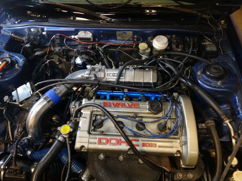

Does that 1g intake pipe fit right over the 2g mas? How's the fitment in the bay? Great job on everything btw.
Yep, you just need to heat it up and do some stretching and prying. It takes a little bit of elbow grease, but it will fit. If you look on page 2 you can see I tried to fit a 2g hard intake pipe.... There was no way in hell. With the 2g intake and the 2g MAF I only had about half an inch left of free space, and that was without the filter on.
I saw a coulple threads of other people using the 1g snorkel with the 2g maf, so I gave it a shot and it worked. :thumb:

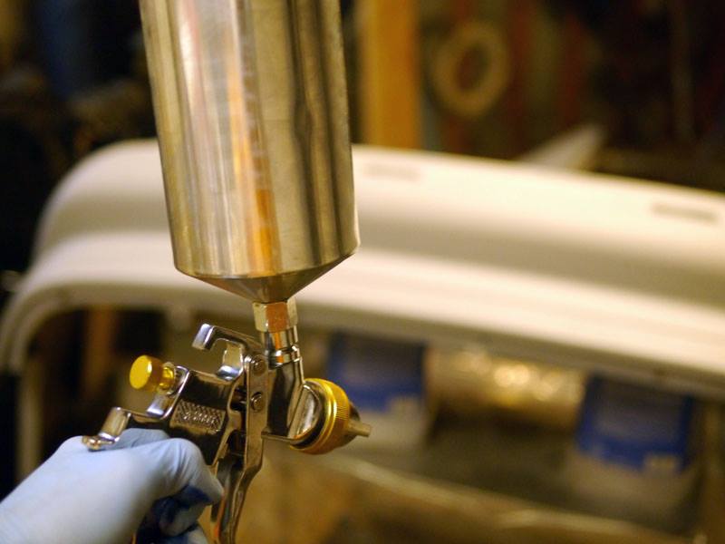

Here's link to the gun I've been using. It's inexpensive but I haven't had any issues with it yet, both the paint and clear sprayed great. I knew when I bought it though that I could work around any problems if they came up (I painted cars professionally for 5 years), but they never did, it sprays awesome.
TCP Global® Brand Professional 1.3mm HVLP Spray Gun-gravity Feed-auto Paint Basecoat Clearcoat with Air Regulator : Amazon.com : Automotive

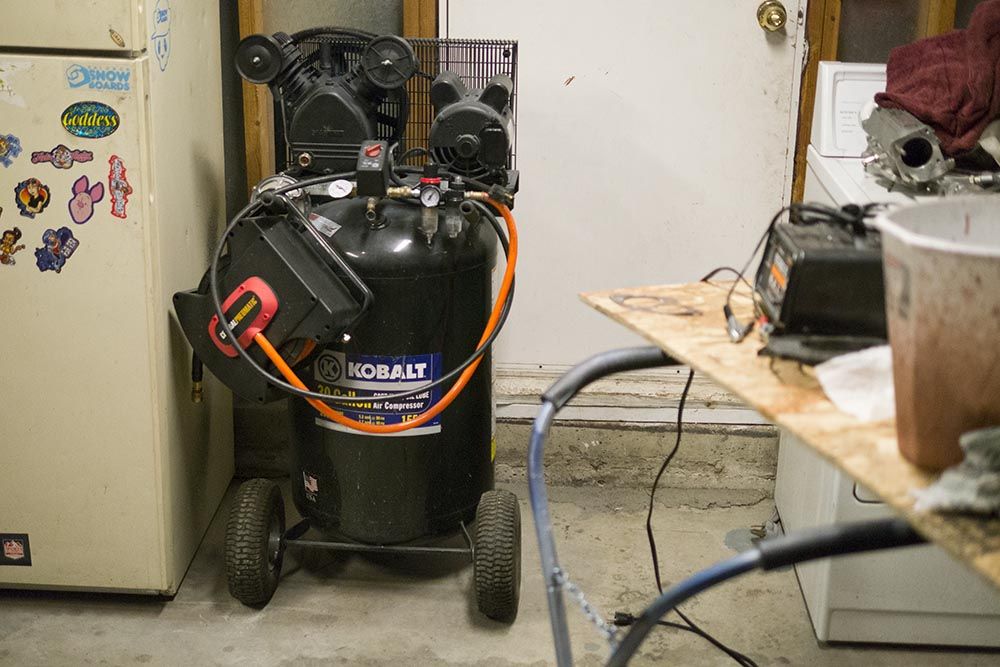

This is my compressor I picked up on craigslist.

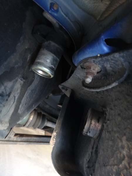

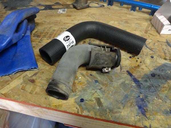

The last time I filled my car full I noticed I was dripping gas from the filler hose, so I ran it down to just about empty and picked up a new one. It took all of 5 minutes to replace, I just had to trim the new hose to fit, I found the part number doing a forum search, apparently I'm not the only one with a 1G DSM who has had this problem. :thumb:
Old hose off:
New hose ready to bolt back on:

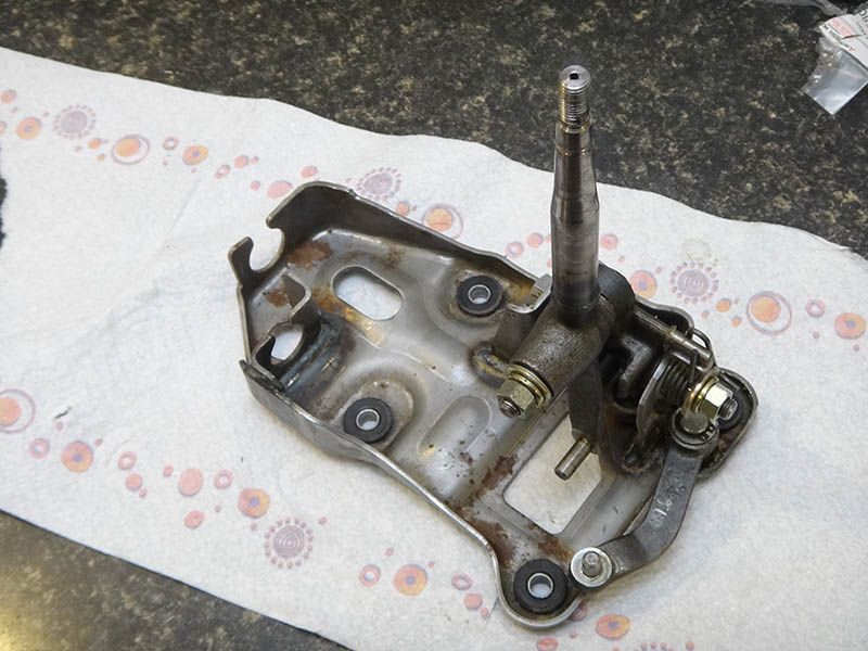

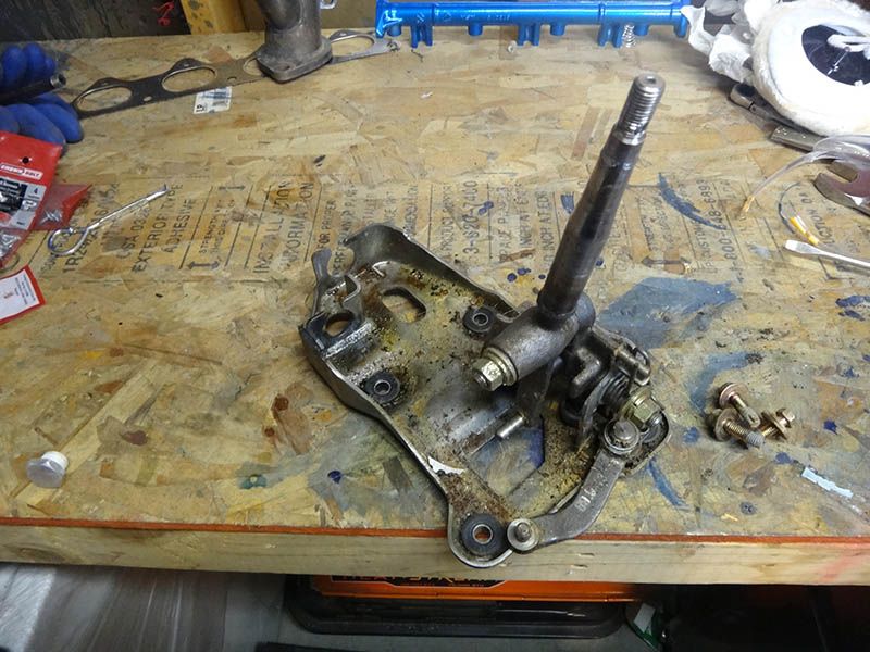

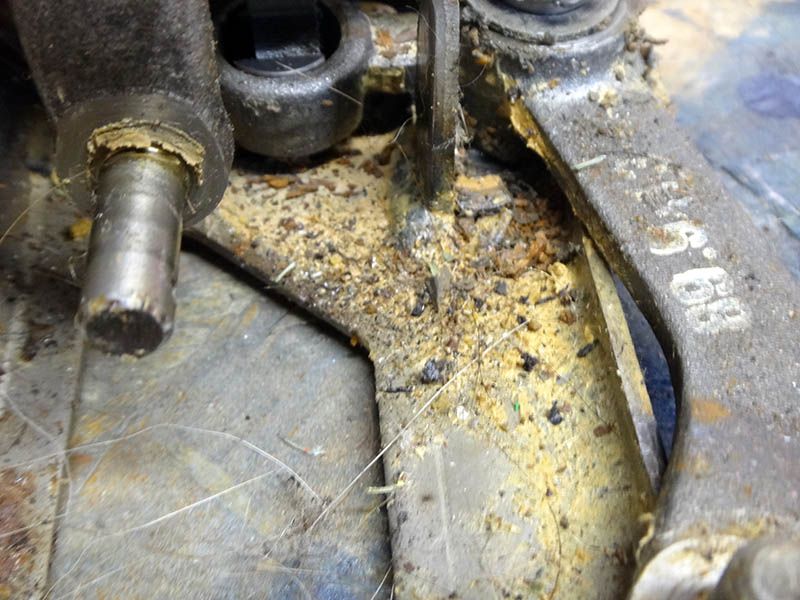

Did a mini shifter rebuild, new bushings all around. Feels like a real car shifter now instead of metal clanging on metal.
NEW BUSHINGS
DIRTY SHIFTER OUT OF THE CAR: A couple of the bushings didn't even EXIST. They had completely disintegrated.
Some of this is dirt and human slime, but I think some of it is the old disintegrated bushings.
NEW BUSHINGS INSTALLED and CLEANED UP!
And here is my before and after:
[ame=http://youtu.be/lvIH8n2Em7w]DSM 1G Shifter Bushings Replace - Before and After - YouTube[/ame]
Wow this is really quality work! You really put time and effort into every little piece you put into your car. This will be a great guide for people to look to for upgrading their stock dsms. :hellyeah:

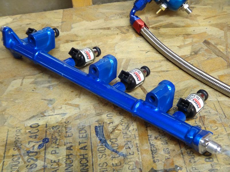

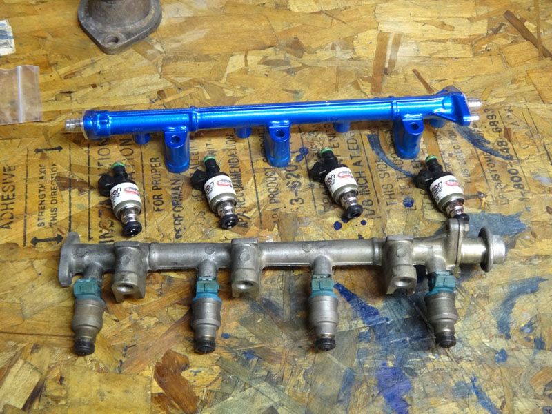

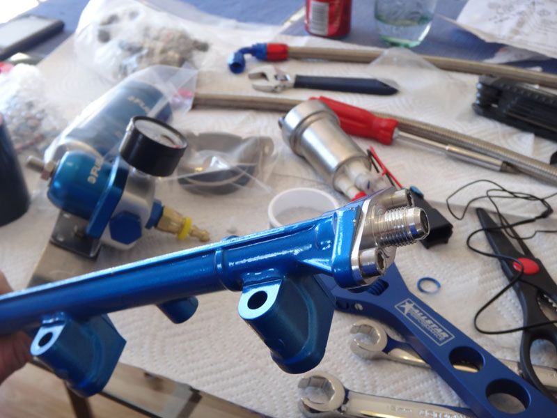

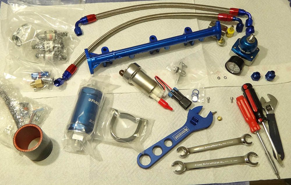

Yesterday I finally got around to installing all those fuel goodies.

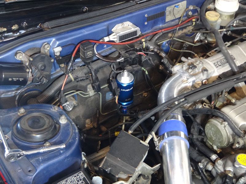

AFPR
FUEL FILTER
WALBRO 450
1000cc INJECTORS
I took my time, read the VFAQ, read articles here on tuners, watched a bunch of helpful videos on youtube, made sure I had the right tools and dove in.
A year ago this job would have terrified me. But after all the maintenance and upgrades I've done over the past year, this turned out way easier than I thought it would.
First up, get the fittings on my shiny newly painted fuel rail.
Old filter out, new filter in! Looks shiny!
Old fuel rail out! New fuel rail next to it!

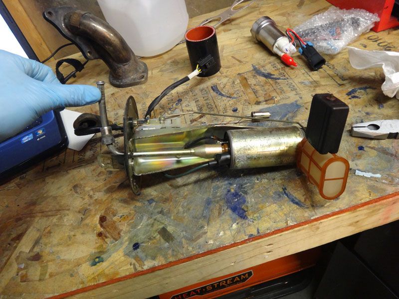

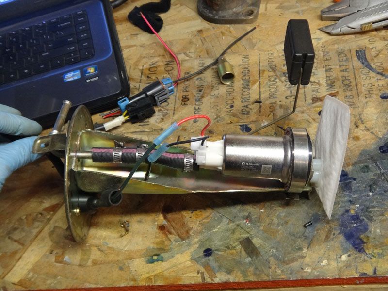

Old fuel pump:
WALBRO 450! :hellyeah:
http://www.dsmtuners.com/forums/articles-engine-fuel/473823-walbro-450-install-1g-awd.html
Everything installed! I need to pick up a couple longer hoses for the AFPR to get it mounted properly.

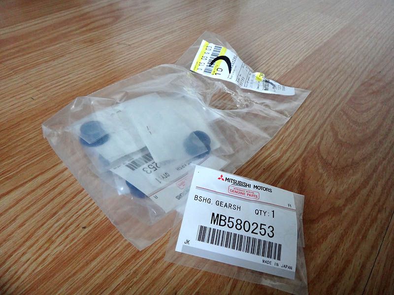

Did you use the stock, plastic bushings for the shifter? I had really good results using the metal ones from the transmission instead, they're dimensionally the same but more durable (p/n MD71916, at least for a 91+).
Love what you did with your car, very much what I am hoping to be capable of doing with mine if I ever manage to find myself a house with a proper garage.
I used the oem bushings (MB580253) from JNZ OEM Shifter Bushing-90 DSM : JNZ Tuning
