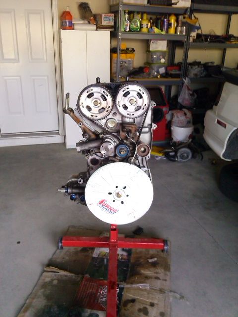

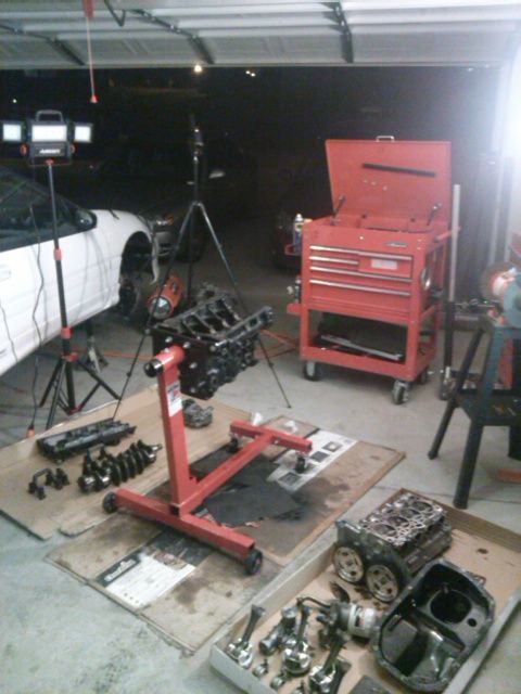

Its time to pull the heart out and give the motor a good once over. Along the way, we will lay out some of the plans for this winter.

Here is a sneak peak about the next couple of videos in the pipeline. Picked up some new lighting, a new camera and some new tools to play with.
Don’t freak out and think I already put the motor back together, I checked the cams when I tore it apart but more on that in the video.

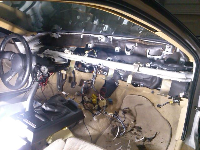

Not really sure. Maybe because I removed all the heat and AC components? This part has been covered up for 24 years protected by the dash from everything but dust so I expected it to be in decent shape.
