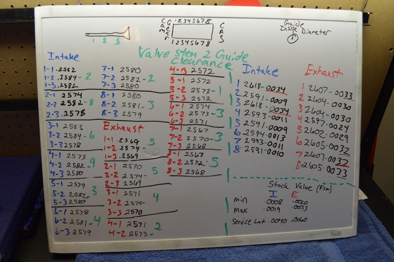

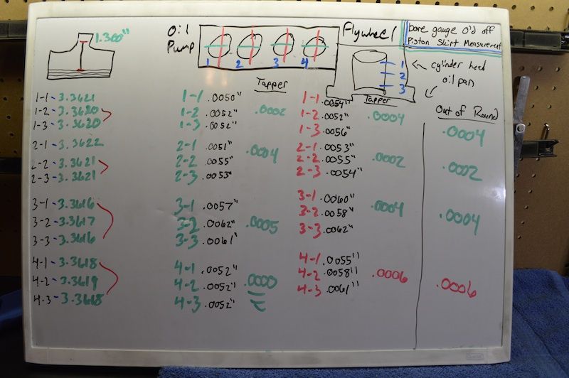

Anyway, I have completely blueprinted the block and head. I found .0015” tapper in my number 3 cylinder. This made my piston to wall clearance .006” which is 1.5 times the recommended .004” PTW from weisco for their 1400 HD. A few of the valve to guide clearances are grossly oversized and the cam bearing surfaces are pretty scuffed up. I have obtained a new stock longblock that will be sent out for machining hopefully this week or the next.

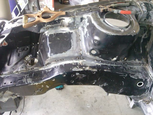

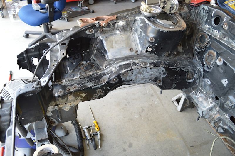

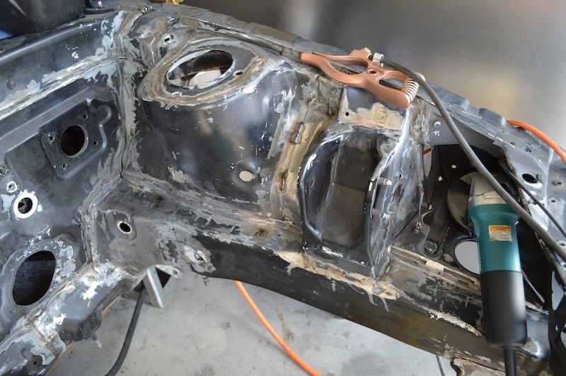

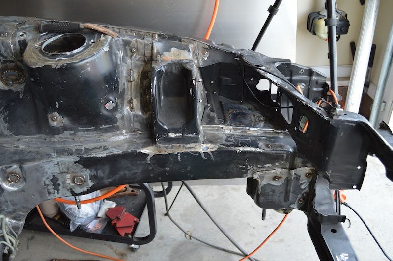

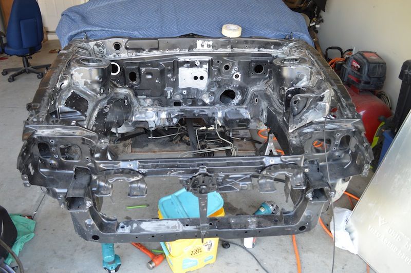

Now for the engine bay. I have pulled every nut and bolt so that it is only a frame from the firewall forward. The engine bay has been stitch welded and I am in the process of filling all the holes that I do not plan to utilize in order to make a cleaner bay. Various unused bracketts have been removed using a spot weld drill bit. The old spray paint will be removed then she will get epoxy primer, a little filler where necessary, block sand, primer surfacer, sand, color, and clear.

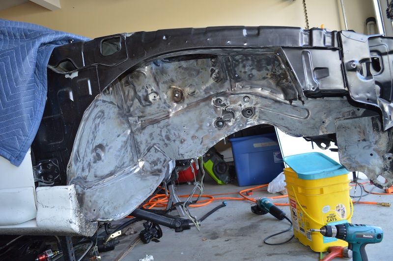

To avoid a lot of contamination from the backsides of the welds, I also cleaned the wheel wells and removed all the seam sealer.
This was just the start of the stitch welding.

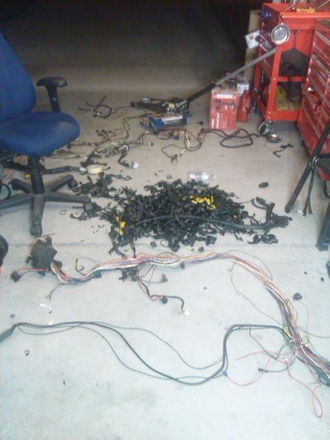

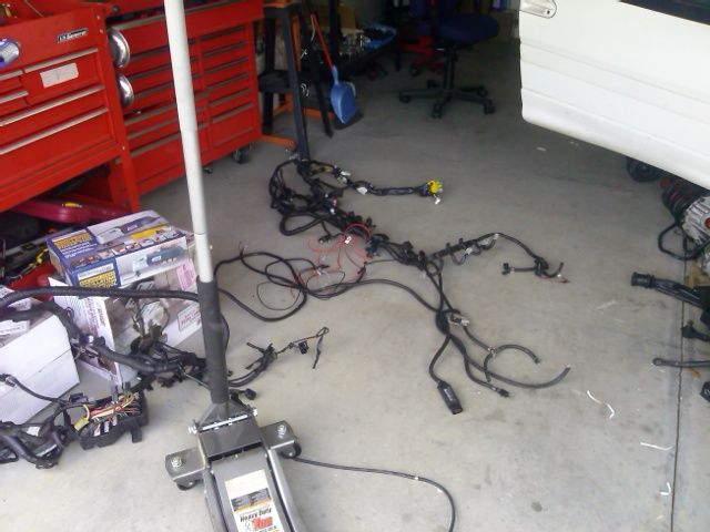

The wiring harness has been pulled and de-loomed. We will be rerouting this once the bay is finished and primed to protect it from the elements.

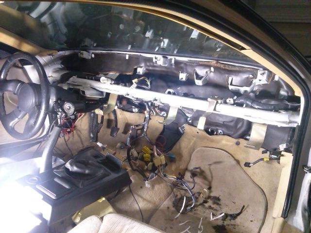

Lastly, the dash has been pulled along with everything else underneath it. This was to make the welding and painting a no hassle job. We also needed to get to the wiring harness and remove some sound deadener.
This picture still shows the steering column and a few other items still in tact but all of that has been removed now.

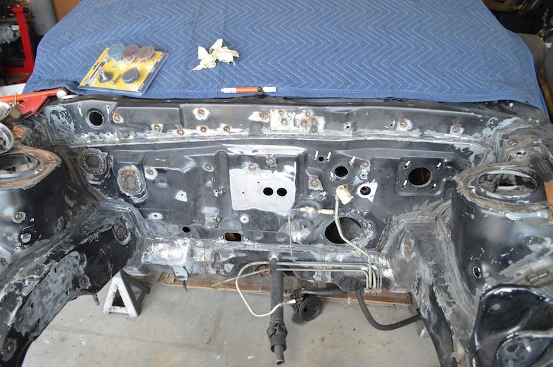

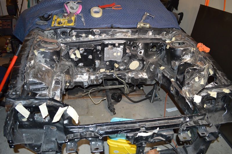

Small update as the work continues to keep going. I managed to get all the unwanted holes in the firewall filled and sanded down.

Tonight I made my last round of things to fix/remove and all of these should be done tomorrow. After that is sandblasting and primer.

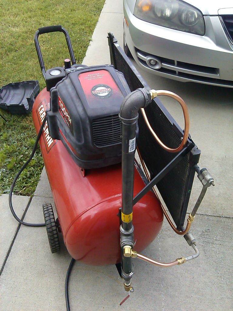

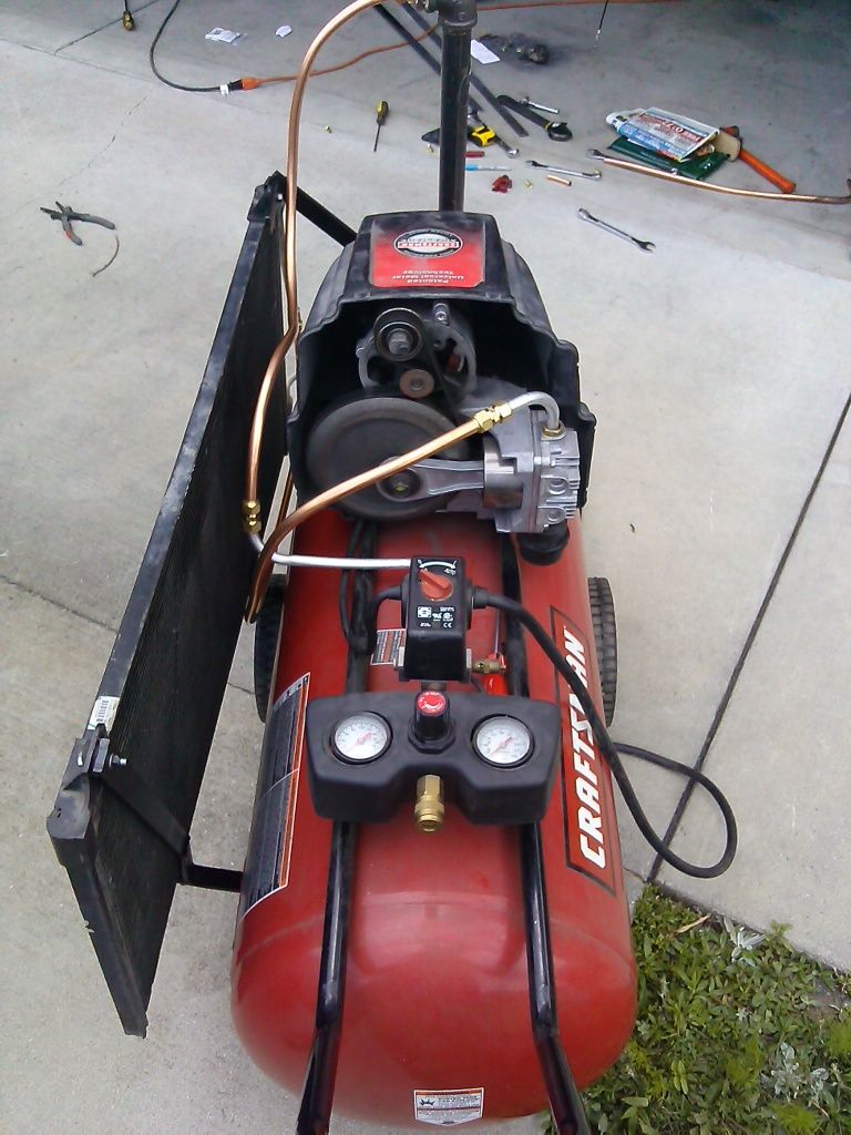

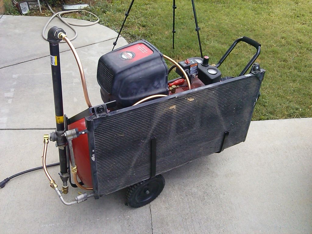

One thing you need when sandblasting and shooting paint is Dry air (and a bigger compressor than the one I have :p) so I put an intercooler on my air compressor. Everything in my garage gets performance upgrades :)
