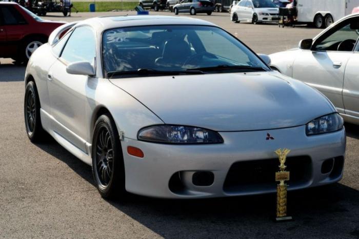

@ kidtsi - the car in your profile is running the +27mm offset correct?
