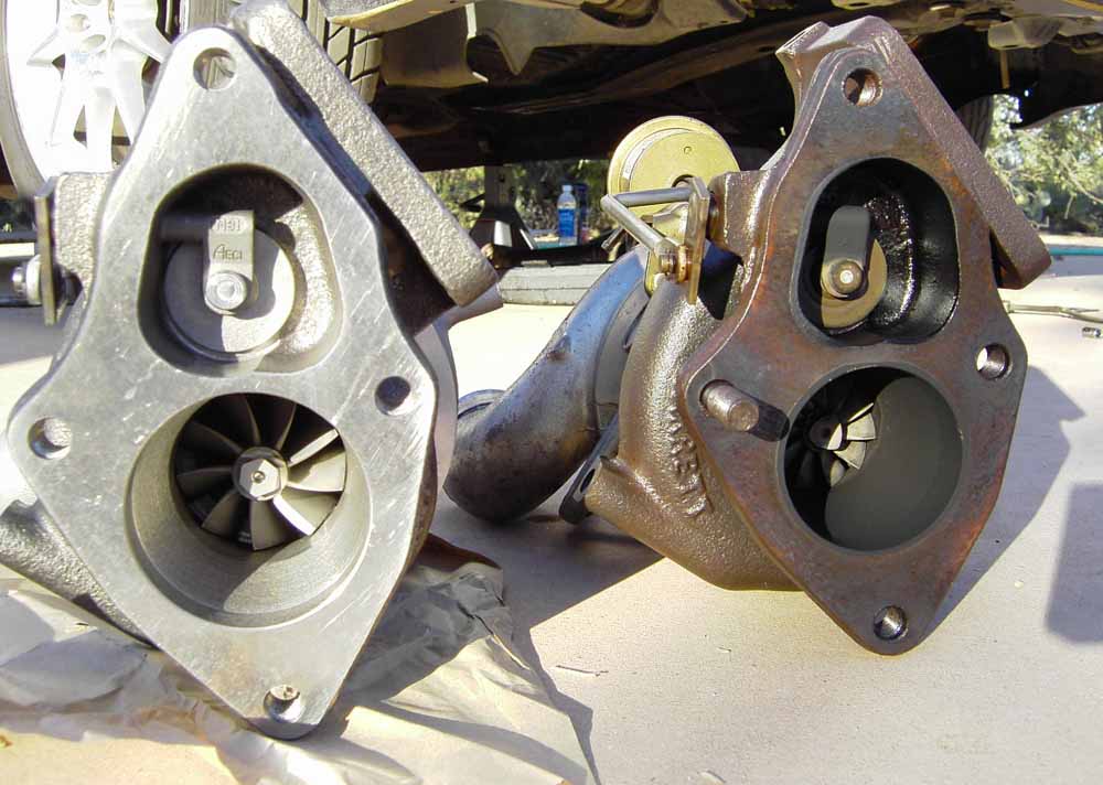

It *seems* like the t28 flapper is larger in the pic; they were saying it as well. I don't know for sure but I'm trying to get someone to measure the flapper on their t28 today. BTW the t28 in the pic straight from FP. My friends is a "normal" t28, not a bigt28 killa etc.

So, I took apart a t25 and t28(not the"bigt28," it was from gpopshop) tonight.
Sure enough, the flapper was 32.5mm in diameter on both. The turbine inlet and outlet were the same diameter as well. I would have said it's the same turbine housing if there weren't slightly different numbers cast into it; the t25 had .45 a/r while the t28 had a .49. As far as I could tell, the same size turbine wheel too.
There is a good amount of material that could be removed from the wastegate hole to better match the flapper, and I believe this would help your creep issues the most. The WG hole is about the size of a quarter, or 24-25mm, compared to the ~33mm flapper.
The flapper in it now gets hung up on the side of the wall if you open it too far, and I don't see you being able to put anything larger than a 34mm flapper in; which is pretty much pointless. It's just machined that close.
My suggestion if the FP turbine housing is the same/similar:
Take the turbo off(or just the turbine housing with the CHRA still on the car, difficult with t2's) and enlarge the WG hole to fit the flapper. Still leave some overlap though, about the thickness of a nickel all the way around(~1/16"/2mm). Do this with the turbine housing off from the turbo, and be sure to remove any chips before assembly of course.
