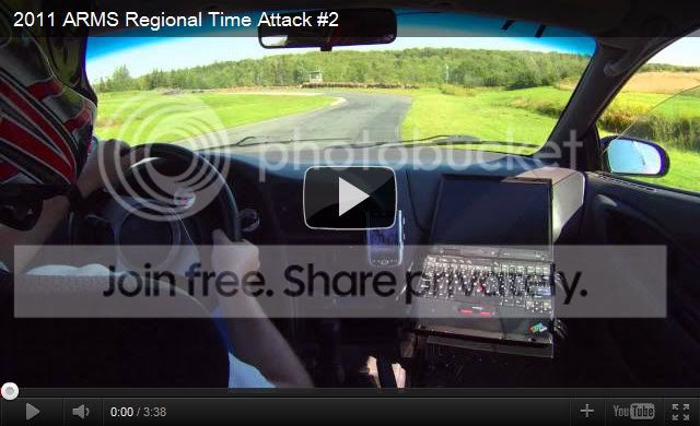

Here's a video clip of my first & only session, complete with numerous annotations:

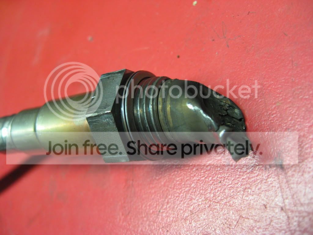

However, in preparing to replace the O2 housing I removed my WBO2 sensor and found it to look like this:
Next to come off was the O2 housing. Initially I thought that it had got too hot and the exhaust blew a hole though it, but these pics tell a different story.
Obviously something hit it hard and punch a hole through it. Wonder what that could have been?
Hmmm... So lets take a look at the turbo and see if anything is missing.
Yup, definitely something missing. Turbine wheel snapped clear off the shaft. What could have caused that??!
