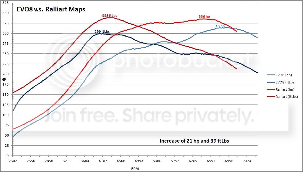

No dyno charts, but I have this one I created in Excel using the HP calculator in ECMLink...
It's from when I was experimenting between different timing & air-fuel ratio maps in the ECU, hence the labels.
Is this at the flywheel or wheel power? What kind of Timing and AFR are you getting away with to max this Little T-28 out like you are? Once again props on the great power produced using 91 and a tiny turbo!! Hope i'm not too much of a bother. I'm just very curious, I'm running a T-28 myself. The most power i ever measured was 220whp at 18psi on Full Function's mustang dyno, and 260whp on Thunderhill's Dyno Jet at 23psi peak. Both on plain 91 with AFR 10:5:1 - 11:3:1. Stock timing, took a little out in the peak torque, and towards redline. Wondering if i'm playing it to safe or if i can produce more with less timing and little more boost? I've always thought a T-28 loses efficiency after 24-25 psi peak, and definitely towards redline at that psi? again thanks for all the info.
