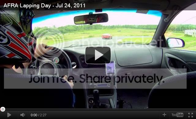

Here's a short clip from day, driving in traffic. This was before I learned that I need to turn down the camera's exposure setting for in-car stuff, so the external view is kinda washed out.

That looked like a blast. You know that track pretty good by the looks of it.
Yes, it's great fun! Even more so when you're not preoccupied with mechanical gremlins.
