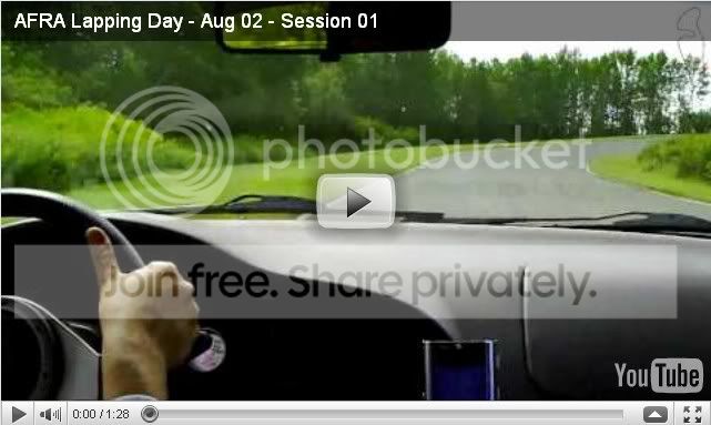

Here's an onboard video of my fastest lap of the session (1:22.285):

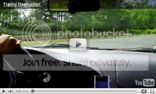

On my very first lap, while accelerating out of a turn, the engine suddenly free revved. WTF? No clunks, no bangs, no sound at all other than the engine spinning freely. I didn't know what was going on. So I put it in 4th gear and attempted to limp the car back to the pits. However, halfway there the drivetrain made a big *bang* *crunch* and the transmission was suddenly stuck in 4th. Uh-oh... This is not good.
Here's an onboard video of that terminal lap:
After parking the car in the paddock, I took a look underneath but could see no external signs of damage. Still unsure what the problem was, I called the flatbed and packed up for the day. :(
