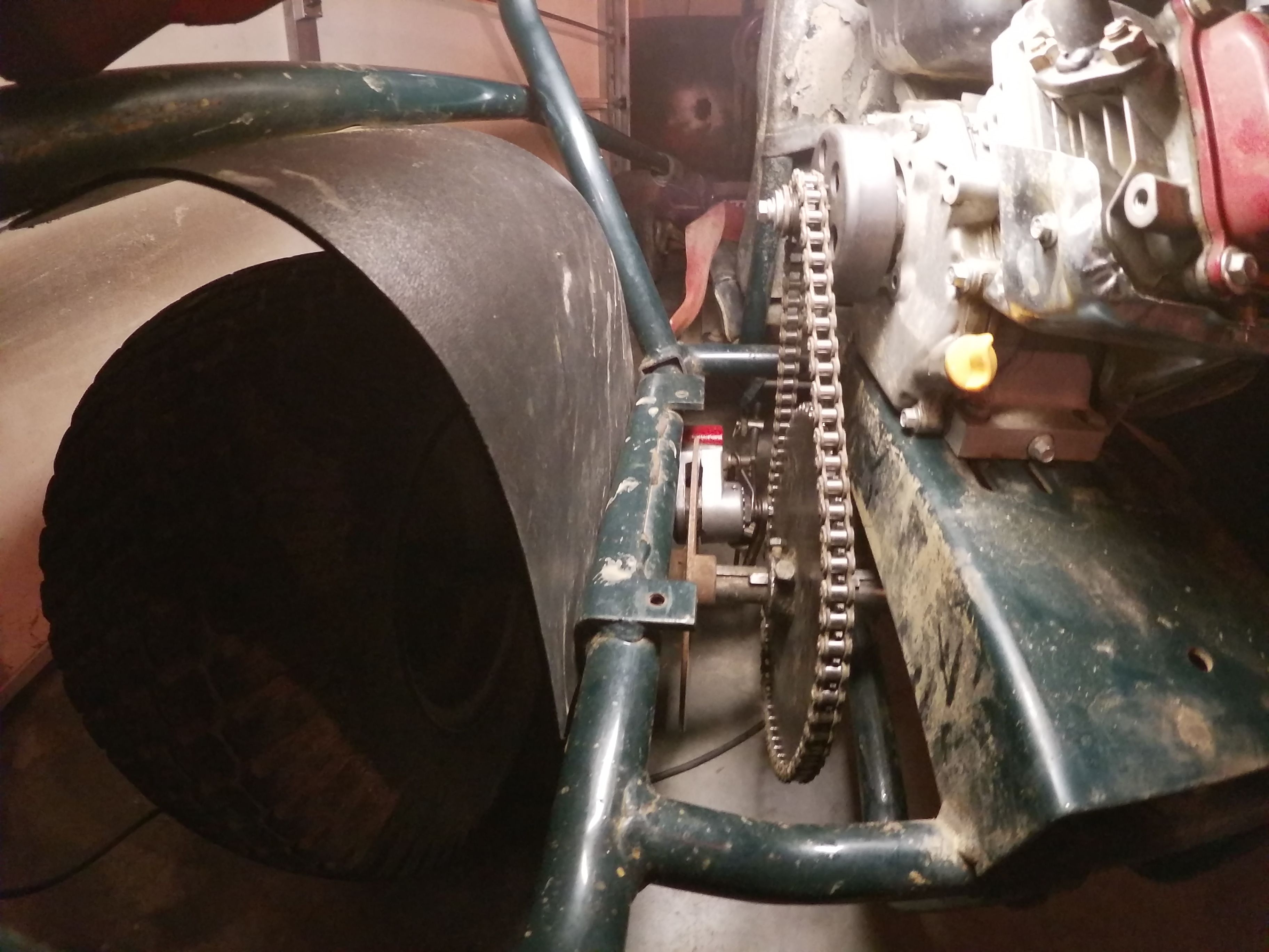

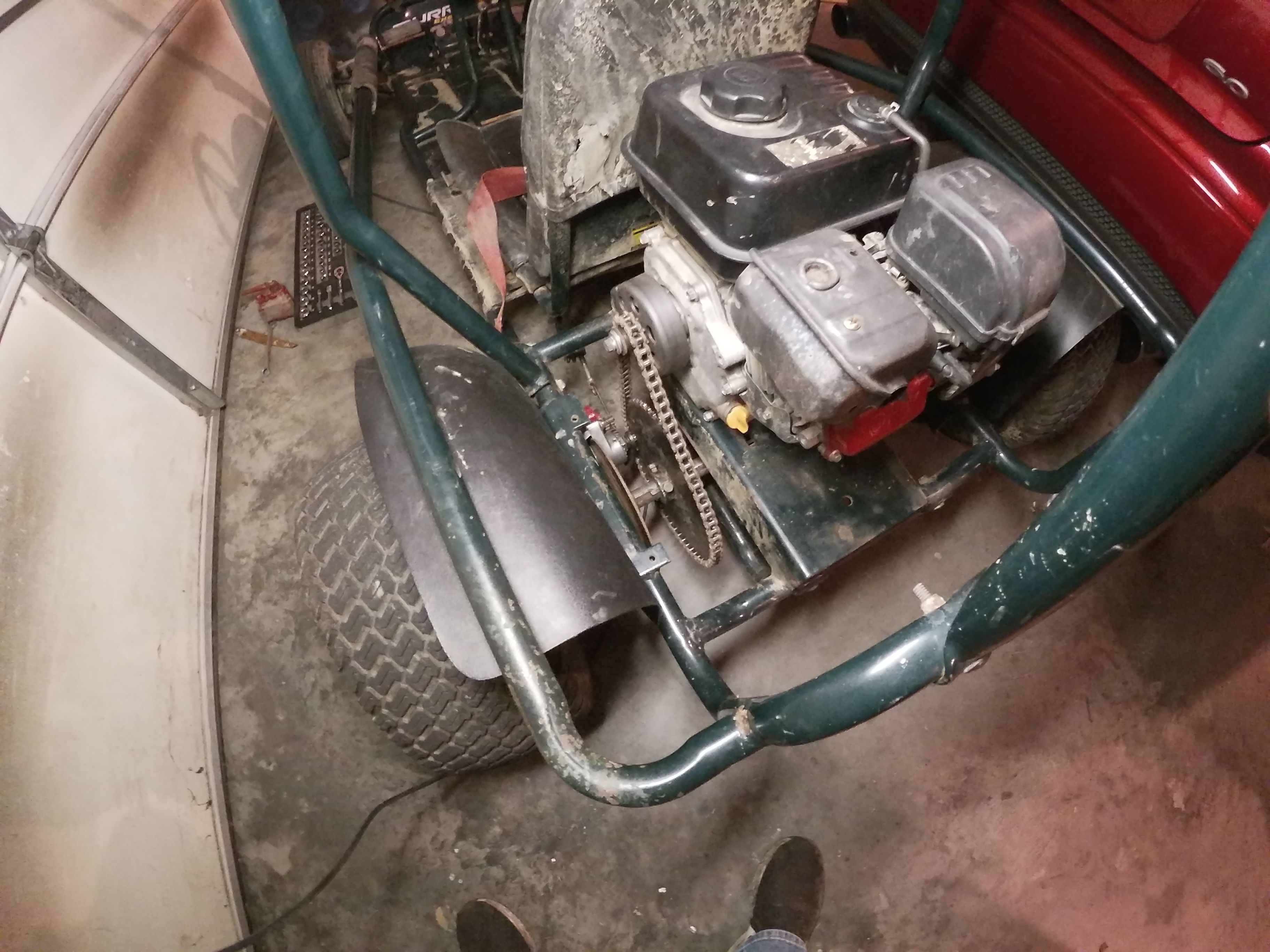

One thing you have to be sure of is that the chain has the perfect amount of tension on it. I had it too tight to start with and it had terrible clutch drag as soon as I started it. I then moved the engine about a half inch closer to the sprocket to get a little slack, and it engages very smoothly now.

The clutch chatters just a little on the first ride, like a break in period. But after that first ride it is very responsive and gets the kart moving pretty quick. The swap takes a little time and skill, but I 100% recommend it, you will get much better results than that torque converter. And you save about 20 pounds too :)

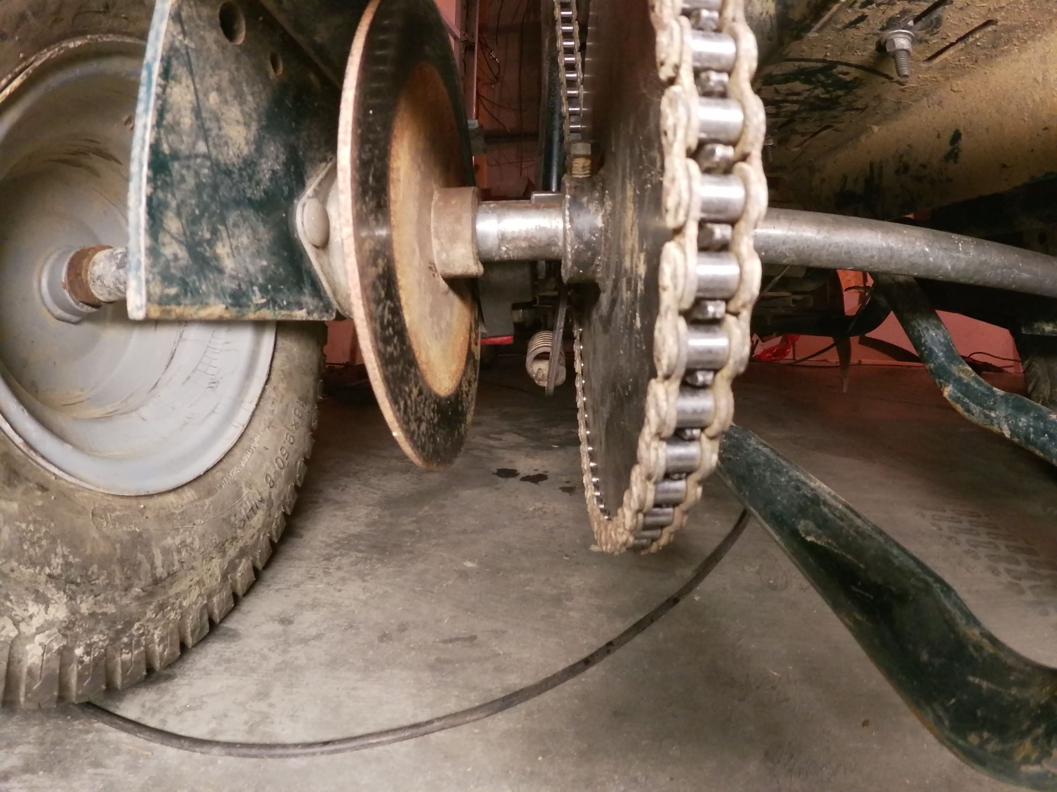

I was looking for your brake rotor and caliper and they seem to be missing, where is the brake at???
Or do you Fred Flintstone it???

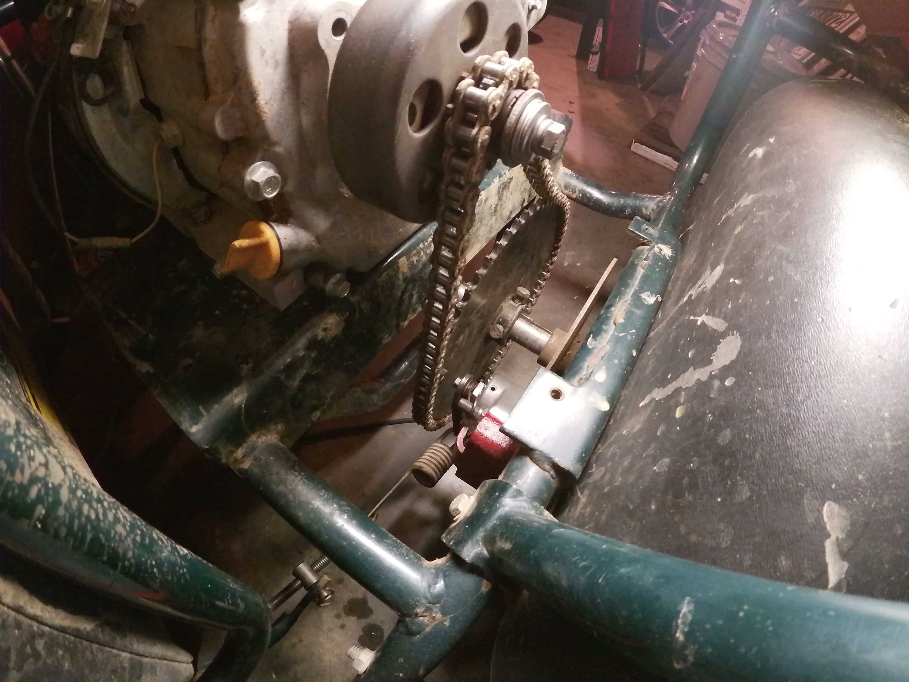

The rotor is there, just on the right side of the drive sprocket in the video. But the caliper is not there, I lost the spring when trying to tighten it so I have to order a new one

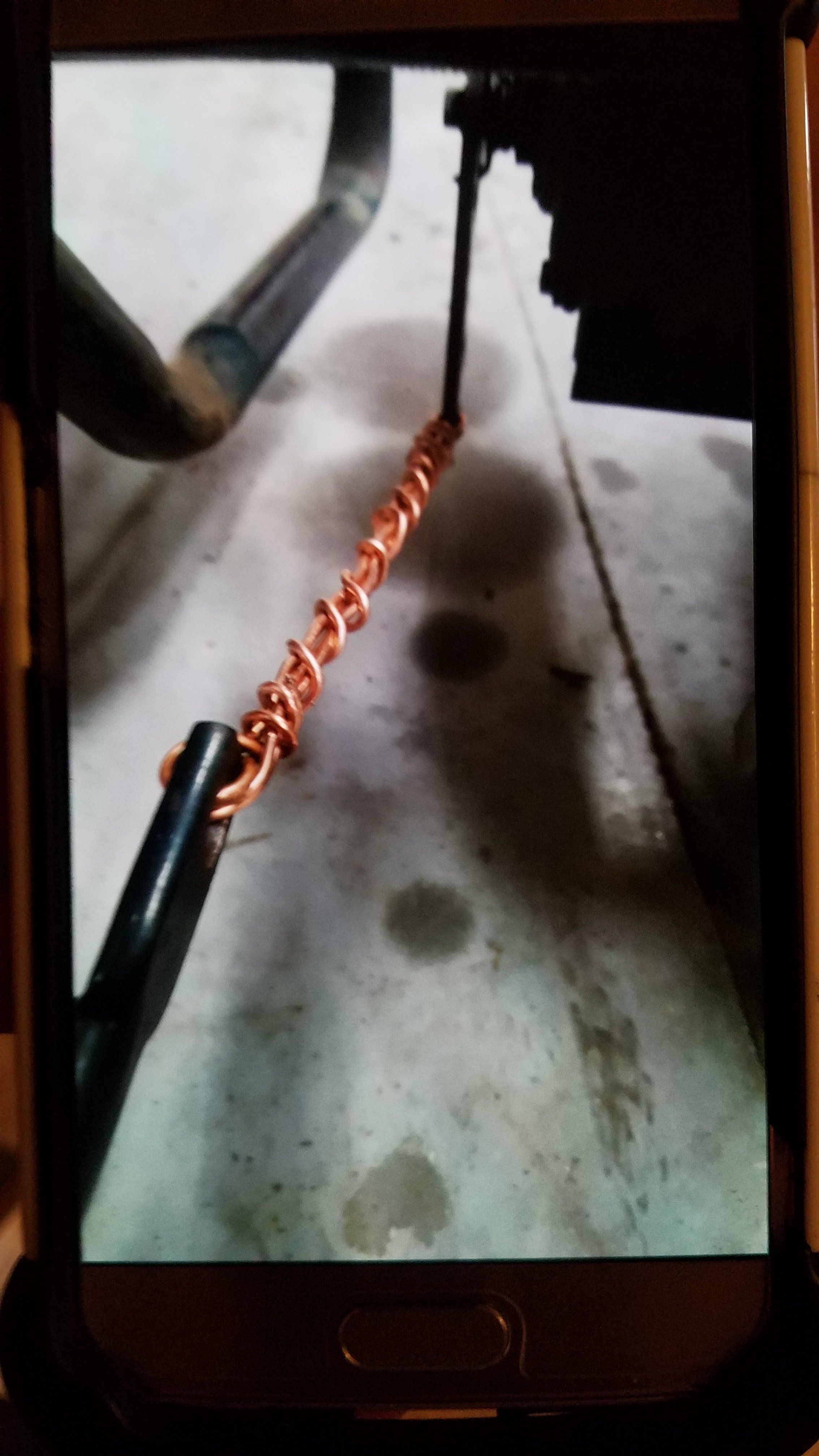

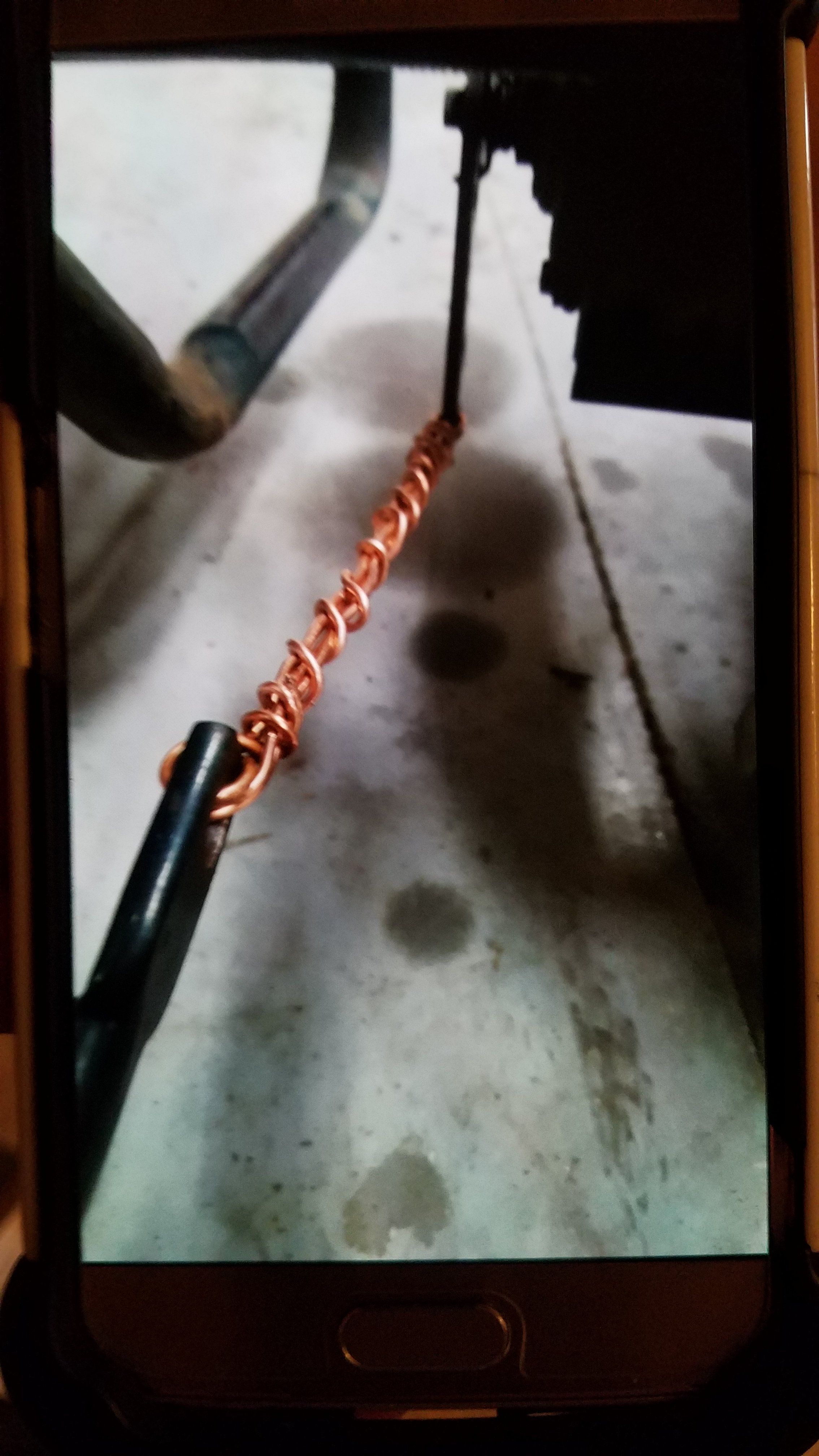

We DITCHED that dam spring. I told Trevor to put something SOLID in its place for better braking and here is what WE did (its a test but works very good, no sponge feeling). There shouldnt be springs in a braking system :f-u:
An adjustable ROD would be a good replacement. Brakes are much more solid and can lock up the tires now.
Thank you for sharing that. I'm about to order a whole new brake setup. Something is wrong with the caliper, the pads are worn, springs and bolts are missing... I'll just start fresh and maybe have a good working system.
Nah, Trevor has you covered until you need a better one. We'll get together!
I got the brakes installed. I guess at this point the build is finished. Until I can go stage 4 on the engine with nitrous LOL. Everything fits well, although a little tight. And everything works very good. I'm happy with the results. Here's some finished pictures. Sorry for the dirt, I couldn't help myself, riding it for the past few days.

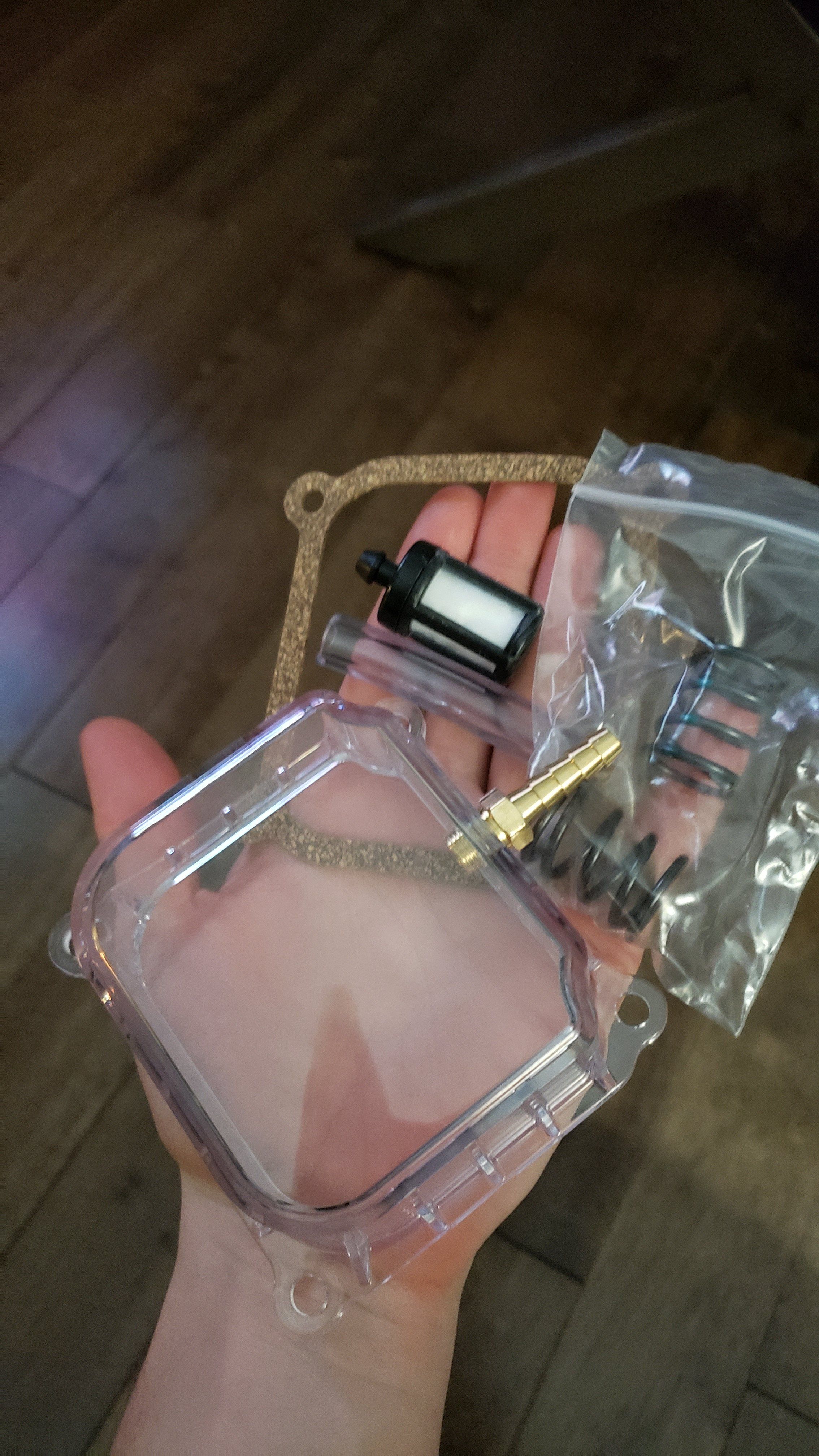

Since I deleted the governor, I've been experiencing a little valve float on the top end. So tonight I ordered some 18lb valve springs to replace the stock 10lb ones. That should cure the valve float and still leave room for more modification. I also ordered a clear valve cover, because why not? I can see inside my engine while it's running :hellyeah:.

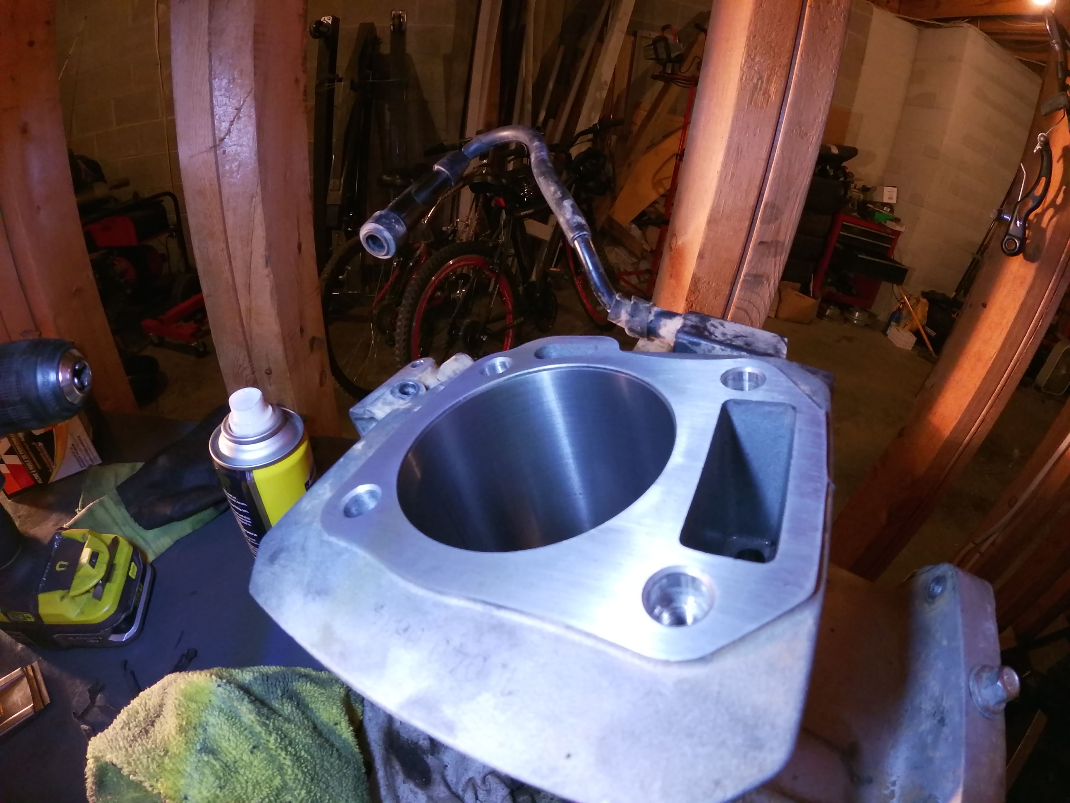

Just take a moment to admire this honing and surfacing work... I did it right here in my garage... It doesn't look half bad, I can't wait to get it all together and put back in. But I'll have to be patient, parts aren't even here yet...
STILL PLAYS WITH BLOCKS!!!
Pretty Solomon! :) Do you think you can get a good cross hatch on the cylinder or can I just not see it?
Anyway, good work, nice and shiney!!

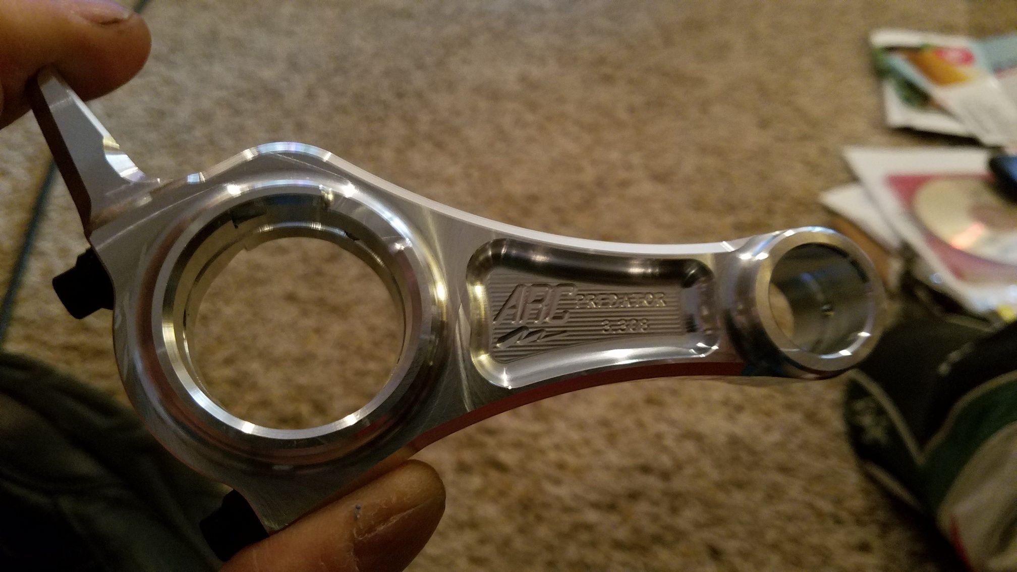

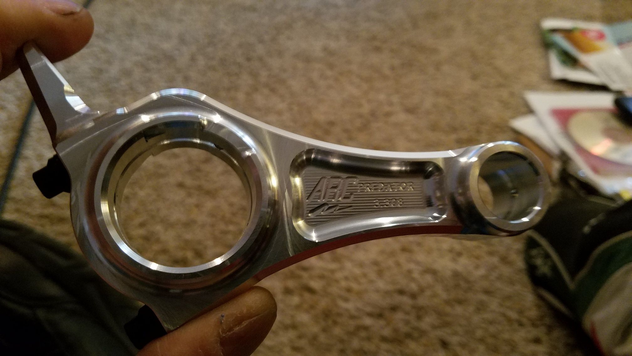

Trevor showed me a cool part, IDK what he is doing (you probably do) but take a look....
I also have one of those on the way. That's the billet rod, meant to withstand up to 10,000 rpm. The stock rod can break at 6,000 rpm, I consider myself lucky to have ran it there so many times.
It's kinda hard to get a cross hatch with a drill, I'll have to hone it some more tonight anyway since there's still a couple vertical scratches.
What size is the bore? I hone all of my blocks with a drill and a flex hone.
The stock bore is like 2.756 inches. I'm using a flex hone on the drill you see in the pic. It works quickly and smoothly.
I just realized, the reason I didn't get a steep cross hatch is because I didn't size the hone down before use, so it's set to like a 4 inch cylinder LOL. I'll size it down tonight when I hone it again.
Nonetheless you can still admire my head surfacing for now!
