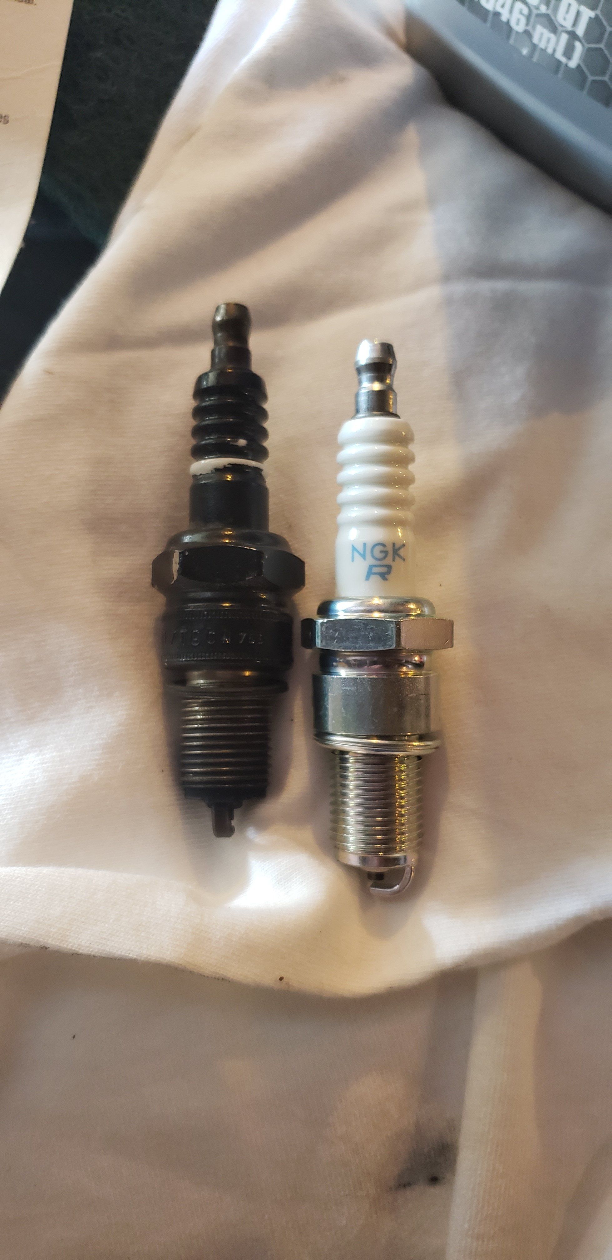

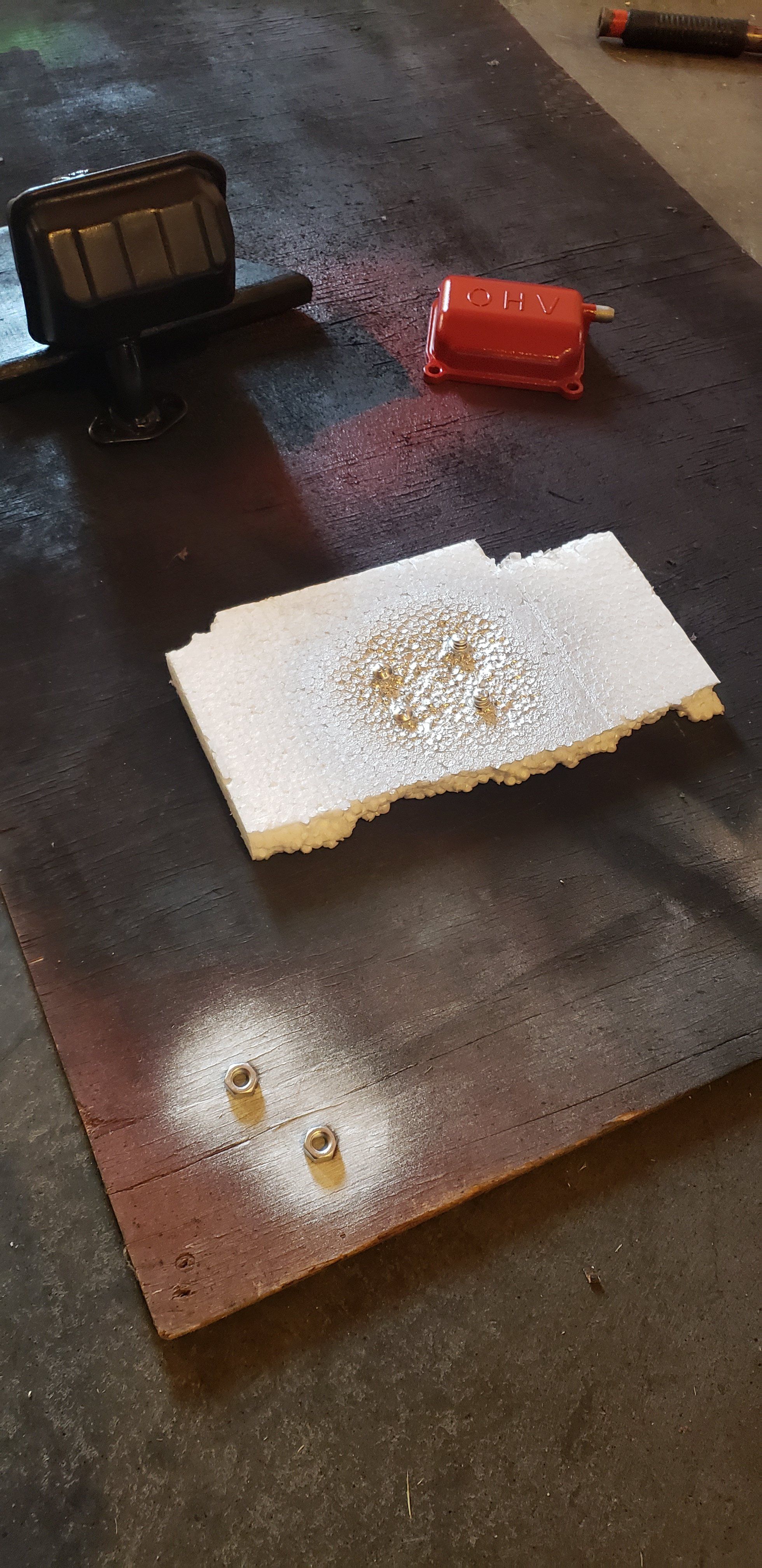

Yesterday I just did a tune up for some quick power gains, better throttle response, and quicker clutch engagement. I actually moved the engine farther away from the rear pulley in order to achieve tightness in the clutch belt. I also decided to run a small mix of octane booster in some ethanol free gasoline. NGK plug, valve adjustment, oil change, and some paint to make it look good. This 4 hour project made this thing a whole lot more fun and attractive.

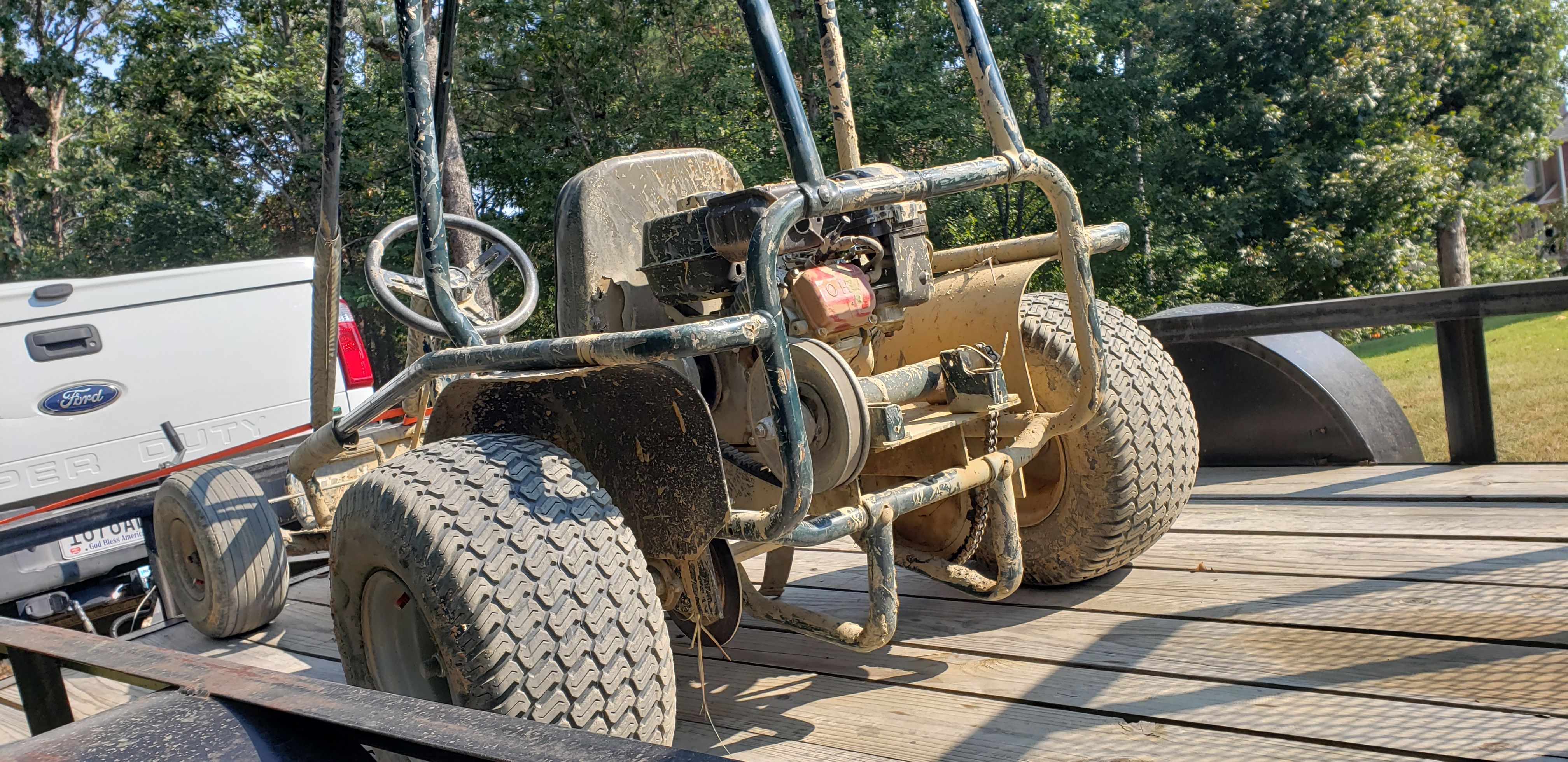

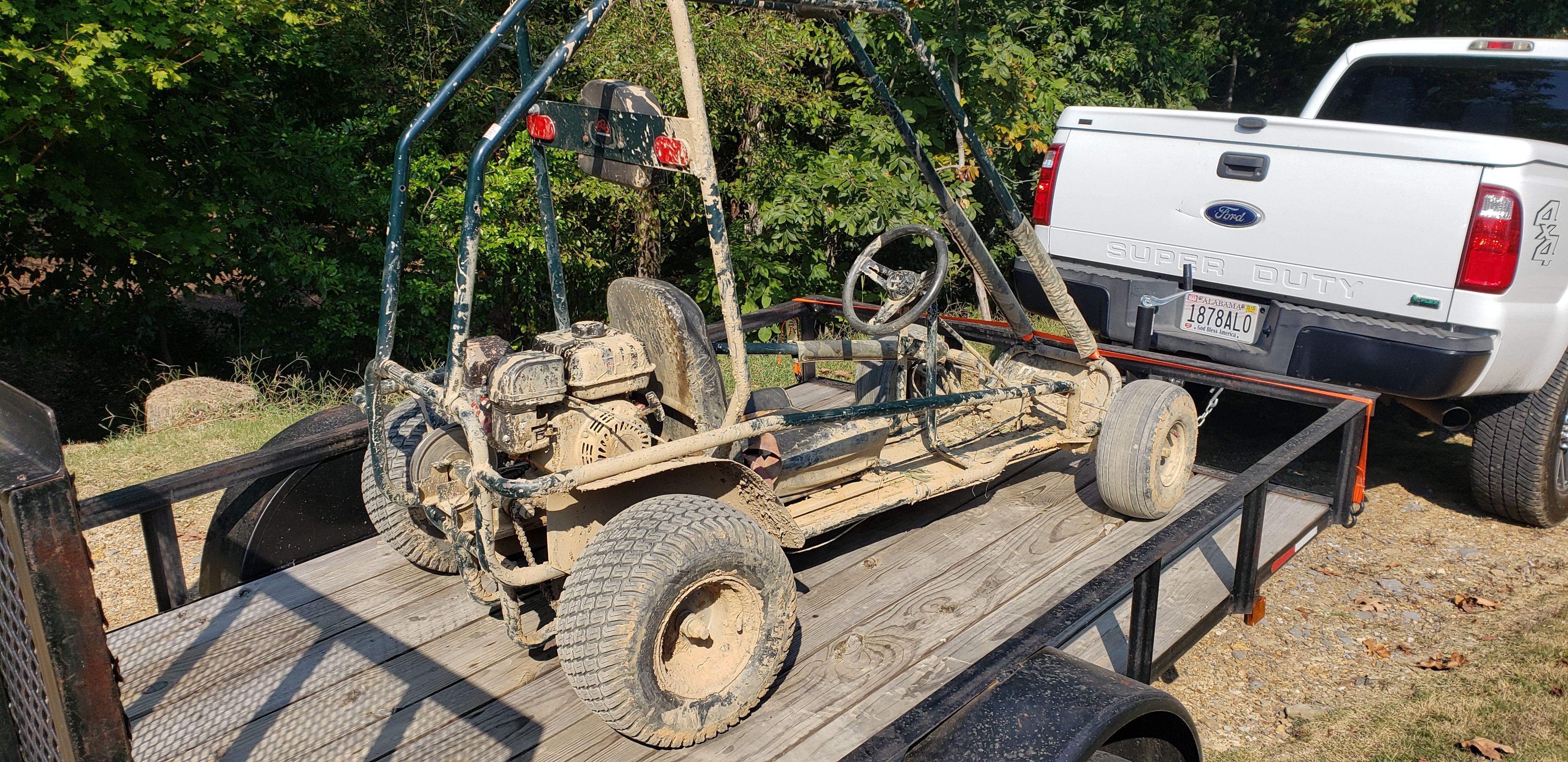

I climbed a 65-75 degree hill with it today. I was super impressed with the performance. I expected something to break out there within the first 5 minutes but it took 2 hours of hell and still nothing broke. I even flipped it upside down, got a couple feet of air, leveled a few trees, etc etc etc... This was the best adrenaline rush I've had in years. There were a few moments when I was sure I was bound to total it. But it held up better than I could have asked for. And some how my body held up too LOL.
I will post some pictures os whatever damages there are tomorrow.
Dang that was fun................ :cool:

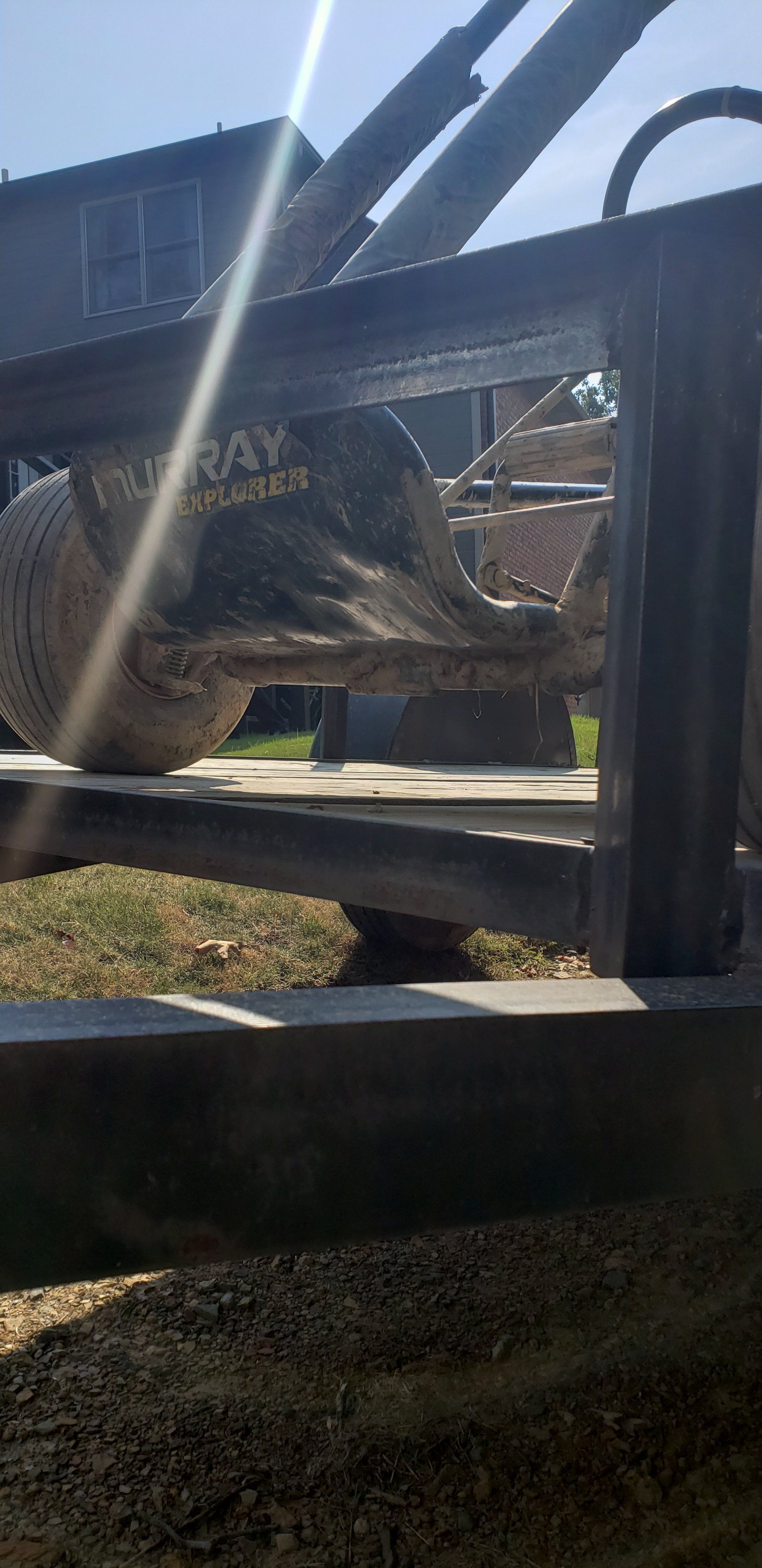

You can see the dents on the front where I plowed through those trees LOL. My friend says I was flying.

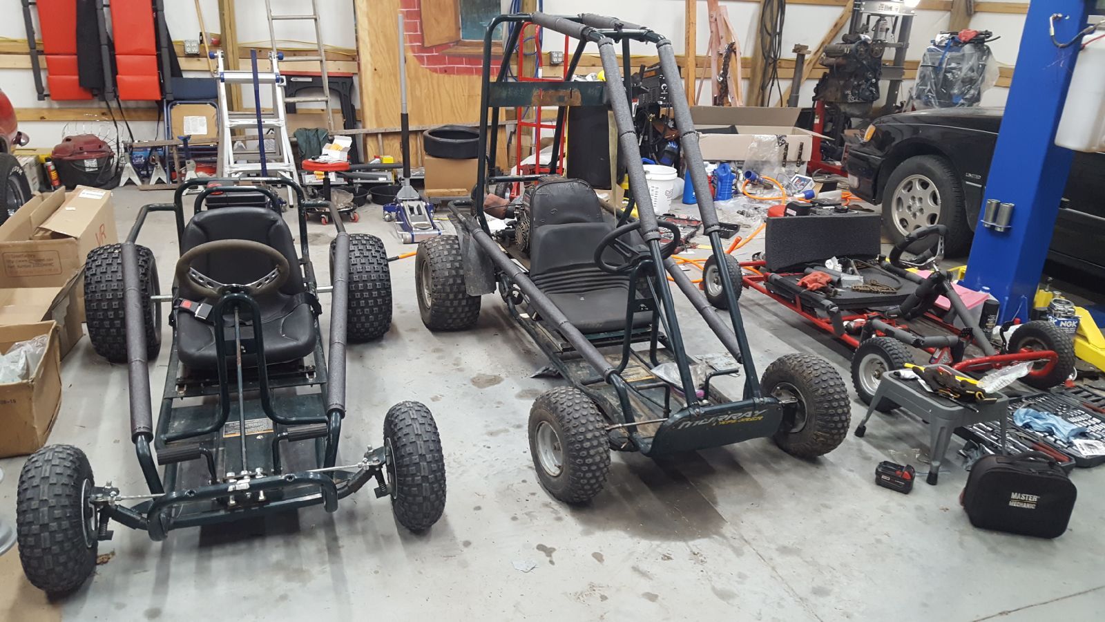

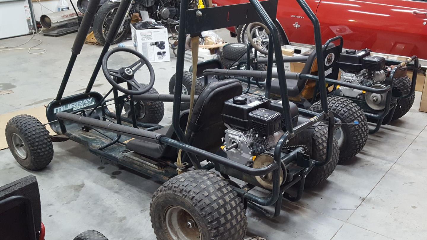

My son says it is usually pretty easy. He said that he thinks you just remove the jackshaft plate and relocate the sprocket. He is getting pretty good with these fun toys!!! Proud of him, bought him 2 Predator 212's for Christmas!!! He was breaking in the motors this weekend and we completely forgot one was running for 3 hours! LOL He said, well that one is broken in. We were both surprised it hadn't ran out of gas!

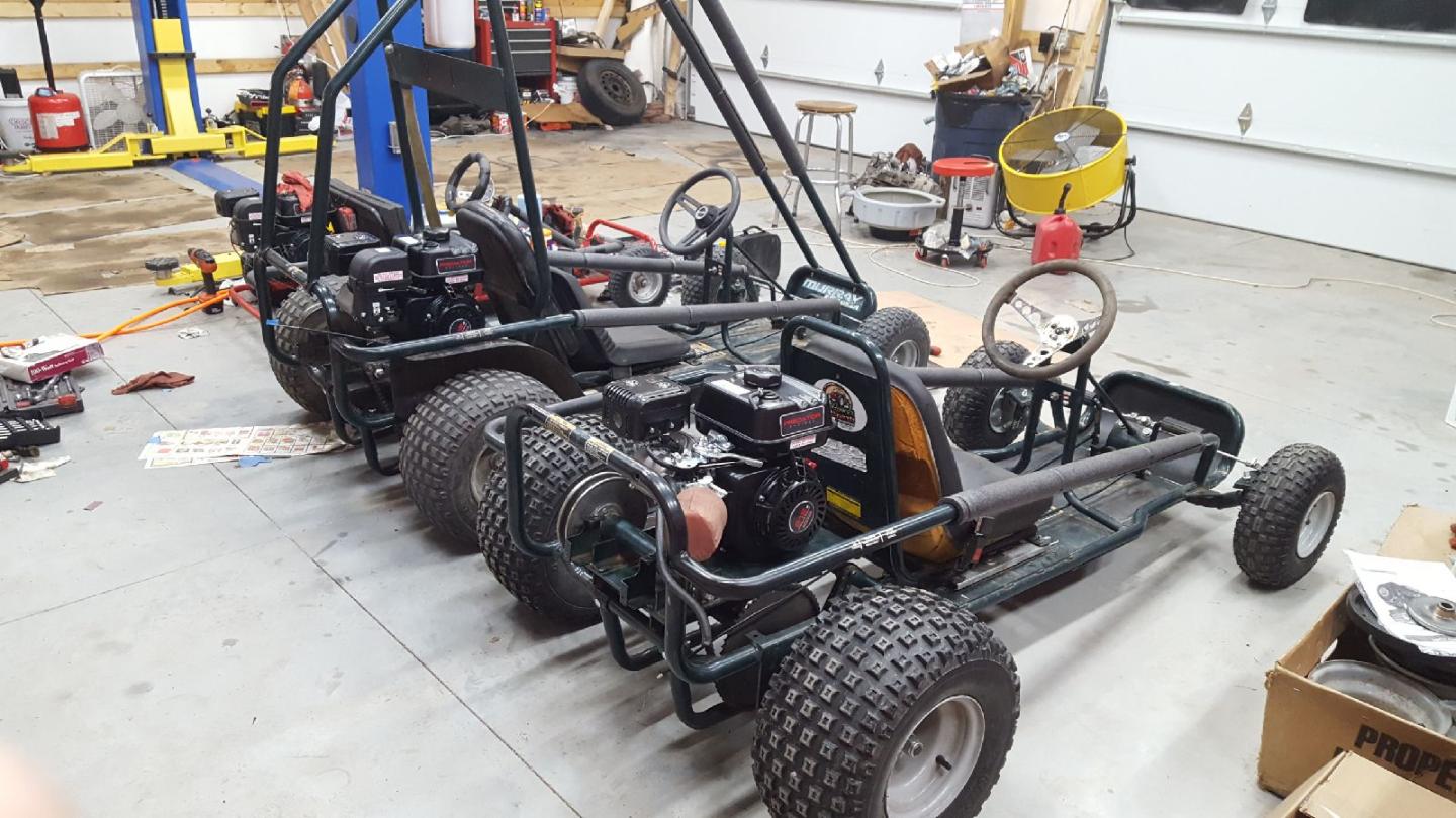

Here are a couple pictures of his toys :)
Following to see how that works out Solomon!
View attachment 585597 View attachment 585598 View attachment 585599

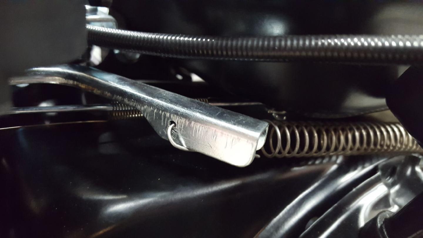

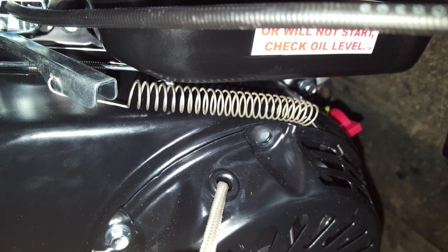

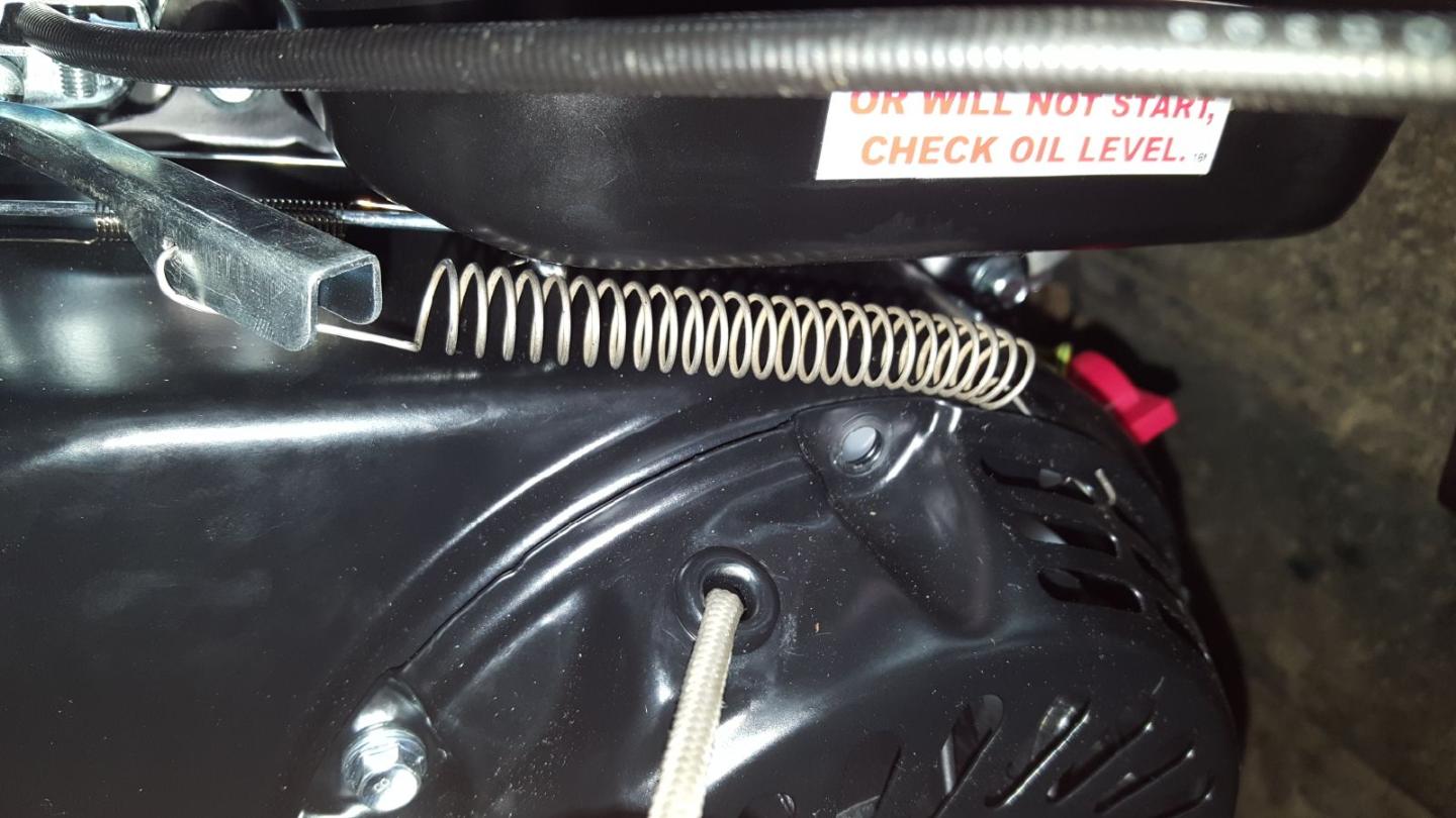

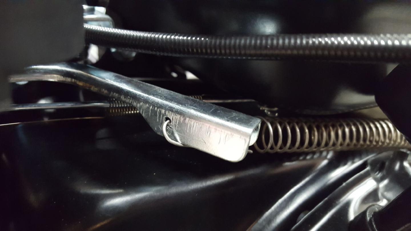

How did he place the throttle return spring when doing the governor delete? I drilled a hole in the pinch of my gas tank because I decided on a whim and wanted to take it for a spin. There's nothing wrong with how I did it, but I'm just curious how he did it because my way seems to be the only way to keep any tension on it.
I'll have him send me a picture. I thk we drilled a hole in the throttle arm and attached it to the starter cover but not positive.
Here is what I thought we did Solomon.......Trevor sent me pictures for you. :thumb:

I will Sol, thanks! He likes to see what other Murray guys are doing and is on some kind of forum for them. He was wondering how well the take off would be and how long the clutches last, pushing a heavy cart like them. Our little Carter cart has the centrifugal clutch but its much lighter.

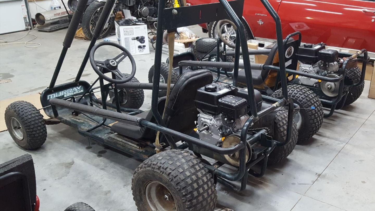

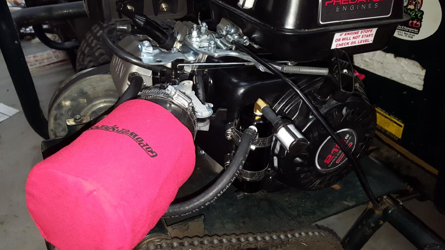

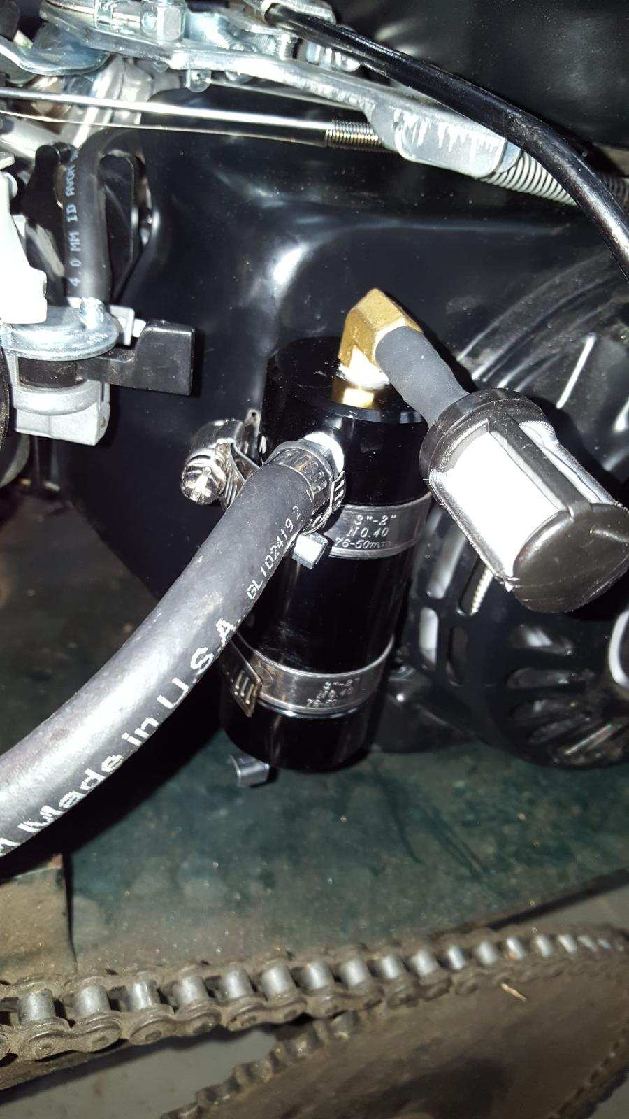

Trevor just got one cart fixed up with a new motor and even has a cute little catch can on it now....check it out....it's about a 1/4th the size of a normal generic catch can for a car.

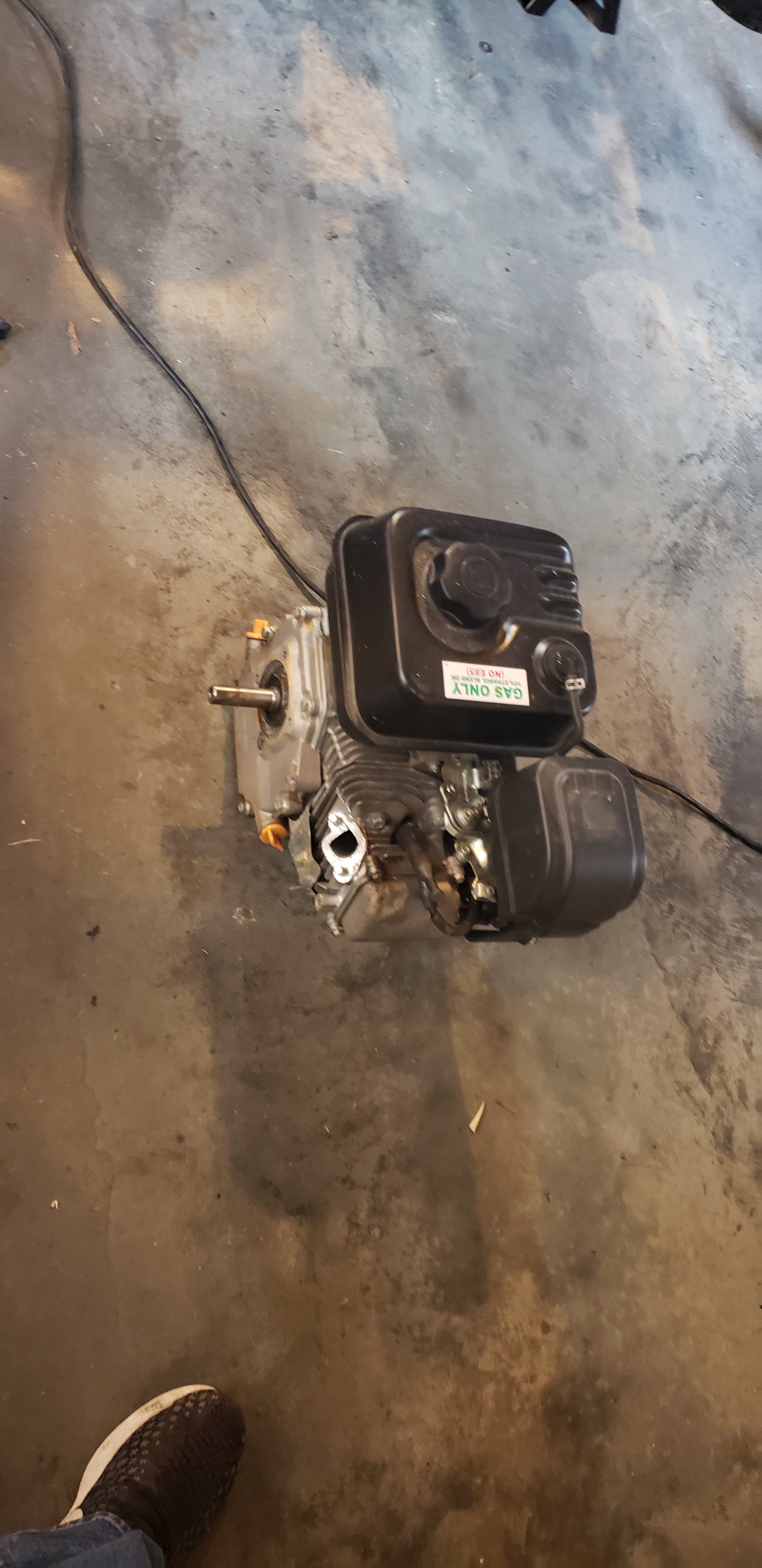

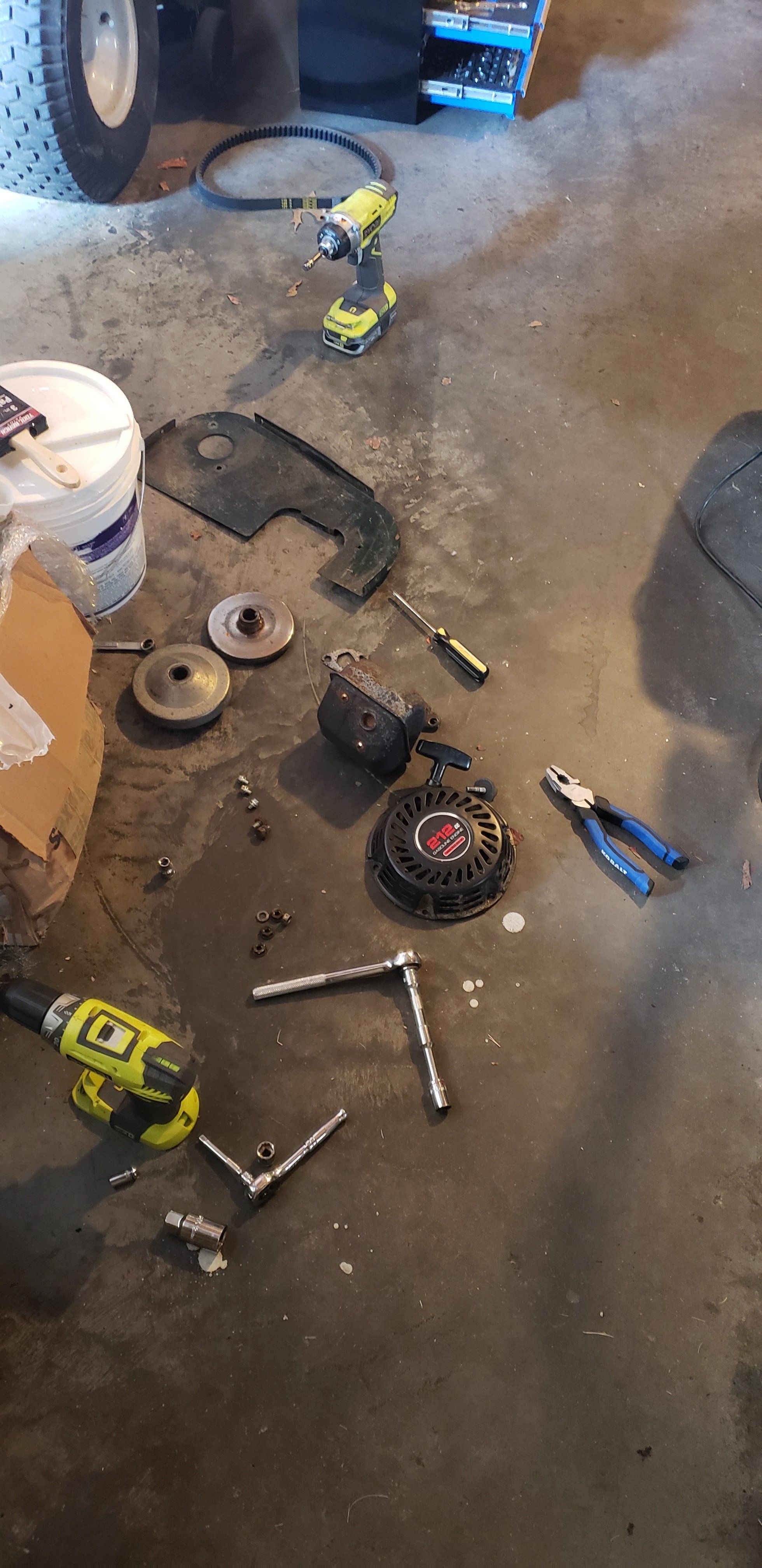

I got everything taken off, and then ran out of time. I should be able to get the swap finished tomorrow, and some riding footage.
This is taking a bit longer than I thought it would. Tonight I got the axle polished and the bearings reinstalled. I put the new clutch on the engine and realized that the chain was actually 4 links too short! But this is not an issue, as I can just drill some new engine mounting holes and still use the stock chain. I have some video on the way, it is uploading...
EDIT: Removing the torque converter plate makes the chain fit. No drilling required.
