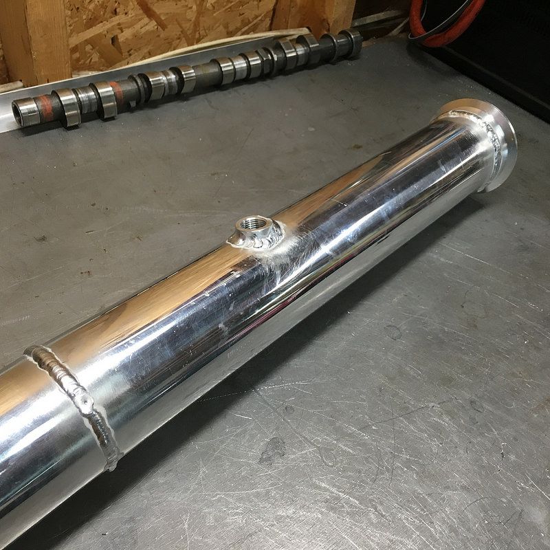

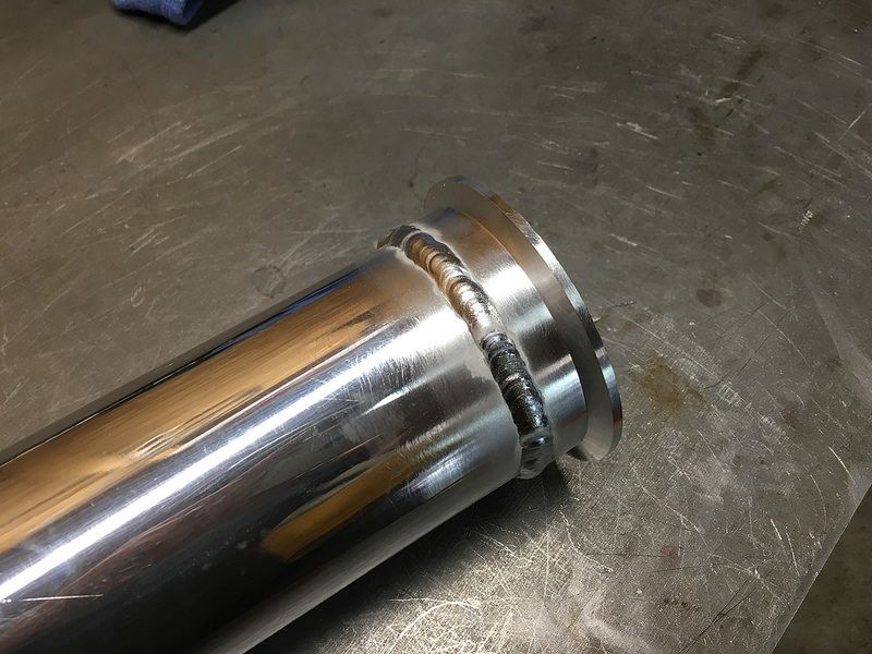

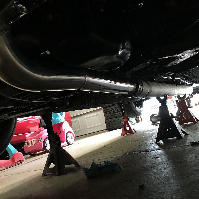

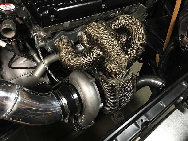

Made the downpipe yesterday and wired in the forced four shift box.
Should be able to fire up the car this weekend.
The exhaust consists of 3" SS o2 housing to oil pan > 3" aluminum downpipe > 4" aluminum to the back with a 4" vibrant aluminum muffler.

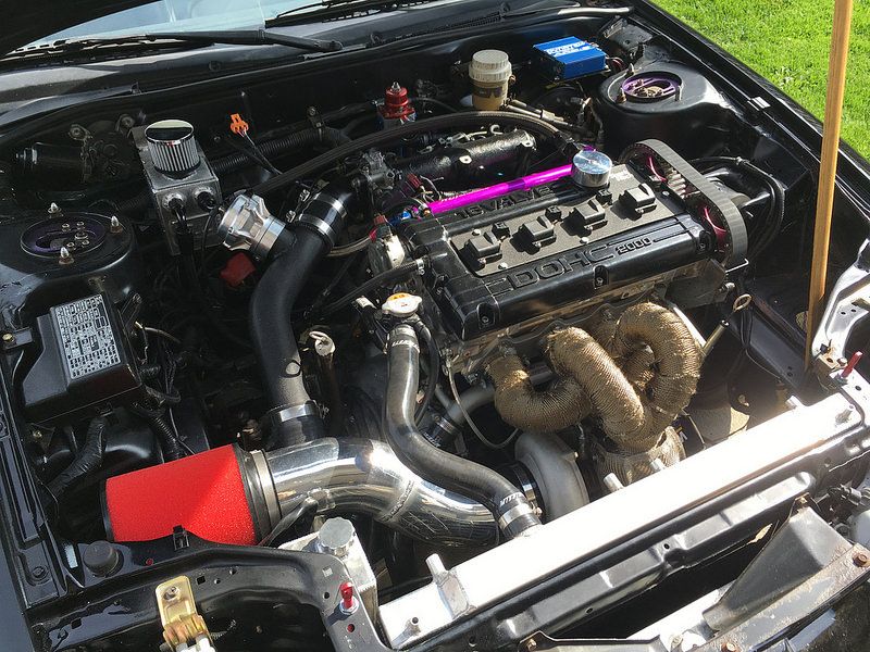

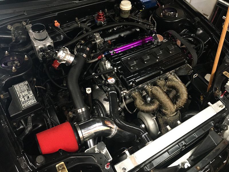

Your build is looking good! Seen how you tap and threaded your valve cover for the baffle underneath, are you not worried about them backing out? I really like the oil fill cap with AN fitting seen them around for years , were did you pick it up? thxs
thanks man! I am not worried about it. I used some good lock washers and red loctite. Evo owners usually have to bolt it back in also and not weld since the valve covers are magnesium. I bought the cap off Hal (he is a member on here and sells them).

Magnesium huh I did not know that, thxs for the info. Any Idle how much the exhaust weighed? Sounds good, looks good too!
What size is the intercooler piping? Also, is that an OEM timing belt? Looks different.

Thanks! I agree, love the sound. The entire exhaust weighs about 15lbs.
This build is great. Nice work!
Thank you :)
2.5" IC piping. Timing belt is an OEM EVO IX belt. They are reinforced with kevlar.

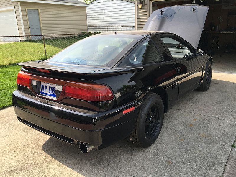

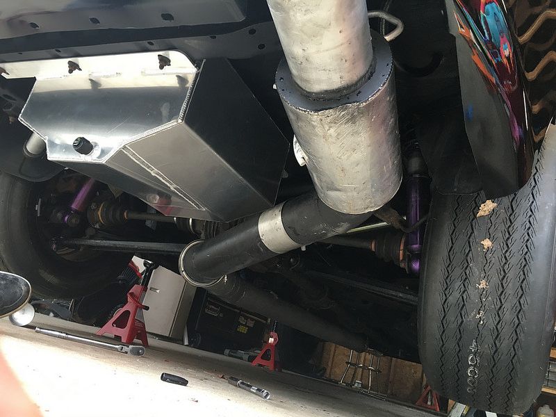

What's the ground clearance on the lowest part of the exhaust?
I'm debating if I should upgrade to 3.5" or 4" being its a street driven car and aluminum exhaust .
Keep up the good work! :)
7-8" I believe. I could have tucked it way better, but I didn't feel like re-doing everything.
Thanks. That's plenty of ground clearance for the street then.

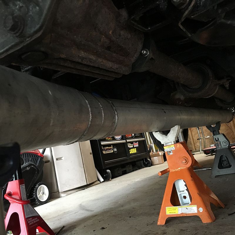

Do you have more pics of the exhaust routing. I would be interested to see how you route yours.
That's the only picture I have right now. It's a straight shot from the downpipe and runs along the left side of the driveshaft, it then cuts across under the rear diff to the bumper.
