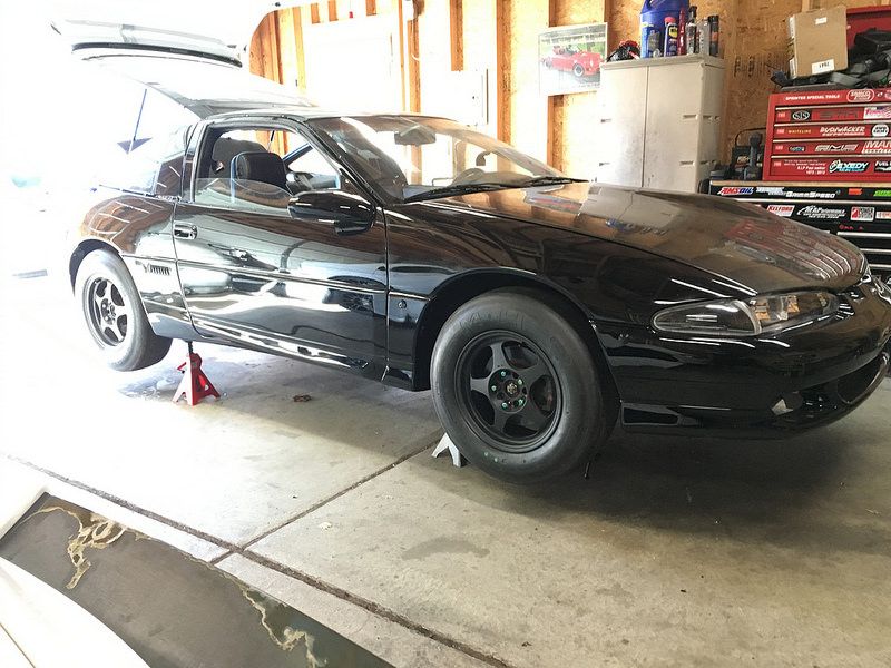

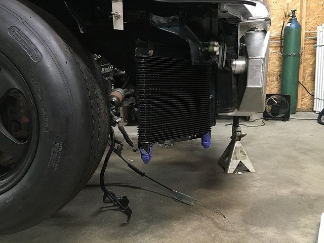

Any reason you went M&Hs over QTPs?
I'm clueless about DR/Slicks so I'm just curious.
The M&H's fit better on the car. They are round at the edges where the QTP's are squared.
You can also get the M&H's a good bit cheaper than the QTP's. Both tires work and I've used QTP's on my past Evo... just figured i would try something different.

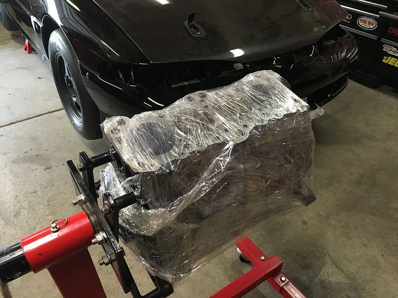

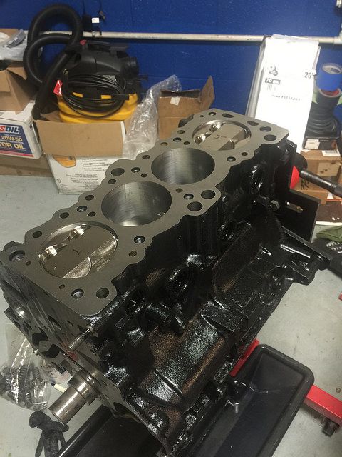

Block progress.

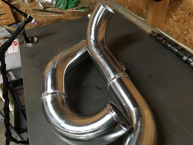

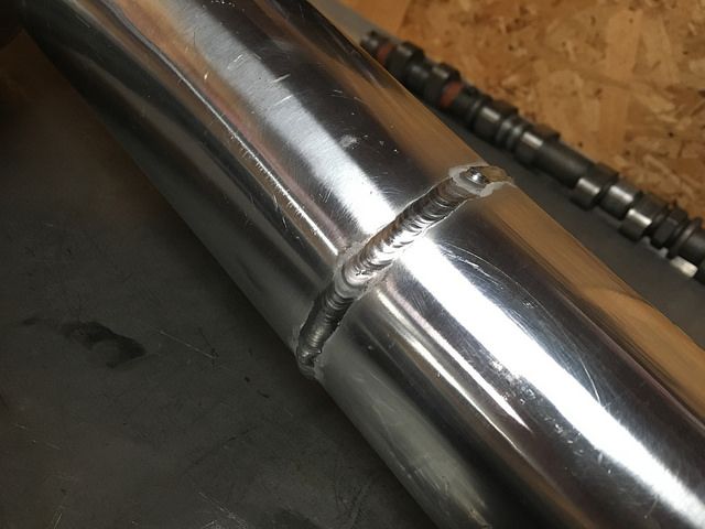

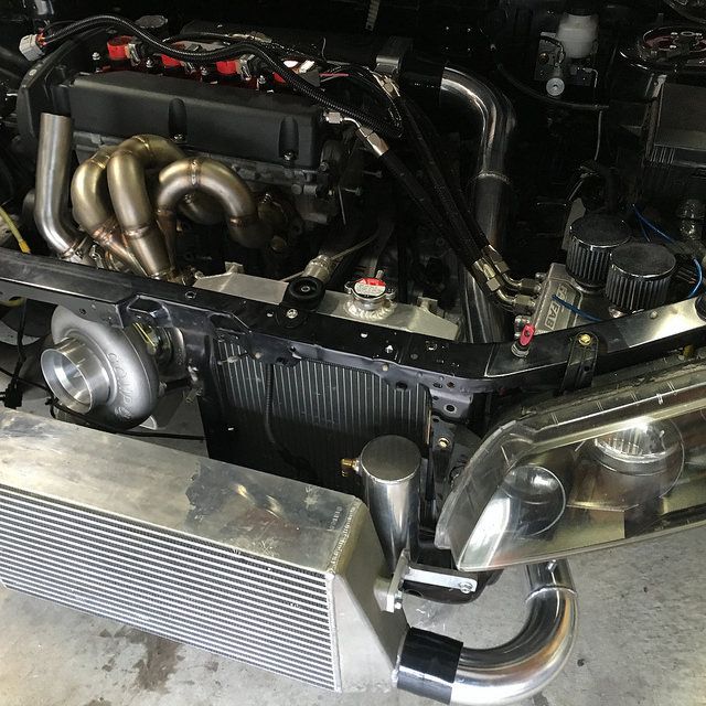

I've also been working on teaching my self to TIG weld with my AHP 200x. I probably have 2 hours of torch time now. Attempted to fab some pipes for a local Evo and they came out pretty decent. Good practice for when I go to do mine.

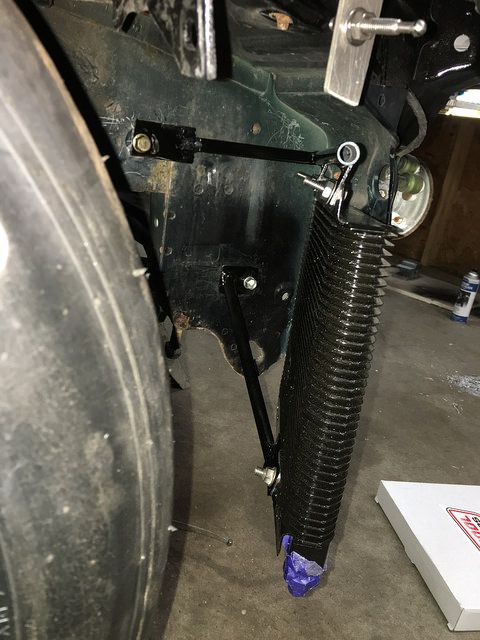

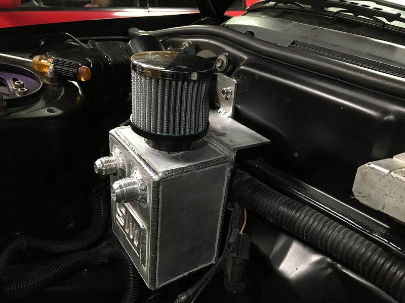

you sure you can't get those fittings on the top side, hate to see something snagged in the lines
looks good scott

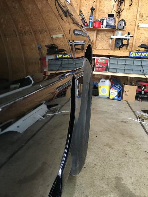

I might actually be trying that, because it turns out the bumper doesn't fit now haha! Suppose I should have checked that before hand :ohdamn:

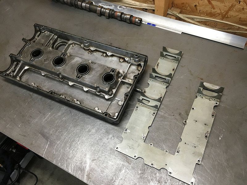

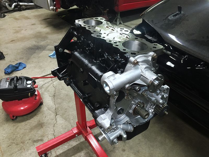

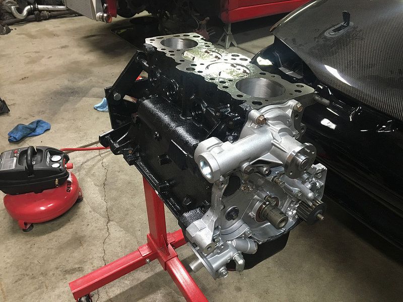

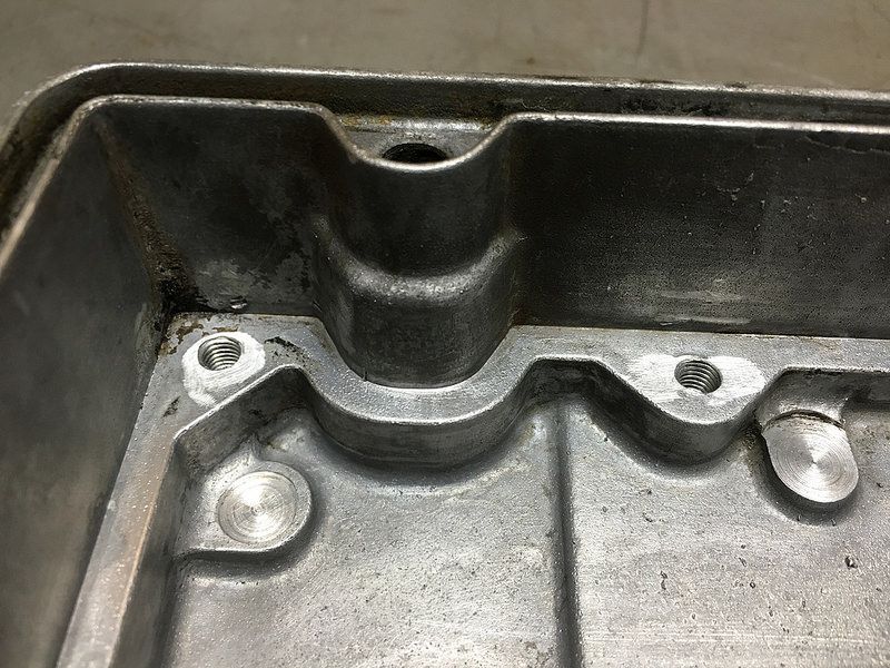

Cleaned up all the engine parts as the car will have an engine this week...
I found a lot of junk in the valve cover baffle so I decided to remove it and clean it out. I ended up tapping the cover so the baffle is removable. It'll be secured with button head allen bolts with lock washers and red loctite.
