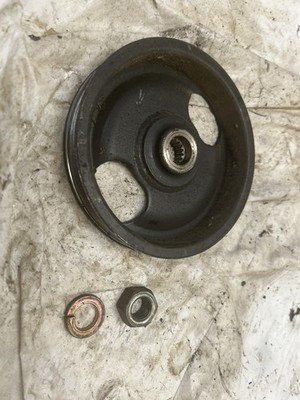

New problem...just when I thought the bleeding issues were complete. Drove it about 8 miles no issues until I pulled in to a parking spot. And it started jumping..
The steering. Didn't really see why at the time but by the time I got home I found a broken belt. And a stripped pulley.
Anyone know the "part number" or if theres an aftermarket version?, I'm sure its discontinued like everything else for the car but figured id give it a try before I buy a whole junk yard pump just for the pulley. Can't seem to find them at any of the usual autozone/advance/rockauto.
Solution
They look a little worse for wear but did not grind away like the pulley. May have been part of my issue in the first place. That pulley being stripped and slipping. I got one off ebay. Ashame they don't come with the rebuilt power steering pumps
