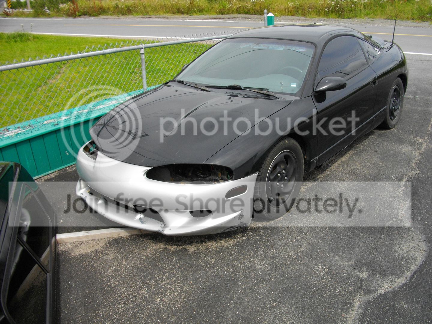

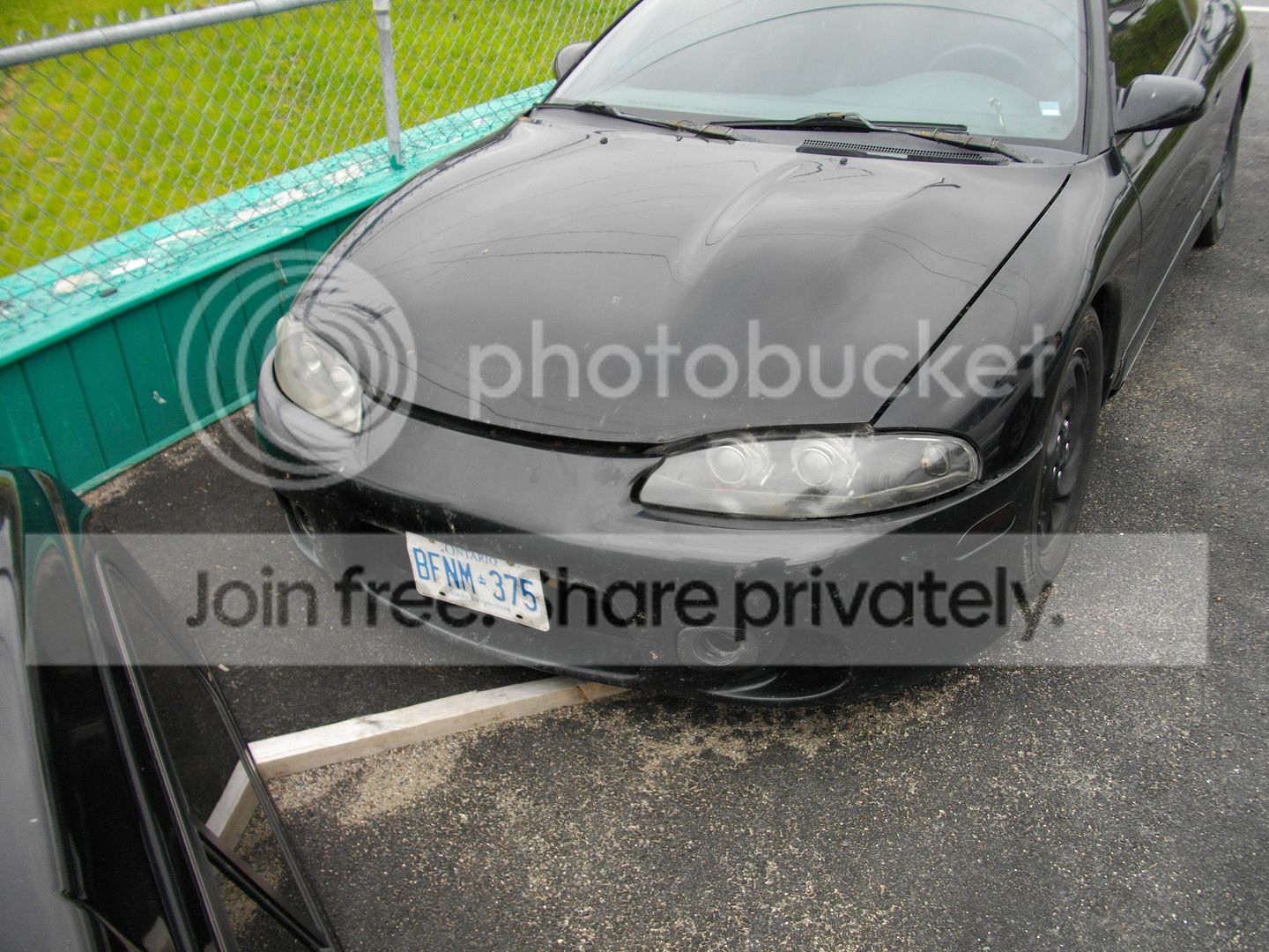

On my trip of here my bumper suffered some damage and was cracked in the middle.

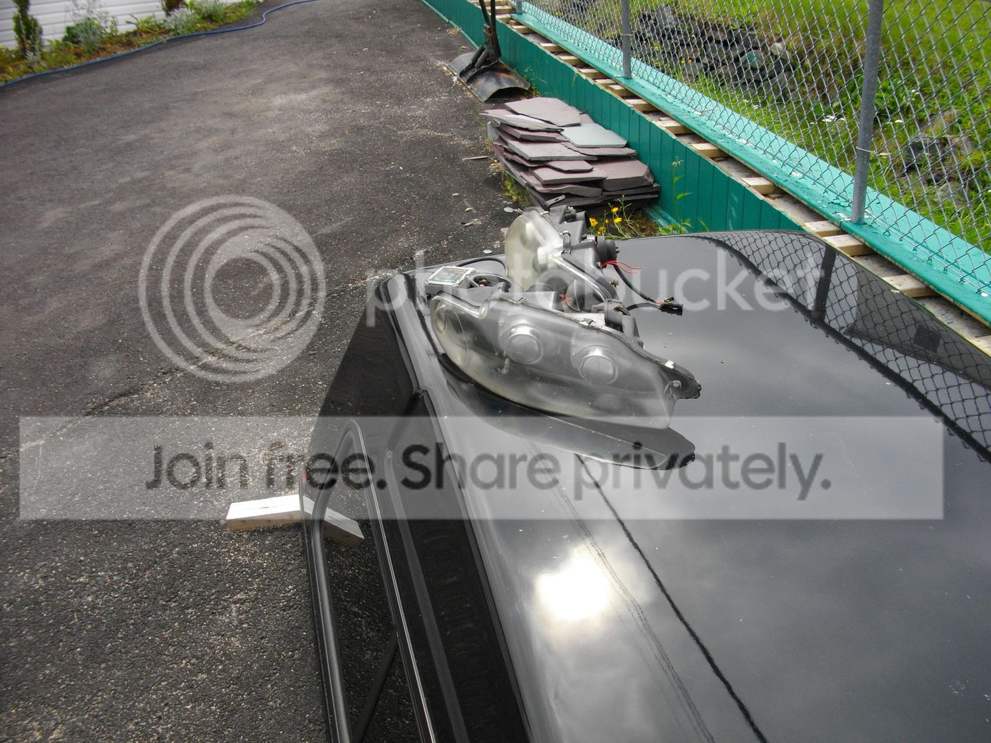

I got my hands on a 2Gb Talon bumper and lights locally for a steal. Still needs to be painted of course plus I will transfer 1 set of my FX-R projectors to the other headlights.

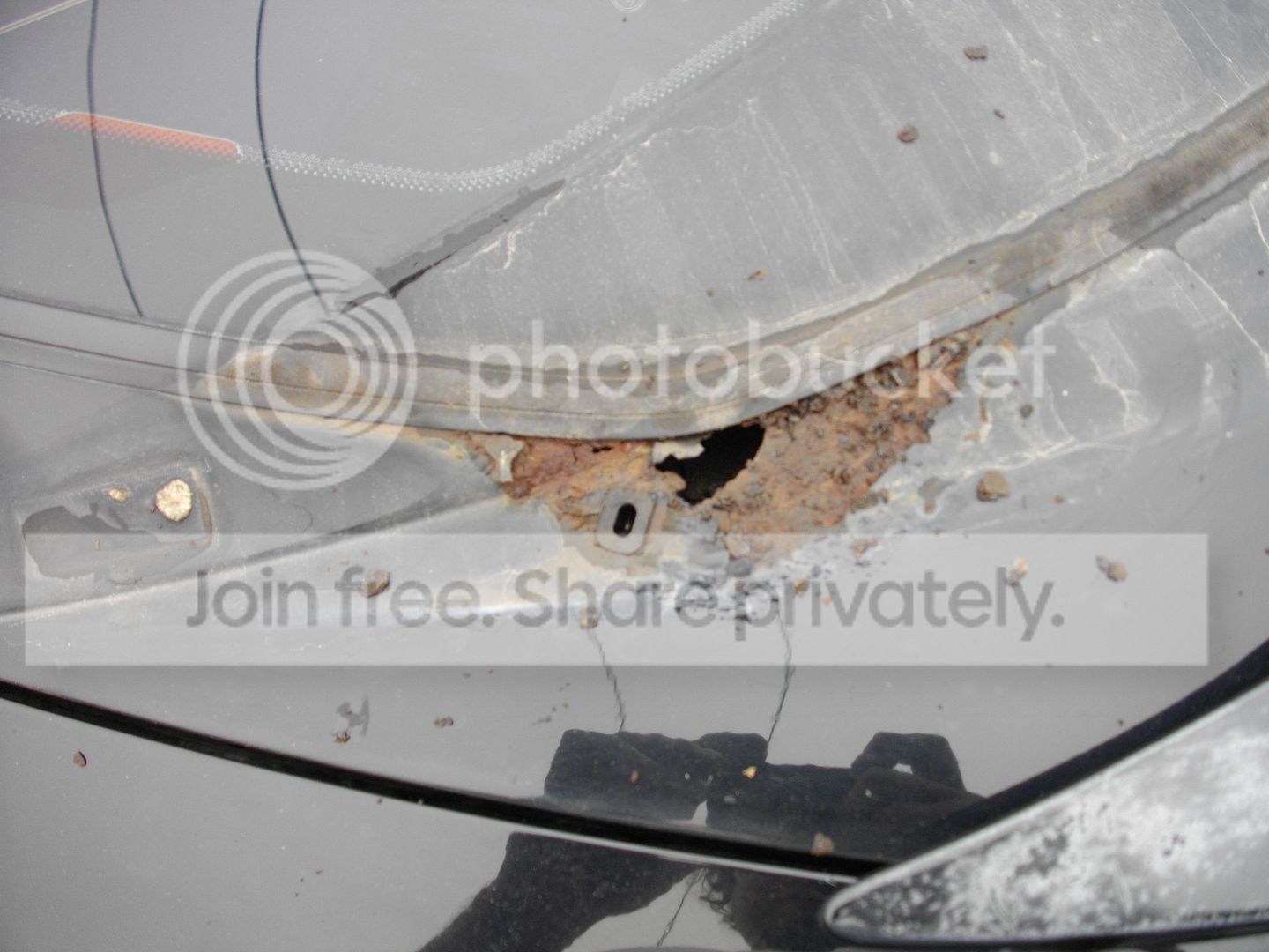

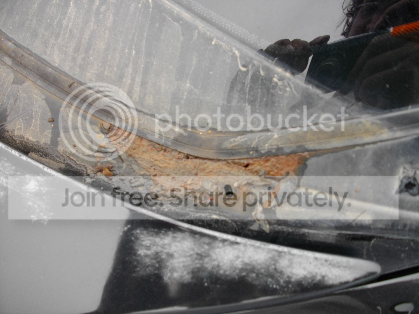

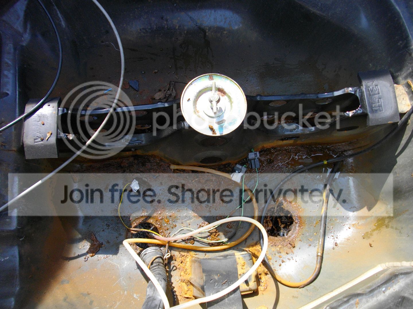

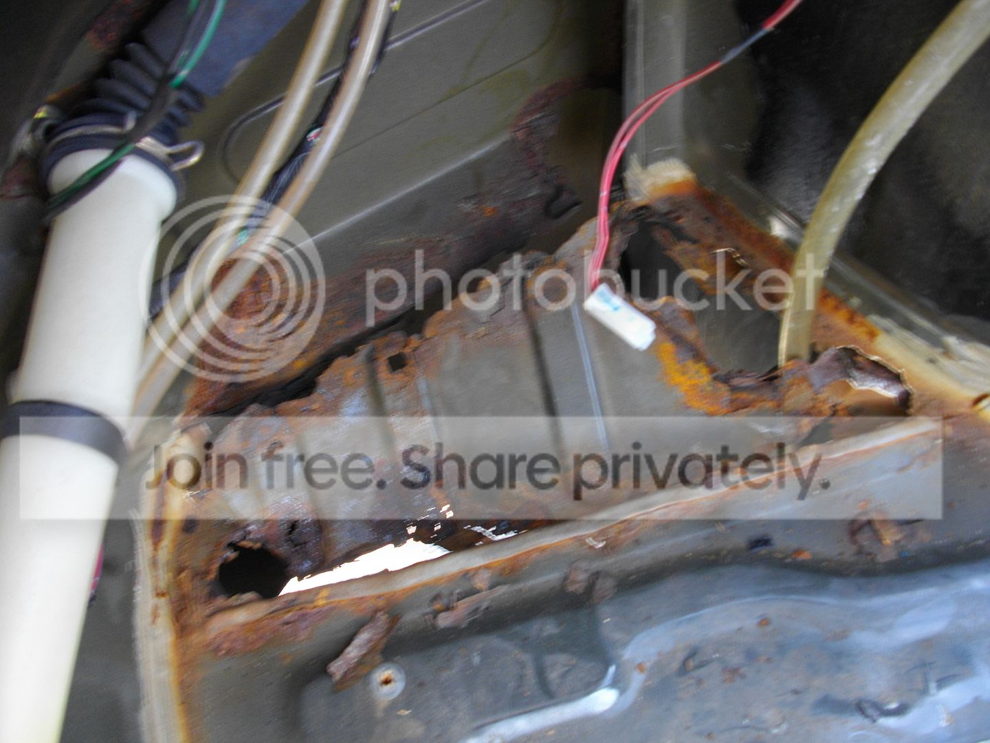

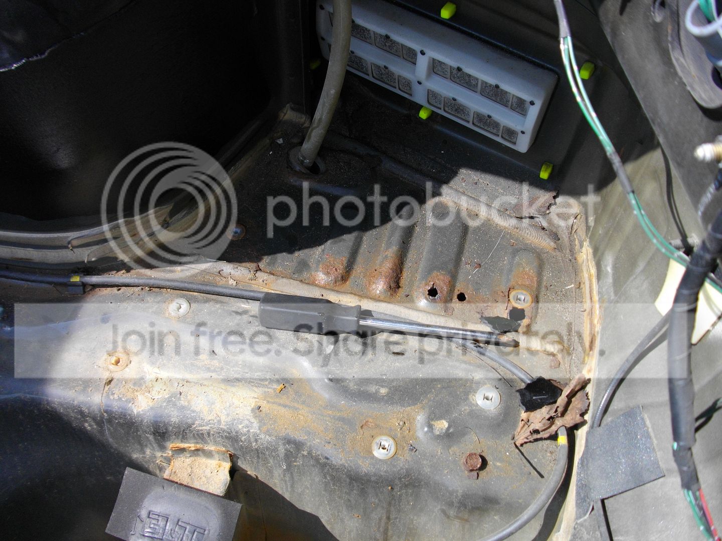

With the interior out I started poking around with a screw driver and found some more rust (ARG!), I'll have to make up a couple patches for the rear floor.
Also pulled the wing off too see how bad the rust is on the hatch, I'm hoping I can patch this for now to save having to buy a carbon fiber hatch.

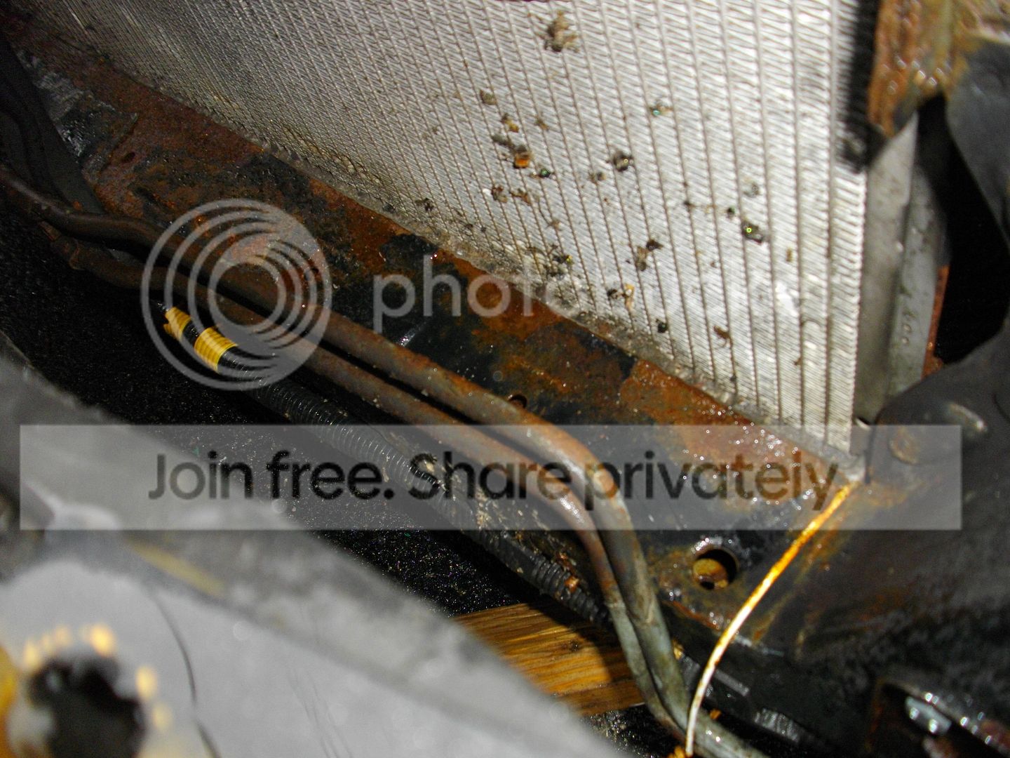

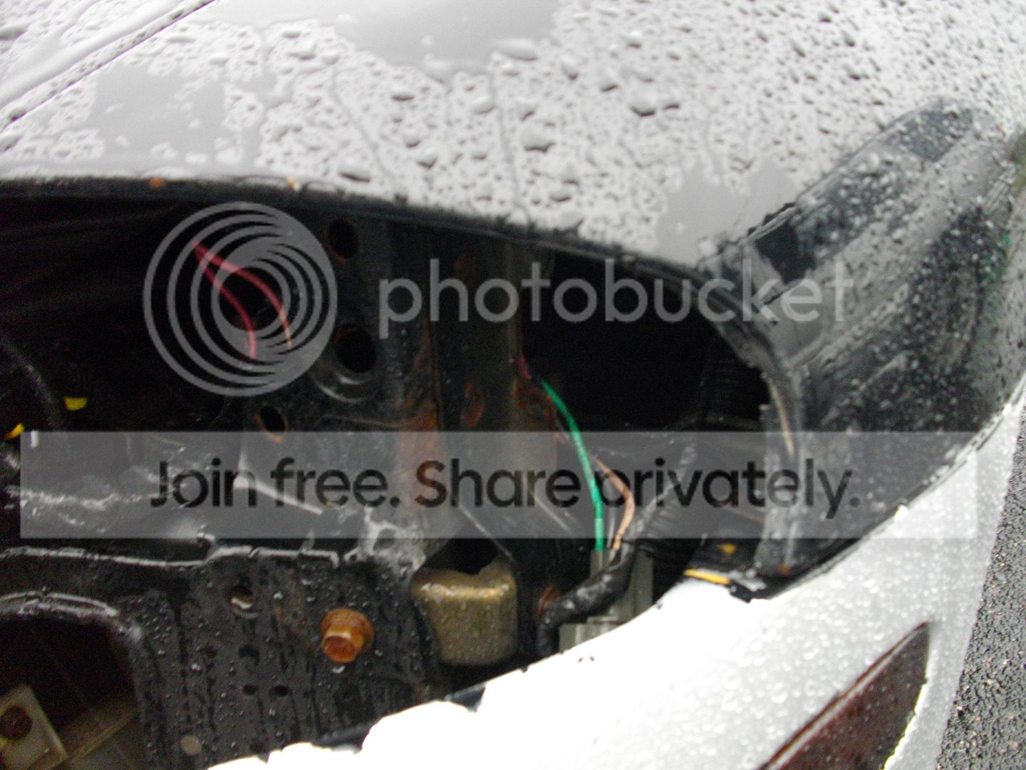

Some good news in regards to the rust, the lower rad cross member is the only piece that is bad/rusted out. The surface rust will get ground down and hit with POR15.

That rust is not bad at all. I have some in the same exact places minus the hatch. Nothing a little POR-15 can't fix. You can also get that rear trunk panel from mitsubishi (Drivers side one at least). You just have to drill out the spot welds holding it in and replace it.
Yea, I've found all those panels on JNZ's OEM Parts site for under $100.
I pulled up the carpets yesterday and the floor pans are pretty much perfect, some minor surface rust but nothing crazy at all.
