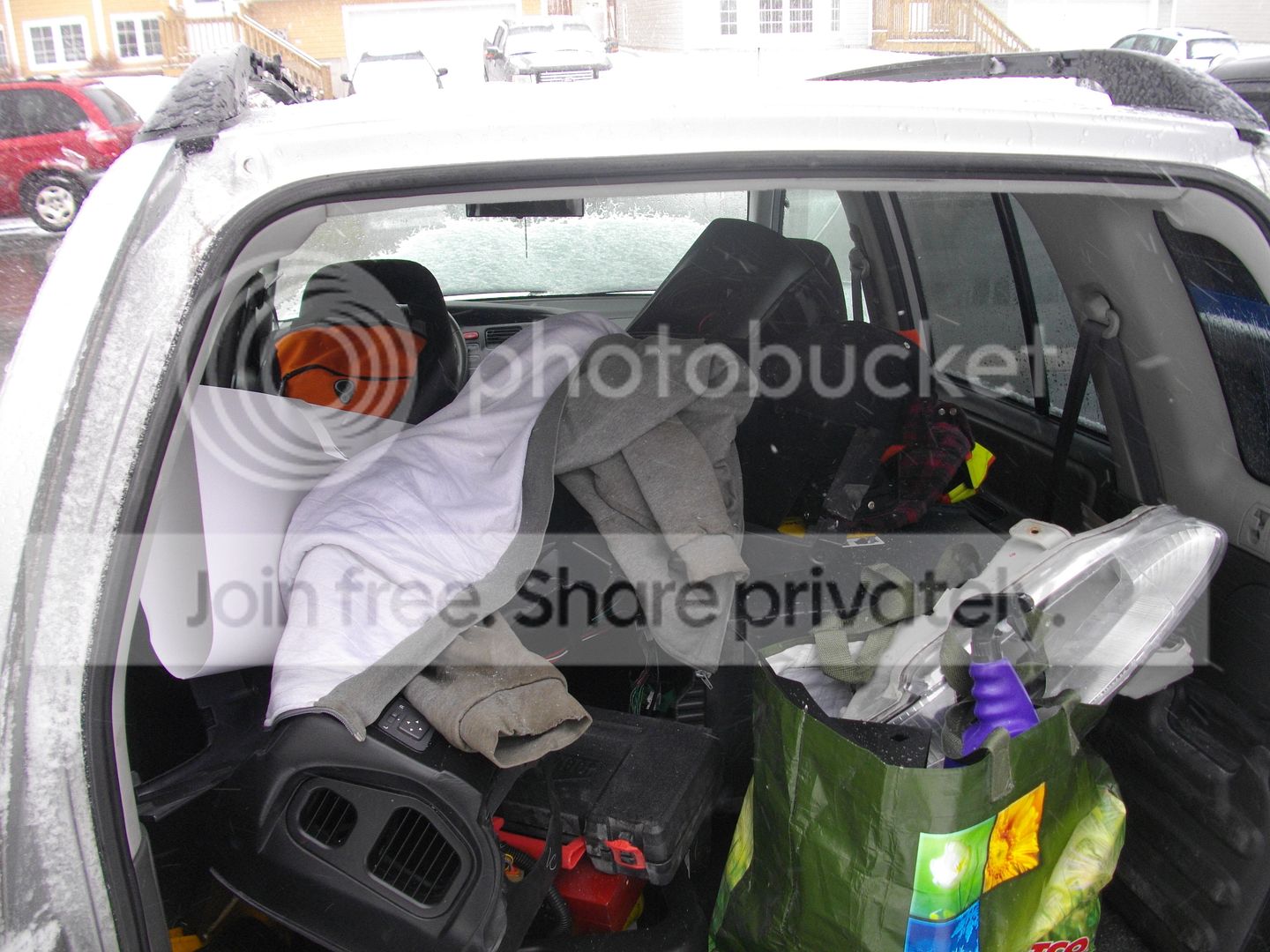

Loaded up the Tracker and left the house around 10ish today. As you can see in the picture, snow, oh joy!
Once I got out to the car around 11:30ish the snow/rain had stopped and by 2pm it had cleared up so I started working.

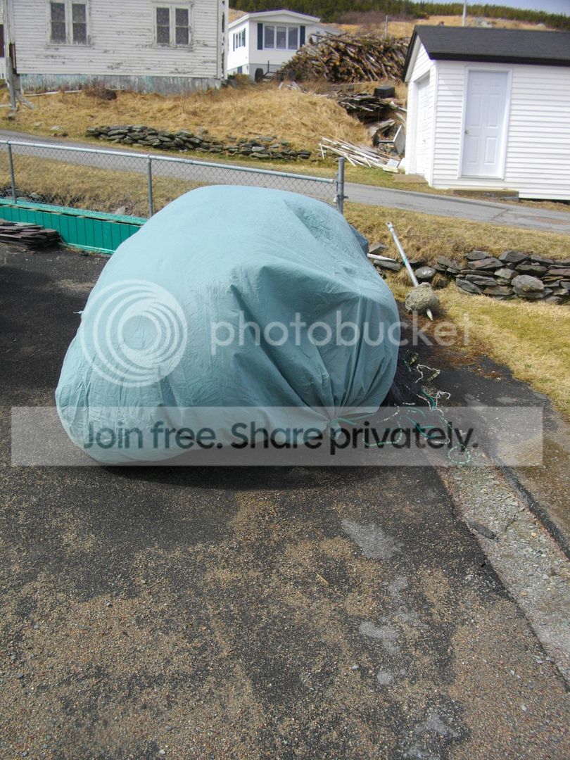

Car still covered by the car cover and a fish net. I need a better car cover for next year.

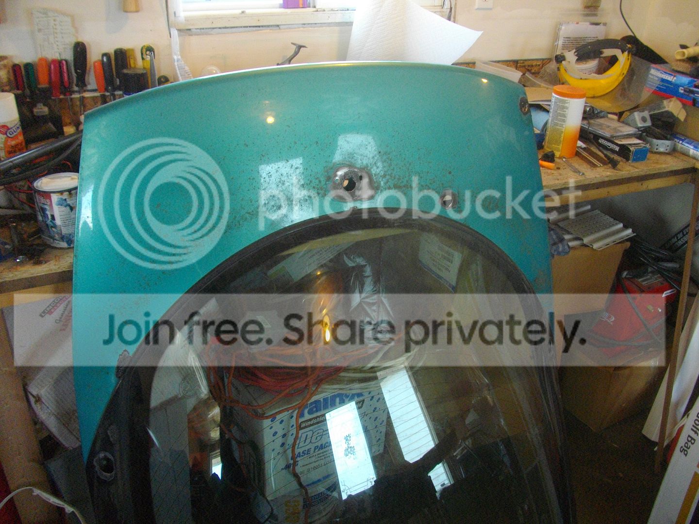

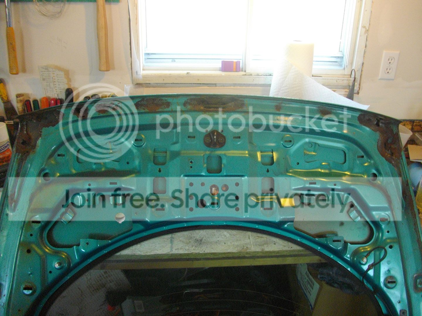

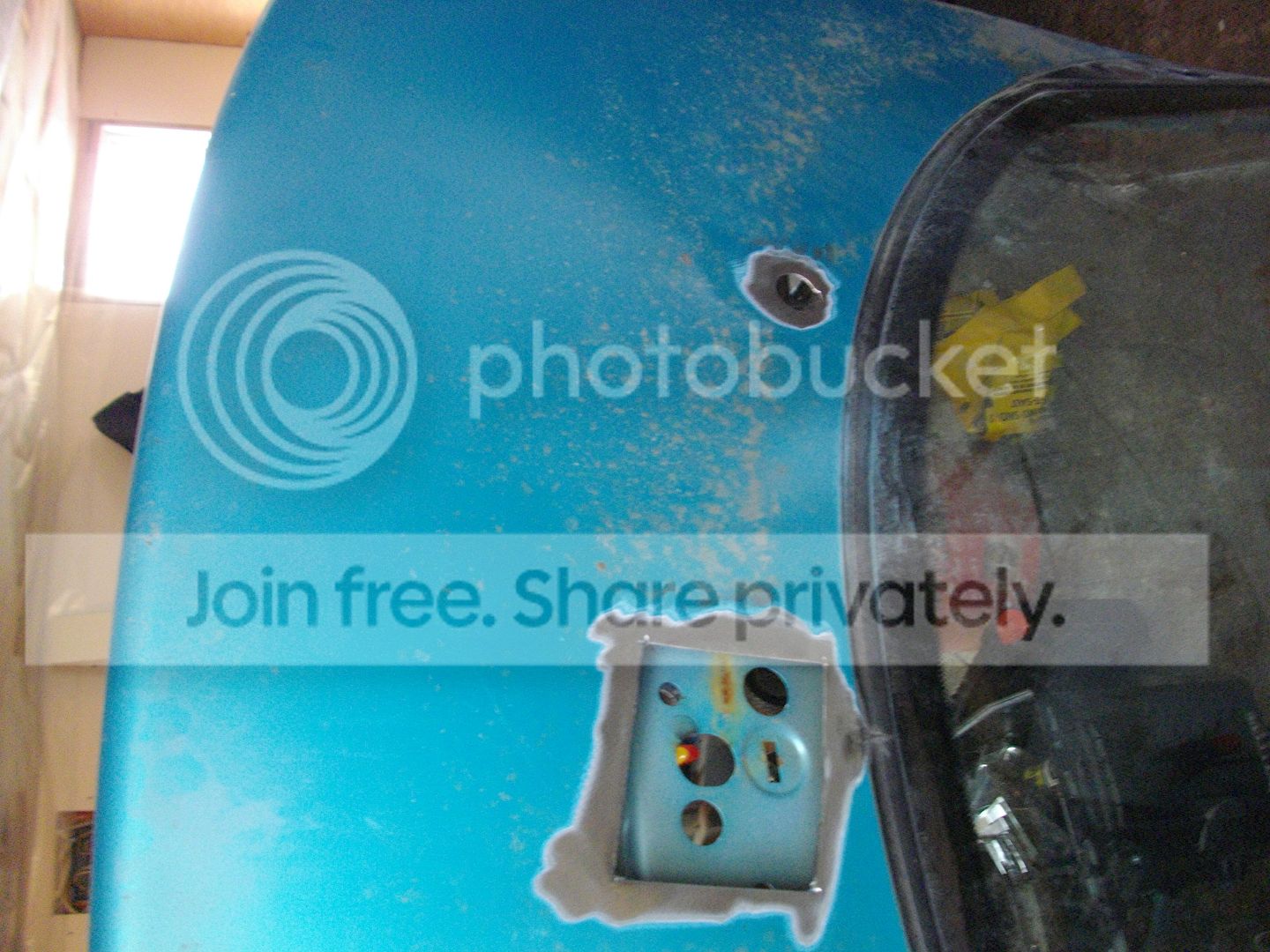

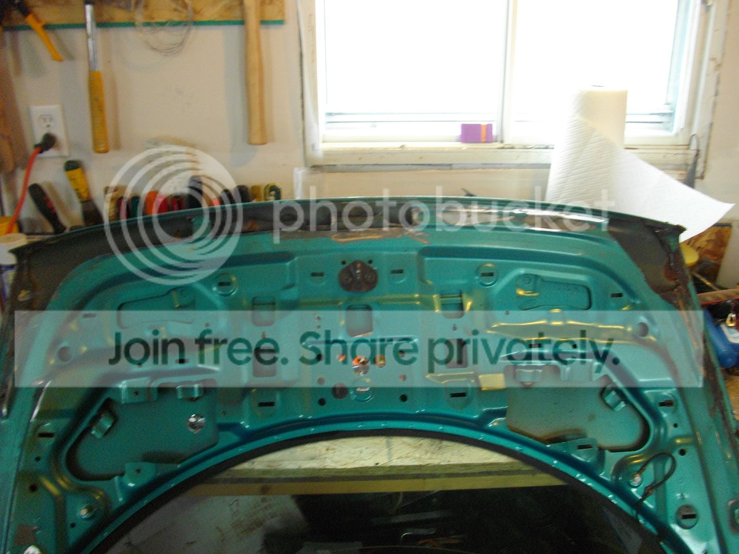

I decided to attack the hatch first. As you can see it's rust but trust me when I say the one on my car is worse.
A flap disc to clean up some surface rust and a cut off wheel to cut out the real bad parts.

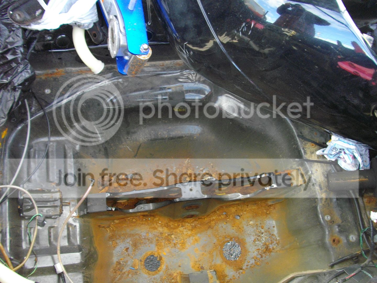

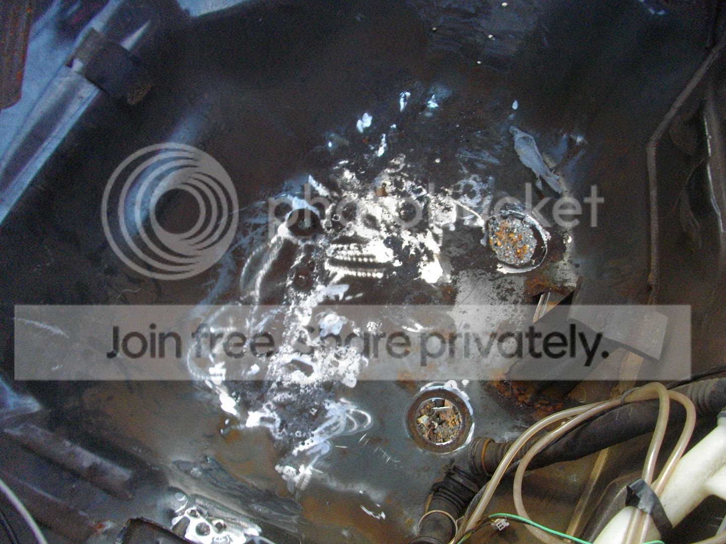

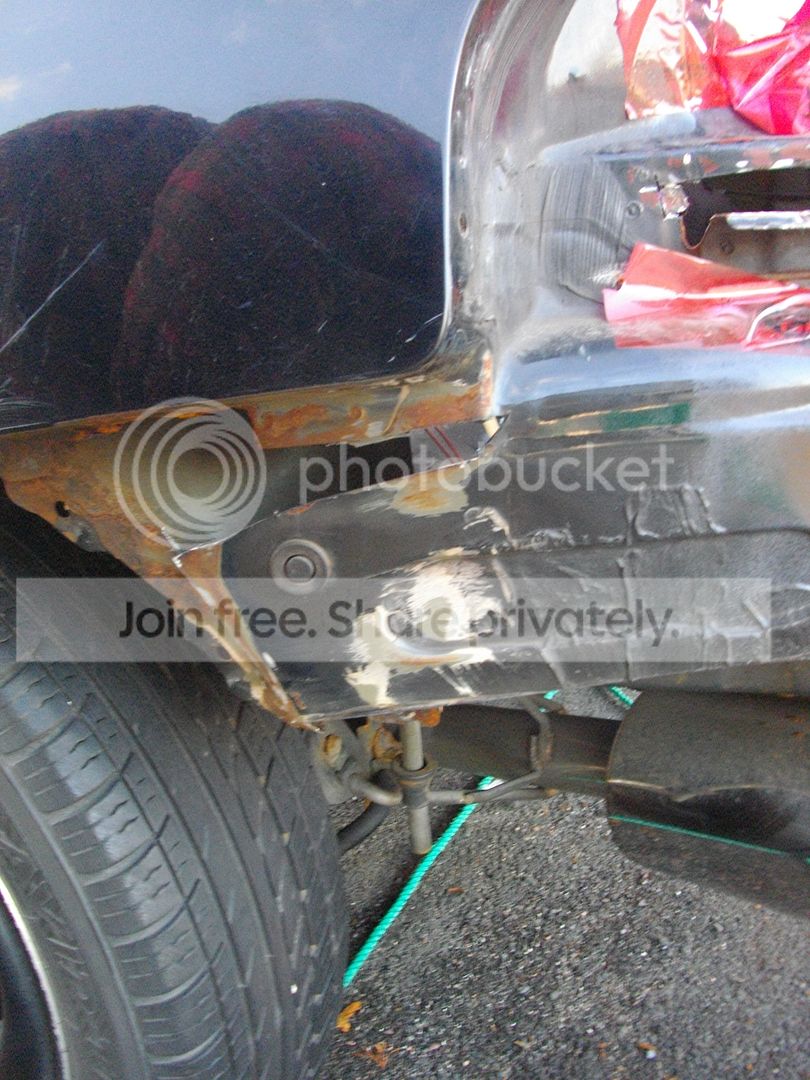

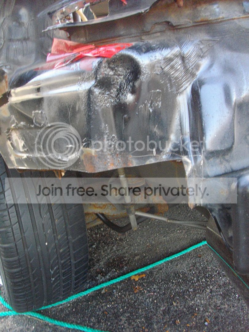

Next, I turned my attention to the back of the car. First I wanted to pull the spare tire holder. I had a set of cheap spot weld cutters that broke instantly when I tried to use them. I ended up just using a regular drill and my grinder to cut most of it out.

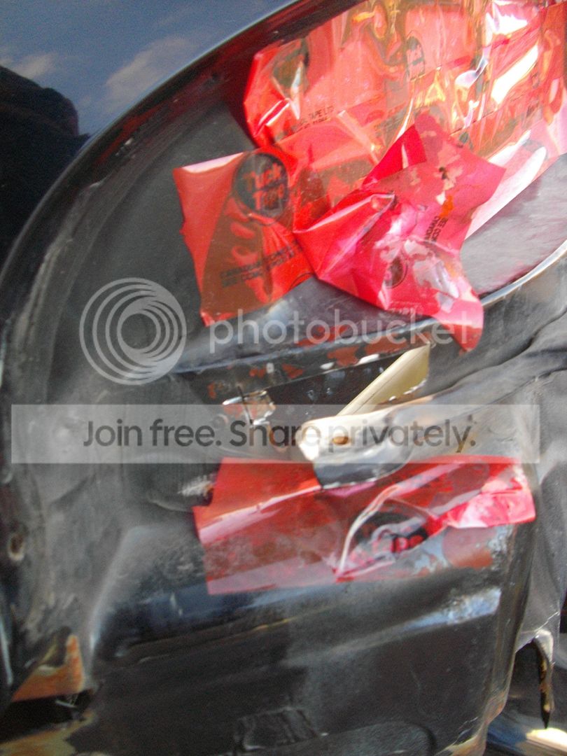

I then trimmed the rust out of the wheel wells and below the tail lights.

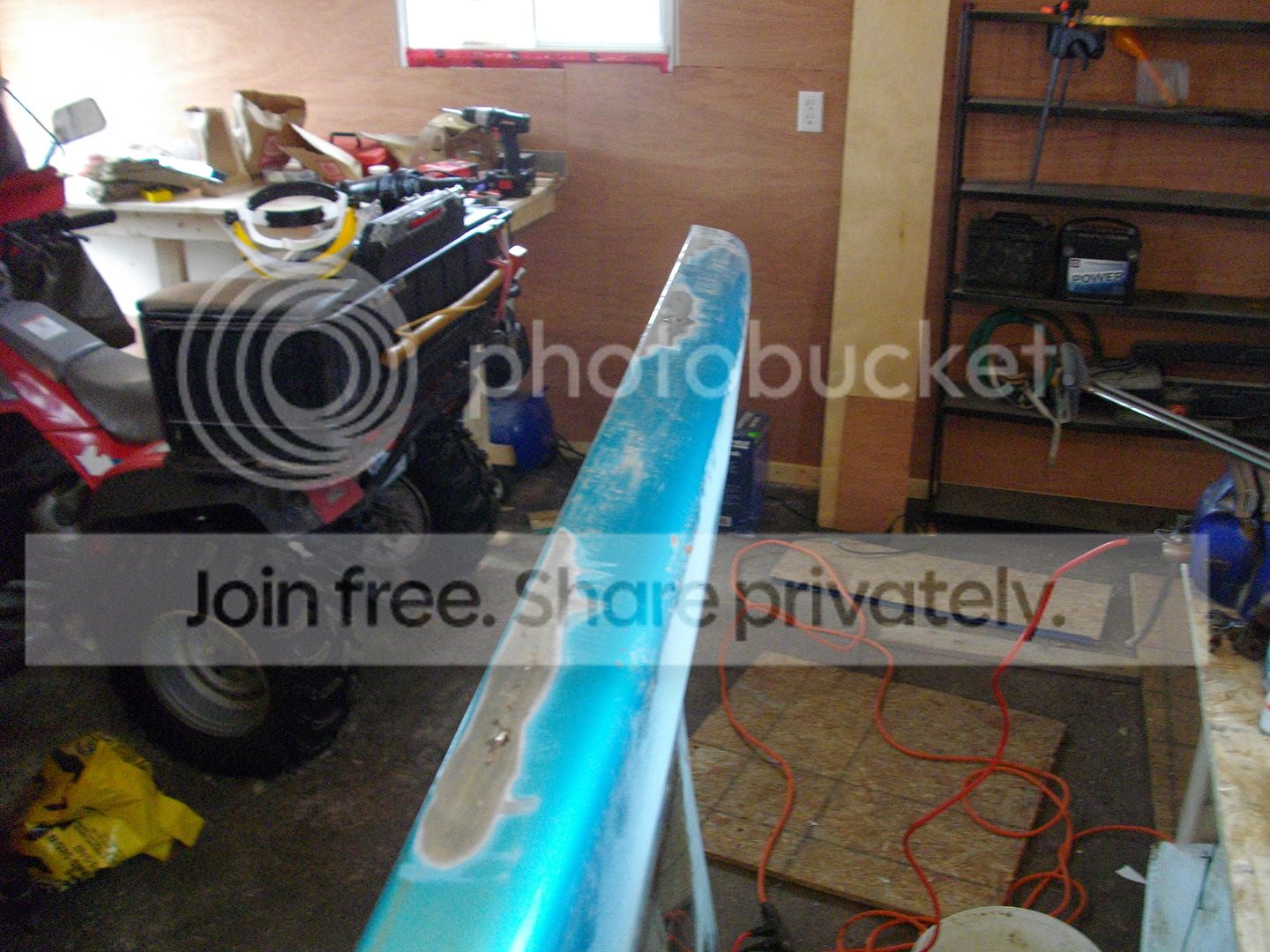

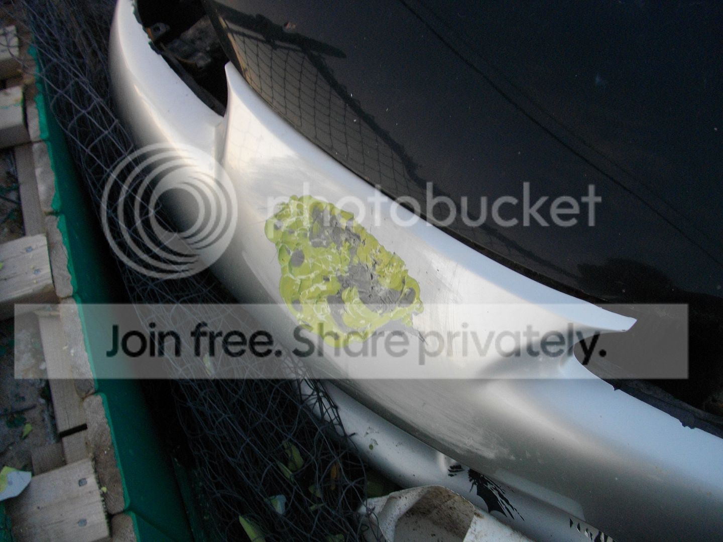

By then it was starting to get dark so I decided to start chipping the filler out of the Eagle emblem recess on the 97 bumper. This was an absolute bi***! I need to get a hand sander to finish it up.
