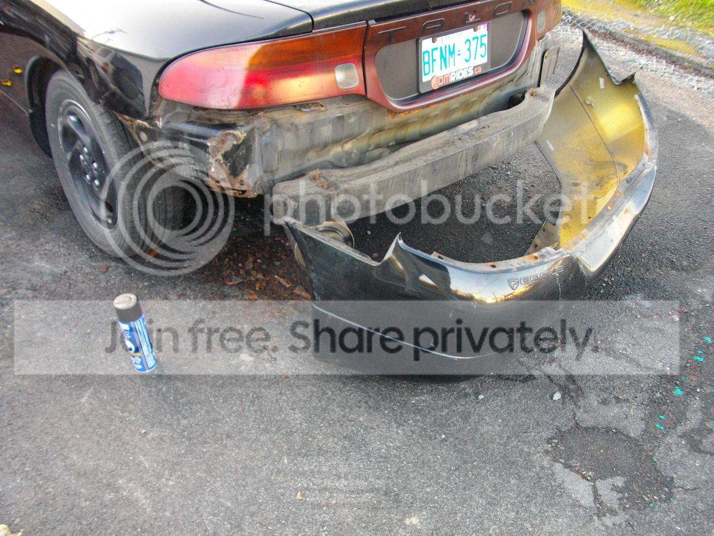

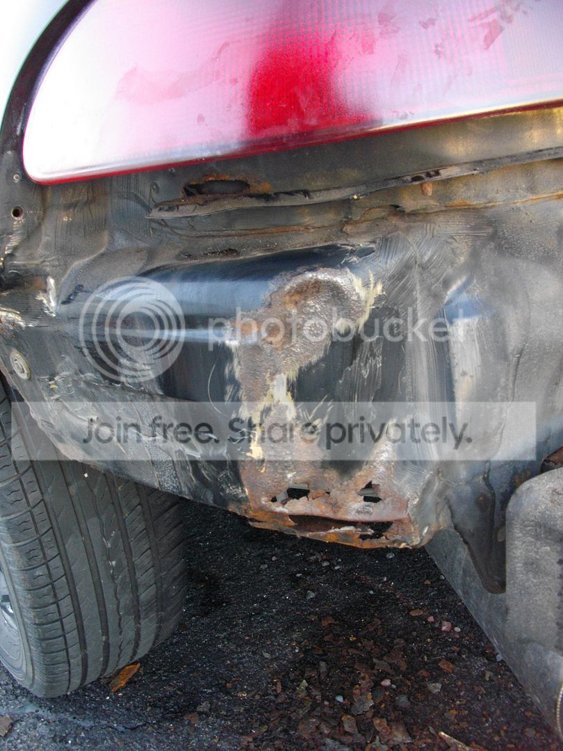

Took off the rear bumper this week and found something that made me happy.
Look closer....
Yay, a nice dent. Looks like the car was in some sort of fender bender, not a bit deal as it was relatively minor. I'll knock it out with a hammer.

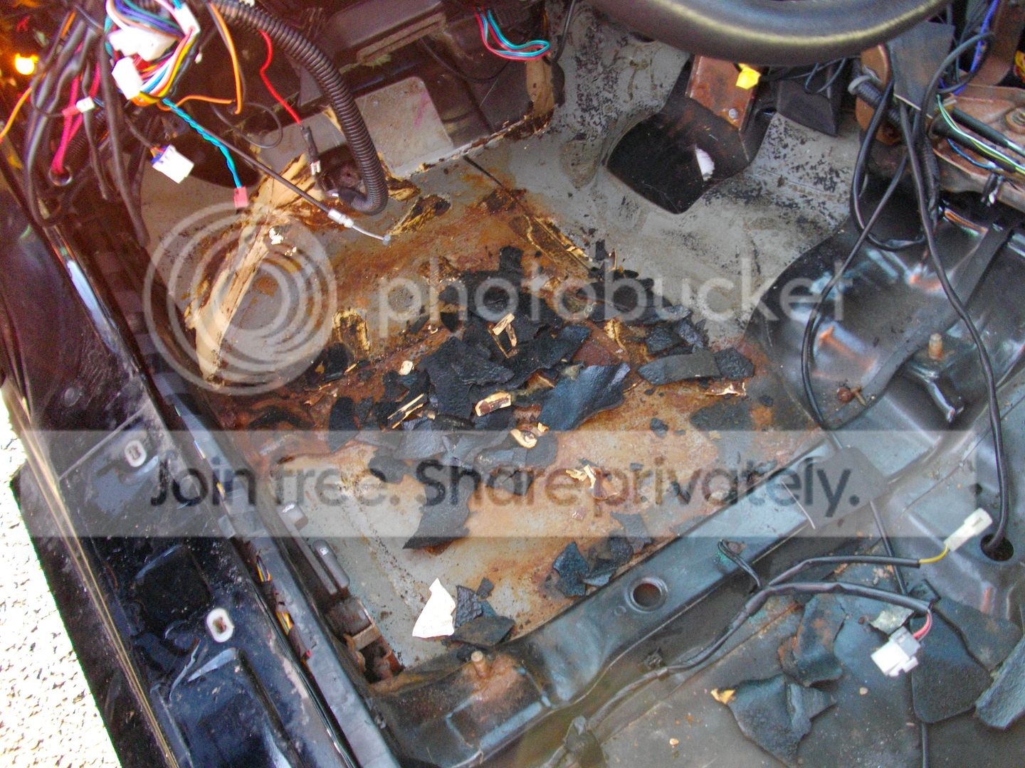

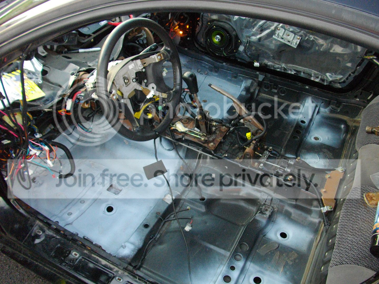

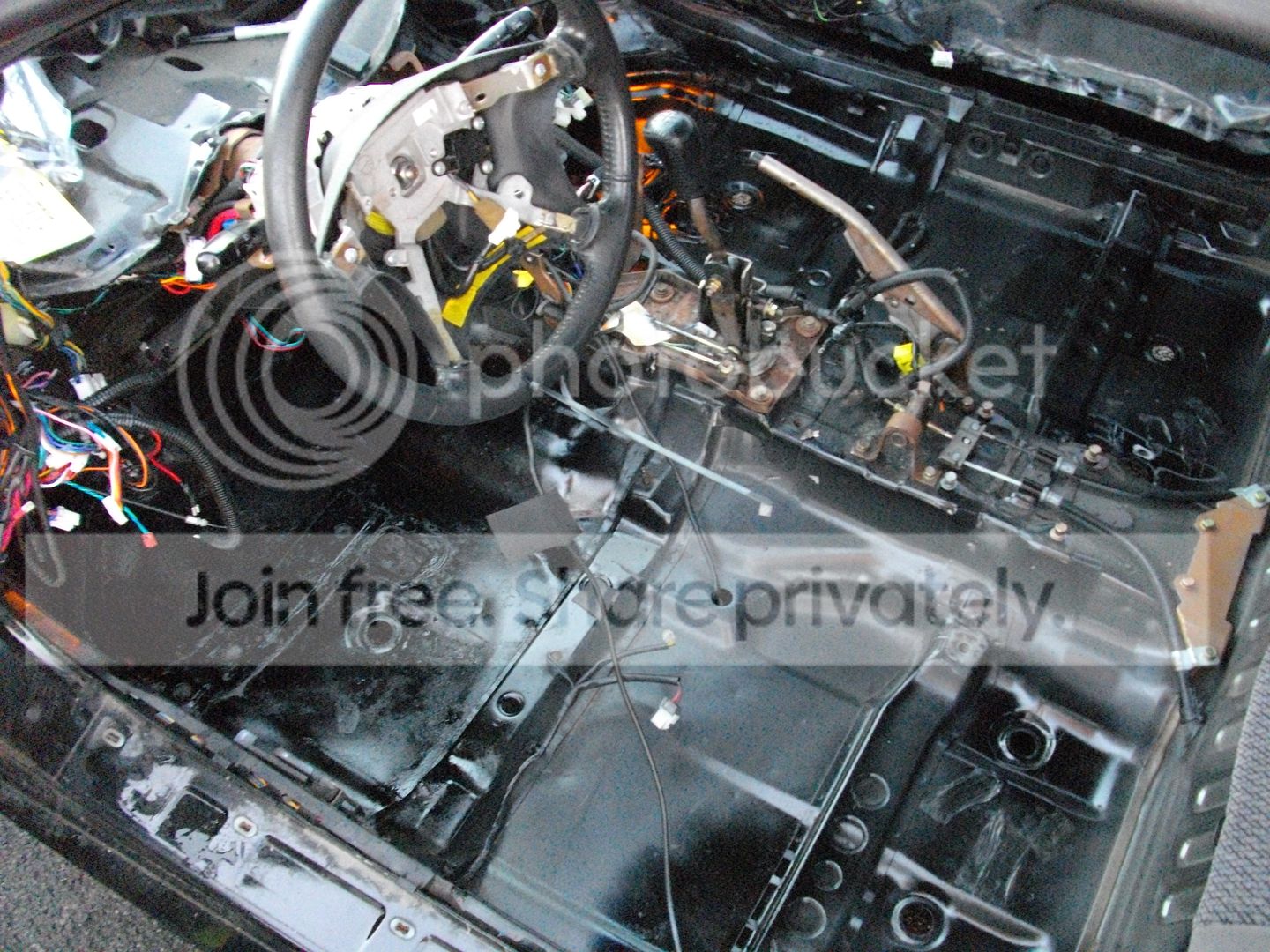

I got the carpets out of the car and all the sound deadening up expect for the stuff on the rear strut towers.

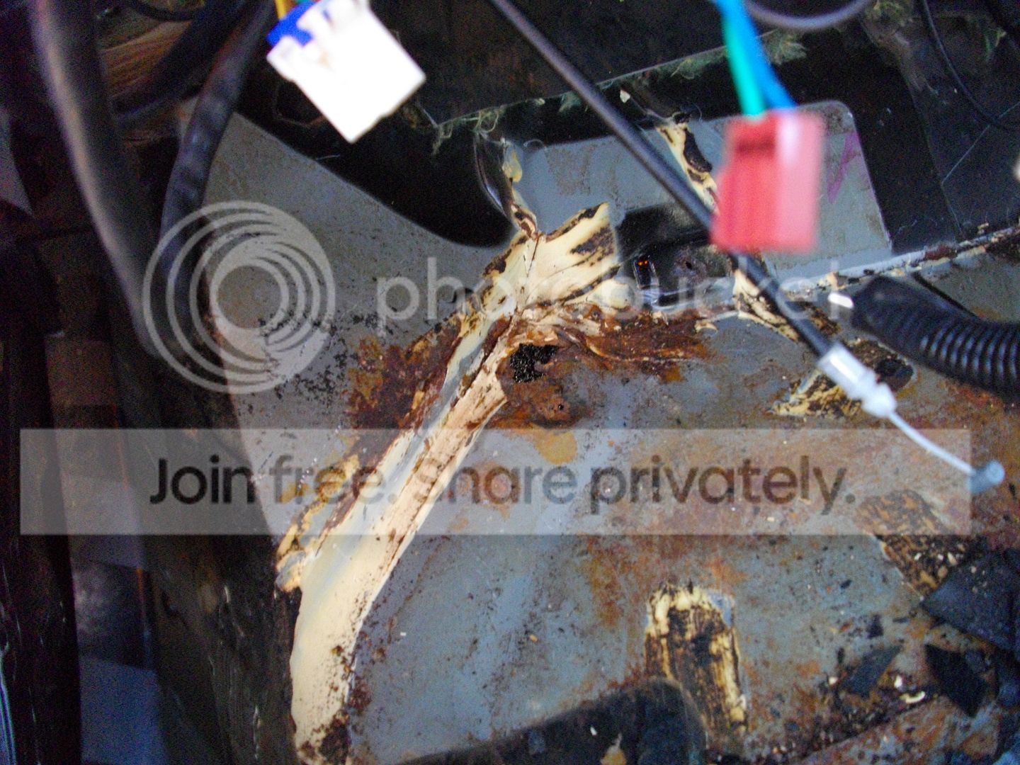

Found a small hole on the driver's side that I'll have to patch.
I decided to hit the rust with a wire wheel and paint it for now. Come spring I'll chemically strip it down to bare metal and POR15 the floors.

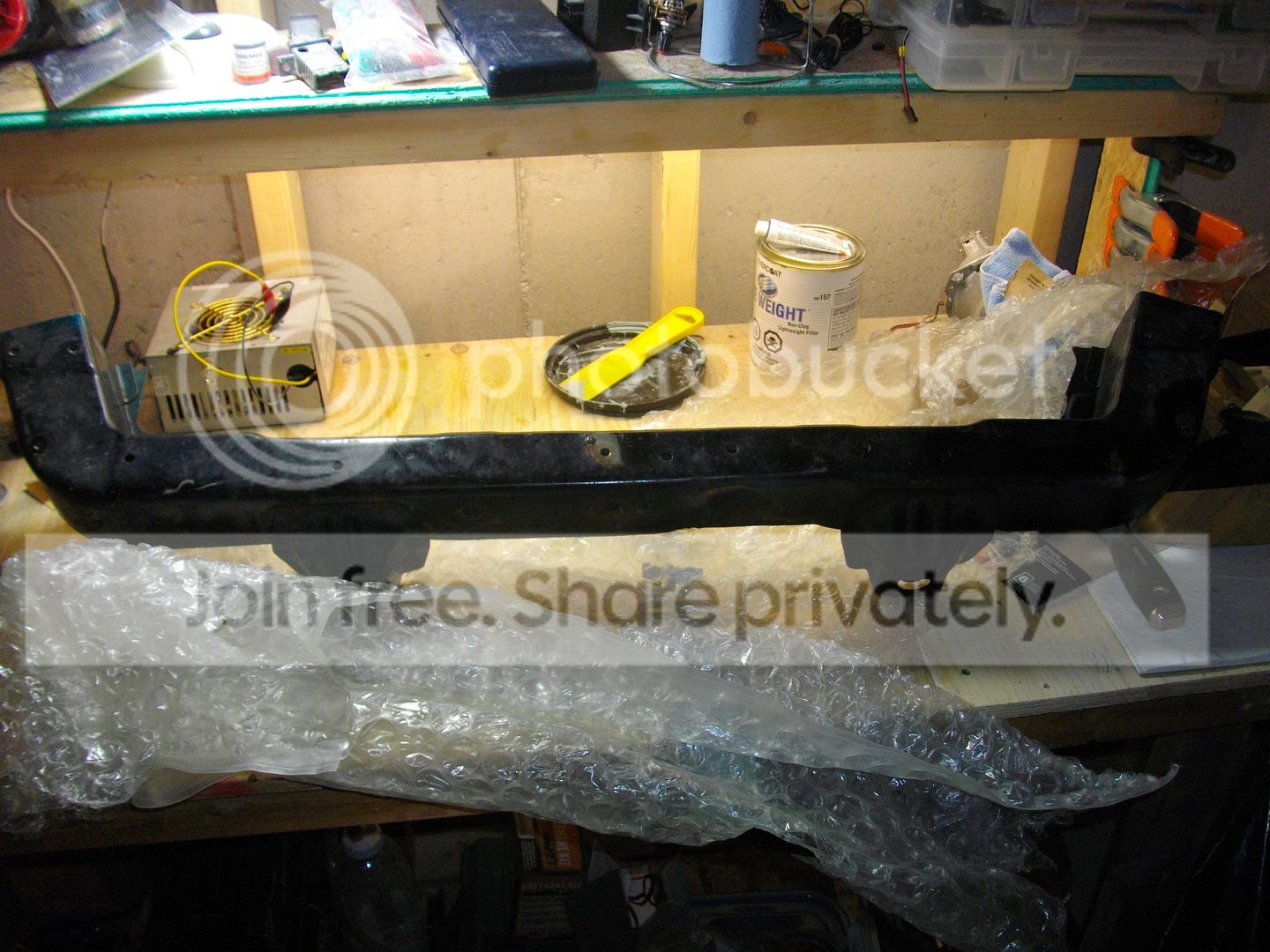

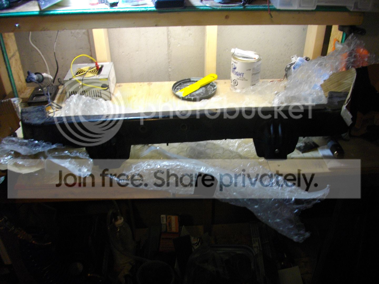

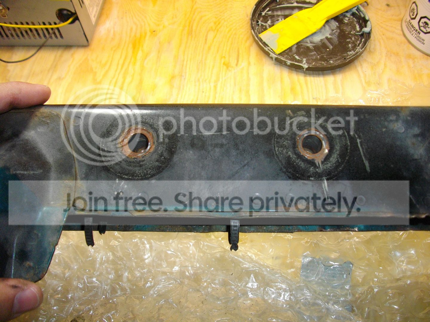

I received a golf bag in the mail.
96&
Nah, it's my new lower rad support, much better condition then the one on my car.
I'll be out at the car from the 22-29th this month welding up a storm.
Nice! I just ordered a new rad support from Rockauto. Can't wait to get rid of my swiss cheese support.
What did that cost you?

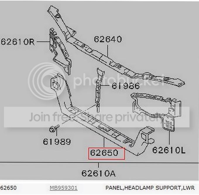

I wanted to do the whole support but wanted an OEM (expensive even at cost) and my upper is in pretty good shape.
I bought the lower for $100 shipped to my door from a member on the Link forums.
$175 + $50 shipped. Too much, but it needs replaced. Nobody is willing to salvage it to sell it cheaply + shipping.
I saw one at Pershing auto for $150 + $25 shipped, but read horrible review of their customer service and the parts they sell.
My upper is fine too so I'm not concerned with it not being oem.
I plan on only replacing the part labeled 62650 in this pic...
That's the same thing I got, just mine was a cut off another car and 99% rust free (there's a bit of surface rust).
I'm gonna coat it inside and out in POR15 before I weld it to the car.
