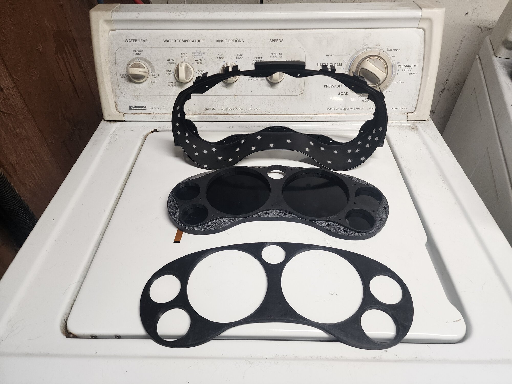

That just a prof of concepet. That cad model is just multiple layers depending on how I extrude them. Ok take away the lcd panels on the before picture. Thats a rough face plate that sits on top of the original guage cluster. Trim away what is not needed on the oem guage face. Then this gets mounted on the back side.

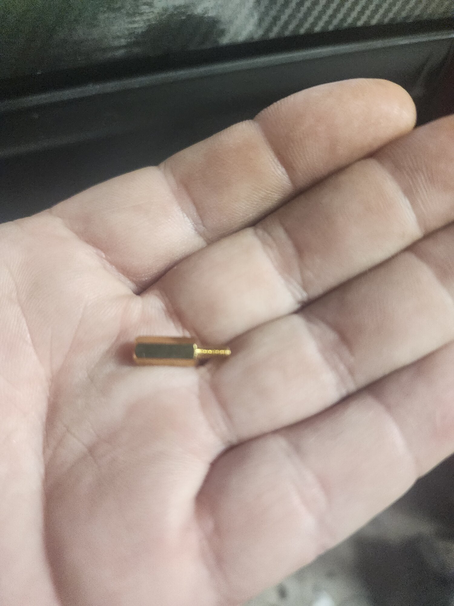

Ok the retaining plate is on the printer. It has provisions for each ribbon cable from each lcd to pass thru. The brass standoffs will secure the retain plate in place ,while giving it space for the mock up pcb, which will hold the diffrent esp32. I will have to remove all these supports in the rear housing and fingers crossed the new stuff will fit inside this housing and will be a bolt in into the car.

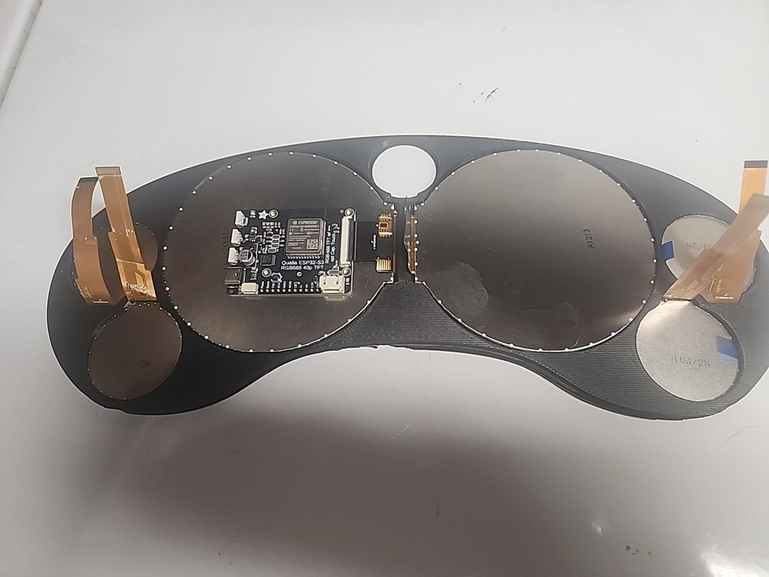

Ok a update. Ordered another laptop to go with the powerfull one i already have. The diffrence is the new one has a powerful graphics card. Why do I need it ,well I orderd a high end 3d scanner . It a ellagoo m1 . Wireless, no scan spray needed or tracking dots . I can now scan 5mm cubed up to a whole car at one time. Also after 2 months of waiting the 2.1 lcd screens have showed up for the vent guage. And the desighn looks very promising. I will post some picks up tonight on its progress.
It dosnt have the same shape yet as the wannabe pcb on the back on the vent gage but these are some of the components going on that board. When its in the car it will be a simple canbus cable connection for the 3 guages. That will connect to the main cluster. Out of the car it will use a usbc connection for bench testing and initial setup. The guage cluster will have the same chip driving each lcd accept the fuel which will be a esp32 s3.
Nice choice on the CAN as it handles noise better than other comm buses with a much longer distance. I am assuming you intend to use a CAN bus ECU (Haltech, ECUMasters)? I may have missed it...
