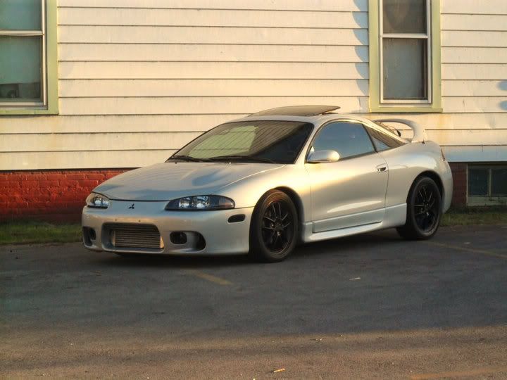

Heres a pic of the car i thought i would share
(looks a little different now that it has a CF hood)
47469_1583982963135_1342564268_31560482_247950_n-jpg.436007
