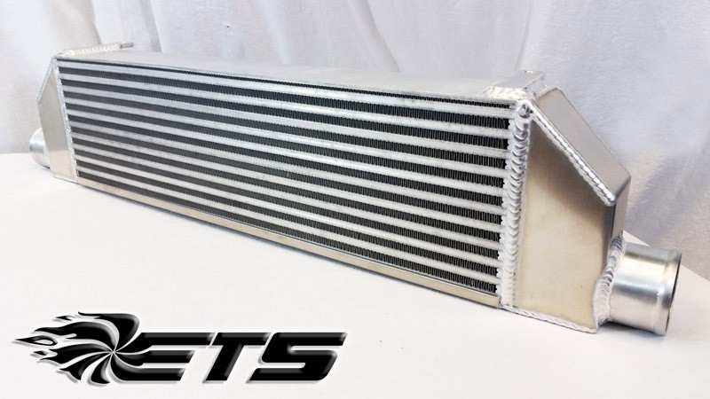

Fmic is one of those things that larger has few downsides. The issues will be packaging and whether or not that affects engine cooling. Cost. And whatever compromises come with running an fmic. I chose an ets street unit as I didn't want to cut my crashbar.
A fuel pump is similar to fmic. Bigger isn't usually a problem if you have a regulator that bypasses enough. I wouldn't go any smaller than 255. You may ready you can do a 190 and not have to run an aftermarket fpr. True but I prefer to have more than enough fuel than "just enough". Don't compromise if you can avoid it.
I am just torn on what intercooler to get. I want to keep my crashbar and foglights.
I am looking at this one at the moment with 3 inch core thickness and because I can keep my crashbar.
I am also looking at the one Pjj recommended.
Just don't know which one would work best for my goals.
Goal is to have a fast spool up time and do hard pulls often in the street
i run the treadstone tr1045 in my car which is the 4.5" one which is a lot larger but it keeps the iats super cool. you would want the 1035 which is 3.5", for injectors grab a set of FIC 1200cc high z and youll be golden
