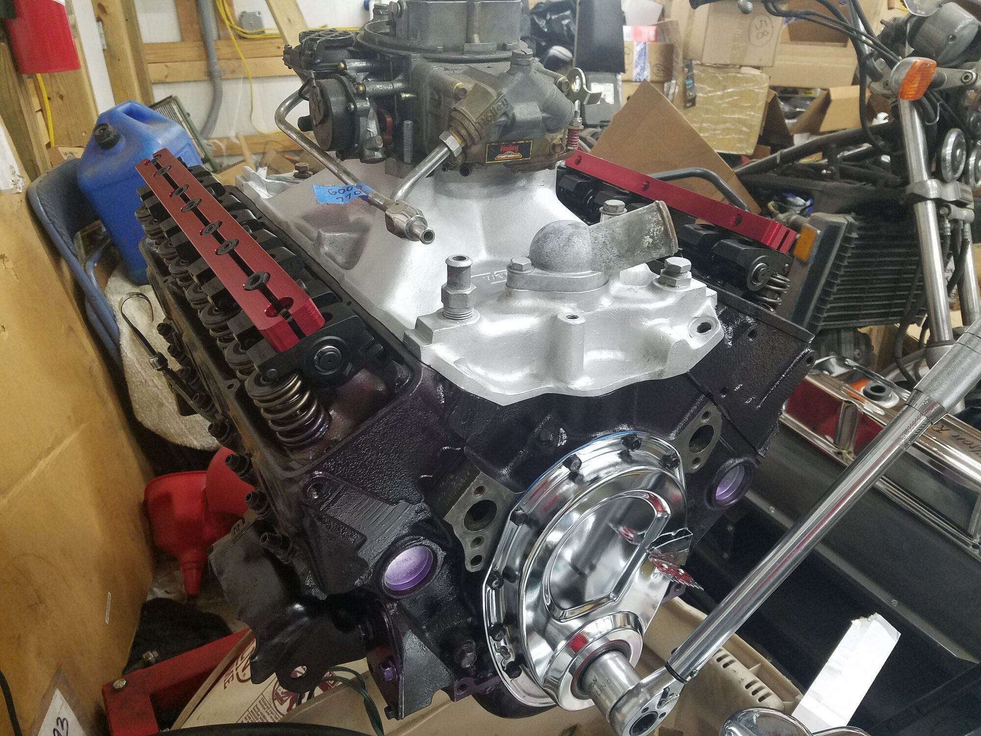

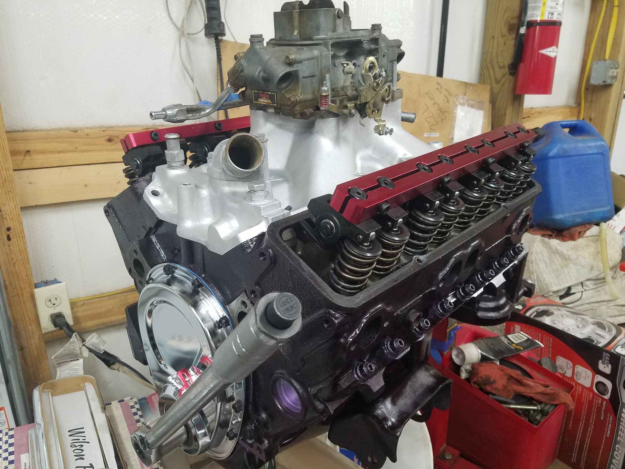

I ordered a new set of rockers and have the girdle so a few days and all should be buttoned up on the roller motor. It will be the first engine to go on the run in stand. Video of that for sure!
***** VIDEO HERE *****
Just pictures of the 350 Roller Motor. :)
If I'm not too busy with family, I could have it buttoned up any day.
It won't be long!

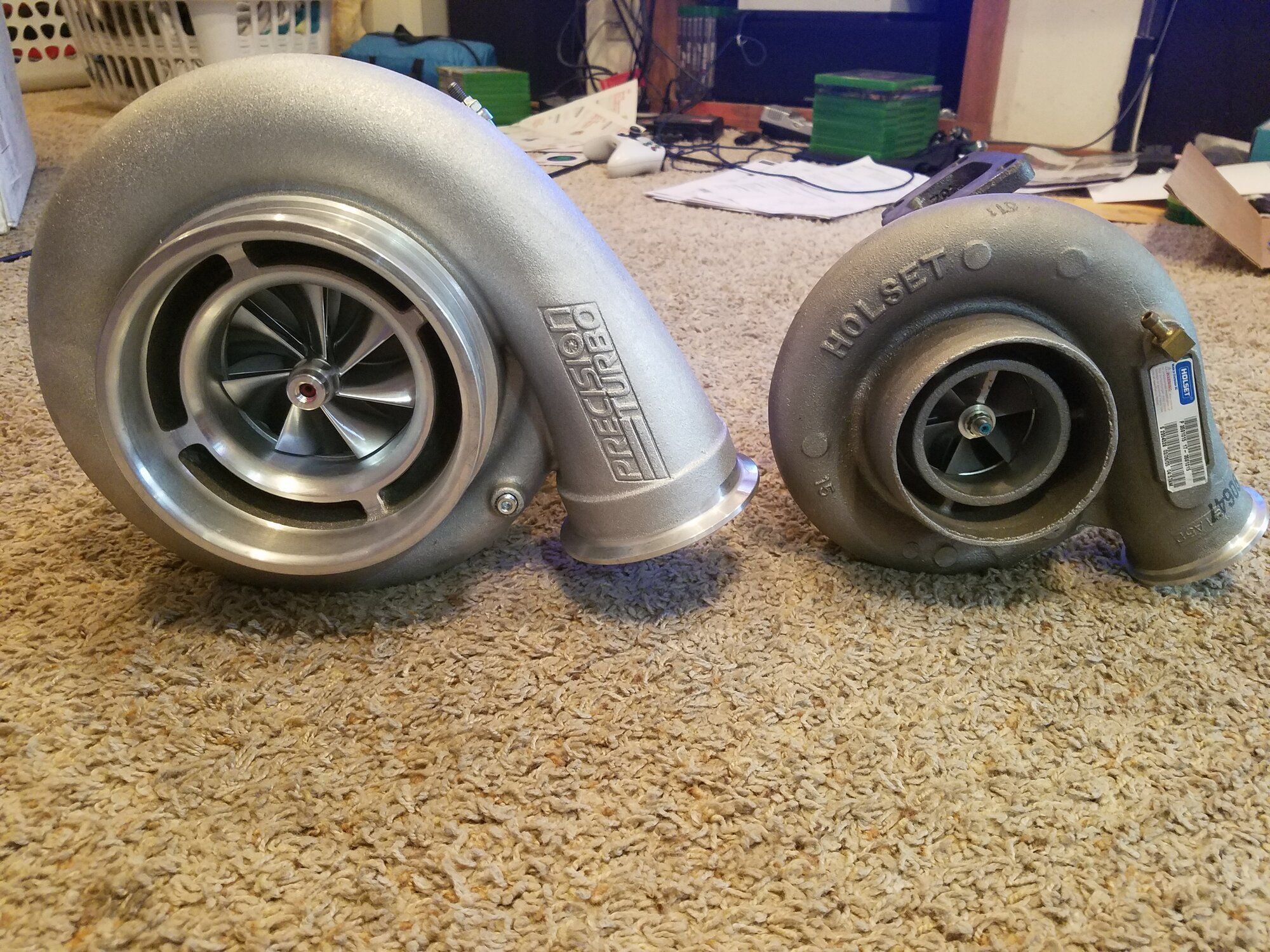

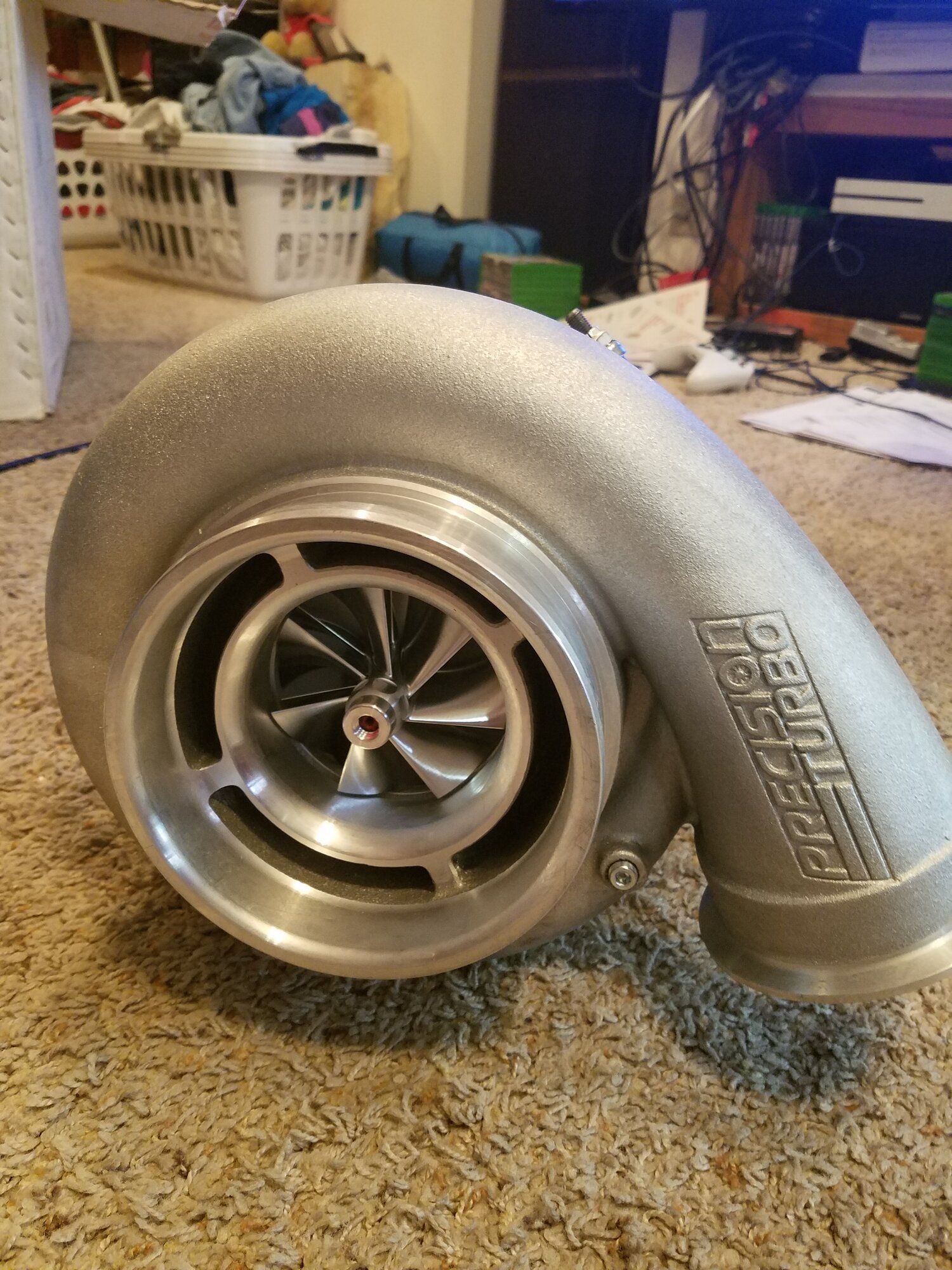

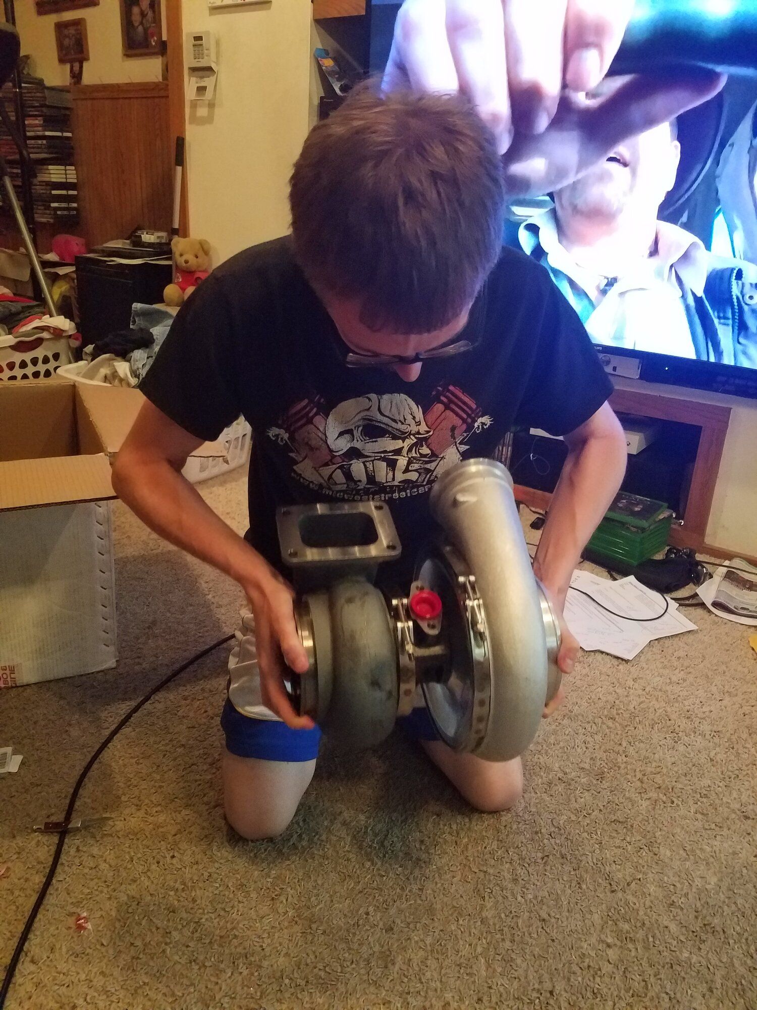

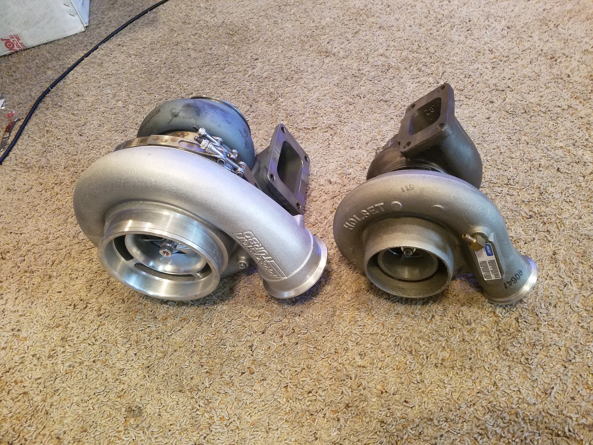

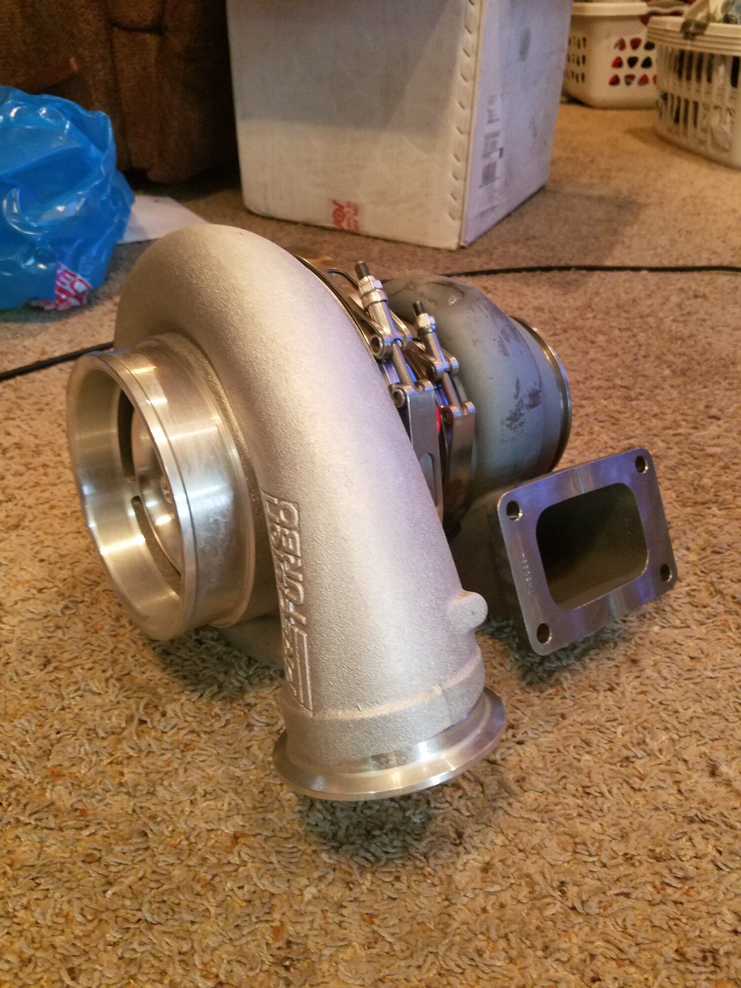

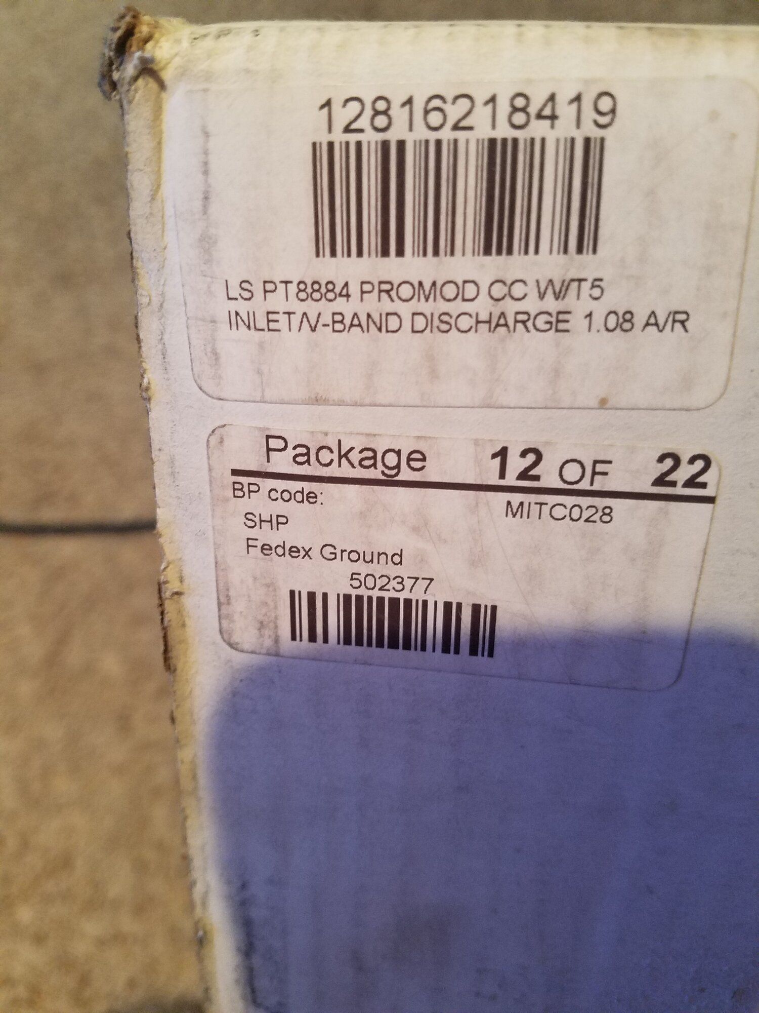

Well I pulled into the driveway today and a Big Brown Truck followed me.
I personally took possession of the cute little thing (55 lbs or so).
8884 Precision T5 with a 1.08 AR hotside. This dam thing can EAT my Holset HX40.
A GREAT BIG Thank You to Cleetus McFarland and the Freedom Factory!!!!
:D:D:D:D:cool::thumb:

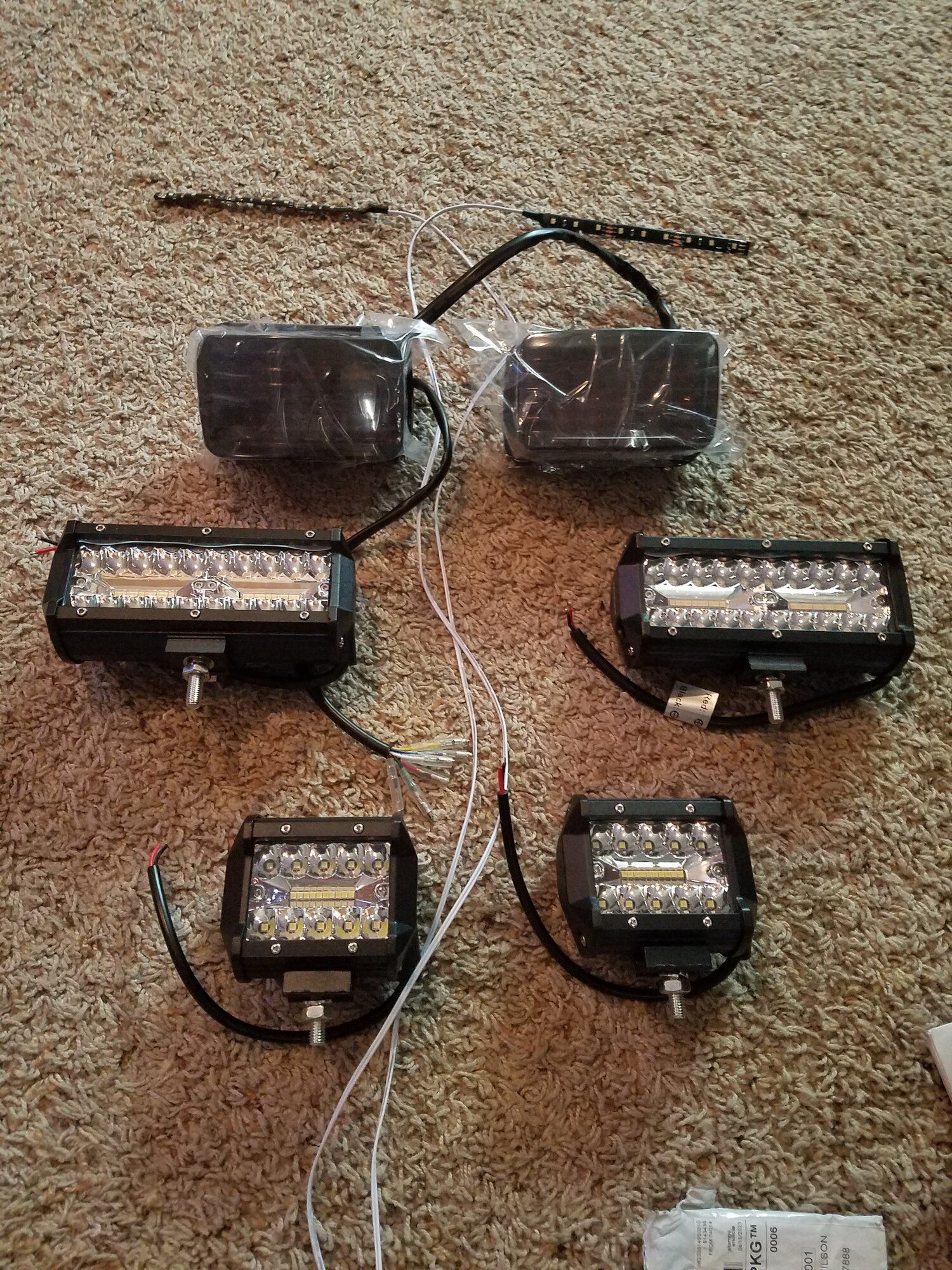

I have been busy ordering replacement parts for my farm cart, the TAOTAO Targa 200 twin seat buggy. Since I goofed up a couple lights, I decided to COMPLETELY modernize the lights for better lighting and better looks. I have all LED Headlights, taillights, backup lights and turn signals (Still have to wire those in).
It will be such an upgrade from what it has, that I think are FUGLY. The originals are round and I like rectangles!
Marty
I "test" wired my turnsignals for the cart last night on my kitchen table and I like them. They are all LED so I will need to turn the flash down slower, which I can do with the adjustable flasher that I bought. Now to wire it all in.....I am thinking of putting 2 green LED's on the dash to remind me the blinkers are on (I have a drawer full of different color 12v LED bulbs). It will be interesting and more modern for years to come. I enjoy "tinkering" on things like this.
Marty

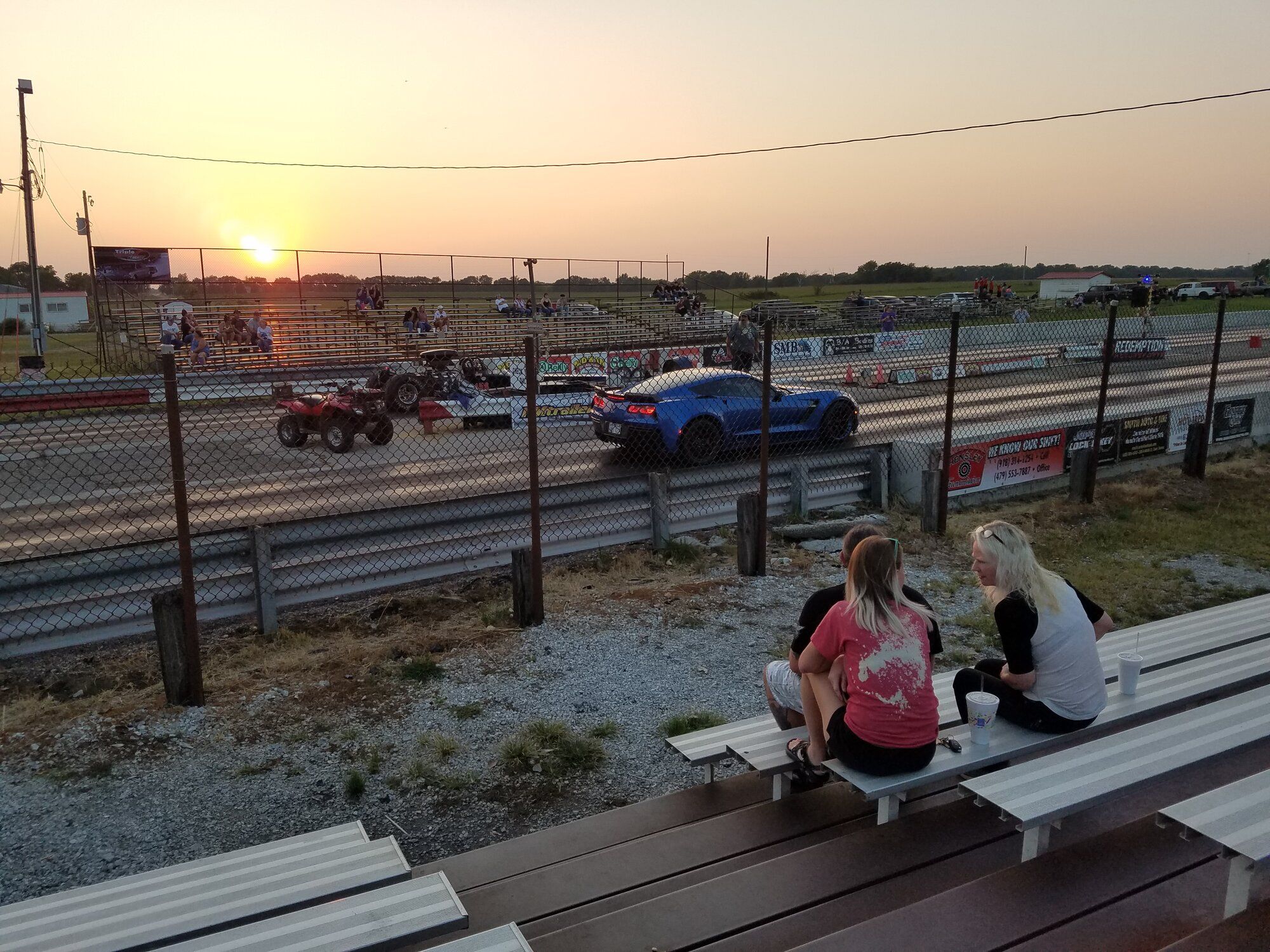

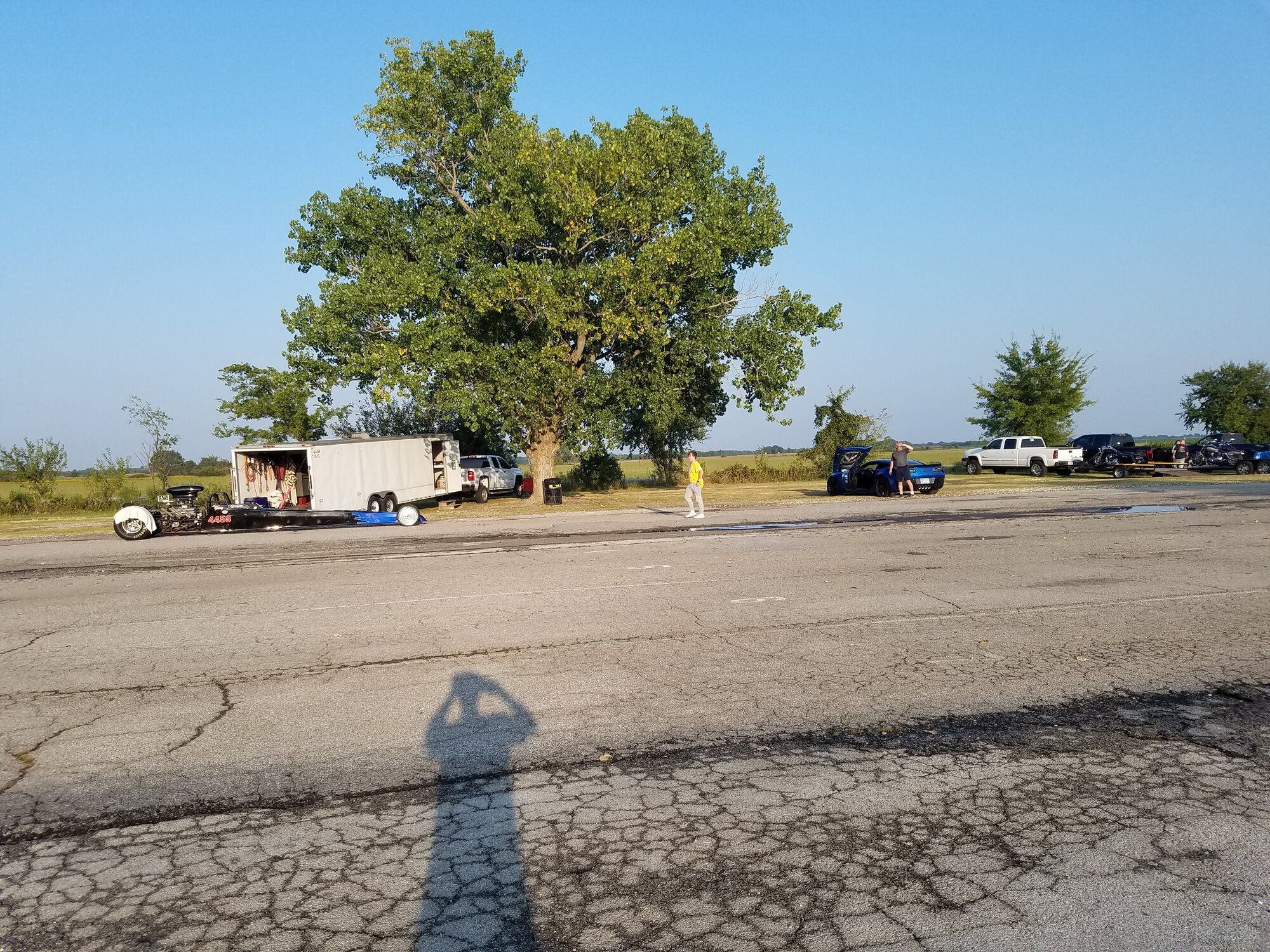

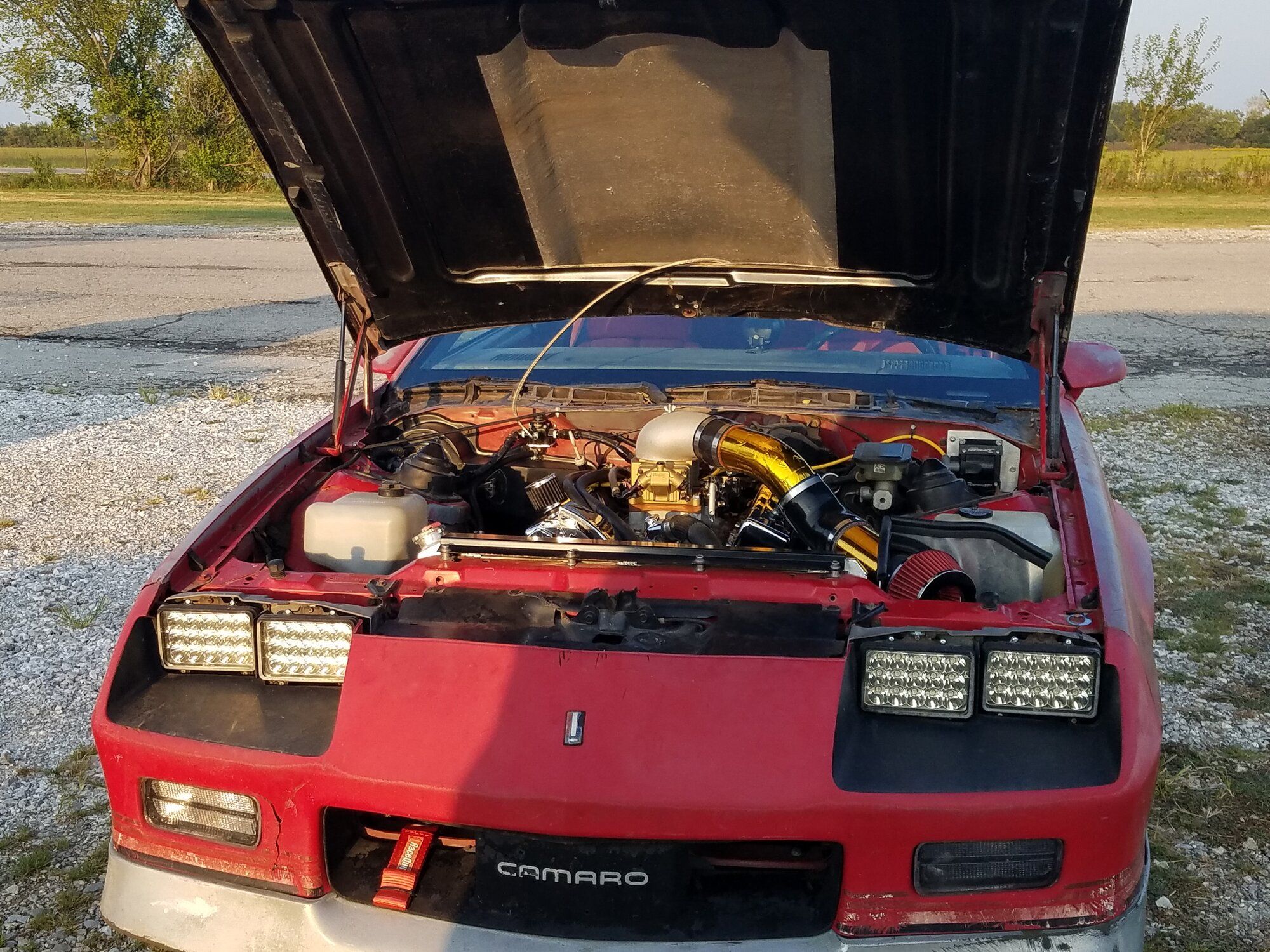

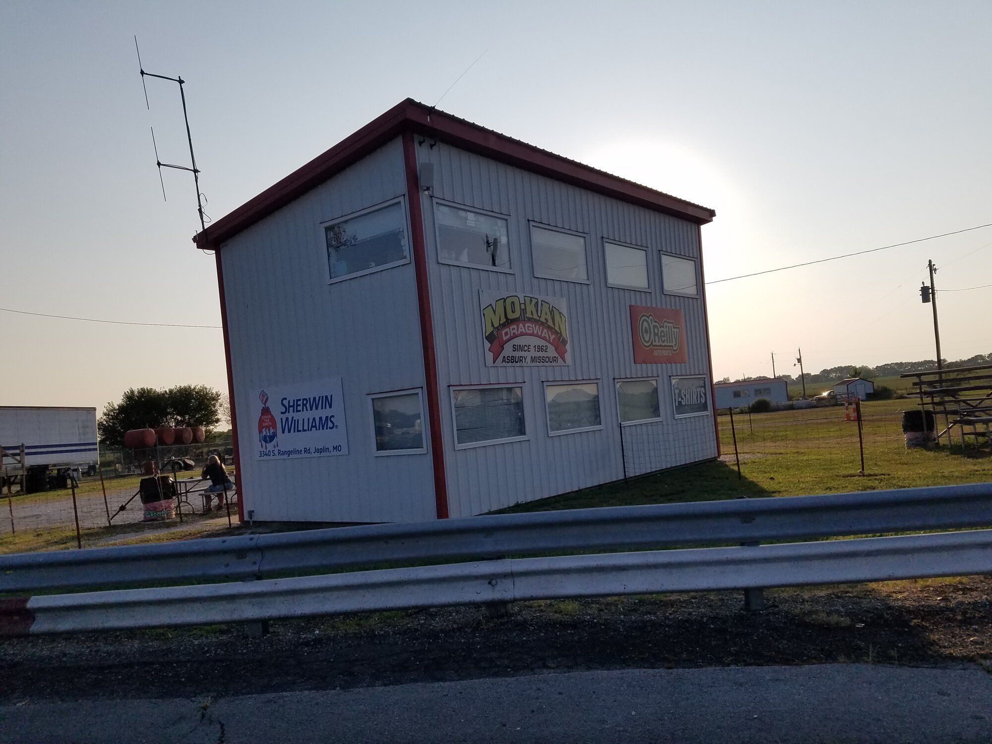

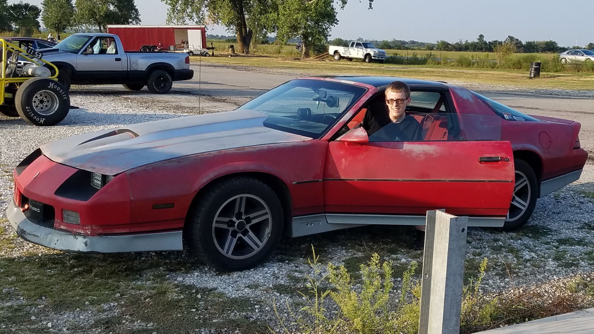

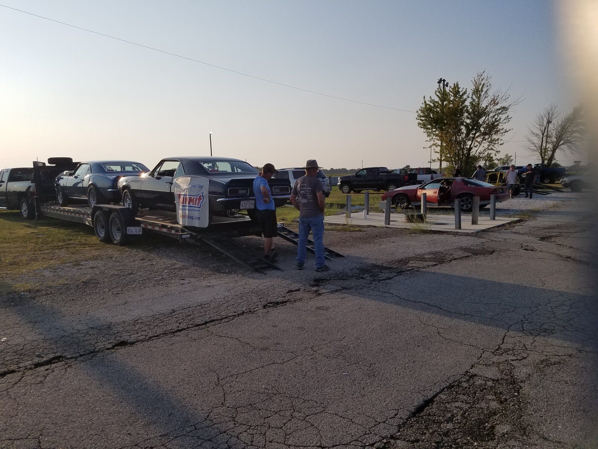

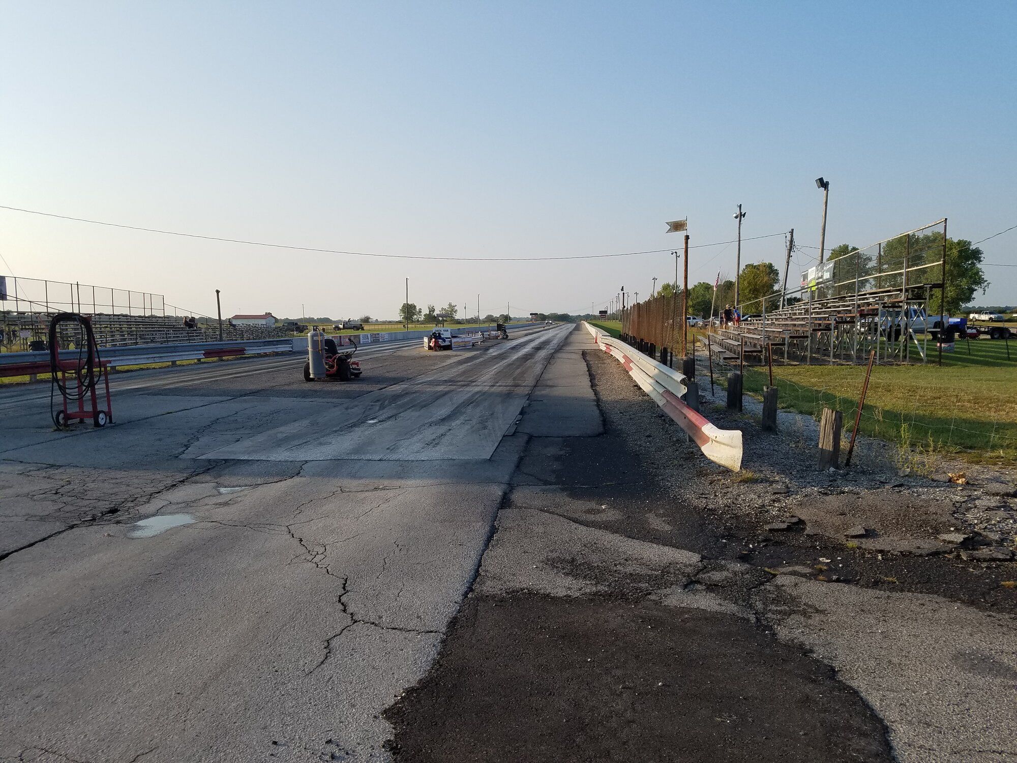

Well, it's test and tune night at the closest drag strip, (MoKan in Asbury Mo) which is an hour and 15 minutes away. We're going to take the 1986 Z28 with the 400 small block in it and see if she can cut a 12.999 quarter mile. Results will be posted! :thumb:
She ran 13.4 the last time she was over there with a carburetor and regular ignition. She is now sporting a holly sniper setup and seems to be more responsive, so we're going to find out!
:cool:
:cool:
Good luck Marty!
Well we didn't run faster or slower. Track prep was a little lacking and the car was spinning but usually doesn't. The track didn't prep like they normally do since they didn't have a Bracket race today. We ran 13.5 all night and I think he got 6 runs in. I say EFI may be more responsive and better in fuel economy but no better than my old carb and Accel Distributor setup. His cold air box did work VERY WELL. Without it, intake temps were around 120 but when he put the plumbing back on and routed to the cold air box, IATs were a nice 75ish. It was all hand fabricated by my son and looks and works really good!
It was a FUN NIGHT! :thumb:
Fun facts - This car cost me $1.00
Motor - 375.00 (then I rebuilt it)
Holley Sniper Setup - $2000
Pops ;)
Shakedown Run
3rd Gen Camaro vs New Mustang
1986 Z28 vs New Supra
Last run of the night at MoKan.
He had a Bye run this time. You can tell the track wasn't prepped like it usually is but it was still cheap ($20) fun! Hope that you all get a chance to do the same thing! :thumb:

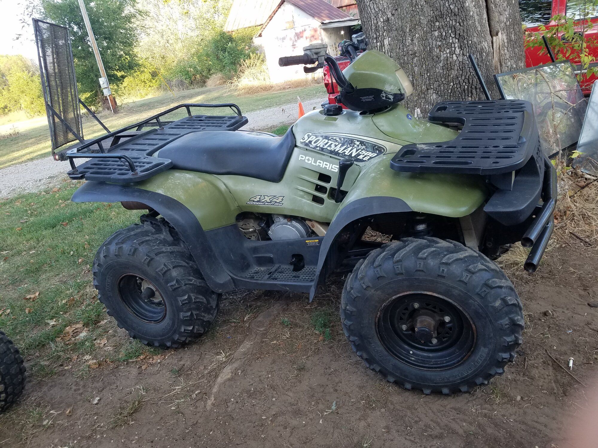

Well I added a new shop tool to the "TOYS" for pushing/towing and general mayhem on the farm. It was bought from a my best friend in the town I work in and it has ended up being so nice (don't look at the zip ties).
Have a look, probably more to come. It's a Polaris Sprotsman 500 HO. New battery, suspension, starter, bendix, cover, carburetor, tool box and I am sure there is more. It just needed some attention so my son and I gave it that. It will be super helpful pushing dead cars into the shop or around the farm. Everything but the lighting is working and I will be upgrading the lighting when the time is right to all LED.
Here is my son test driving it after a successful carburetor replacement/adjustments and anything else we found needing attention.
A big thanks to the Polaris web group for their help!

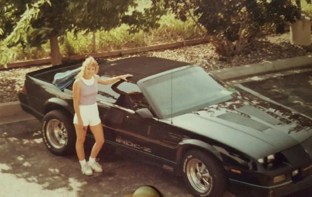

Came across a couple pictures from the 80s and my vehicles back then, after the V8 Vega, 1970 Chevelle SS and 1971 Camaro SS.
I'll try to find a picture of all 3 of those from the 70s.
Man, that's ALONG TIME AGO.
It is my '87 IROC-Z Convertible and my '75 Chevy Blazer. Such fun vehicles from the WAYBACK MACHINE, ROFL
Yeah, 35 dam years ago Pat. I used to HAVE HAIR. I still do but not alot. I was probably 25. ROFL

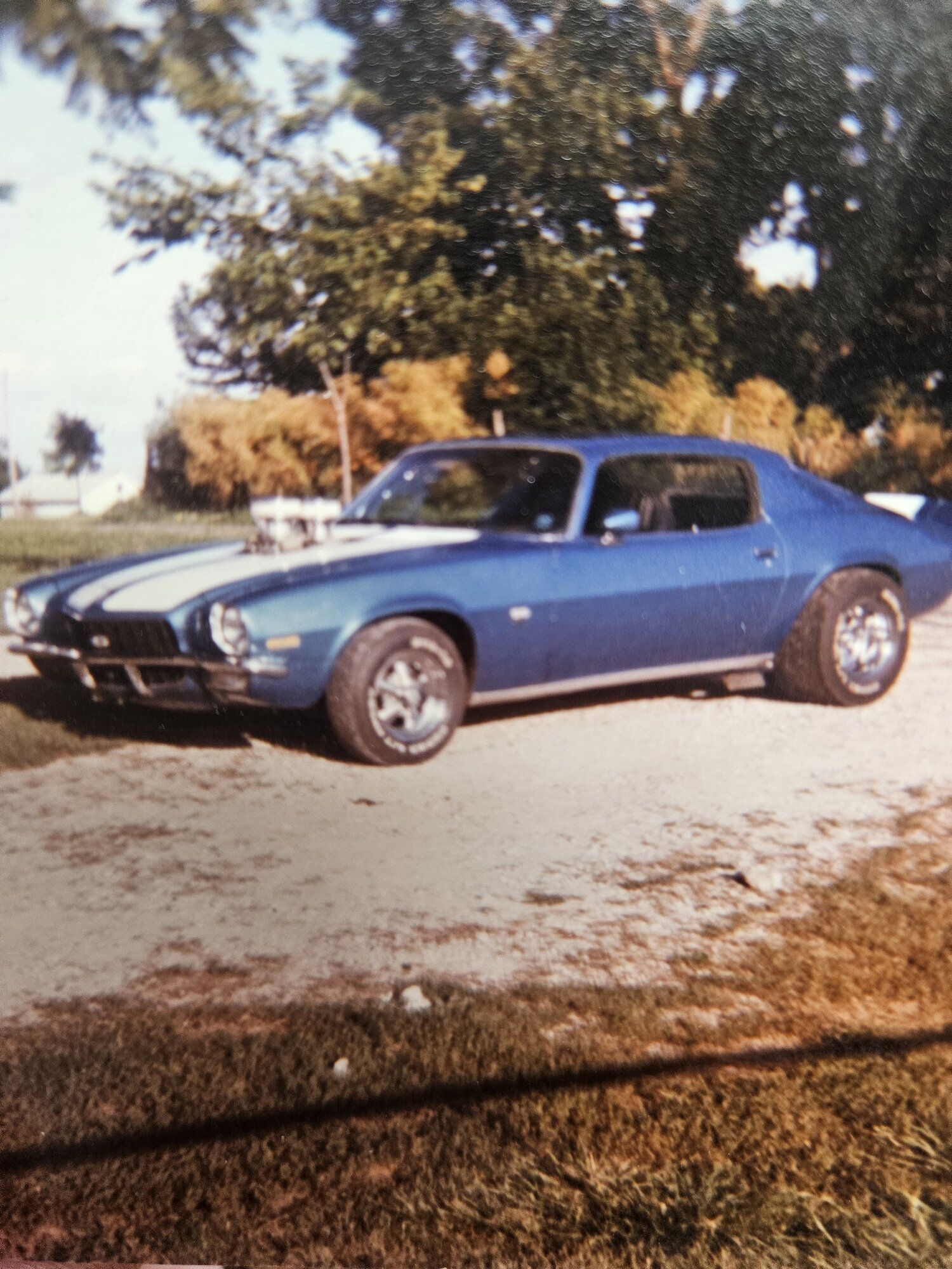

1971 Camaro SS 350, 2 600 Holleys, Comp Cam, 10:1 with 3:73's. Ran 13.2's in street trim.

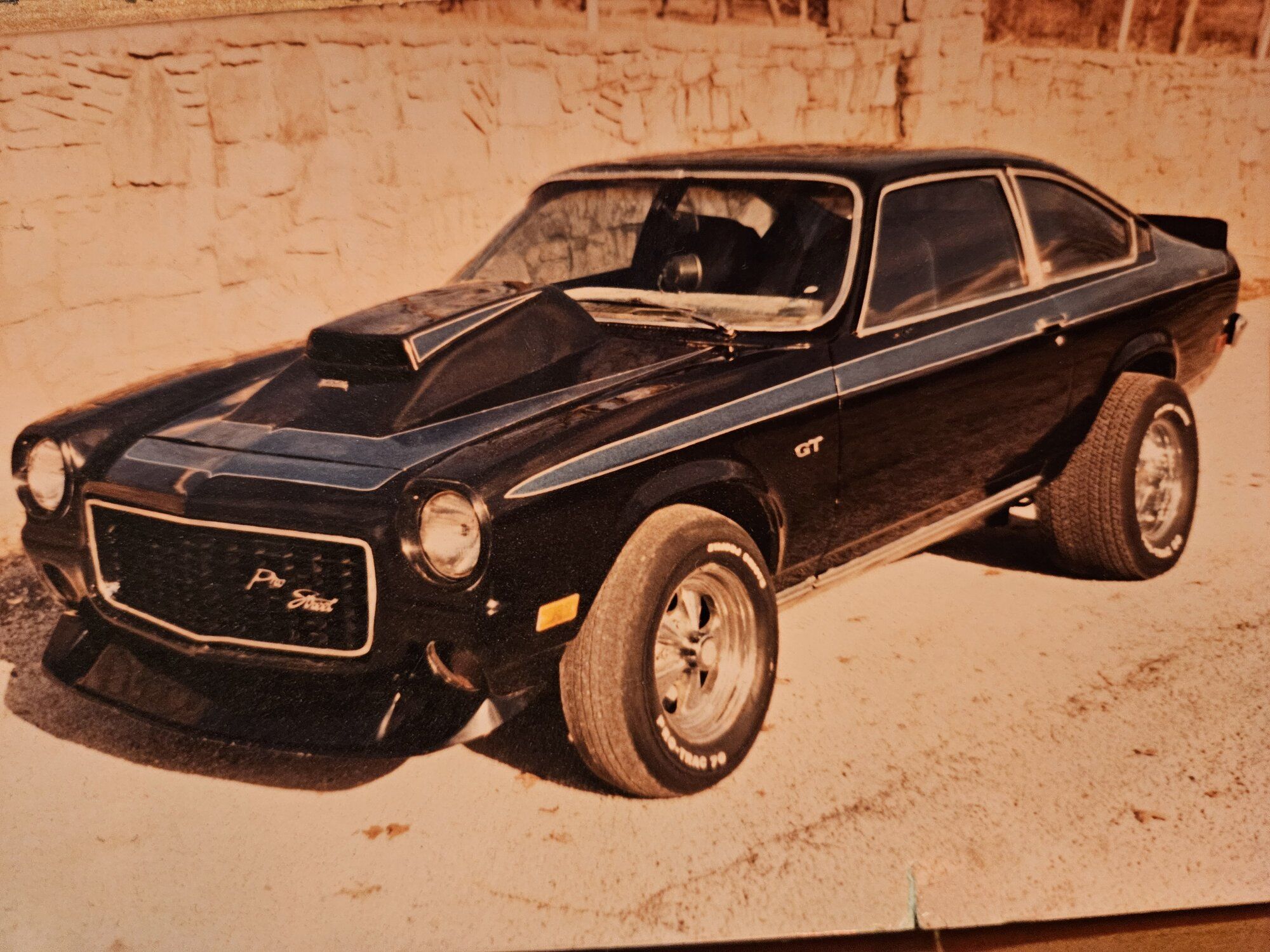

1973 V8 Vega GT - Corvette 327, 11:1's, 4 speed, 4:56's. Ran 12.82 and got me to the finals. I broke out in the finals, running faster than my dial in. I was young and dumb. I could have coasted across the line I was winning so good. DAM, missed the only trophy I don't have!

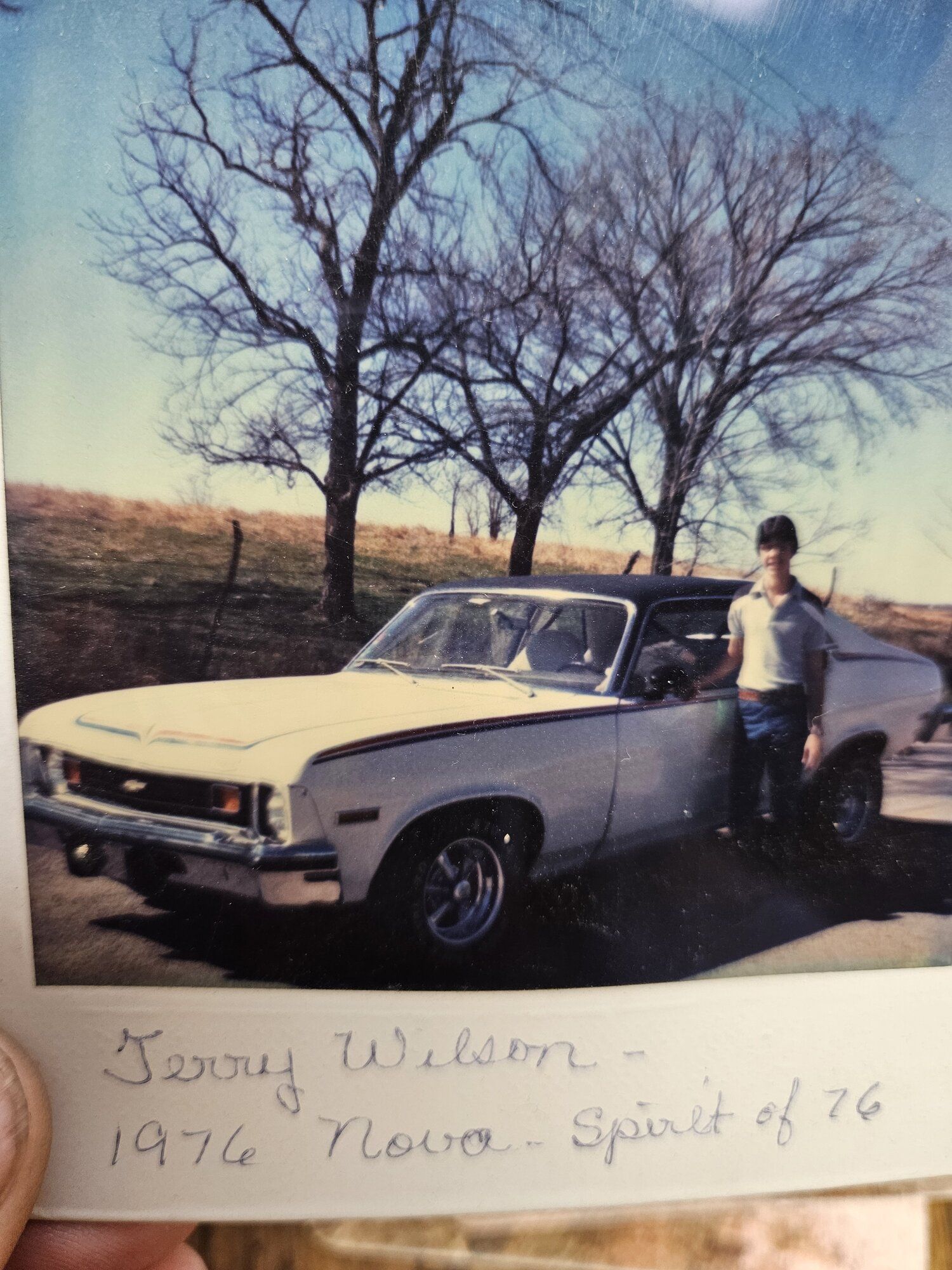

1976 Chevy Nova "Spirit of 76" Edition. This came out with a 6 cylinder, 350 turbo trans. I pulled my brothers motor and stuck a SBC in it. He was happy! 😊❤️ RIP little brother!

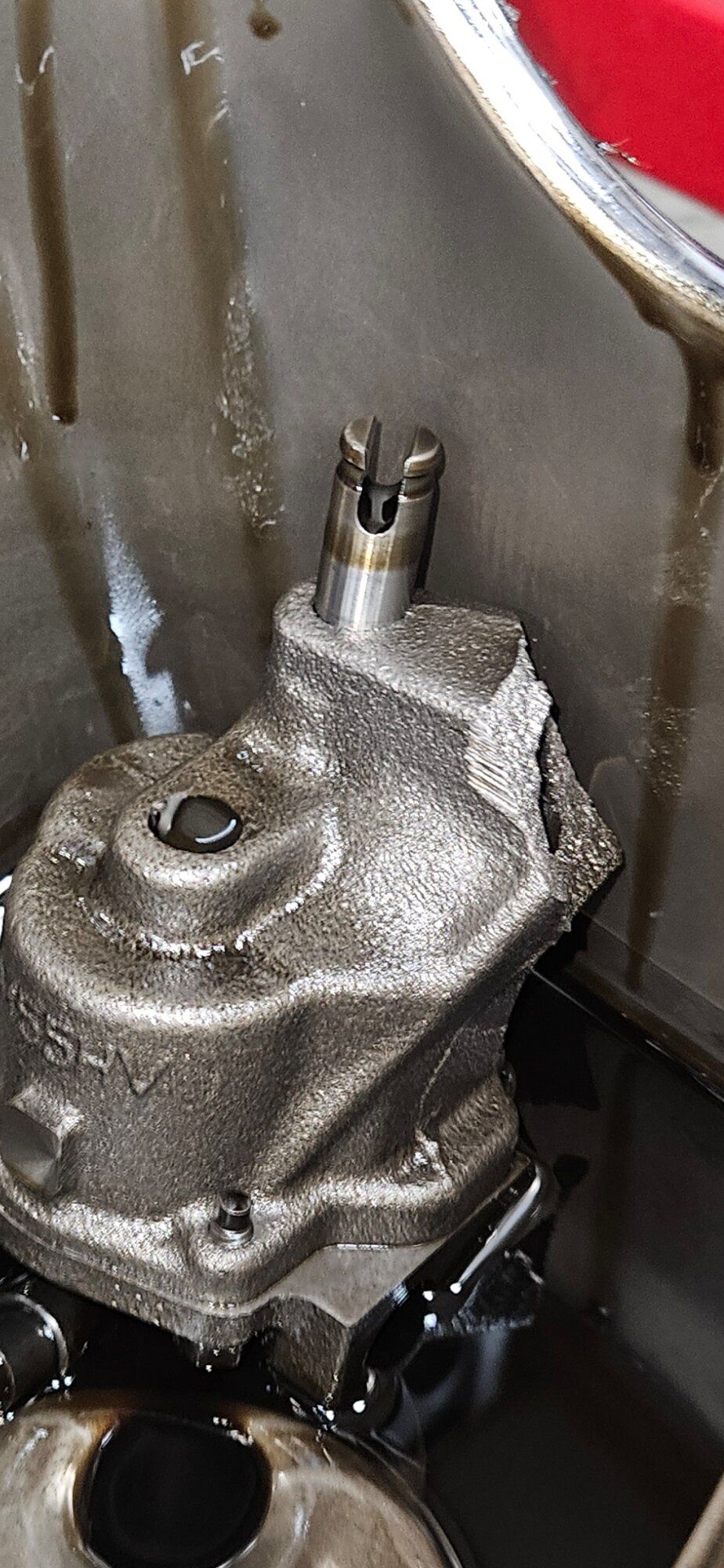

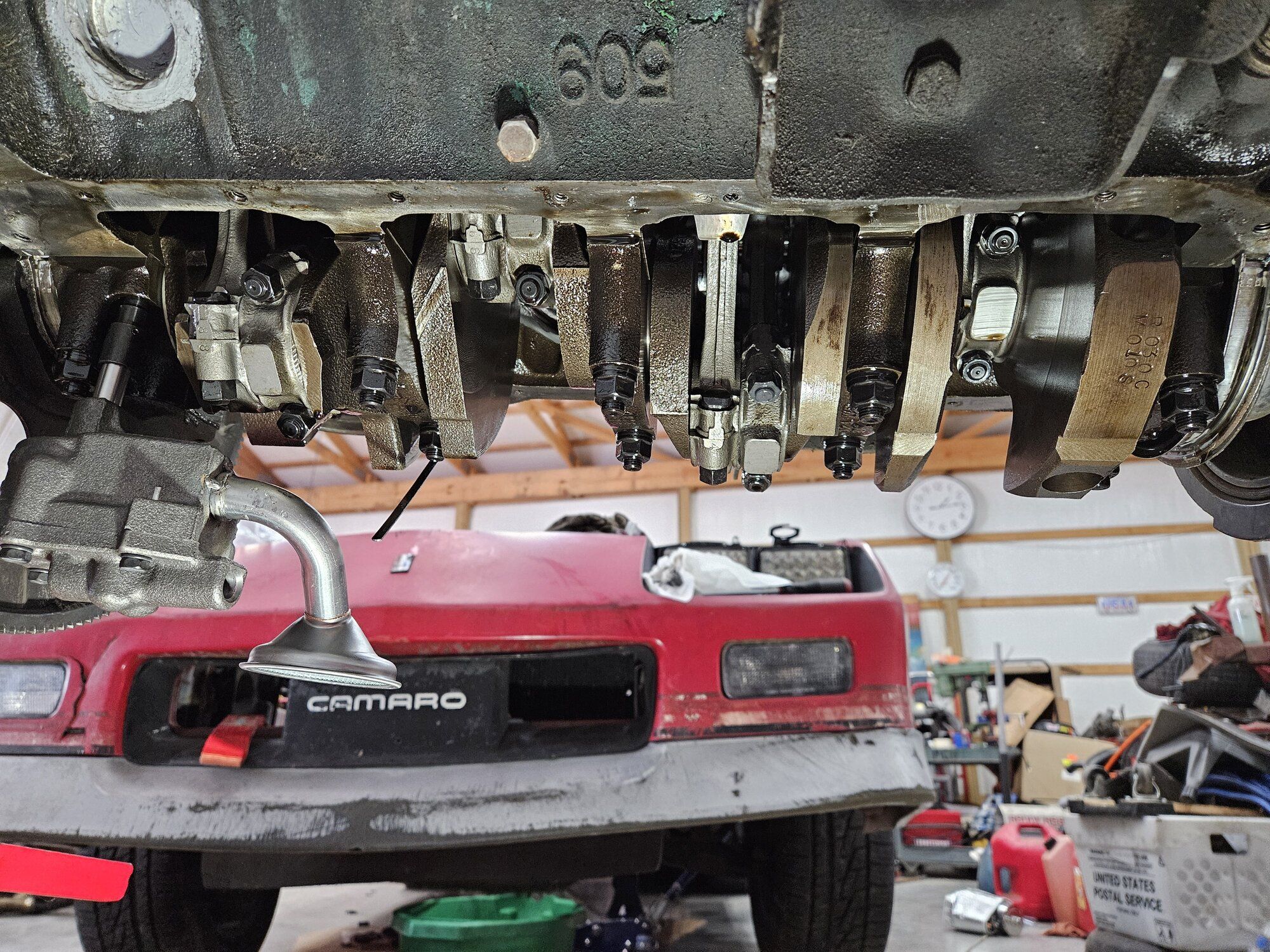

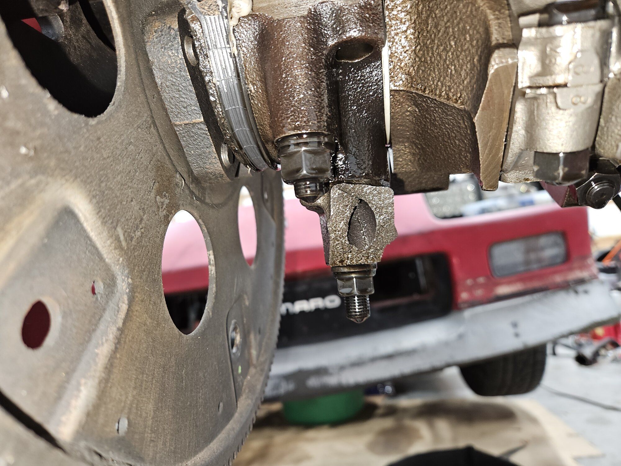

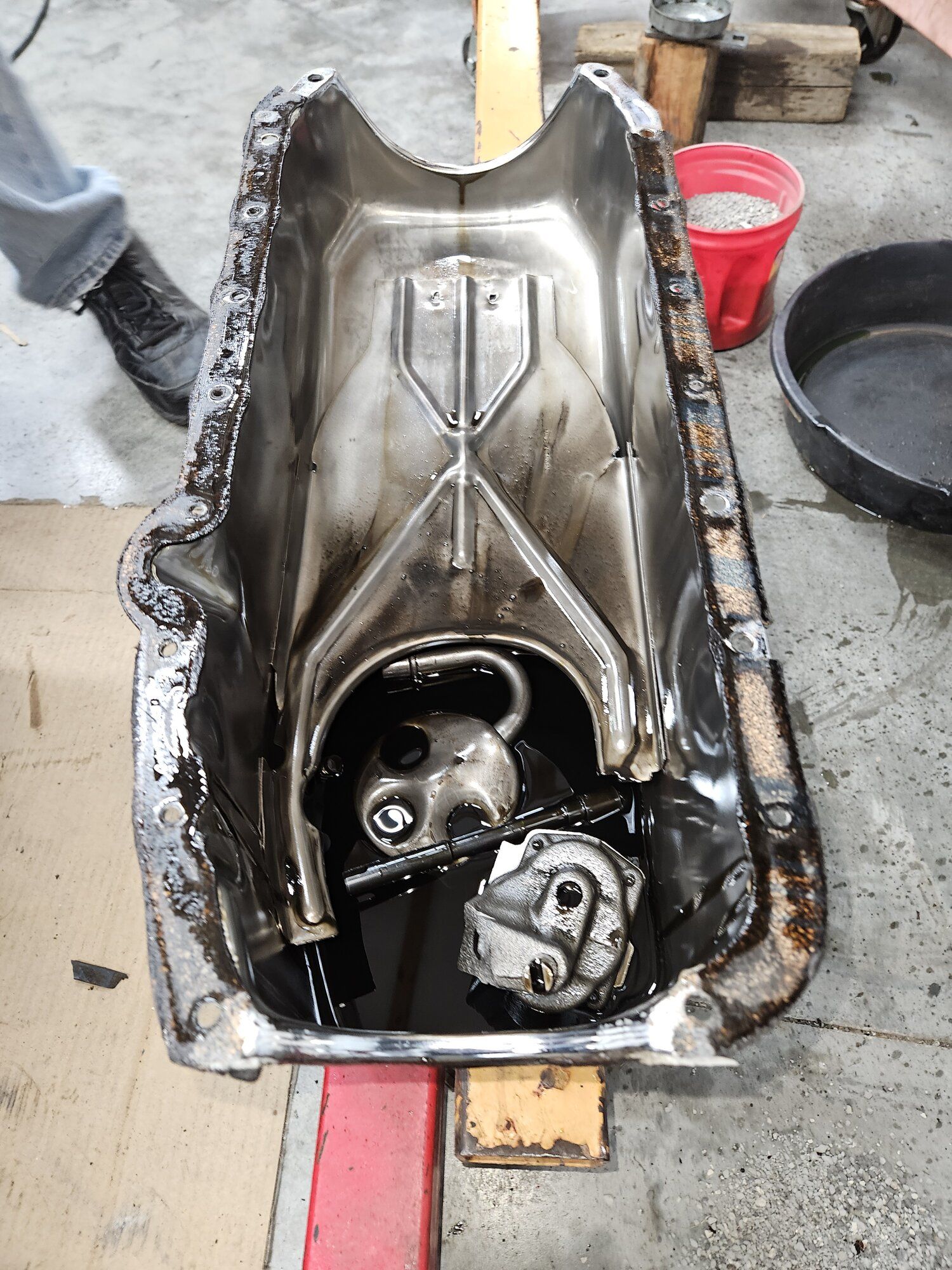

Well, the Wilson herd of "animals" had a failure that my son and I have finally found. I have never seen this on an old SBC with a Melling High Volume pump (or ANY DOMESTIC PUMP for that matter). He was on his way home from town at cruising speed, about 55, and the oil pressure took a dump and went to ZERO. He killed the engine immediately and coasted into the drive. We looked back at our last video and can see the oil pressure going from 60 to 40 then back up to 60 the week earlier, we just didn't see it in the video.

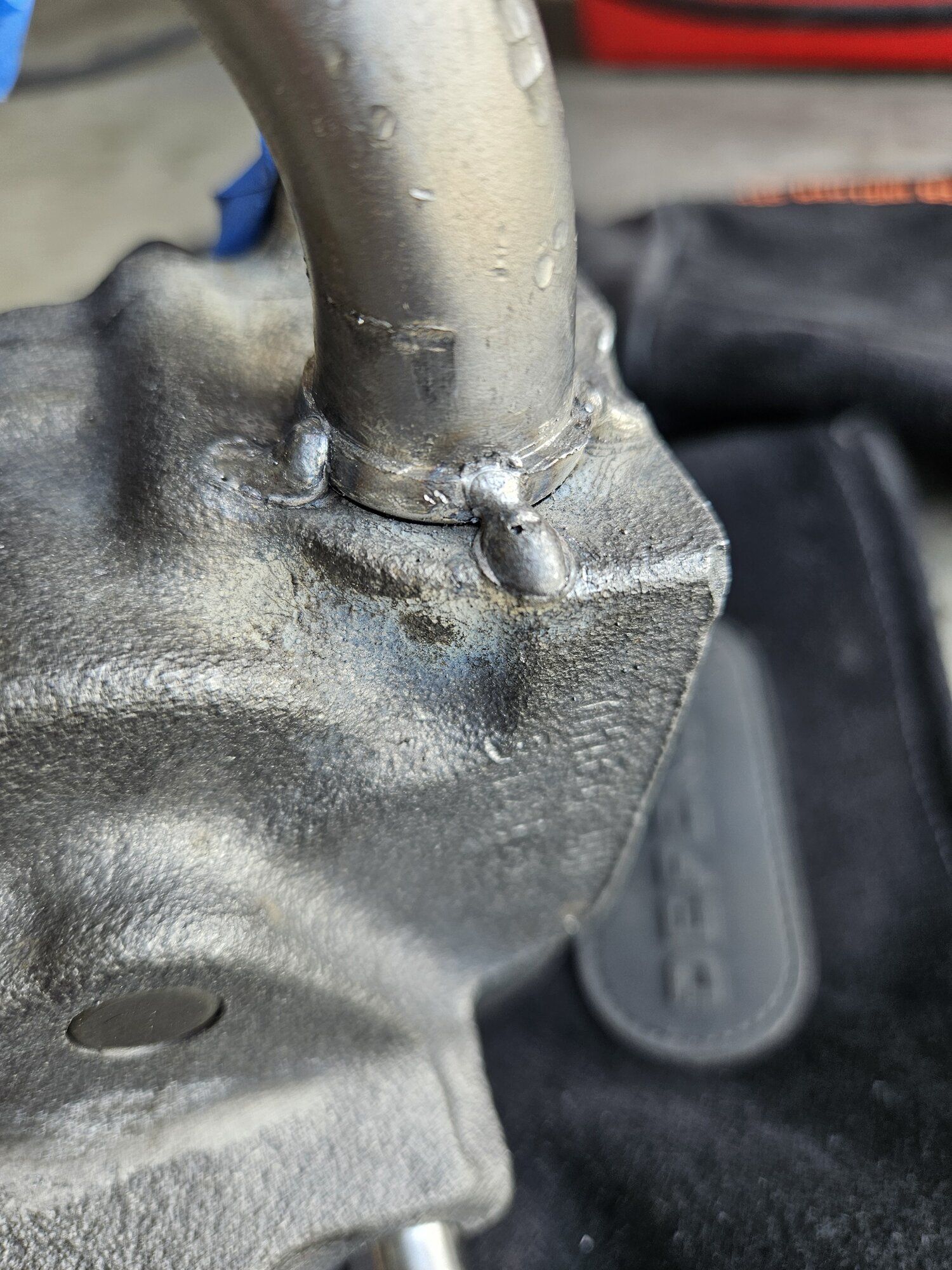

Anyway, we'll clean up everything, install a new M55HV pump and screen (we'll tack weld that puppy also) and she should be OK. I'll probably pull 1 rod bearing for a look see, but they are all still nice and tight just like my ARP Oil Pump stud is :hmm:
Just CARNAGE pictures. I "think" everything will be OK. We're gonna swap intake manifolds and retorque all the head studs while the motor is out. He is putting a OG air gap Scorpion intake on to lower AIT's, as his Holley Sniper EFI unit is a speed density setup. We are swapping the aluminum roller rockers out for a set of SS units also, for longevity.
Fingers crossed, just updates as to what is going on in the Wilson Shop ATM.
I have NO EXPLANATION for this currently :idontknow:
Marty (aka Pops)

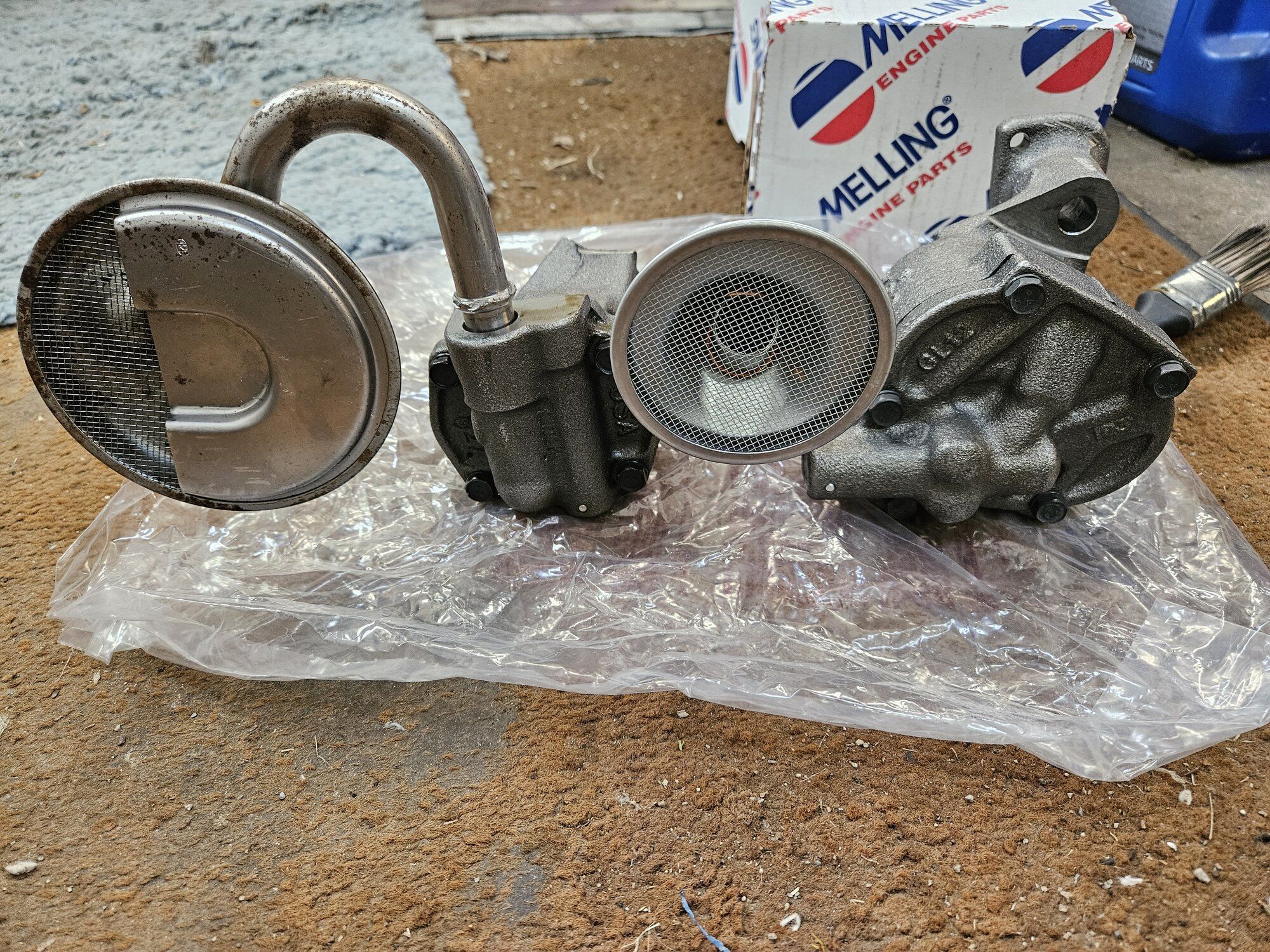

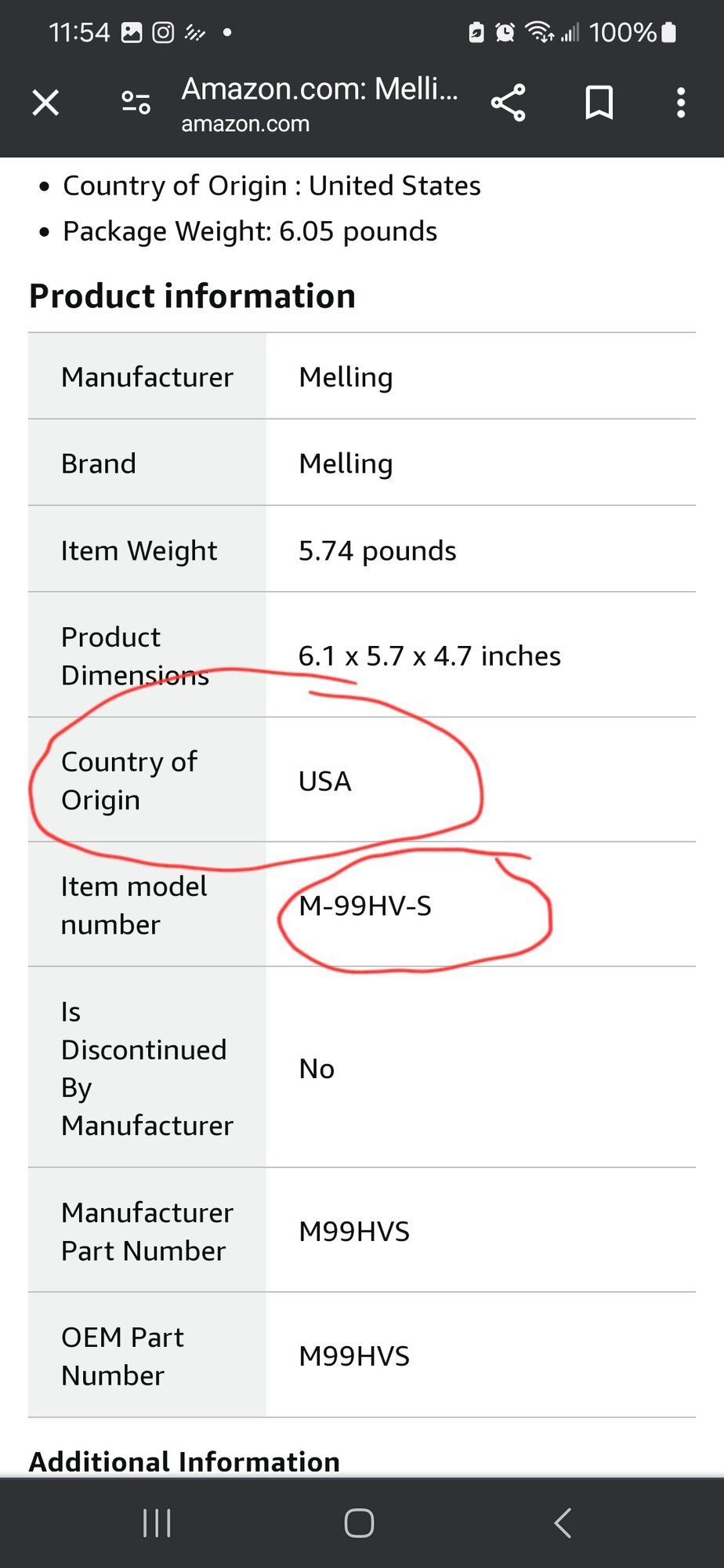

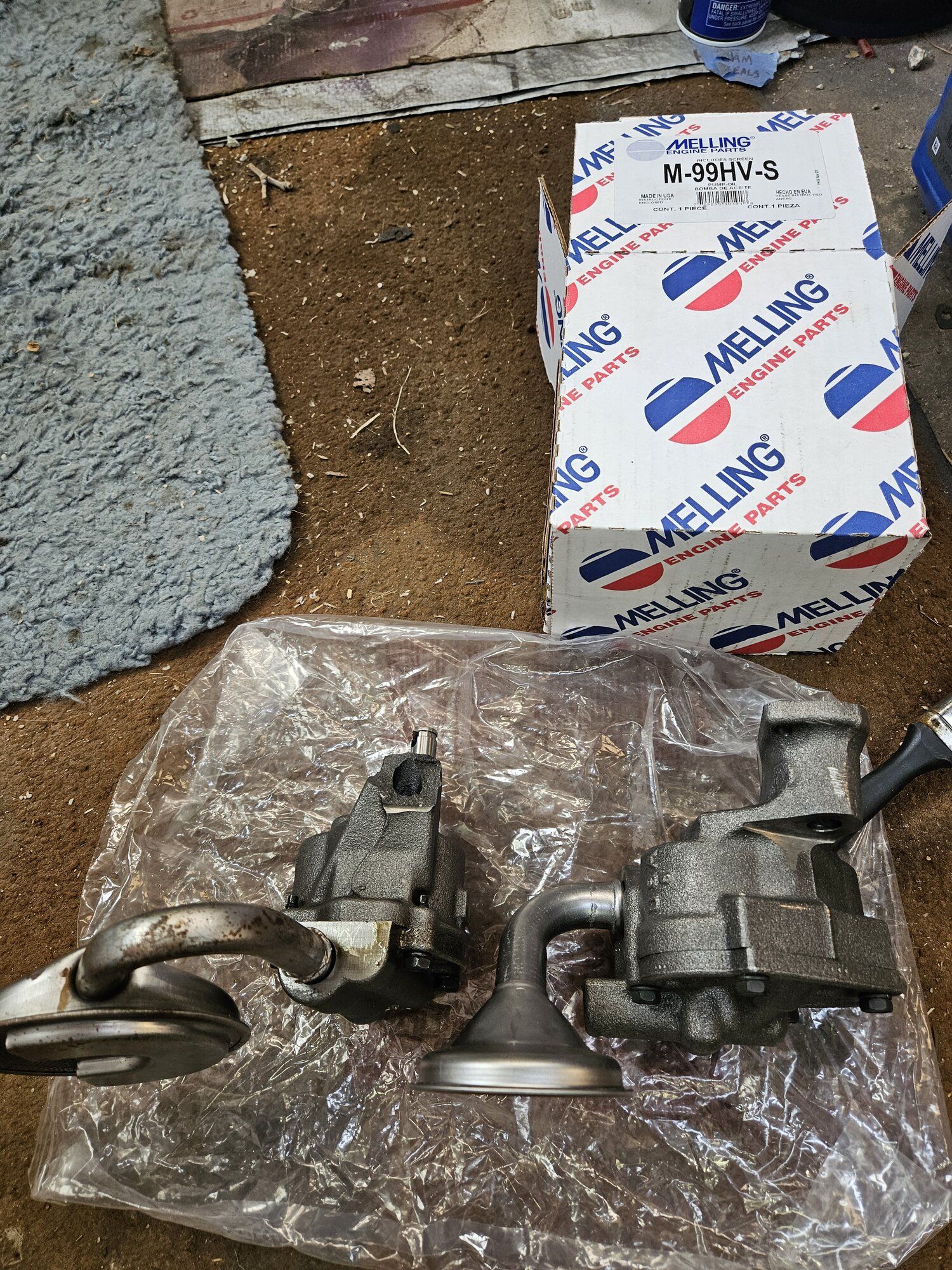

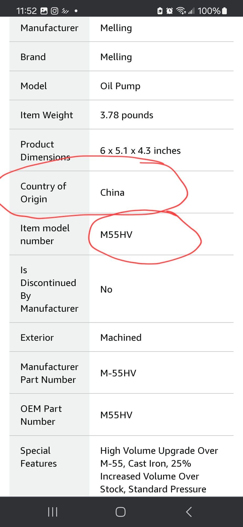

Well I am going with a Chevy BIG Block oil pump on the SB 400. After looking at "Origin of Manufacture" for the Melling M55HV, it is from......everyone can guess....................
C H I N A
The new pump is a Melling M99HVS. It only came stock on a 1968 Z28 with the high revving 302. I have used this pump before with no problems and feel even better that when I look at it's "Origin of Manufacture" is U S A!!!!!
It is a heavier pump but looks much beefier (because BIG BLOCK).
Here are the 2 Product Information Sheets
Small Block Hi Volume M55HV:
BIG Block Pump for a Small Block M99HVS:
Both side by side. Much more HD and made in USA!

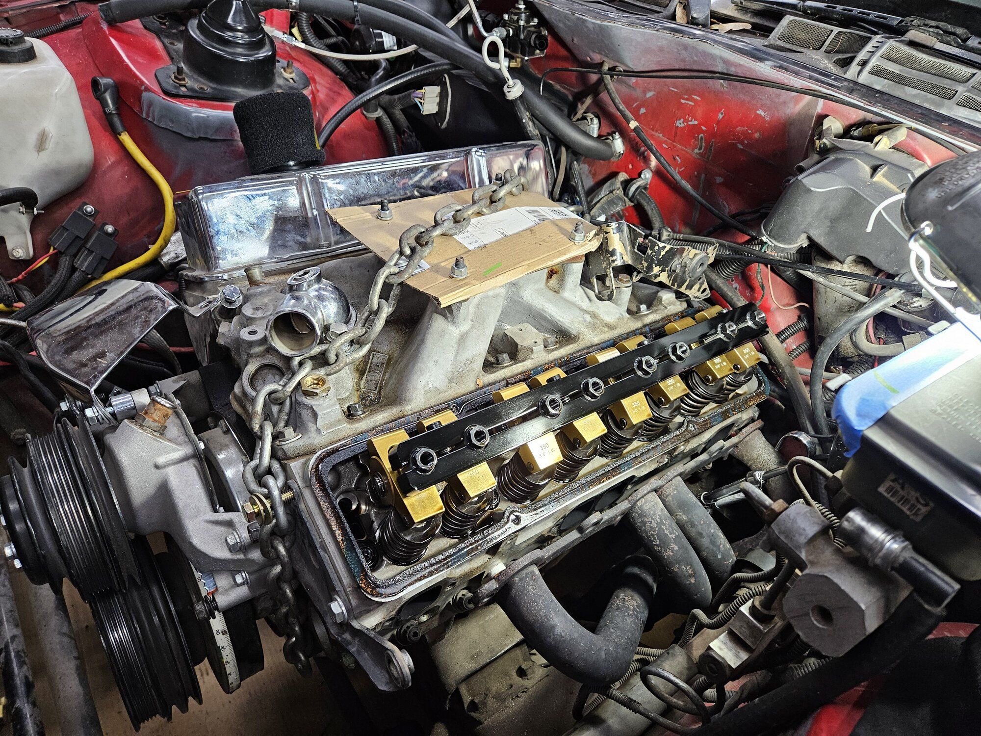

So that's what is happening in the shop this week. My son goes to work for a mechanic shop on Monday, so we are on a time schedule of sorts. Trying to swap intake manifolds during this fiasco also and SS roller rockers, if they will clear the big springs on the valves. Then get it sitting back in the bay is the goal. :thumb:
Marty & Trevor

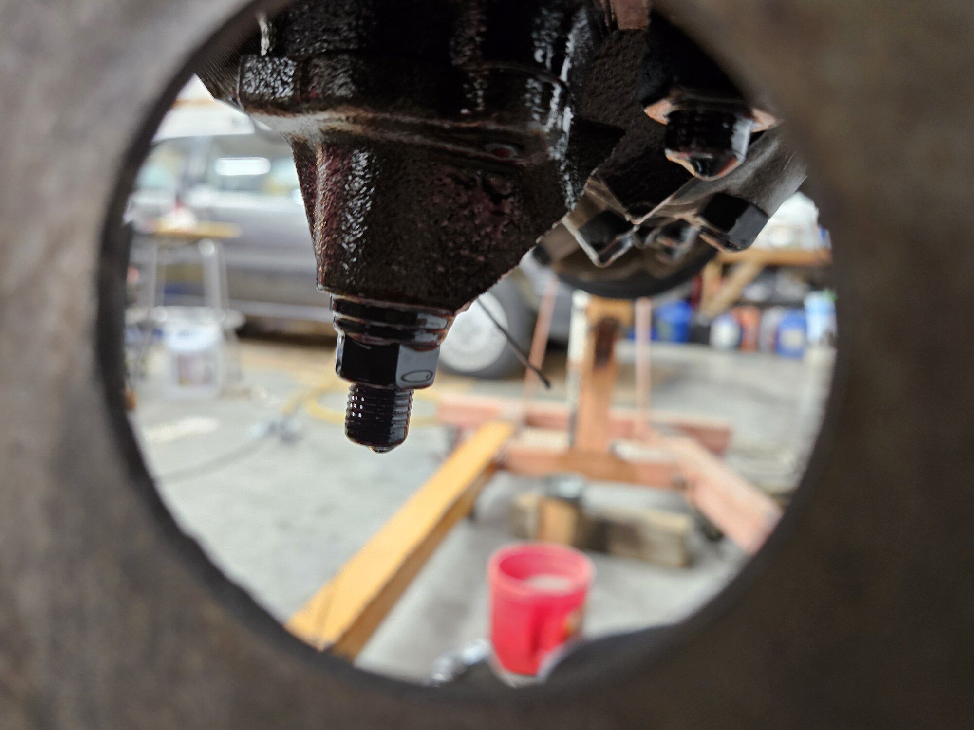

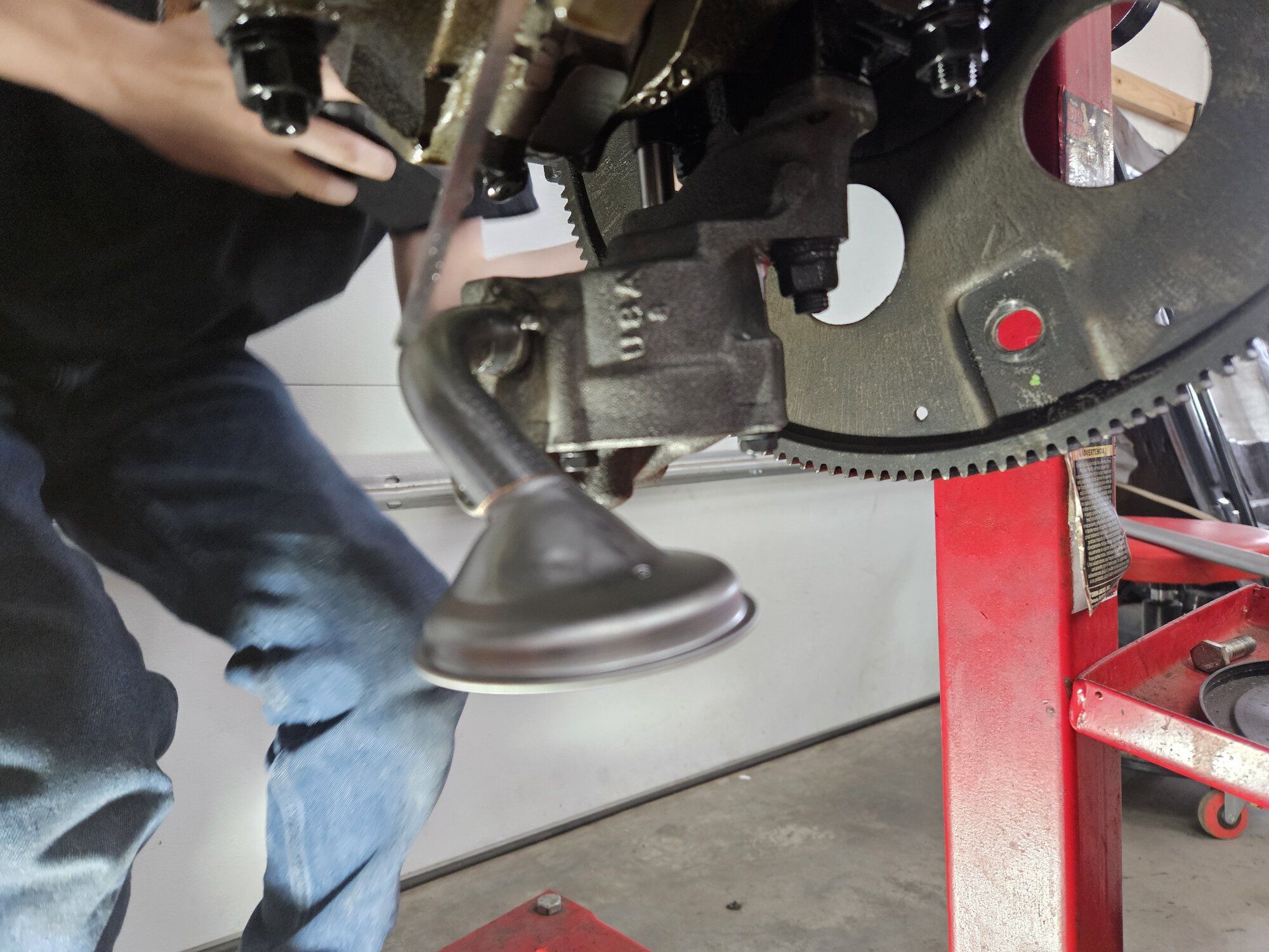

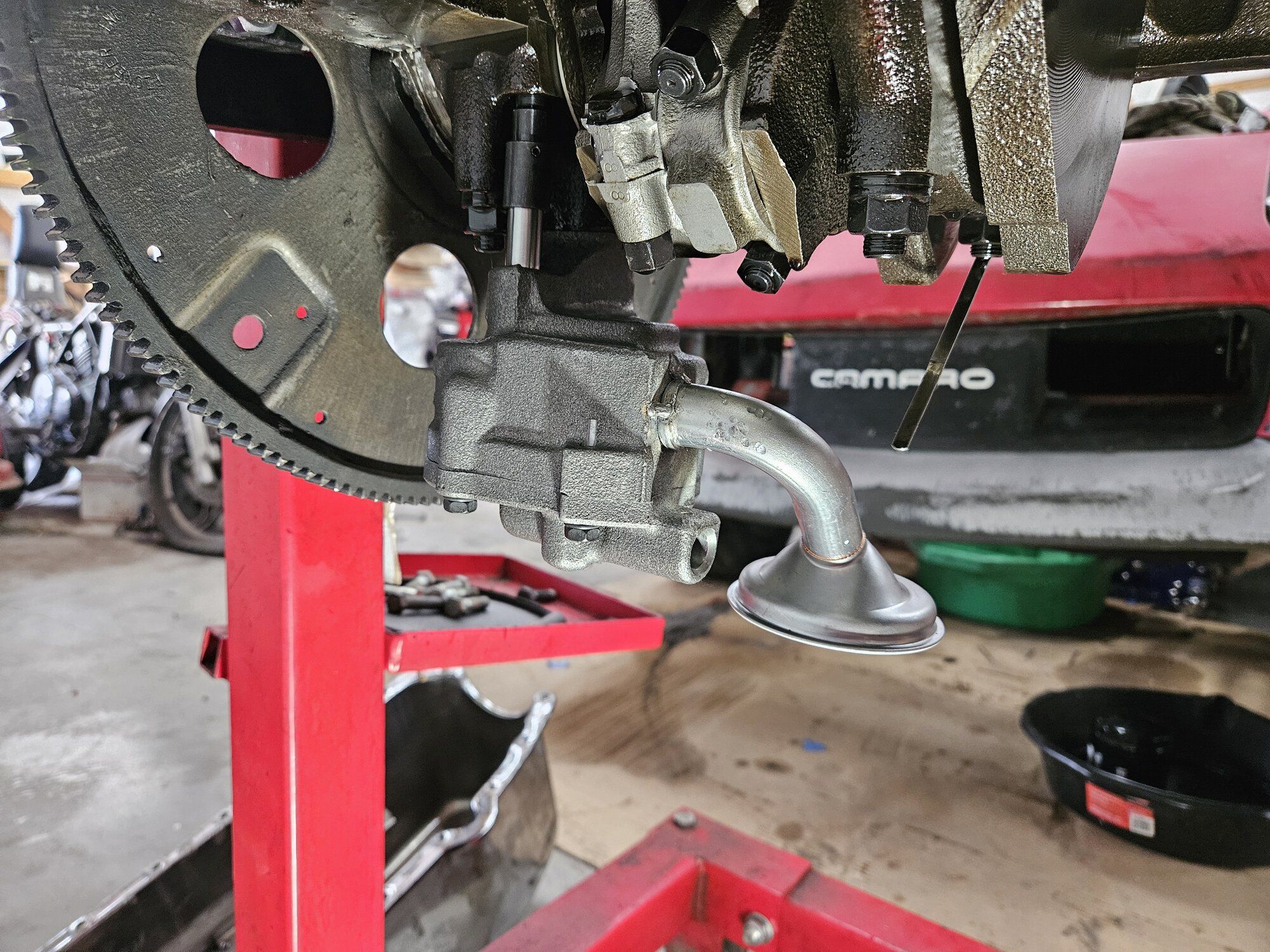

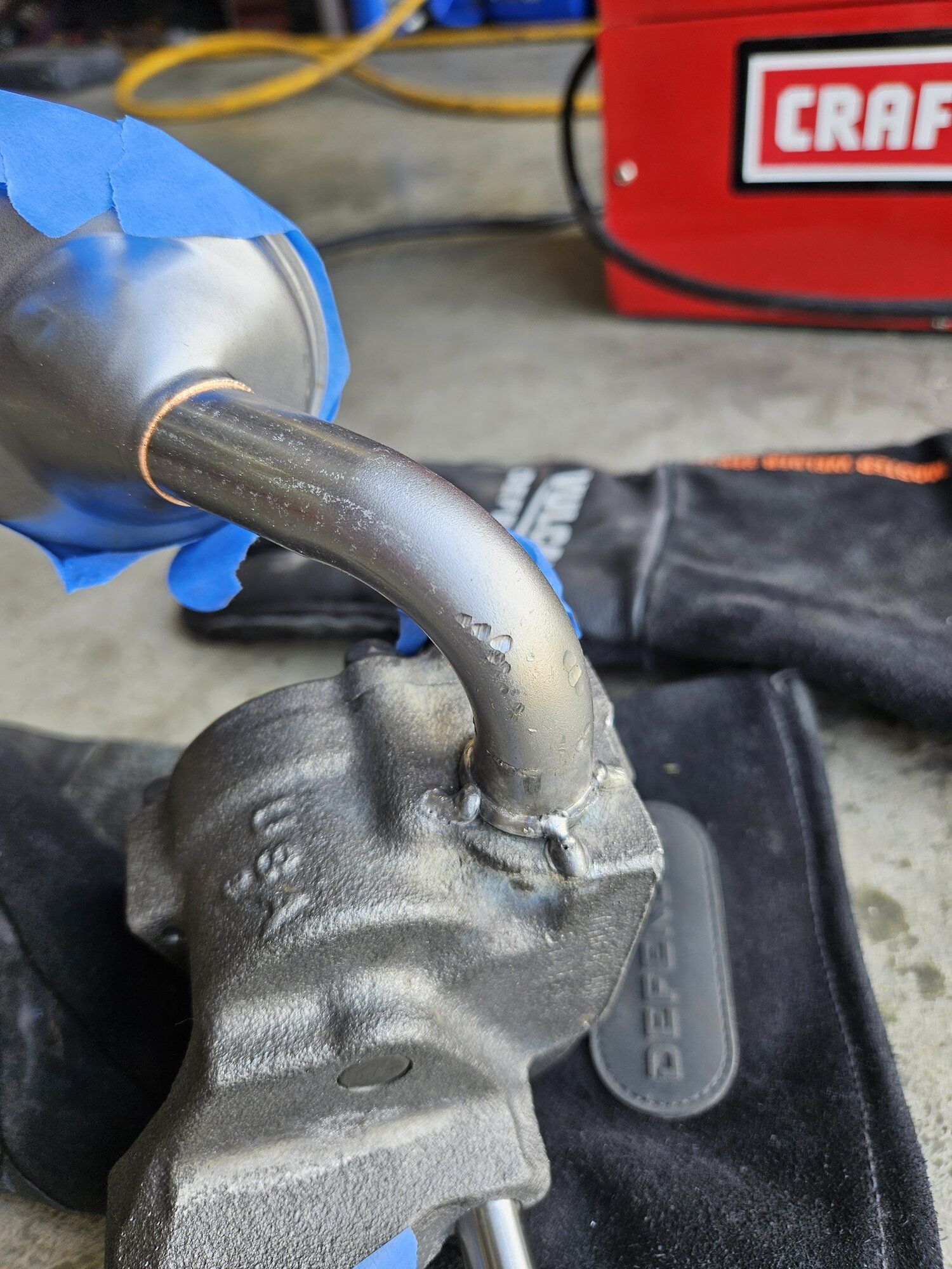

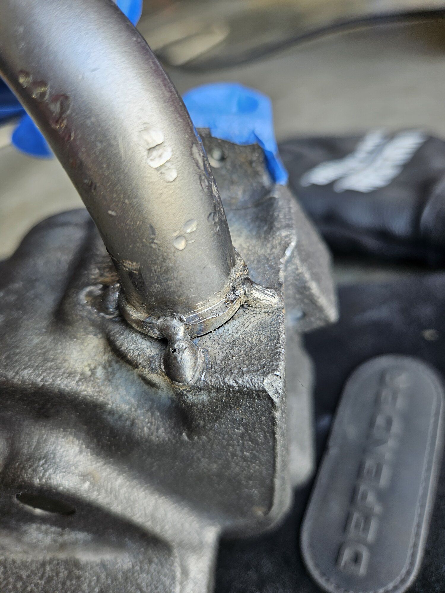

Pump installed with the pickup screen welded on. We aren't giving it a chance to fail. My son notice the oil pan baffle was loose on 2 spot welds so he re-tacked them when he did the oil pump pickup. We have a "fancy" one piece oil pan gasket this time also. I pulled #3 rod cap off and looked at the bearing and it is fine, thank god, so I am going with the thought that the rest are good too (of course, crossing fingers). 🤞 The entire bottom end looks clean and no loose rods to wiggle and it even started for a couple seconds as a test before we pulled the motor out, and it sounded fine except the rockers were a bit noisy from not pumping up.
The goal of it sitting back in the bay b4 he goes to work Monday is moving forward. We'll see how close we can get. It's too much fun to just sit and look at, since its last encounter was with a V8 S10 Truck, that ended close but a WIN! :thumb::cool:
