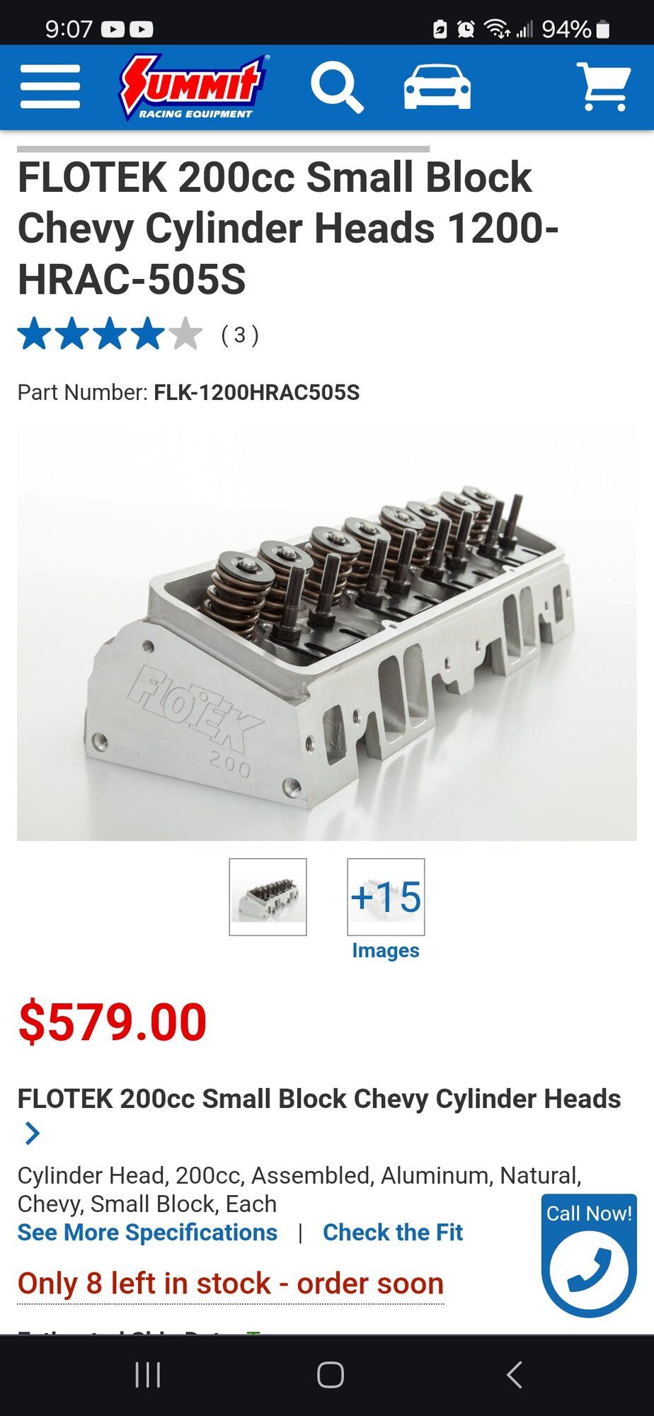

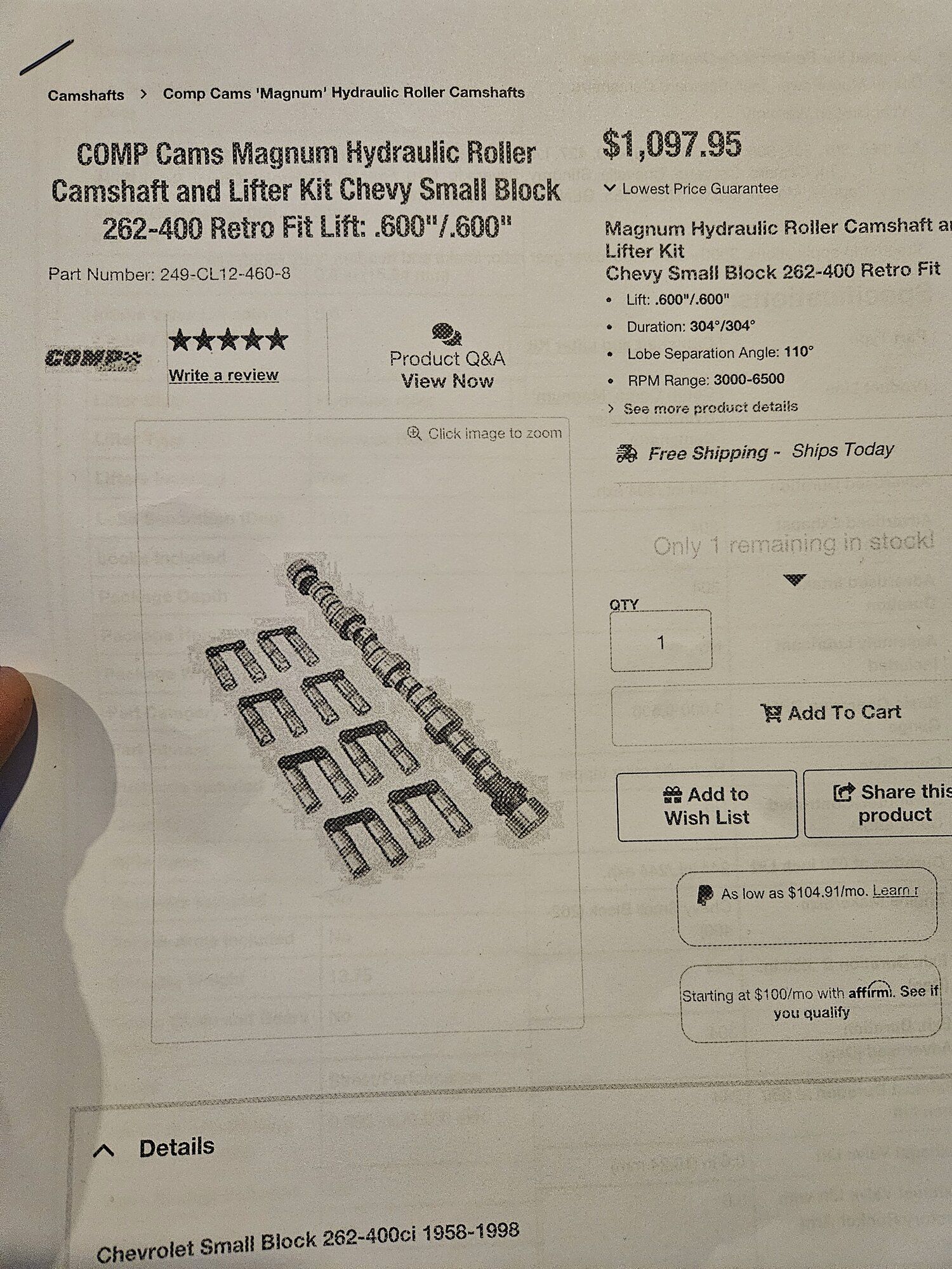

Well that didn't last long. The pump fixed it but now oil pressure plummets after 4000 rpm. I am taking it out and getting another ready. I suspect main bearings/thrust bearing excessive wear but am not sure why it drops after 4k. Roller cam this time I think. I acquired a 817 casting 400 SBC and crank that seem to be in remarkable condition. Parts are already on the way or here. I need a set of heads and a roller cam so that is a chunk of change I'll be working on.

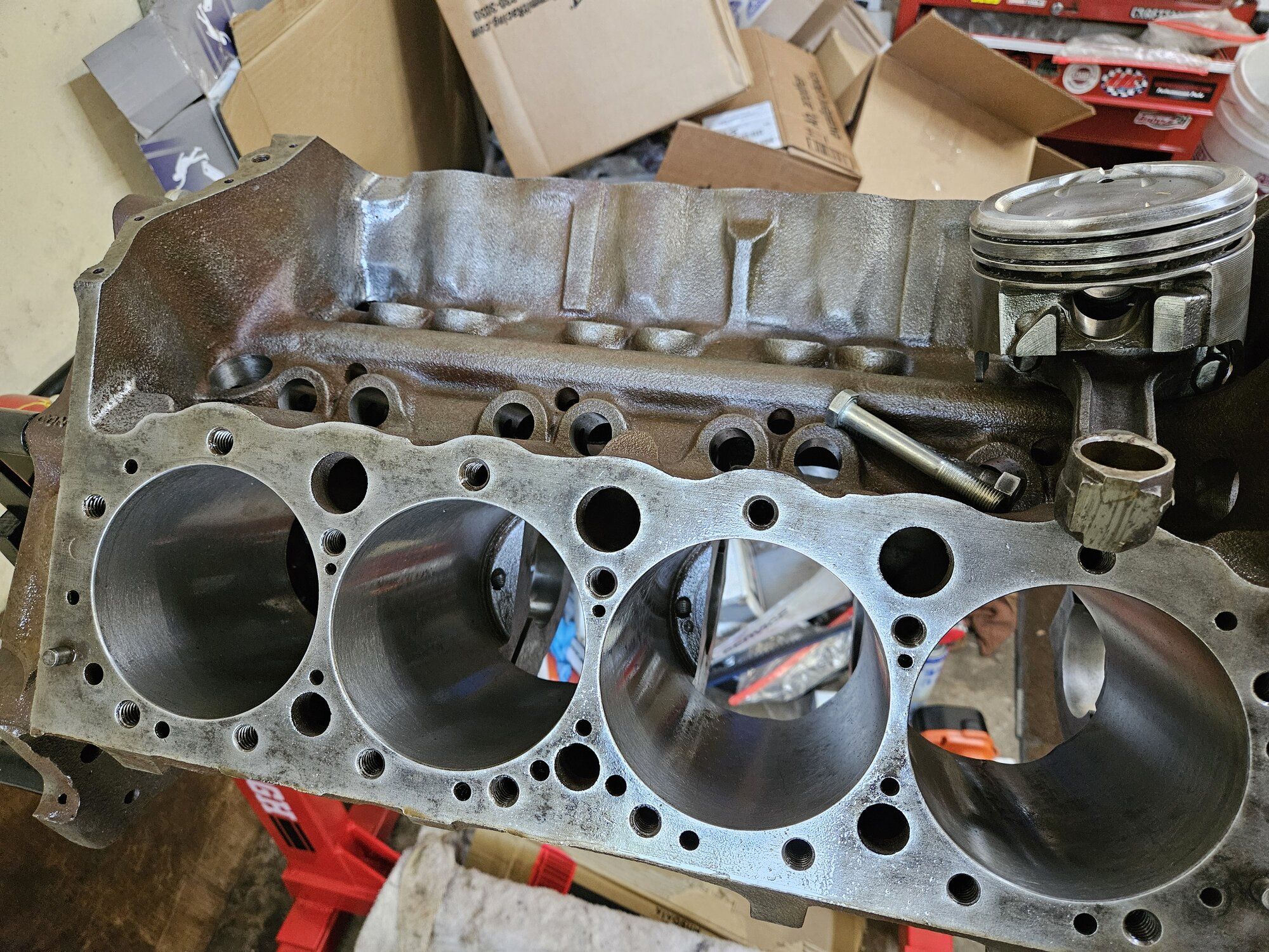

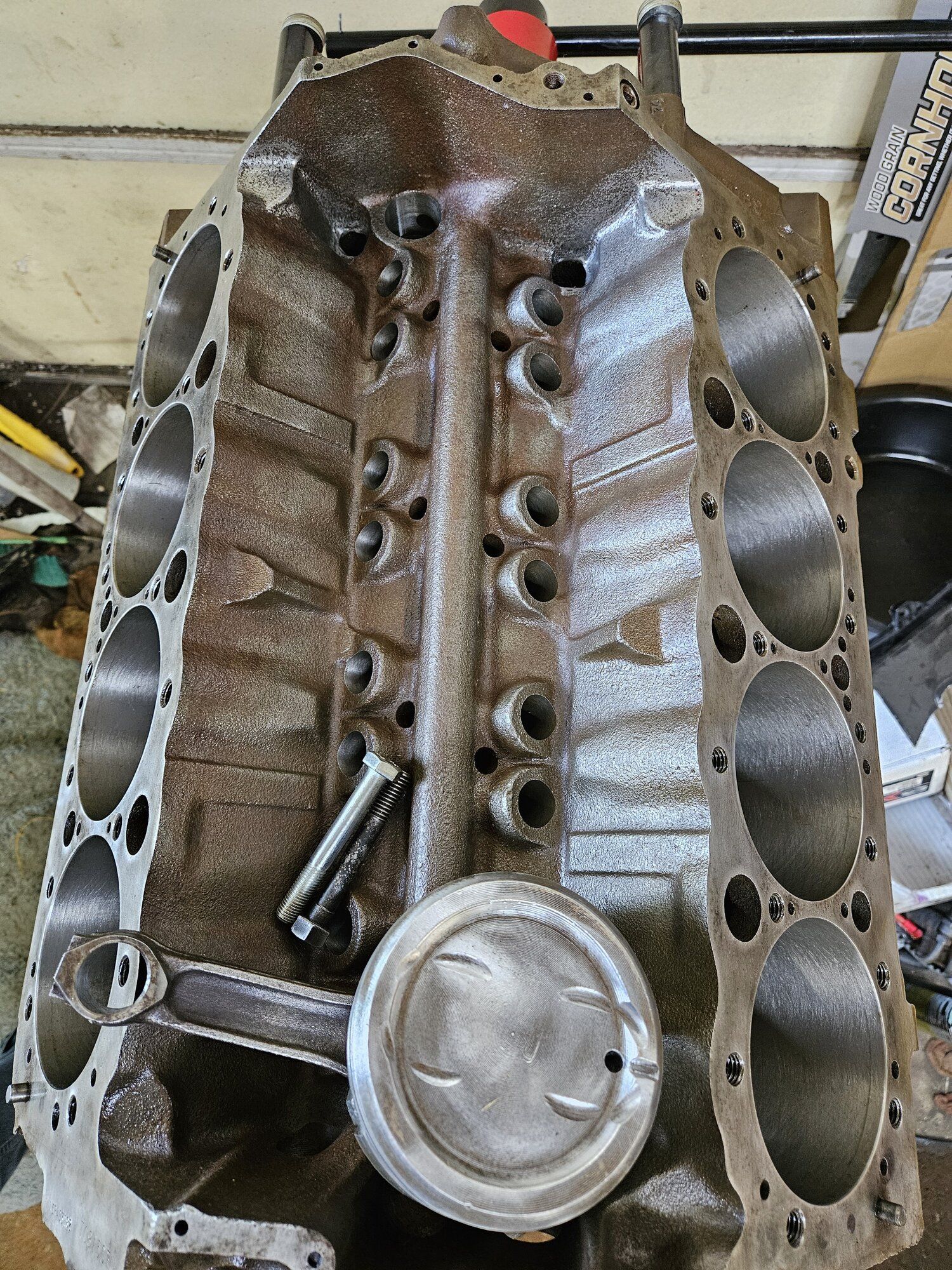

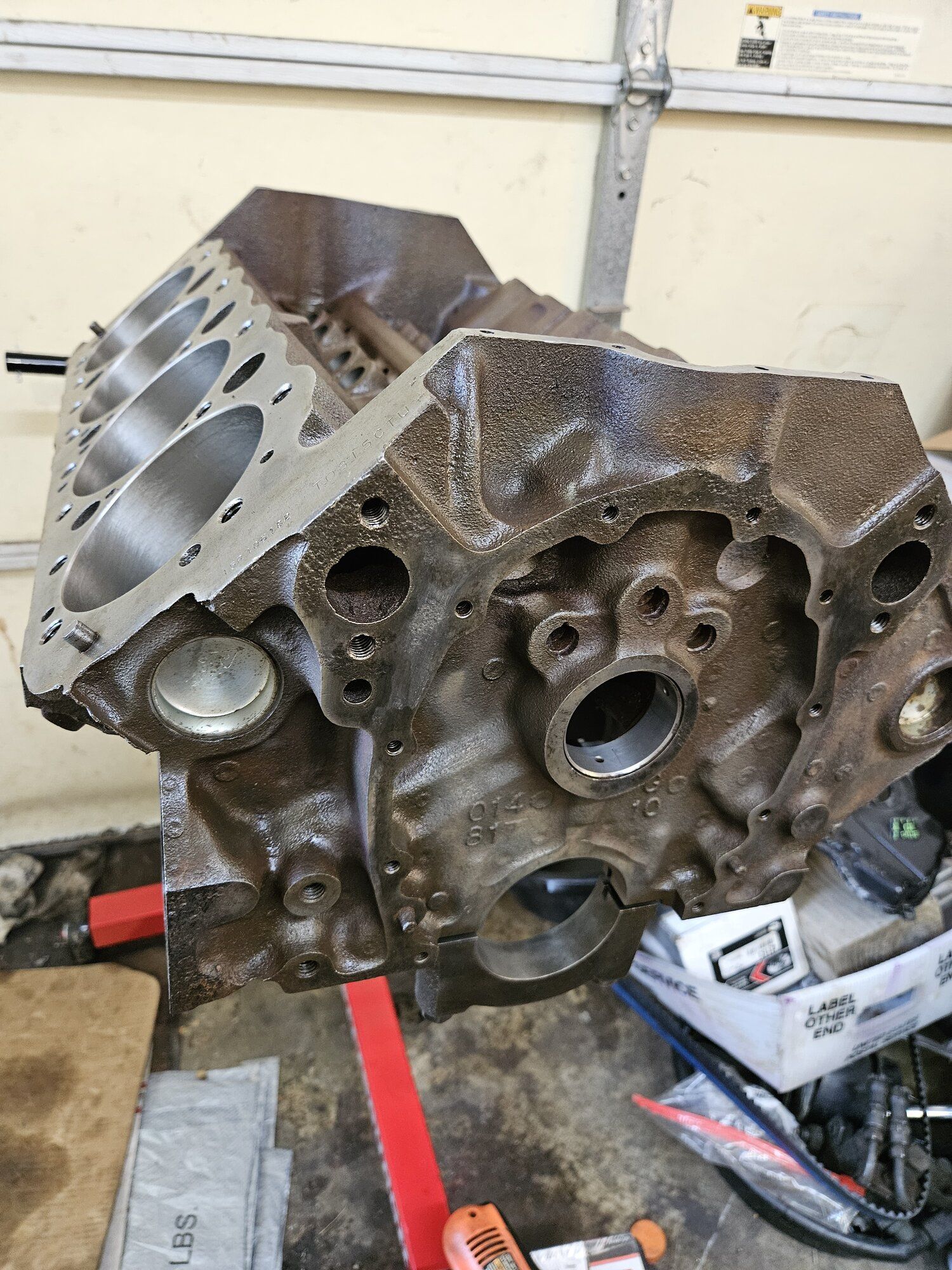

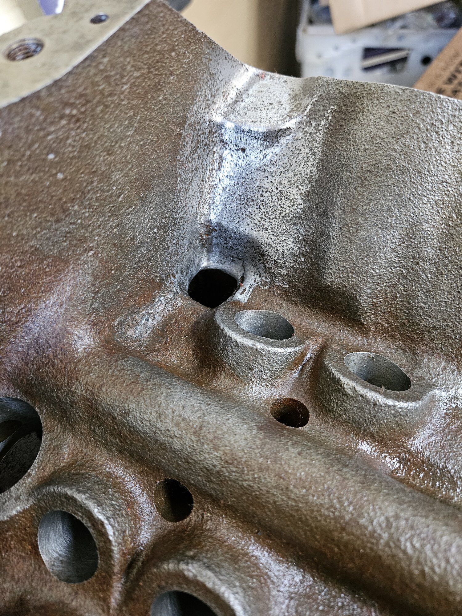

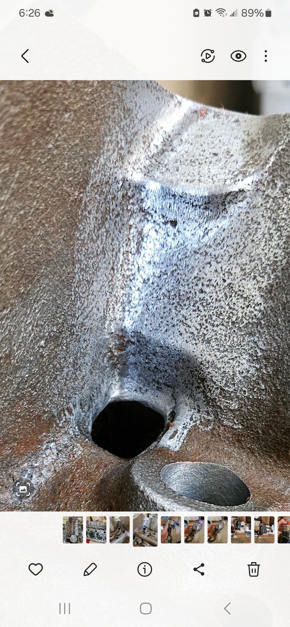

Here is what the new block looked like when I got it. Quite a difference...and lot of elbow grease.

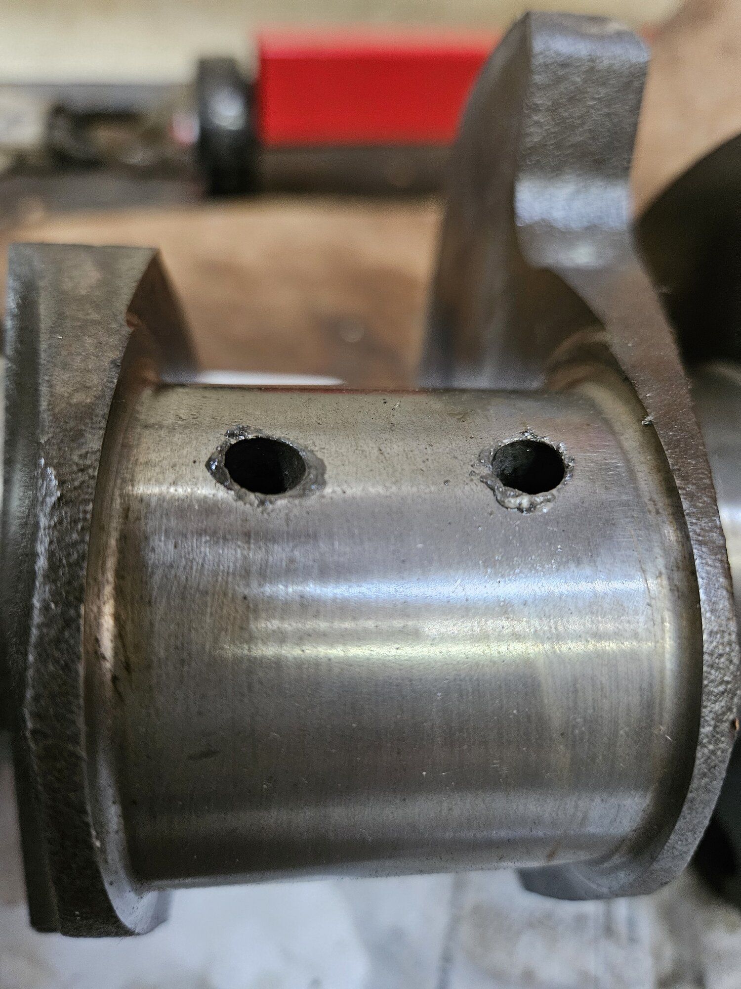

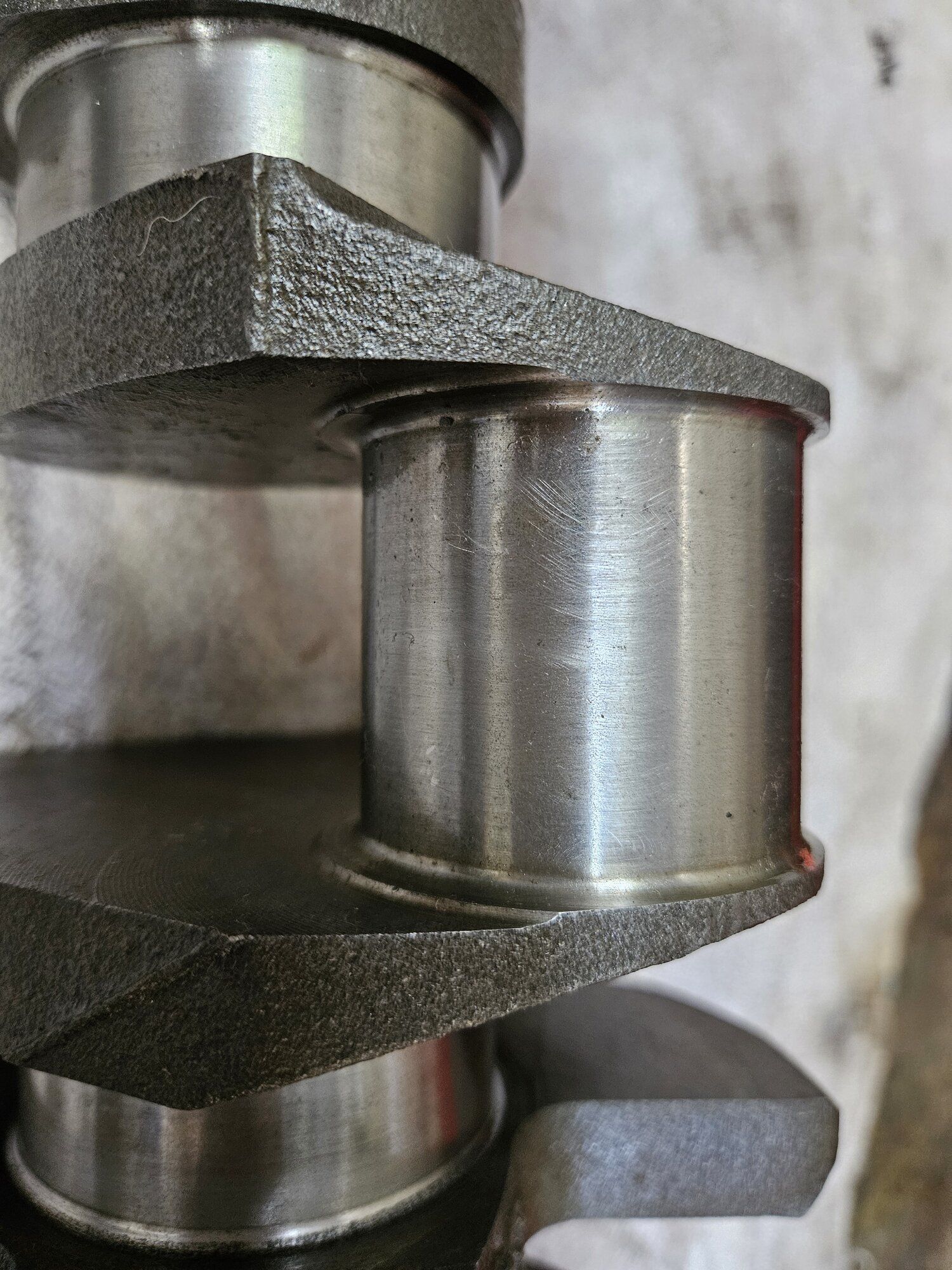

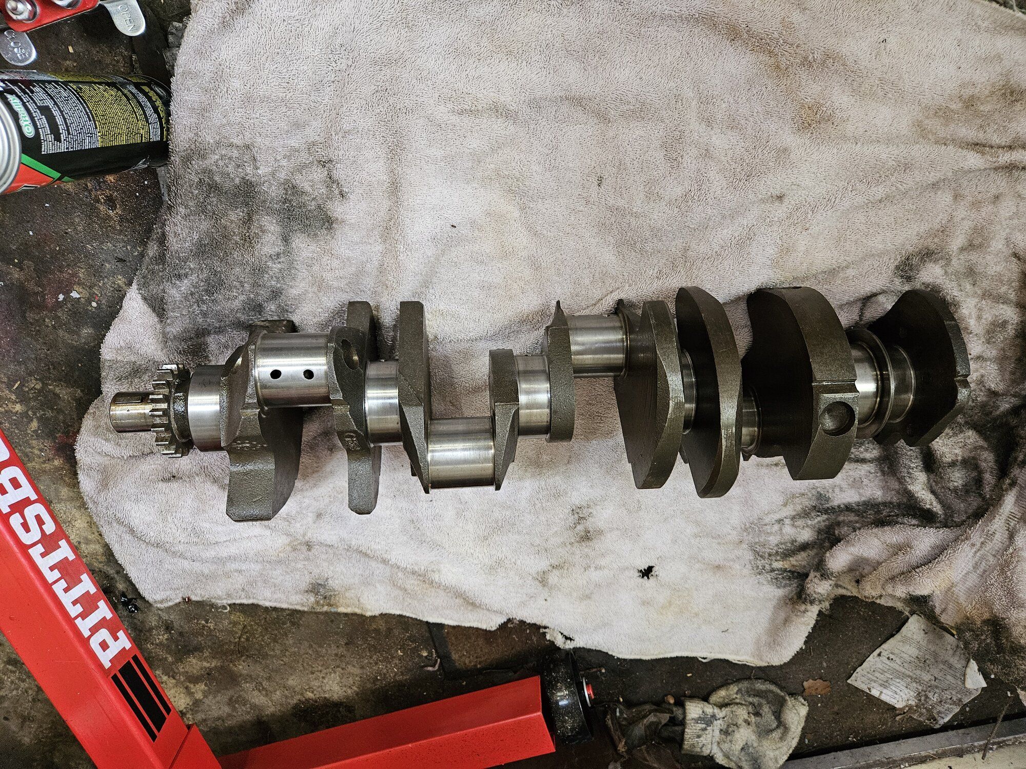

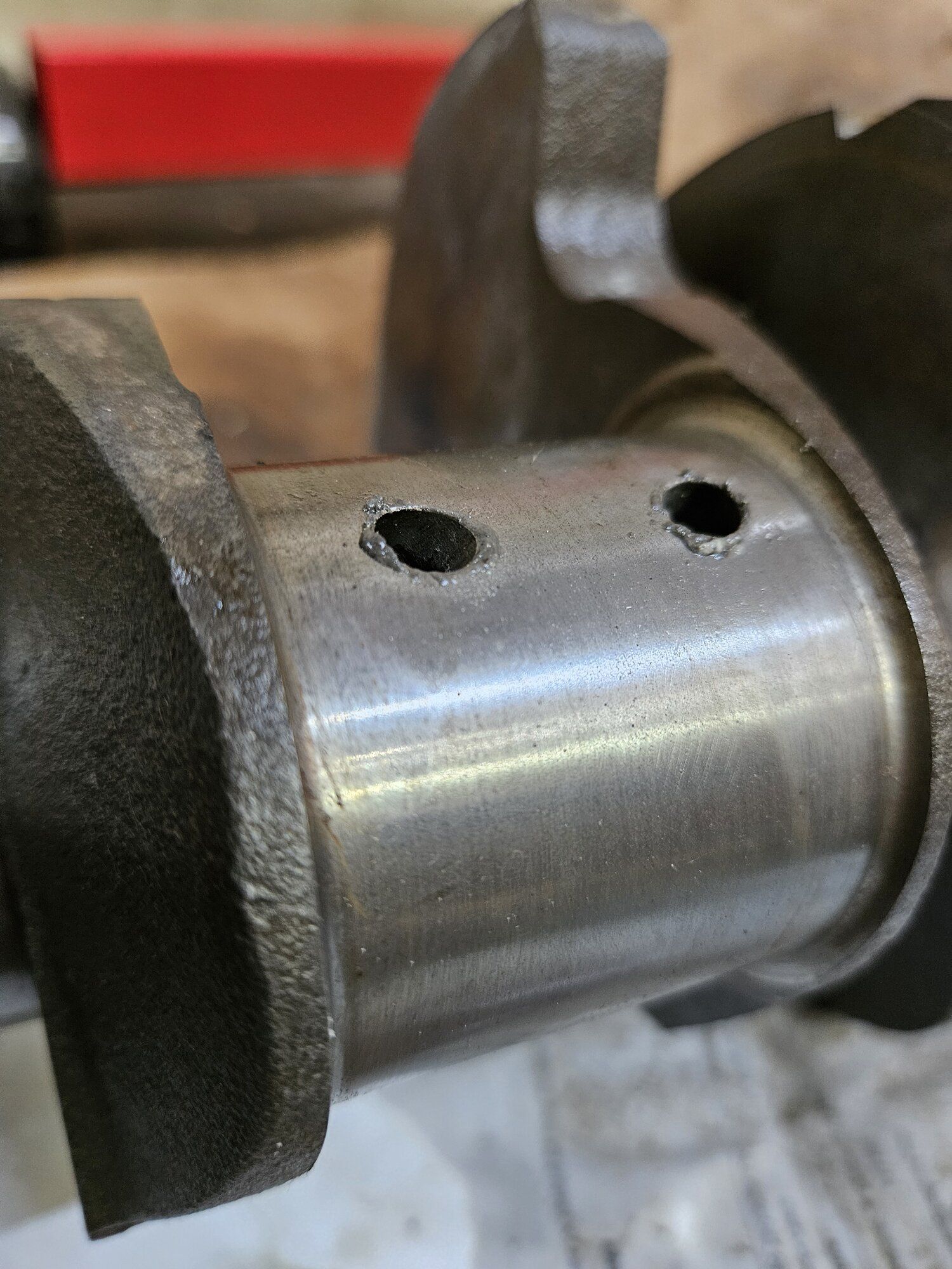

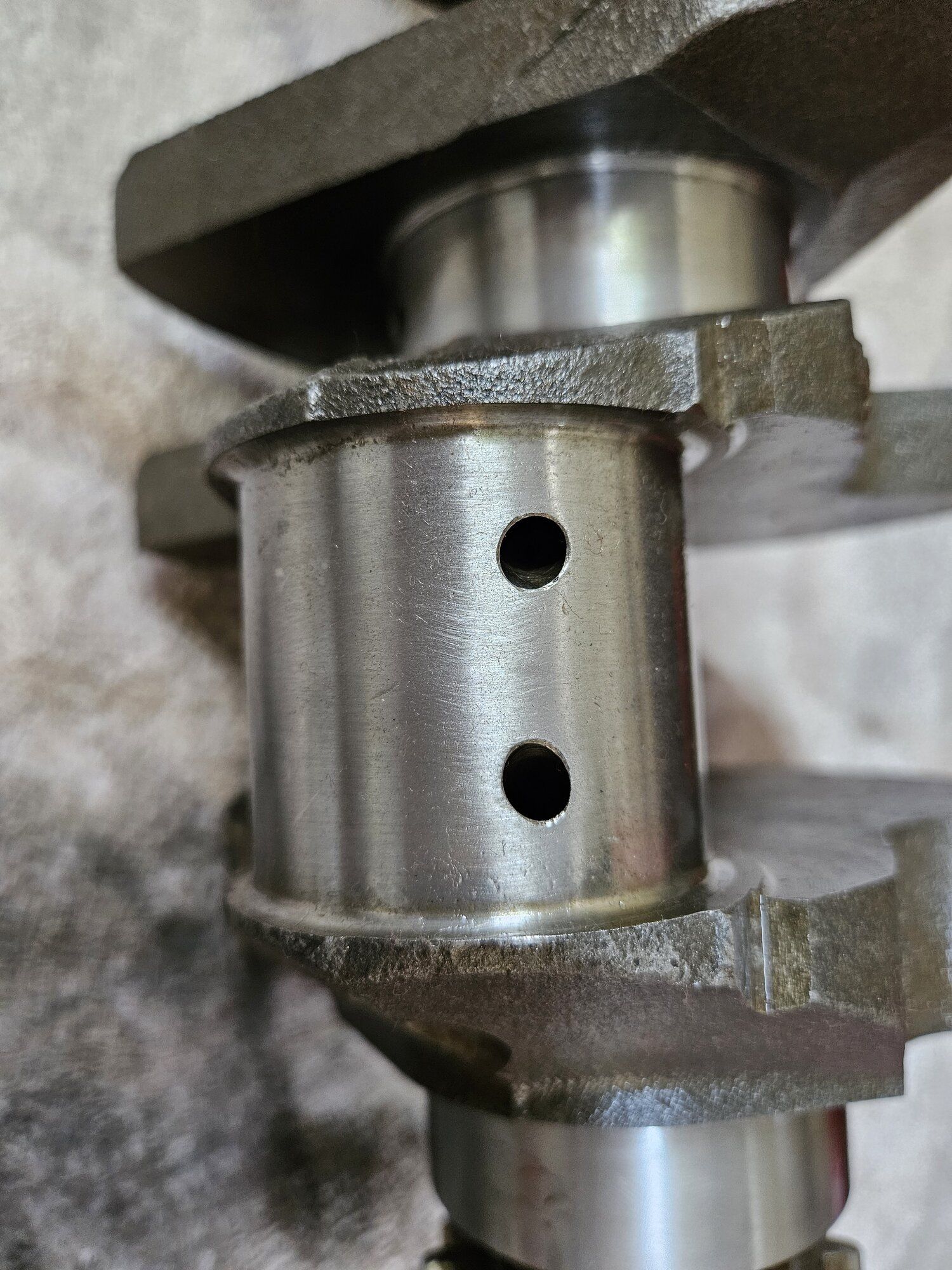

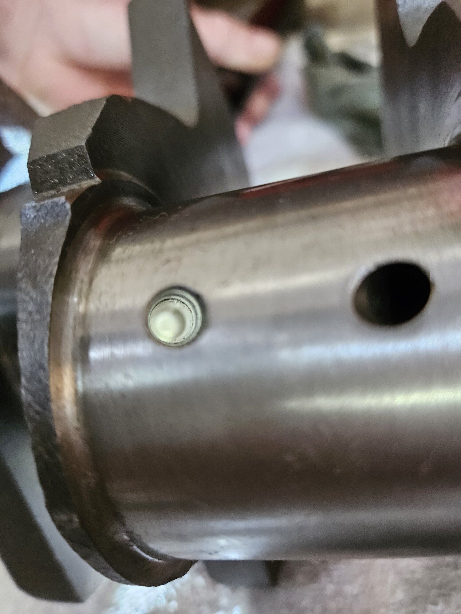

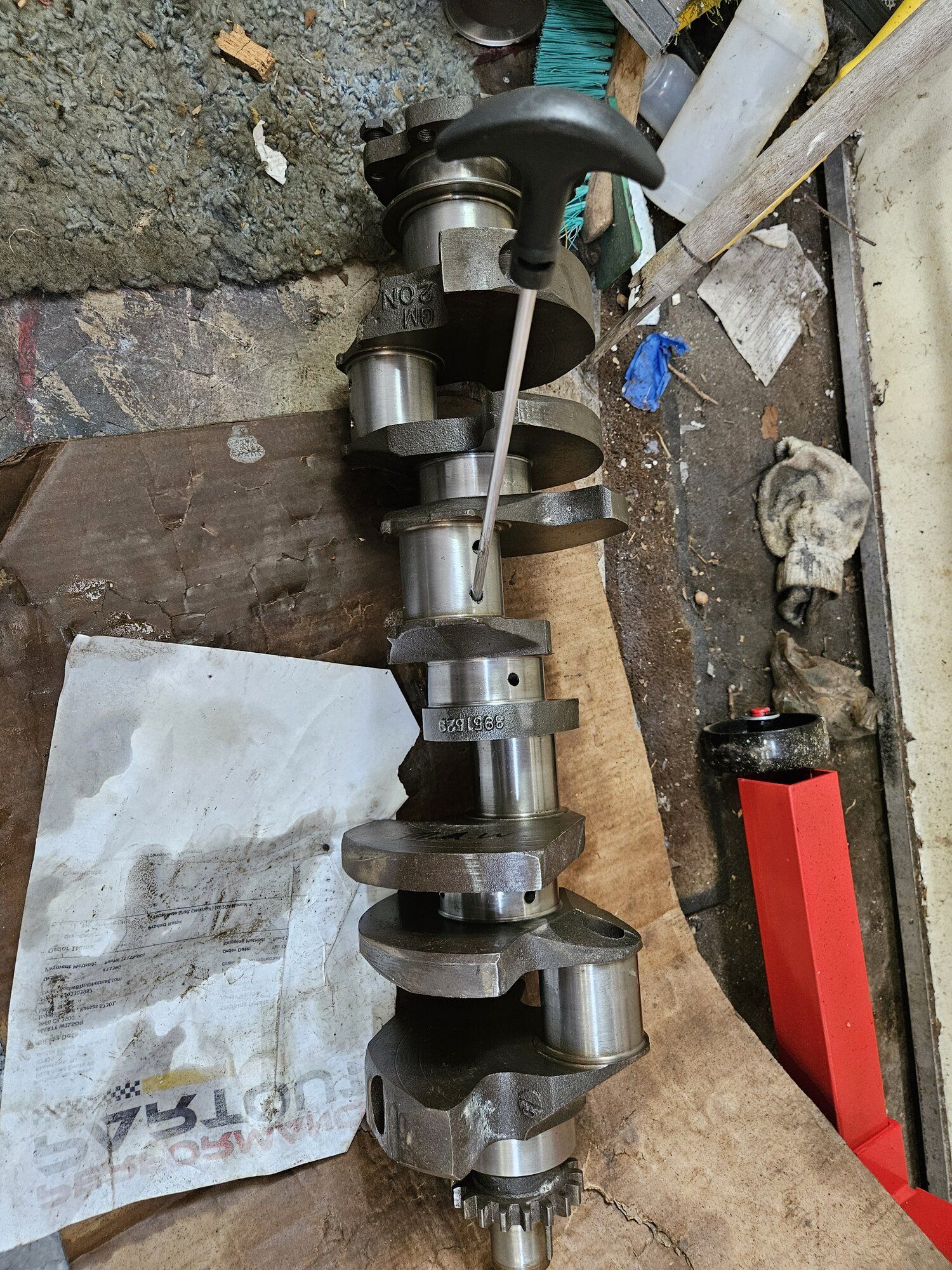

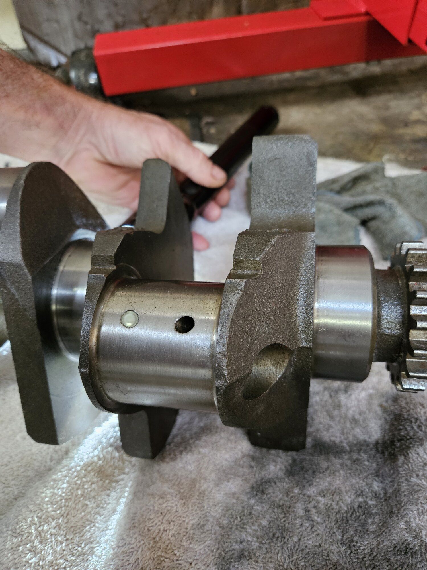

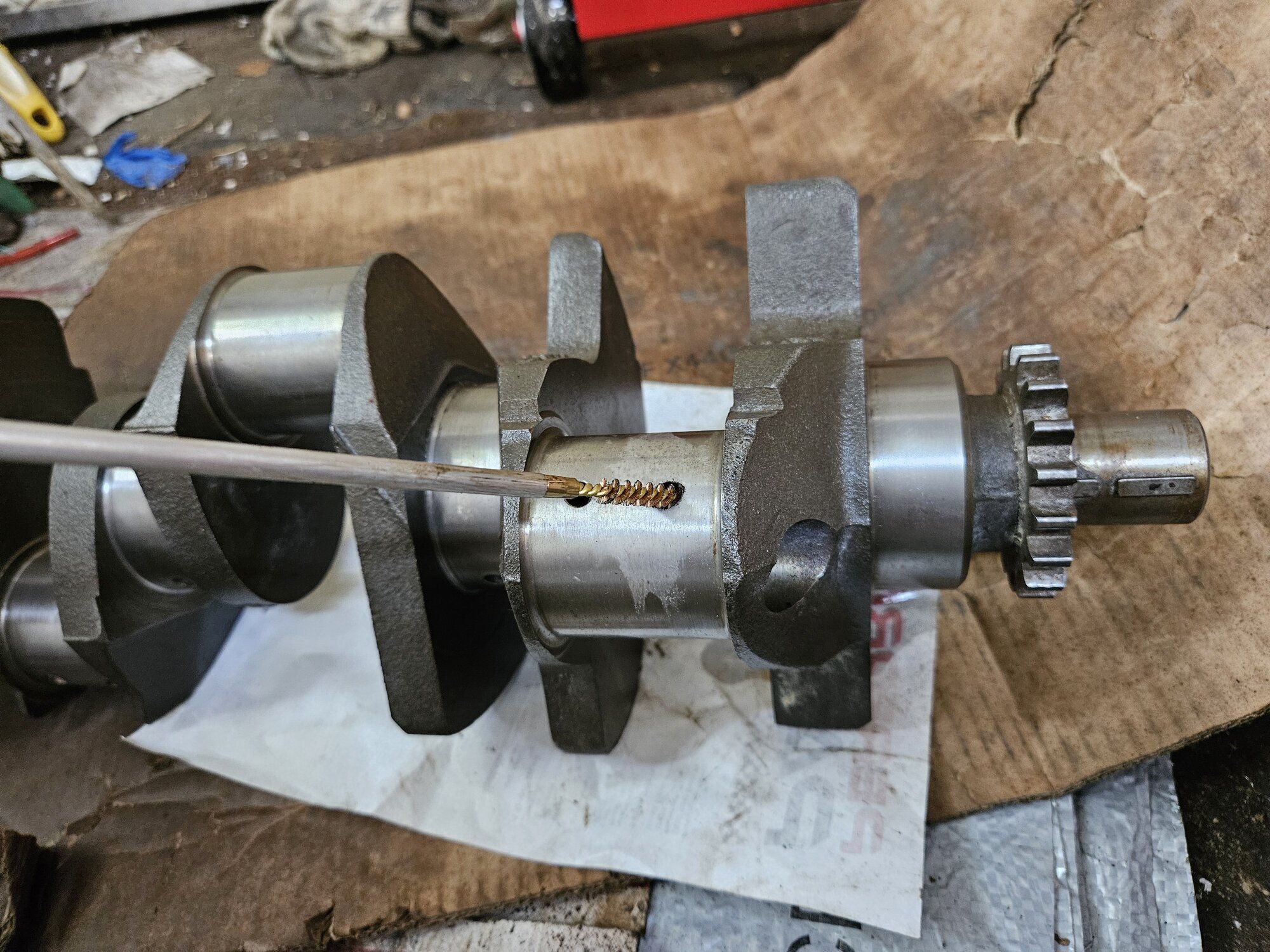

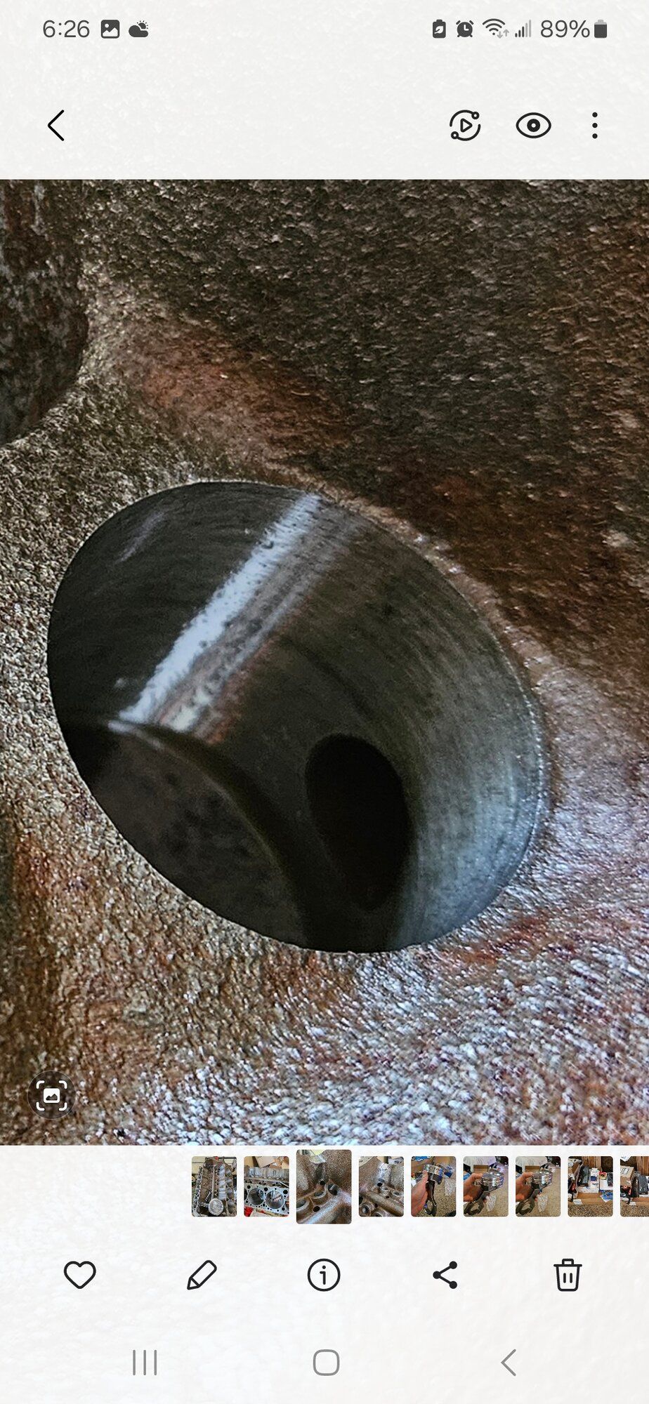

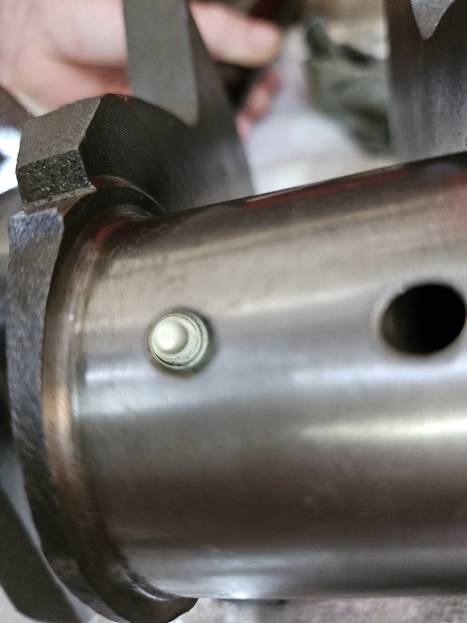

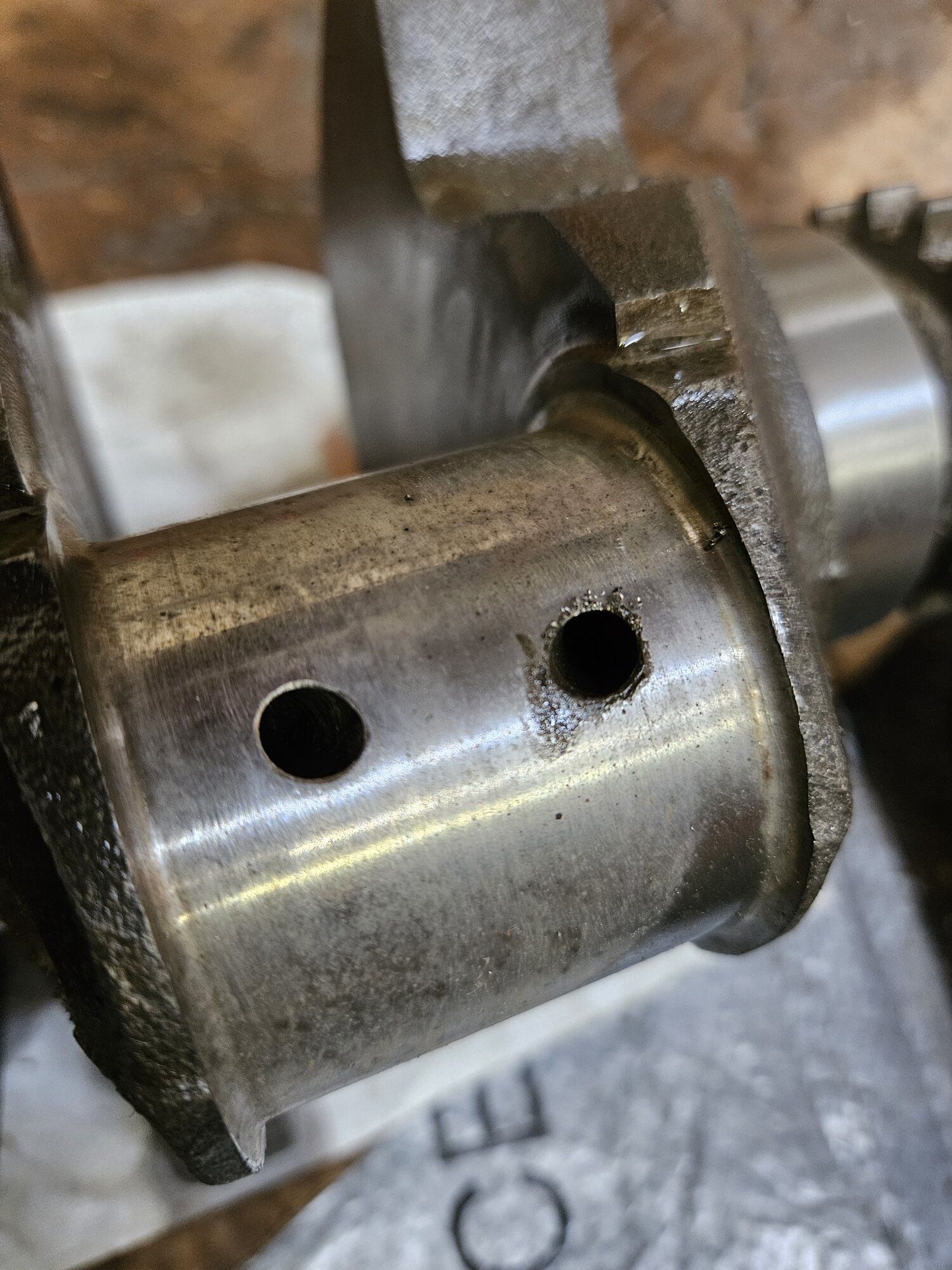

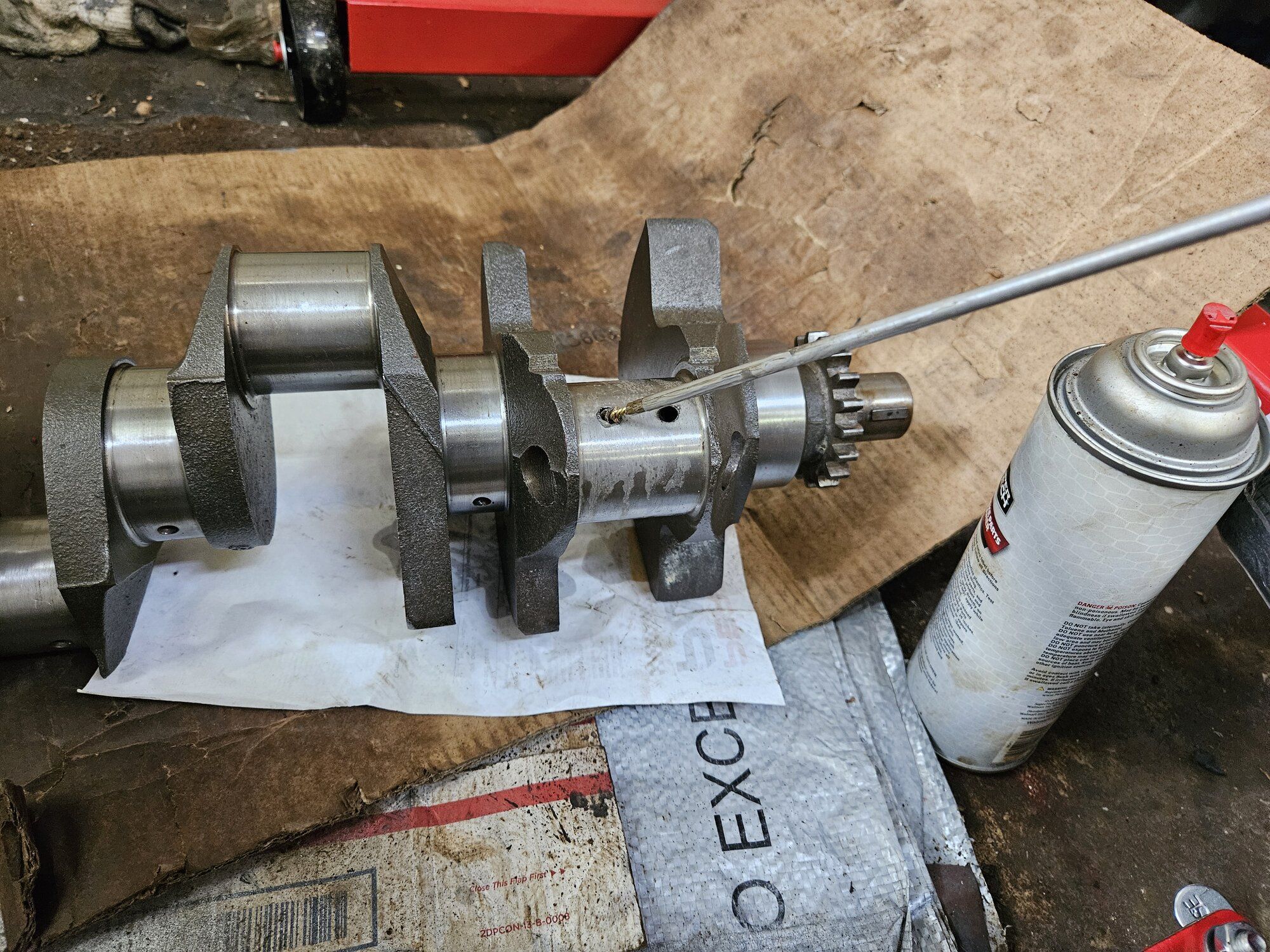

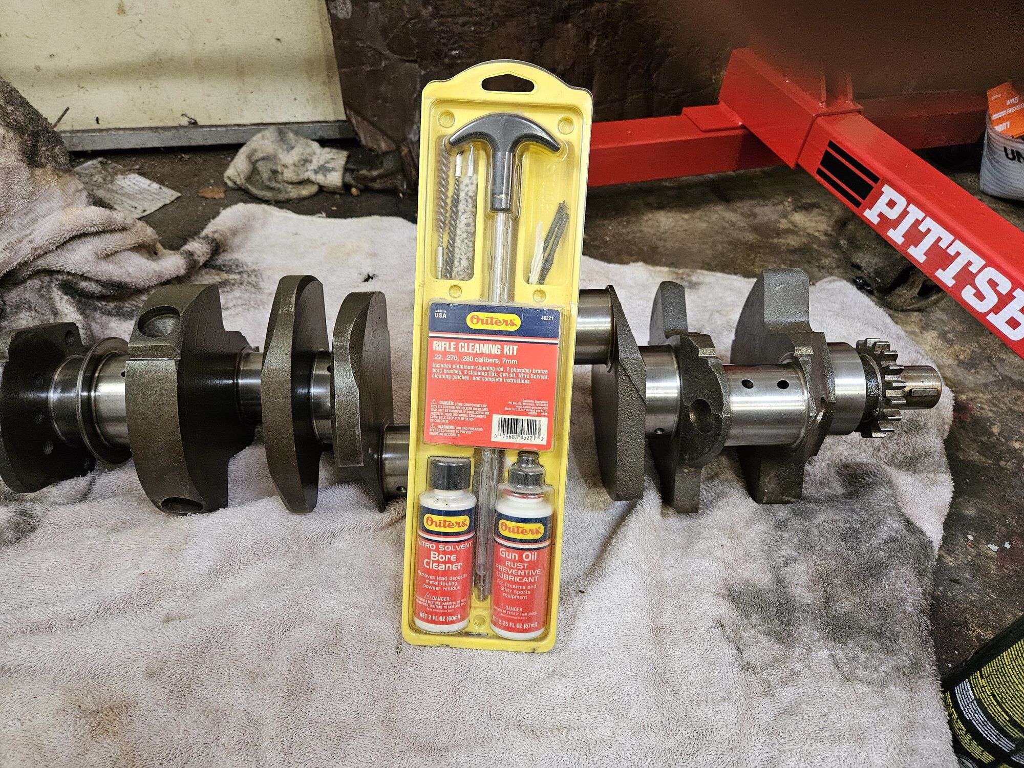

In any case, I cleaned out the oiling holes of the 400 crank today and got some crud out. Some folks would have looked at it and possibly installed it without a good cleaning with BPC and a .22 caliber gun cleaning kit.

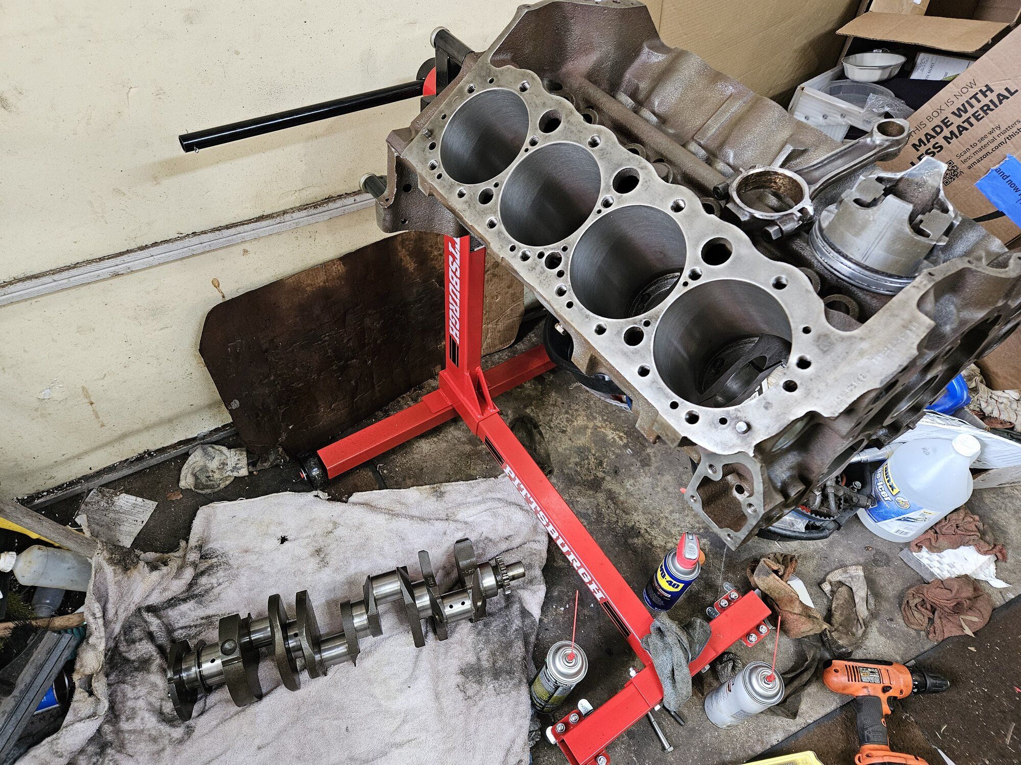

Rinse and repeat, as always, until you know they are clean. A good visual is always good if you can see completely thru the oiling holes, and on a SBC, you can. One more cleaning before install of the bearings after a good hot soap and water bath of the BLOCK at the local car wash then a WD40 SOAKING.
I will clean the crank oiling holes with WD also.

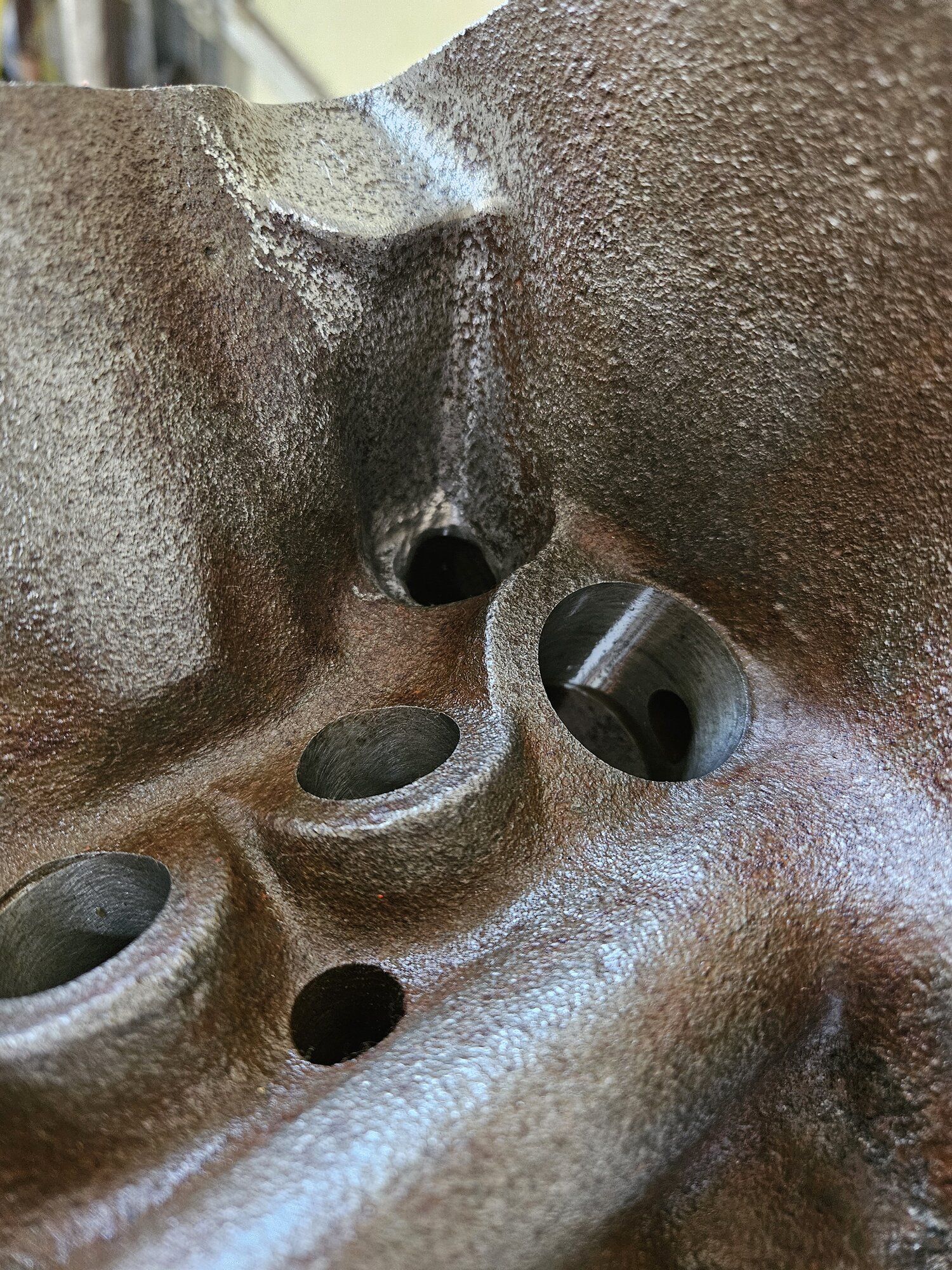

I have a couple "tricks" i need to do on the block too, for faster oil return before the wash.

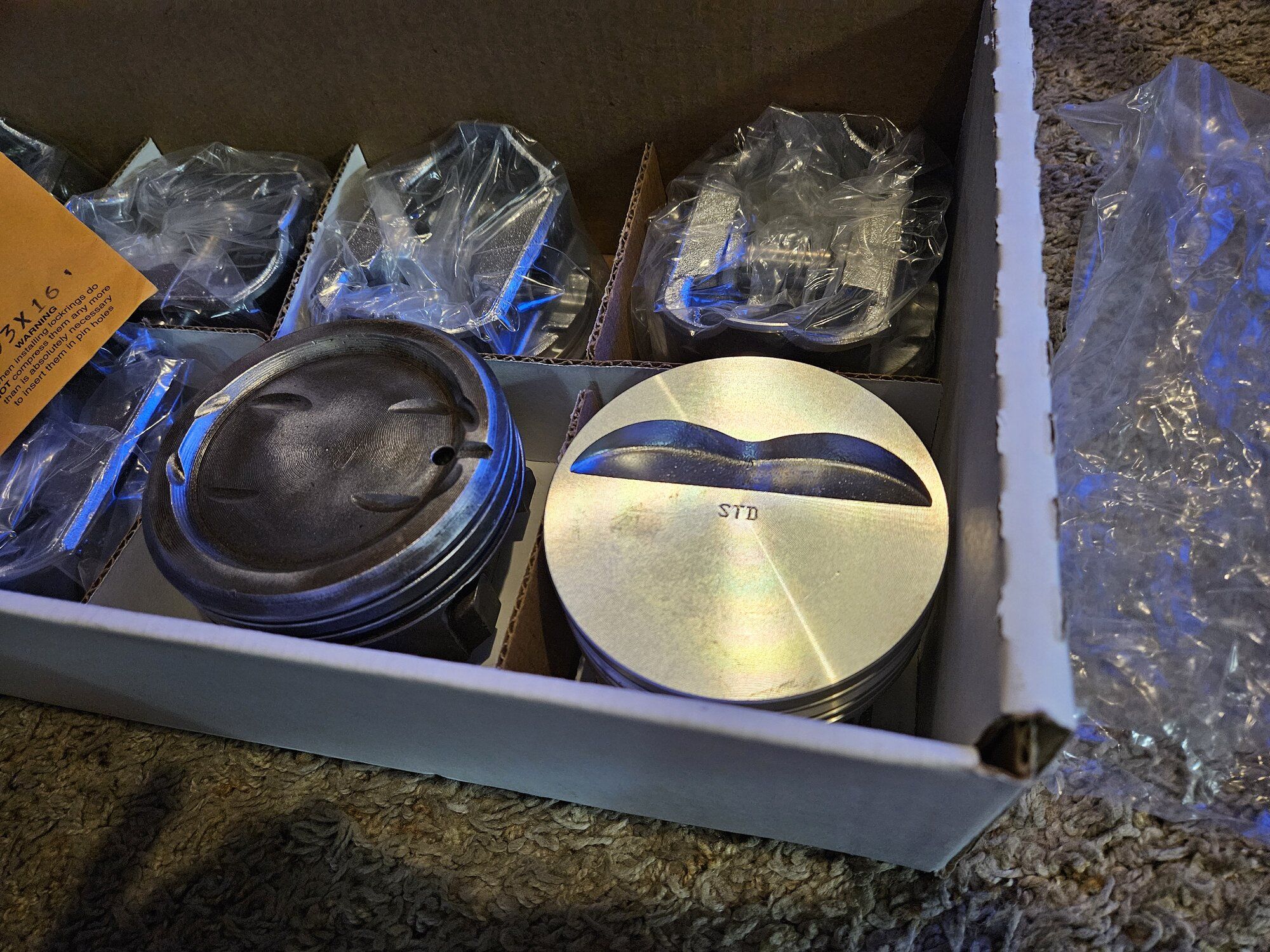

Bearings, rings and pistons should be in tomorrow or Tuesday, I think.

I also retapped every dam threaded hole in this block too, so she should be in pretty dam good shape after her "bath"!!! :thumb:

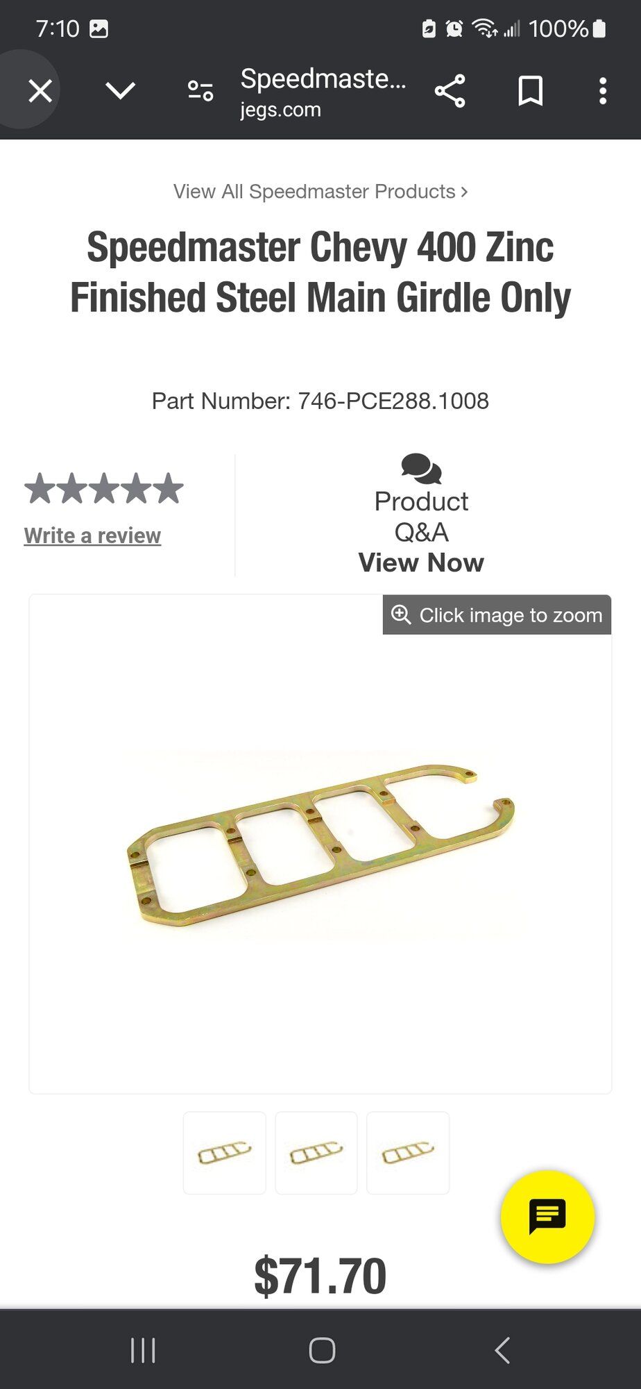

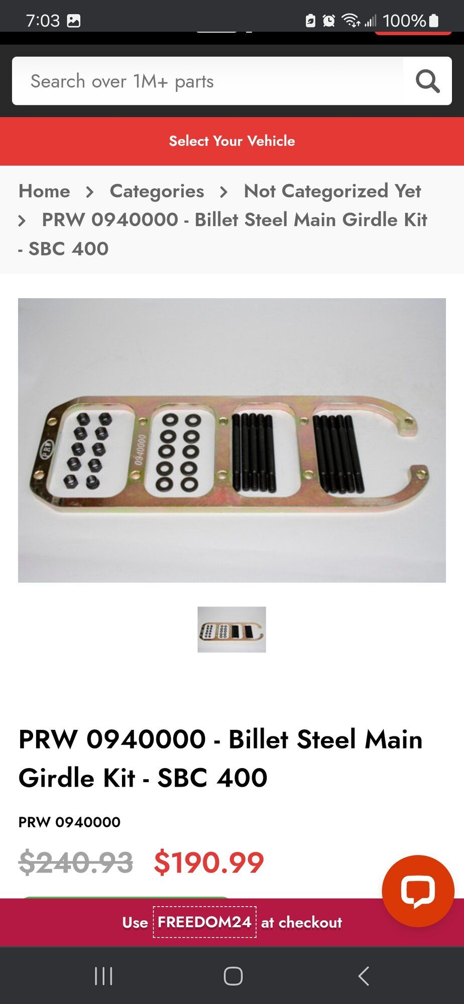

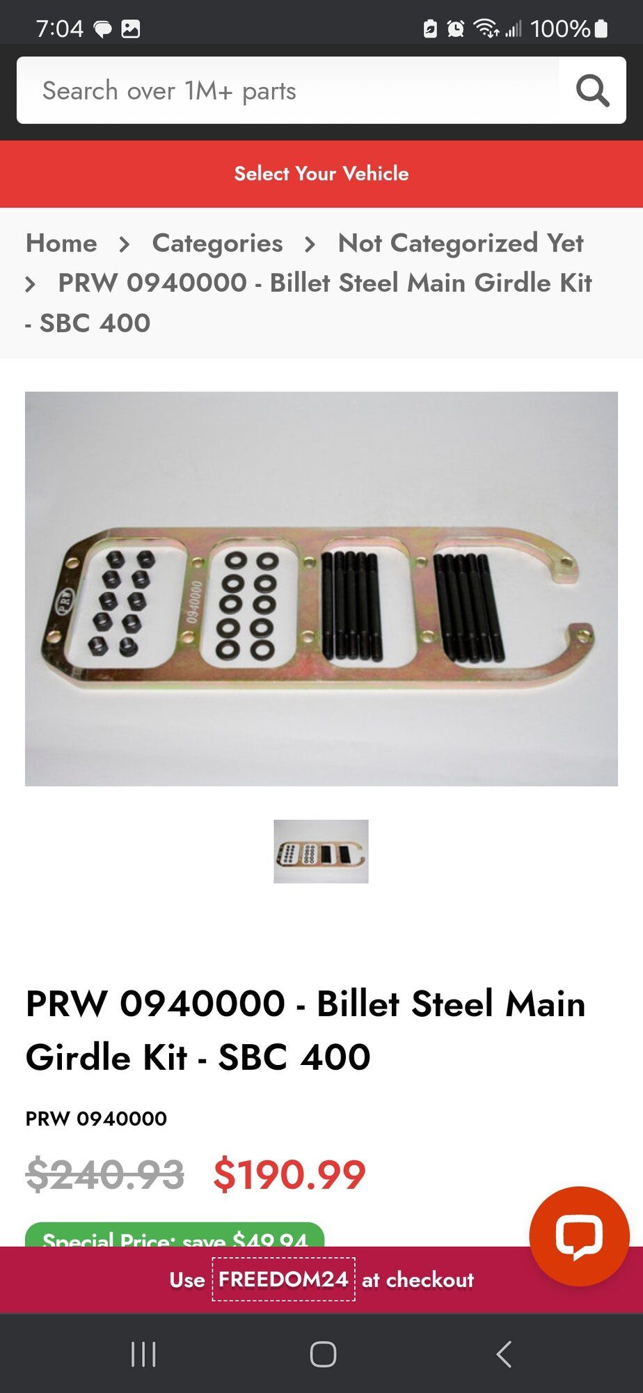

While NOTHING got done today after work, more SBC parts came in and I found a Main Girdle for the 400 also, hmmmm. :hmm: :cool:

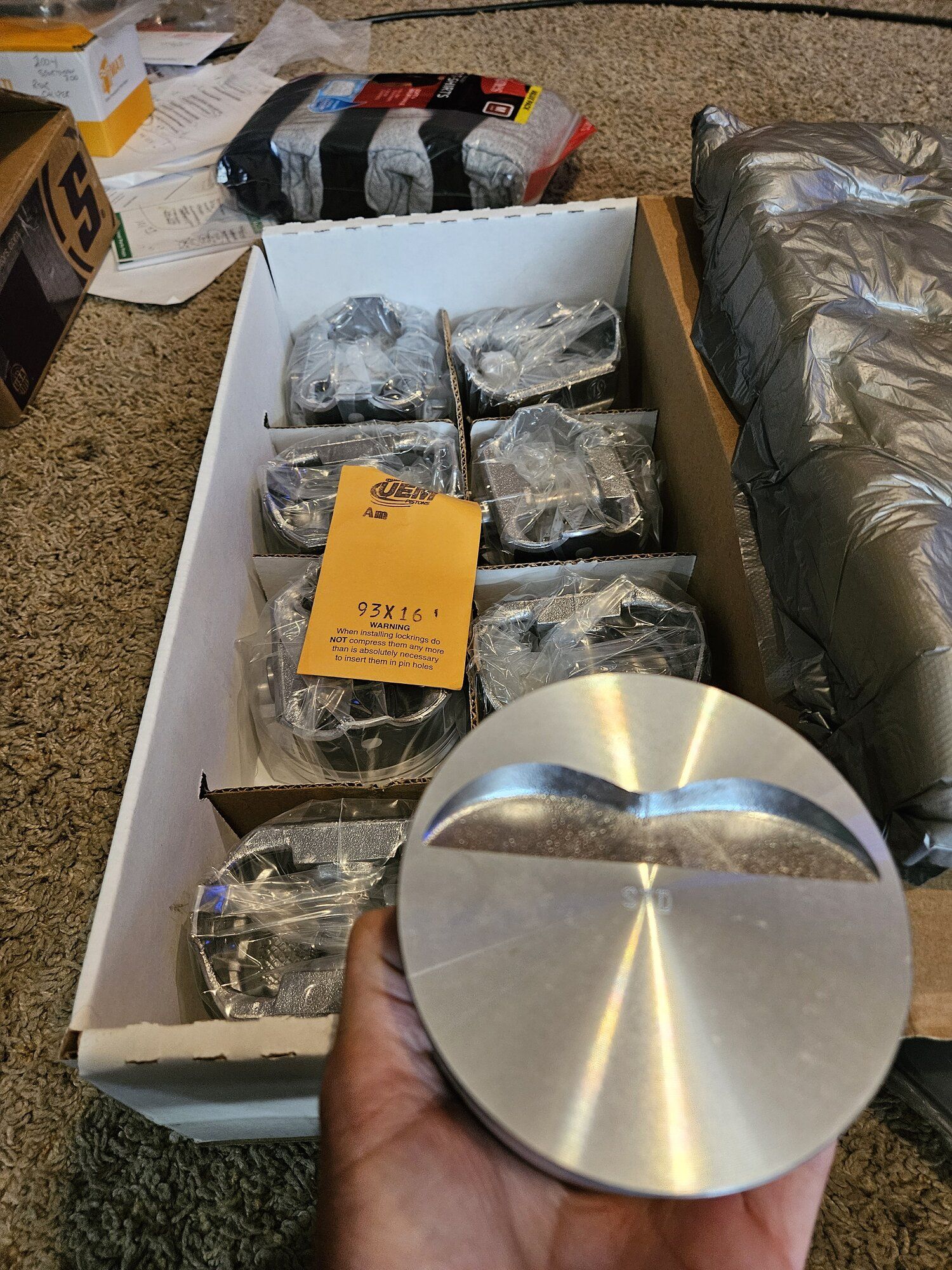

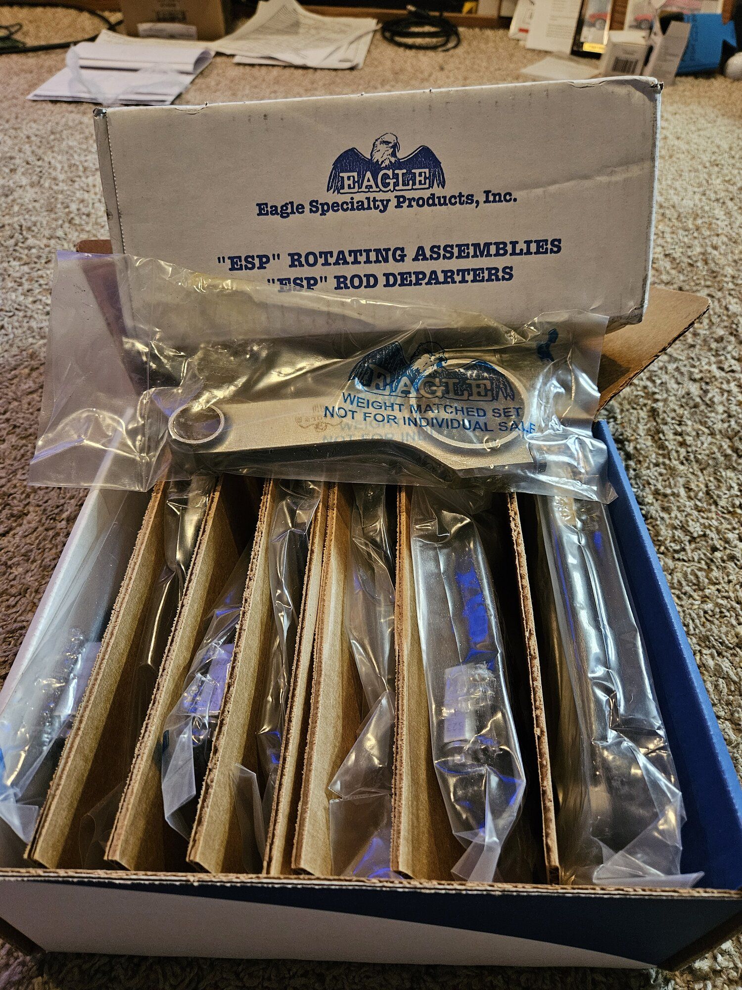

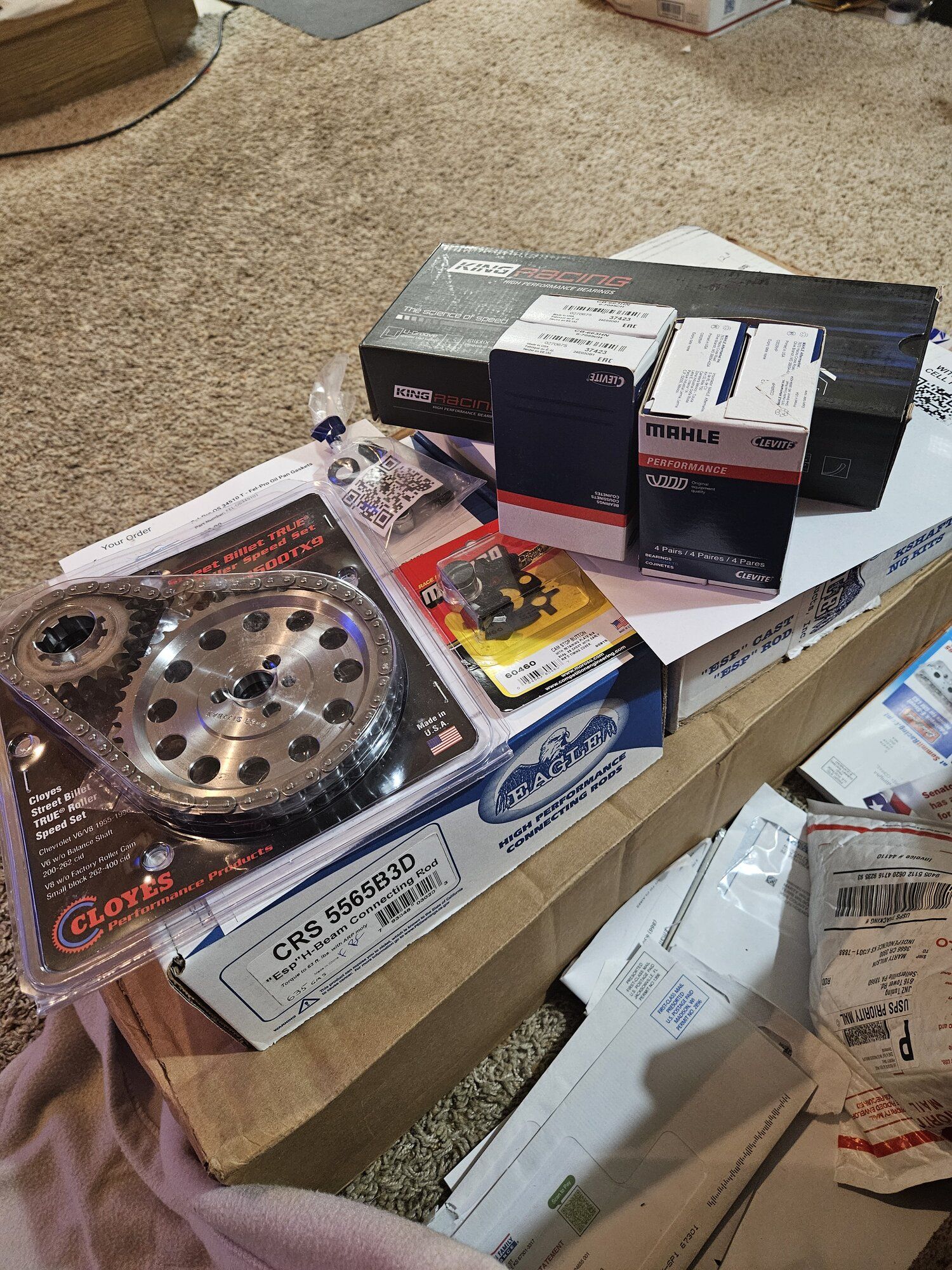

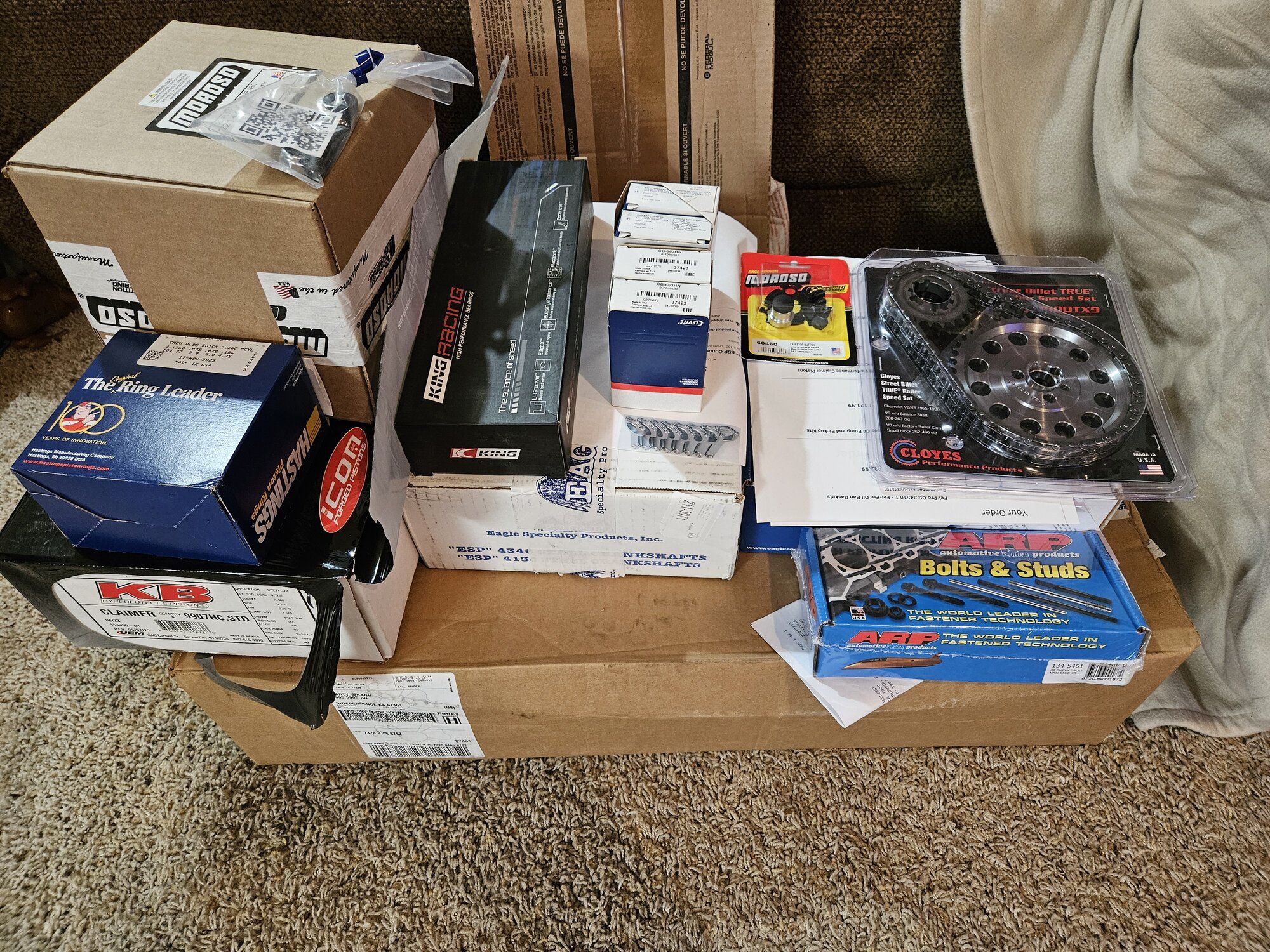

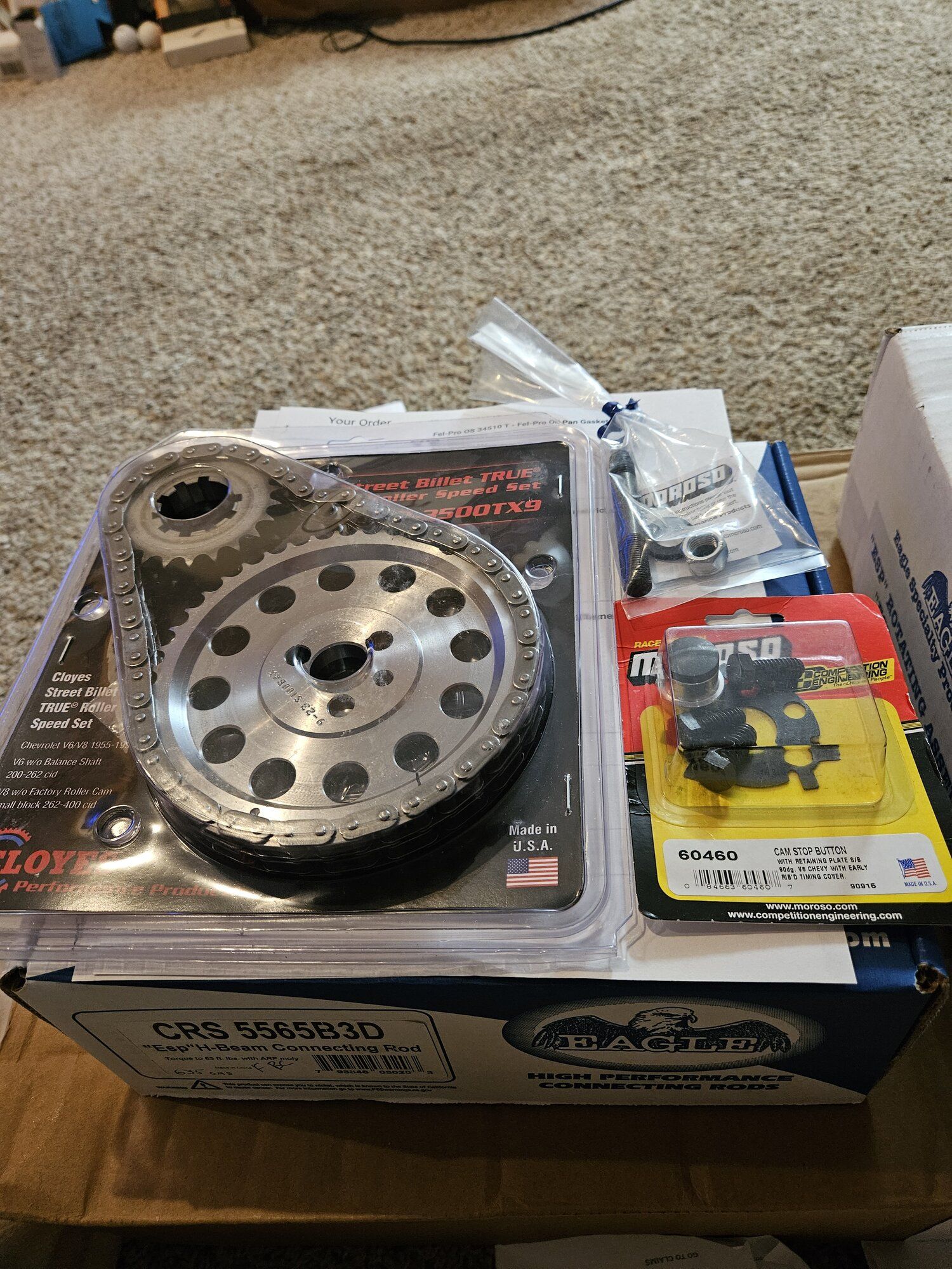

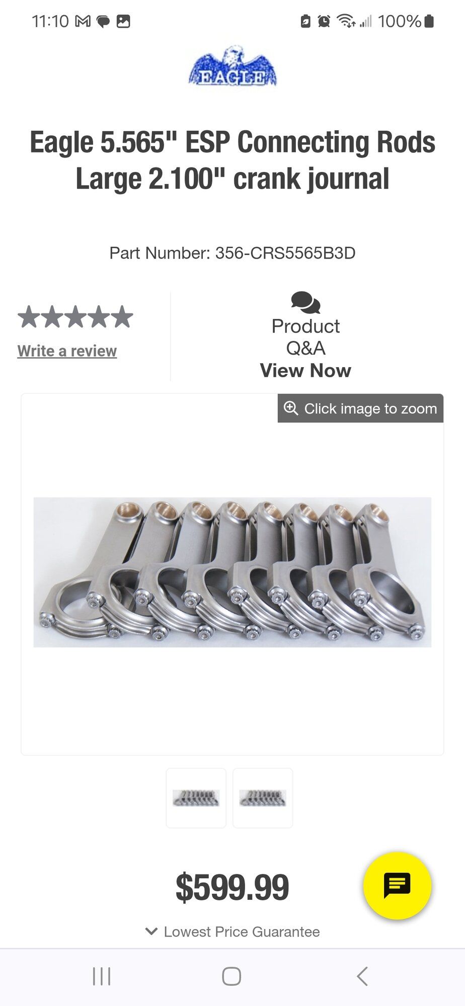

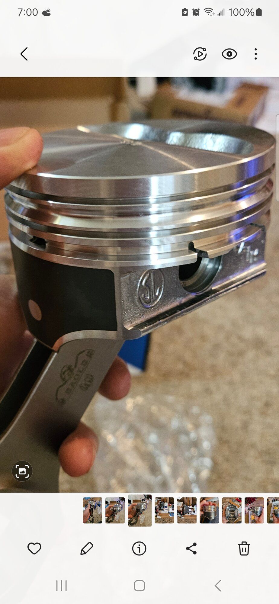

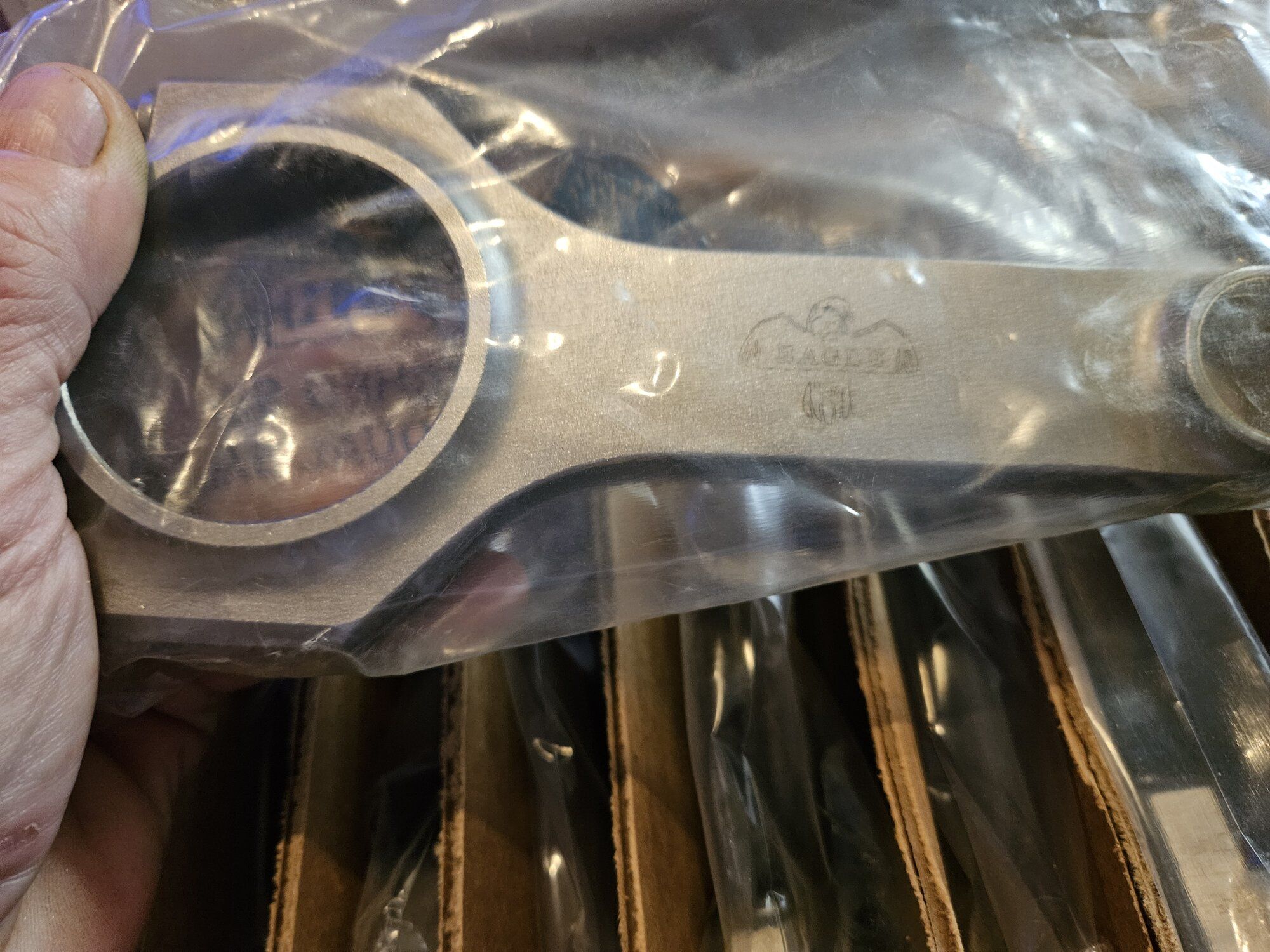

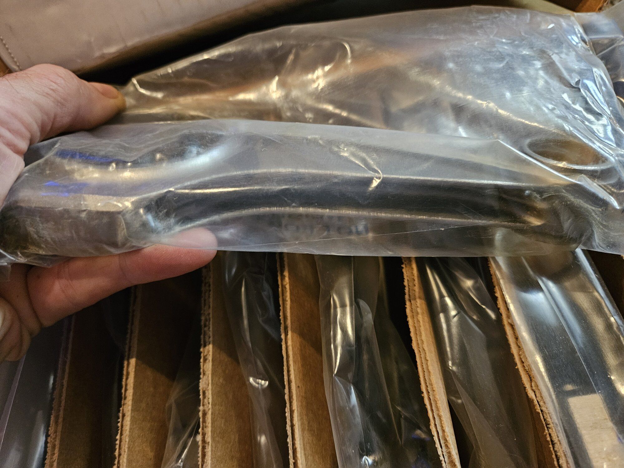

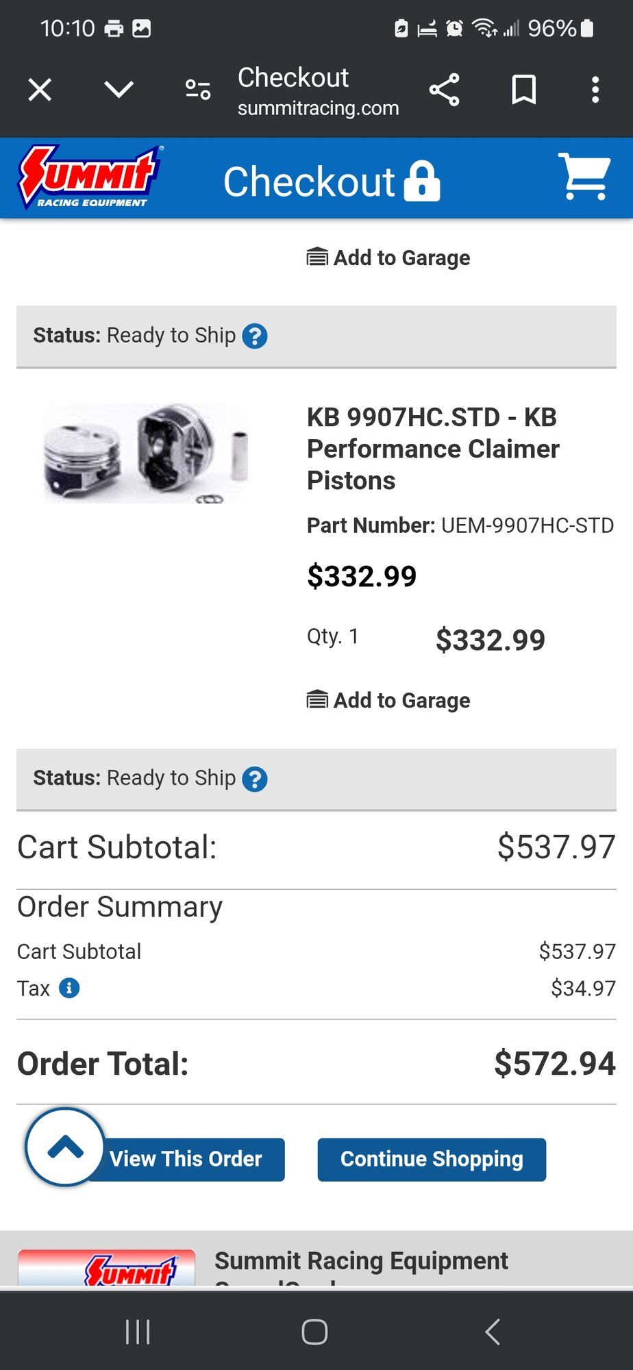

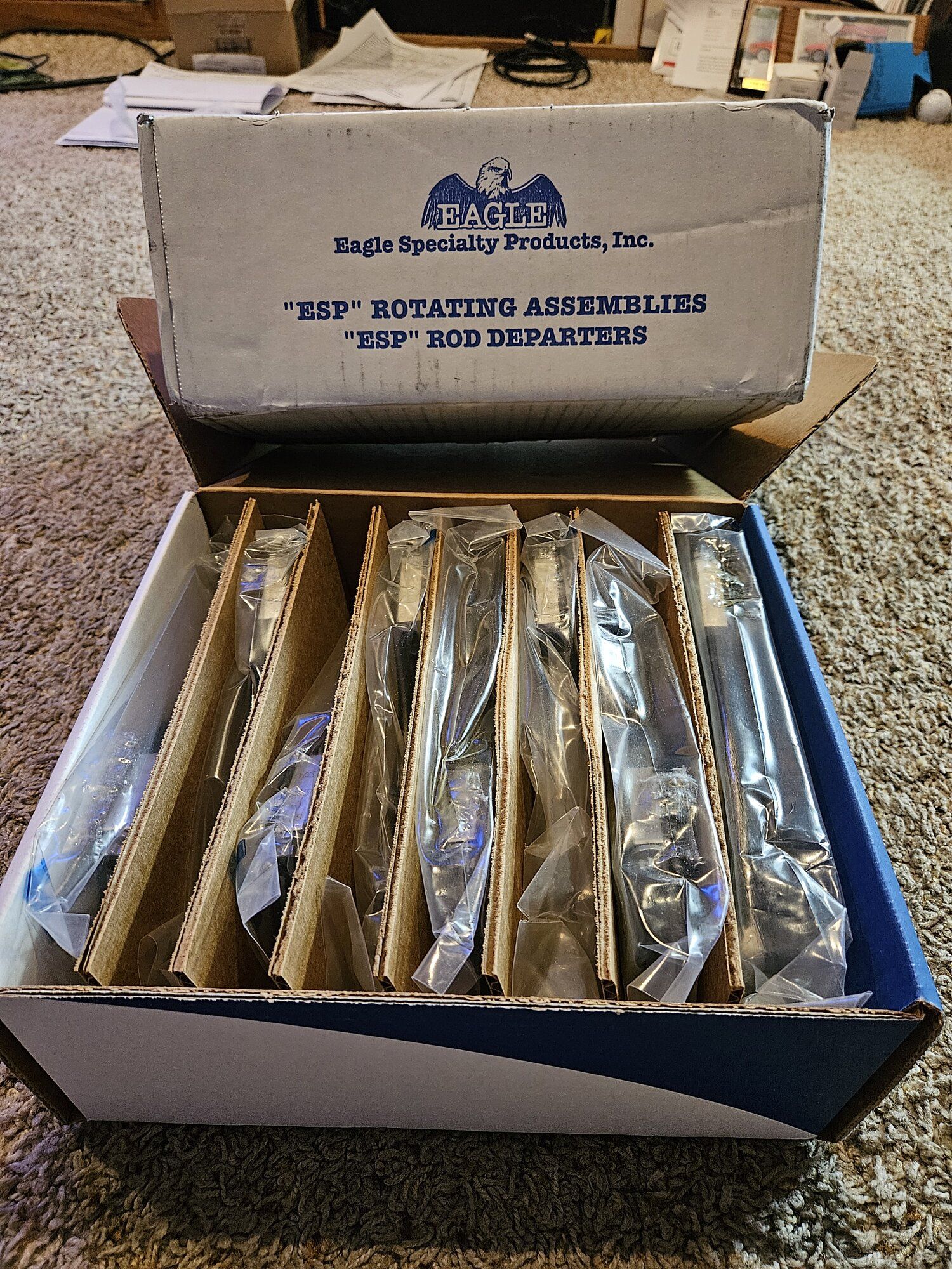

AND.....The pile of parts begins! Rods, Pistons, Rings, Bearings,Timing Gear/Chain, Cam Button, Oil Pump. Woosh....$ gone.
Bigger $ when the cam and heads are needed. :oops:
Gotta pay to play.

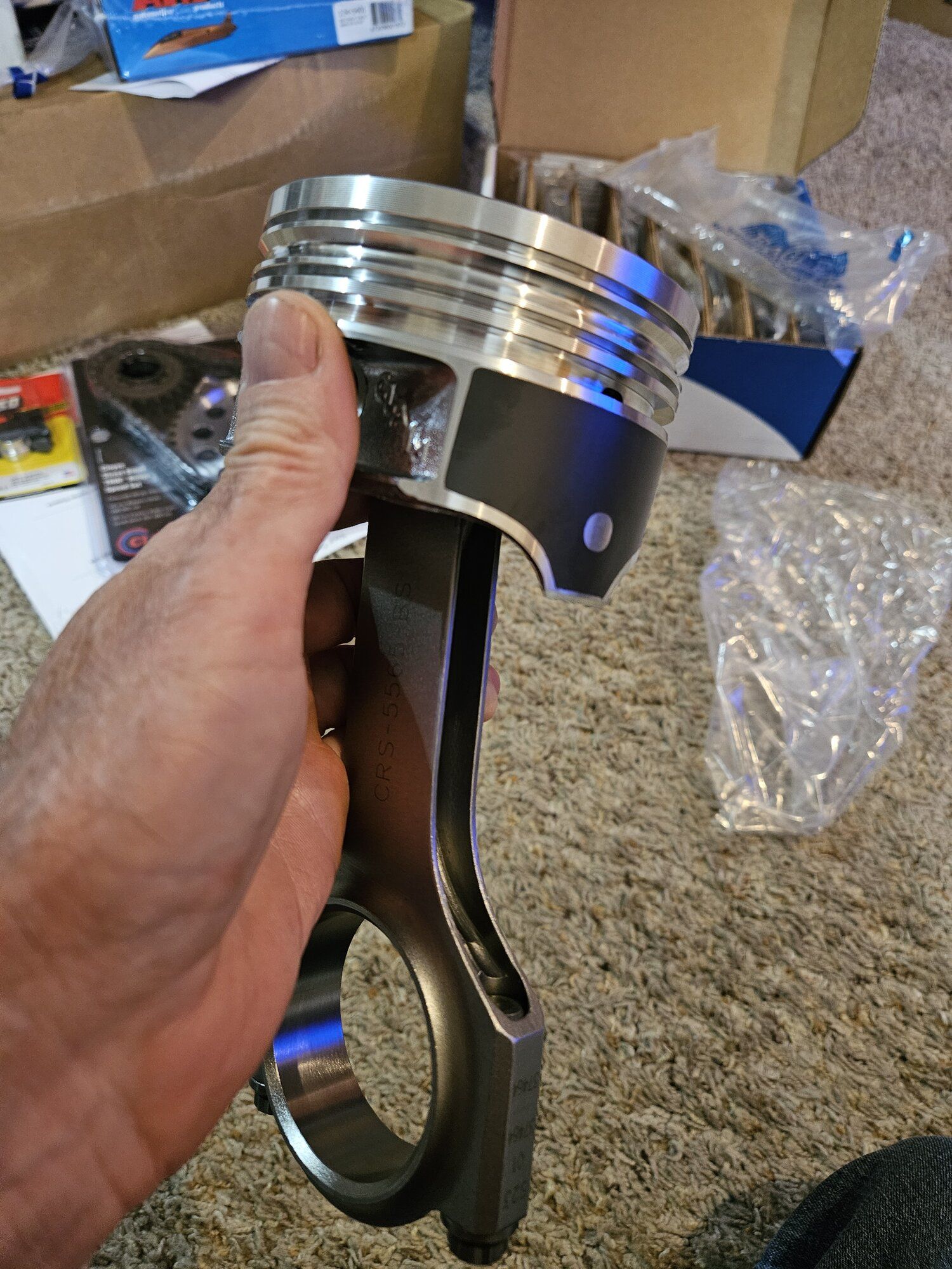

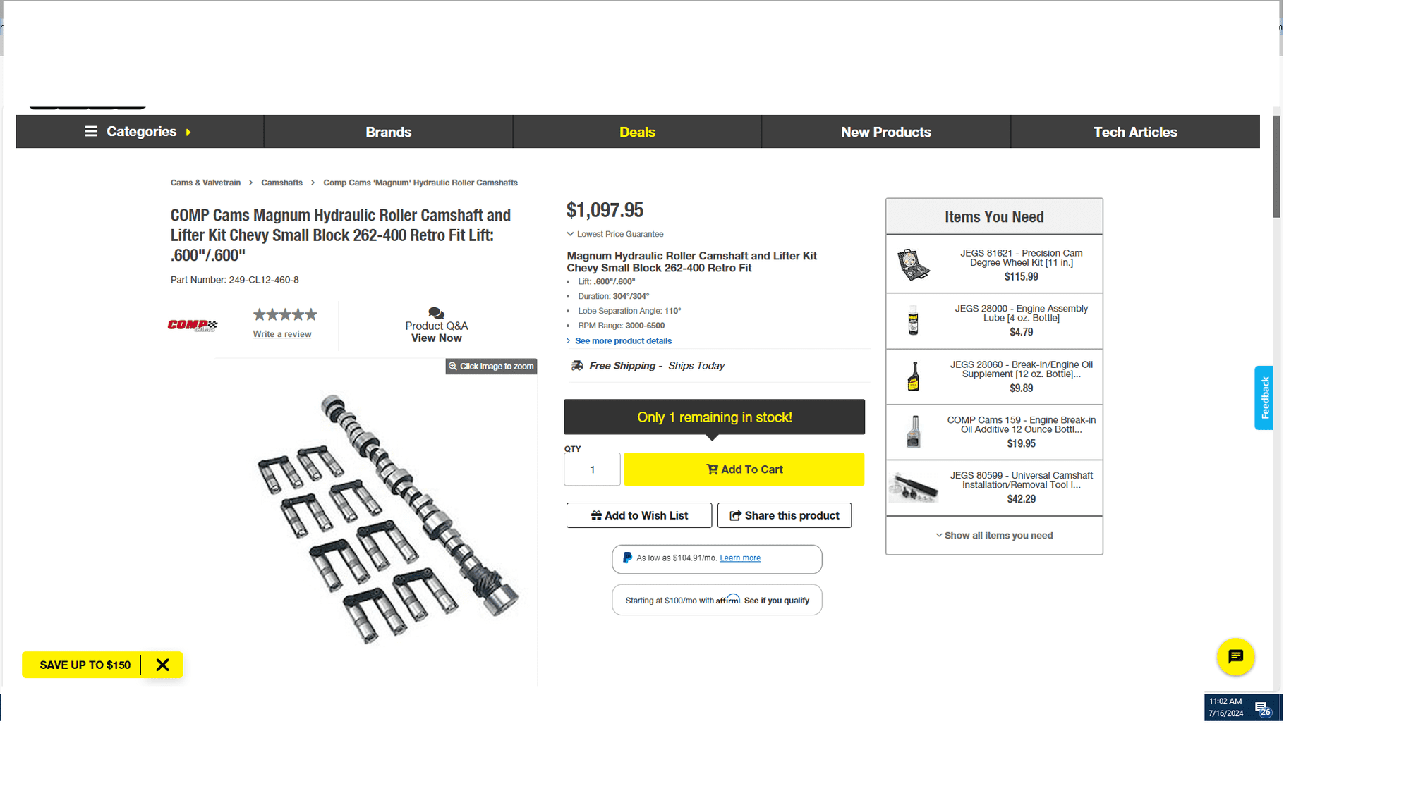

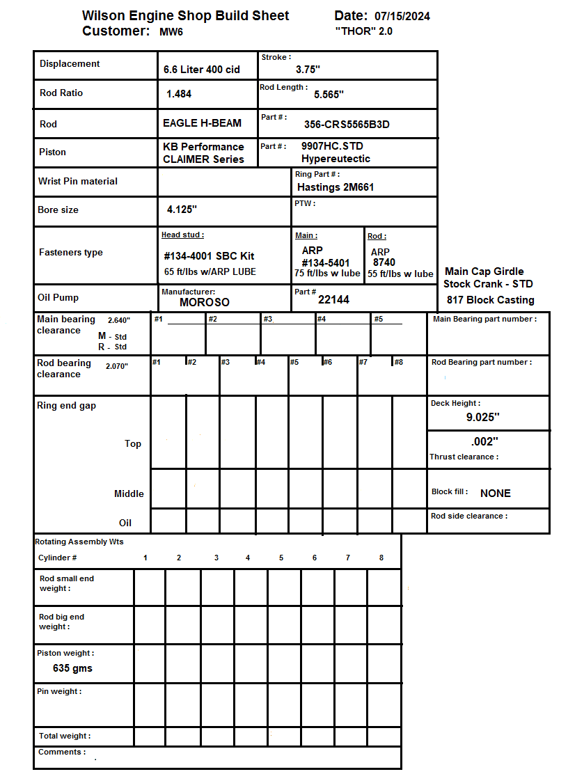

I couldn't wait til assembly time, I had to put ONE together :)
No locks installed tho.
A little oil return clean up on the 400 SBC casting.

Since it is supposed to be 105* heat index today, it will be a good day, after lunch, to take the pressure washer to the 400 small blocks block and crank, then blow dry and spray with a light coat of WD40 to prevent flash rusting of all the clean or machined areas. As always, thanks for following along what we do here. We're ALWAYS busy!
