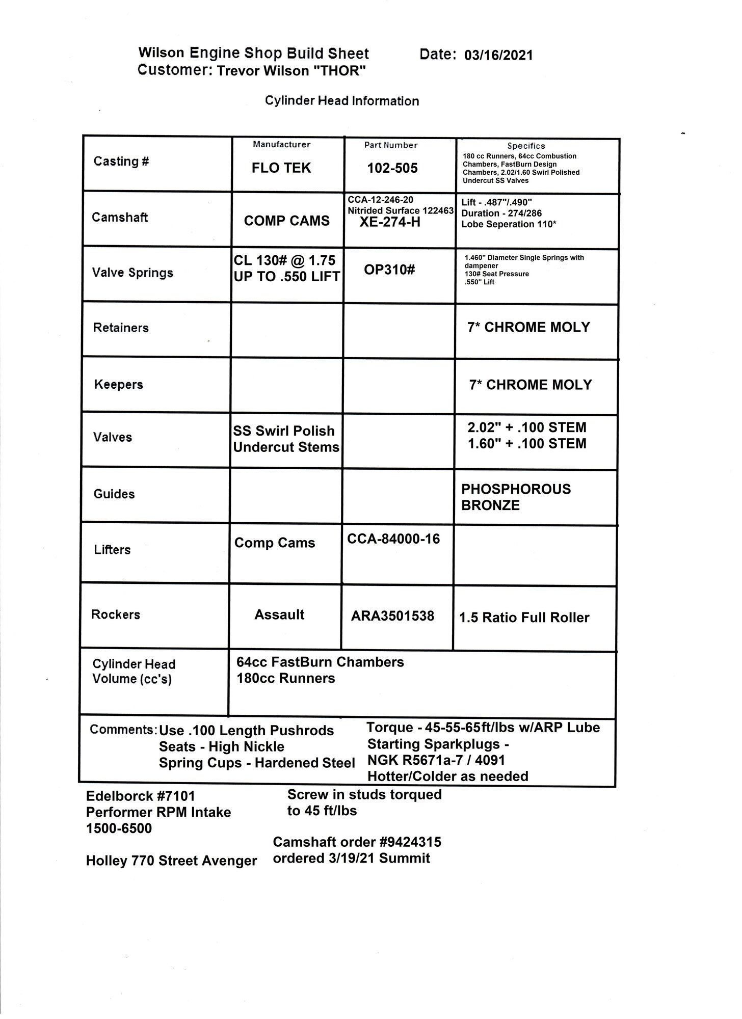

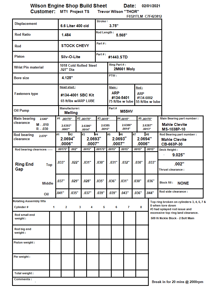

Updated Spec Sheet for the Small Block Chevy build. Like I said, very good bottom end numbers, right where I like to see them!!! :thumb:
I am waiting on the Nitrided cam from Comp Cams. It is supposed to ship 6/1/21. It is a XE274H grind and should work really nice in this setup for torque all under 6500 rpm's. This will all be running through a 4L60 transmission with a "Thor" converter coupled to the 3:73 posi in the Red '86 Z28. Subframe connectors, driveshaft loop....all the goodies. :cool:

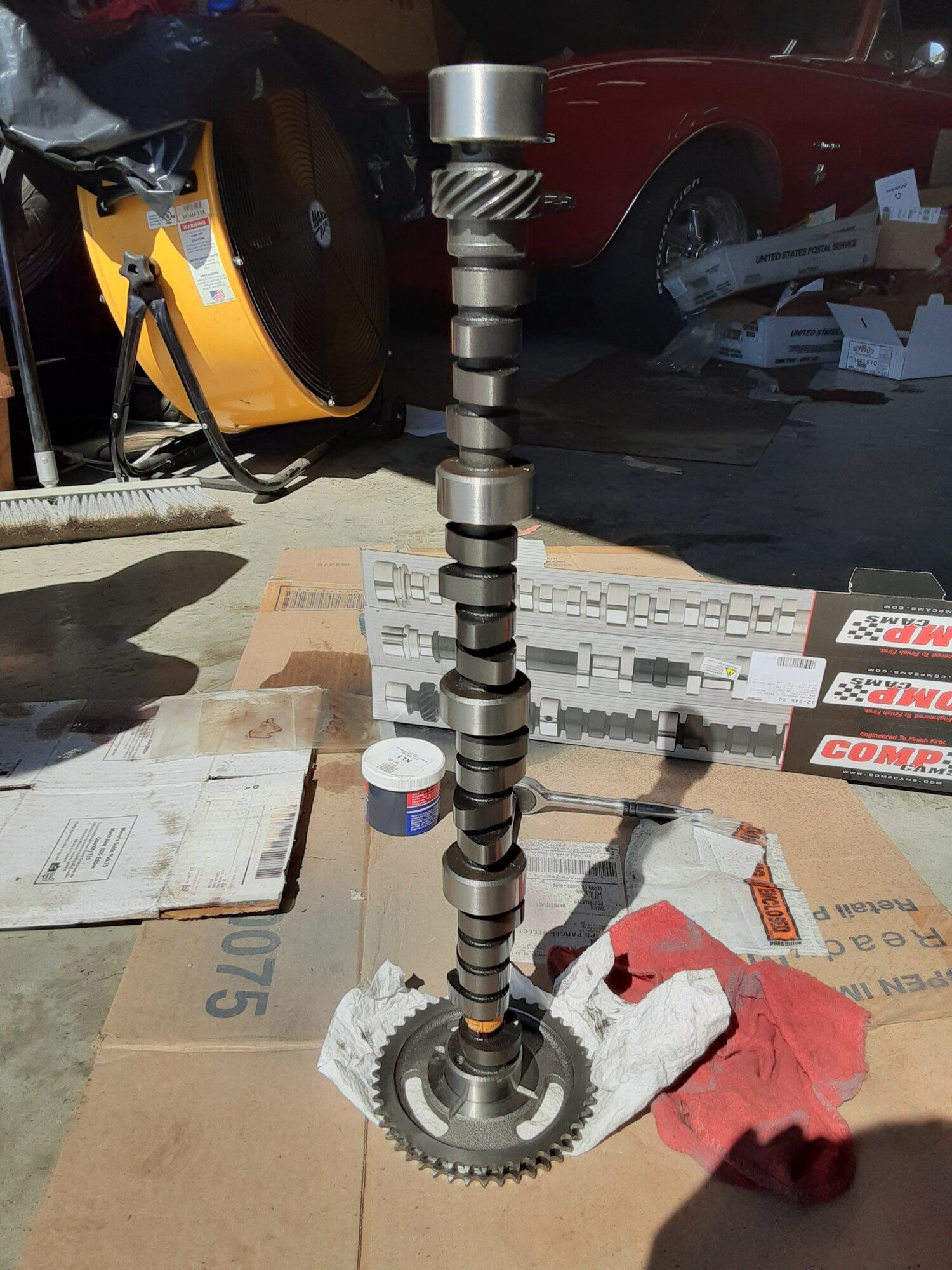

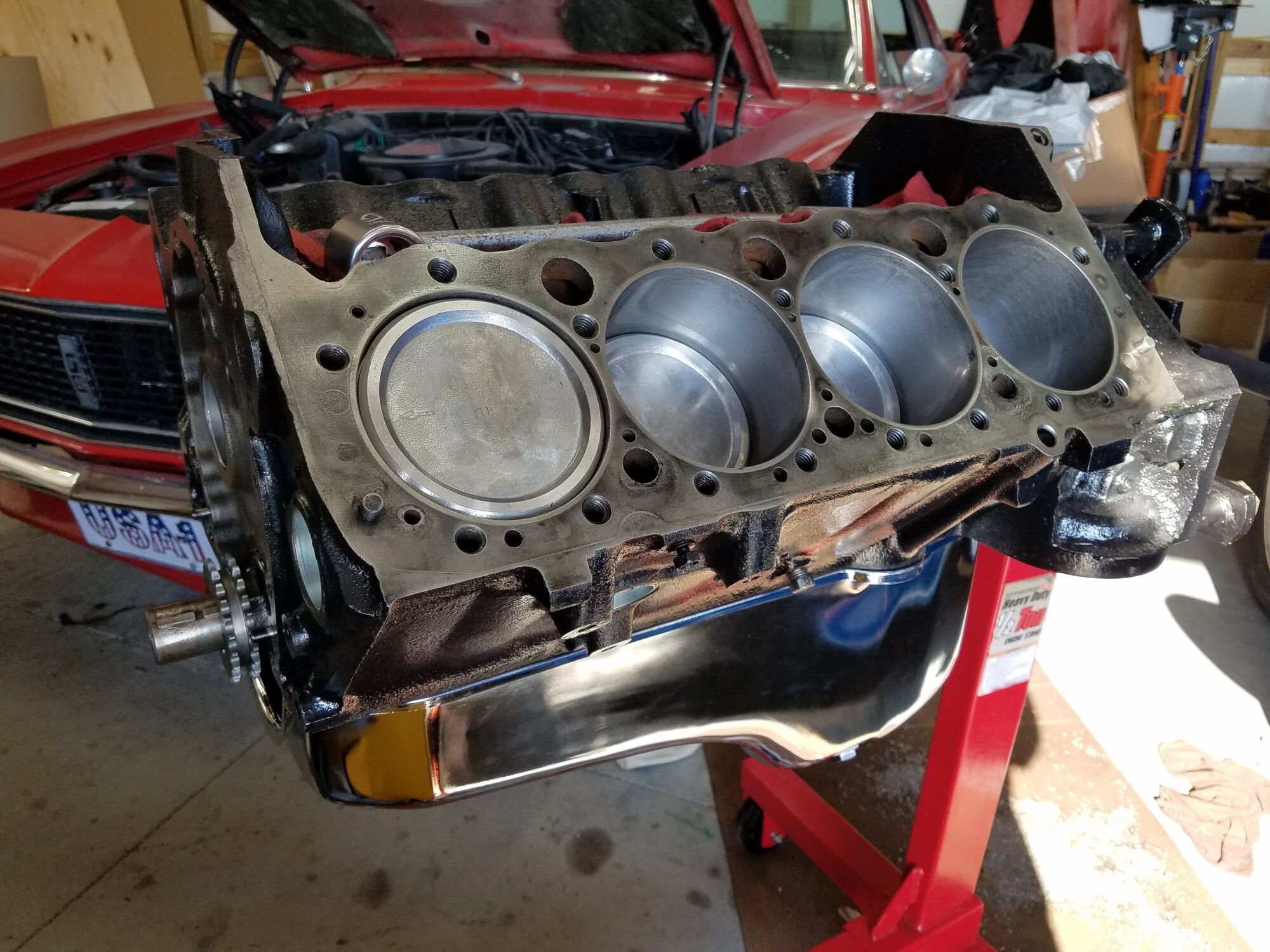

A few more pics of 3 hours of work last night, you can't tell I did anything, but the bump stick came in so it got installed immediately!
Now to button up all of the loose ends a just a few parts small parts left (pushrods, distributor, plugs and wires), bolt the heads down good, then strap on the 800 Holley:thumb:

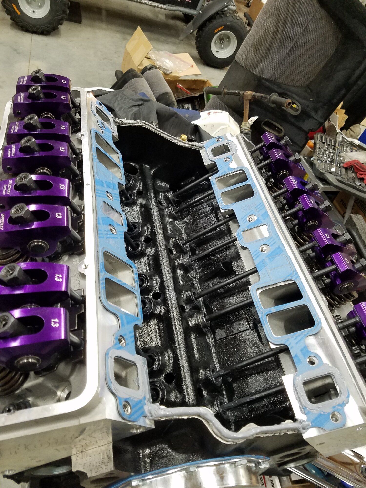

I will be using 1.3 ratio break in rockers for the initial break in for the cam then switch back to the 1.5's for the rest of its life.

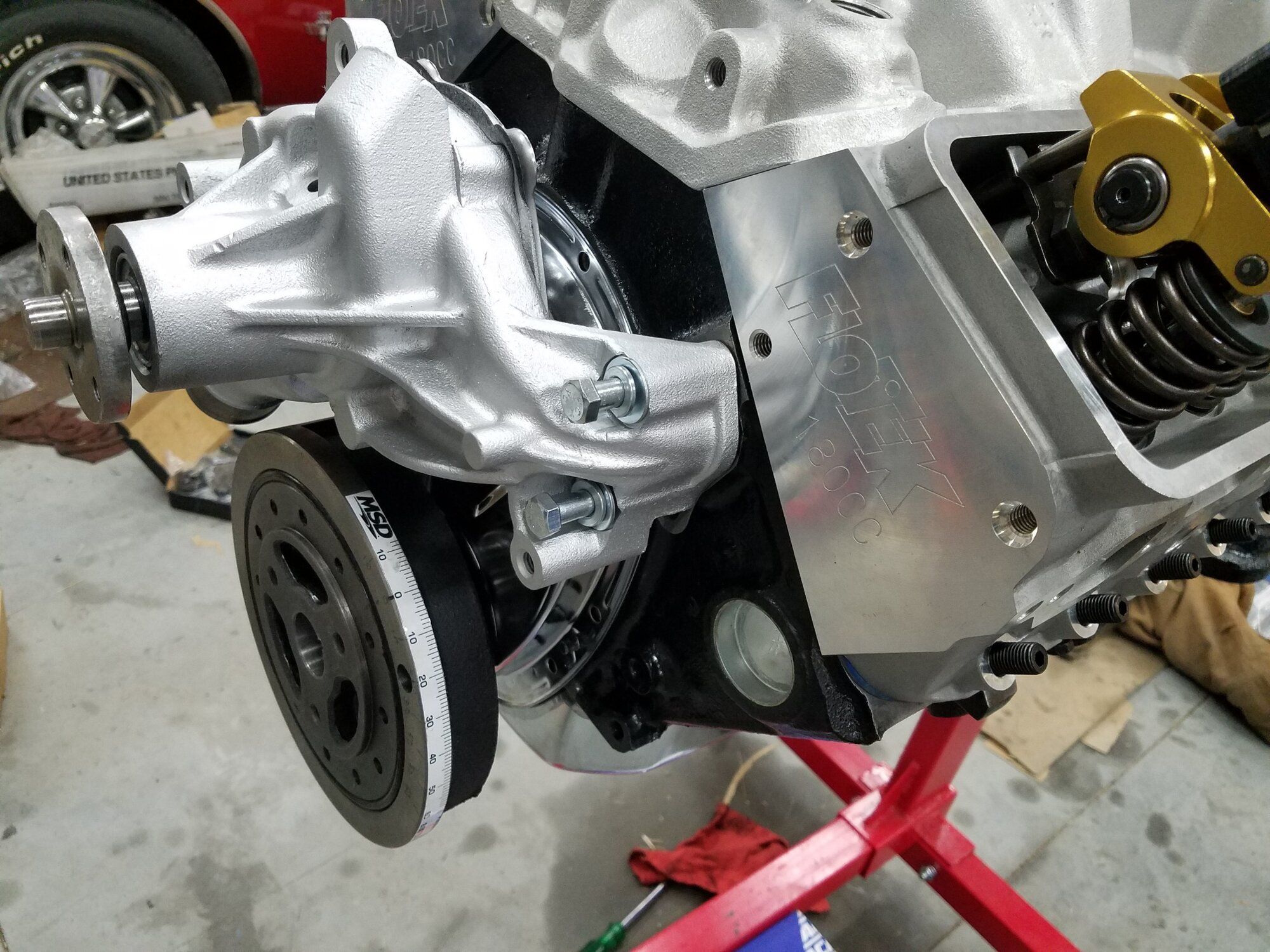

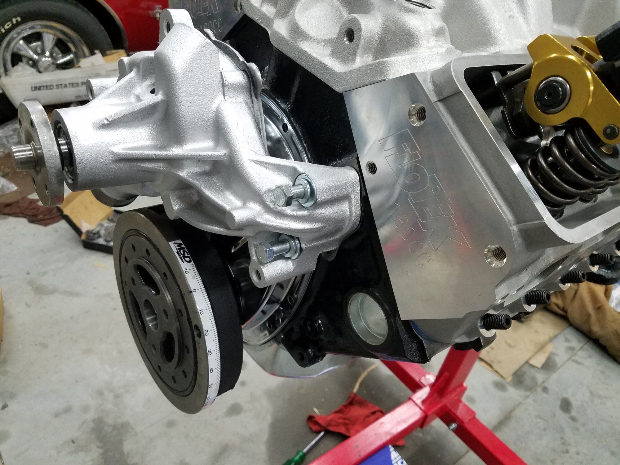

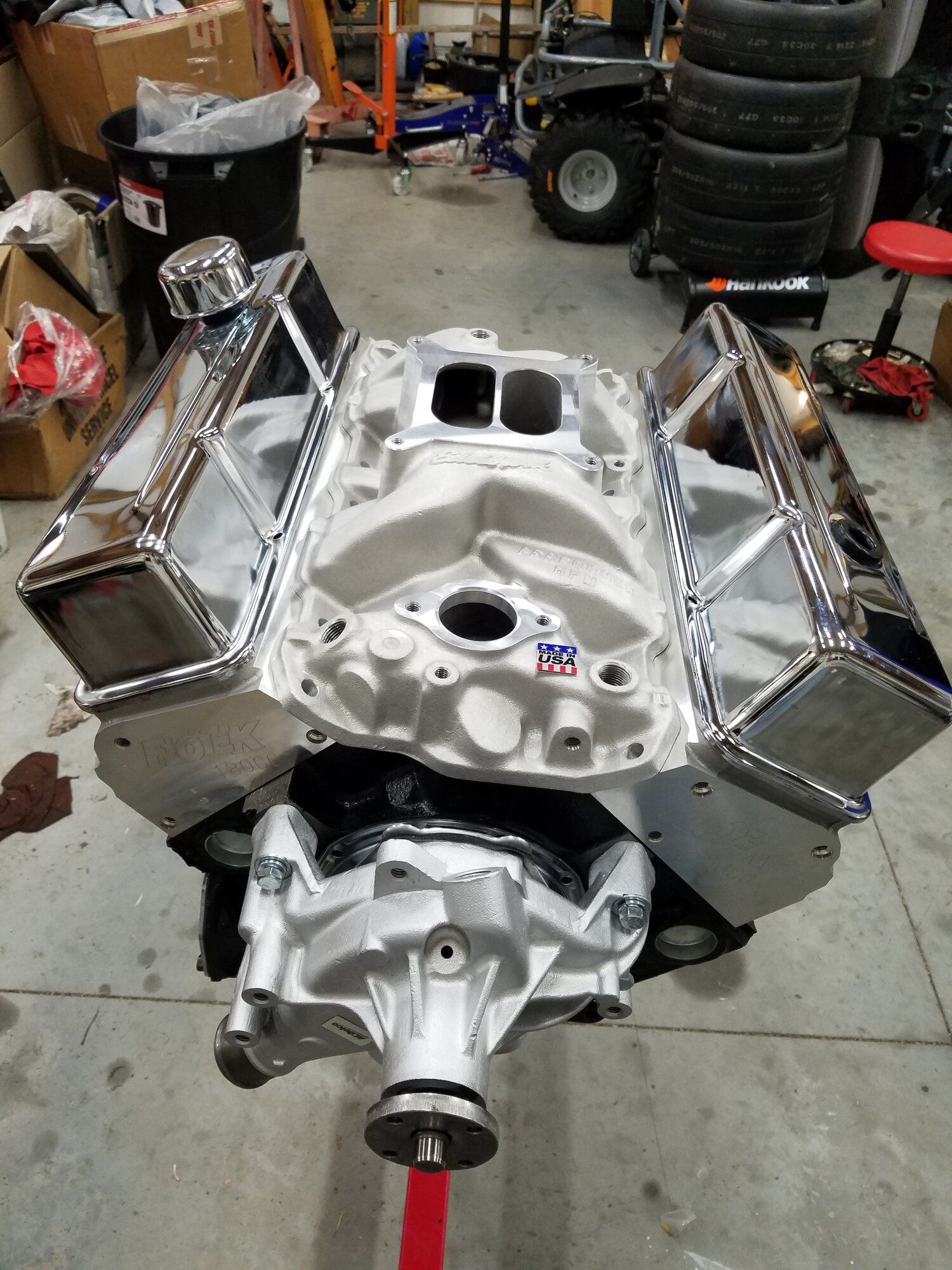

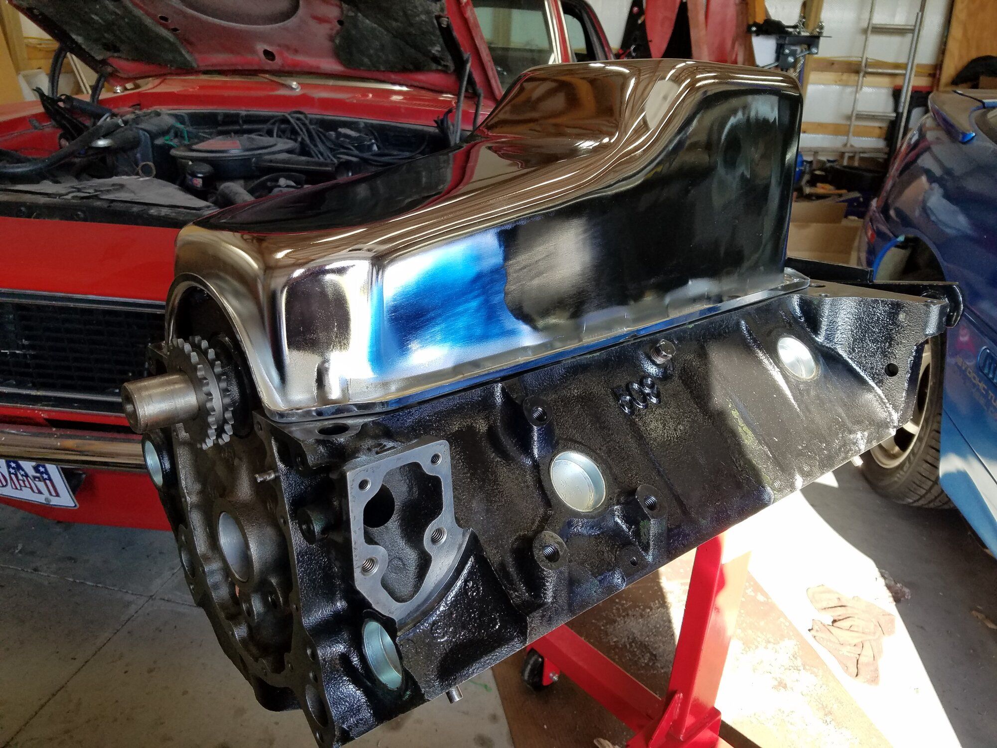

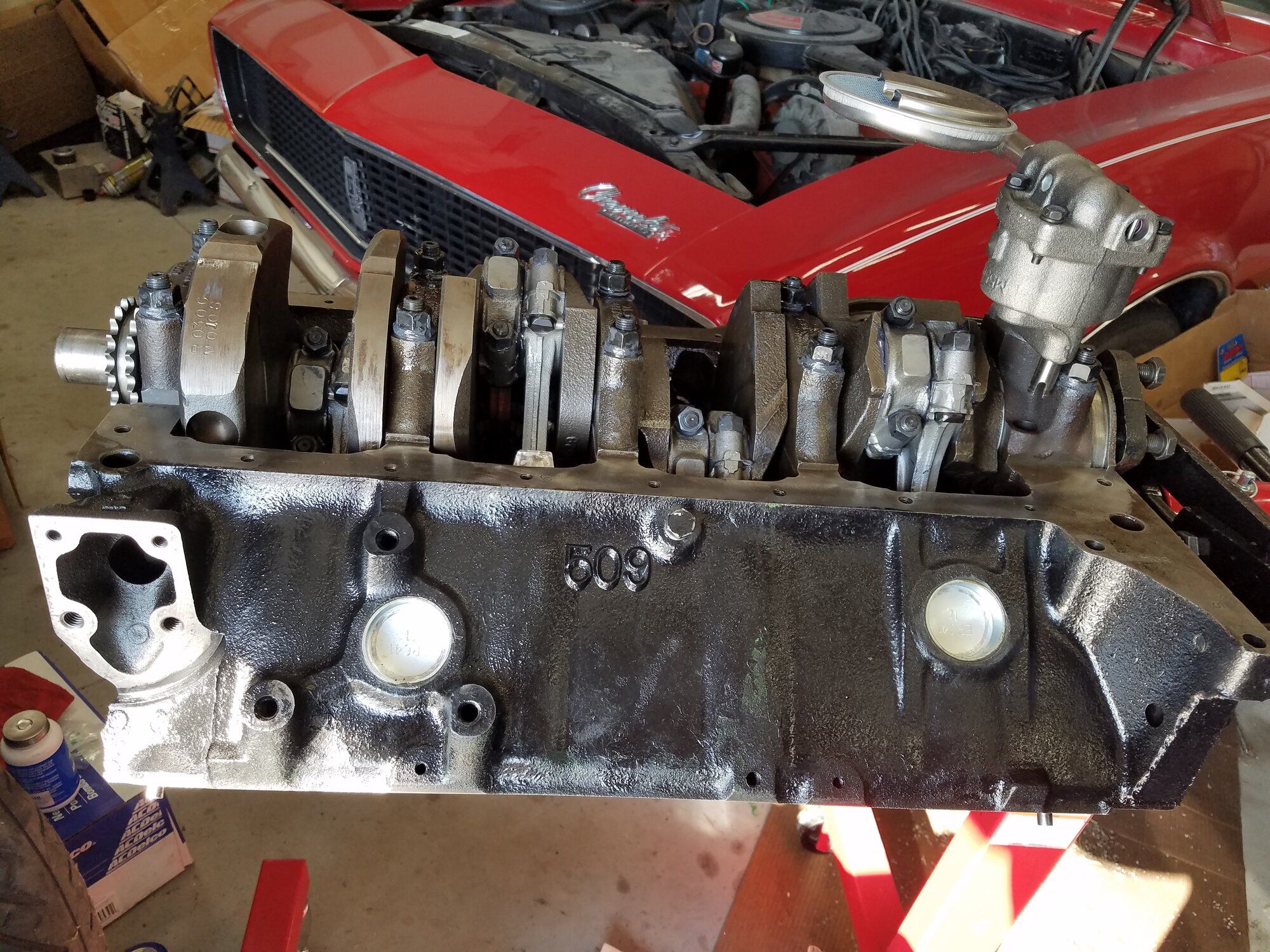

Just a small update on the V8 build. I have the oil pump, cam, front cover and oil pan all bolted up as permanent now and the top end will get bolted in (not just pictures and getting shit out of my house and on the motor). I need .100" longer pushrods and will get that and a distributor on the way. I have a 6AL box for this also but shhhh. :shhh:

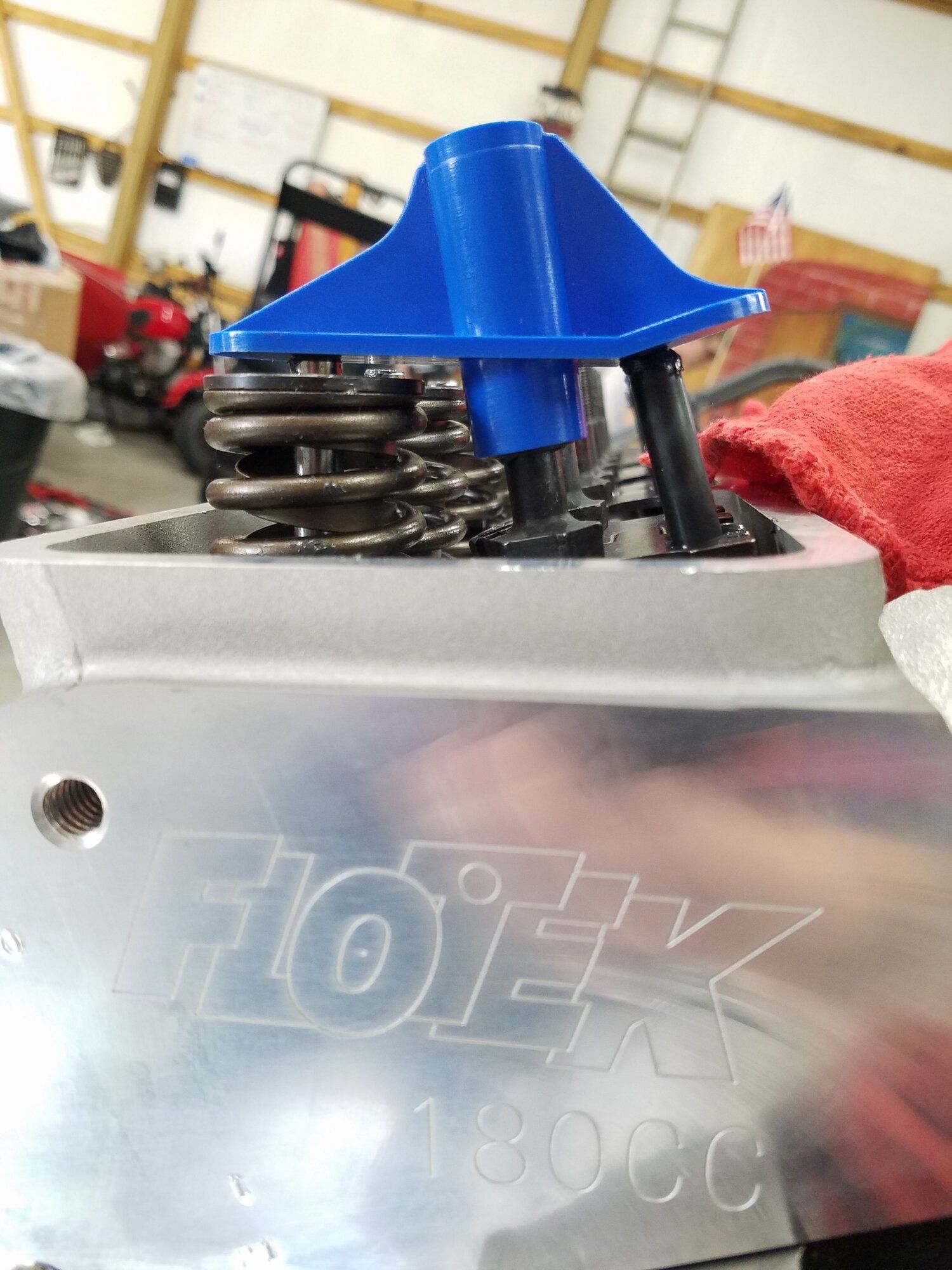

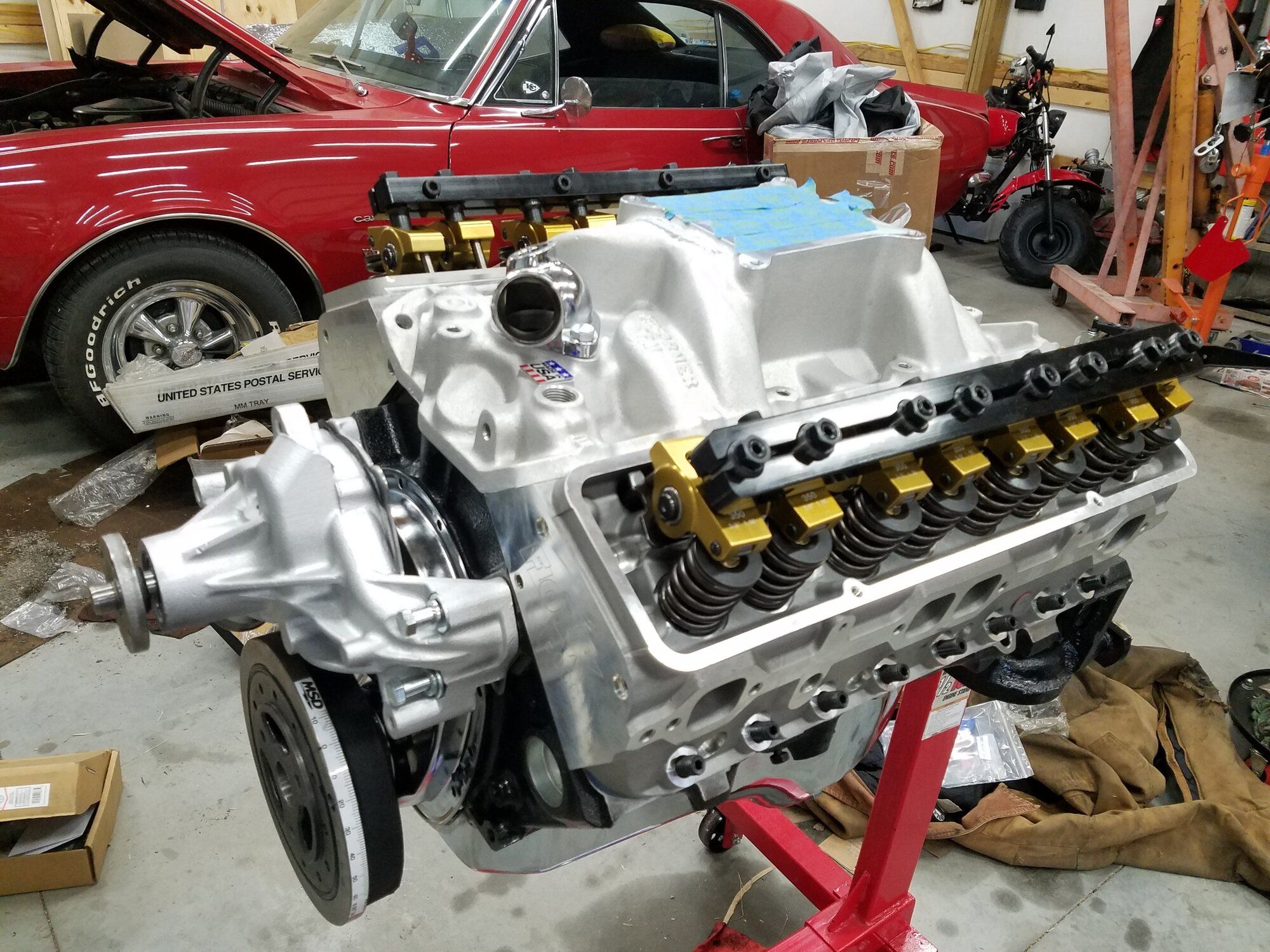

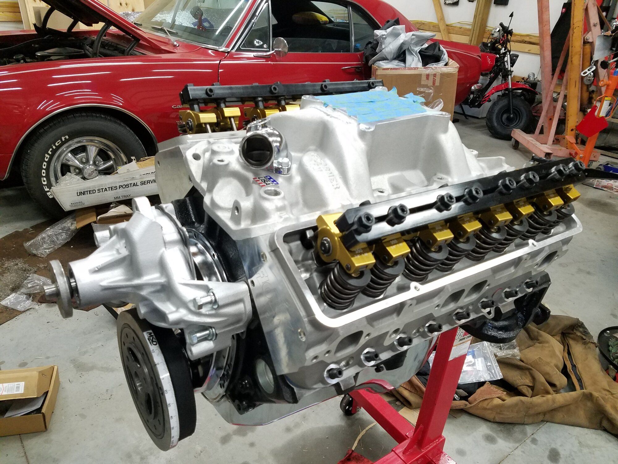

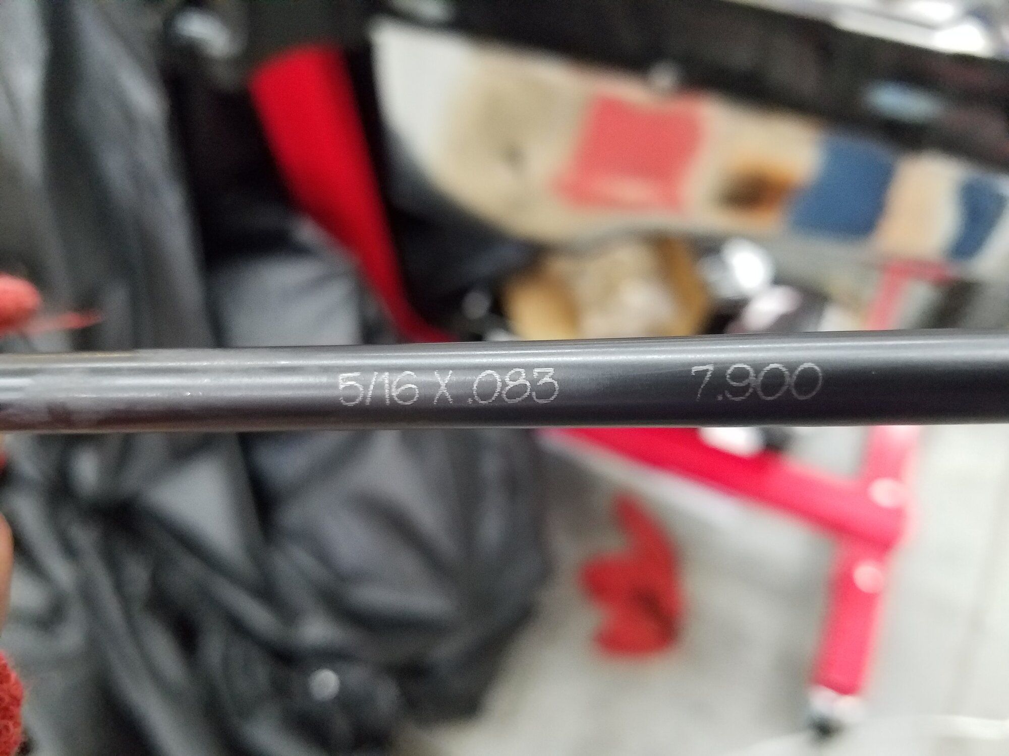

With the heads bolted down at 65 ft/lbs, it was time to check the pushrod length that I had already checked and ordered. I had to use .100" longer pushrods for the correct valvetrain geometry. They worked out perfect!
Here are a few more pictures. Making headway! :thumb:

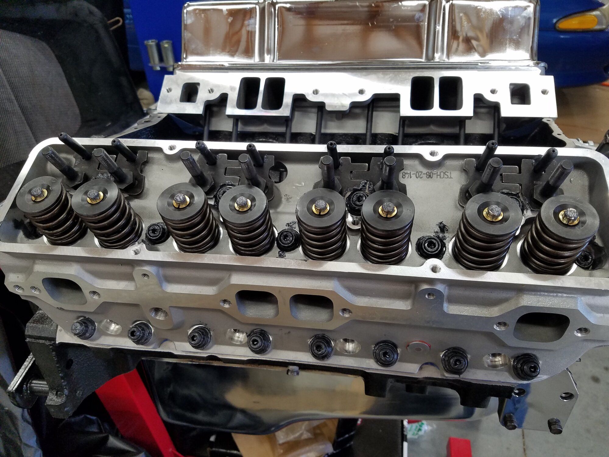

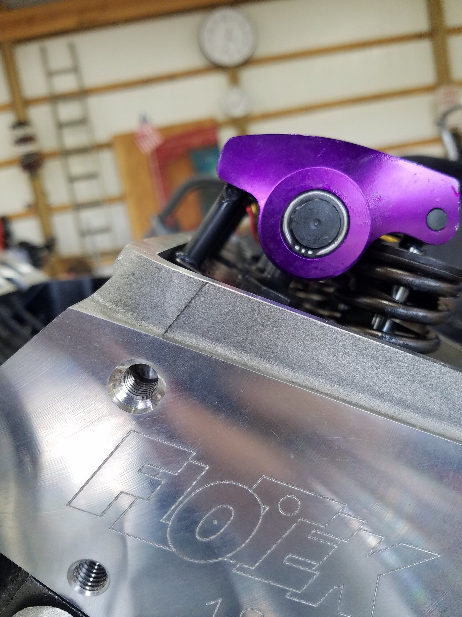

Set back. Called the head manufacturer and asked if the rocker studs needed sealeant. "Yes they do" was the answer so we are going to tear the studs out and apply ARP Sealant and re-align all of the individual pushrod guideplates but its not to terrible. Better to catch it now!
On the up side, I have all of the 1.3 rockers ready to go on then we can seal her up with the intake, carb and distributor. Scheduled for tomorrow but we will see how the day goes.

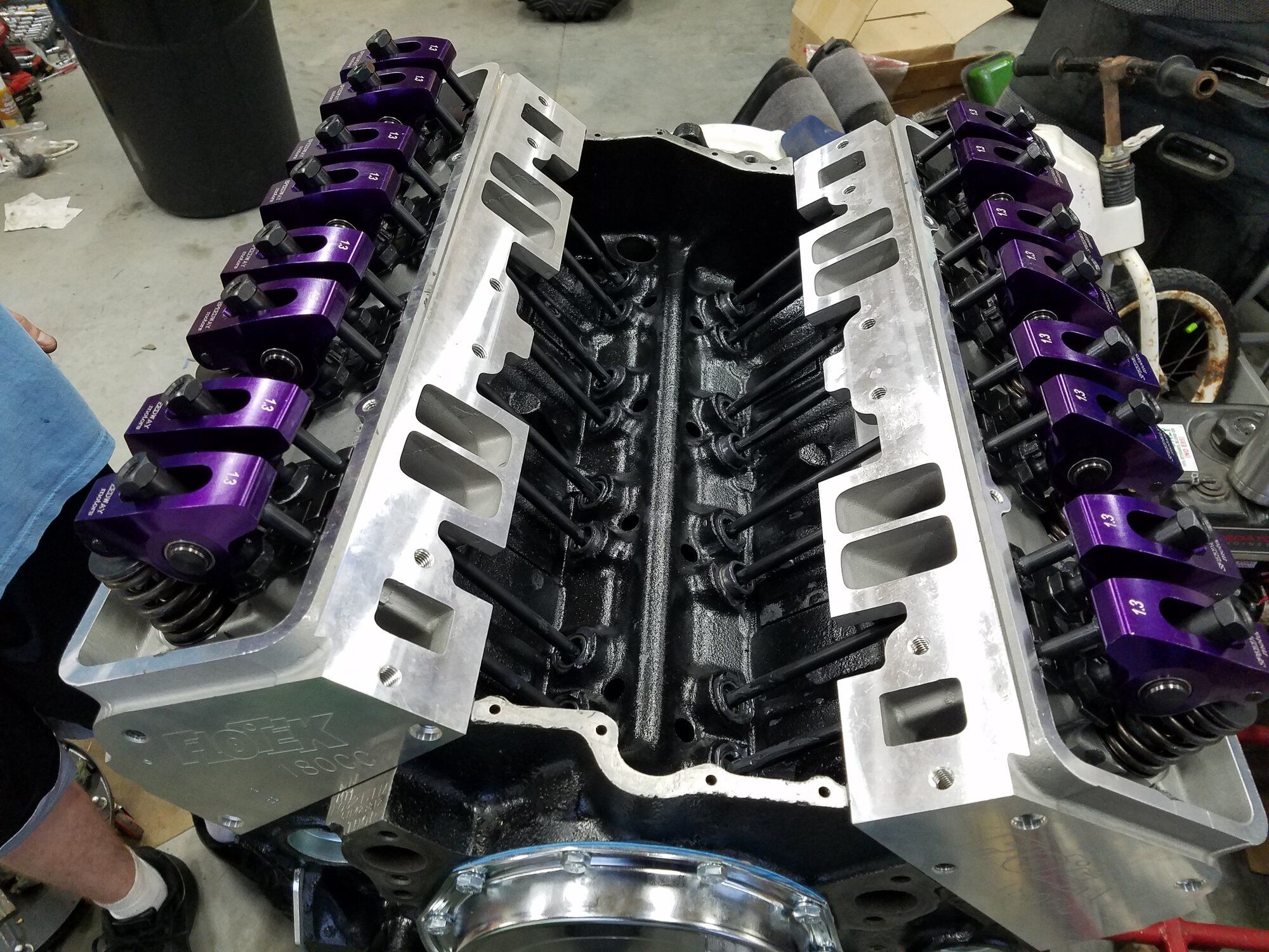

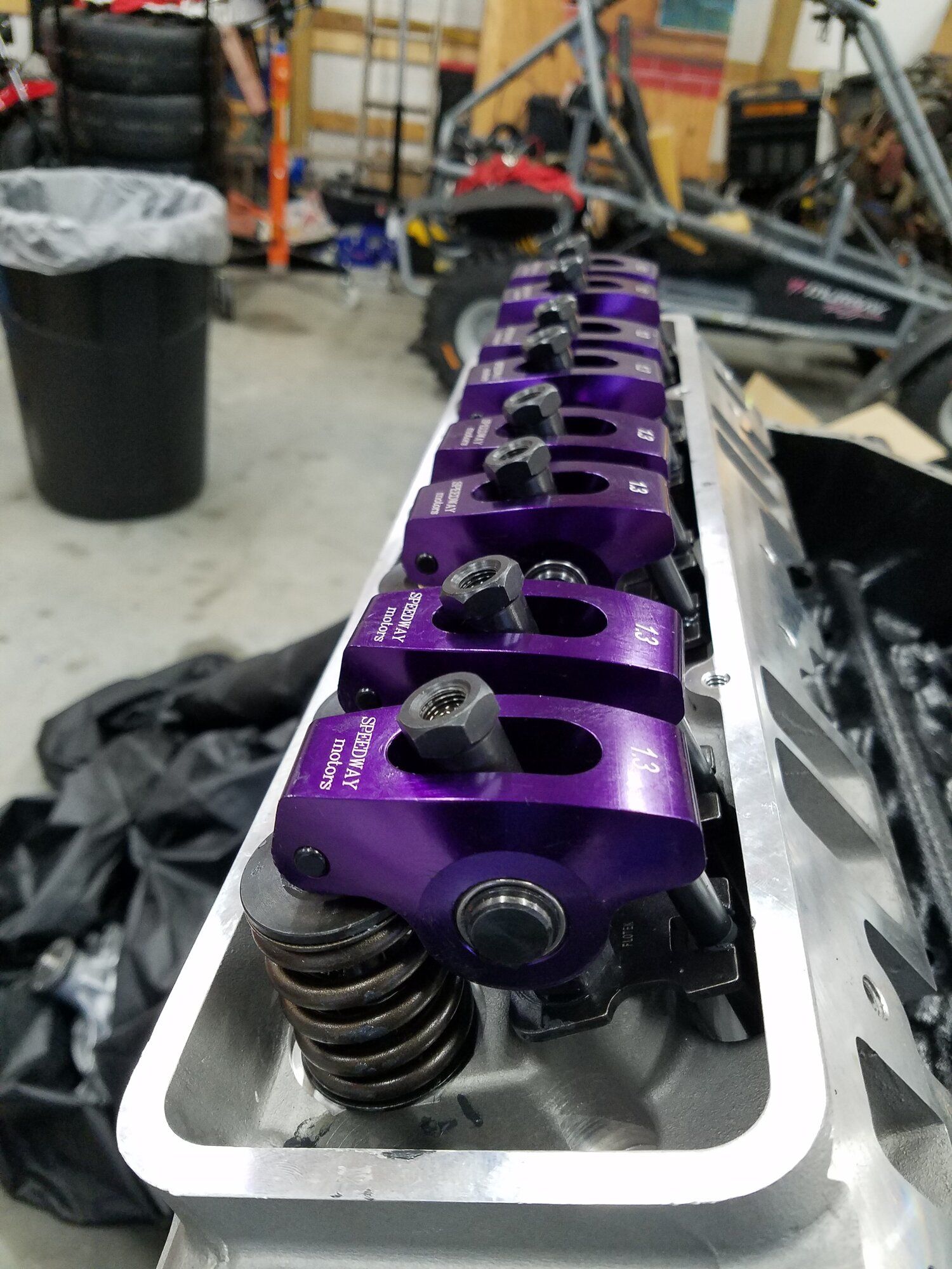

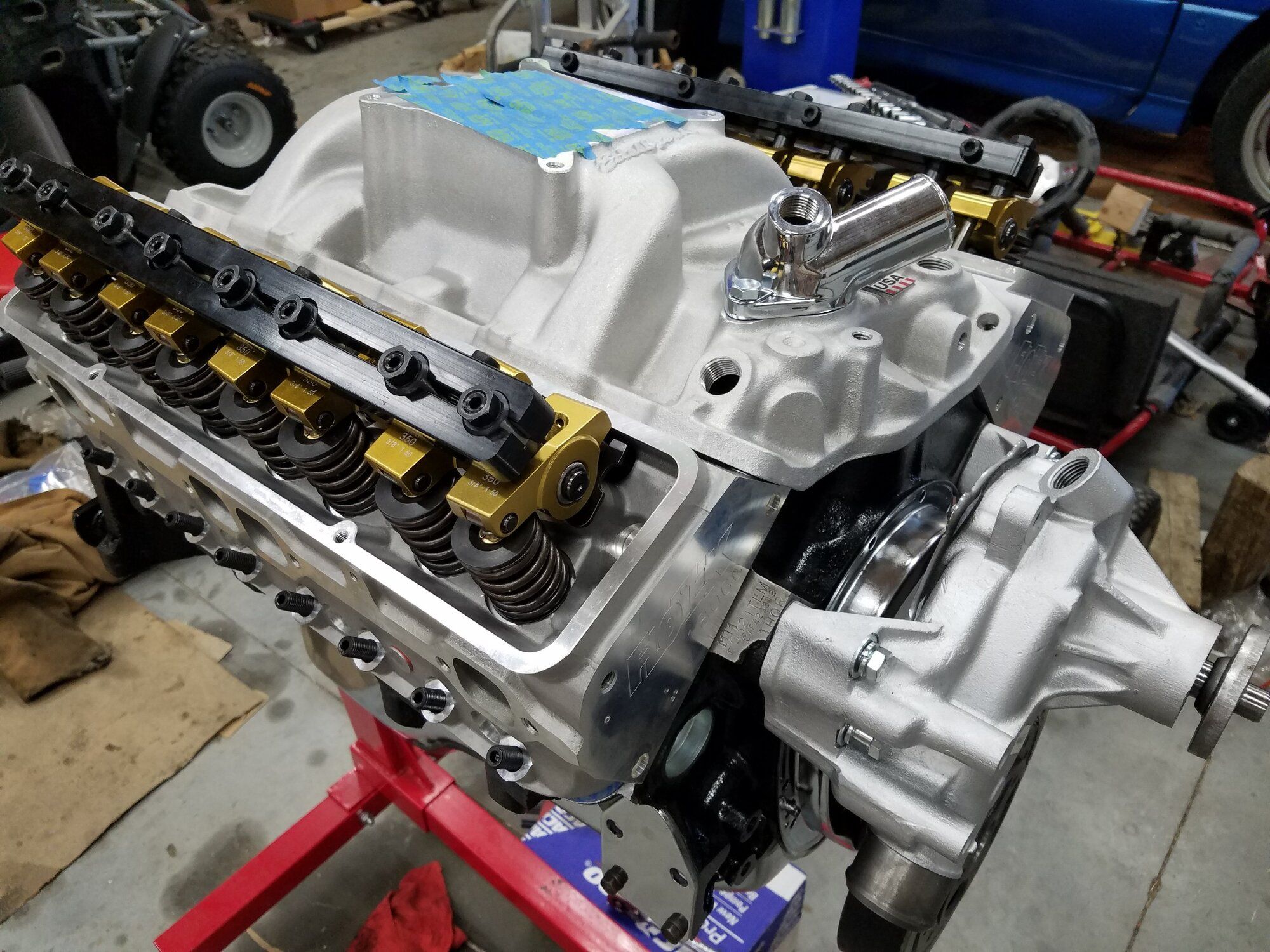

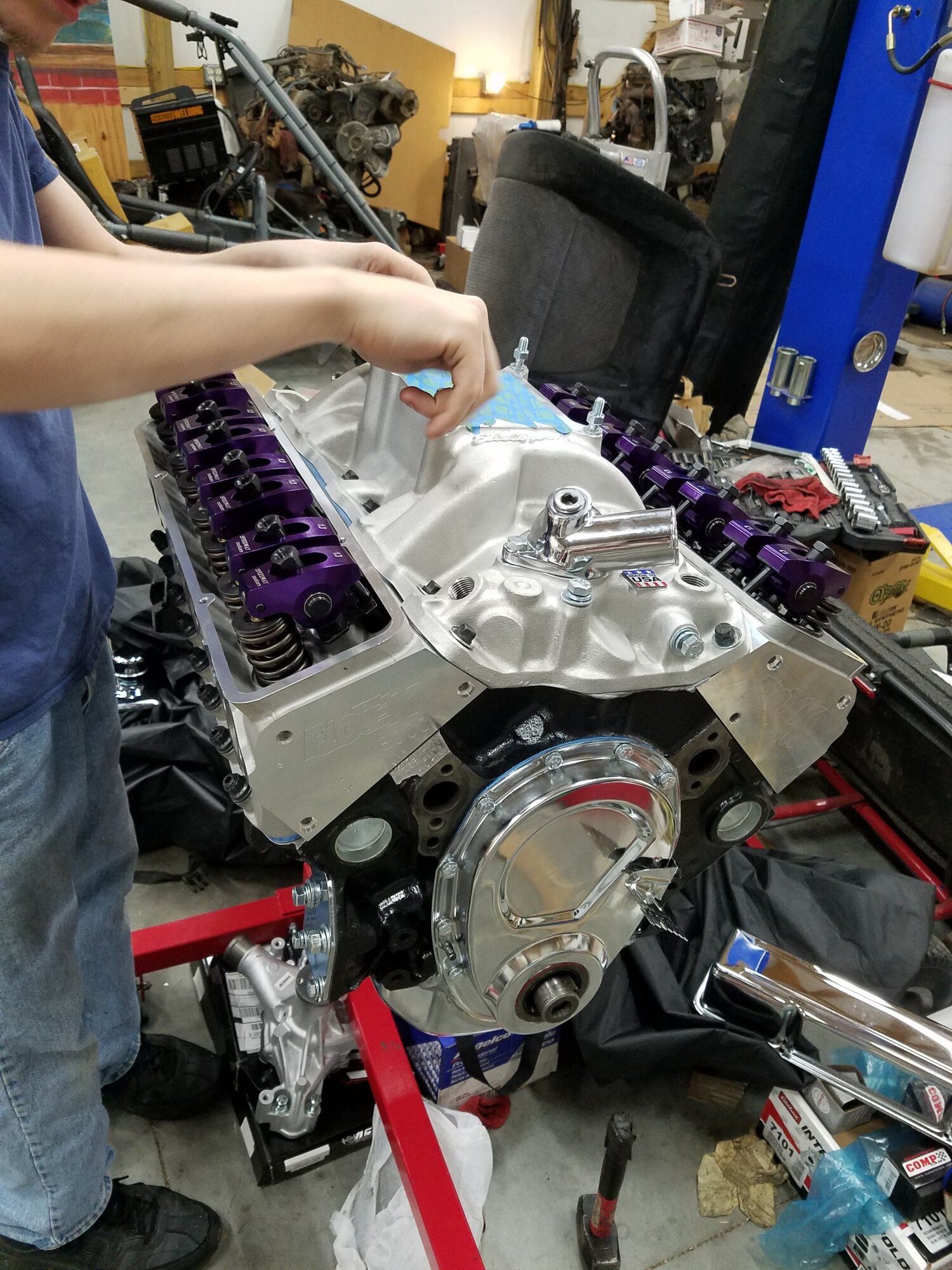

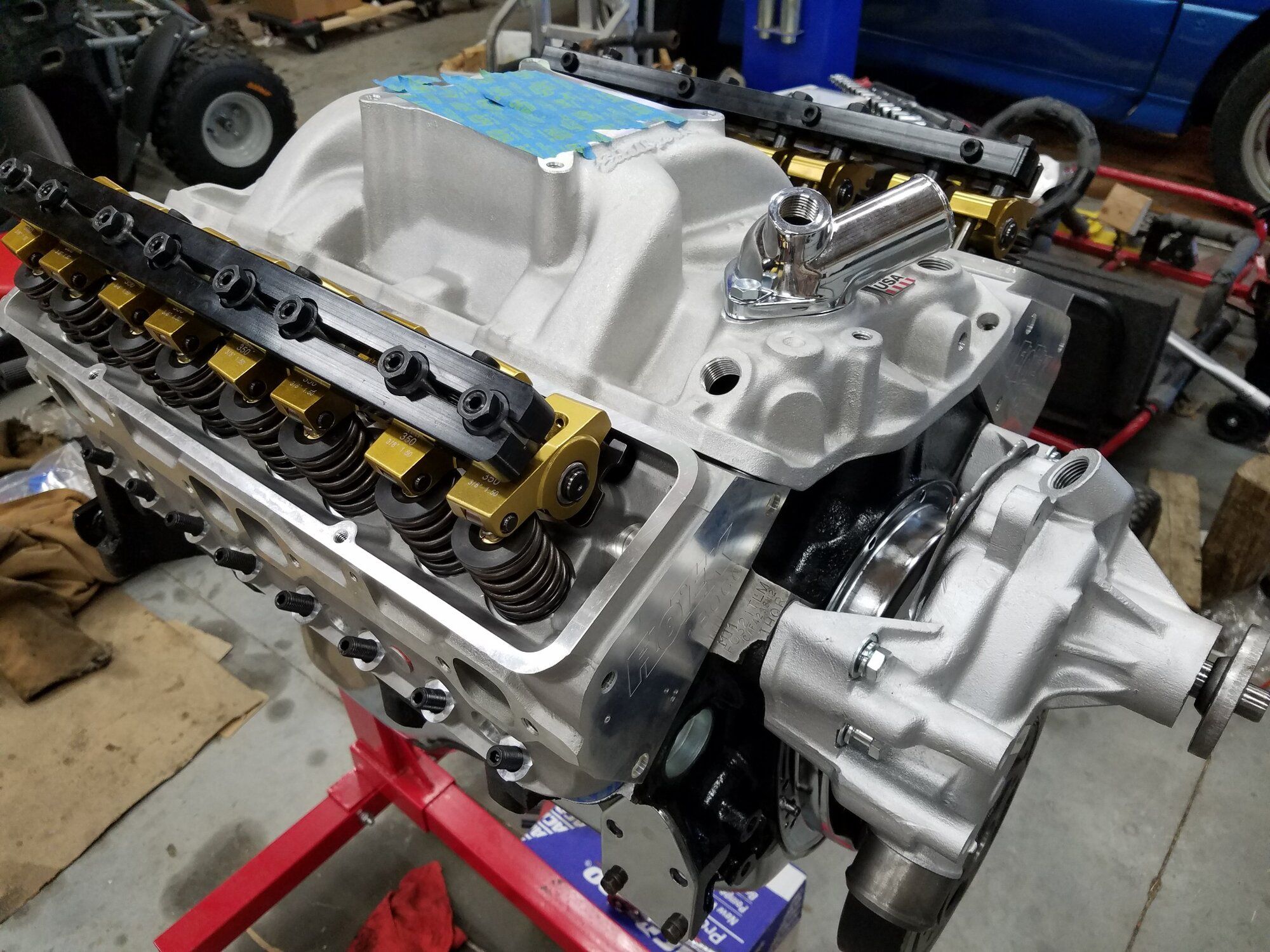

Today I am pulling all 16 rocker studs out of the V8 heads and applying ARP thread sealer per FloTeks great customer support line. Glad I asked if they needed sealer before I got any further. Half are done as of now. Each one requires me to put a rocker arm on and then align each individual pushrod guide plate for exact location of the rocker to valve tip before locking them down at 45 ft/lbs. Not hard, just time consuming. Time for lunch! Stay "tuned" ;)
Pops

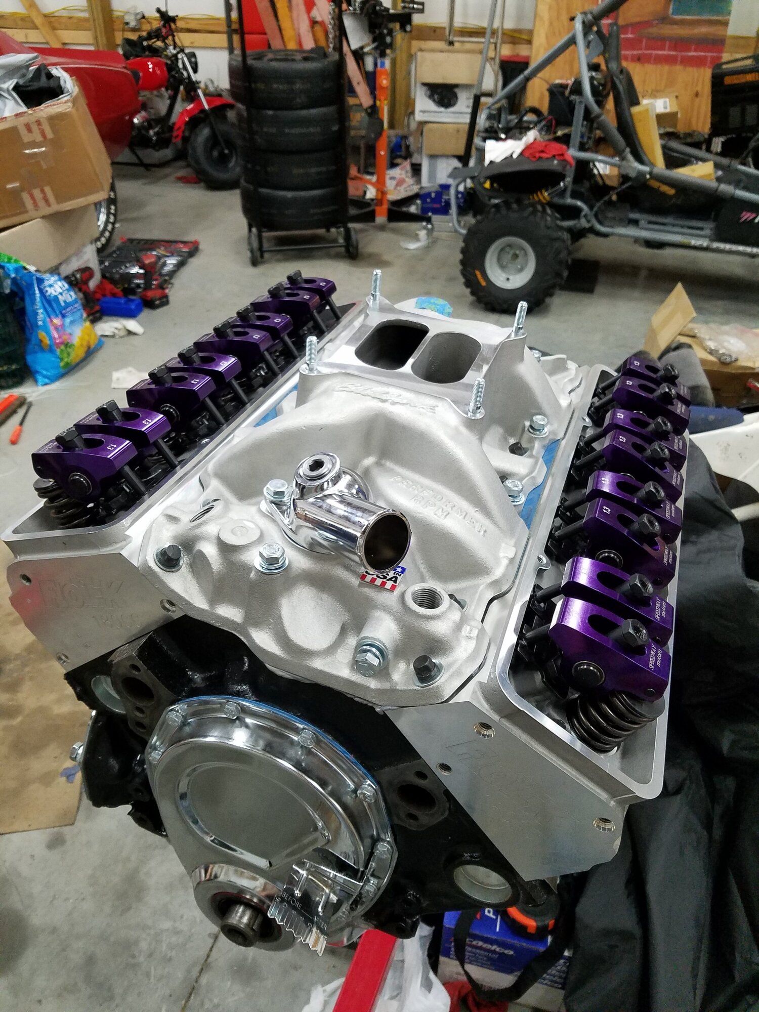

Got all 16 sealed up and precisely back in place with each guideplate.

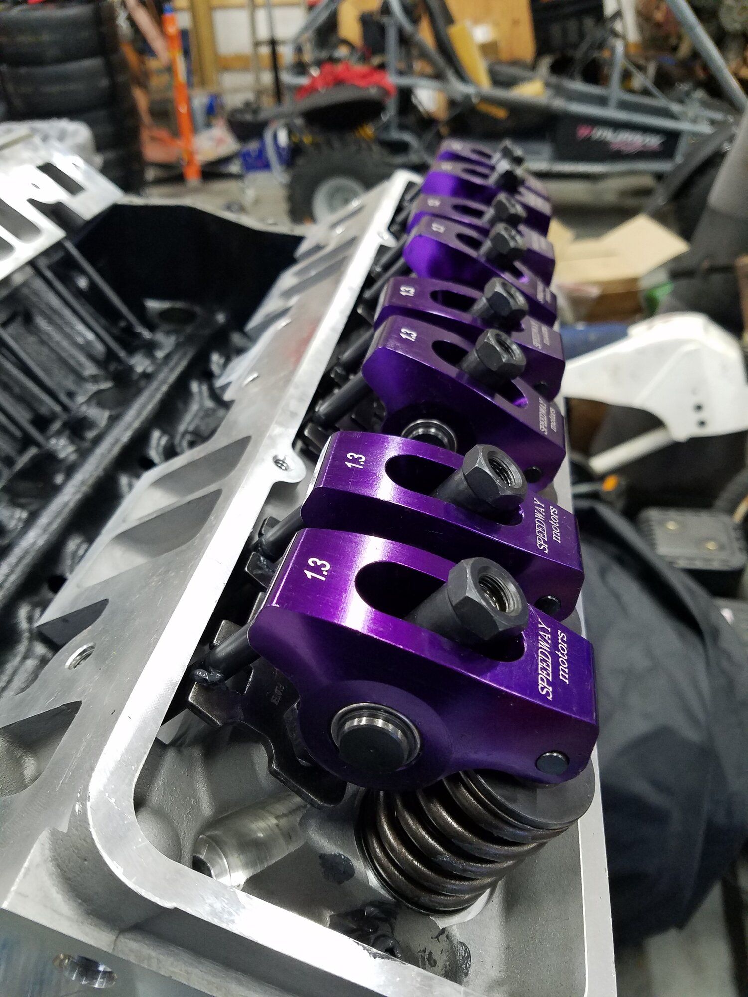

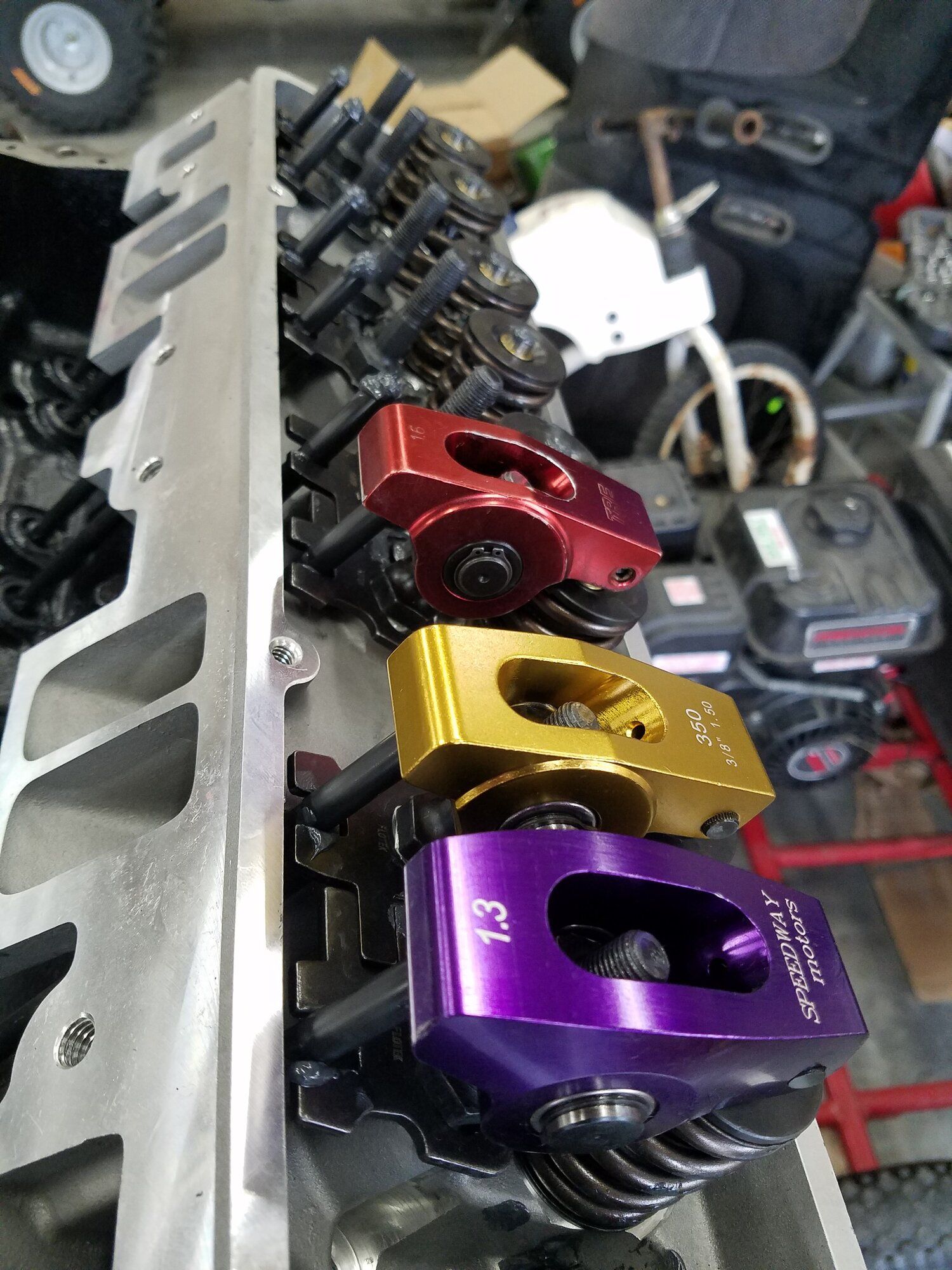

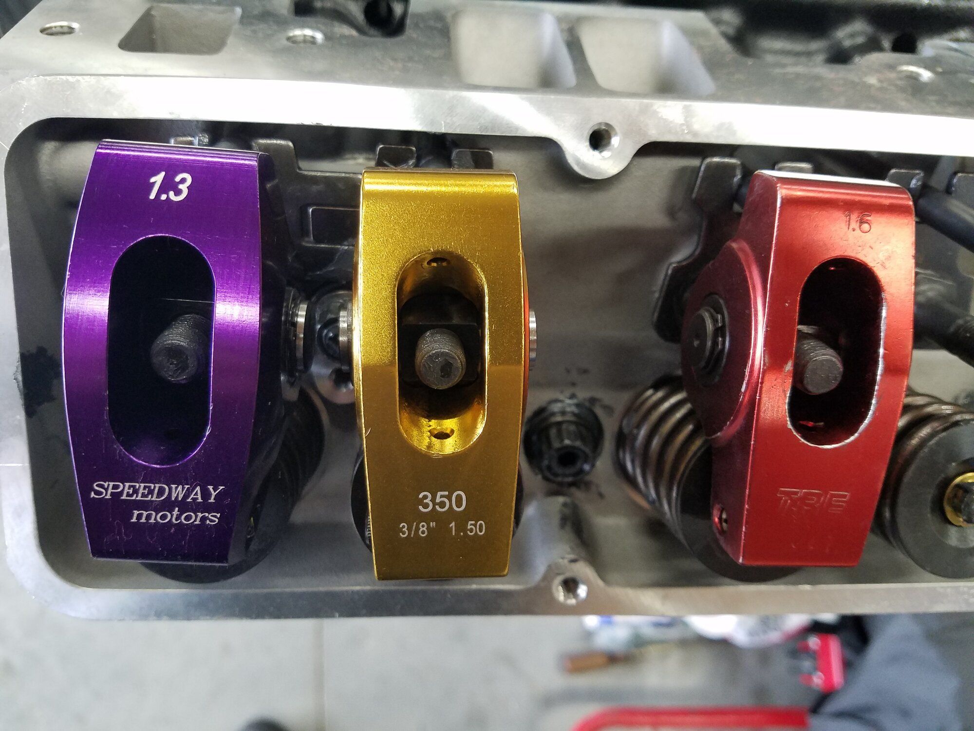

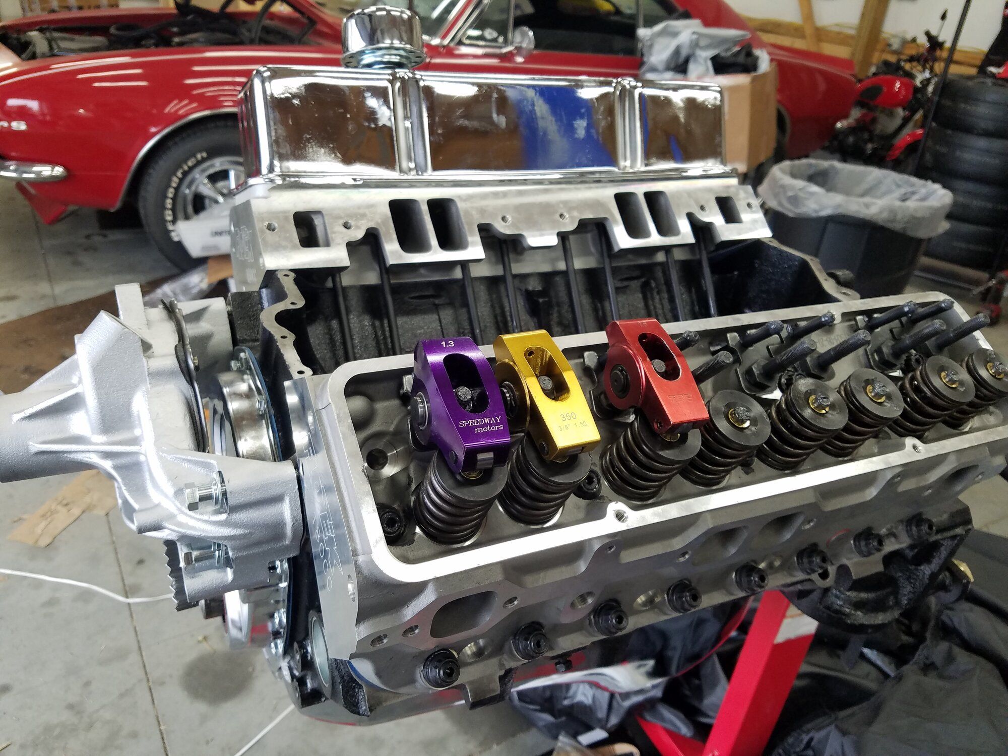

Now, pick a ratio, any ratio LOL.
I am bresking in with the Purple rockers then going to the Gold 1.5s. The Red ones are 1.6s if I would like a little more lift outta this cam.
It's time to set the valve lash and seal her up!
Enjoy a few pics!

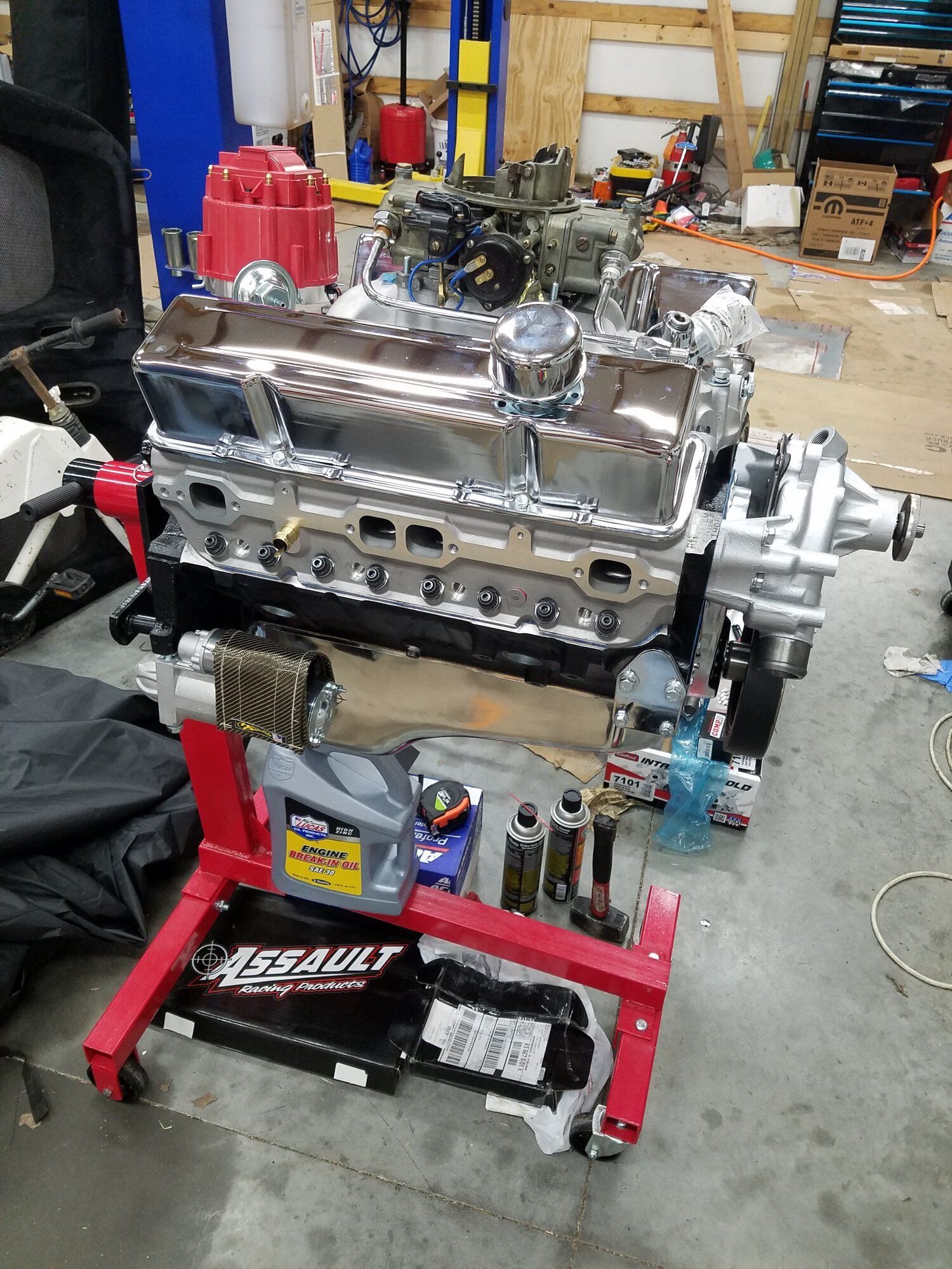

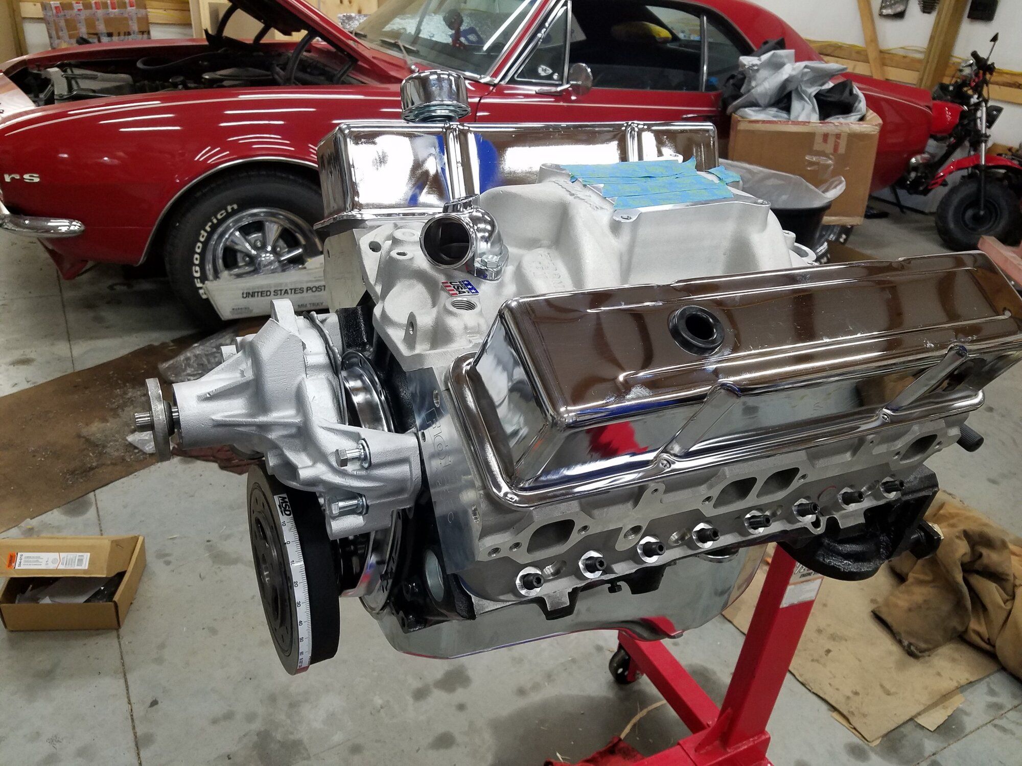

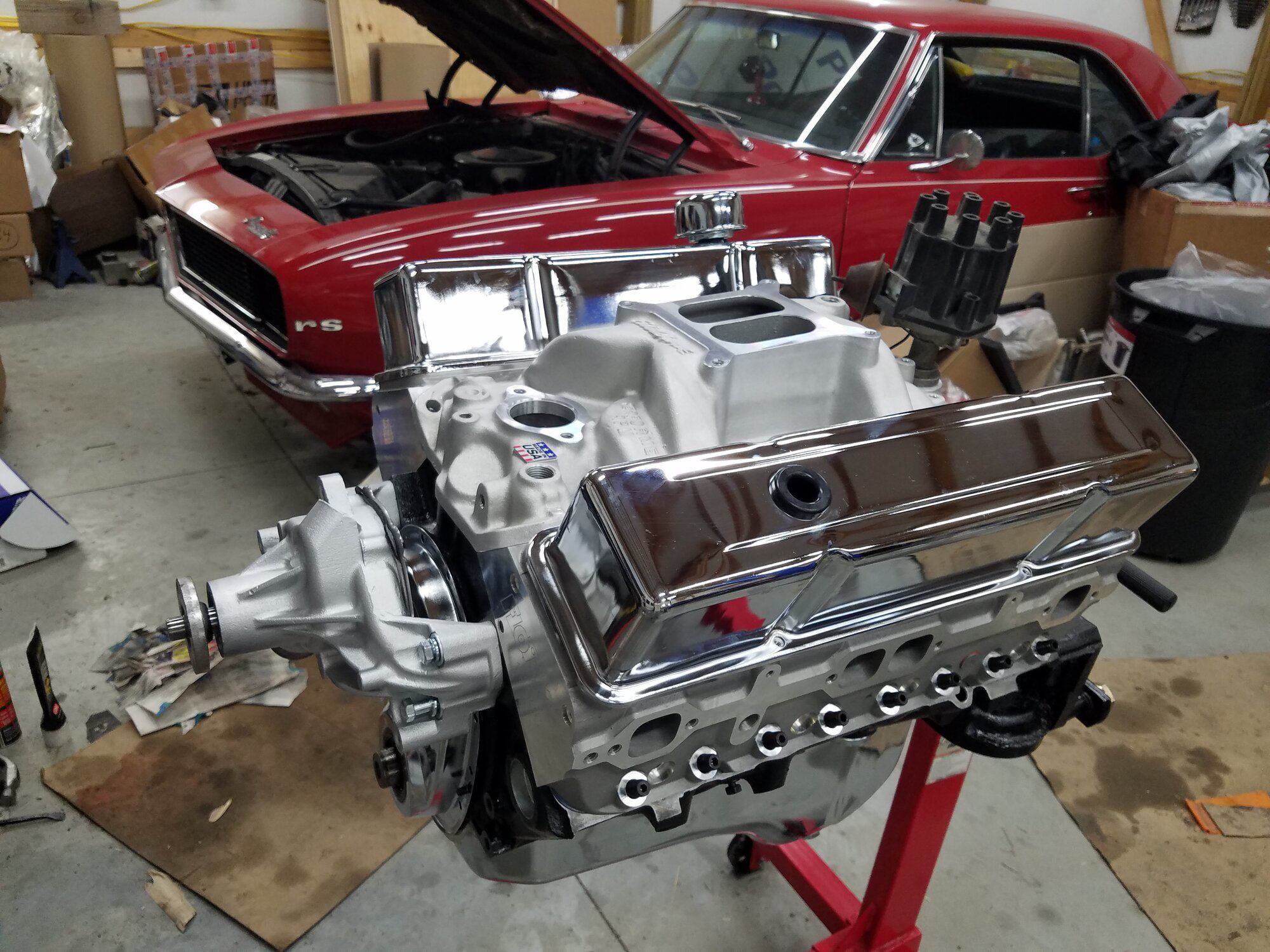

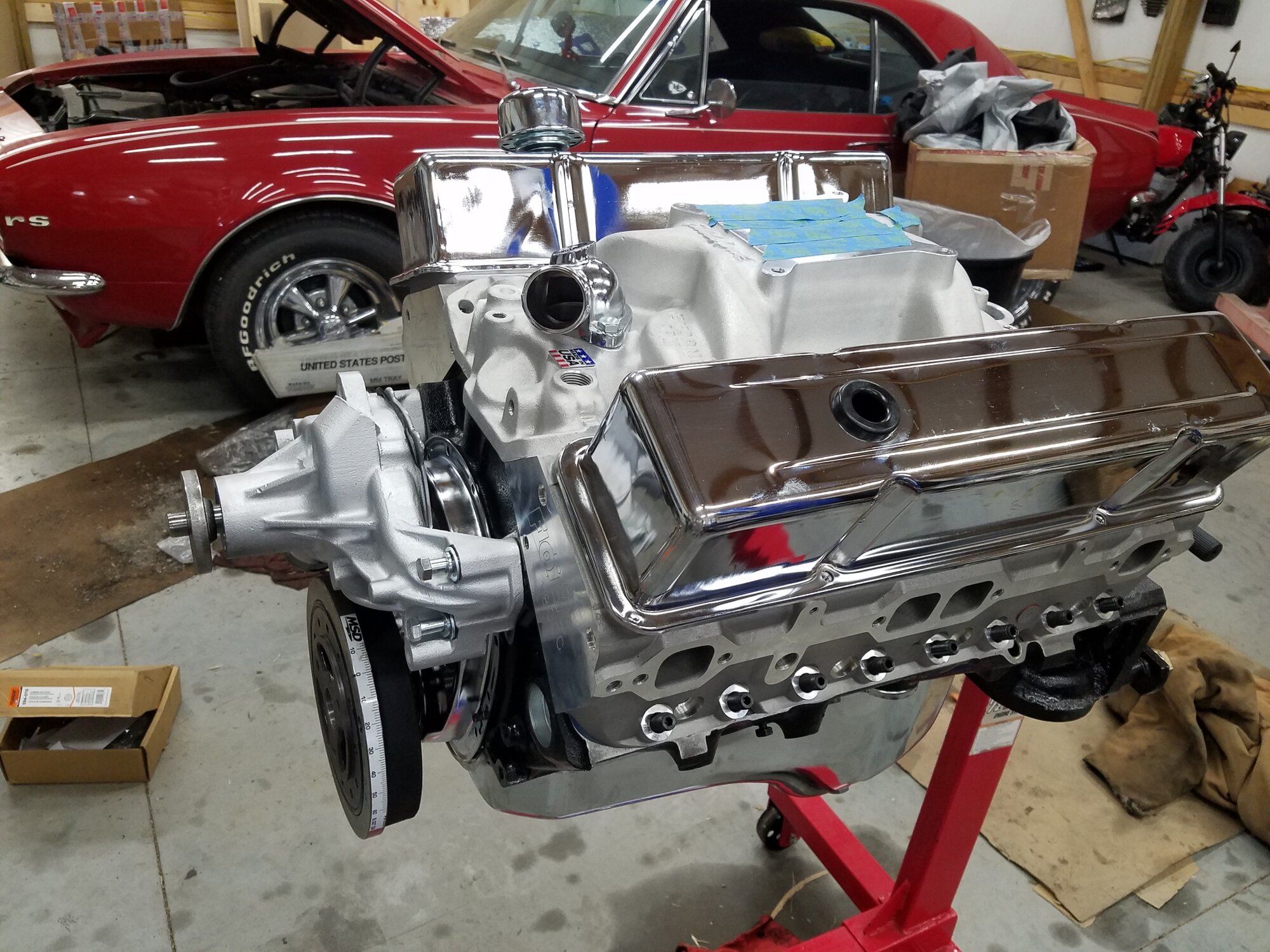

Right? Not a sole will know what is under those cheap chrome tall covers (I had to hack the baffle out of them so the girdles would fit). It will/should look like your typical SBC with bolt ons. I hope it performs BETTER than the typical and pretty sure it will. :thumb:
Thanks for watching it go together!!!

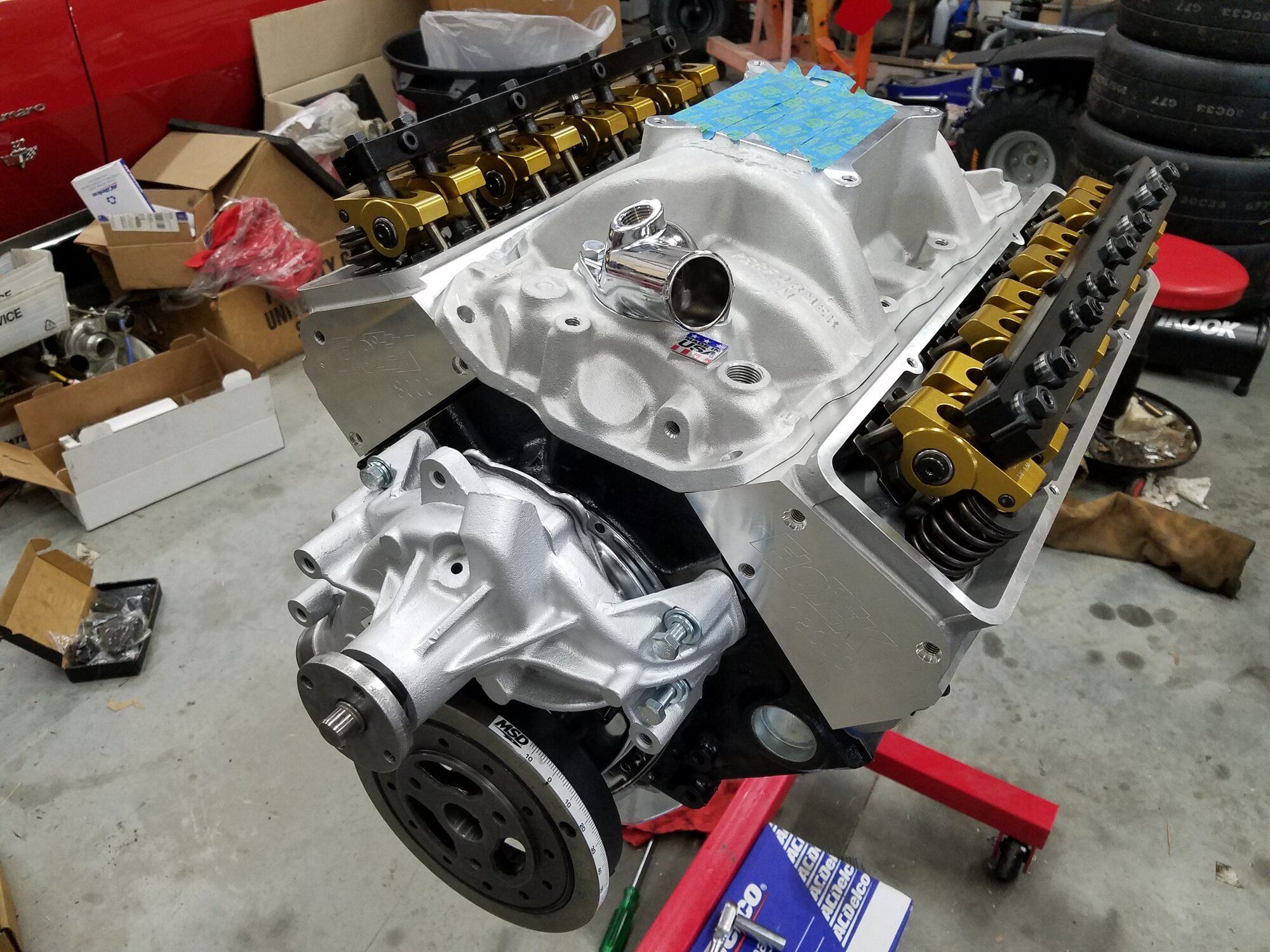

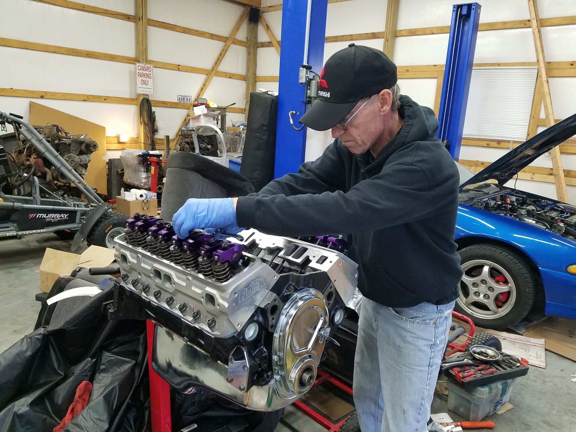

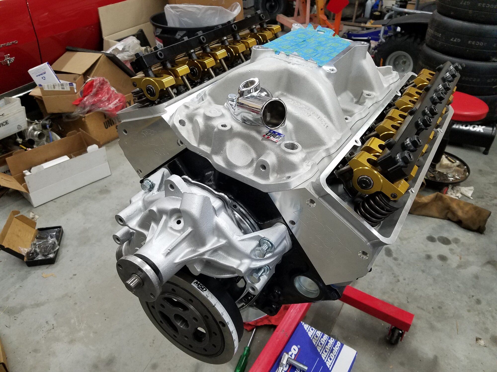

Valves all set using this 2 step method. I visually watched each lifter depress and tought a couple younger guys how to "feel" when a pushrod contacts the lifter buy spinning them as you tighten them down. Good experience for some folks.
Here is what we ended up with after setting all the valves for initial startup.

I have never found a set of CLEAR SBC Valve covers so that expensive stuff can be admired, although this build is another sleeper build for the local crowd hehehehe. Shhhhhh ROFL
Oh that is what we like to do. I might put some duct tape on the car just for "sleeper" effects.

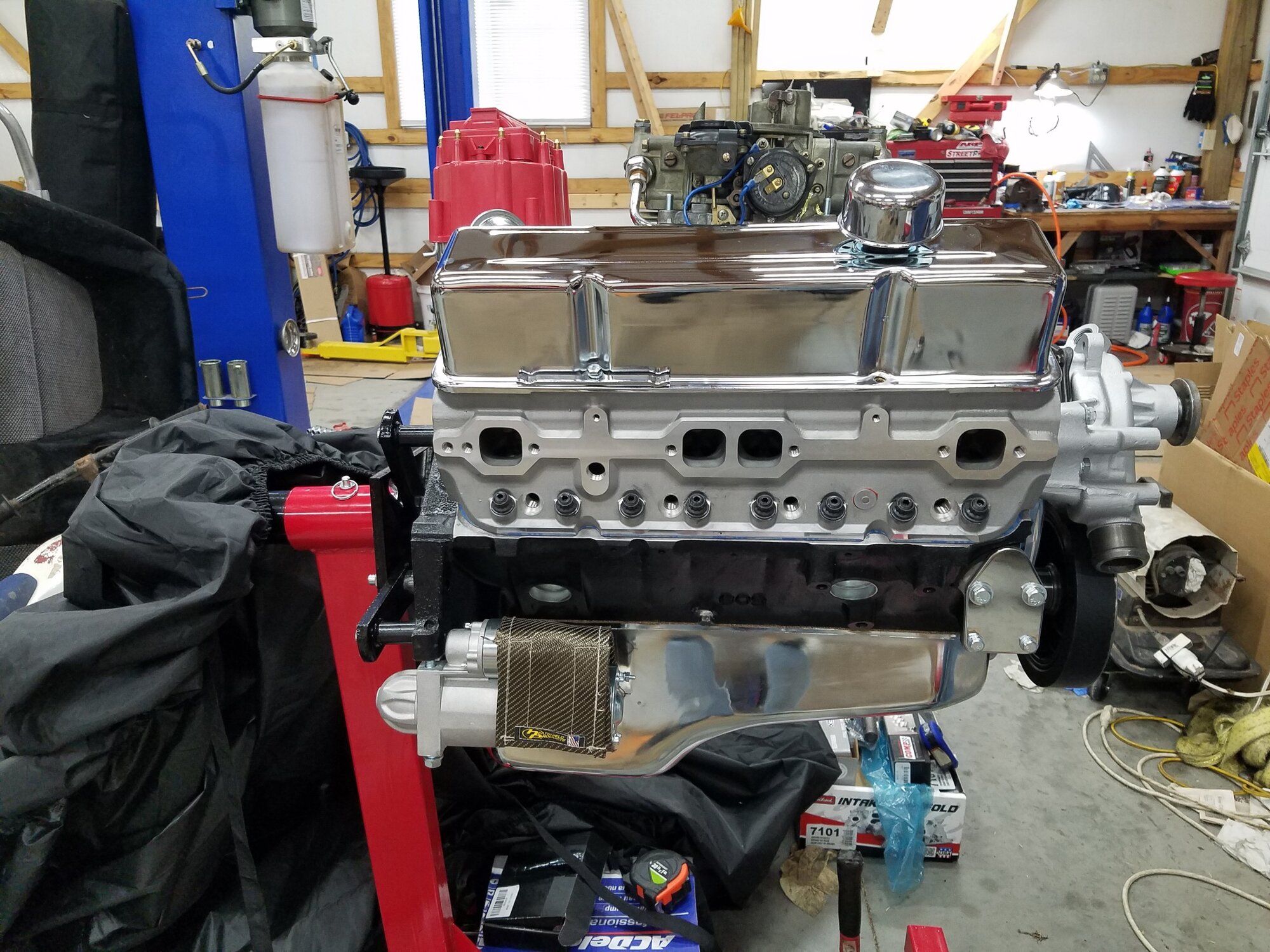

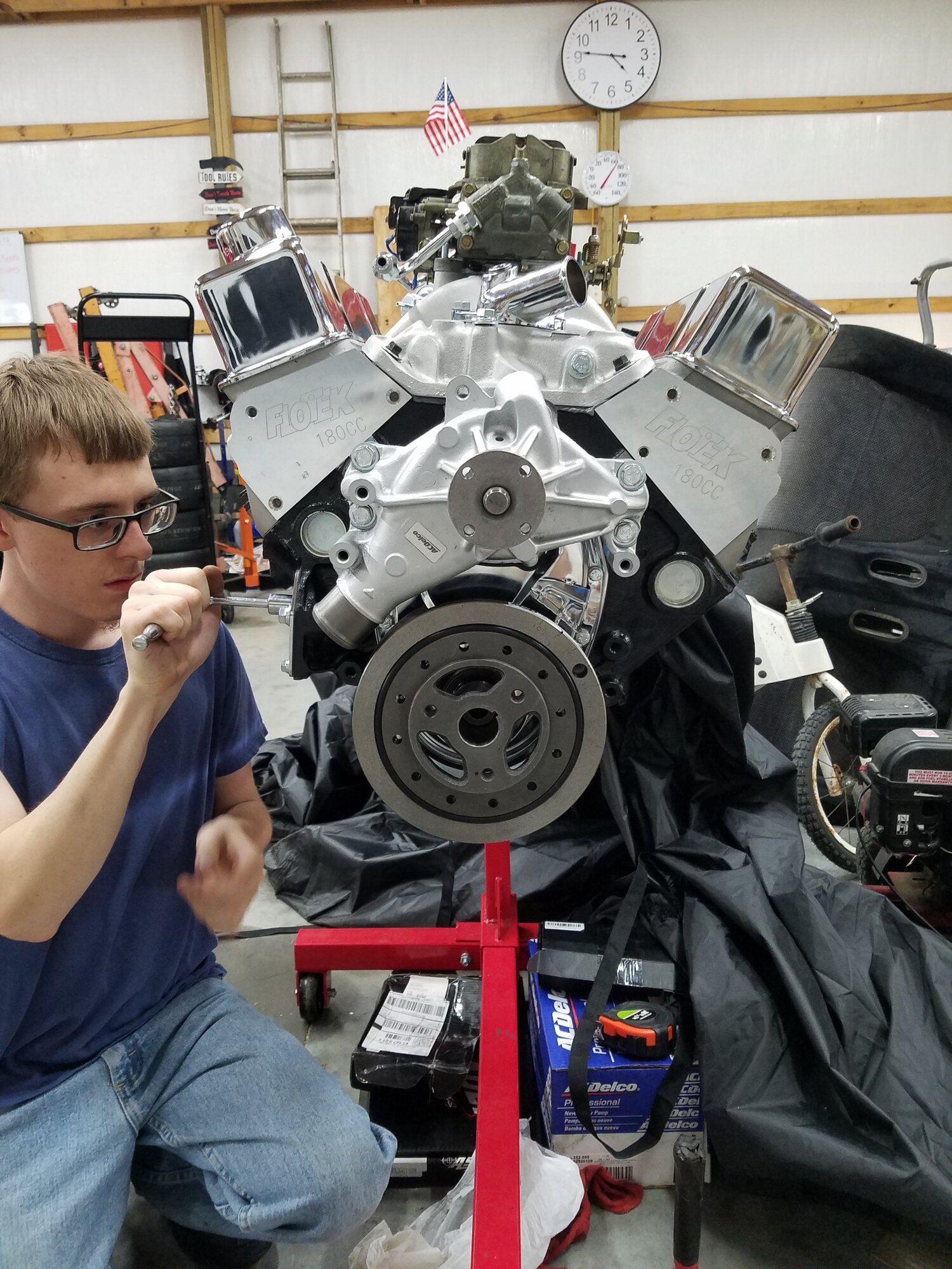

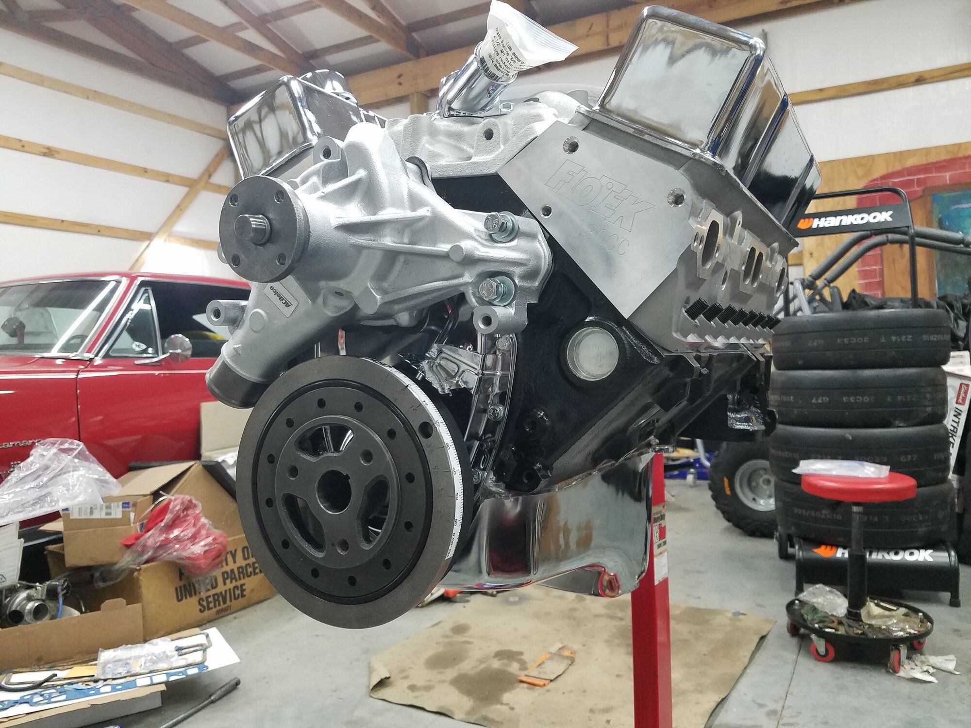

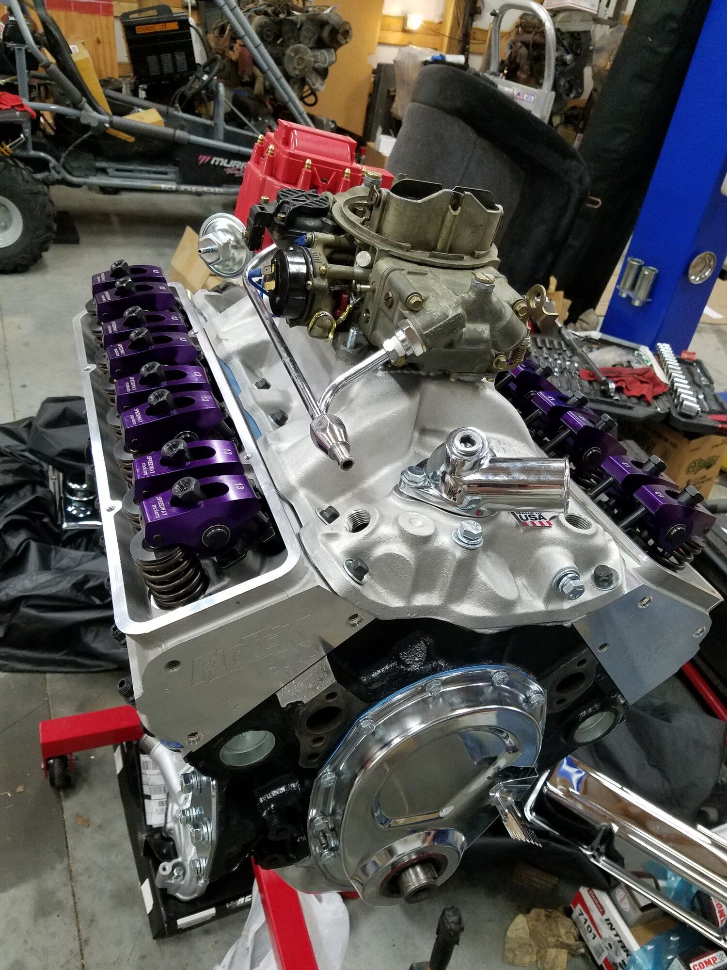

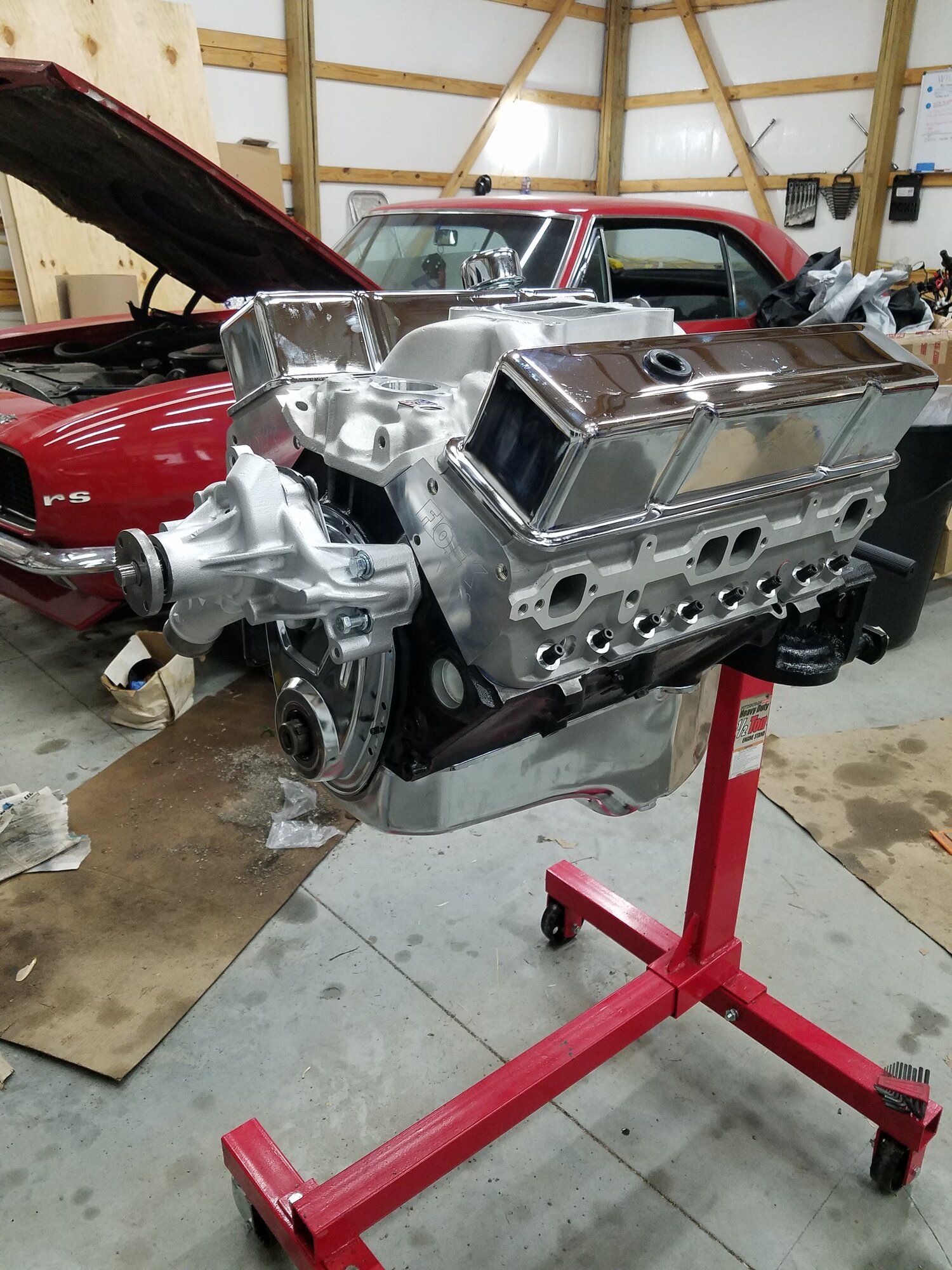

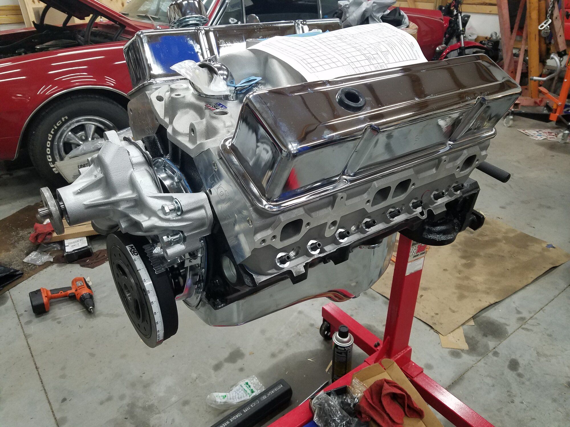

Well, the SBC is done. I need to clear coat the balancer and suck it on and that is just about it.
A few pictures, you can hardly see the block for all of the "bling". The only original pieces are the block, crank and rods.
She sure is pretty, now if she will just do what I built her to do, then there will be smiles in abundance!!! :thumb:
Enjoy and thanks for the encouragement to get my mind off of my DSM transmission to all of my DSM buddies!!!!

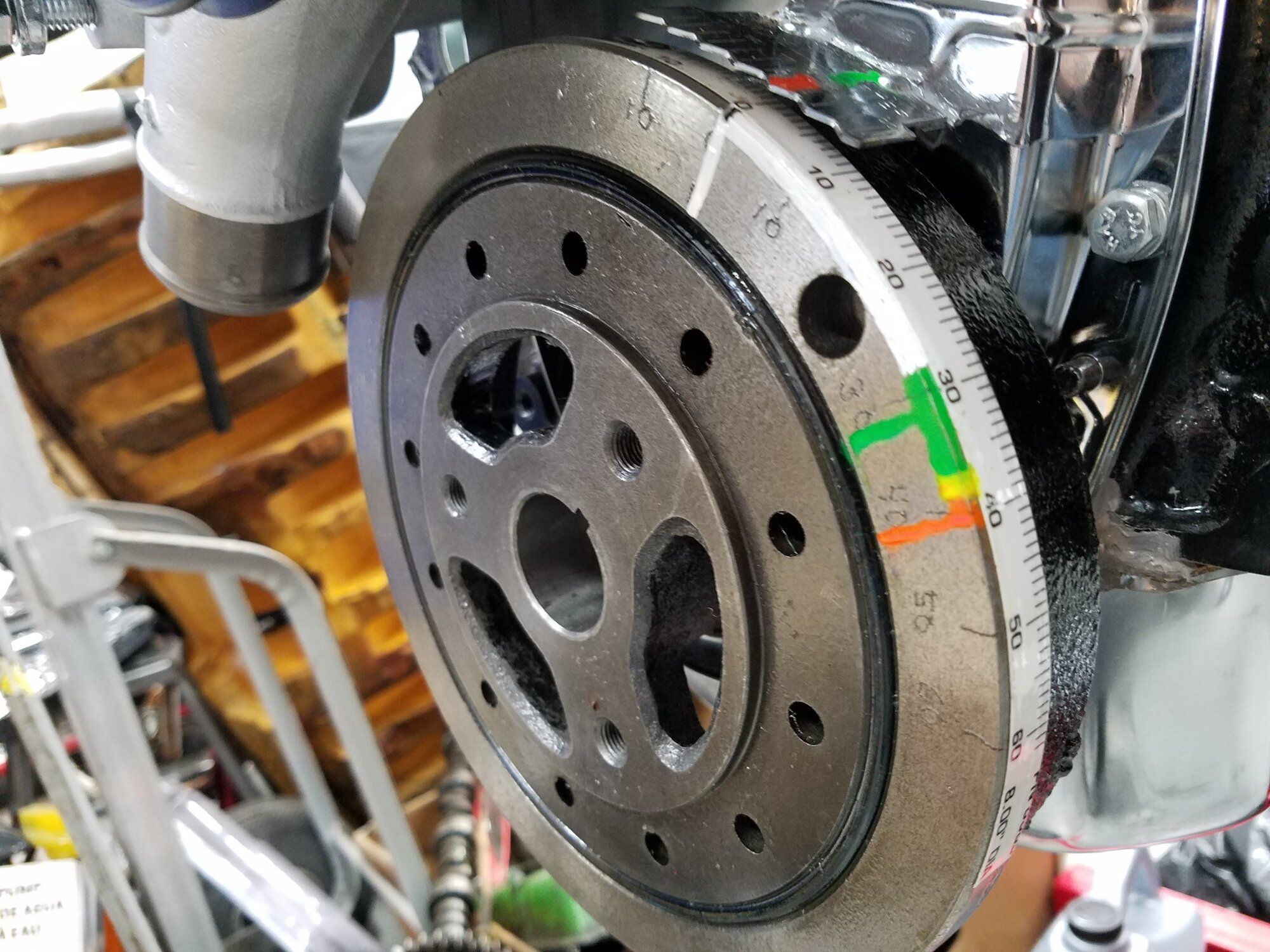

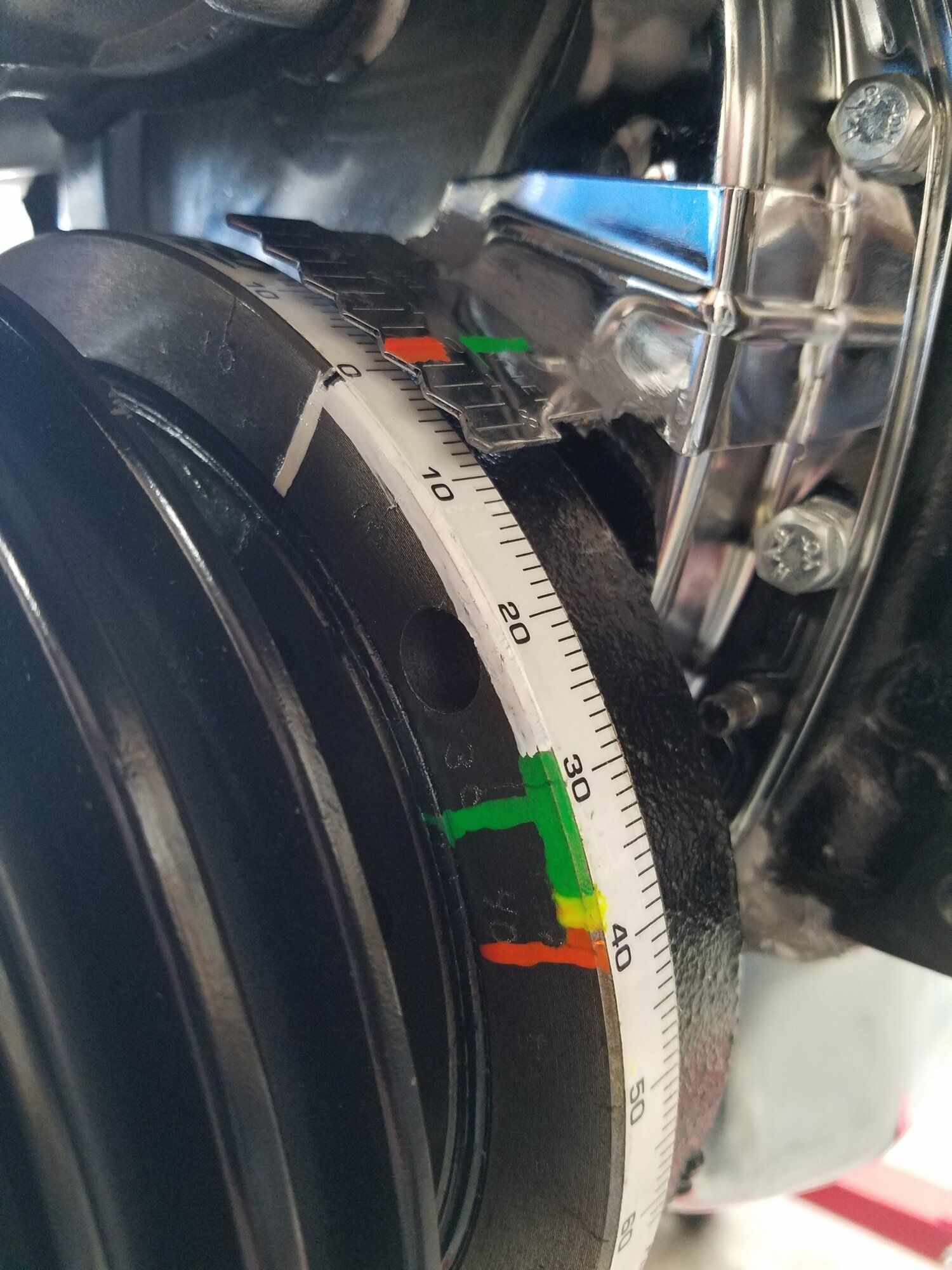

Well I got the last piece ready to go on. I patiena'd the new balancer with timing tape on it with LOTS of clear coat to try and keep it on the balancer. I used 500* Engine Clear so we will all see how it holds up.
Boy I'm busy.......
Thanks for hanging in there with me and my son Trevor on this non-DSM project! (The next DSM project is his Blue 90 GSX) :shhh: Stay "tuned" for more on that!!! ;)
Pops
I decided to put my little "spice" on to the balancer. Now you don't have to look for numbers, just a color but stay out of the RED! ;)
I added a little YELLOW strip in between the Green and Orange as a "Caution Zone" and will post it tonite or tomorrow as an addition to these pictures.
It was just something "different" but will show total timing, which on my Chevys, I always run at 28*-36* when its all in and feel safe about it. Each motor will vary in that range.
I am going to clear coat over the top of that tonite to seal it on.
It will probably be a month before we get the motor into the sons car but its ready!
