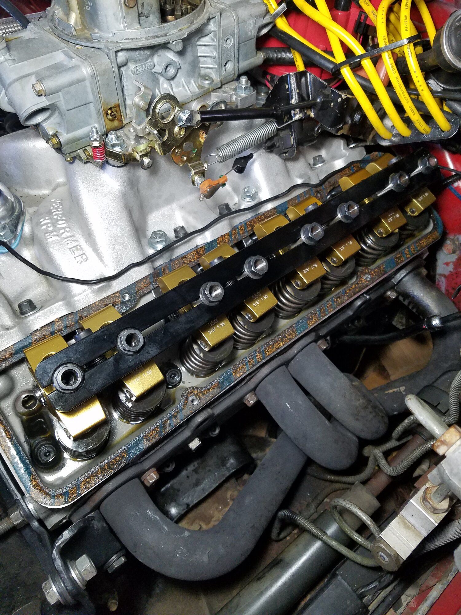

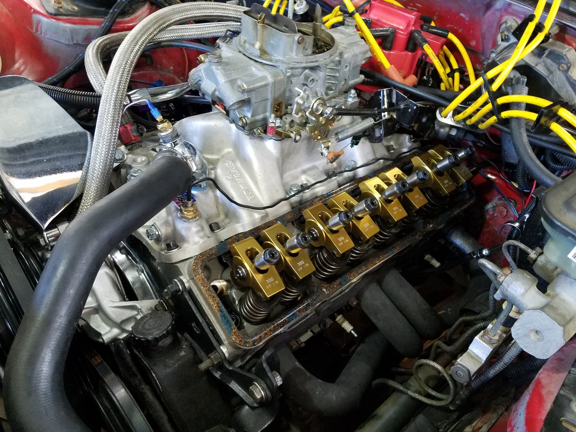

Latest updste on the 6.6L in my sons car.

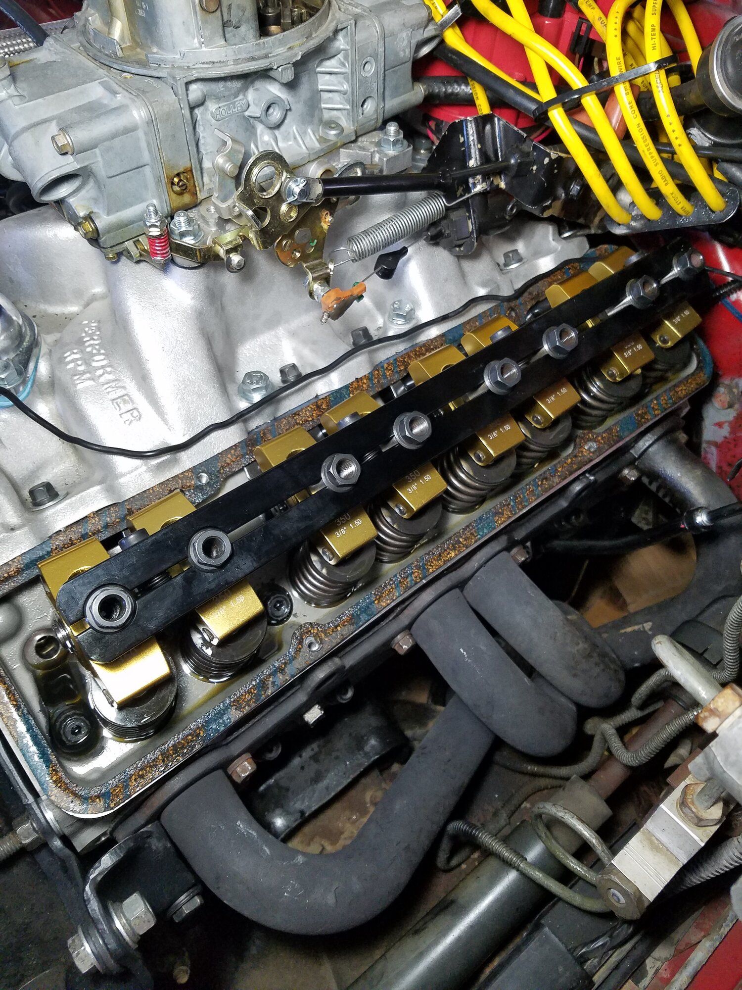

I switched over to 1.5 rockers today and put the stud girdle on. I hope I got all of the lifters adjusted correctly because I'll have to take the girdle off to readjust any of them. Crossing fingers, thanks for following along!
Oil change to 20W50 tomorrow with ZZDP also.

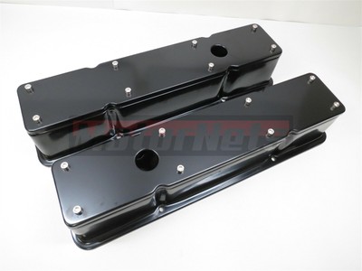

It really is but I've never seen a clear SBC valve cover Larry ;)
I can not recall where I got the valve covers but they came with a removable top and we just changed it out for lexon / plexiglass.. It`s pretty awesome to watch the lifters do their thing and lets you see how well the oil is flowing ..Also lets you do adjustments with out having to remove the valve cover .. Just a thought Marty ...
Ya know Larry, I have made a valve cover just for making adjustments while it is running and it is pretty much what you just described. I cut out the middle and have a piano hinge on it to open it up.....but you can't see thru it, it was an old tall chrome valve cover I had laying around. That set of VC's that you are pointing out are pretty cool and no baffle for me to have to hack out in order to clear the stud girdles I use either......but I see they are out of stock now. Dang!

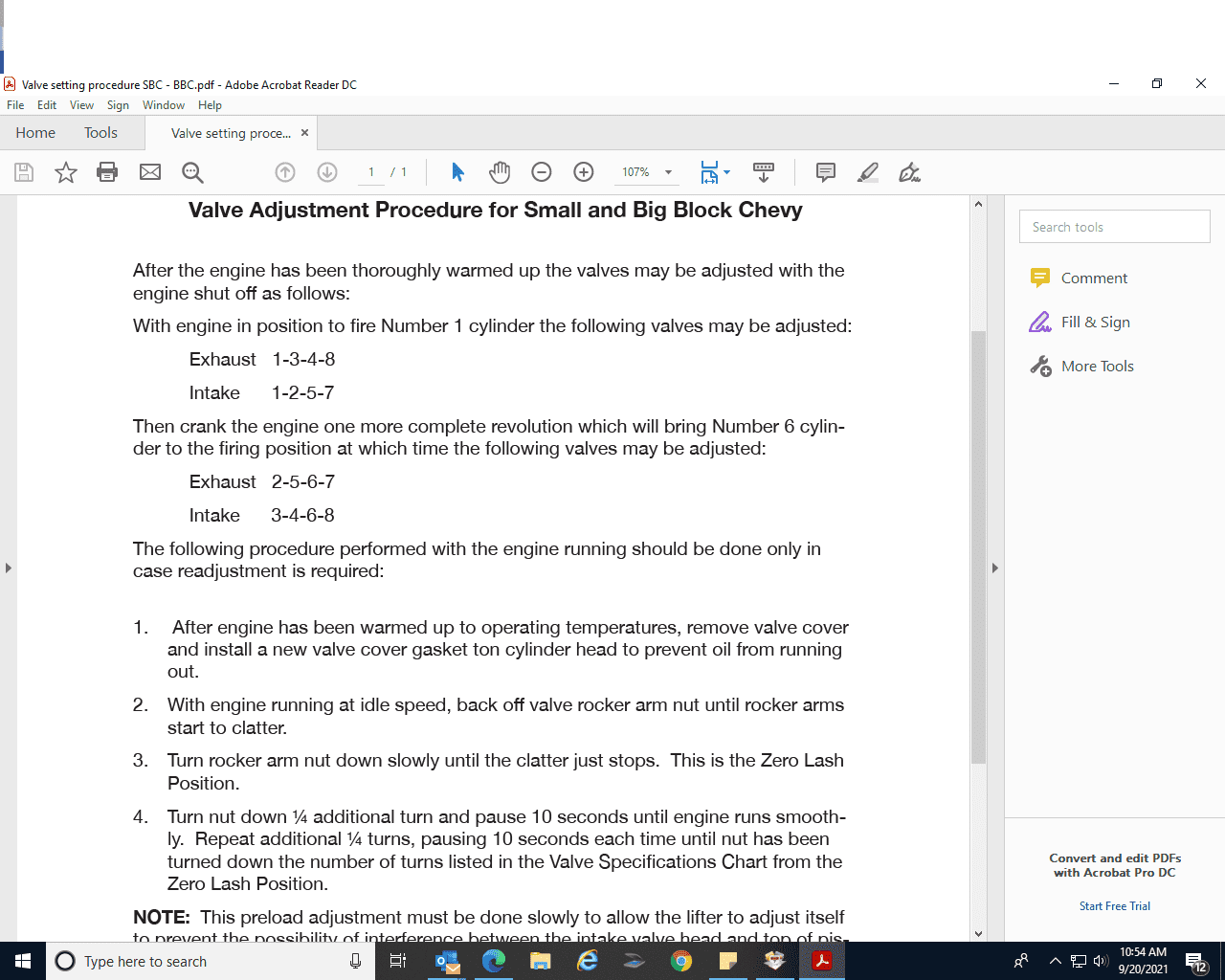

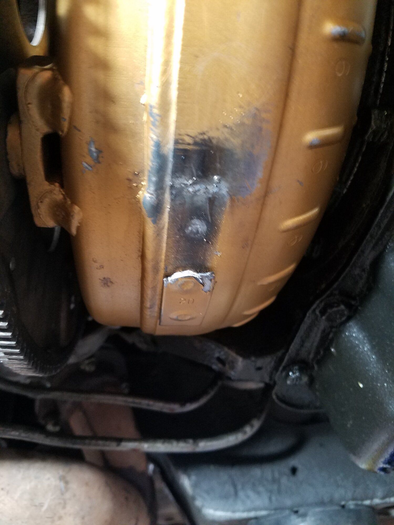

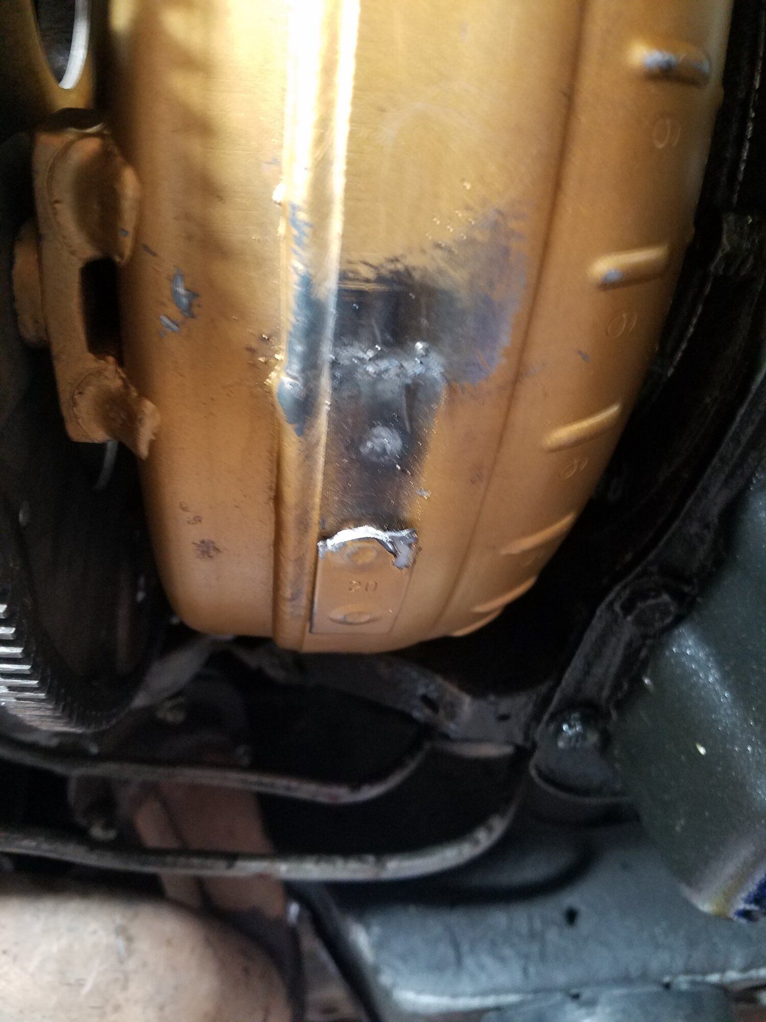

Now I set the valves when the motor is off but on TDC or #6 on TDC and so far, so good. No ticky ticky ticky going on. BUT....that torque converter weight that we welded back on......IS GONE NOW.
My son is going to call the company about that to see if it will wear out a front pump seal on the new transmission.

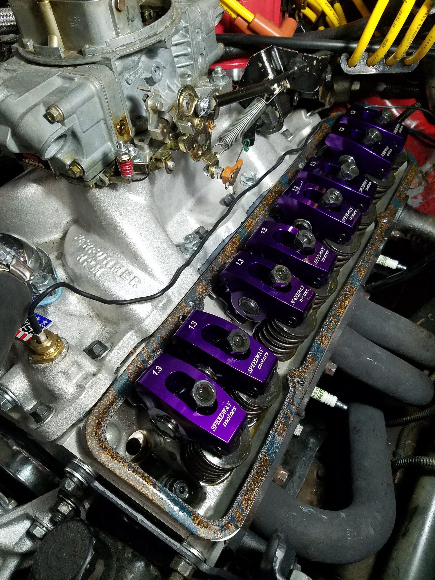

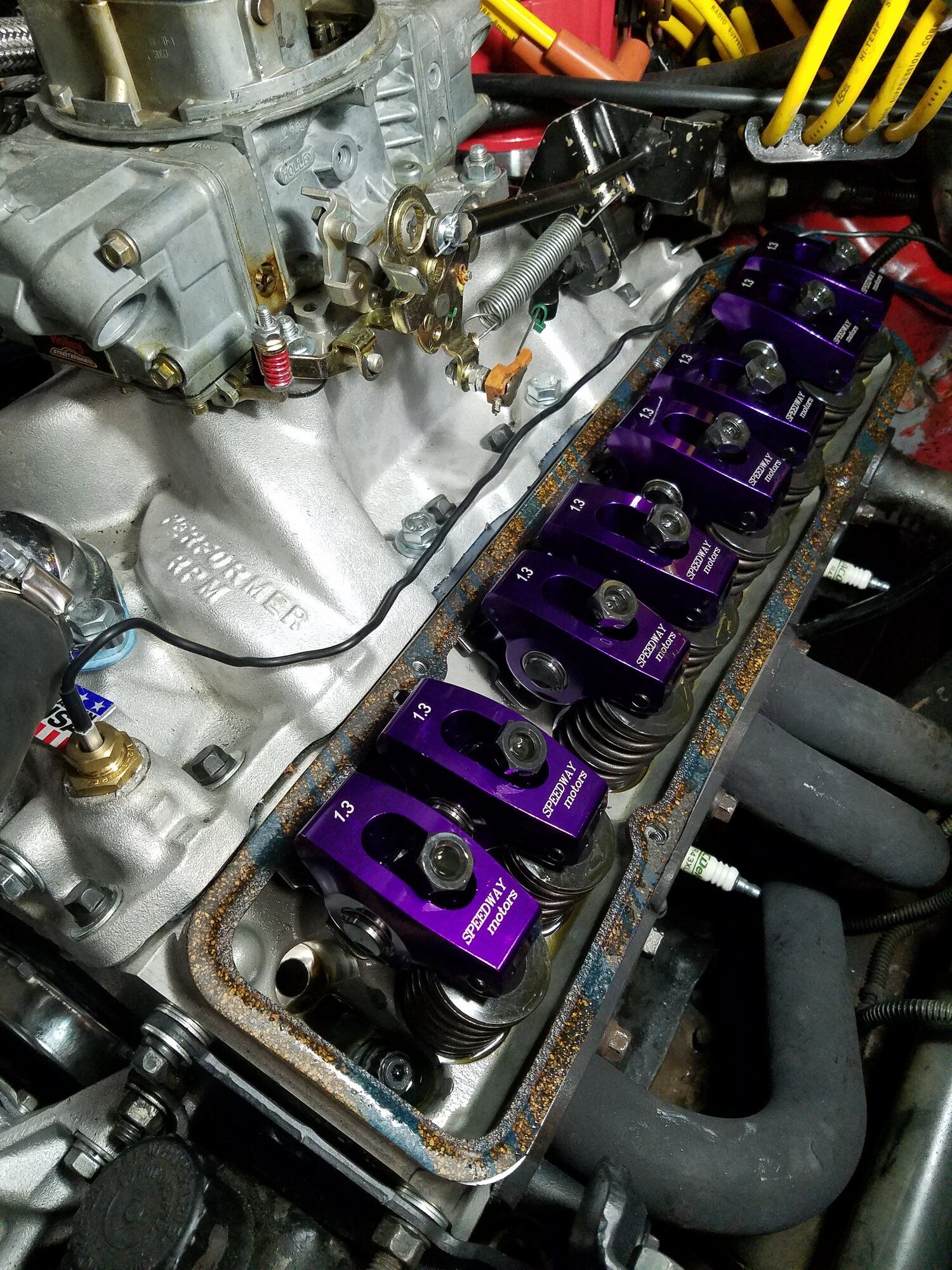

I just use this procedure now for valve lash adjustments like I did Saturday when I swapped out the rocker arms. I prayed to the engine gods for no ticks after I got them all swapped and adjusted and so far it is nice and quiet. :thumb:

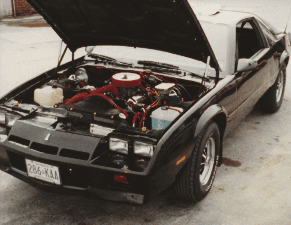

Back in the day I had a 1983 Camaro 2.8L but don`t let that fool ya.. A great machinist here in my home town built up a little stroker motor out of that motor.. I swear it ripped...I could blow the doors off the 305 HO Irocz....and the stock 350s ... At car shows they never did any thing for the kids so I would build a 1/18th scale model of my car and give it to the lucky winner. I had this crazy microphone hooked up to my stereo so the kids thought the car talked...I had the wire running under the car and would stand close enough to hear their question but they could not see me . They would drag their parents back to look at my ride.. I got many votes that way... LOL Ya I know it`s a bit ricey with the pink but I dare to be different ....

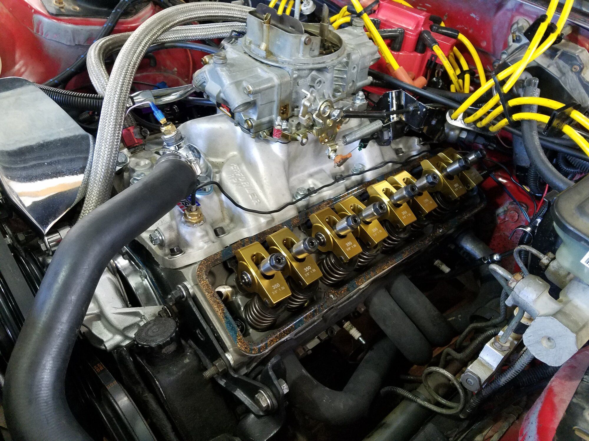

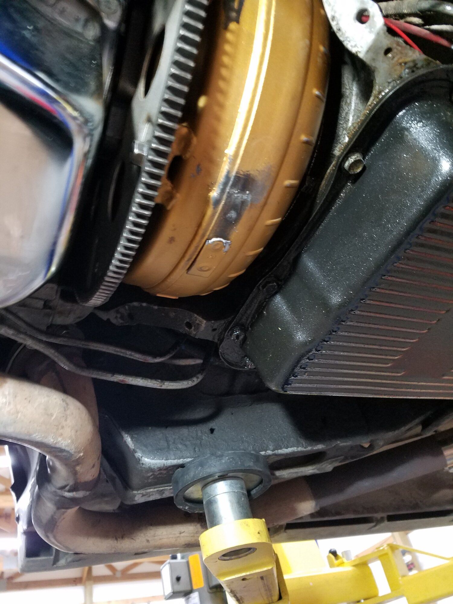

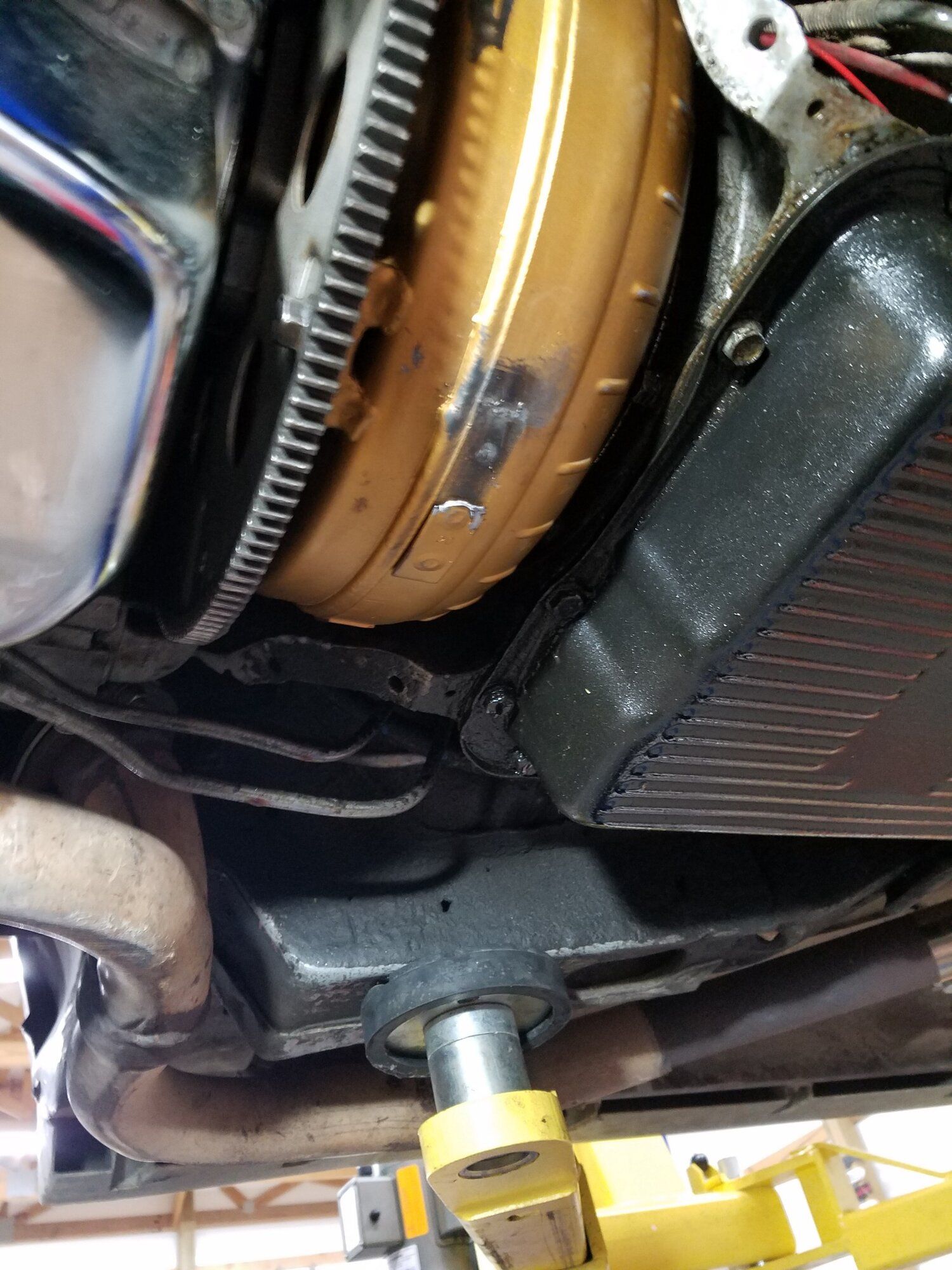

Hey, here is one thing that I forgot to share.......Went to change oil to Lucas 20w50 Breakin oil and look what we saw NOW.........HALF OF THAT WEIGHT IS GONE. :hmm:
Will it effect the front pump seal? Will it be out of balance with fluid running around in it?
Wouldn't it be a bicth to have to take it all back apart? My son is going to contact the company with at least a complaint.

Dang Marty that sucks. Do you have any theories on how the weight broke off?
I would think with that weight screwed up like it is , will take out your rear main or cause internal damage to the transmission.. But you already know that right Marty...
Wish you lived close cause my buddy could weld that back on and balance it on his lathe ... ;)
Yeah the whole process of removing the motor....AGAIN just to take it out and actually warranty it is a real big hassle. My son talked to the manufacturer yesterday and they are talking about what it will do and what they are going to do or suggest. Thanks for the concern and the thoughts on if it will or won't effect the trans or motor!
If they could figure out what size weight that was and send it to me, I could make a new one work by cutting it in half (which is about what is missing) or take off the whole weight and tack the new one on REALLY GOOD!
Marty
Glad to hear that the manufacturer is working with you on a possible fix .. Would be nice to get her up on a hoist and drop the tranny rather than pulling the motor and all Working with your son on this car brings back fond memories of my Dad and I ... Good luck
It would give me a reason to use my NEW TRANSMISSION JACK! Not that I really WANT to, but at least I have one. If they will pay labor, I might just do it, as long as they pay ME - Wilson Engine Shop. :cool:
Well the torque converter company said "It is under warranty, just ship it back to us"..........Sounds real easy huh????
I asked the son to have them send me a weight. If he wants to warranty it, he can but I am not partaking in that venture.
