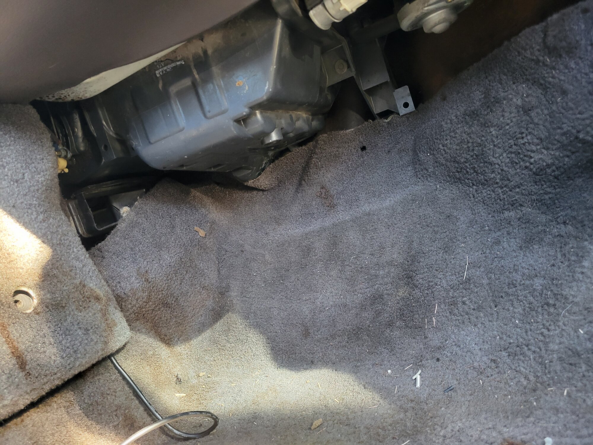

Has a water leak everytime it rains it &seems like water is coming down the driver and passenger kick wells or the fire wall. I am assuming it's the cowl seal at the bottom of the windshield which is causing it or door seals. Going to put some silicone in there or a vacuumed line i slit the long ways. Idk if the vacuum line would work or not. I do have new door seals to put on I just need the clips that goes from the seal to the door.

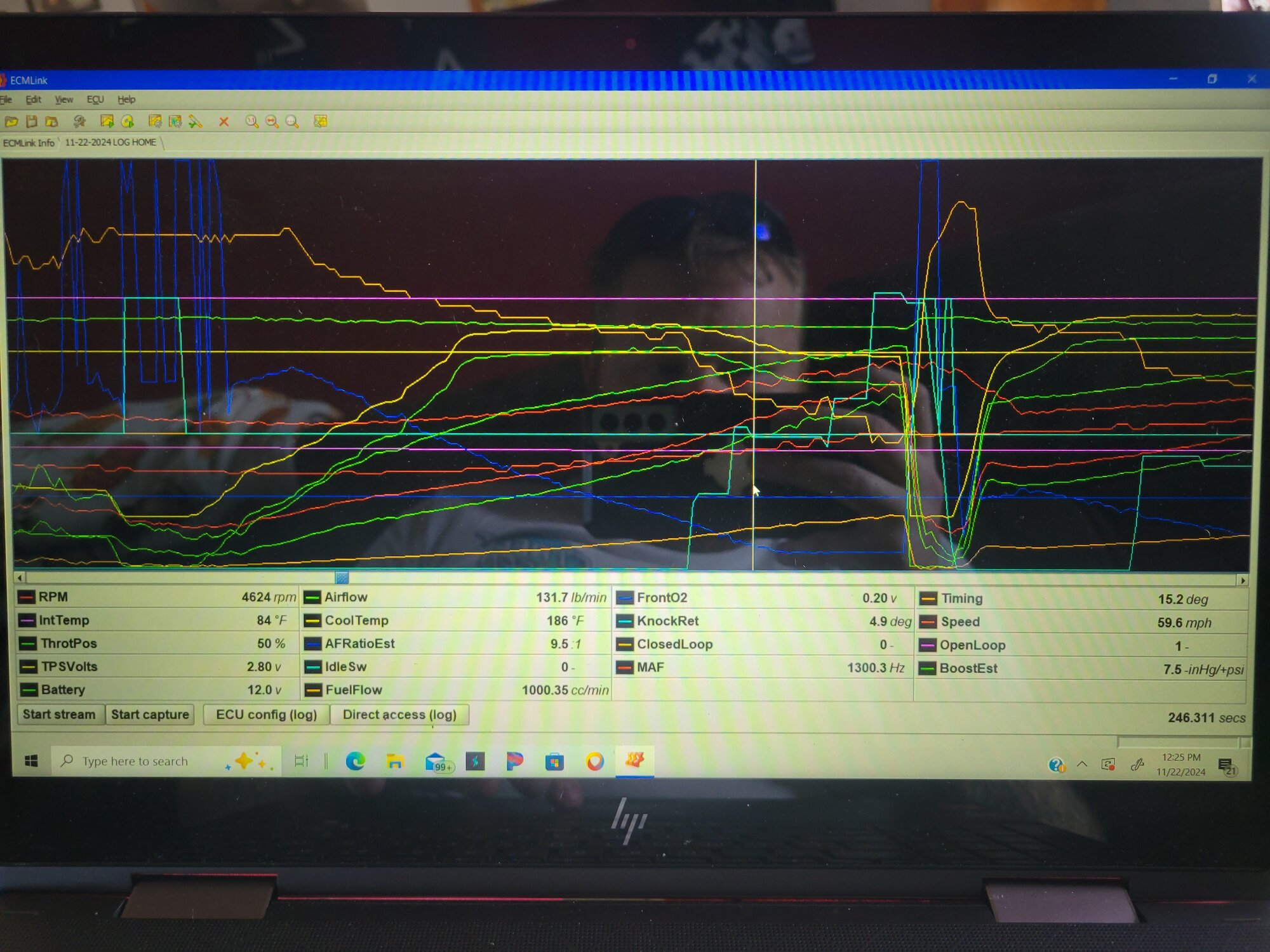

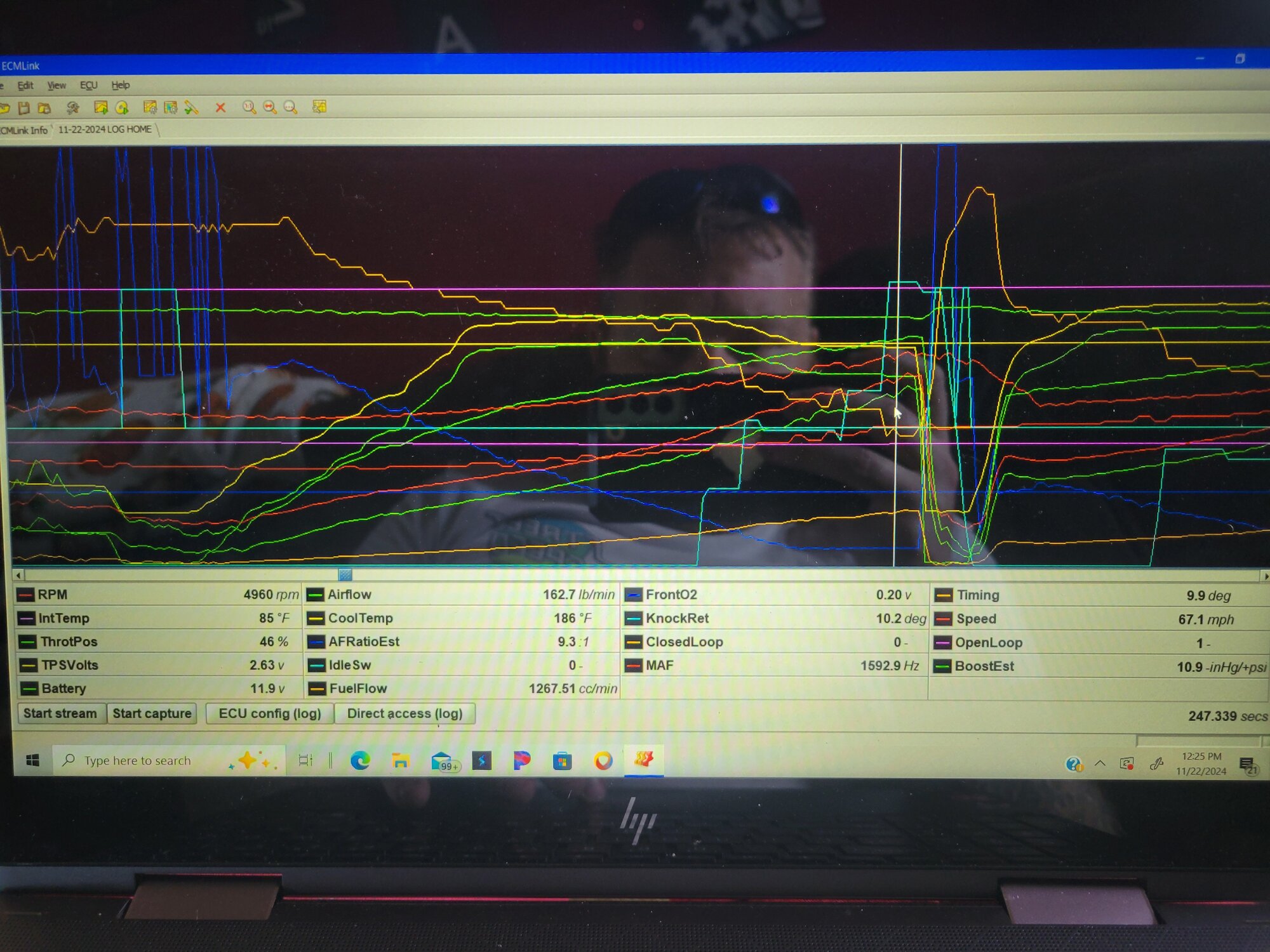

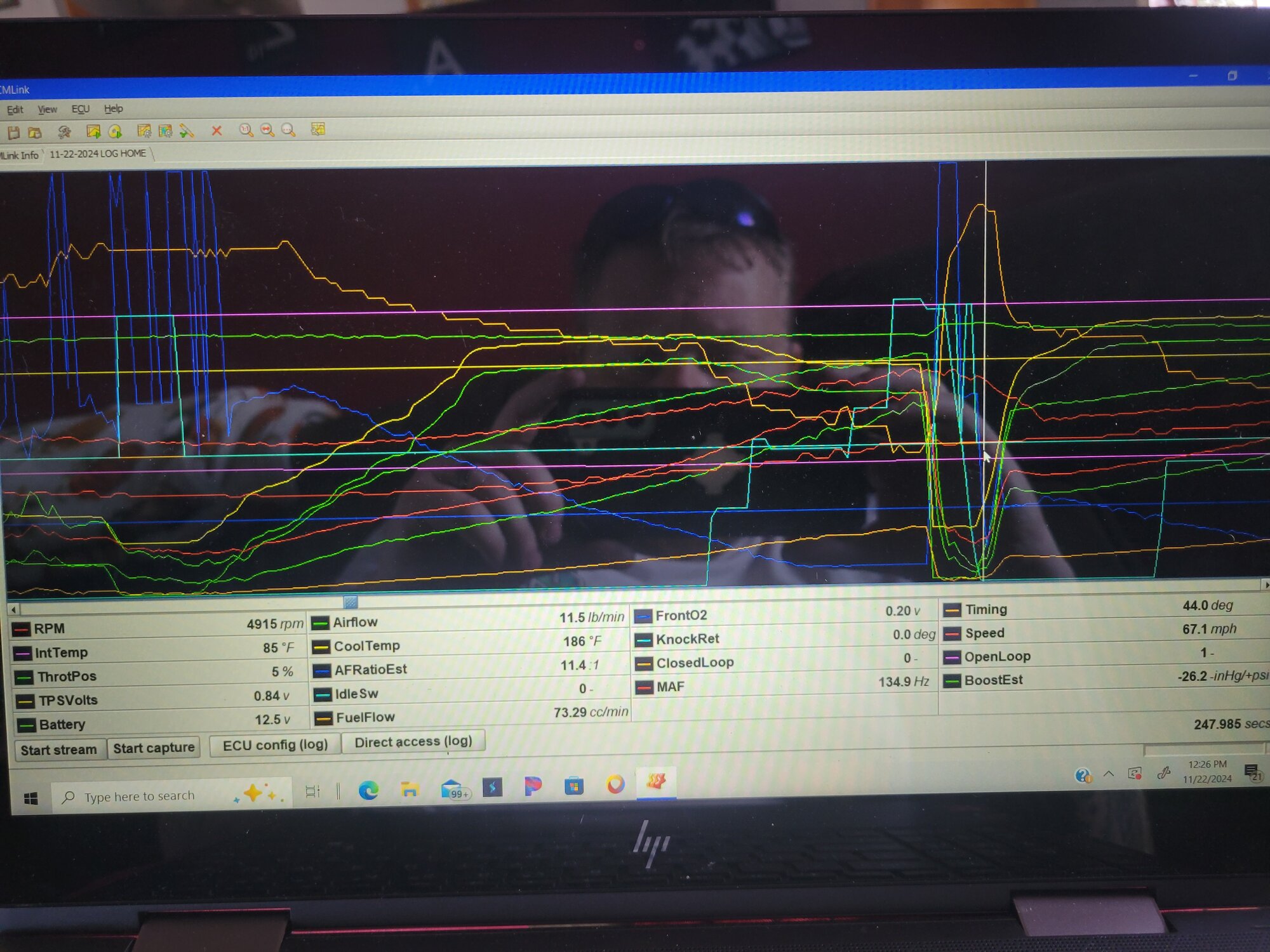

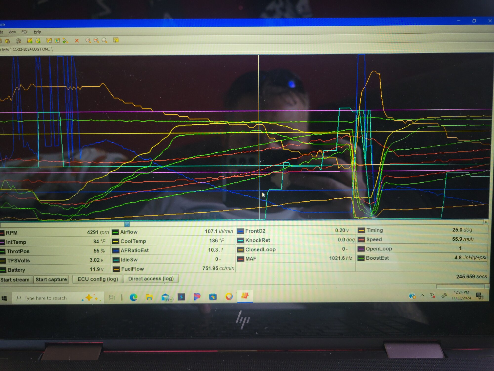

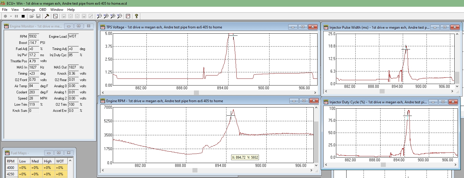

You're not flowing 162 lb/min. That would be like 1300-1400awhp. Your battery voltage drops significantly, and your AFRest is like 9:1 at once point with only 9* of timing. I'd wonder what your wideband reads when this happens. I haven't looked at the log, but I'd bet your voltage is dropping below 12v at WOT and as a result you're going lean. But the ECU thinks it's rich and keeps pulling fuel.
Someone smarter than me and more prolific can look through the log but the voltage being 11v at some spots is worrisome.
Are those stock injectors flowing that much? The car dosnt have a fpr & is on stock fuel pump unless dude put one in, so i am sure it is stock 450cc injectors also. I do have 1000cc injectors & a walbrol 255 fuel pump in the garage to be put on eventually tho.
I think stock injectors, yes.
Because I found a log from December 2008 when my car still had the stock injectors, stock fuel pump, stock FPR, and stock ecu, and for maximum beauty it had literally the same MAF that you have on your Talon right now.
So here's a partial shot of my log with the cursor at a spot where the conditions are:
inj duty cycle = 85%
inj pulse width (On time) = 17.2 ms
MAF Hz = 1827 Hz (look at MAS In and MAS Out in the engine monitor)
RPM = 5932

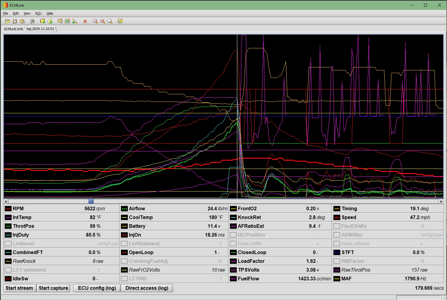

Now look in your log at 179.669 seconds:
inj pulse width (On time) = 18.26 ms
MAF Hz = 1791 Hz
RPM = 5622
It's about as close to the same as you could get between 2 different cars.
Main difference is you got yours at about 300 rpm less than me. That's not much and it might even be because mine was in 1st gear and yours was in 2nd gear. In 1st gear it's harder for the turbo to keep up with the engine because revs are climbing so fast.
I don't have a wideband gauge for it. I thought the voltage was pretty low. The voltage should be at 14v while running I believe. Well hopefully thr voltage dip is causing into act weird and will be resolved with a new alternator. I can always use the alternator on the eclipse and see if thay changes it and puts my voltage up n toward 14v and eliminates the knock going above 5 degrees. I am learning all this stuff so tha k you guys for helping! I greatly appreciate it.
Were on boost- It is pretty cool it is the same MAF because you helped me out with getting the car running and driving with your maf and knowledge. With our cars being pretty close to the same in the logs, is that saying there isn't anything alarming causing the knock to retard timing? I know when voltage gets low it can do some weird things.

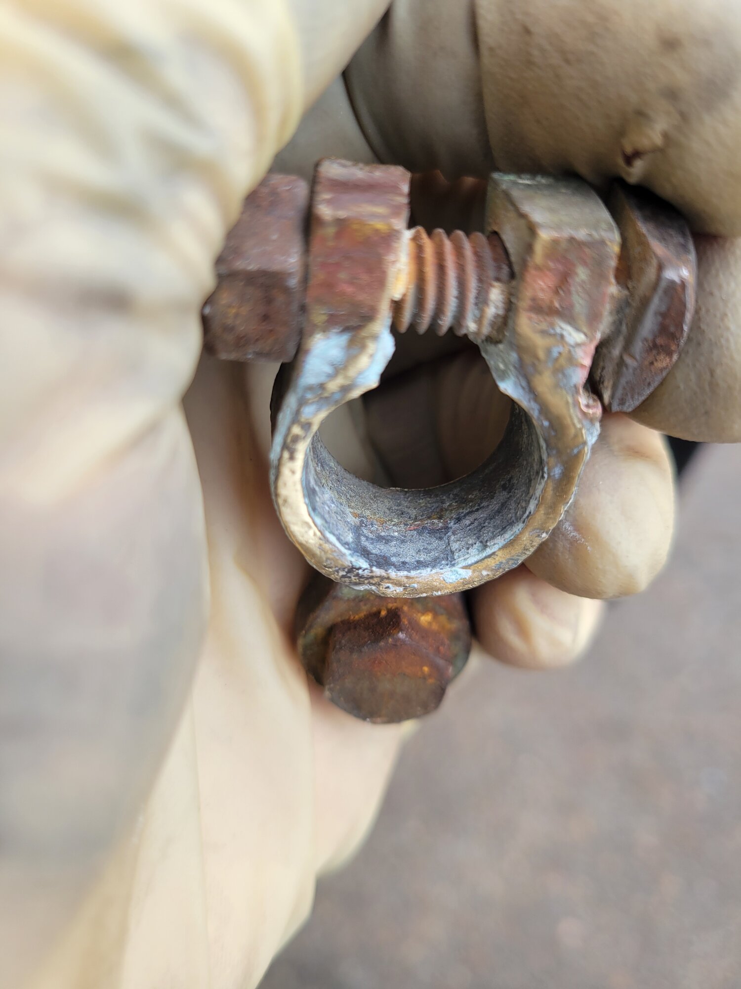

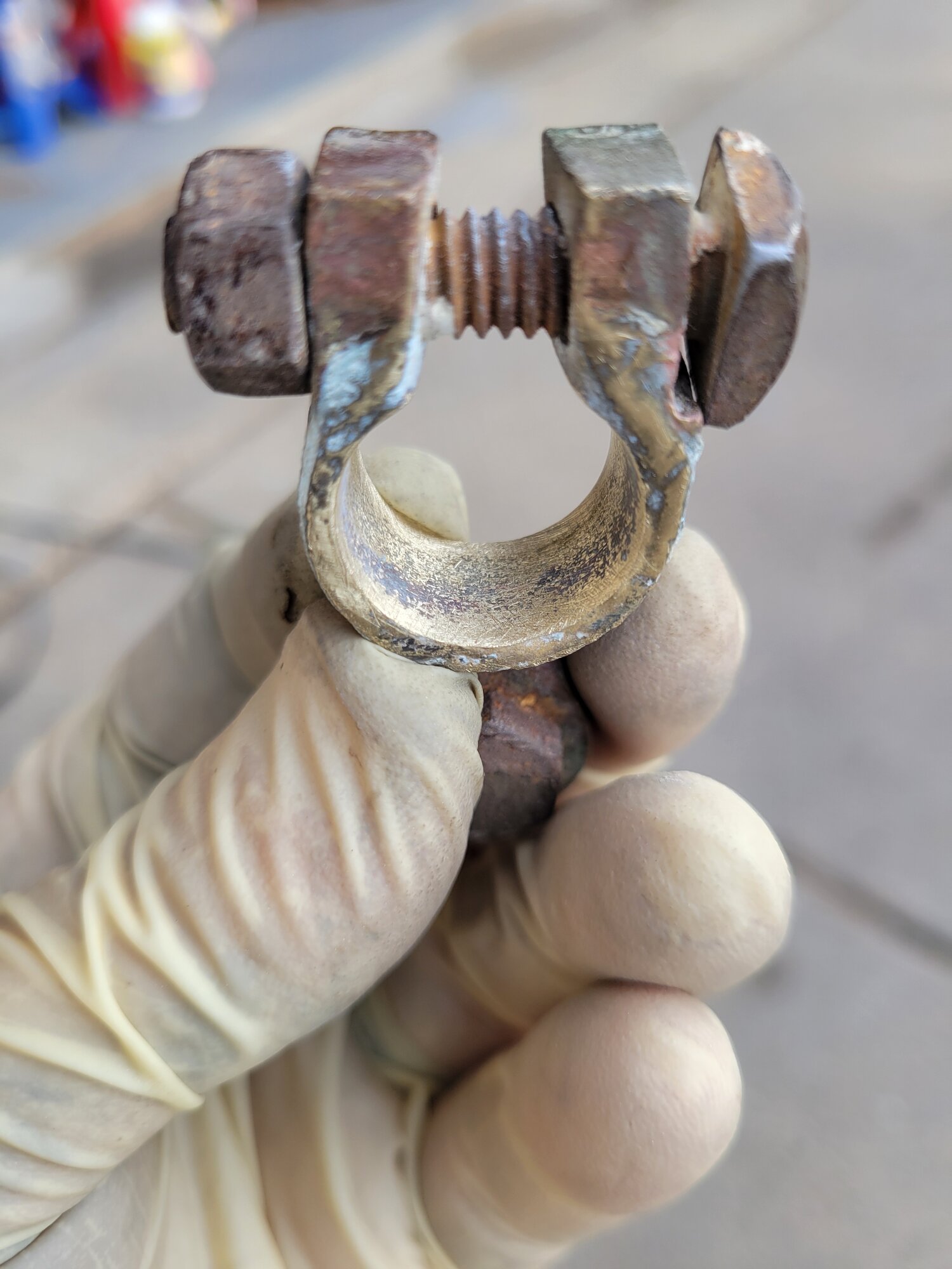

Here is a before & after of the battery terminals and I also cleaned with a polish pad on a dot co the battery cables and the battery post themselves. so everything is nice and conductive now. The battery has been on the charger and will put it back in the car tomorrow and go for a drive to see if that helped with the voltage issue.

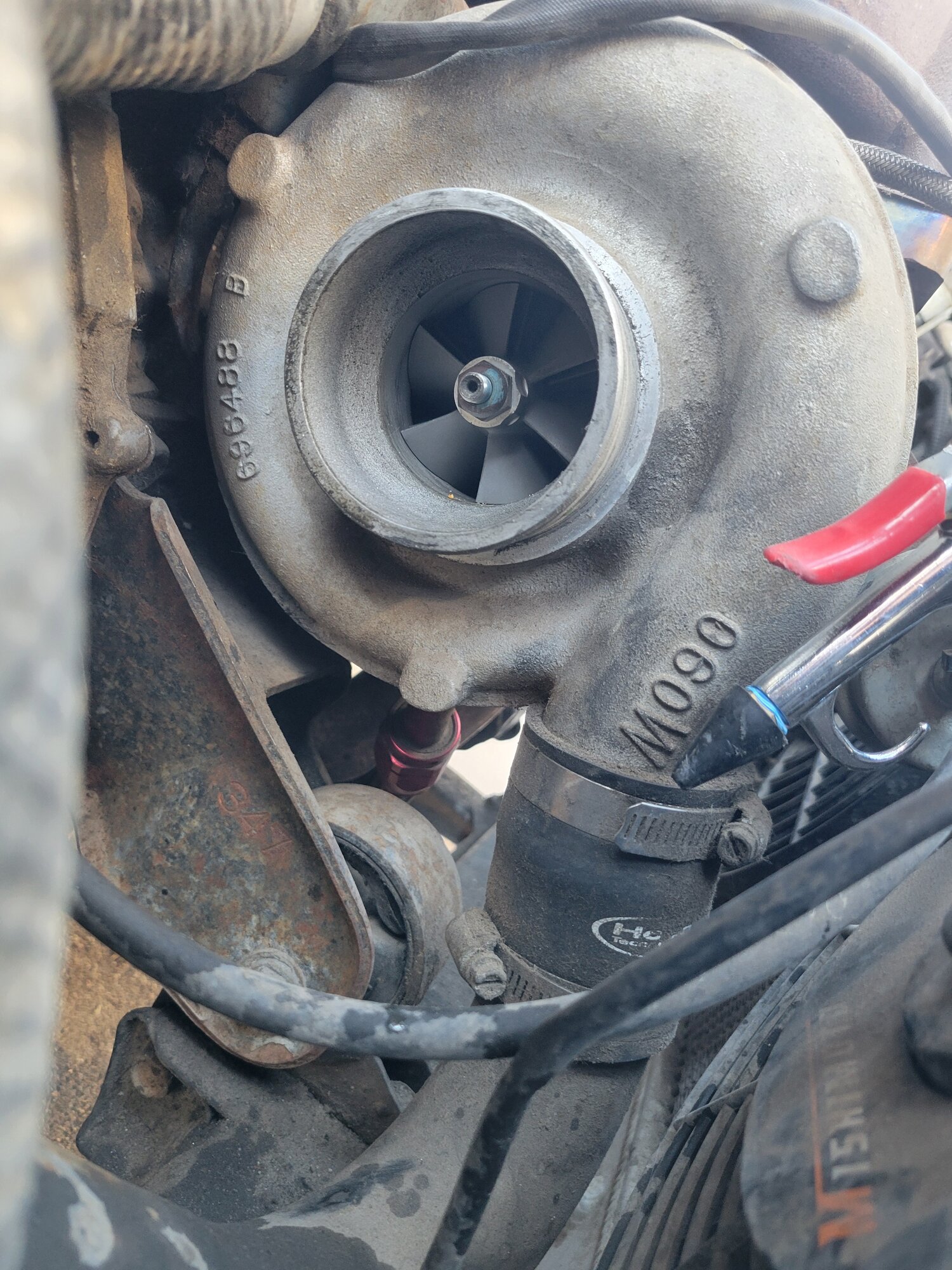

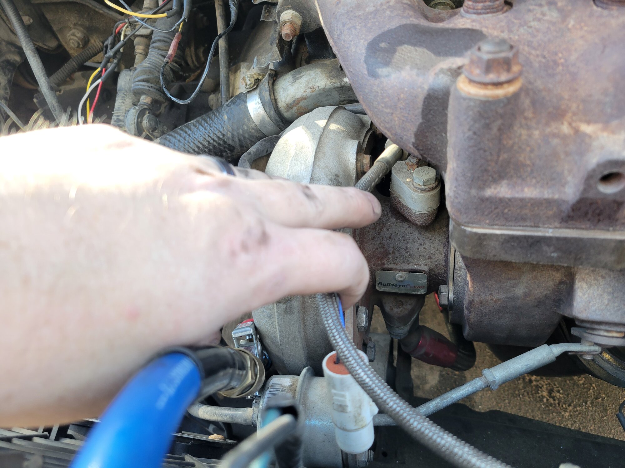

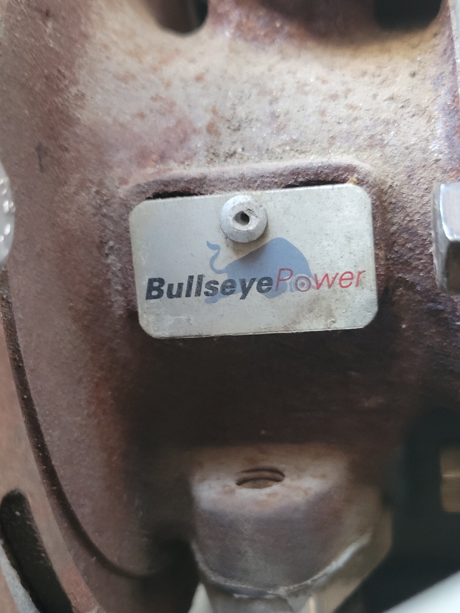

While I was there figured I would take a pic of my turbo as it's one that is a older one but still very low miles. It is a Bullseye 57 trim turbo.

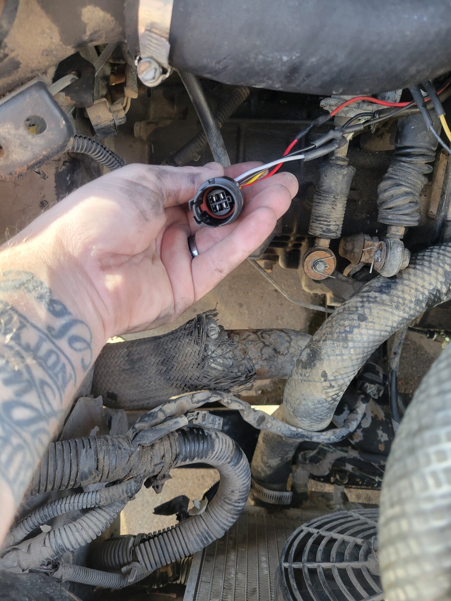

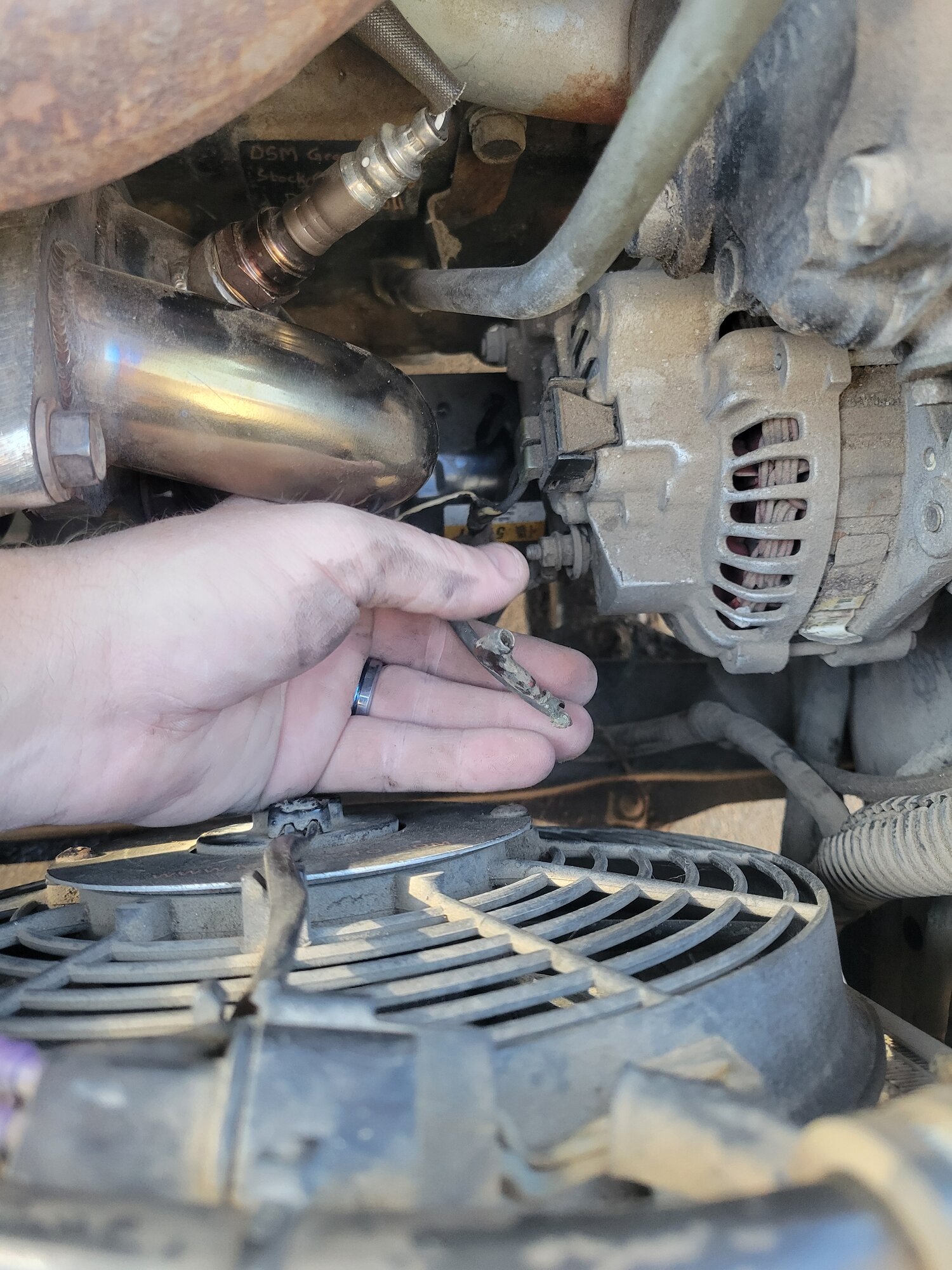

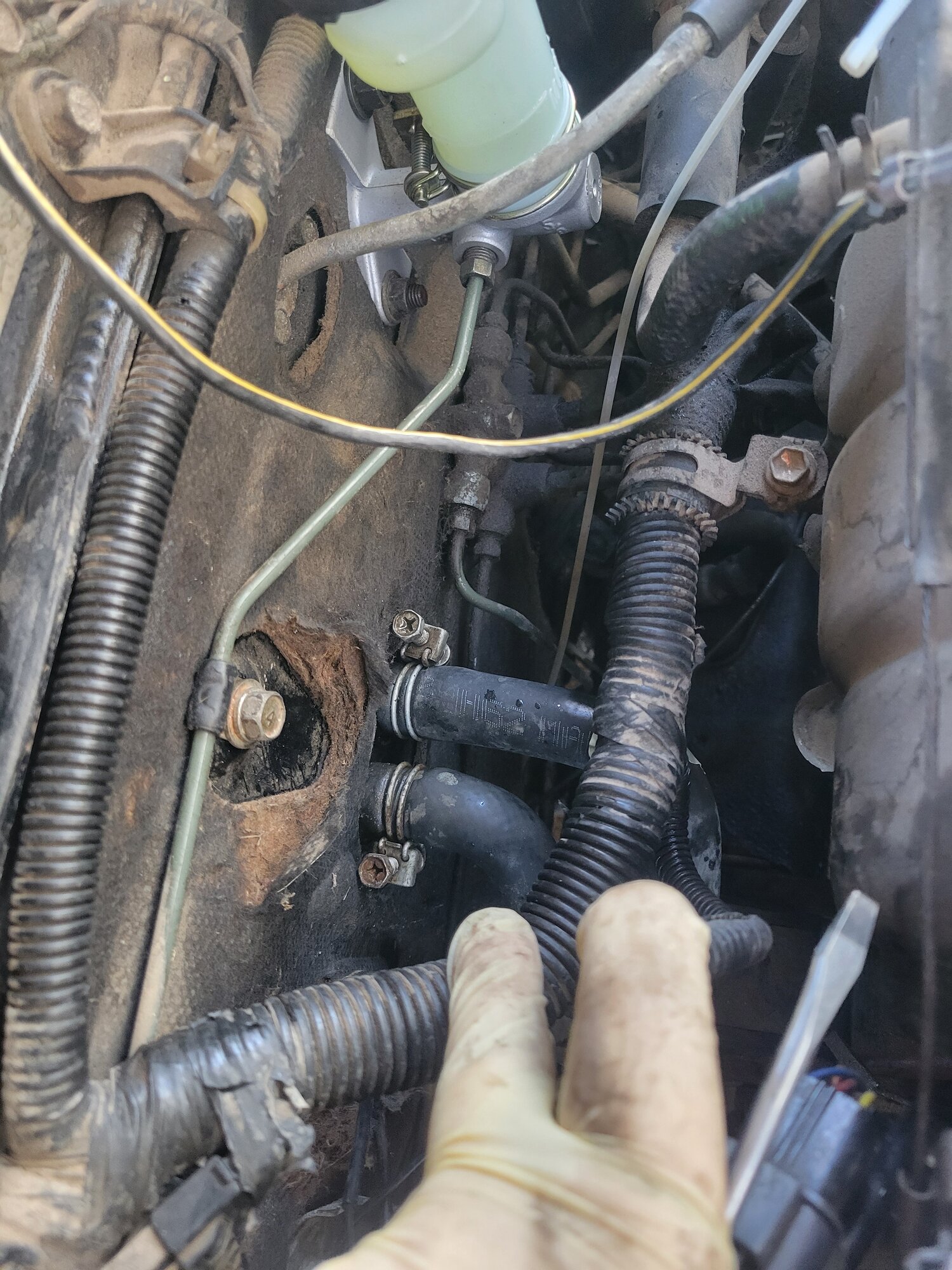

I have this wire hanging by the alternator that I have no idea what or where it goes to.
Those battery terms look horrible. Hopefully good ones will increase your voltage a little. Voltage in ECMlink is usually about half a volt lower than it is right on the battery. If you look at my specs and photos page, I have a pic there of my in-cabin voltmeter. I have that running on the cigarette lighter circuit which was easy to get at, and the voltage there is just like right on the battery (about half a volt higher than in ecmlink). Another beauty of it is the cig lighter circuit comes on with the key in ACC. So I can read the actual battery voltage just by turning the key to ACC with the car just sitting there not running.
That wire could be for the oil pressure idiot light. After they break off they usually are hanging around under the alternator somewhere. If it's up higher then I don't know what it is. Normally there is a wire going to a sensor on the front of the PS pump. Maybe it's that? You can get along without that one if your idle is a little higher than normal. That is what bumps up your idle speed a little whenever you turn the steering wheel.
Well the knock might be alarming. I haven't looked at that yet. All I looked at so far was just the things I thought would point to whether your injectors are stock size or bigger than stock. In my old setup that I had from 2008 to 2015, I sometimes had knock and sometimes didn't have knock. Mostly when I had knock was when I let the boost go over 15 psi. It might take me a while to look at those things. The usual suggestion is to reduce timing a little in the load vs rpm cells where the knock occurs, and in the cells just before. But we sort of need to know AFR and boost psi.
I don't have a a/f gauge and will take quite a while to get one. I will just stay very conservative on the pedal and boost untill I can manage to get one. I do have a triple gauge pod. New boost & oil pressure autometer ultra-lite 2 gauges ready for the a/f gauge. Hopefully by summer time I can get one!
Will look and get that wire clipped back on that is hanging down. Also will let everyone know if the heater in talon works & if the voltage went up at all wich I assume it will. Atleast hope LOL
