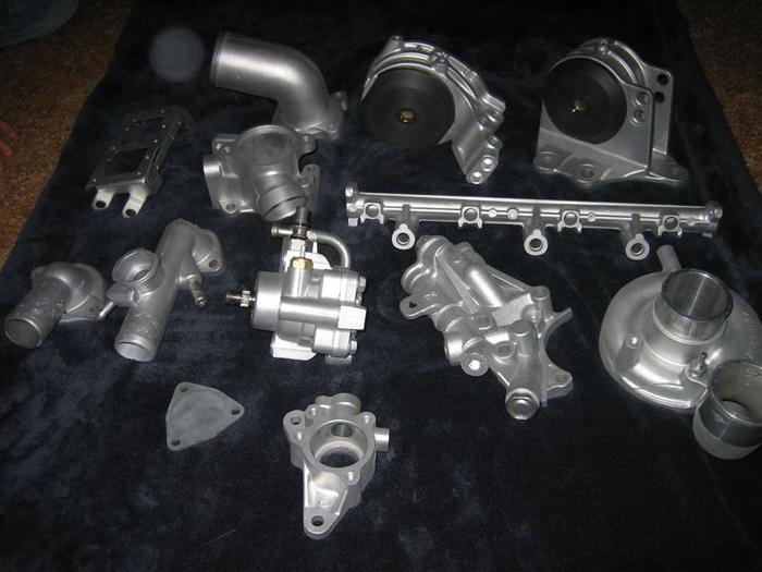

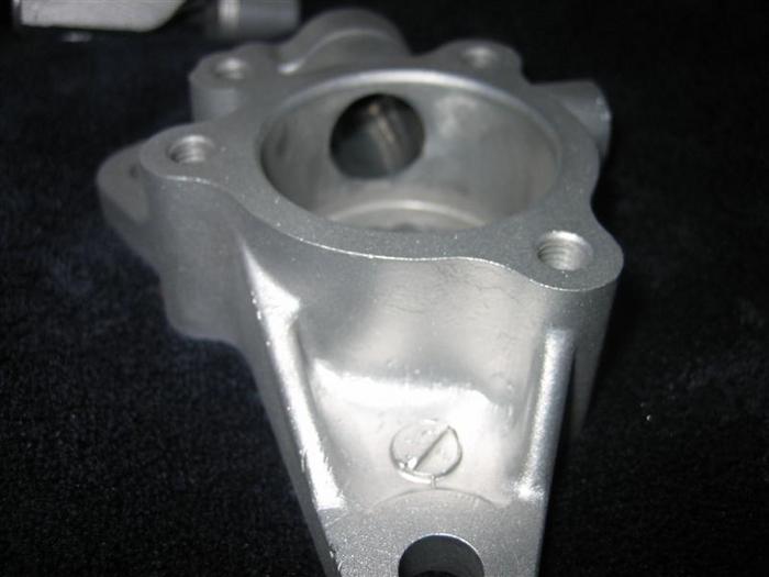

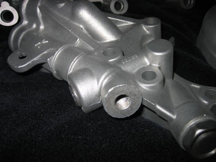

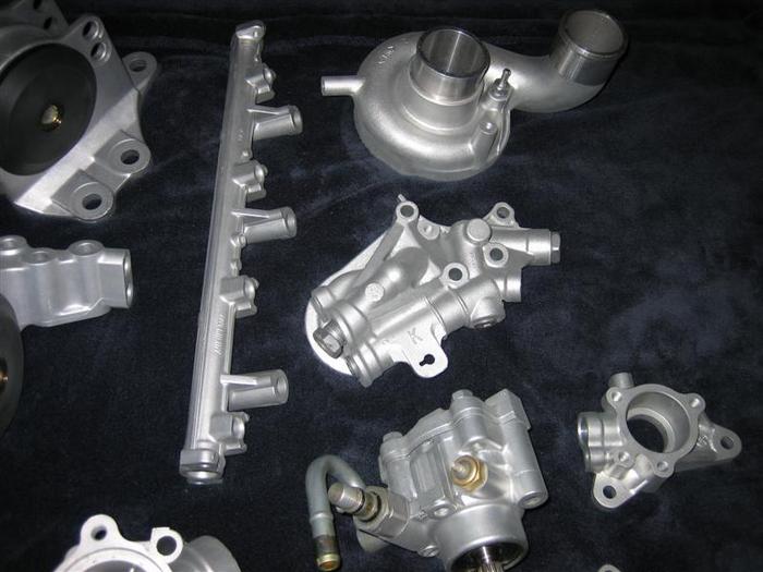

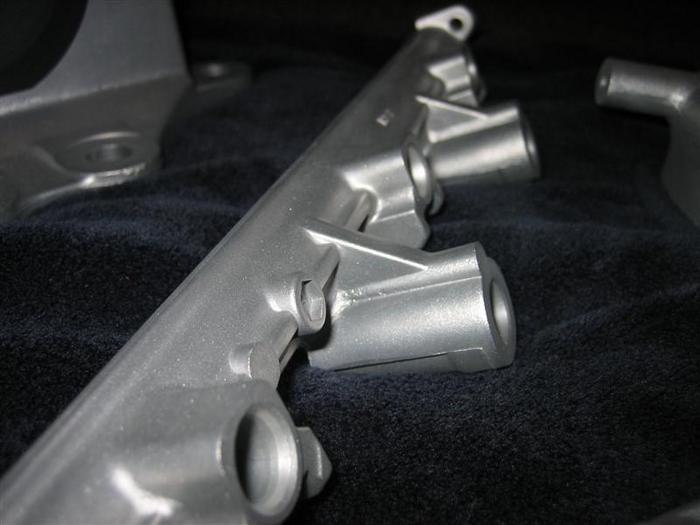

Quick update this time. I've finished up the blast cabinet and I've been blasting a bunch of stuff with extra fine glass beads, and I installed my Prothane mounts. I have a bunch of things at the welder's but he's had them for nearly a month now :toobad: We got ahold of an oven for powdercoating so we're hoping it works, but we probably won't get to trying it out for a couple of weeks.
Enjoy the pics :)
Those parts won't be painted. They're all aluminum so that I'm leaving them like they are with the blasted finish. All the bolts I blasted will be powdercoated clear since they're steel, along with a couple pieces on the power steering pump.

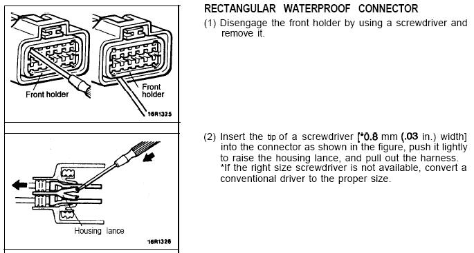

Here is how to remove wires from waterproof connectors (found in engine bay):
These pins were harder for me to remove than the ecu connectors. Patience, patience, patience. Oh, and the proper tools help too :coy: Try to deal with ONE wire at a time; you will get confused less. When pulling wires through the big rubber firewall grommets BE CAREFUL!! The pins have sharp edges and you can very easily damage other wires when pulling the pins through the grommet. If you're careful you will be fine. Probably the better way to do it is to cut the pins off, but I kinda wanted to keep everything intact "just in case".
