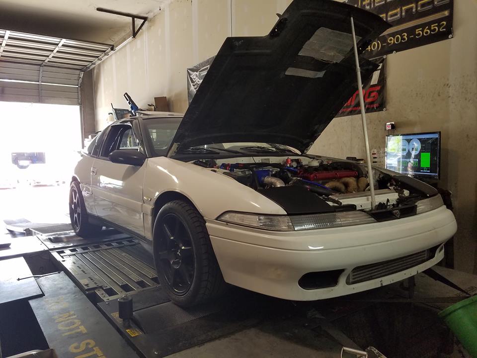

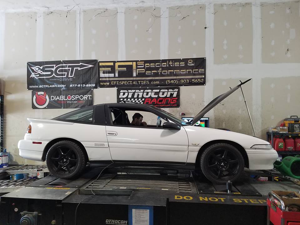

So up until this point I have tuned the car entirely by myself on the street and strip for the past 7 years. It was time to see what the power curve looked like on the dyno so I could fine tune my shift points and see how the powerband really looked. Got in contact with Dave Katz at EFISpecialties and set up a date. First base run on my tune it laid down an impressive 557h.p and 397 ft lbs of torque. After a few pulls Dave turned the turbo up from 38 psi to 43 and tweaked the timing from 7K-9K for optimum power. It made 587hp and 408ft lbs of torque in a 108* heat index. Peak torque was 7300RPM and Peak Power was 8000RPM. We took it all the way to 9K on the pulls and the power curve did not fall off at all. The EVOIII SMIM blew my mind and I am a firm believer on why Curt Brown told me to go with it. We went all the way to 49PSI but the car started losing power so it is most likely a back pressure issue and the BEP .70AR Housing was maxed out.

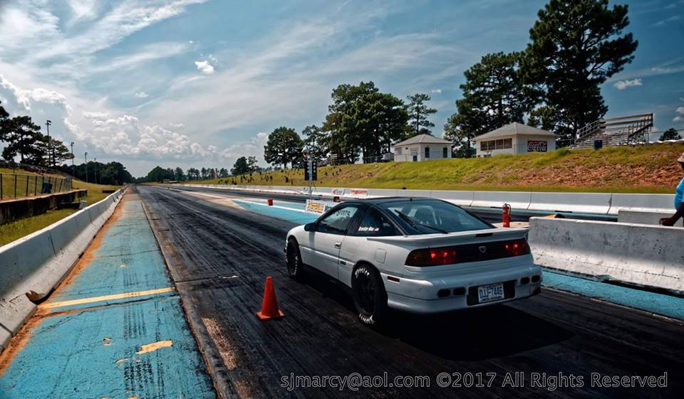

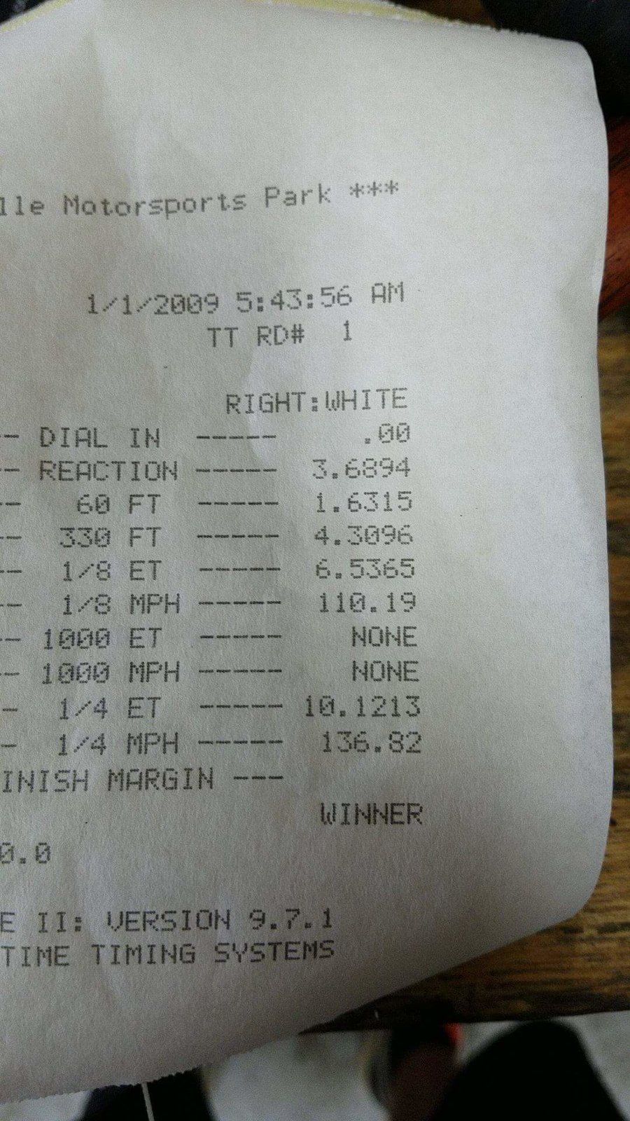

Back to the track we go in August. Ran a 10.9,10.4 and finally a 10.12 my new p.b run. It was super hot over 100* my 2nd to 3rd pass I only had 20 minutes before the track closed so my trans temps were pretty high around 180* at the start. I spent some time working on the stall/launch tune to get that 60ft down which is literally the only thing holding me back from a 9 second pass right now. IFO came back to Rockinham which was only a 45 minute drive and first qualifying pass sheared the passenger rear axle in the diff housing so I was done for the day. I'm hoping to hit the track again at the end of the month as I feel the changes I made to the stall tune will get the job done this time and some cooler N.C air will help me out as well.
10.41
10.41 different view
10.12 rear view
10.12 side of track view with time and mph of my p.b

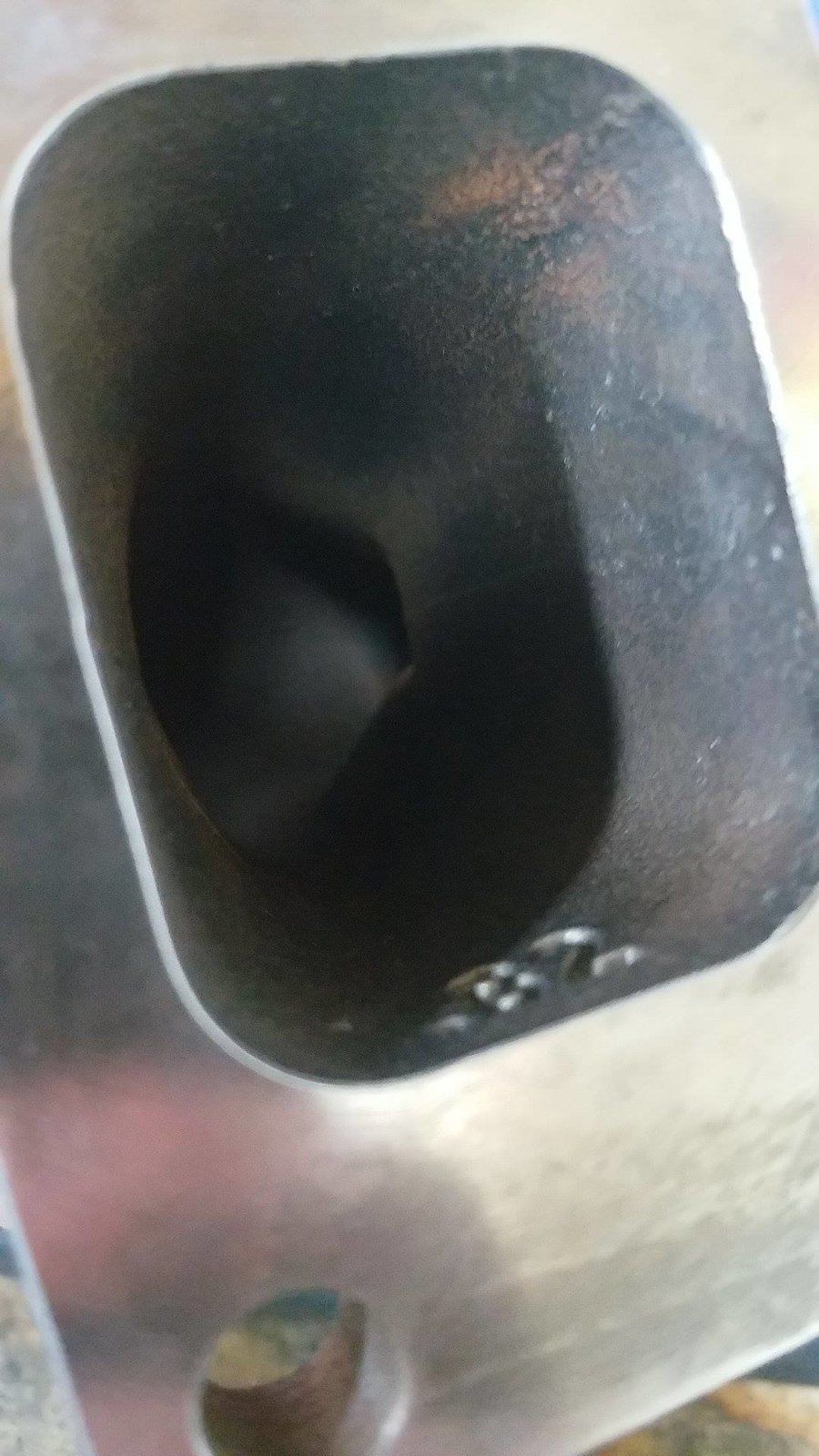

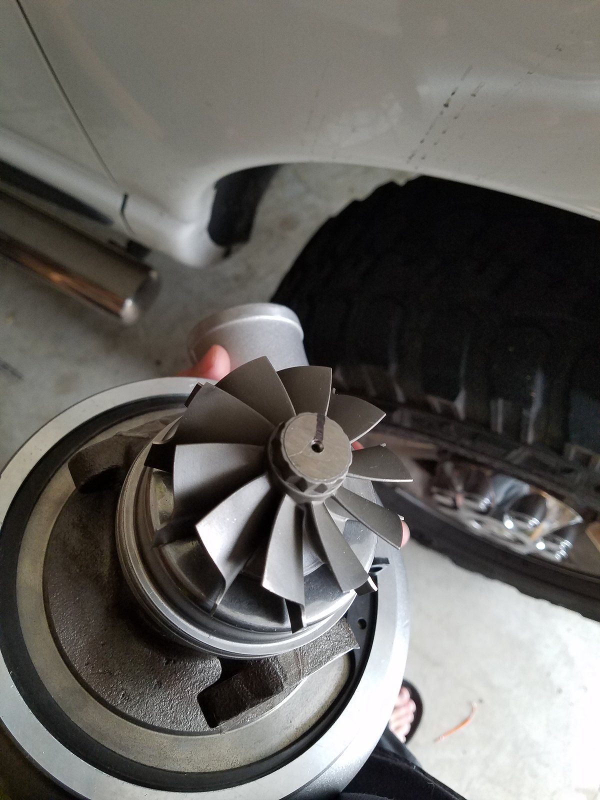

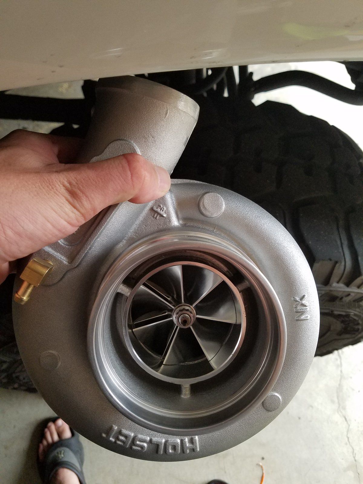

May I ask what they sell that exhaust housing for? Is this what they consider the hx40 pro?
Here is the link to that turbine housing from eBay where I bought it from. The Super 40 is the 60 or 62mm 6 or 7 blade compressor wheel. It still uses a hx40 turbine wheel and a hybrid compressor wheel made by KTS so I'm not really sure how to classify that one.
The turbo itself may have been out of steam on the dyno to many factors and with link I am limited as to what I can actually log. Then you have converter characteristics, trans temps ect. to factor in. I was honestly just going to swap the 12 blade turbine wheel out for the 10 blade and call it a day but I figured it was worth a shot to try the new version compressor wheel as well.
https://m.ebay.com/itm/Holset-Hx40-...%3A07269c5c15f0aa492407991cfffc9ed8%7Ciid%3A5
It's crazy how that housing is less than half the cost of the bep housing.
Yes it is, I came across that a few months back just searching around. It is not as bulky as the bep housing is. I had to extend the vband clamp 3/4" inch so my exhaust lined up correctly. The one thing I did like about the new housing and vband flange they sent is it has a small ring on it acting like a gasket to ensure it locks in with no leaks.
this thread makes me want to build my hx40 instead of changing turbos LOL. awesome to see how far the holset can go. ive been contemplating the 63mm wheel that turbo lab sells along with a bigger turbine wheel and big ar housing.
It is a very capable turbo on a budget no denying that. I almost threw the towel in and bought a 76mm BW turbo I came across for a smoking deal but I didn't reach my 9 second street trim goal yet. I just did a lot of thinking on it and decided I wasn't done with Holsets just yet. I haven't done much weight reduction besides the free removals of un-needed stuff which will help a ton next season. A very good friend also pointed out why go bigger when you haven't reached the full potential of this set-up yet. That right there brought me back to reality. We will just have to wait and see how the new turbo acts on the track.
Looking at the 63mm compressor wheel its actually very impressive with a huge 103mm extended tip. The turbine housing is a a 50/50 kind of deal because every manufacturer makes housings differently. It's advertised as a .82 but really how much larger is the volutle compared to the BEP .70AR? I can look at airflow in link and compare but since I am running the 67mm version with a 10 blade turbine and .82 housing compared to the 66mm version with a 12 blade turbine and BEP .70AR housing that wouldn't exactly be a fair comparison. At the end of the day though if my trap speed increases then I know it works.

For us the car went fastest with the ERL manifold, .70 housing, 67mm H1E turbine, and 66mm wheel (the one which copied the Garrett T67). Still it was only .35 seconds faster than a box-stock 60mm HX40 in the same housing at less boost. The .70 housing was definitely too much turbine restriction as after just one season it had some unacceptable thrust wear. I addressed that over the off-season by going to a machined Garrett .82 housing, and the car also got the custom top-mount manifold. It gained almost 800rpms of lag over the .70 housing and ERL manifold, but it was run for two more seasons and the turbo never suffered any thrust wear again so obviously the reliability issue was corrected. It made a handful of 8-second passes on the .82 housing and top-mount manifold but never bested the 8.77 done on simple parts that anyone can buy and install. Surprisingly the car only went two tenths faster with a Super99 than it did with the 66mm HX40 despite being at 10psi more than it was on the Holset but there was likely some intake restriction with the 2G head. New aluminum-rod engine's been built with a 1G head and four more injectors with a goal of 7's on the horizon. A new manifold will be built to support a billet S475 I have here...I chose that route because there are plenty of available turbine wheels and housings in the S400 platform with compressors up to 83mm so there is plenty of room to grow down the road without the need to spend $4000 on a custom Precision that will probably fail.
I now have three different users logging an accurate 80+ lb/min at 42-44psi with the 60mm KTS wheel so I haven't been building a whole lot of the 66mm turbos lately...and all of those units have the 76/64 turbine. The additional lag just doesn't seem to be worth it as most of these cars are still 100% street-driven with occasional track use. The fact that you can see performance like that from a 60mm journal bearing turbo that is roughly $1000 cheaper than something comparable like the PTE 6062 is just mind-blowing.

I can't believe that you have guys logging over 80lbs/min on the 60mm version! Mine is logging over 80lbs/min at 43 psi but it sounds like the 60mm is right there with it and I know it spools much faster. That is very promising and eye opening to guys looking at upgrading. The thing I like how you guys did it was completely maxing out each specific set up before making a change which is the best way to keep going faster. I used to talk smack about autos too but after switching to one myself it is very tedious tuning compared to the good old man shifting especially the launching part.
