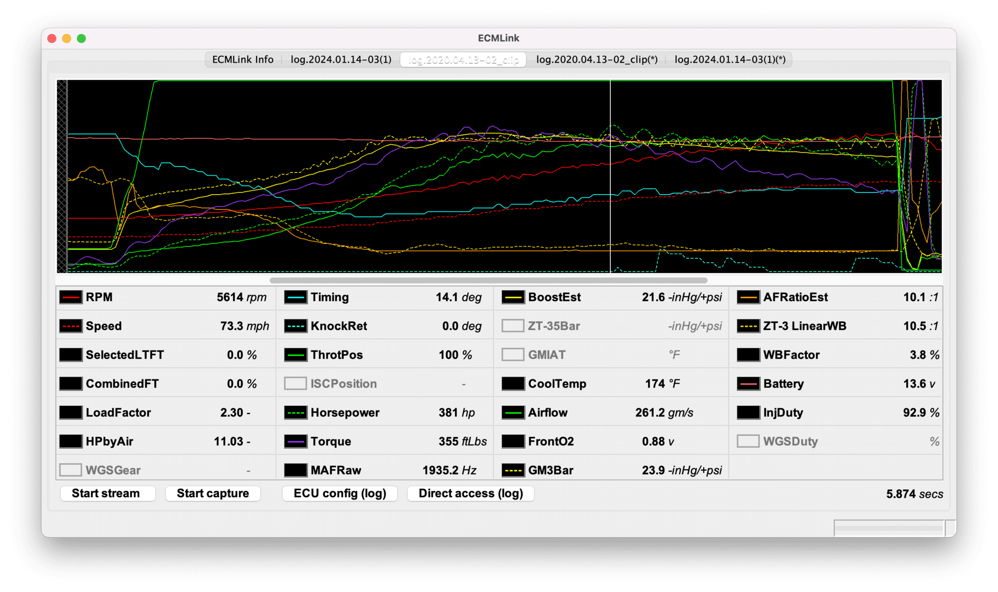

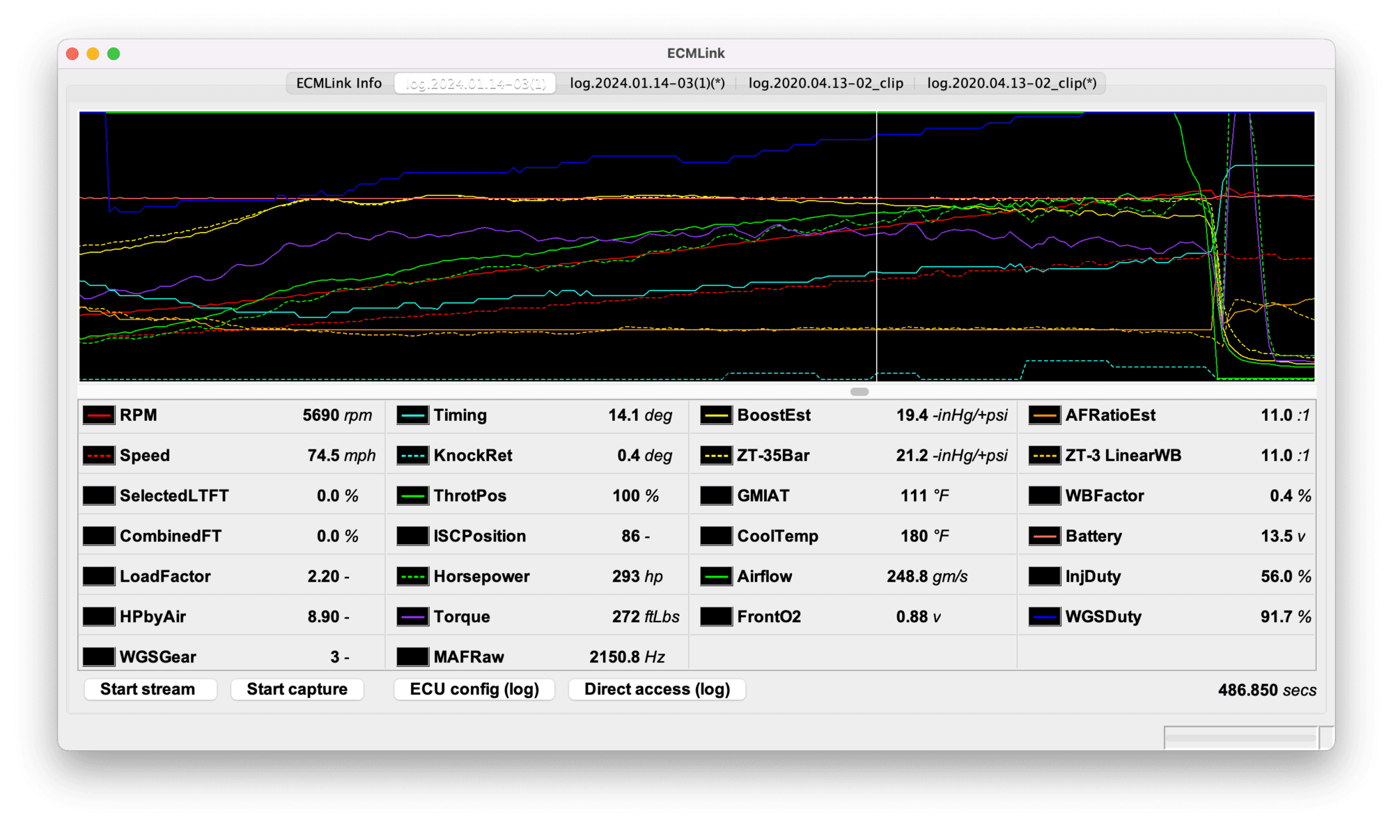

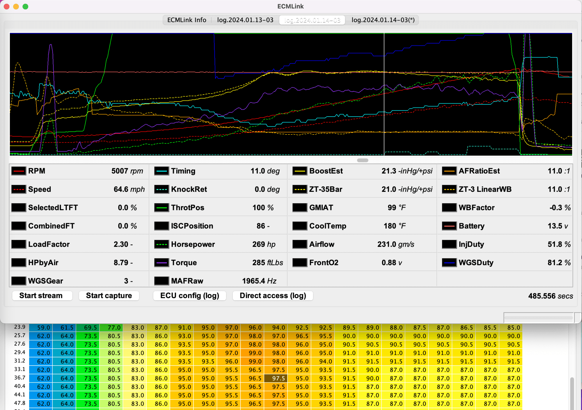

Today - the WB is on the line - Temps are just a little warmer, so either the engine is calibrated due to temps in the right range, or the sensor is just working today. Go figure. Knock is back.
Yeah, I checked where it's easy to check, from 61 to 79 seconds, and the wideband is acting just right there (checking against Front O2).

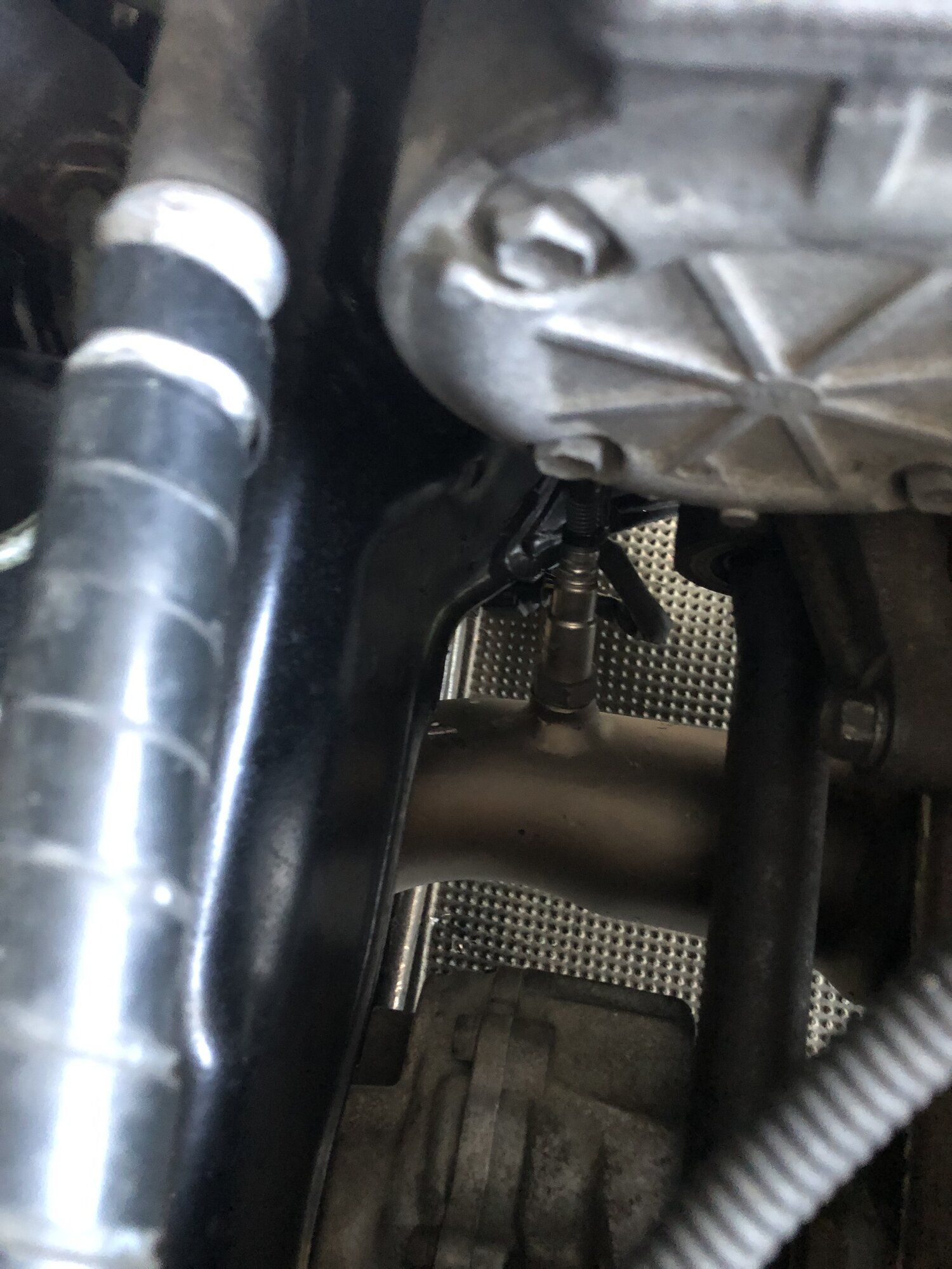

Where is your wideband sensor located?

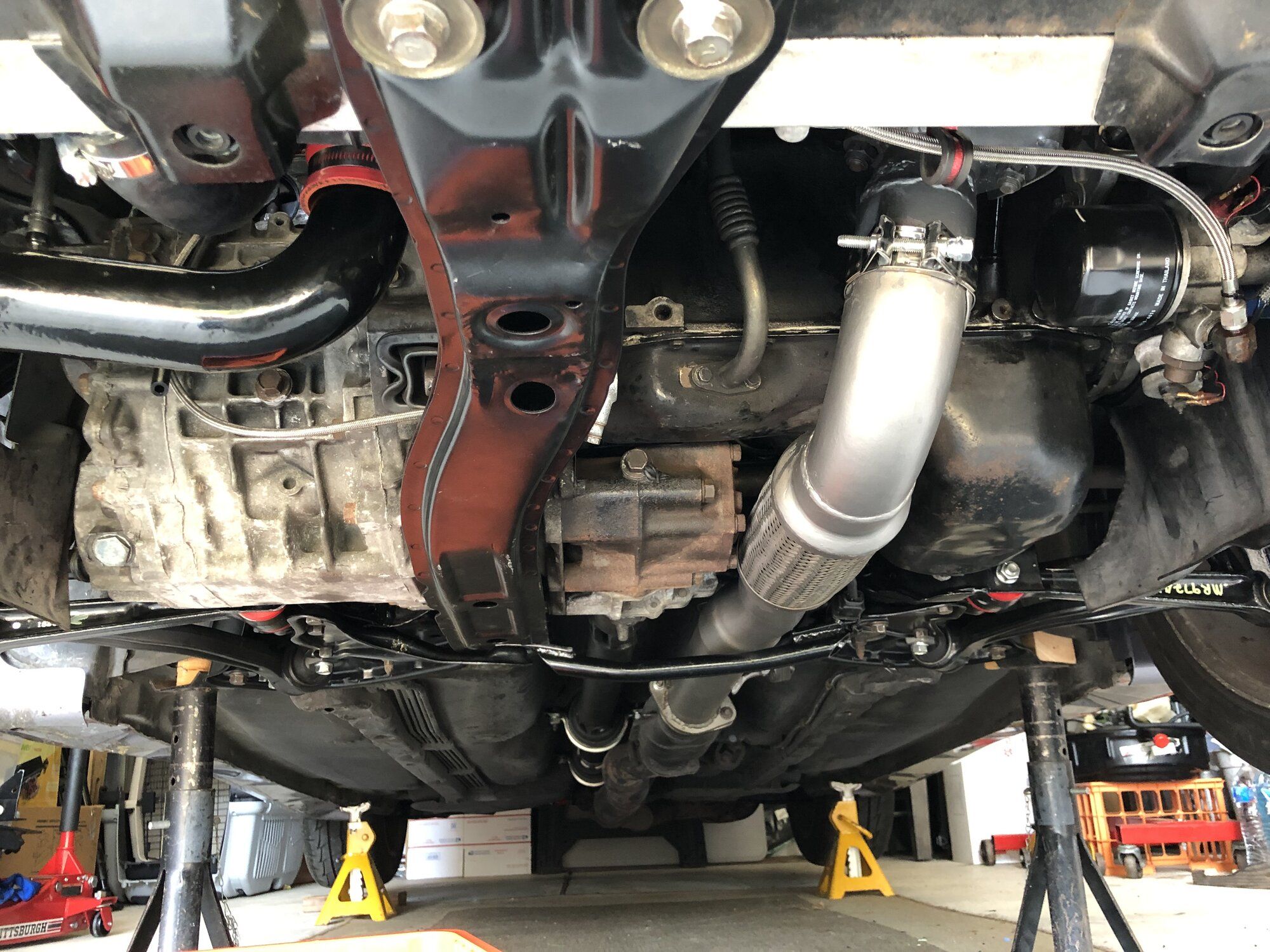

err, not where you can see it: Its just after the flex section, on top of the pipe in the gap between the front sub frame and firewall, sorta where the black lower brace is bolted up in this shot.

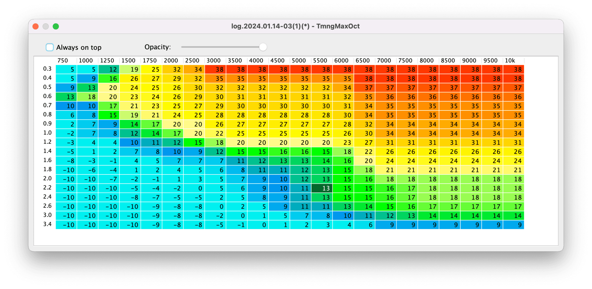

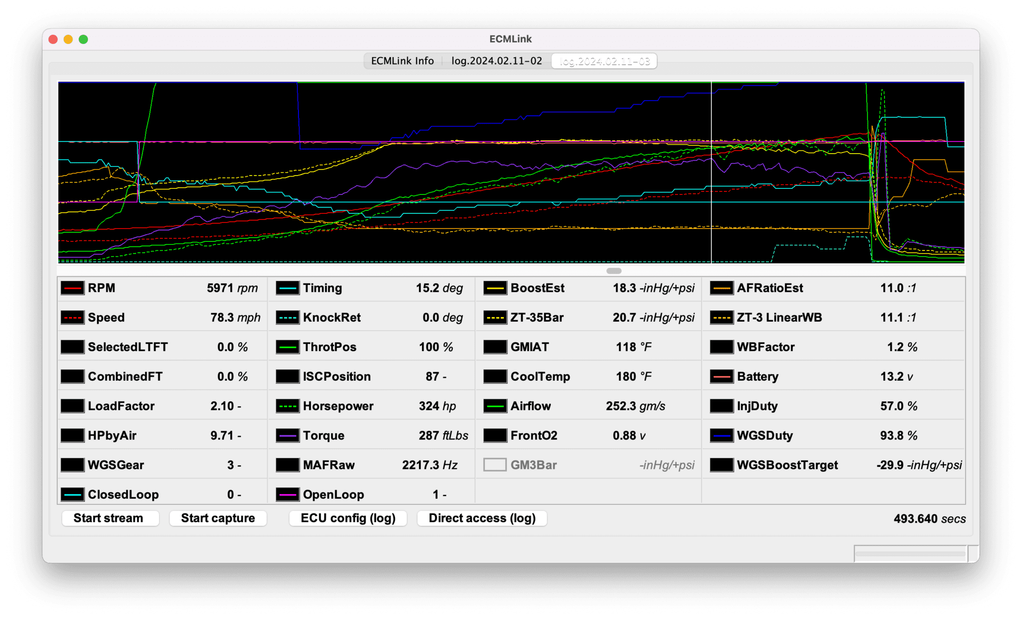

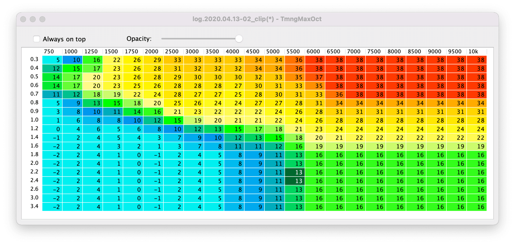

I went back to 2020, looking to see why I was able to pull up the timing and HP numbers higher back before all the updates. The old data has a shorter pull, with slightly higher boost levels, but the real improvement is in the Torque and HP numbers. The HPbyAir is in the 10's to 11's. Since I have already put 2G timing numbers in the high boost areas on top of the EVO8 map - I can not figure out why I am not doing better today.

By the time the old big 16G had spooled up at 4K, it was into 7-8deg of timing. It never dipped down into the 5's because the RPM's were higher from the start at lower boost.
In comparison I'm seeing more MAFRaw but less Airflow.

I decided to change oil and filter today, and take a look around. There is an occasional smell of burnt oil during a run, so I looked for signs of a drip above hot parts like the turbine, and the downpipe.
And I did find some - looking up from the floor I could see a collection of oil on the bottom of the water pipe behind the turbo. Mostly oil travels down, so that leaves me with Head Gasket, Valve cover gasket and…? The Valve cover gasket looks dry, and I think oil seeping down past the exhaust manifold would have smoked long before getting to the water pipe, so its Head Gasket and …?

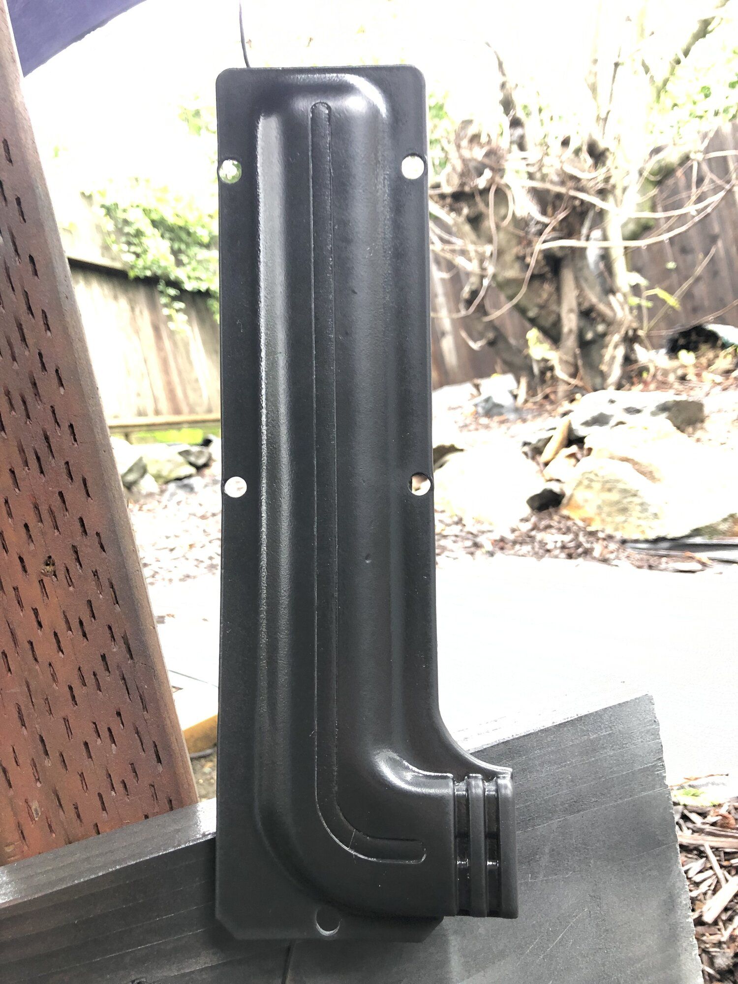

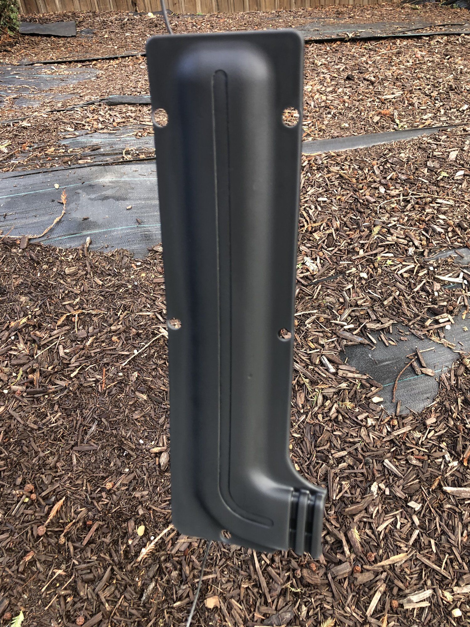

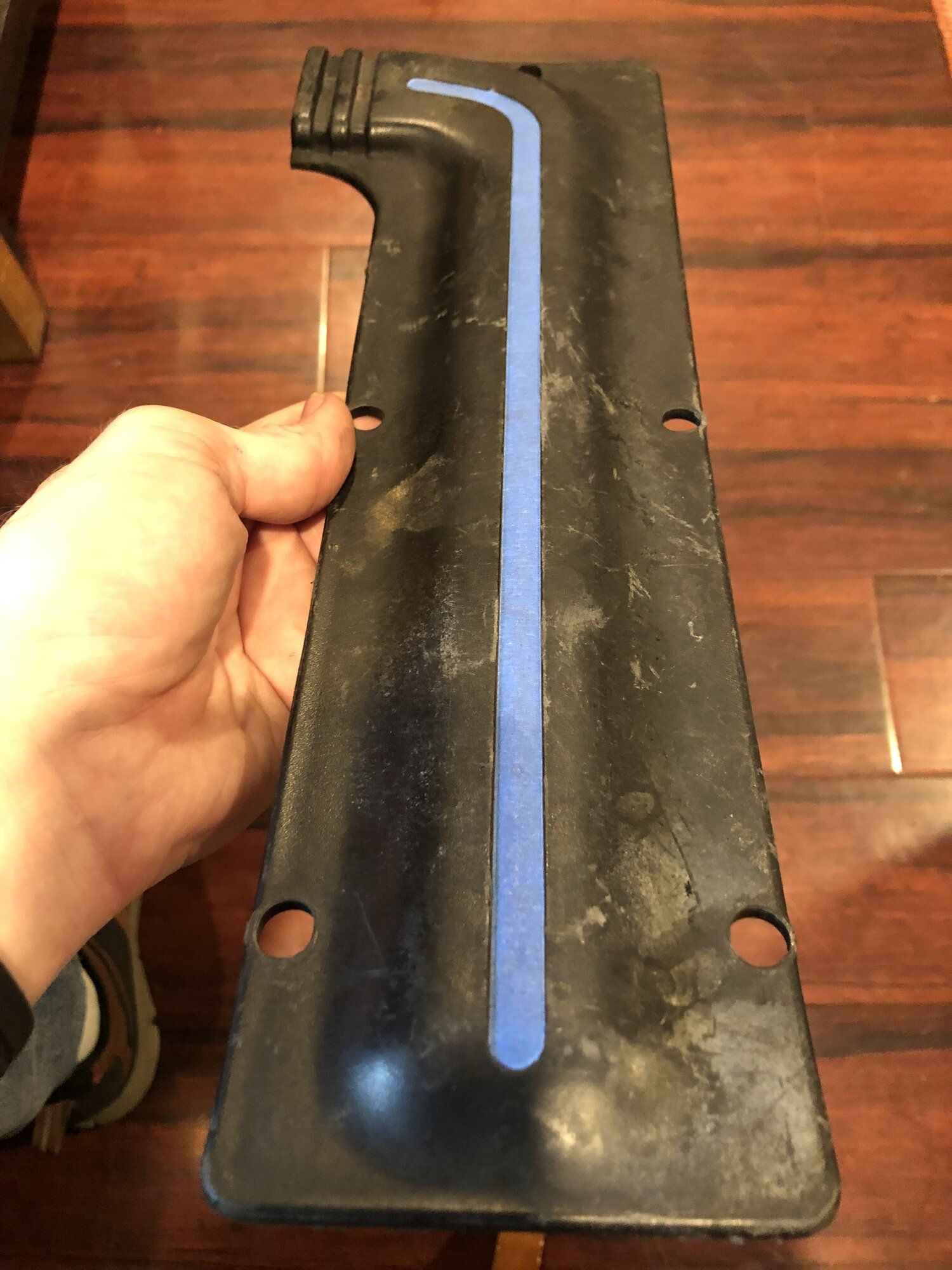

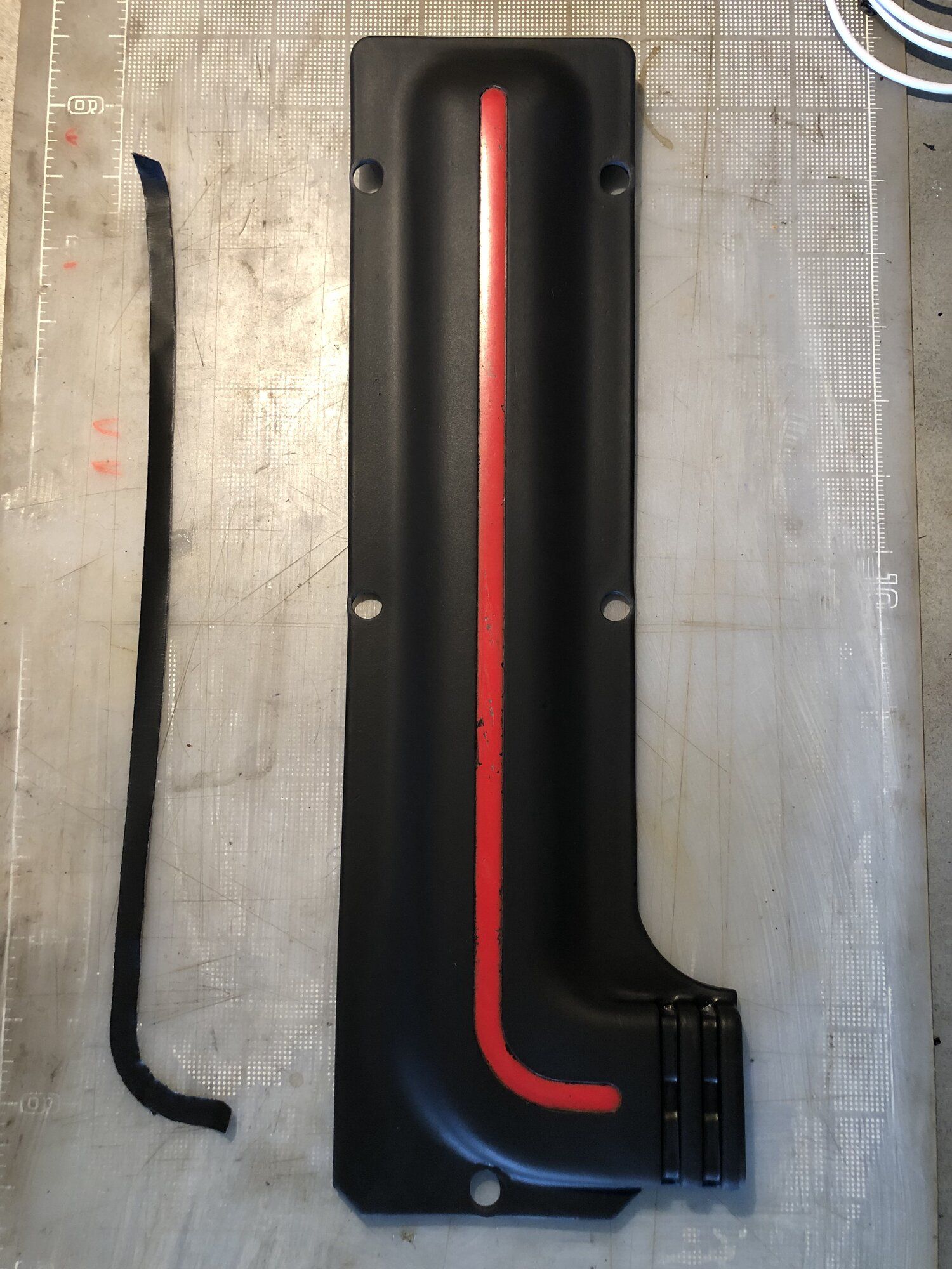

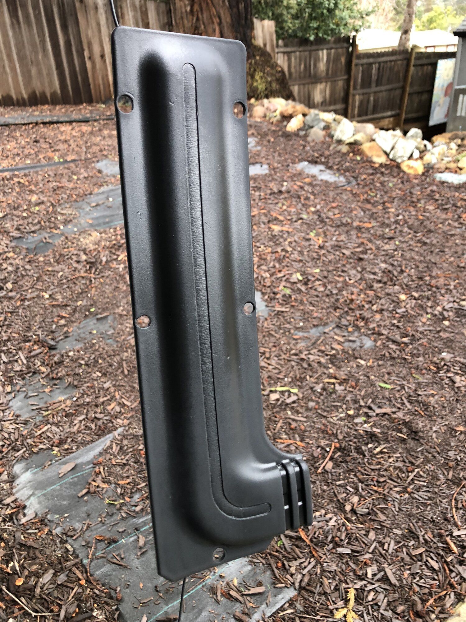

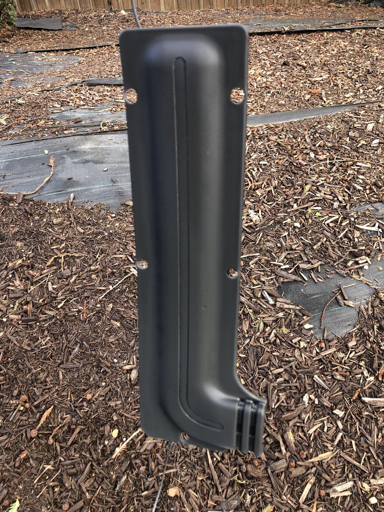

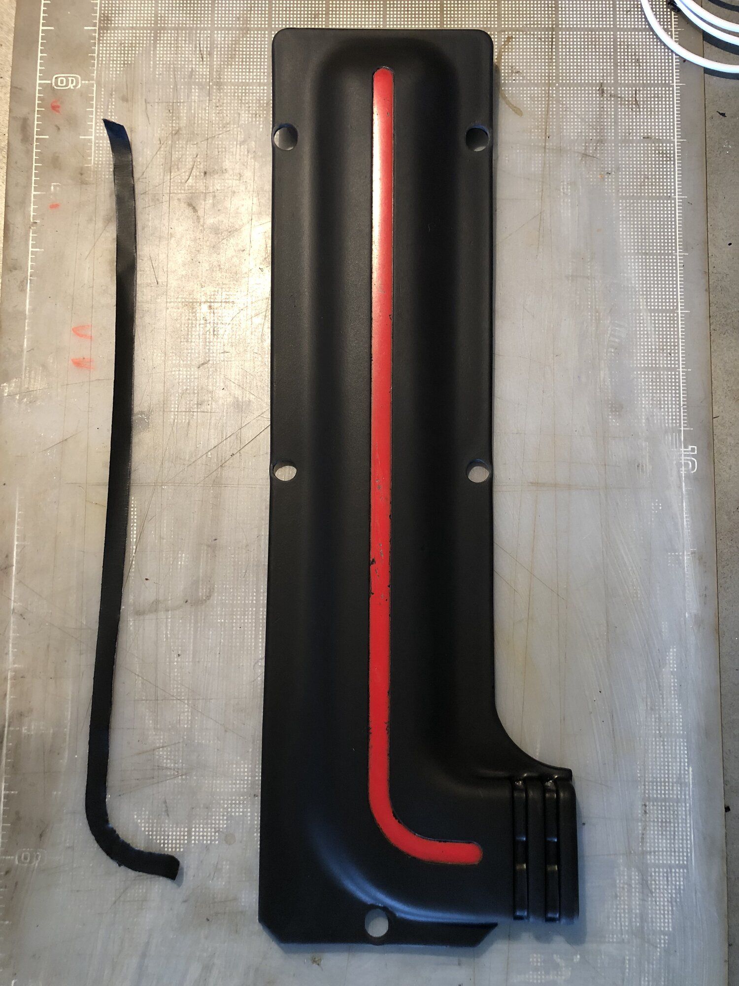

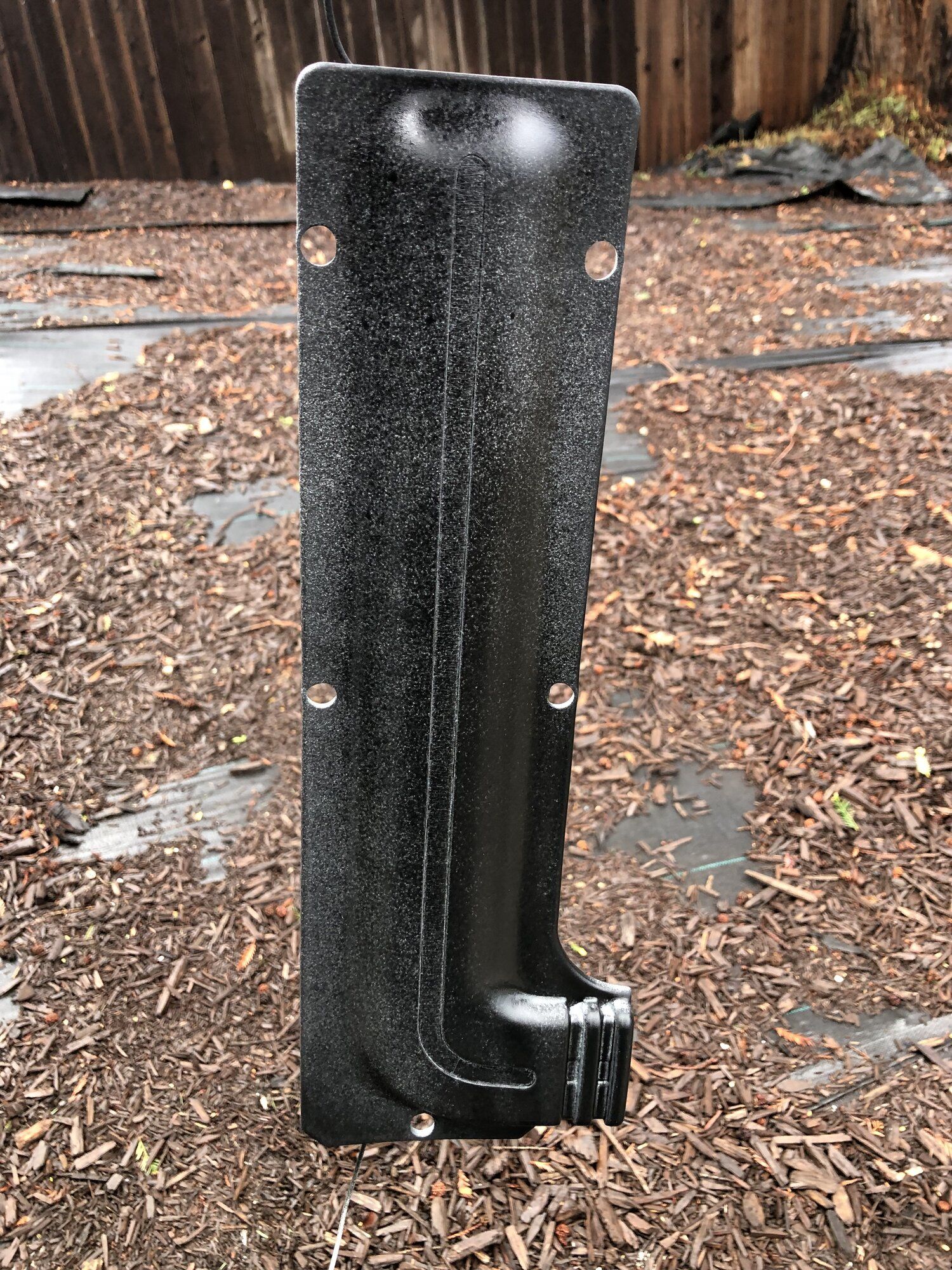

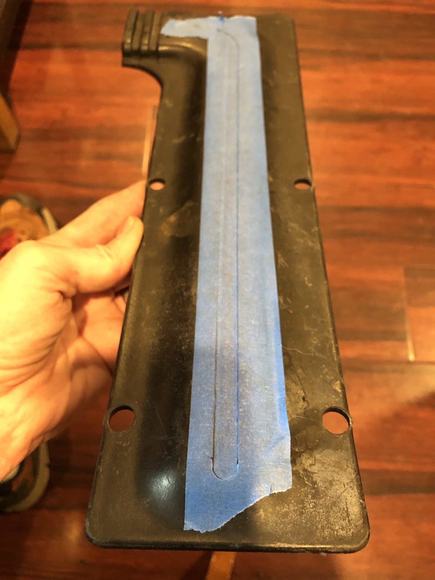

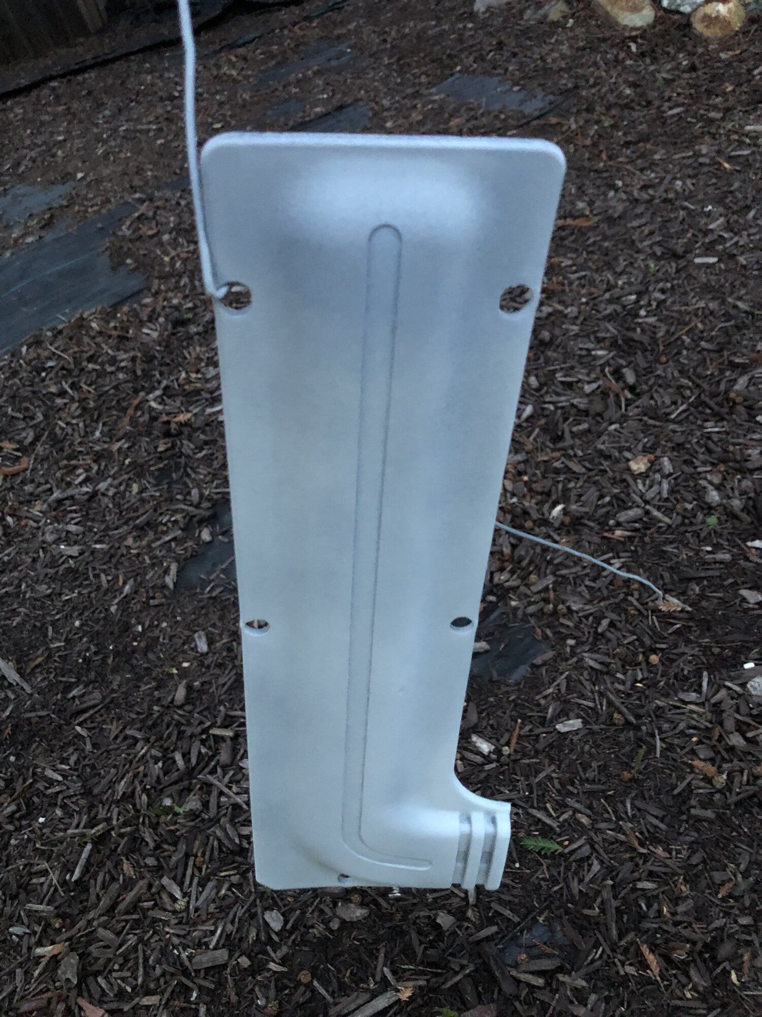

Also after changing oil, decided it was time to referb the finish on the red stripe spark cover.
Starting with protecting the red stripe:
Trim masking
Green scotch bright pad scrub
Plastic prep
Adhesion promoter
Primer x2 light coats

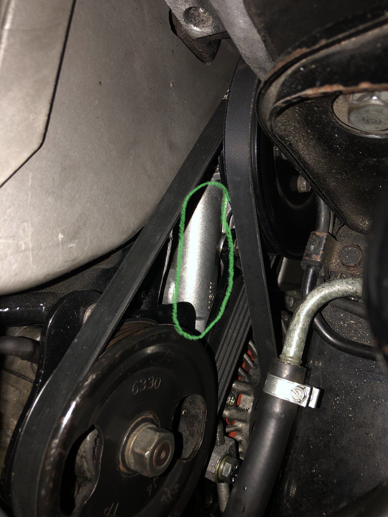

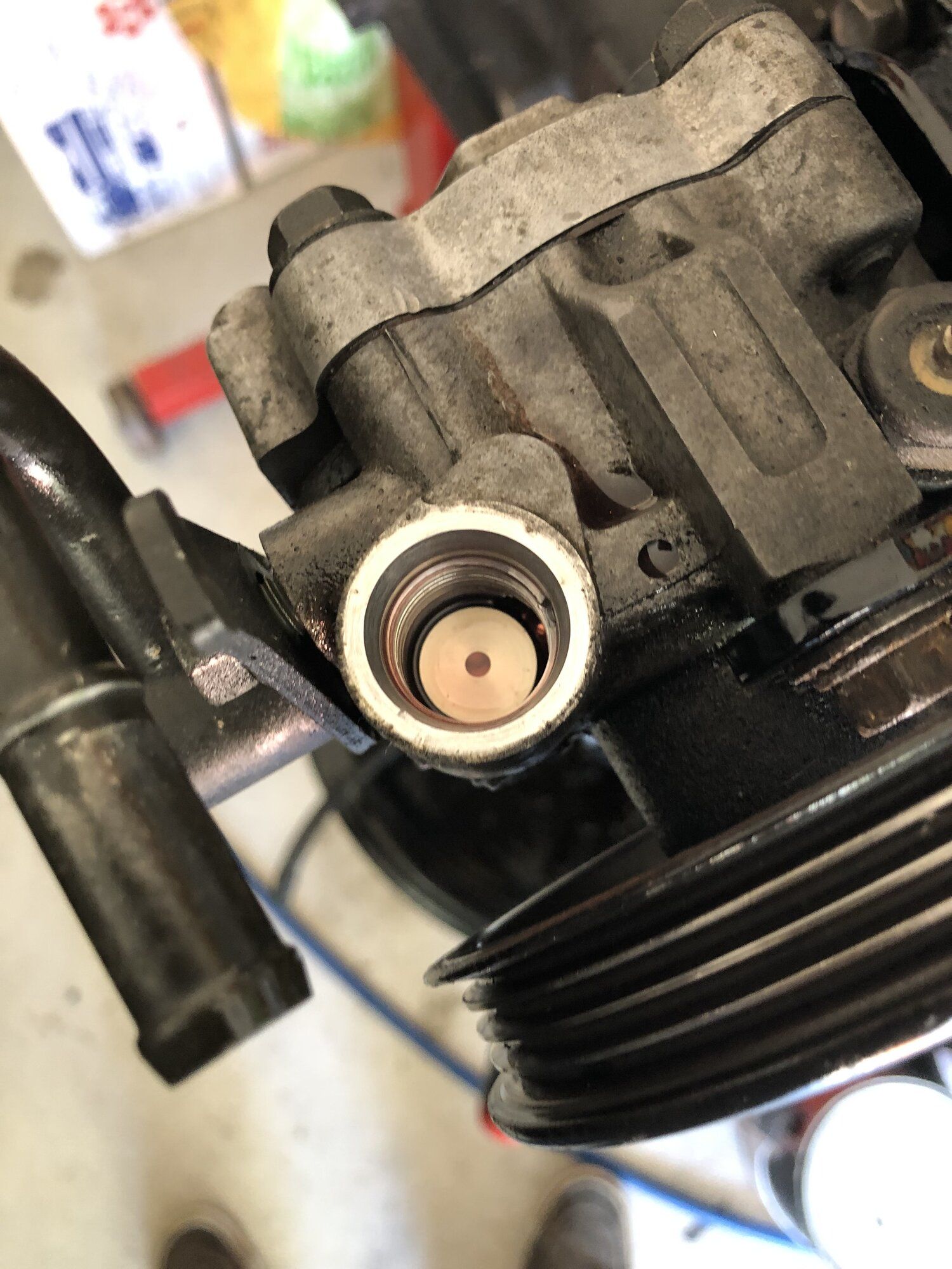

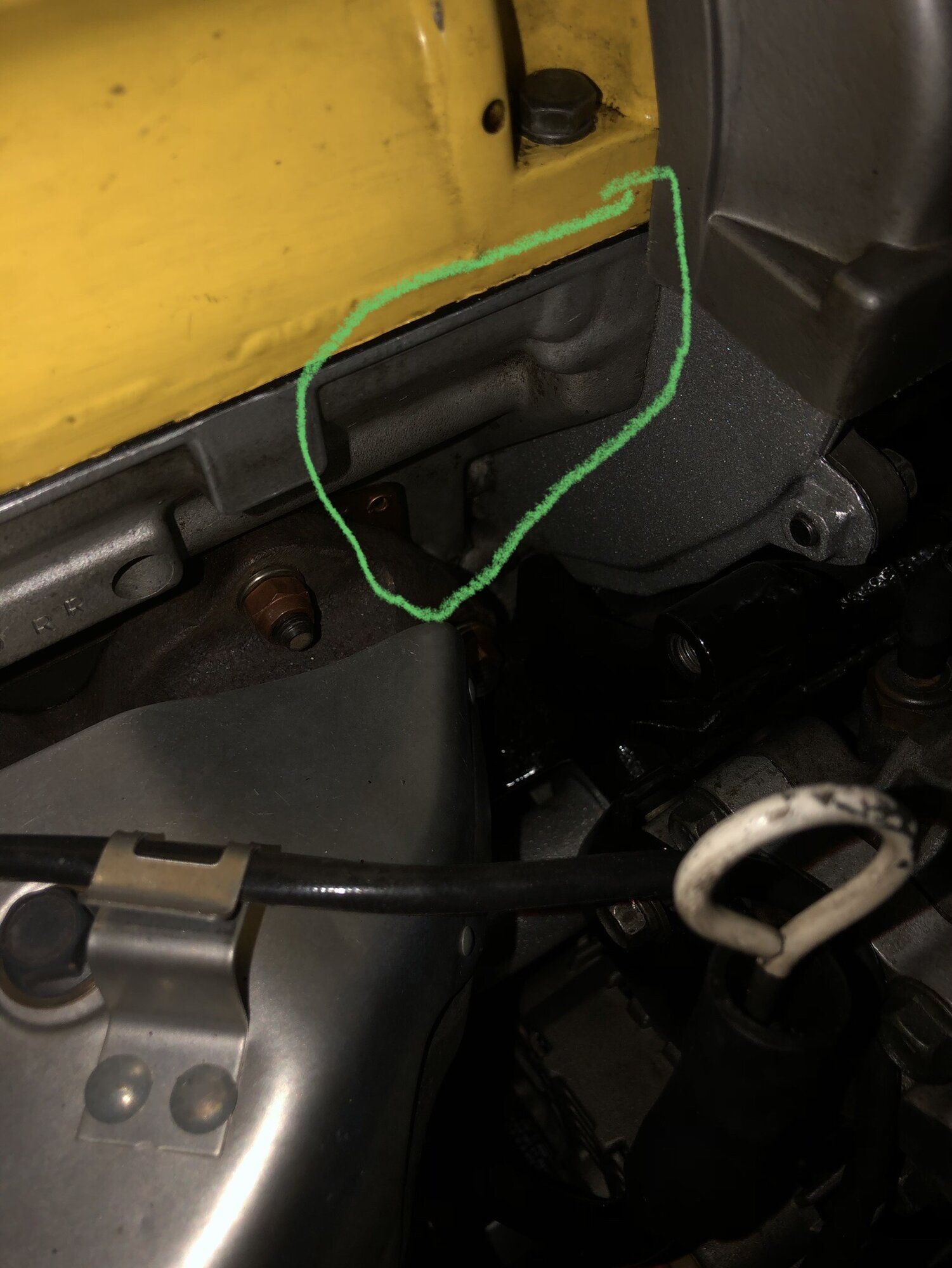

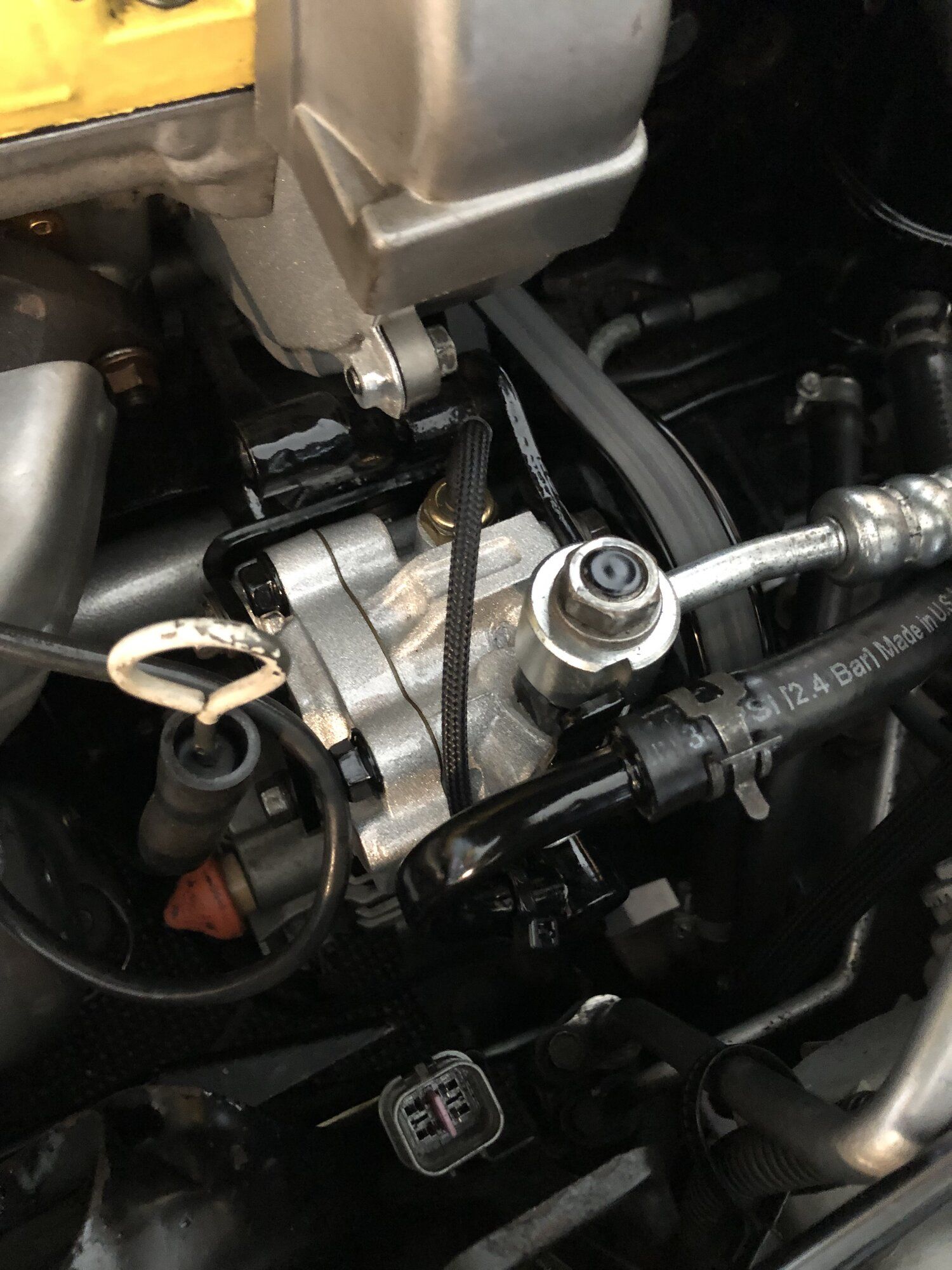

I’m amazed where a little trickle of oil can go when it leaks past a seal - looking from the accessory side of the timing belt, I see oil drips on top of the water pump, and start going backwards -
At the bottom of the tin timing belt cover behind the PS pump, oil was collecting and tripping on the water pump, and it came from the front valve cover seal here:
I double checked under the cam gear cover and it was dry (thankful) . I think I found the right source.

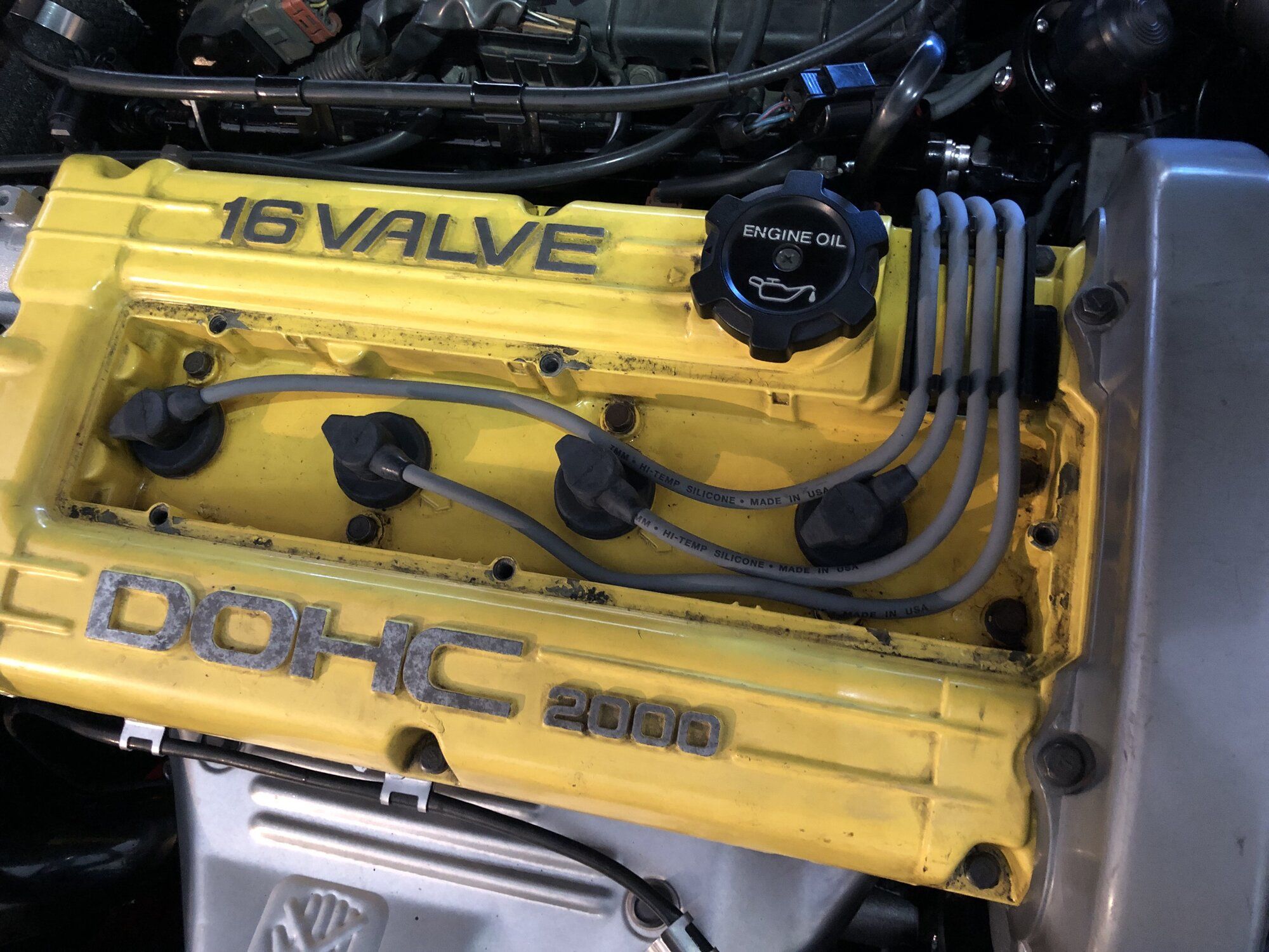

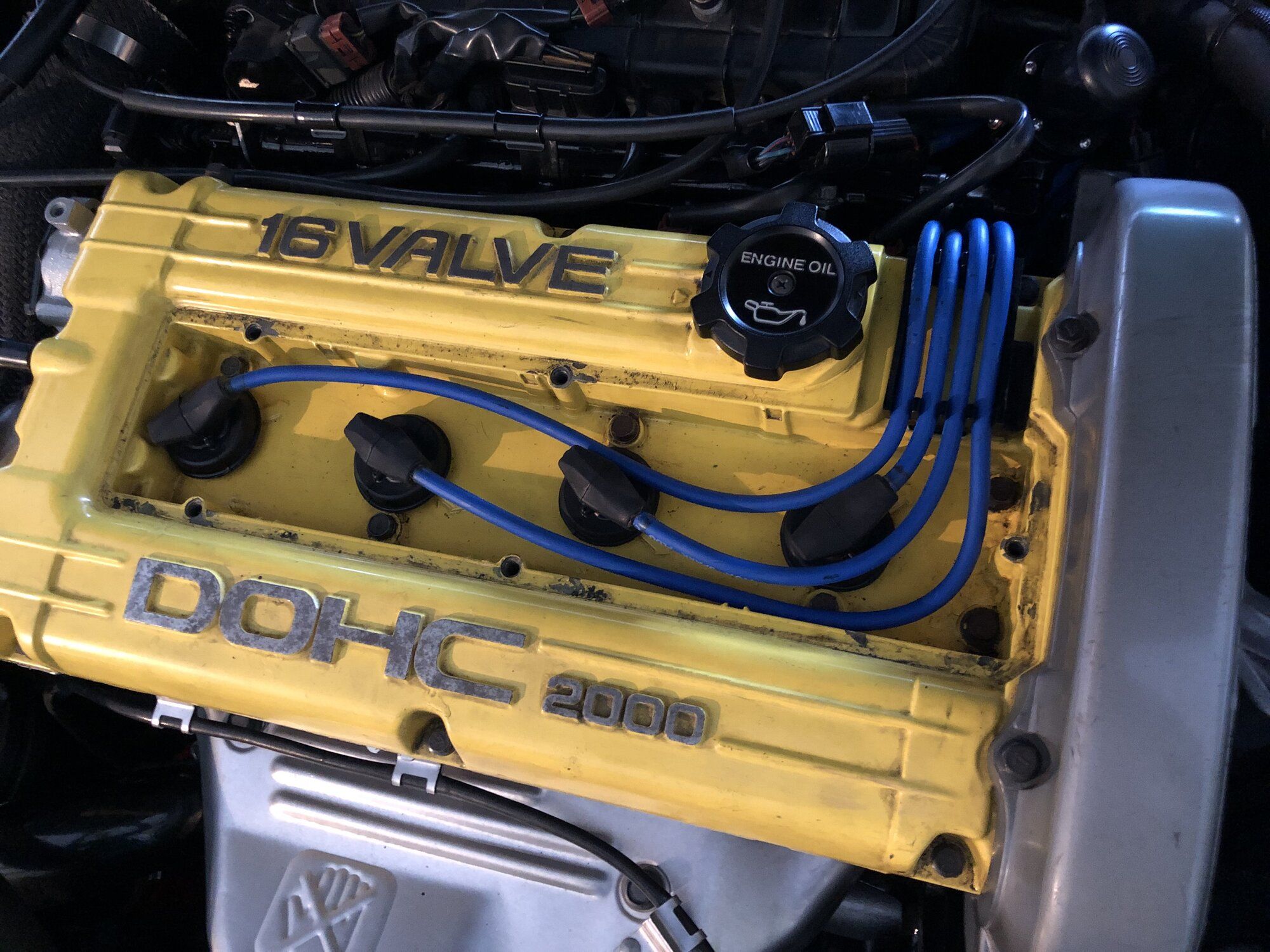

What wires are those? Was never a big fan of the blue either, but those NGKs are the top dog.
Prospark 9100 from General Cable
Amazon Link
The NGK’s work well enough no doubt, but the price on the 9100’s is so good, it was worth it to try - and so far I see no performance issues

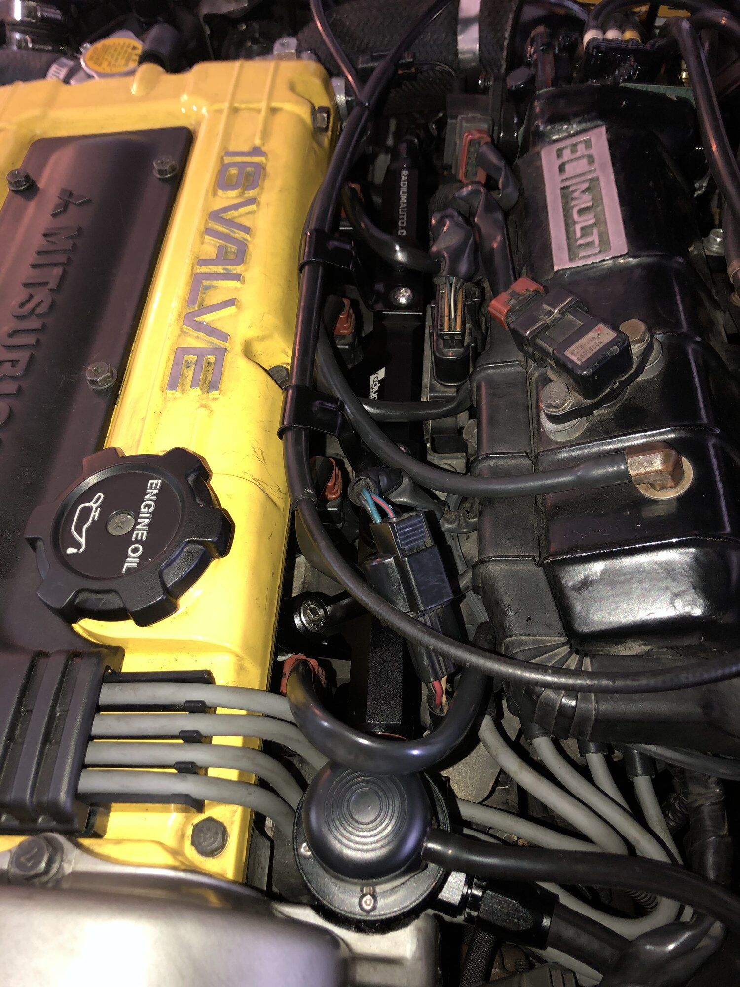

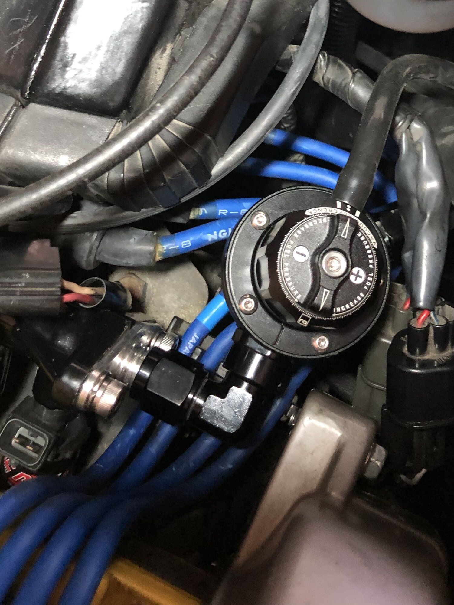

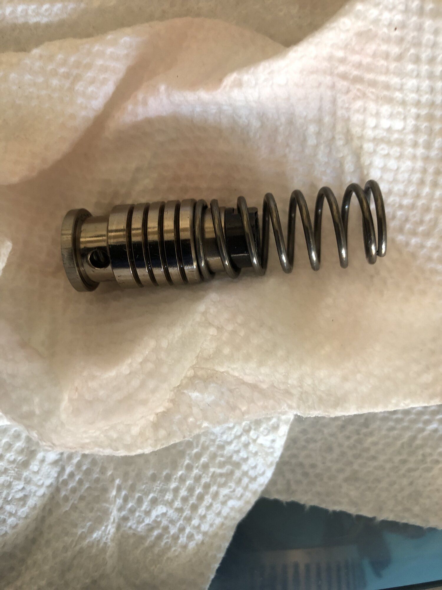

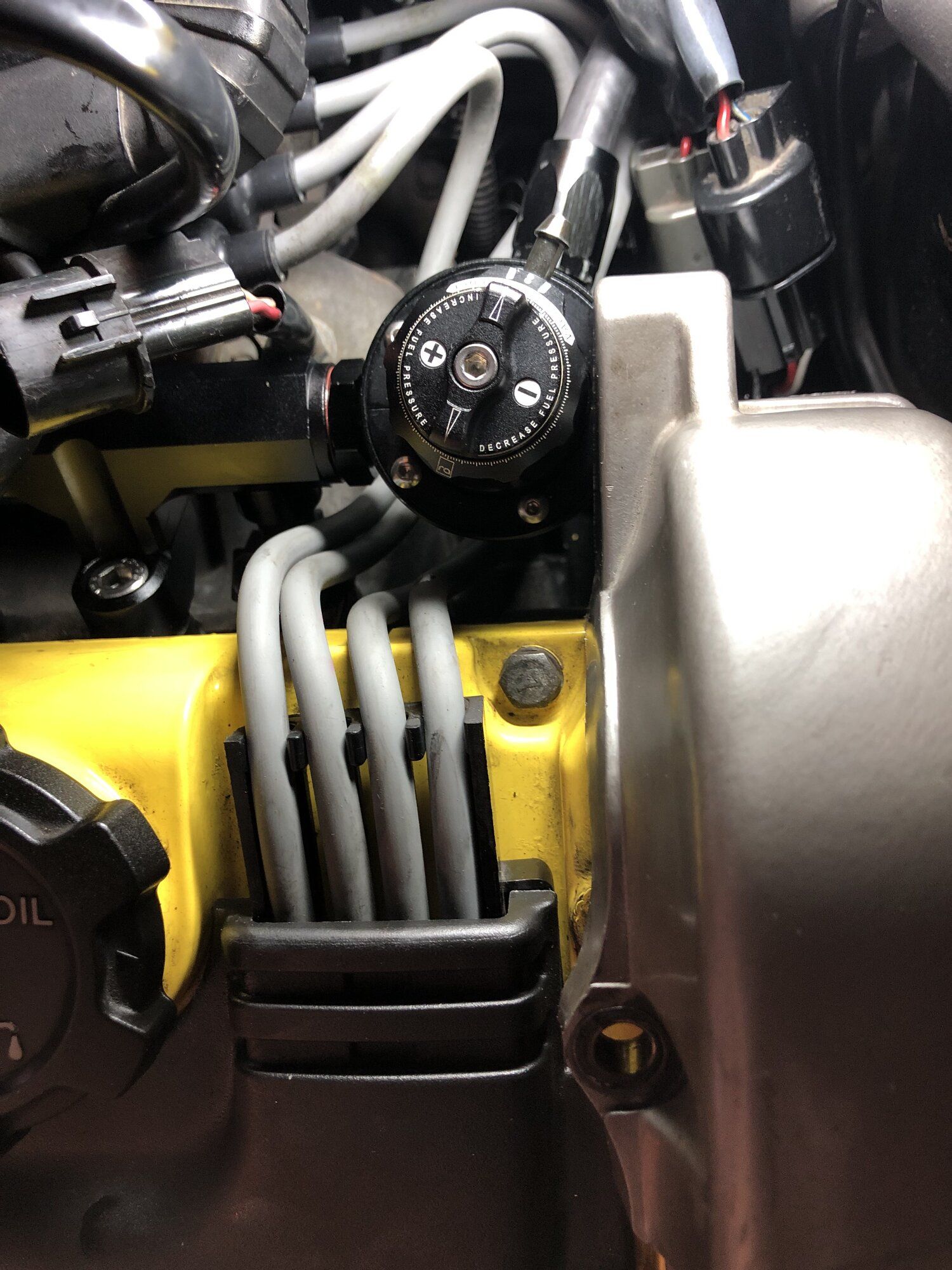

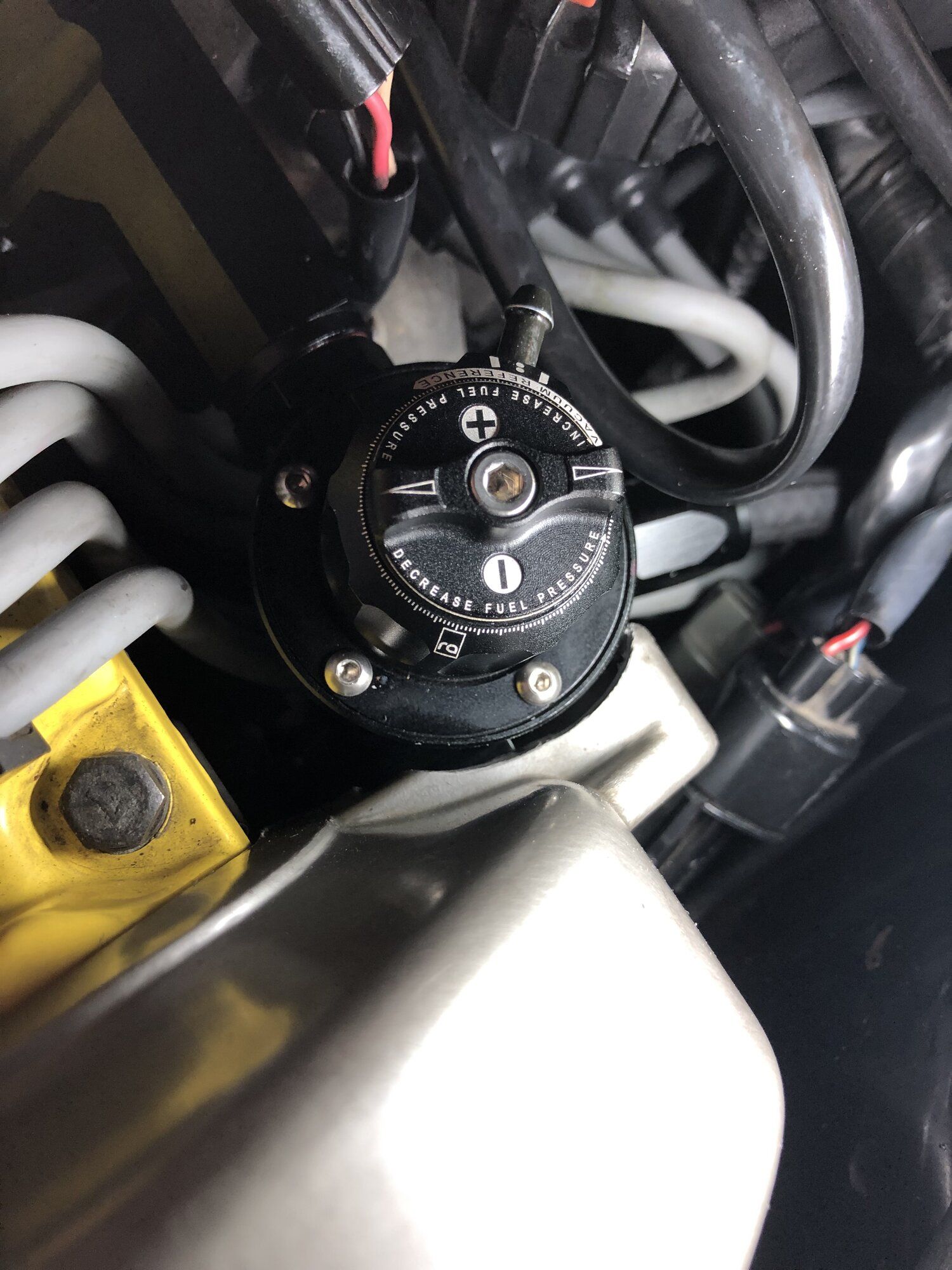

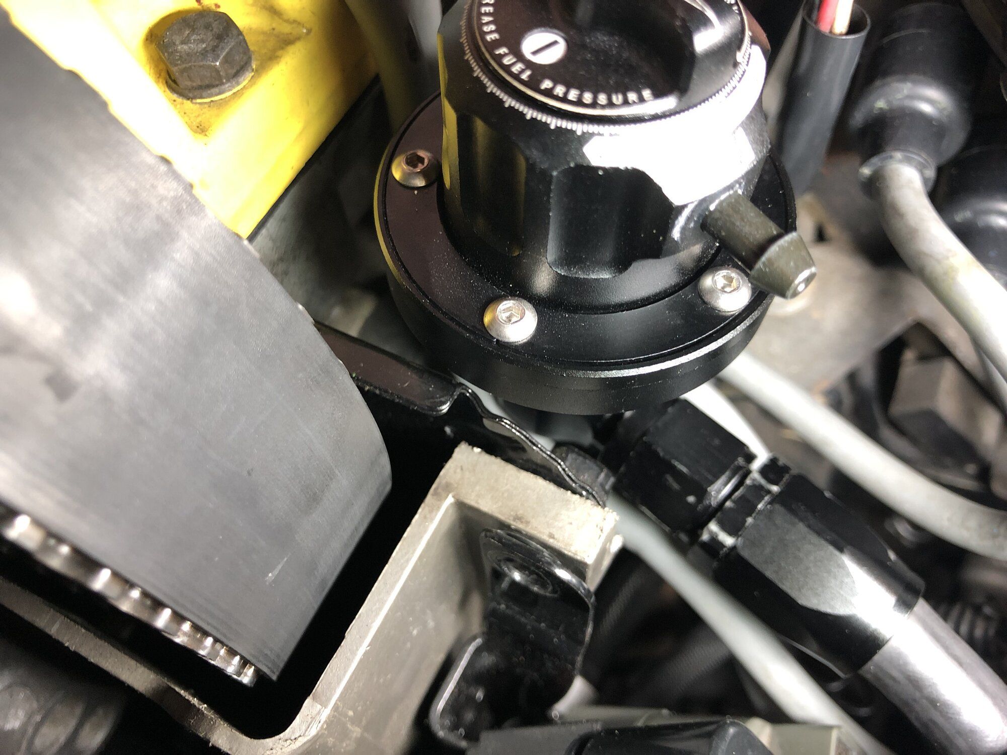

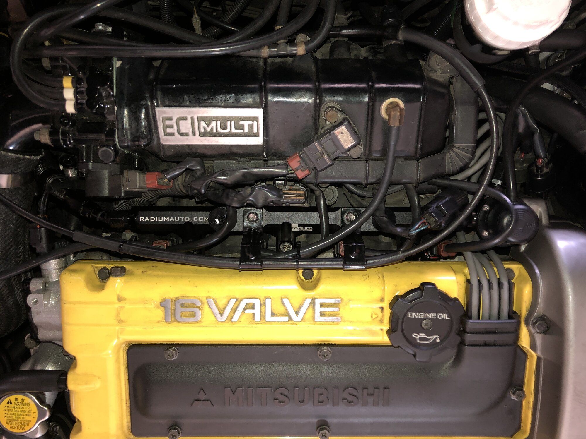

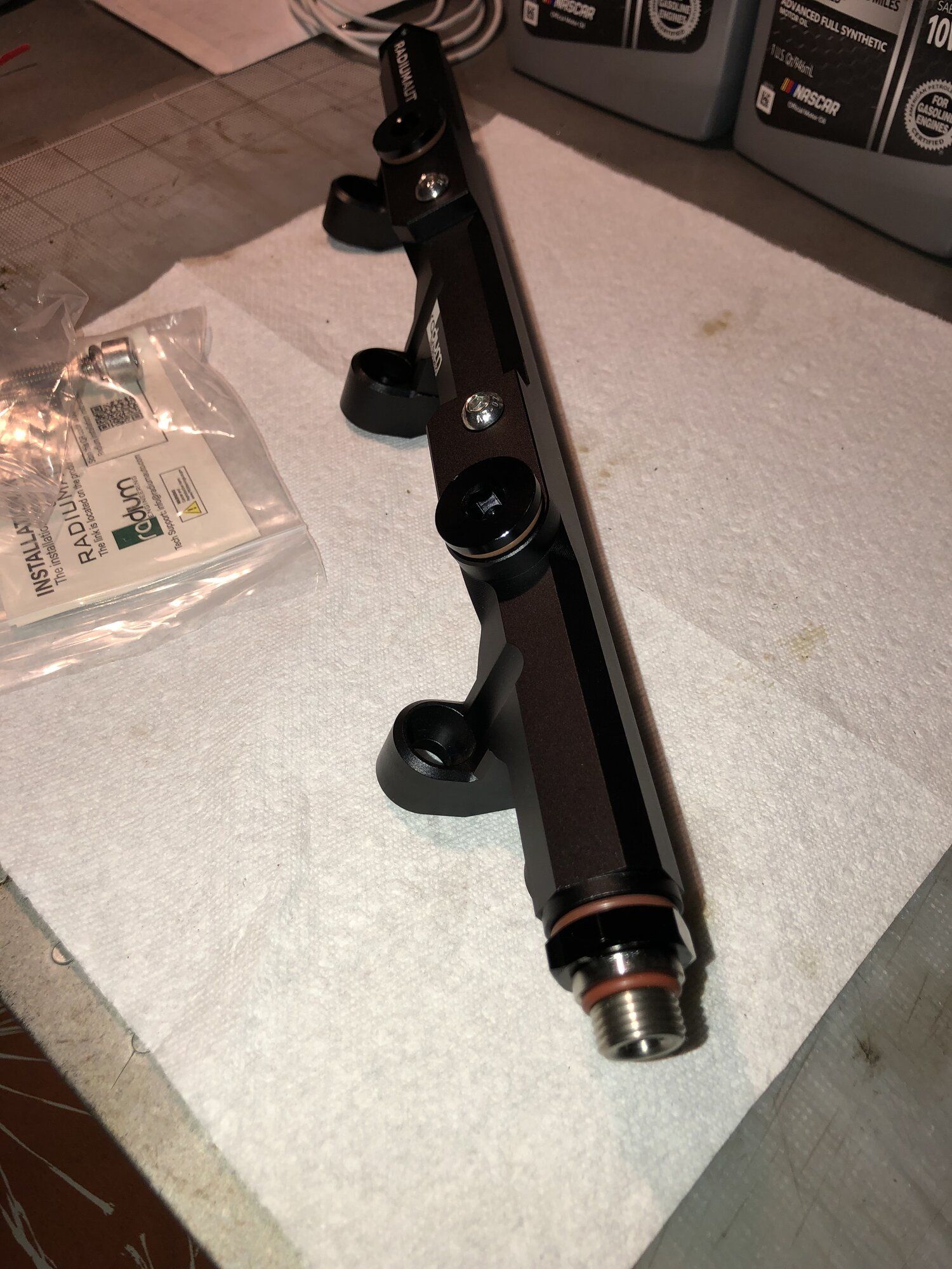

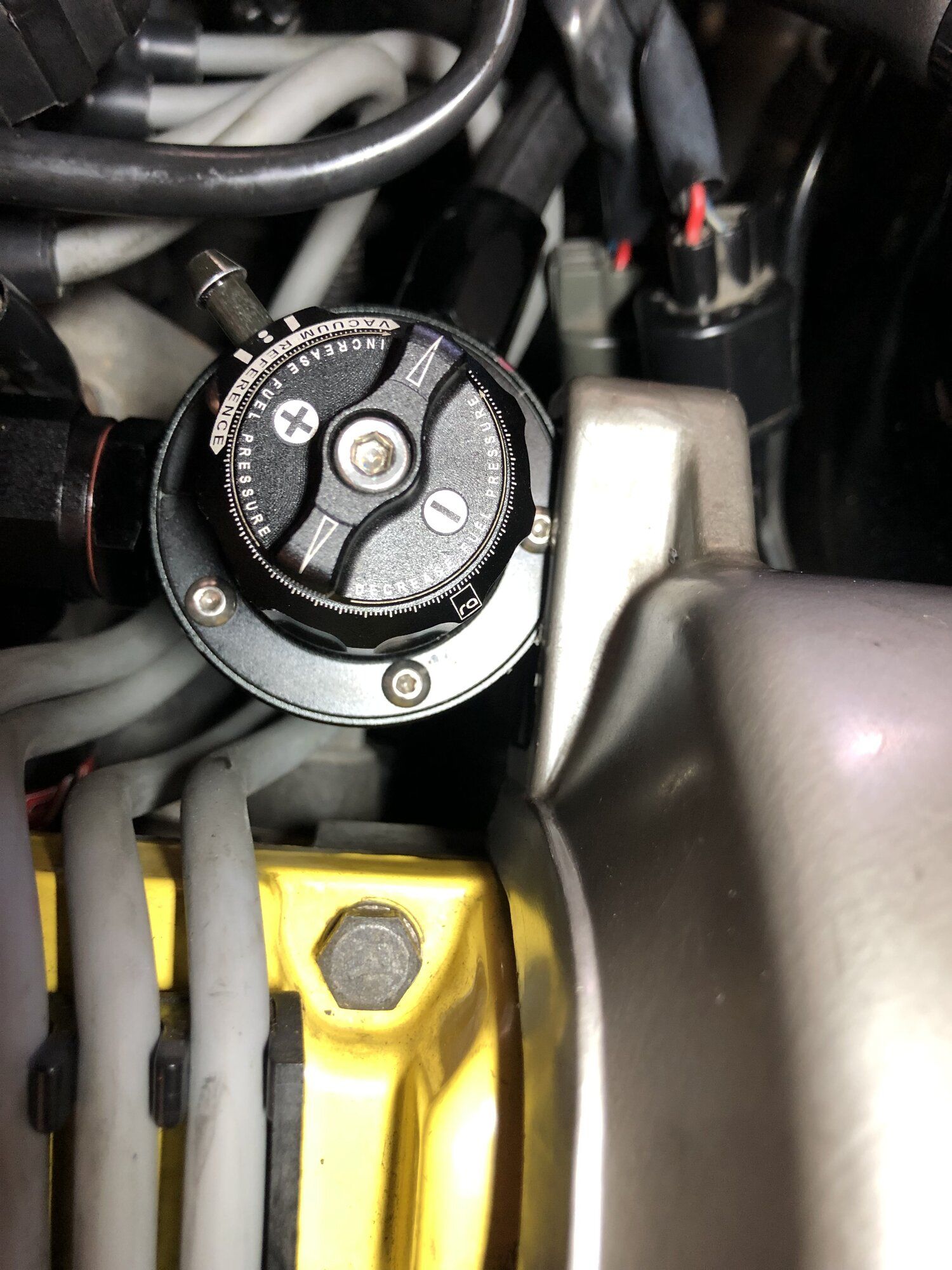

For my Birthday I decided to address a small detail that has been bugging me ever since I added the AEM340 and the upgraded radium FP regulator.
I want to hang the FP regulator directly on the end of the fuel rail. I had to compromise with a 90deg elbow, and it works, but I just don’t like how much leverage it has hanging out there in a place with lots of vibrations.

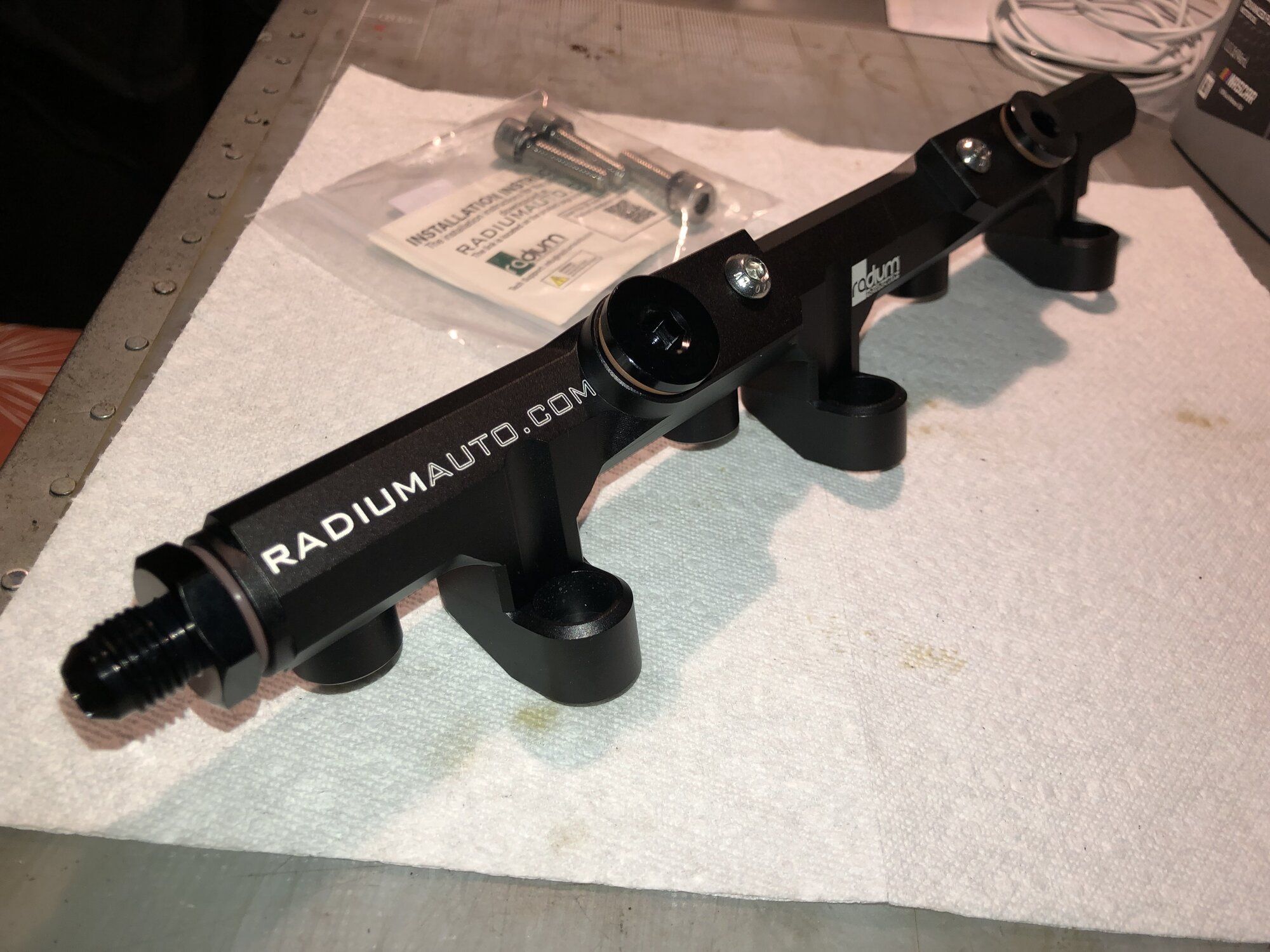

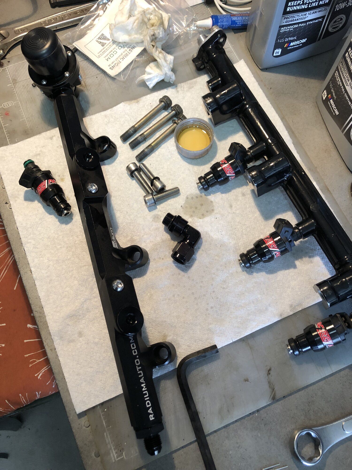

Instead of cutting an ORB into a stock fuel rail, I went for it, and picked up a matching Radium fuel rail with the ideal fittings:

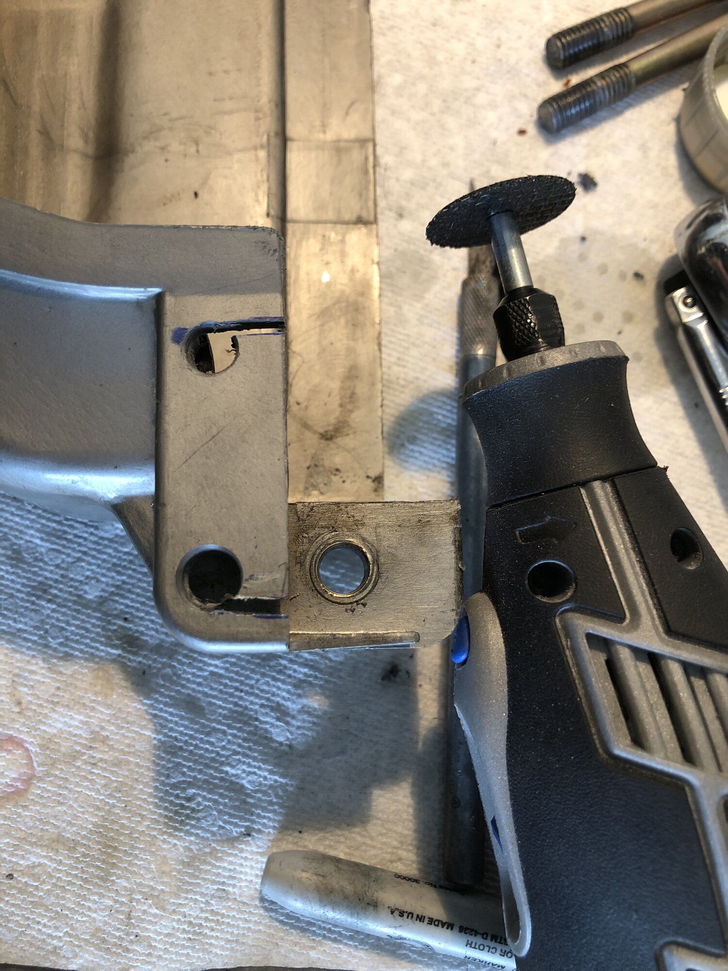

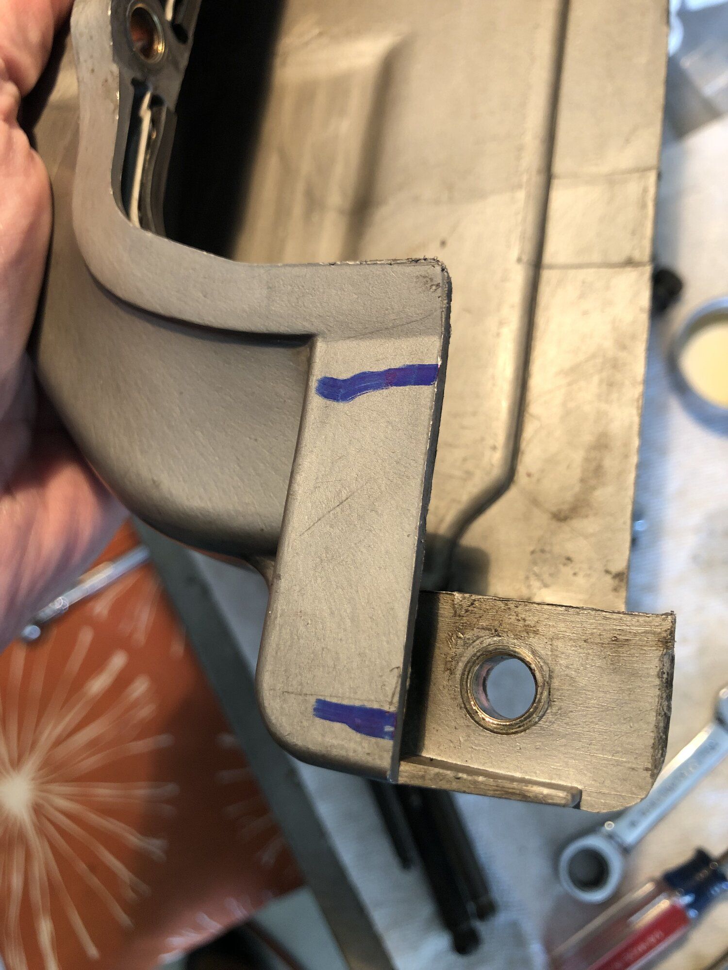

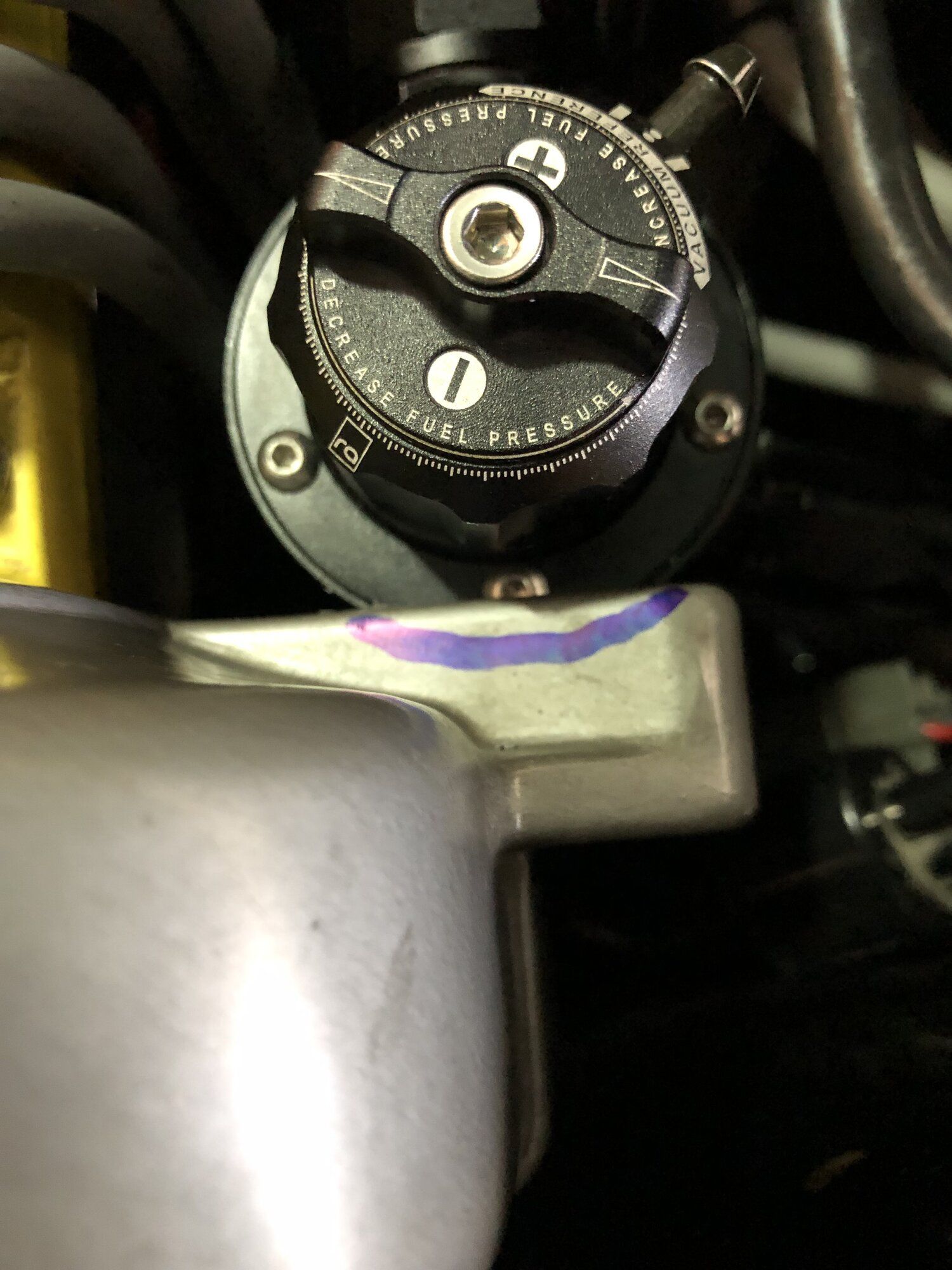

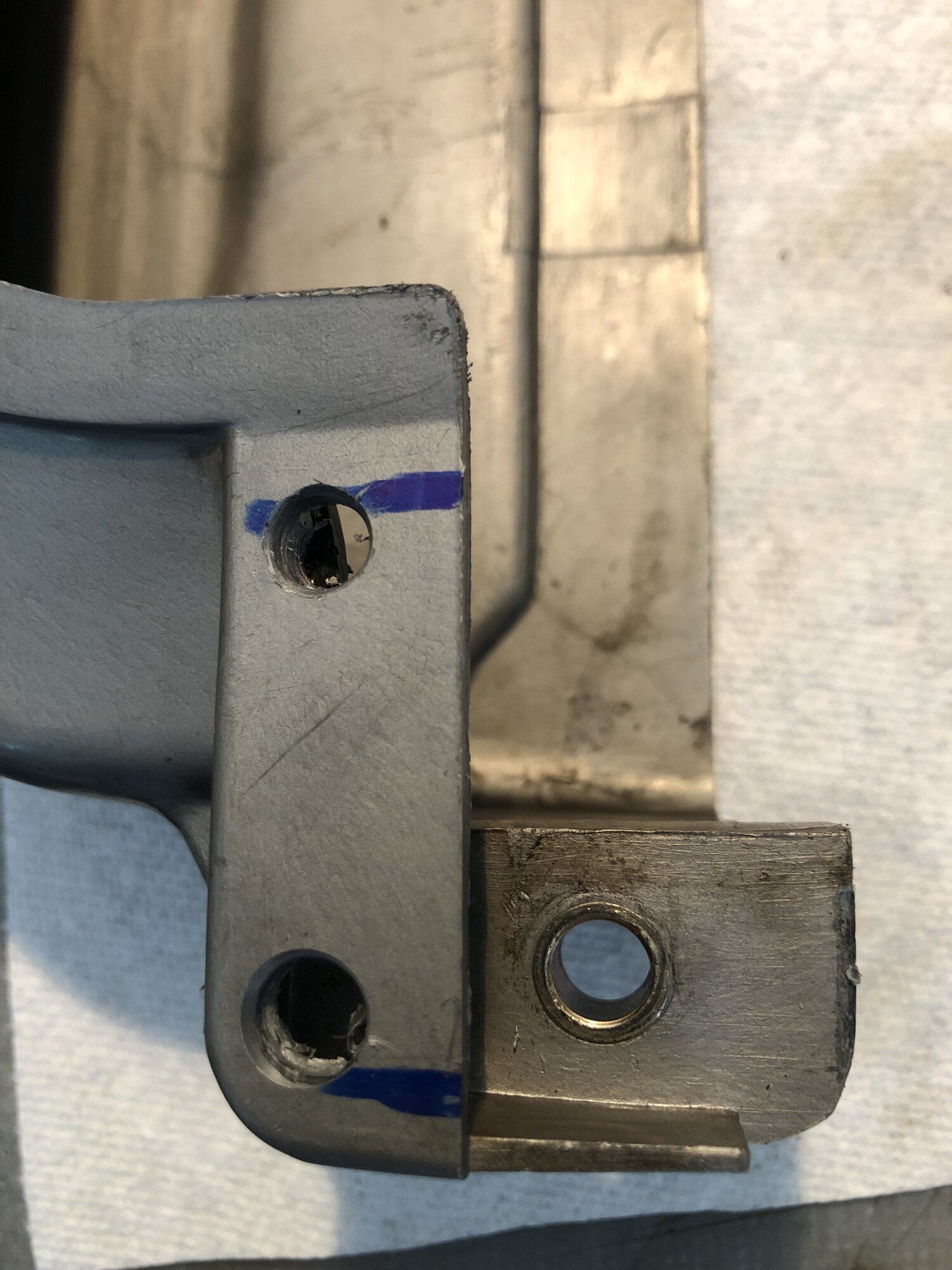

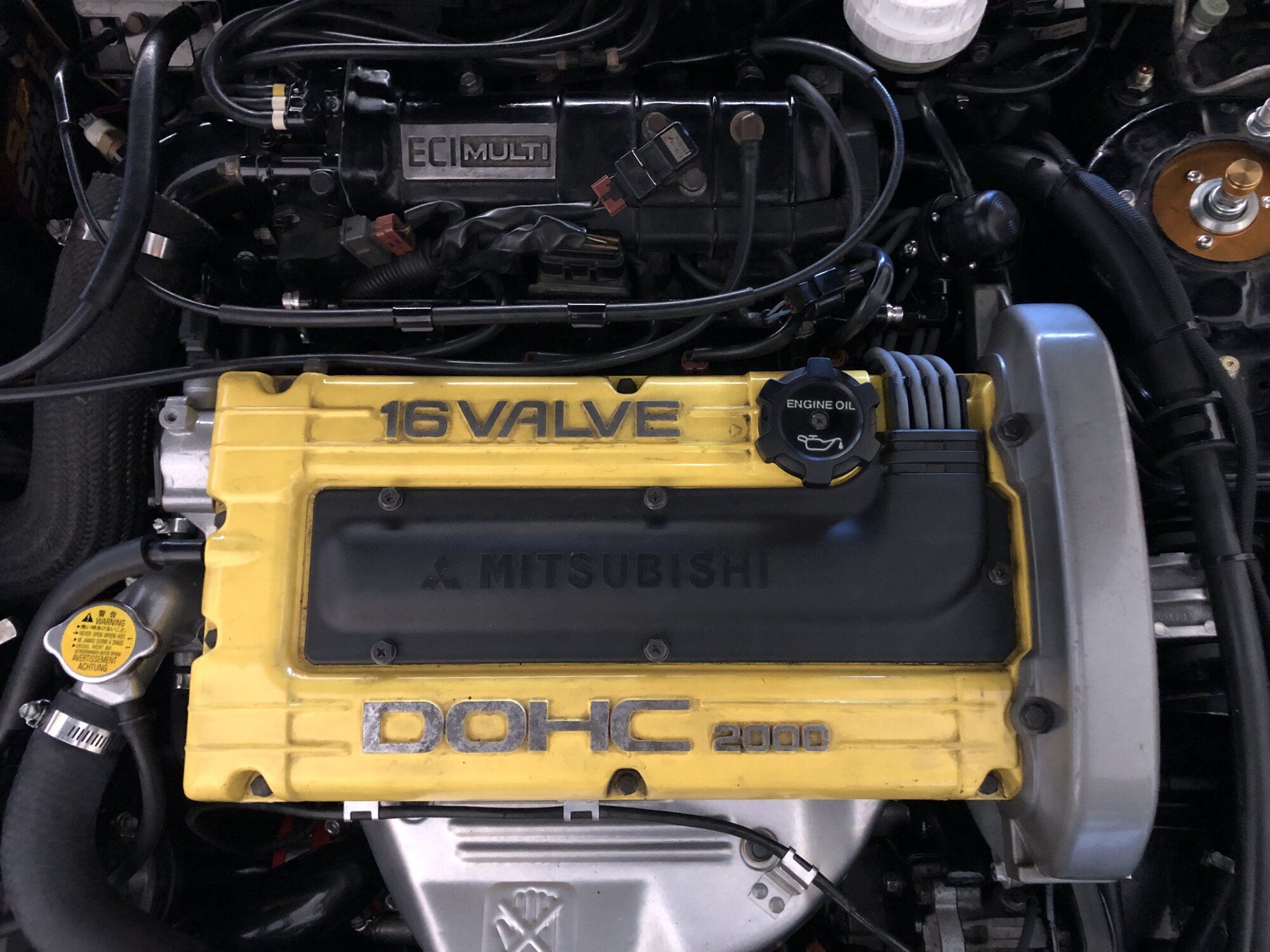

This require some additional work to clearance the stock Timing Belt cover, and I think it worked out quite well.
I've been eyeballing that rail and regulator setup for quite a while but thought it might contact the timing cover. Did you have to cut the inner tin at all?
On a side note, any idea what size the orifice is on it? Wondering if it's able to regulate a larger pump, 525/535?
One of those pics shows how close it is to the rear tin - no cutting on those. The only clearance needed is with the plastic on the upper cover. Cosmetic, not structural.
I would expect support for VERY large pumps with this regulator - but you can get the technical specs online, and see what the largest output AN size they offer. You can mix and match all kinds of fittings for their stuff.
