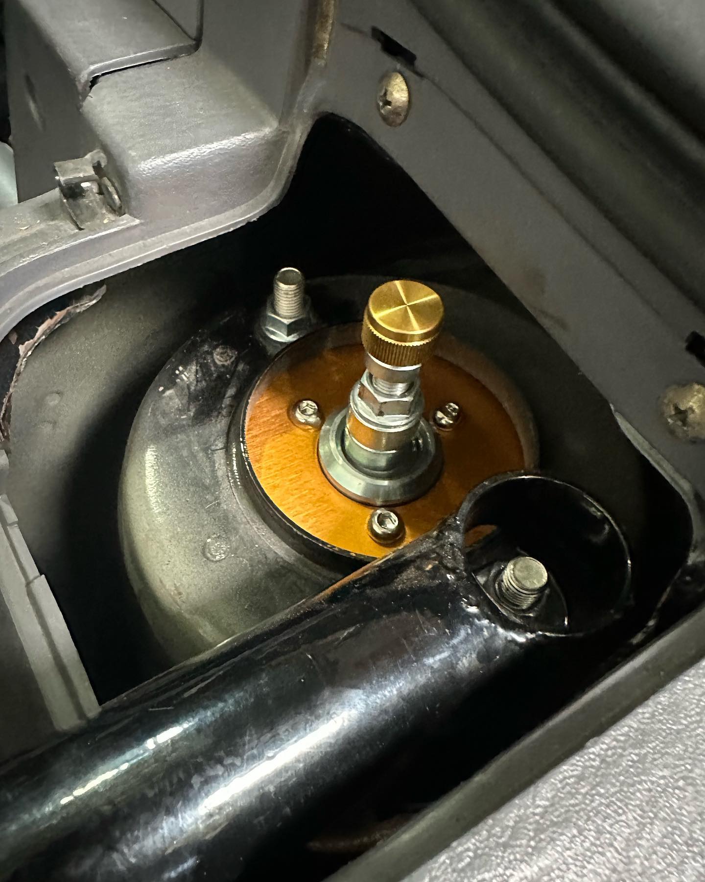

I cut clearance/access holes in the rear strut tower covers with a hole saw:
