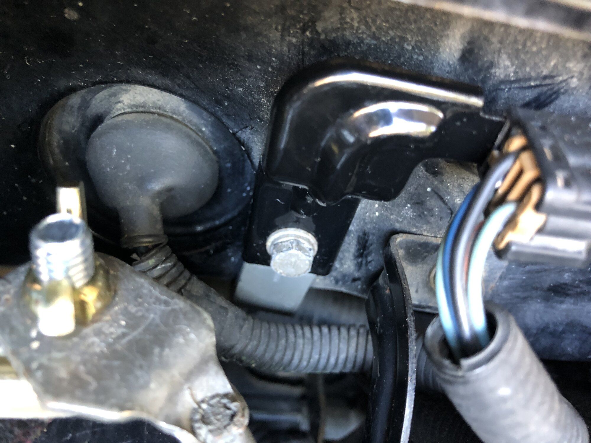

Curious why the 2Gb CAS didn't work out for you. Any ideas?
Otherwise, always nice to get things chugging along on their own!
That is the question - Why didn't the Kiggly Crank sensor and 2Gb CAS combo work?
I need to do a bit of problem solving to identify which of these two are causing the issue. I expect the issue is BTKAC (between the keybord and chair)

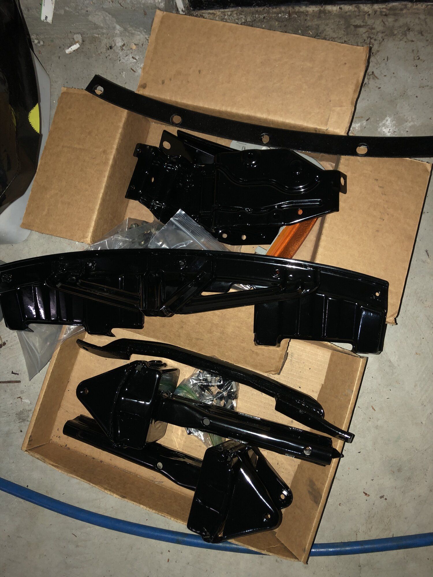

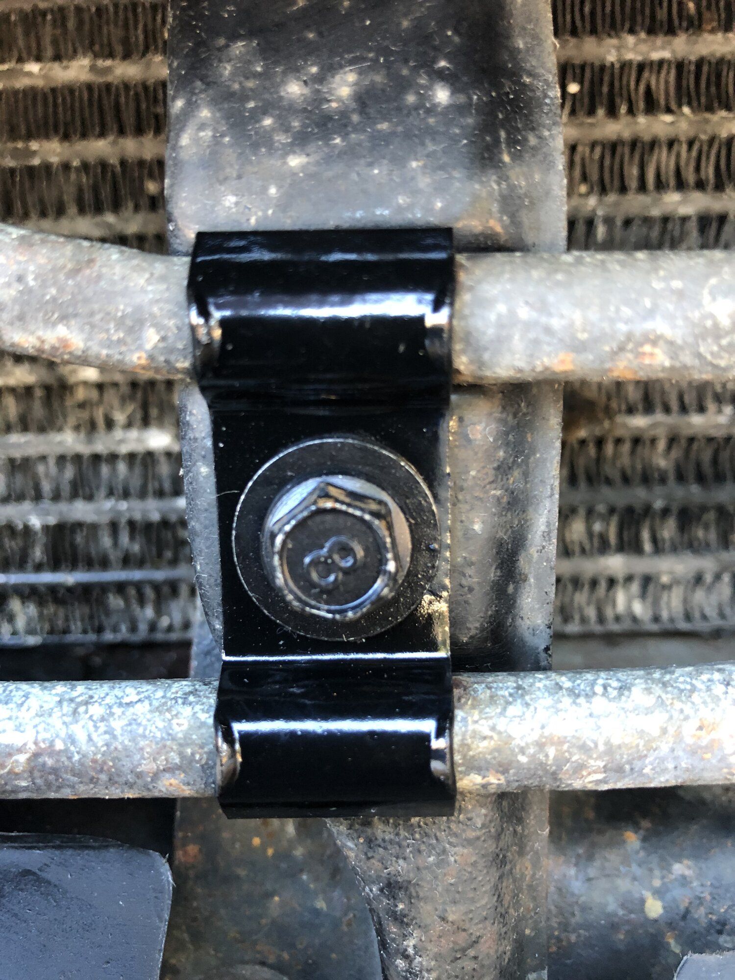

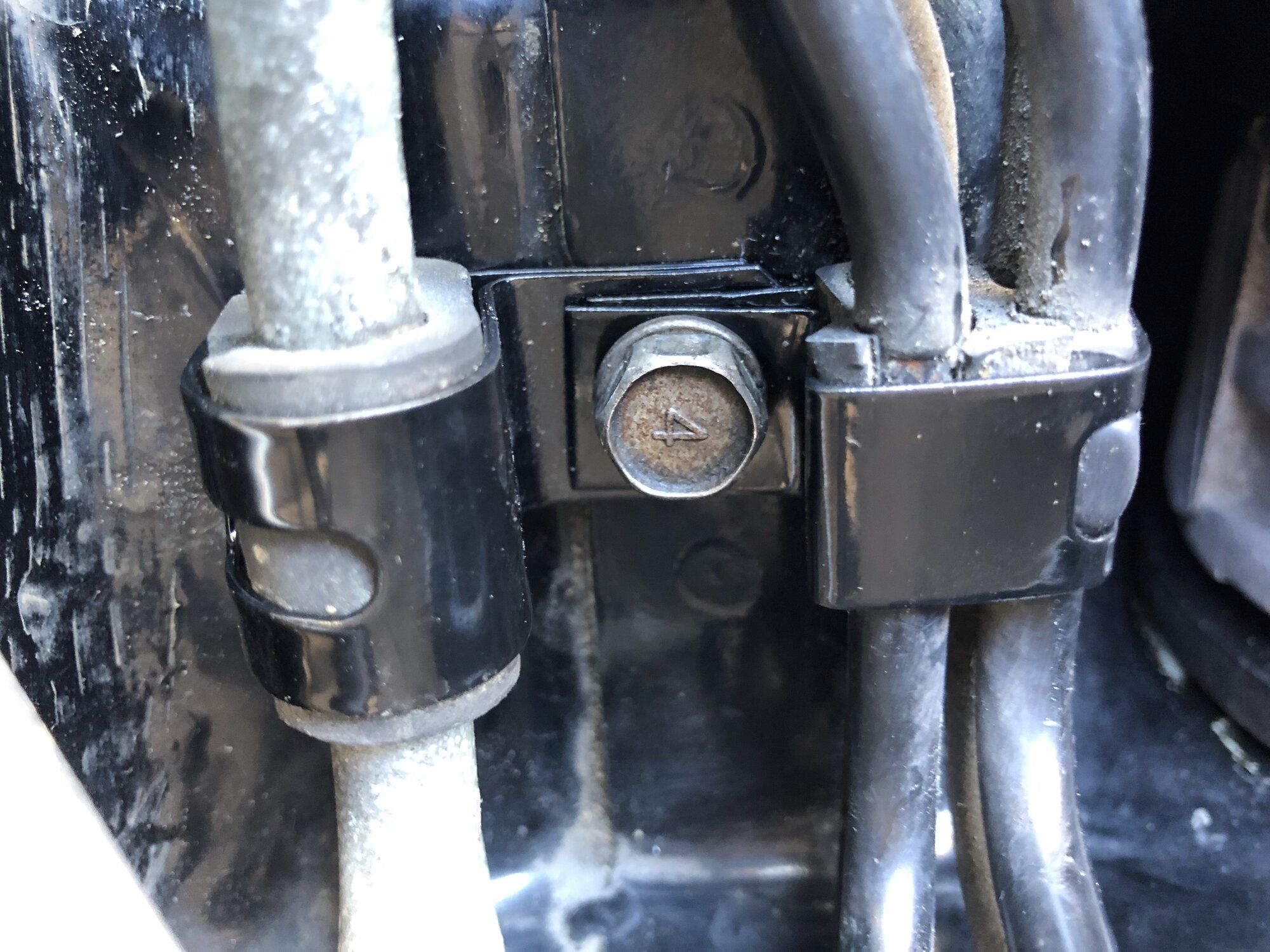

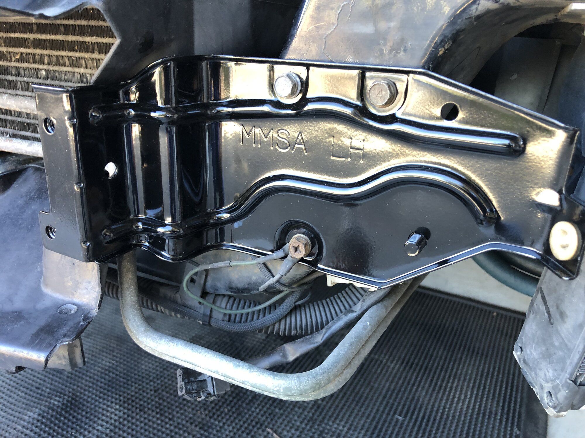

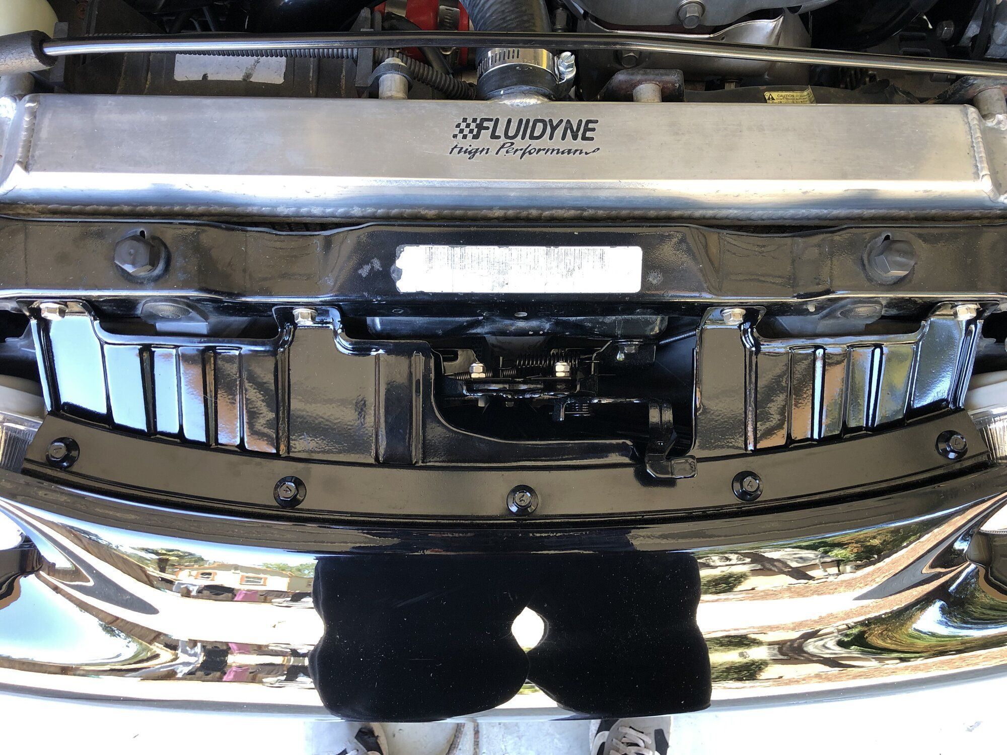

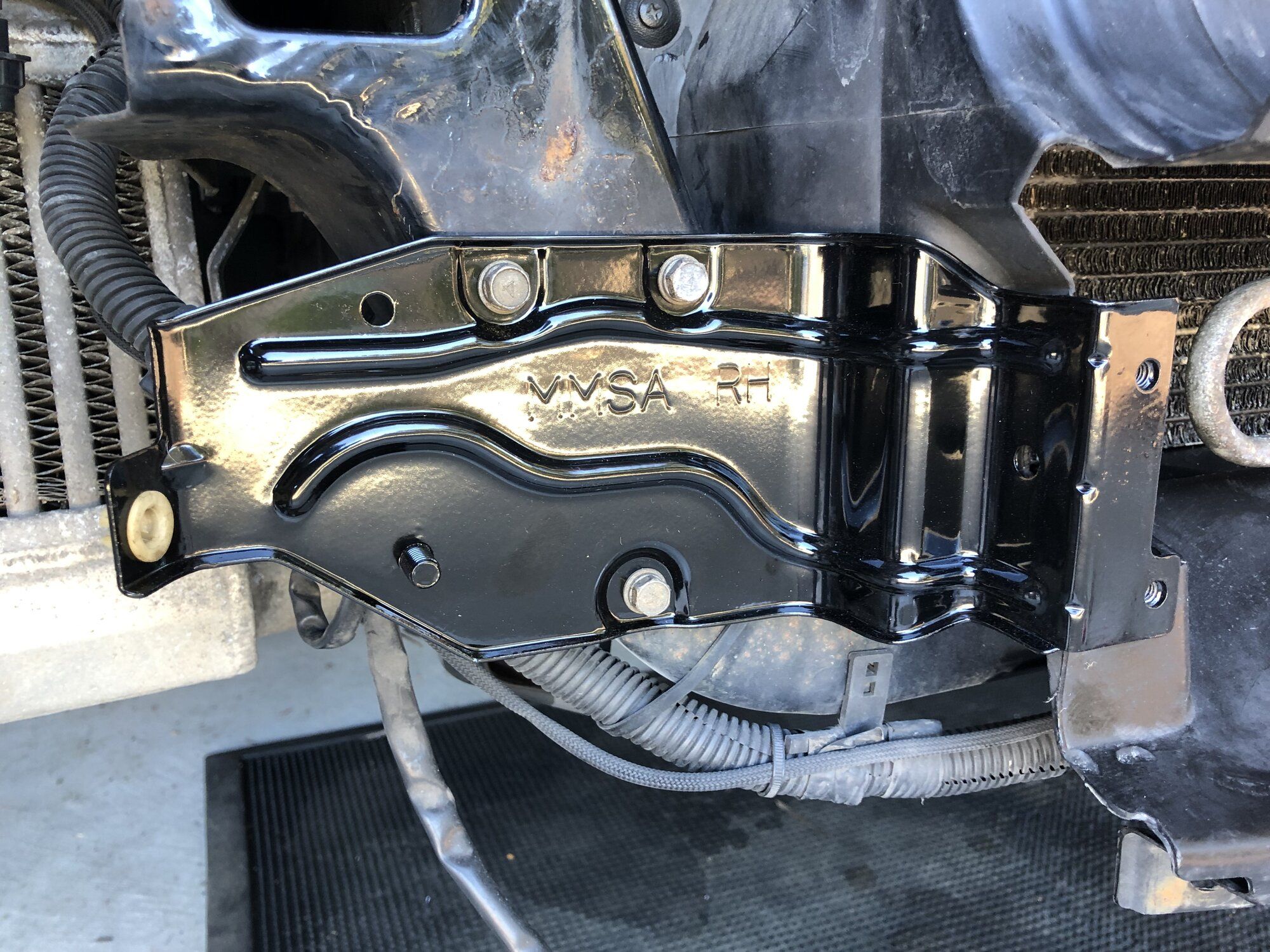

Front bumper brackets and misc powder coating (Completed)
Hot parts refurbish (spot welding) (Completed)

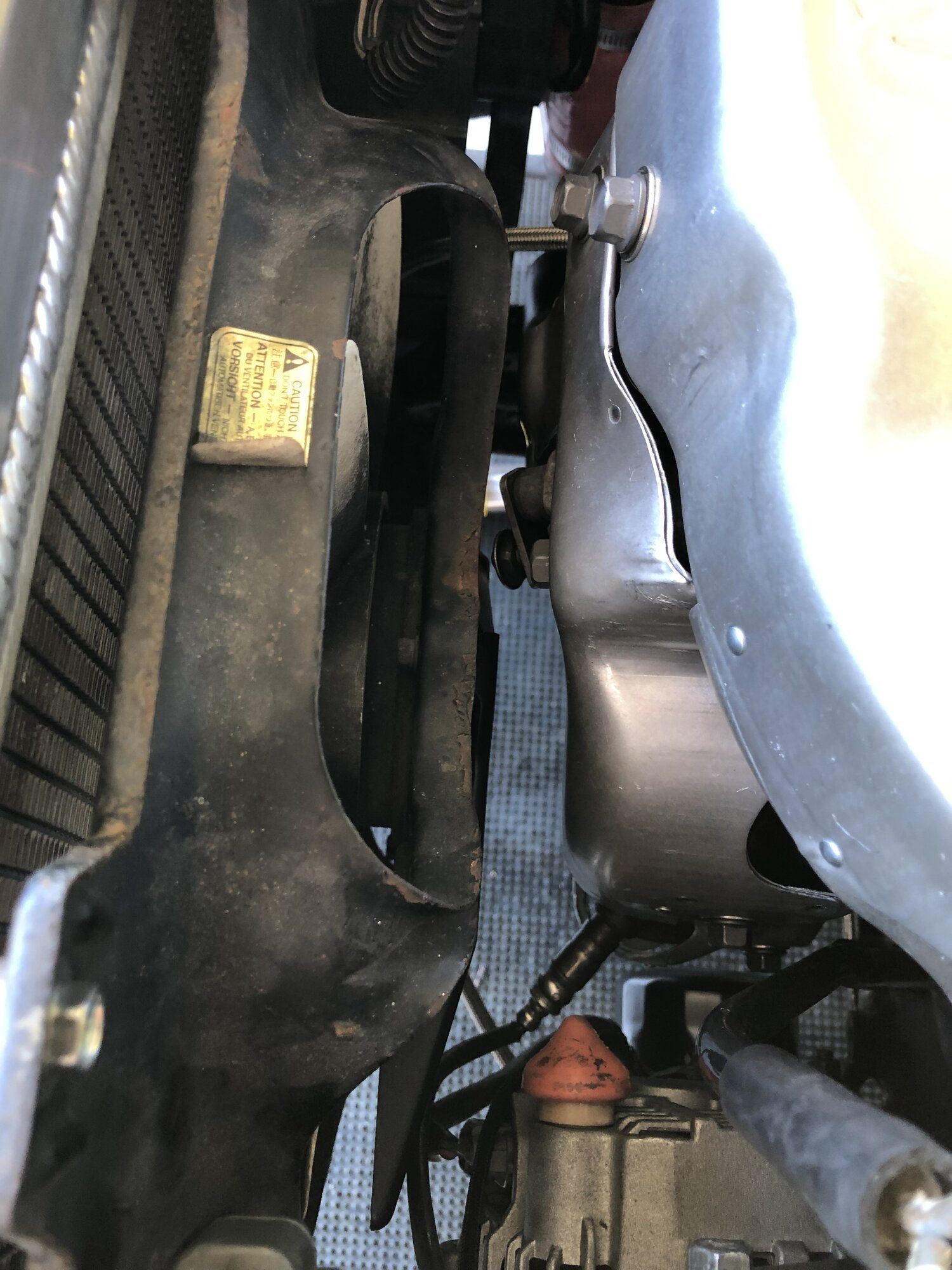

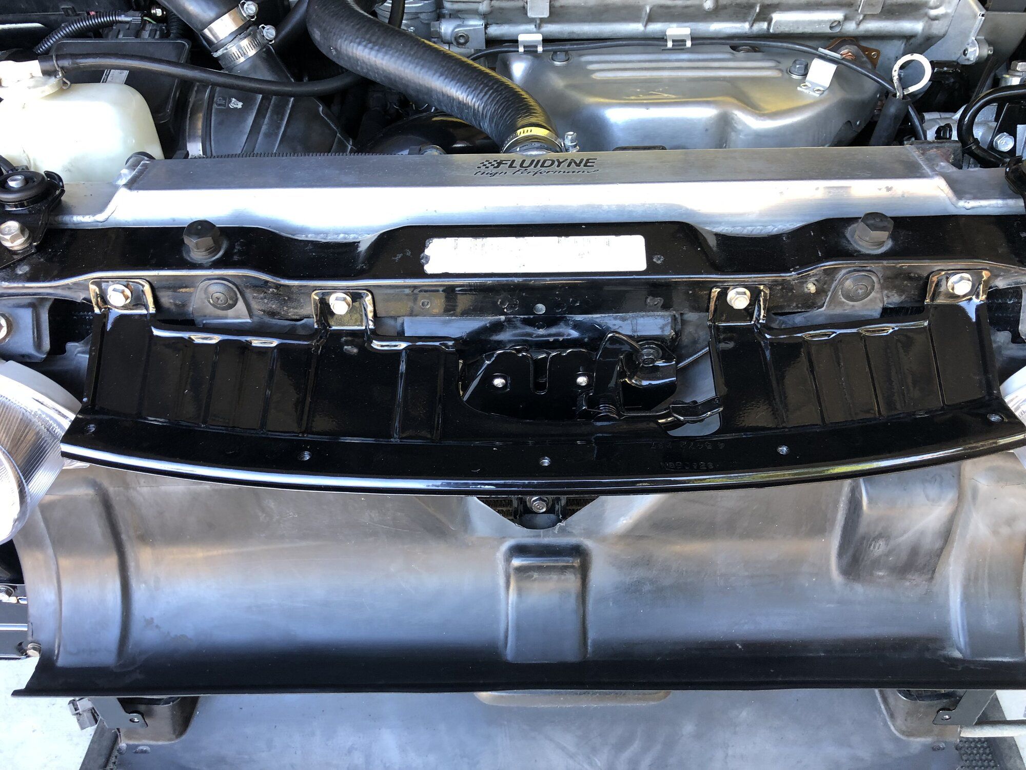

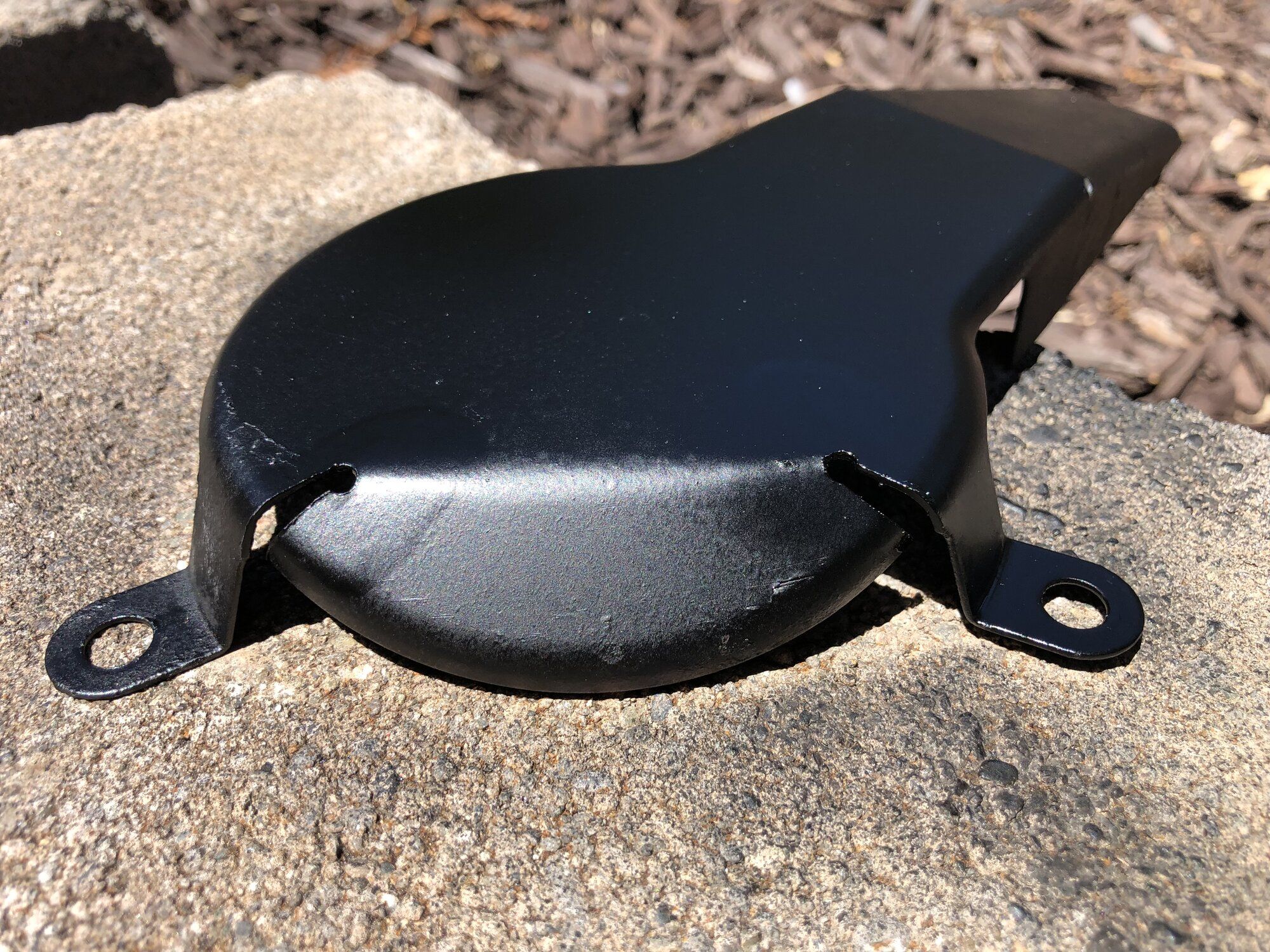

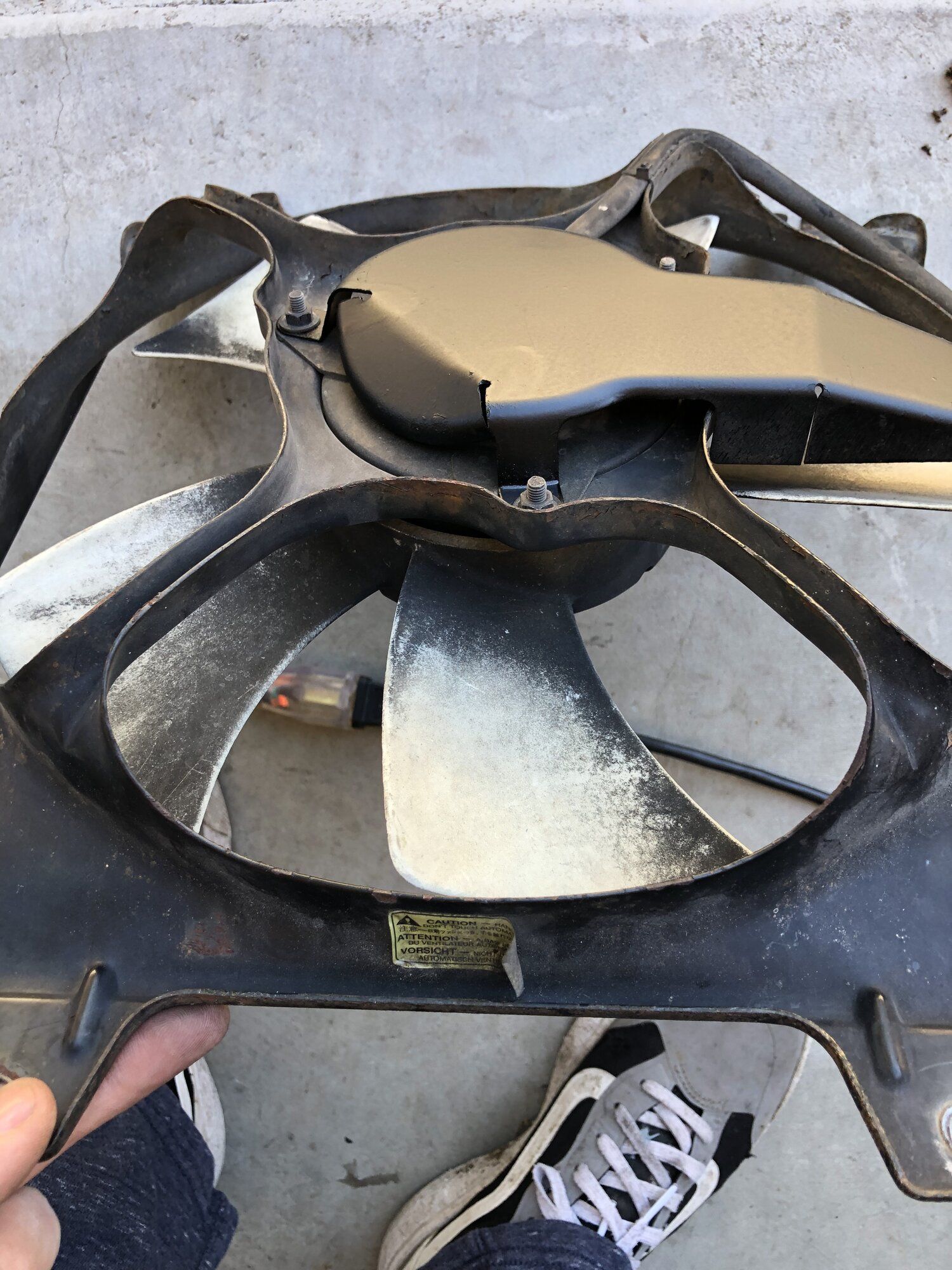

And clearance of the fan shield:
A couple holes and cuts make it easy to make a nice bend to push the edge of the shield away from the WG flapper
I can see daylight between the turbo and fan again

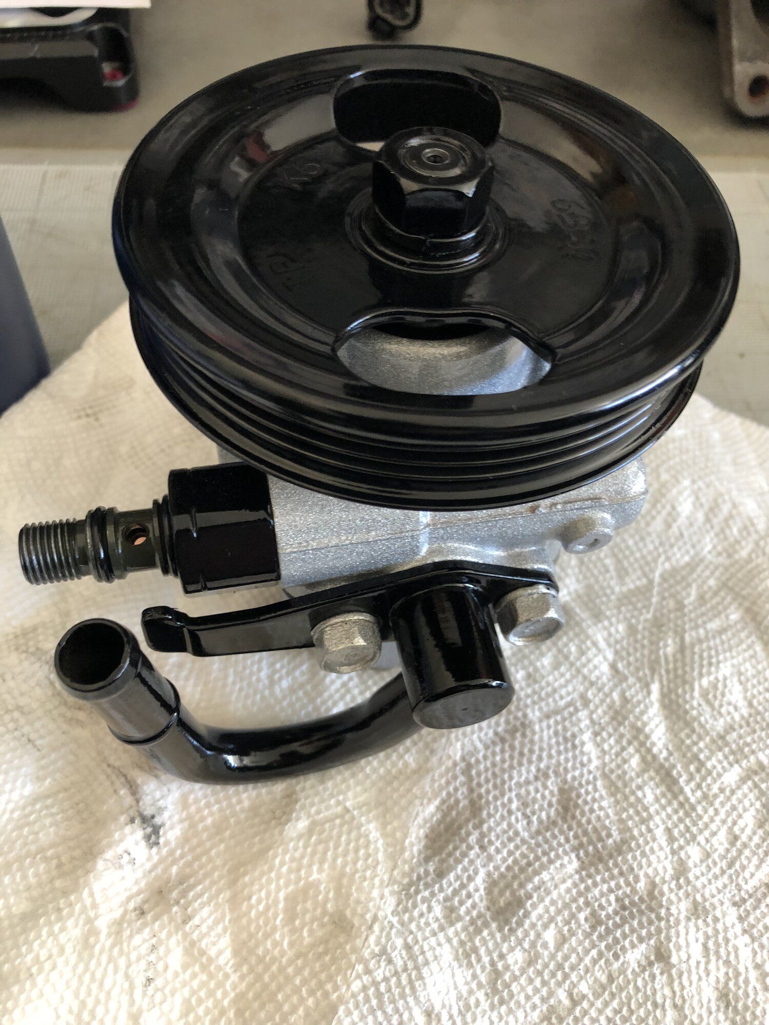

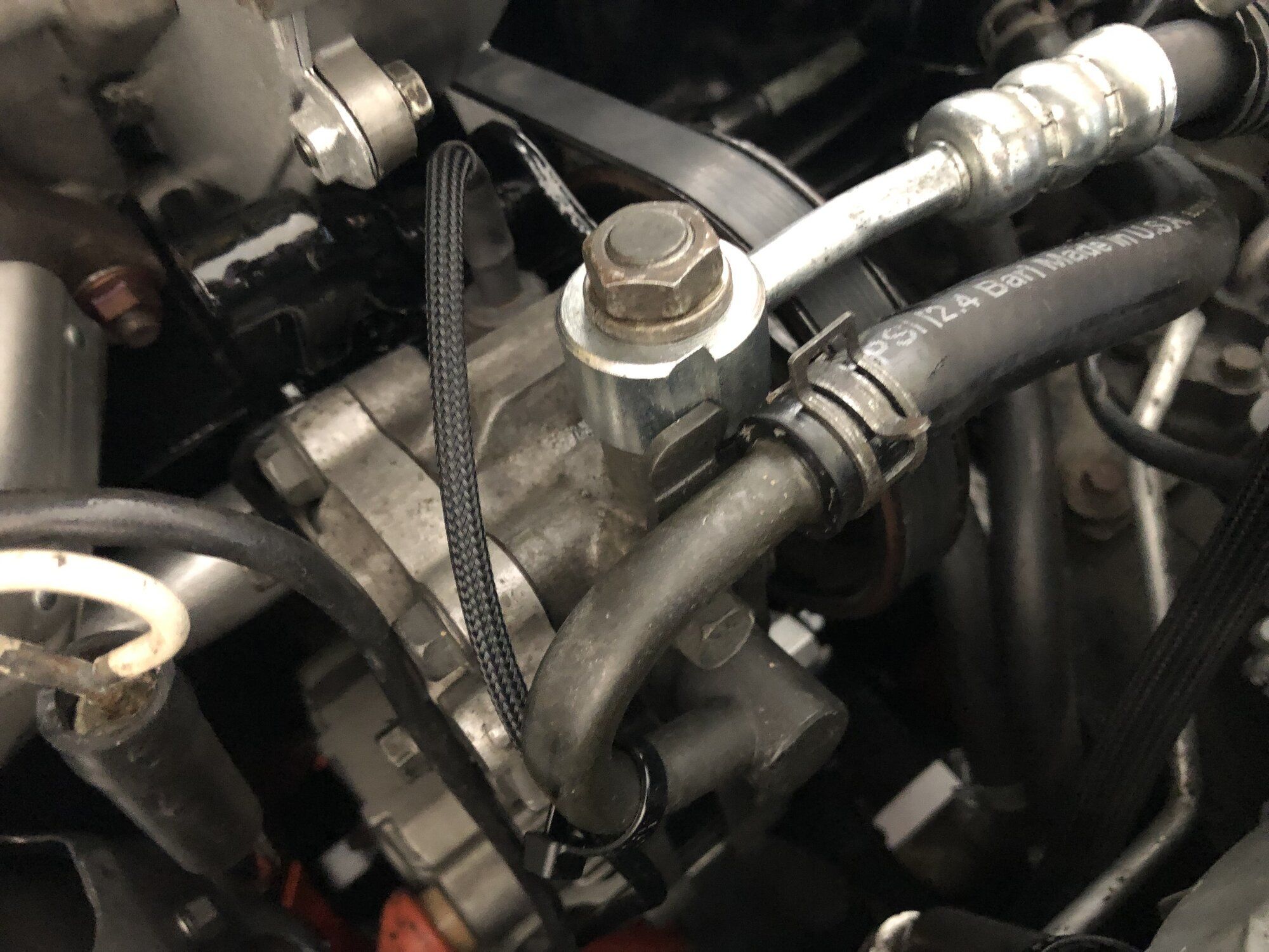

PS Pump issues
Beautiful rebuilt pump is not working quite right. It took a bit of messing around to finally admit the pump was the issue - Logic went like this:
Everything is installed ok, fluid is topped up, belts snug, spins nice, why no power steering?
Theory 1: Air bubble
Diagnostic action: Disconnect fluid supply hose, use hand pump to push fluid through the system, turn over the pump occasionally, reconnect and turn the wheel lock to lock a few times.
Result: No change
Diagnostic action: Increase RPM, turn the wheel
Result: Steering assist! Pump is pumping but not enough at lower RPM
Diagnostic action: Swap in the original pump - was working before, should work again, or it will point the finger away from the pump if the same behavior remains
Result:
Its working, even at idle.🤔
Well good enough for now, but the new pump needs adjustment.

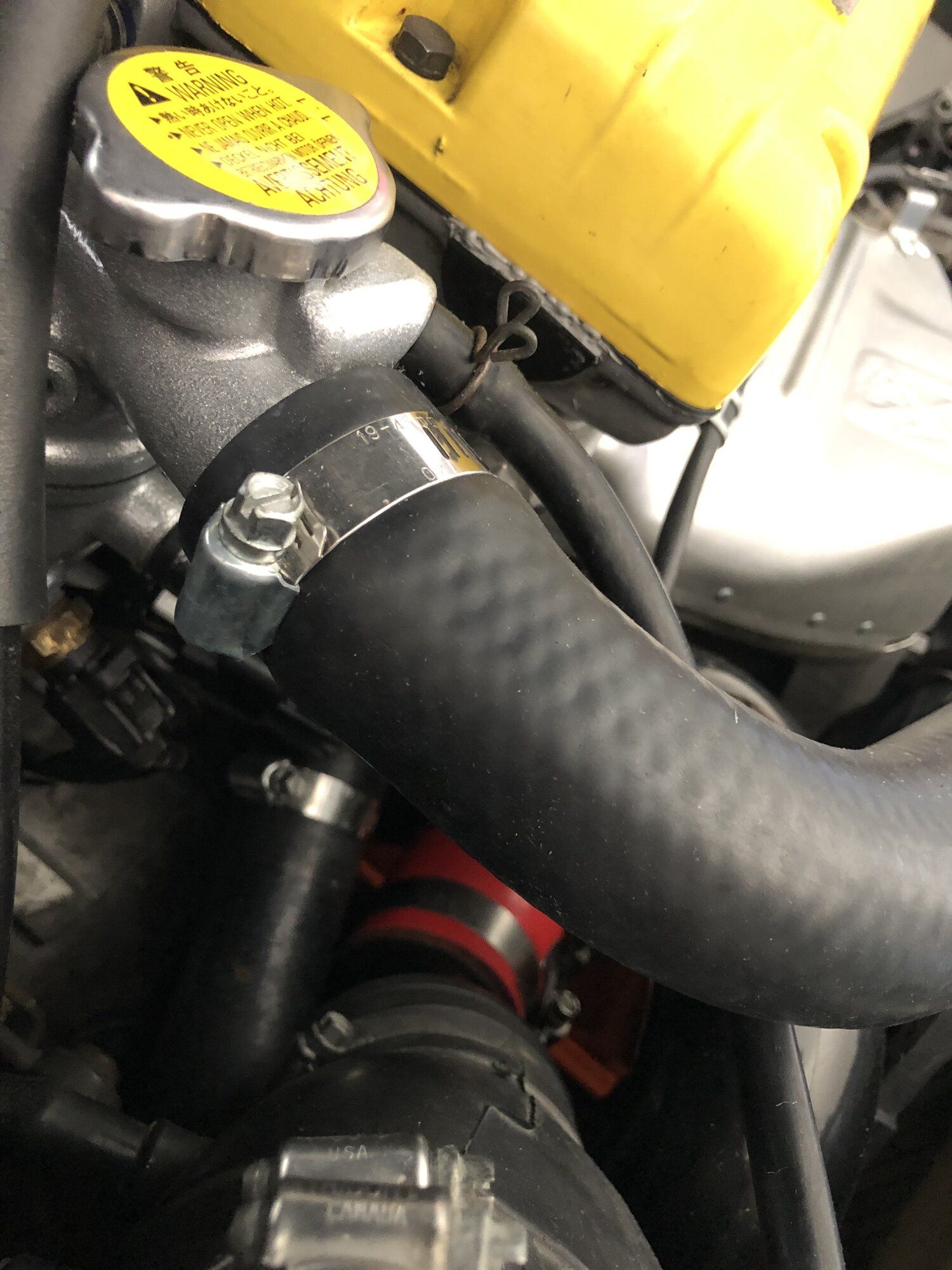

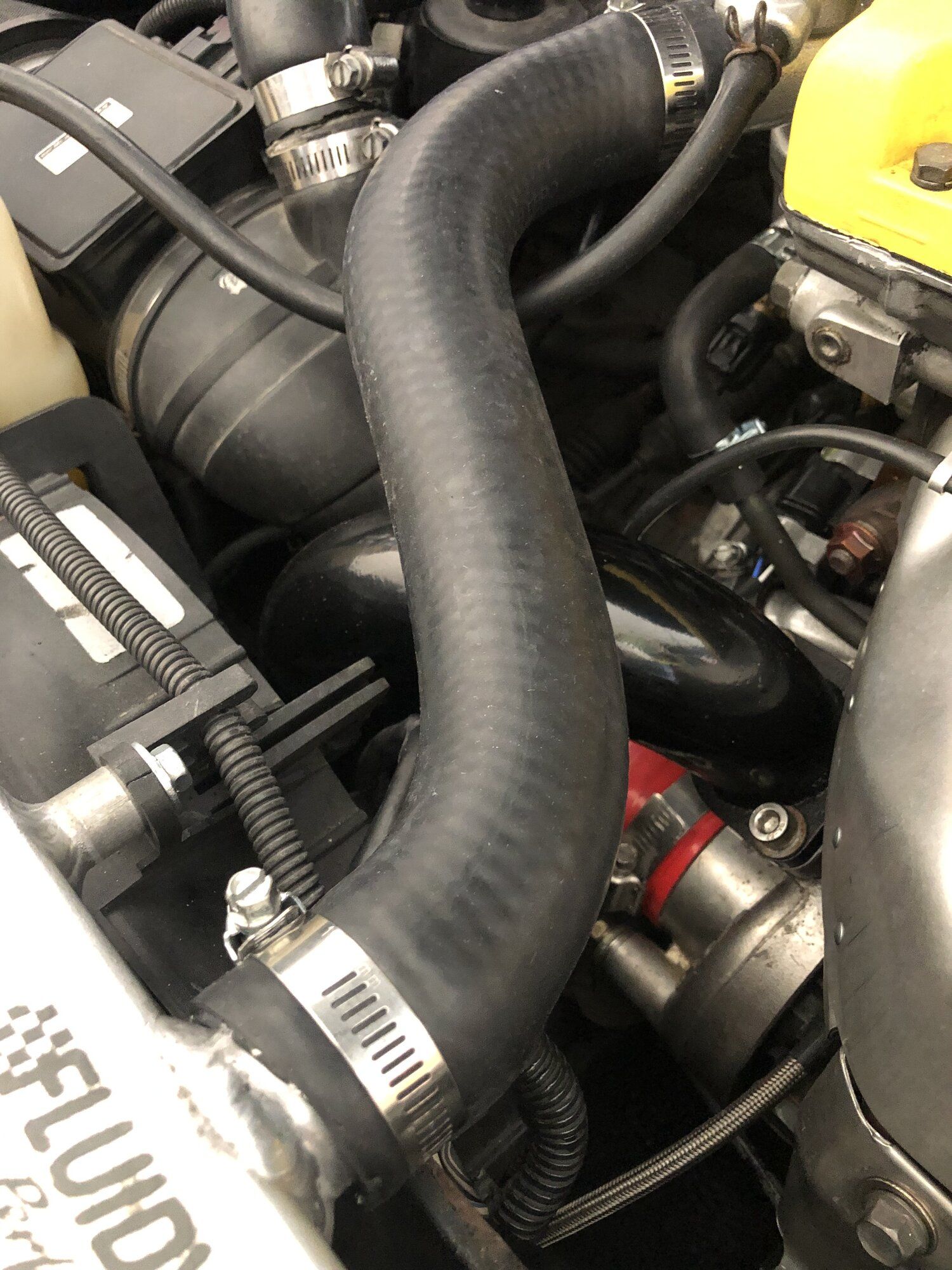

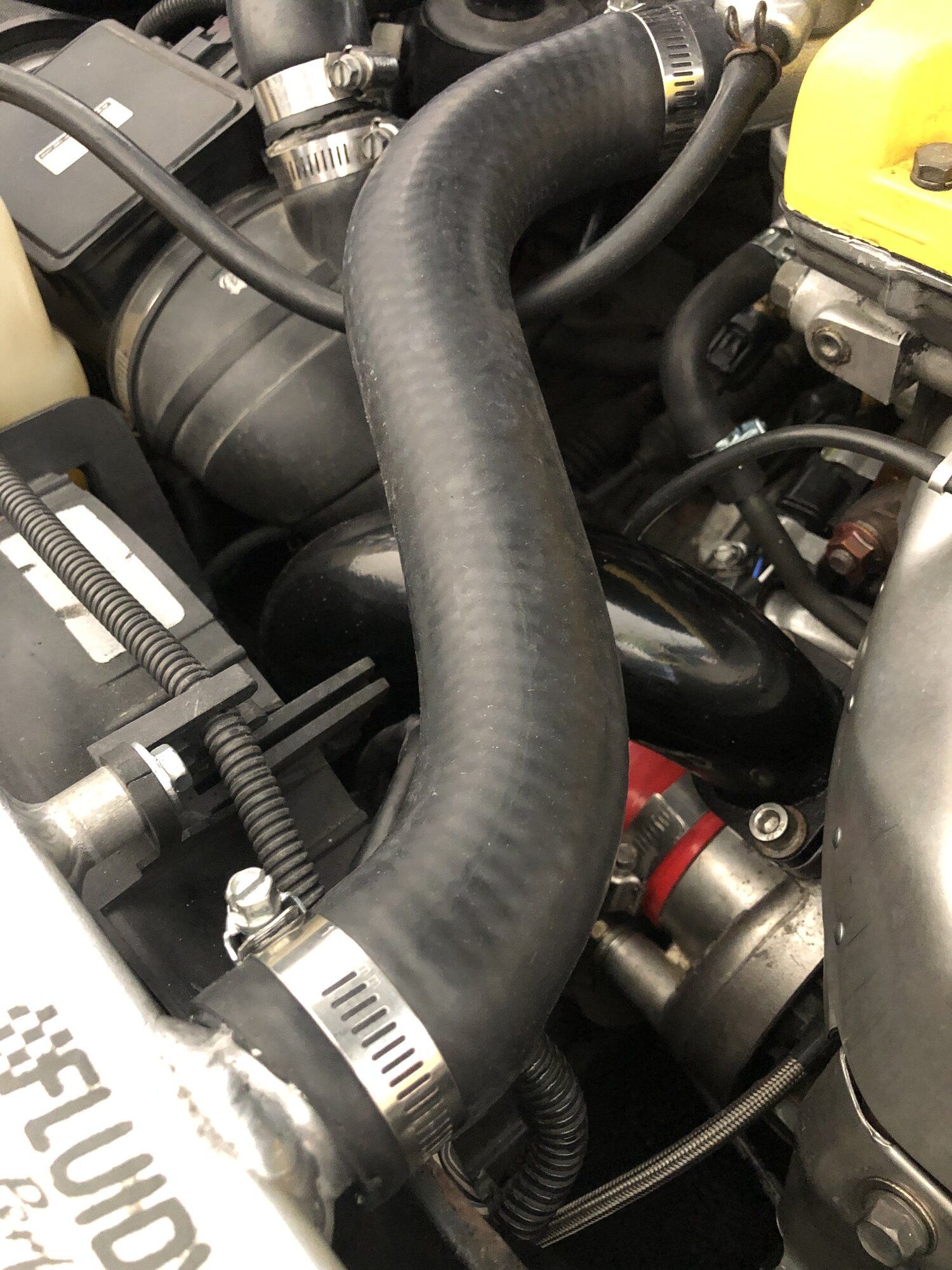

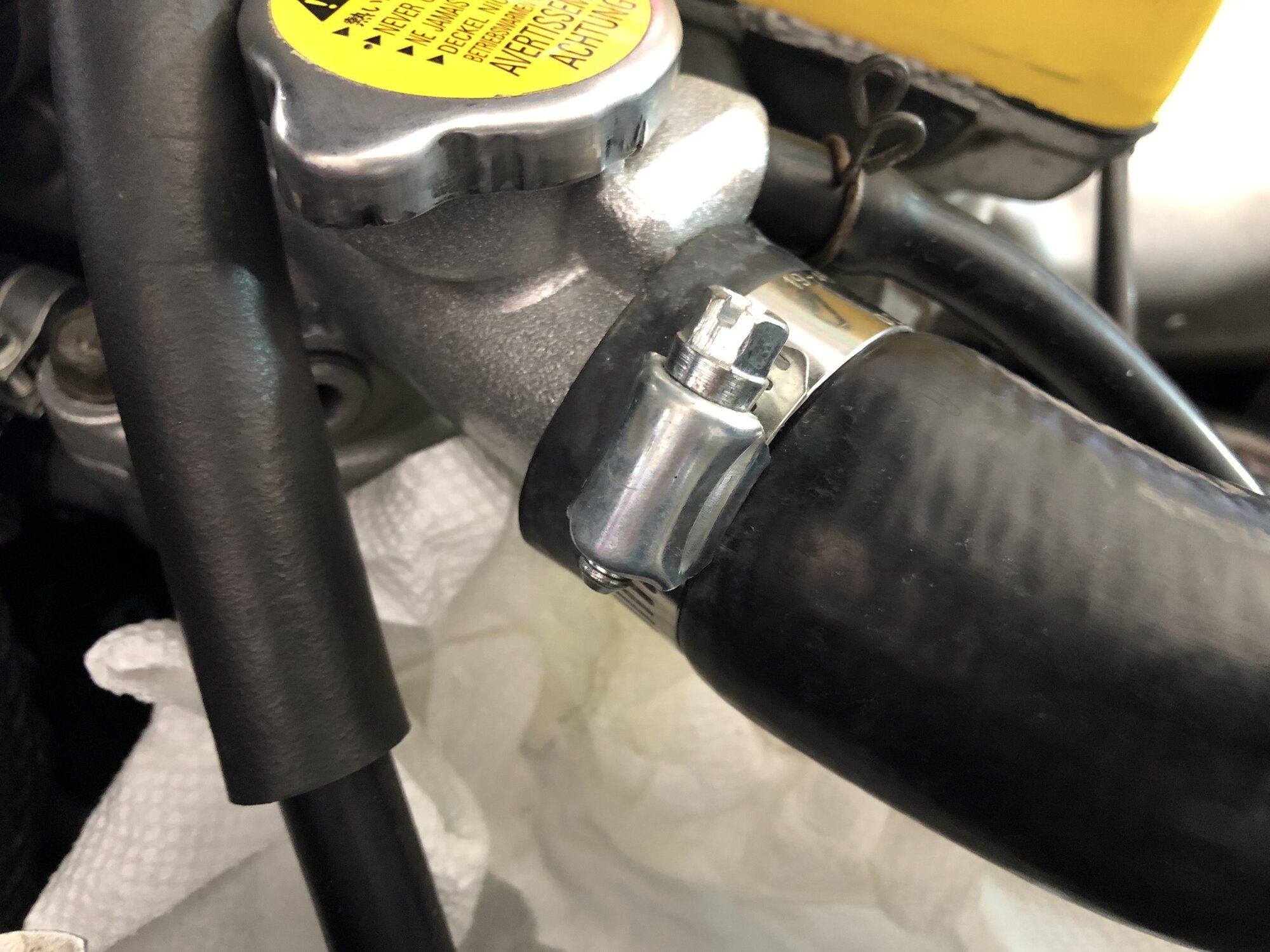

Now on to a minor leak from the upper coolant hose at the water neck
I think I’ll swap out the hose with a new one. So maybe someone can put my mind at ease, Is the cooling system normally pressurized so that the hose is tight to squeeze?
On consulting with Rich, he suggested unbolt and re-torque the pump housing (4 bolts) - Done. Found again, I need a deep socket 24mm - that I don't have. A quest!

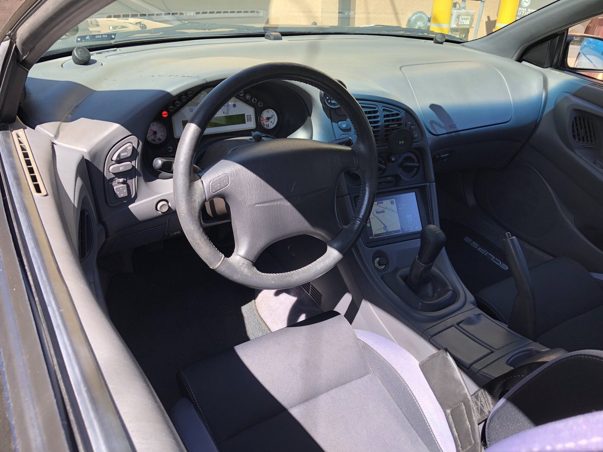

Used the cigarette lighter for its first time
Turned on the car, and connected the phone with car-play - Depesch Mode
Shutdown ECU Logging and Timing (for maximum Pi4b performance)
Grabbed the joy controller from the glove box - and played Ms Packman, and Space Invaders

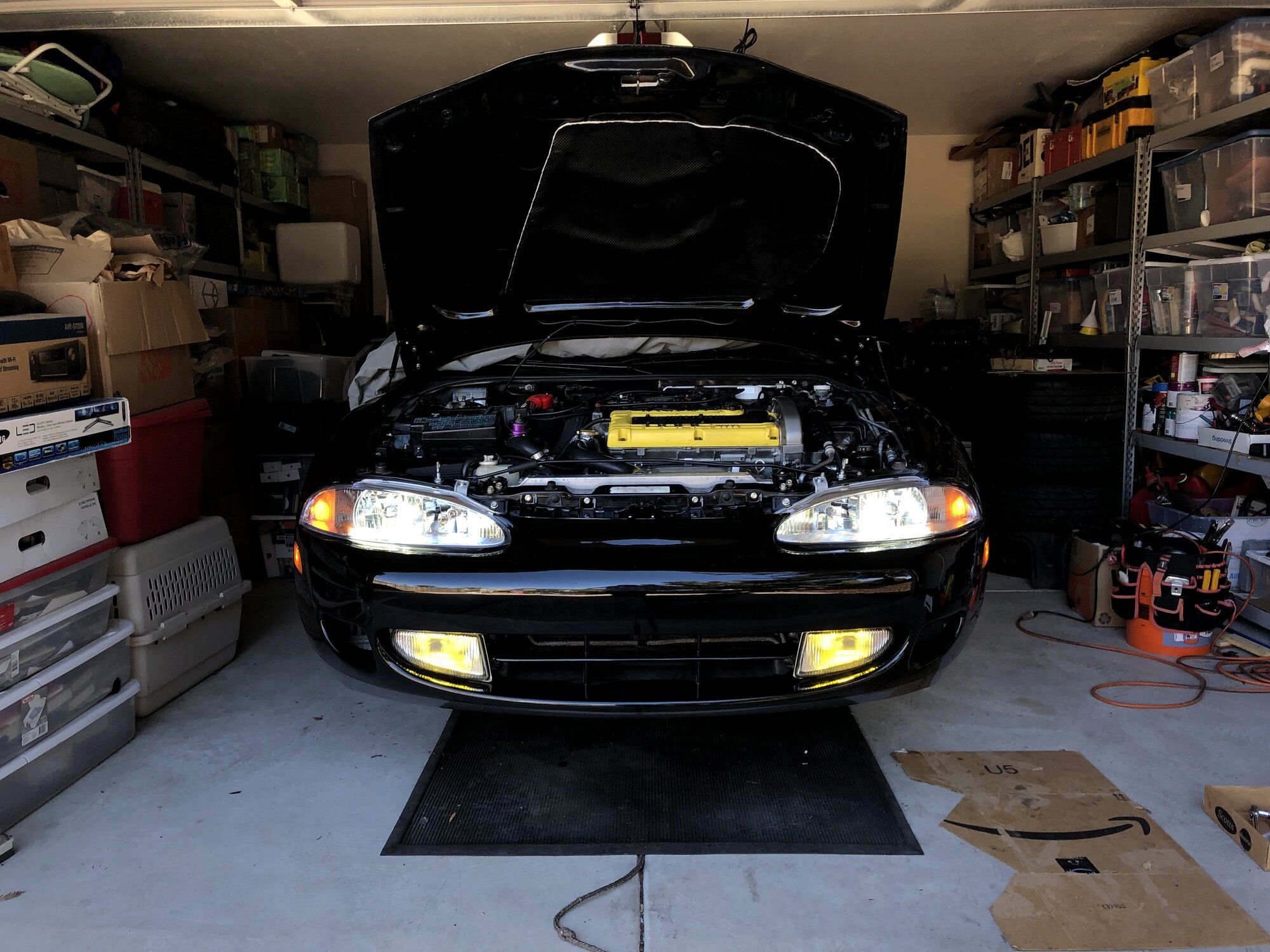

Test drive!
Got her out for a walk around the block
Mostly working as expected.
Idle is high, like 2k until the engine warms up, then it drops down to 850 at about 180deg coolant temp.
The BISS is all the way closed, and the ISC stepper position is still 0-10. Was hoping to see 30’s
Makes boost quickly, idle is ok after its warmed up. Still a little wonky to tap the throttle when RPM’s creep up to get it to fall back to normal.
Brakes are spongy, need to bleed I suppose.
When it is idling, it perrrrs nicely. Looks like I have addressed all of the leaks. This is good to go on the road! It has a trip planned to LA
