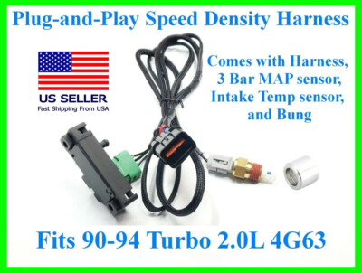

I couldn’t connect the ZT2 wideband to pin 15 (EGT), which is why I couldn’t provide an ECMLink log. But I want to share some information about my car. I’m really confused about pins 6 and 14. @steve wrote that on a 1990 harness pin 6 is green and pin 14 is green/white, but as you can see, pin 1 on my MAF sensor is green/white even though this harness is from a 1990.
I bought this set from this seller..
I hope you can help me with all these issues. I won’t give up with your support.
Pin 1 (MAF Reset) on the MAF connector should be green/white just like yours is and according to the 90 FSM that should go to pin 14 on a 90 ECU. The Idle Position Switch wire is green and runs to pin 6 on a 90 ECU. If you have a 91+ ECU those signals changed locations so the MAF Reset signal, still a Green/White wire, runs to pin 6 on the 91+ ECU and the IPS Green wire runs to pin 14 on the 91+ ECU.
This is exactly what I've been saying. I'm not sure what part of it you're not getting. It's not the color of the wires running to the sensors that changed but where those wires run to at the ECU. Between 90 and 91 the ECU pins changed and anytime you mix the two you have to correct for it.
