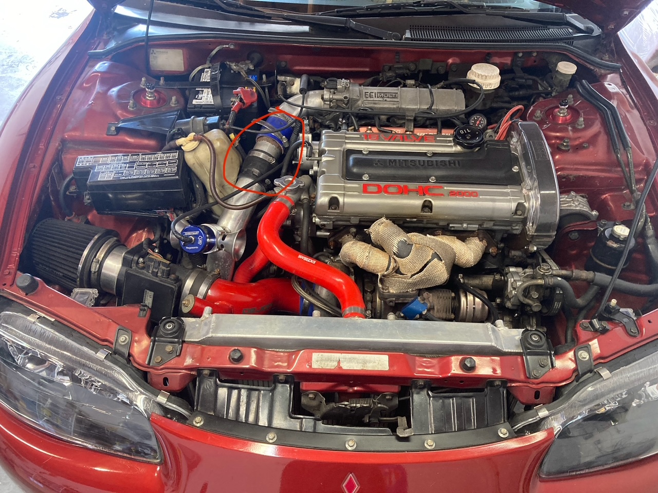

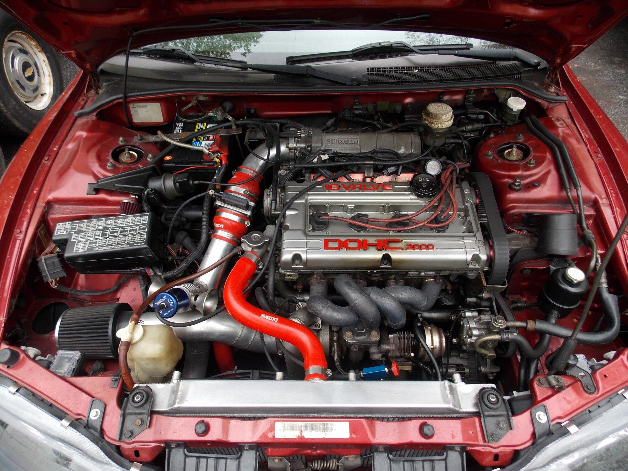

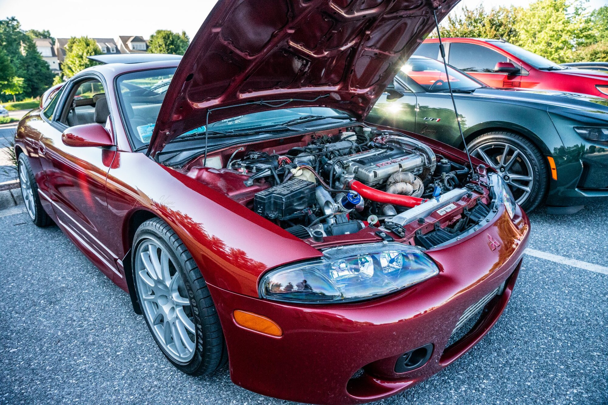

Ok so the winter project for this year was to clean up the engine bay by fixing the horrific patch job of intercooler piping that caused everything else on the intake side of the motor. You can see that the overflow tank no longer fit in its correct spot and that the intake/MAF had to be tilted on its side to fit:
The main reason for this ill fitting mess was the car was originally tuned on a GM MAF which was removed when the car was going through some troubleshooting early in my ownership. I was 17, didn't know anything about these cars (or much about any cars), no one I knew had these cars and my dad comes from a muscle car/hot rod background and didn't much either. Long story short, the car ended up at a guys shop who was at least somewhat familiar and he decided the car should have an OEM mitsu MAF... and so it did! That meant removing the length of pipe which included the MAF from the upper intake piping and replacing it with the length of pipe circle in the above picture, and it has not all fit well together since.
This is how the engine bay looked when I bought the car in 2014..
One could argue that I've made the engine bay look worse over the years...

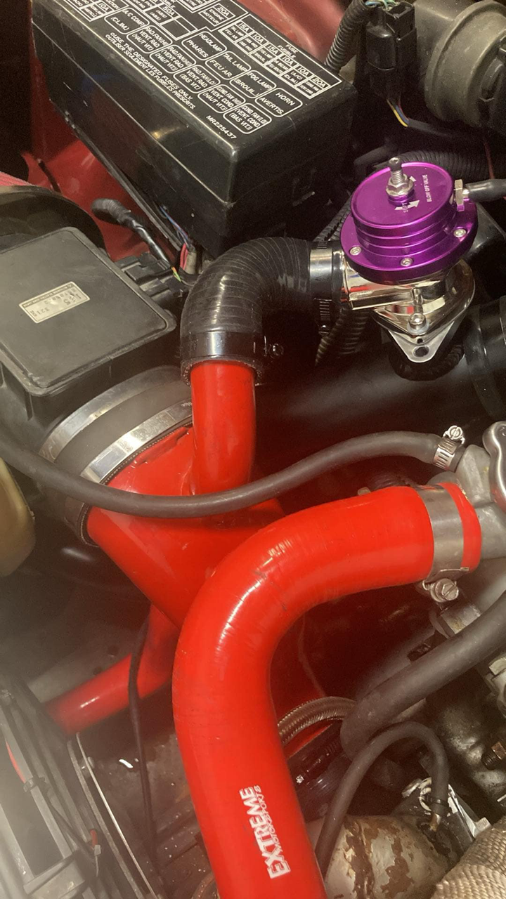

I decided on the CXRacing intercooler kit as it fit the budget and allows for use of stock fog lights, which I was excited to put back on the car as I haven't been able to run them due to the fitting of the old intercooler and piping.

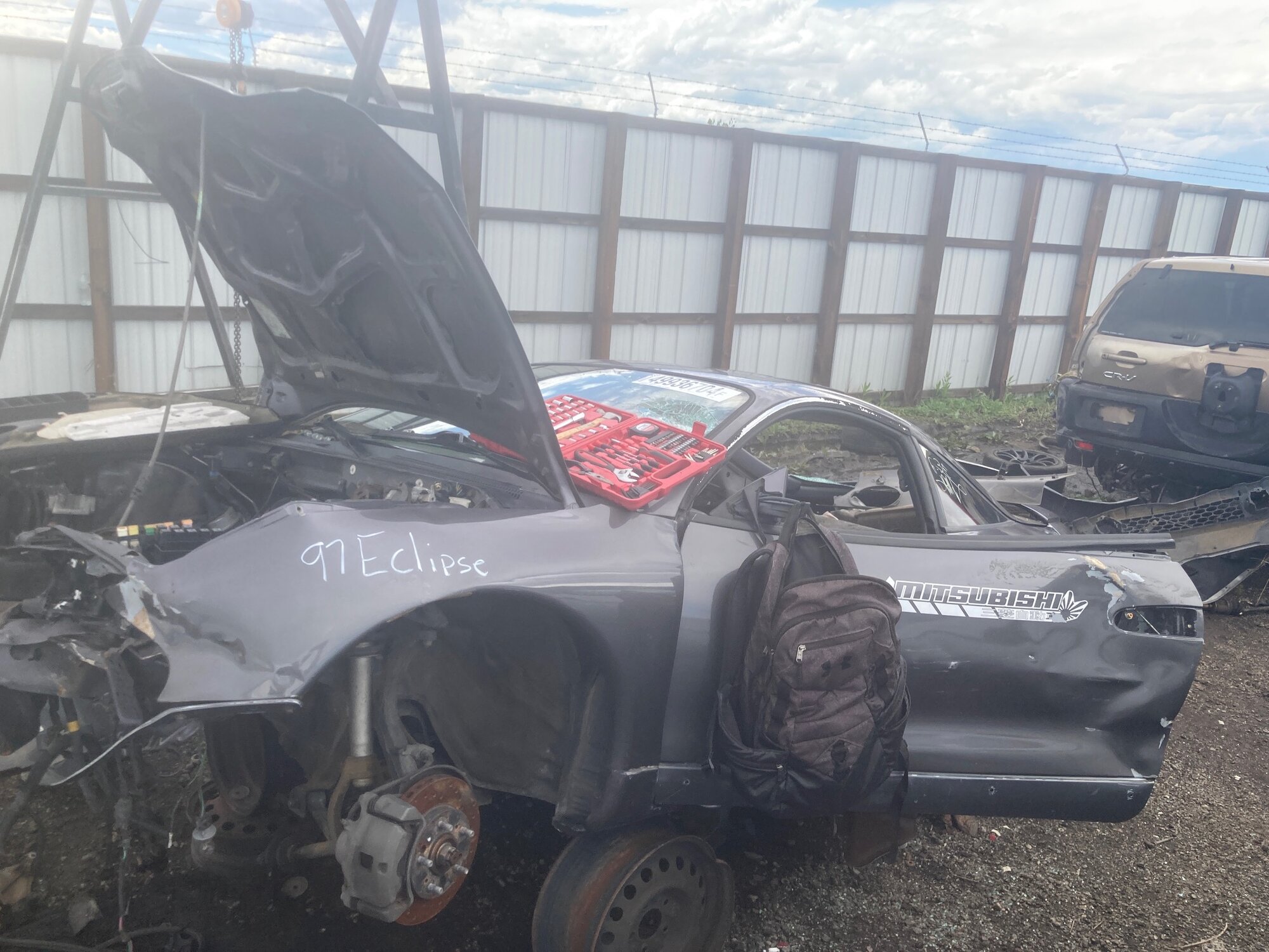

Fog lights were sourced from this poor GS (and a few others) in a local junkyard

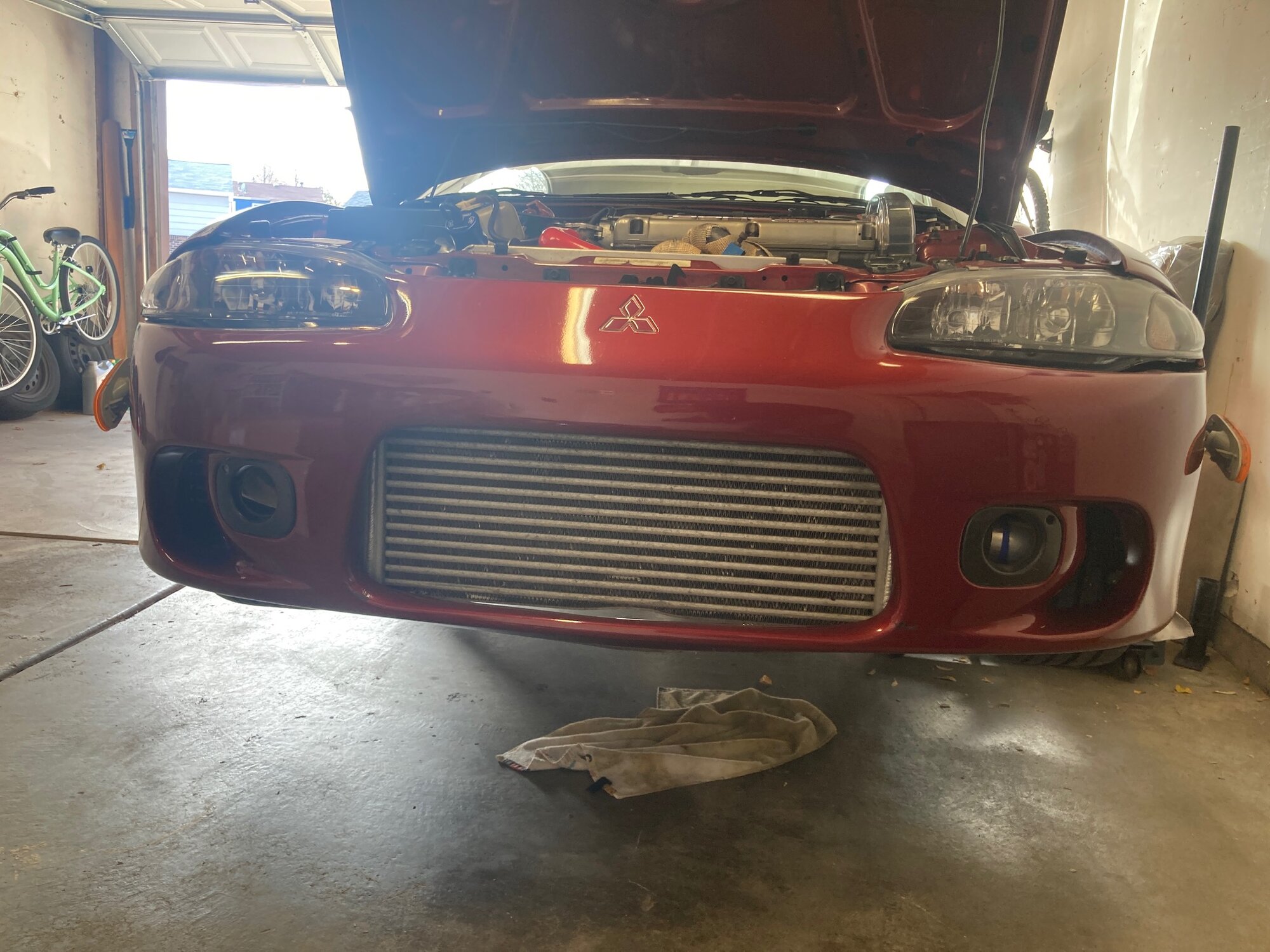

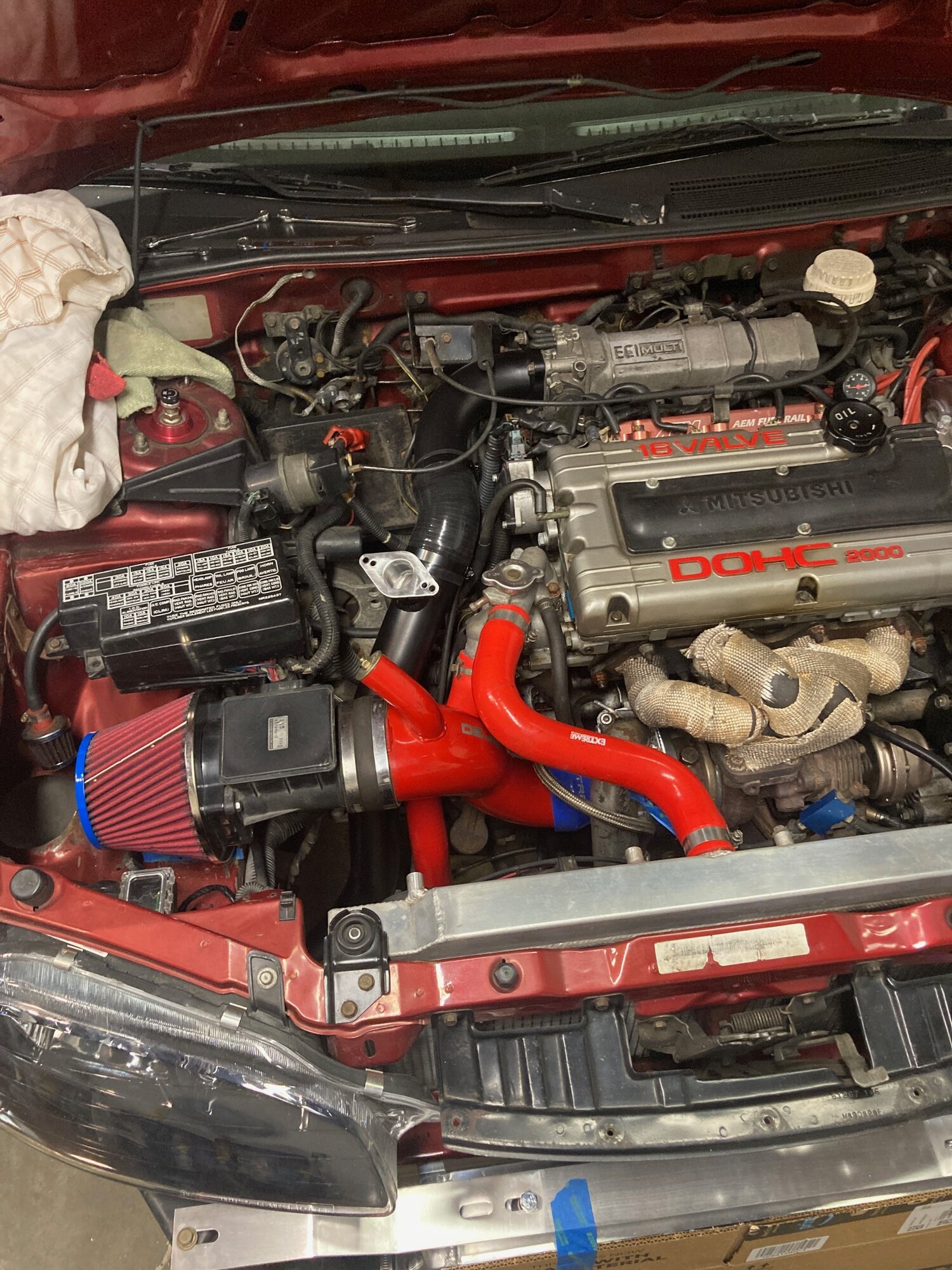

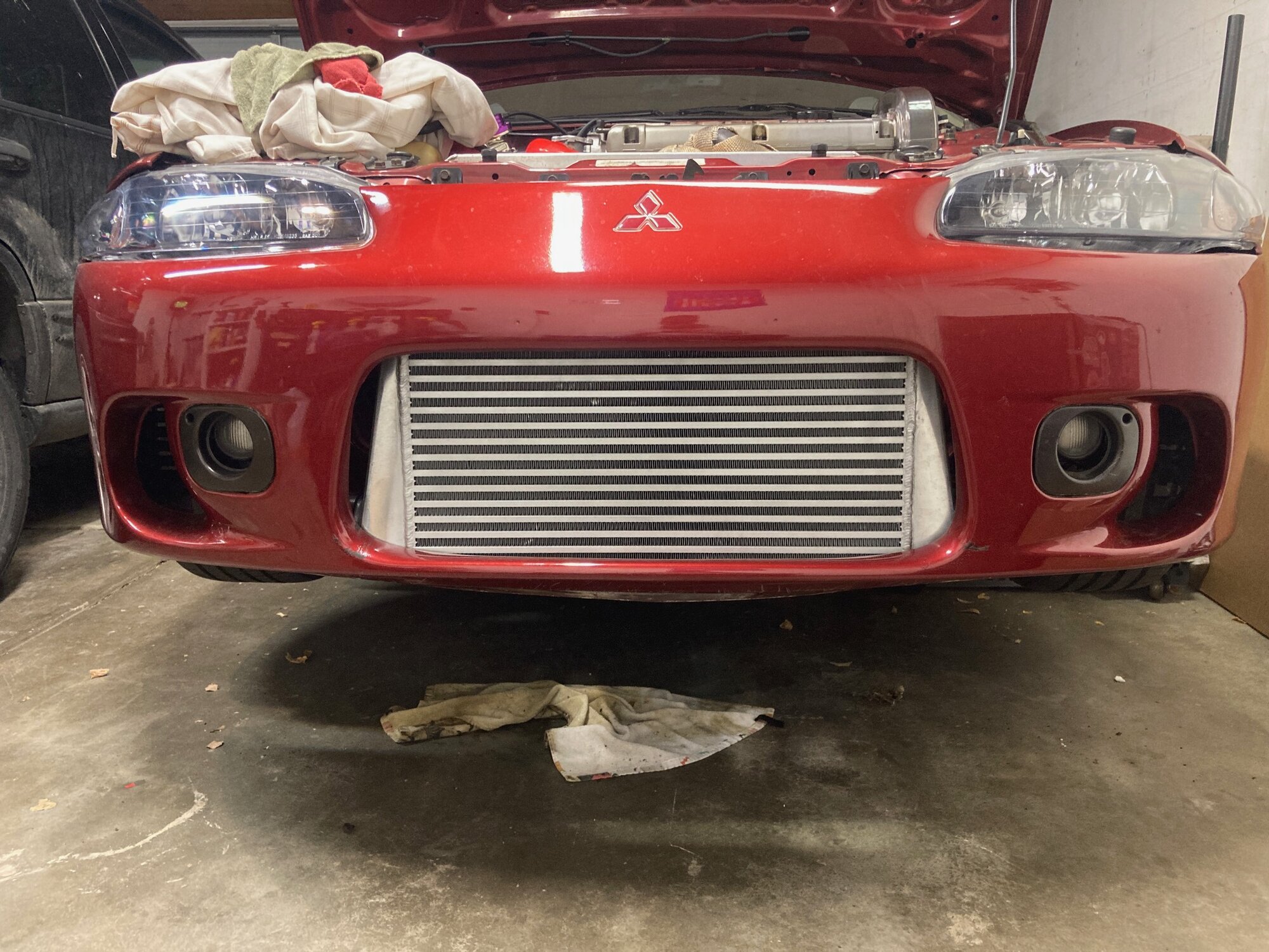

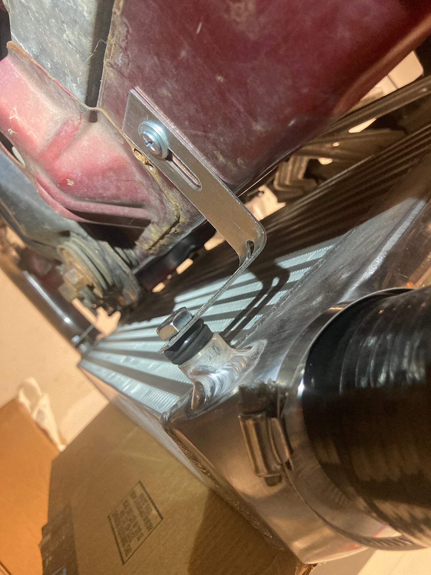

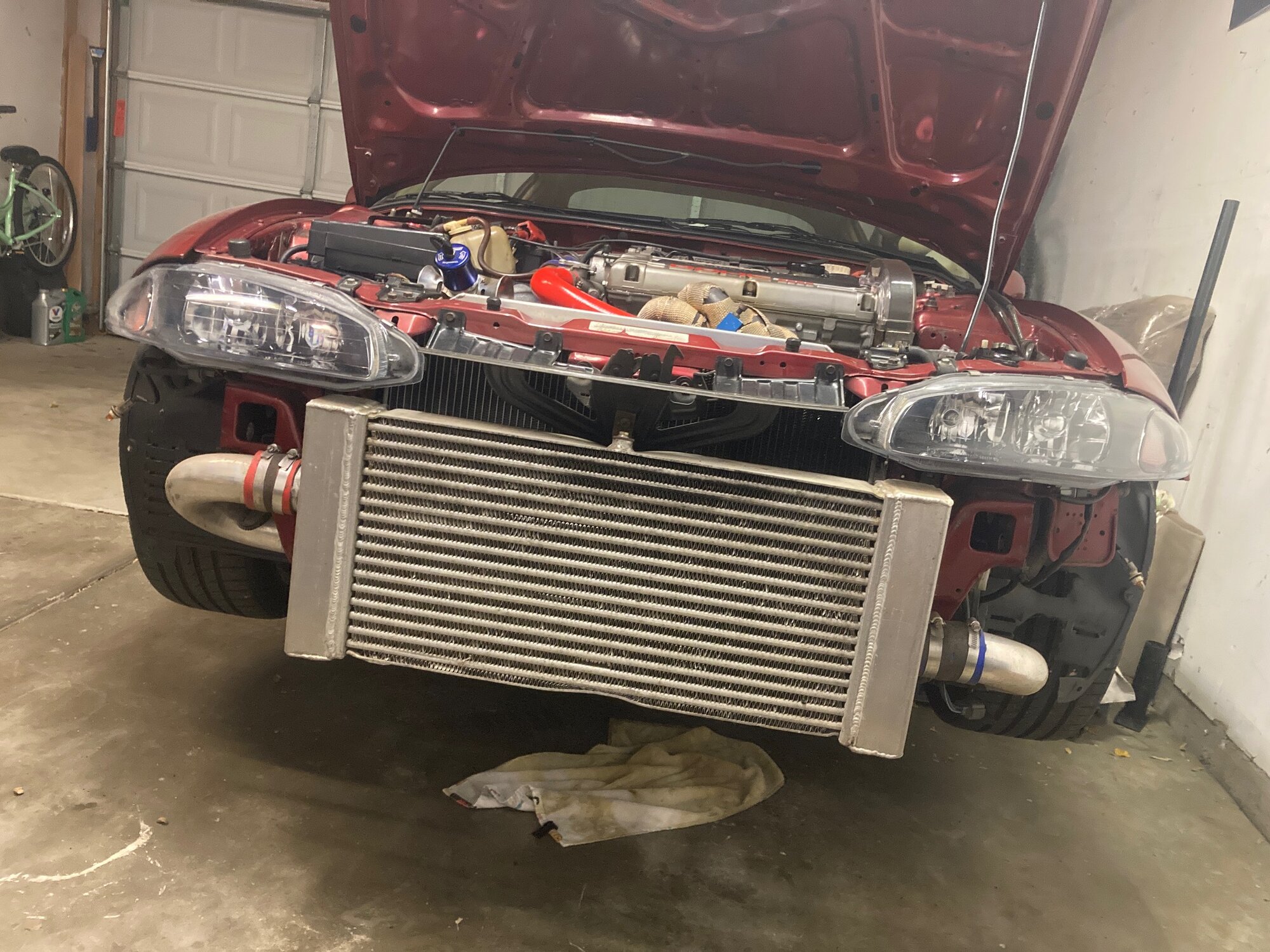

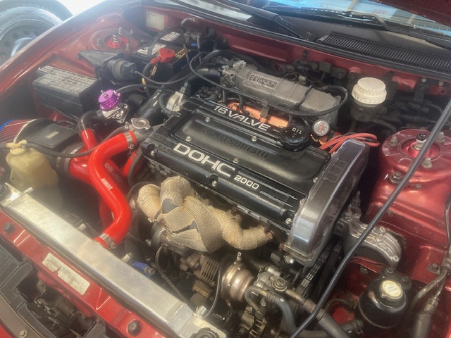

After removing the old piping and receiving my CXRacing kit, it was time to install. I also found a Image Performance cone filter that bolts directly to the OEM MAF rather than using a converter plate which made the whole intake quite long and tough to fit. The cap of the filter is blue which is currently driving me nuts and will need to be painted/powder coated sooner than later. Speaking of which, I had the TB elbow and two upper pieces powder coated in satin black for a more OEM look, seen below in some stage of assembly
After the junky BOV that comes with the kit was installed, OEM fog lights with yellow PIAA bulbs were installed and the front mount was put into place. I ended up being unable to use the metal spacers that came with the kit. I have seen other people (legitstreetcars on youtube) also struggle with the metal spacers and opted for these rubber spacers, which allowed me to add/subtract the amount of spacer I needed and still firmly holds the lower mounts of the intercooler
Front bumper cover back on! Alignment of the fog light bezels and the fog lights are a bit wonky due to how the bumper is cut and fitment of the intercooler but not wonky enough that I can't tolerate it... You also may be able to spy that the BOV sat WAY too high in the engine bay and needed some shifting around before the hood would close
Engine bay was all put back together and I even made a recirculation hose which this car has not had on it for years :|
Winter project complete! More to come soon

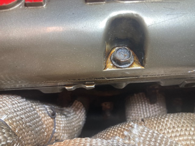

Ok so a few weeks back I started up the car and let it get to temperature for the first time in a couple months as the car sat over the winter. Re-sealing the valve cover was something on my to do list as its been apparent oil is seeping out in multiple places. After I shut the car off I noticed this:
Looks like a cracked valve cover to me! There was also oil in the spark plug valley, meaning likely another crack from one of the interior bolts. These bolts were installed by the machine shop that rebuilt the motor back in 2014ish and they must not have been aware how brittle these valve covers are (honestly, neither was I at the time). I took the valve cover off to find 4 different length bolts :confused:

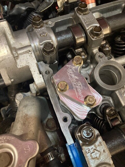

I was able to find a good valve cover locally for fairly cheap and jumped on it. I also used this opportunity of having the valve cover off to add a part I should've a long time ago.. A Kiggly HLA!
Such a simple yet effective mod!
A hardware kit from STM and patience to not over-torque the bolts and it's all back together!

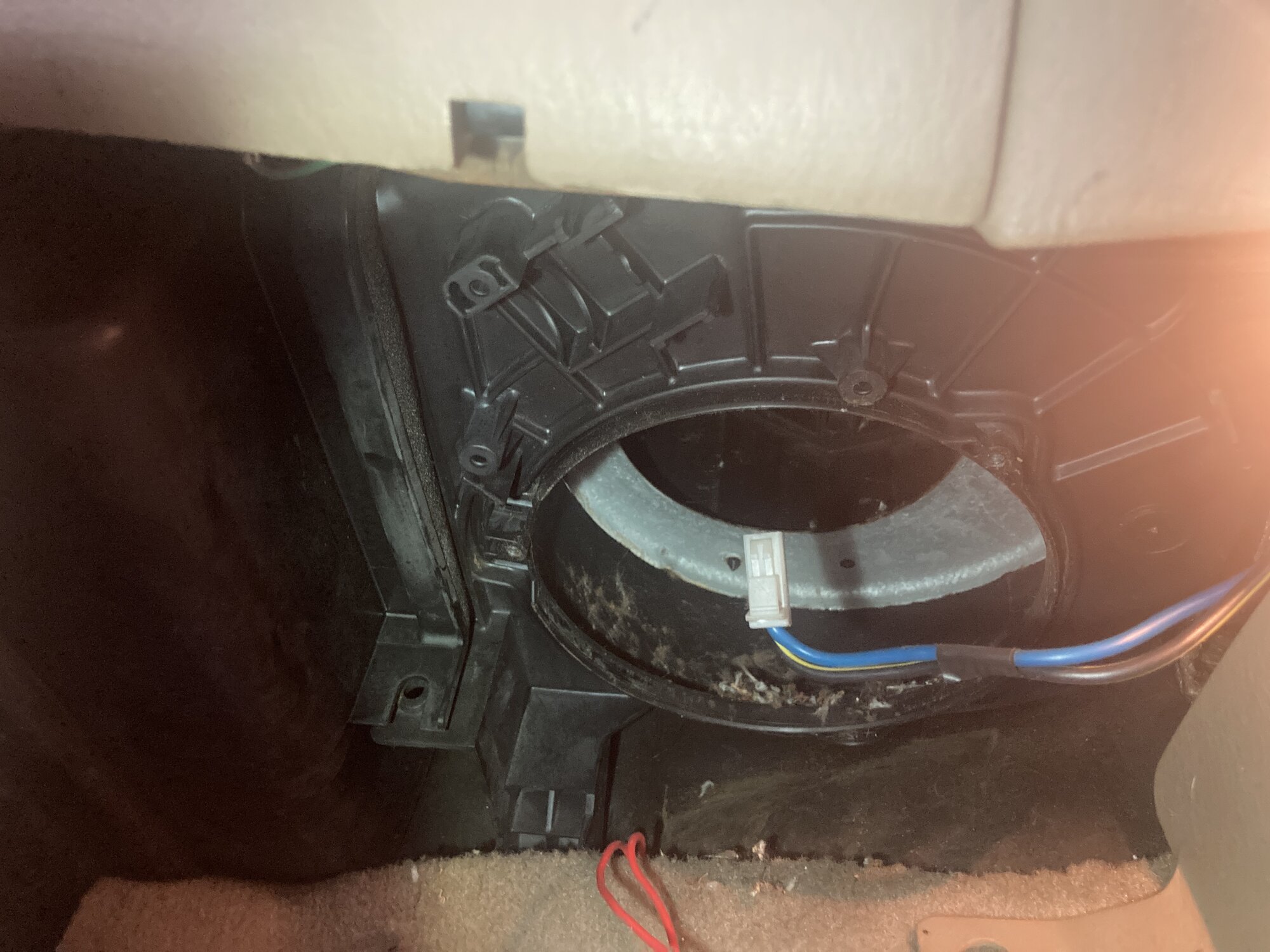

This car has had the AC components deleted but the heater system is still in the car and I do occasionally desire to use it for early morning drives. One morning I went to turn on the heater and heard rattling coming from the blower motor and a horrible smell. I knew exactly what that meant and was not looking forward to dealing with it so I put it off...
Until today!

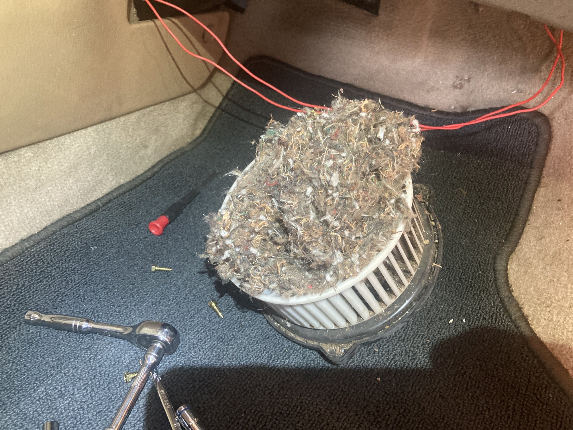

The back screw on the blower motor is kind of a PITA to get to but after removing it, I was presented with this wonderful mess!
The smell coming off of this thing was horrid.

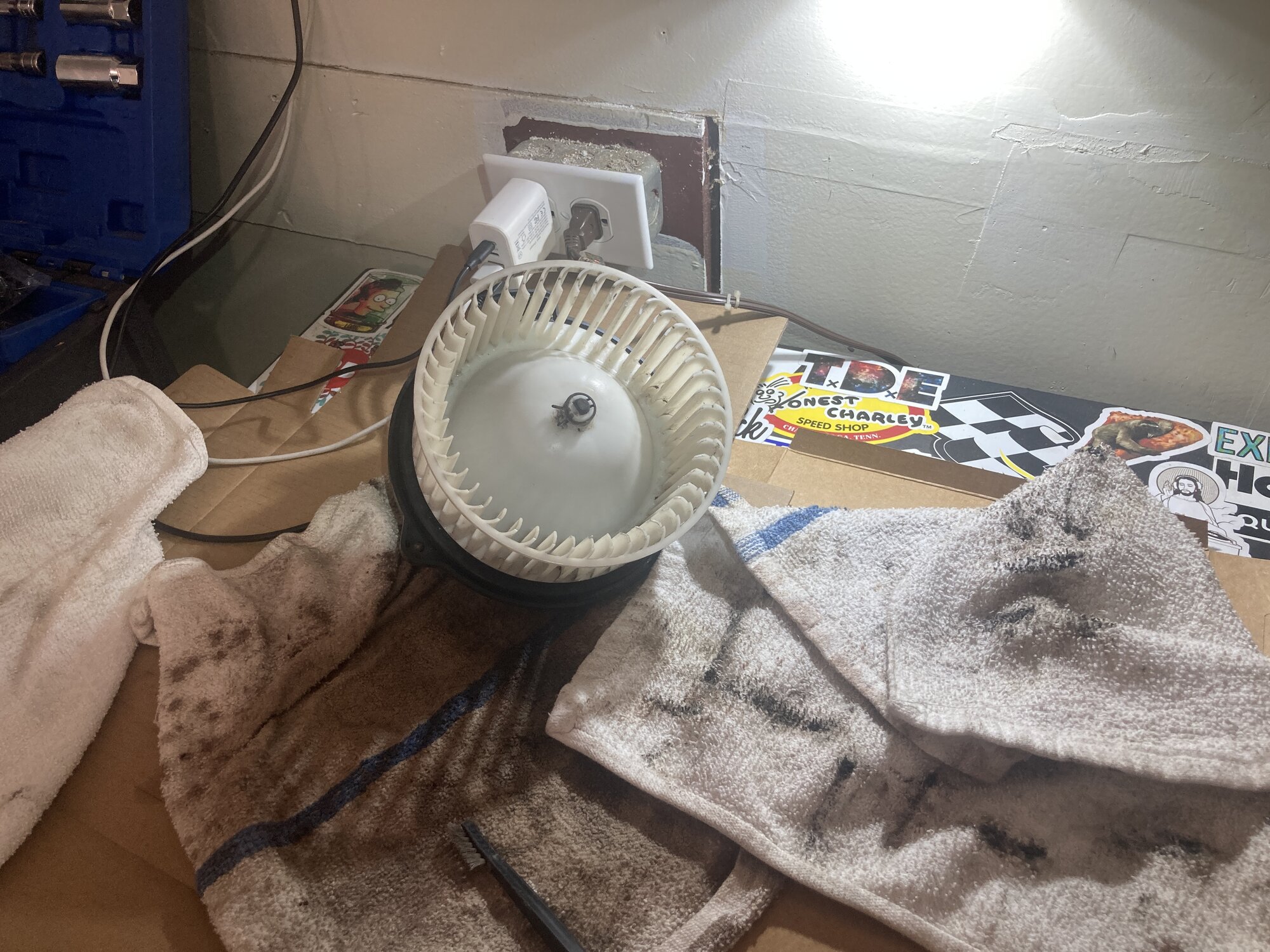

After dawning PPE, I used a small nylon brush and plenty of APC to get it cleaned up and had the blower motor looking good as new

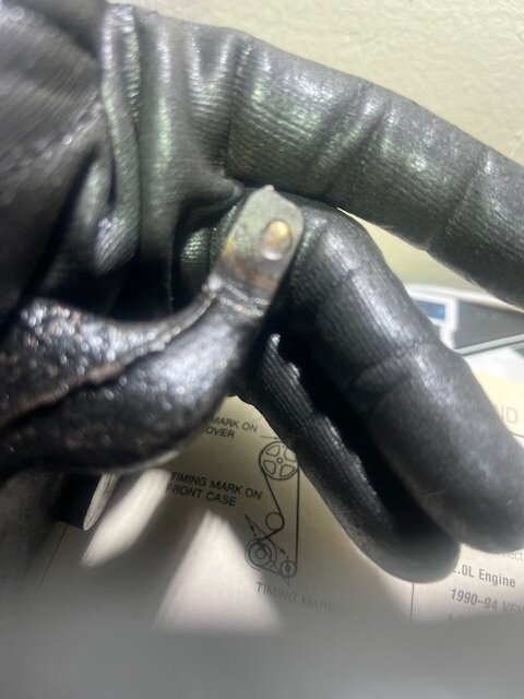

After disassembly, I was shocked to find a new problem, a divot worn into the tensioner arm. Perhaps this was the entire issue or the tensioner had indeed failed as well, eitherway this was a problem as the 6 bolt tensioner arm is discontinued and though FIBA is working on a OEM+ version, it is not ready yet.
I cannot weld, but had some friends come to the rescue and fill the divot as a hopefully more-than-temporary fix. The rest was a simple timing job and after reassembly, it fired up with no rattling to be heard.

I never gave it much thought but why don't we just grind the pad flat? All I can see this doing is changing the amount to turn the eccentric tensioner a little more. By the book it has a torque value. I do it by feel but even so i dont look at orientation until its done.
I had the same divot and did exactly that years ago. So far so good. That's funny, I can weld and have a welder, but it never crossed my mind to weld it flat.
Yeah that is actually a good point, not sure I've seen anyone do that, but I have seen people weld up that divot when it happens. Better yet, a harder material that doesn't wear down! @FIBA M - EC17PSE looking to you!
