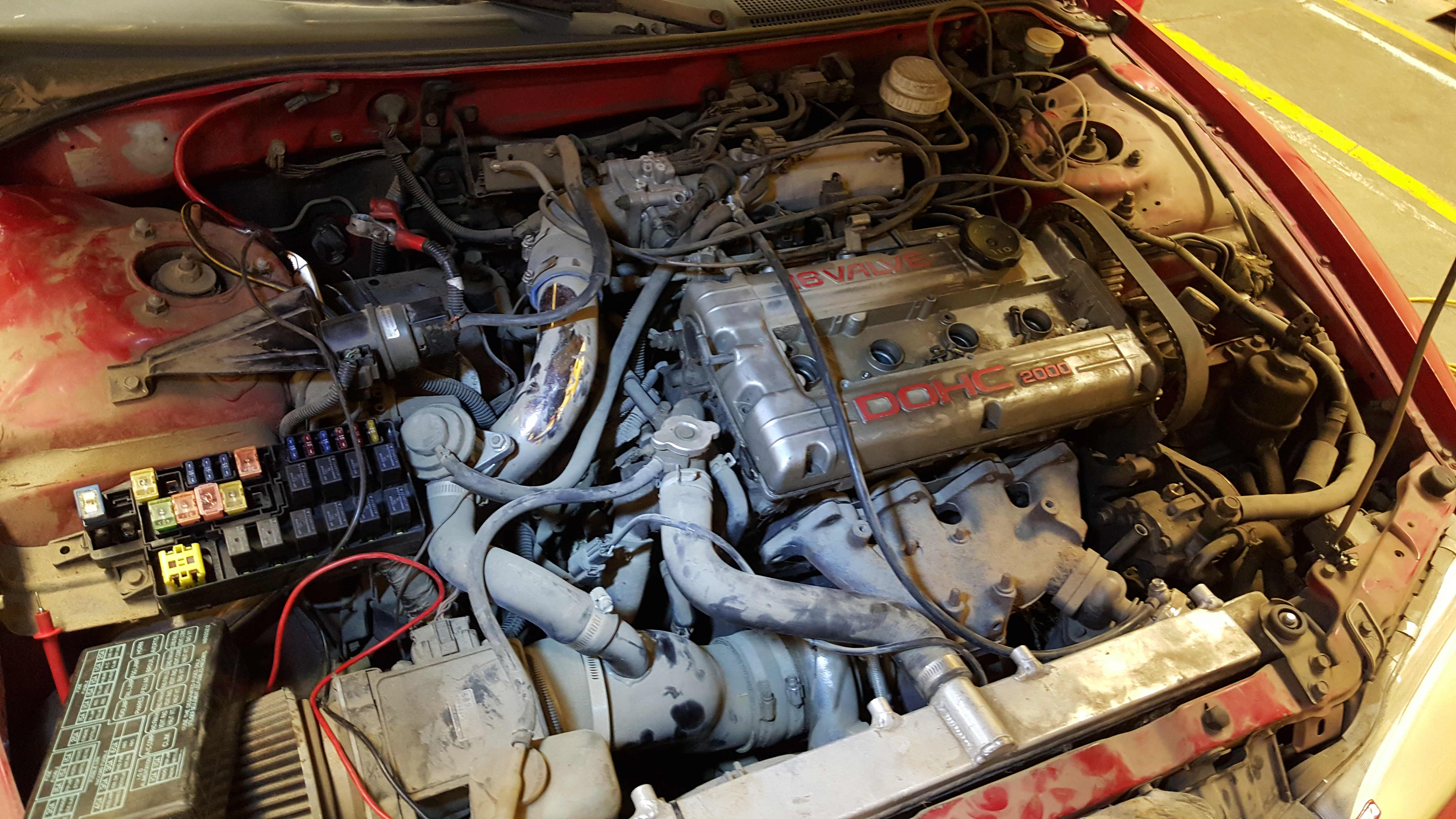

I teach shop at Grandview High School and this 2g DSM is our current performance project. We bought the car with many upgrades and are learning as we go.
Hey everyone/anyone... Take a look at what I've got listed, please ask questions, because we still are figuring out what we've got here. Only had it a week. Once we've figured it all out, I'd love suggestions on where we are lacking. Thus far I know of no upgrades to the fuel system minus the 880cc injectors. So that seems like a weak point.
Also, we've got a 6 bolt motor on a stand and a 7 bolt in the car. We might pull them and swap. Then we'll have to determine which head/manifolds we will use.
All input is greatly appreciated!
I would also recommend looking into fuel upgrades as far as a pump maybe a after market regulator. Stock heads and intake manifolds will be good for now. The exhaust manifold will be something to look into. depends if was go t3 or dsm bolt up with a bep housing. Oil feed and return lines for that turbo.
Walbro 255 in tank pump and adjustable fuel regulator for feeding the bigger injectors. Wickedboost92, they have a Holset turbo so it probably doesn't have coolant lines only oil feed. Make sure that Holset has a good oil drain. Check any of the vendors below for good pumps and regulators :) When you get the engine out, change the fuel filter at that time since it is much easier to access then. A lot of people go with AN fittings and fuel lines from the filter to the fuel rail and from the rail to the regulator. Some also run bigger line from the tank but I don't think you will need to go that far since the stock line should provide enough fuel for your injectors.
The factory fuel feed from the filter to the rail is a restriction. remove the banjo fitting and do a straight fitting with a -6AN feed line using a 90* hose fitting.
