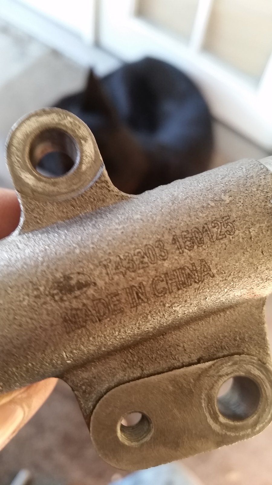

I got an oem tensioner to use instead of the gates China one. Mines was faulty straight from the box. I contacted jnz with regards to it and they didn't even bother getting back to me. I'm not the only one has experience with faulty gates tensioners from the new as well. Some research will give you what you need.

The belt brand is irrelevant, the tensioner being a poor quality oem clone with a poorly cast chamber that will bleed pressure is kind of the important part not the country of origin.

Here's the current T43215 Gates Made in China tensioner. The part is stamped made in China on crimped ring side near the bottom of picture.
