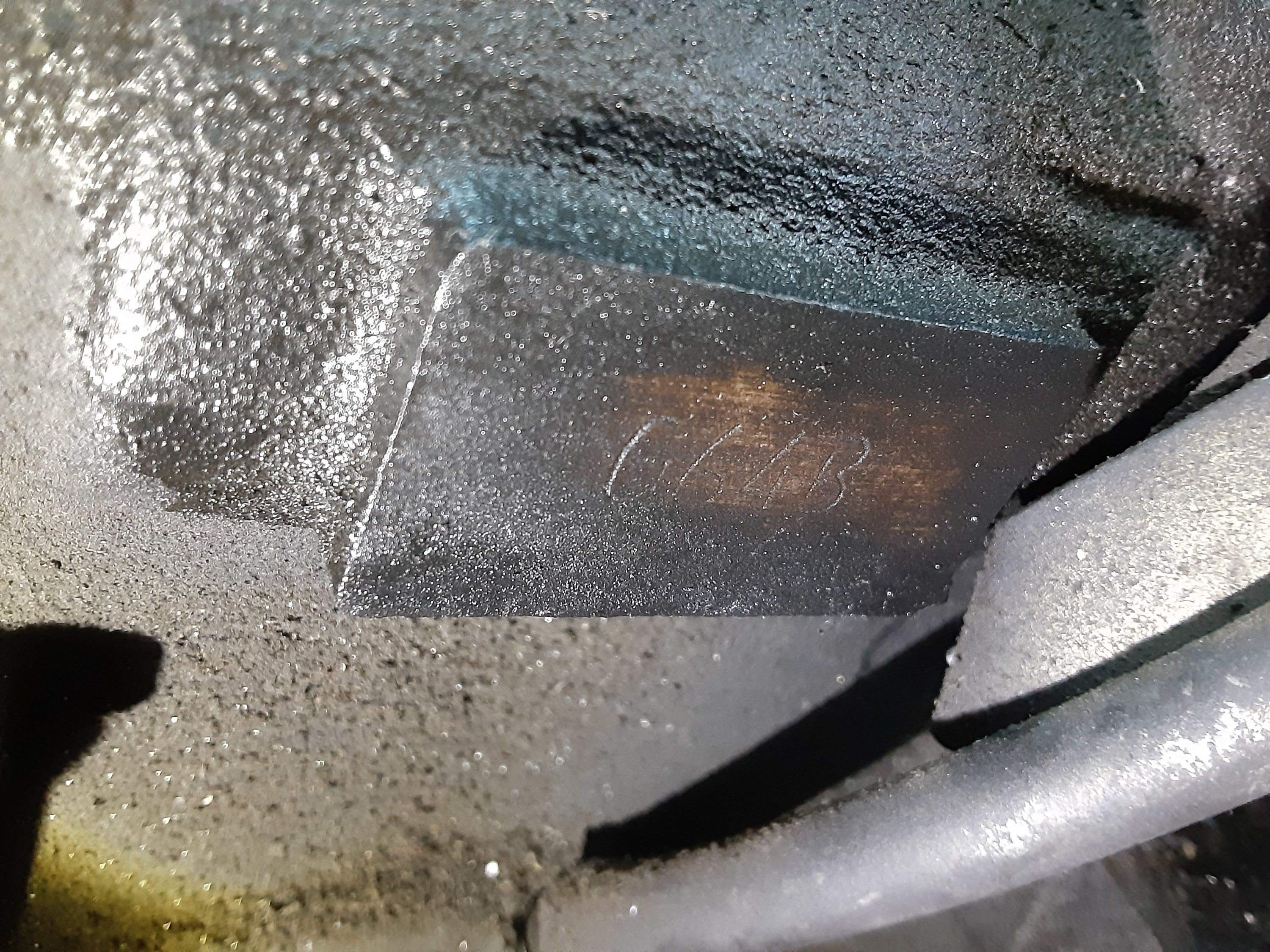

if they are already pulled from the cars and the transmissions removed, the best way to verify that they are Narrow blocks is to bring a basic tape measure with you, and measure the bell housing dowel bolt centers narrow blocks are 12.75 inches across
This image above is the G64B i just recently got, and sure enough it is a Narrow block the wide blocks will measure 13.75 across from bolt centers, and I have never seen a 6 bolt fwd wide block Mitsubishi so if you know the car they came from is fwd they are vary likely Narrow blocks and well worth $300 provided that they are in good shape.

So I just verified that the block is from a 1987 Mitsubishi Galant fwd, they want 300 bucks. It’s about an hour away. Might be worth the travel
