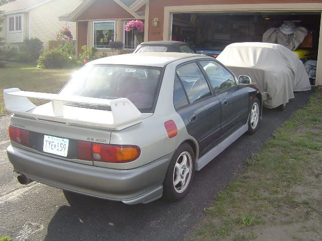

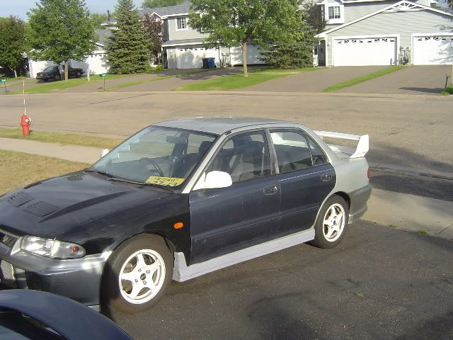

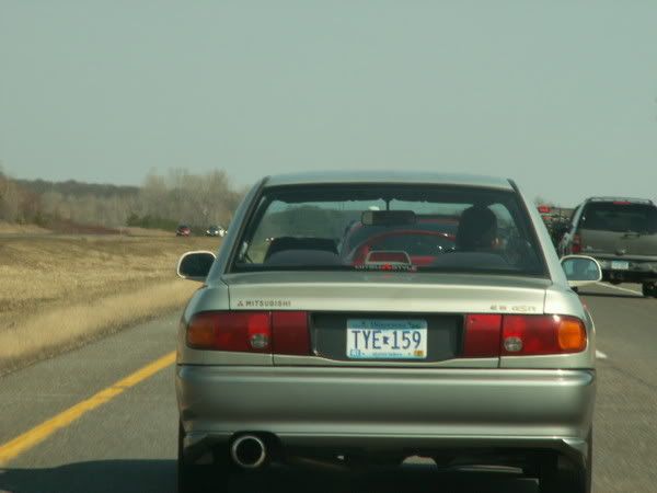

Full on Evo III swap to a 95 Mirage shell, 4g63, AWD, RHD all OEM
Built 1995 evolution 3.

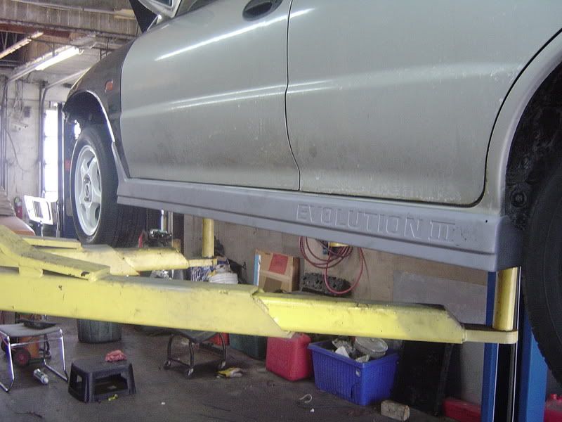

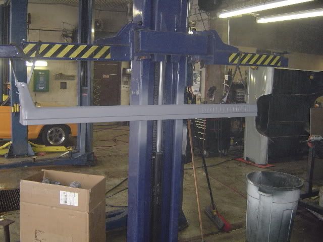

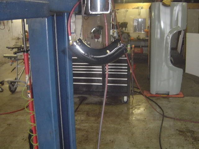

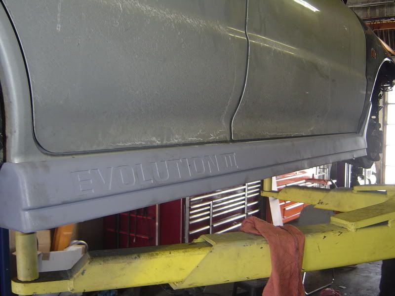

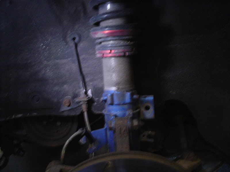

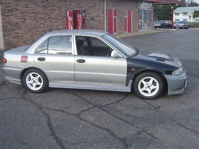

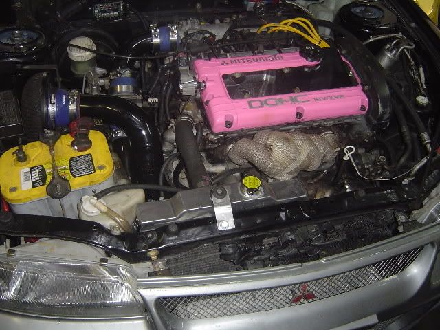

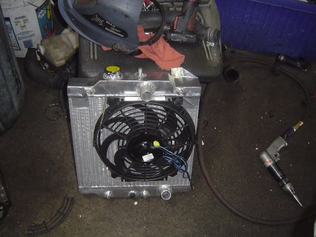

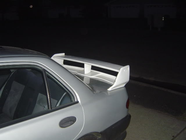

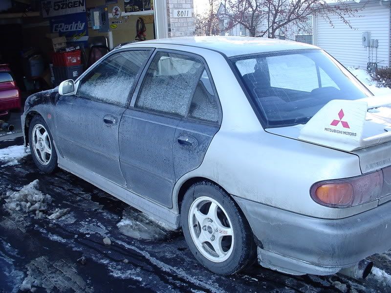

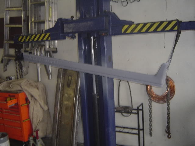

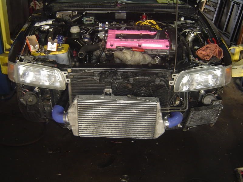

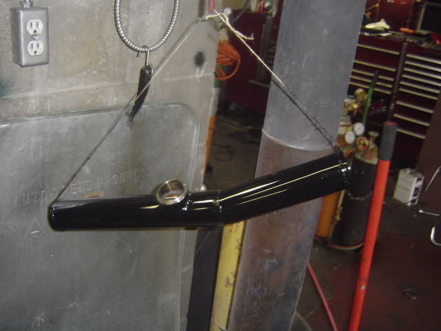

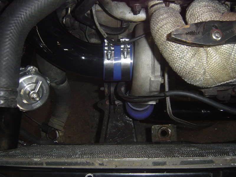

finished off the skirts and surfaced them today so they will be protected on the car till I find the wing so I can do all the body work. Also got my 1/2 sized alum radiator 17in H,15in W,2.5in D also put on a 12in slim fan. Got it mounted and the 2 lower mounts cut off and re weled on to the frame for it and the top mount made

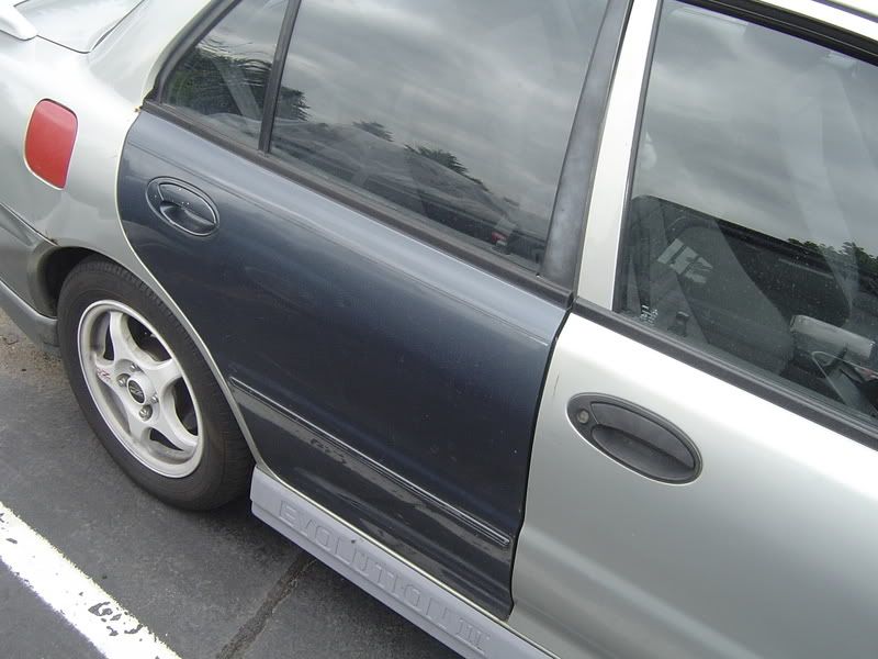

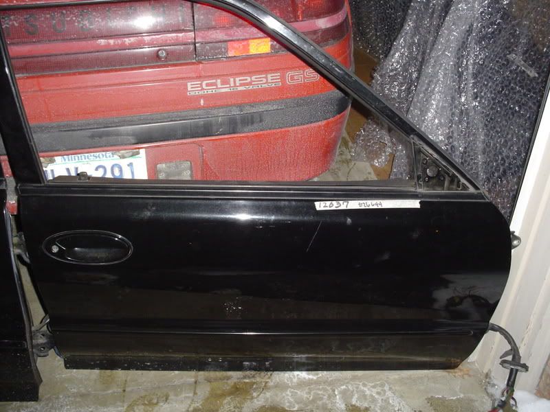

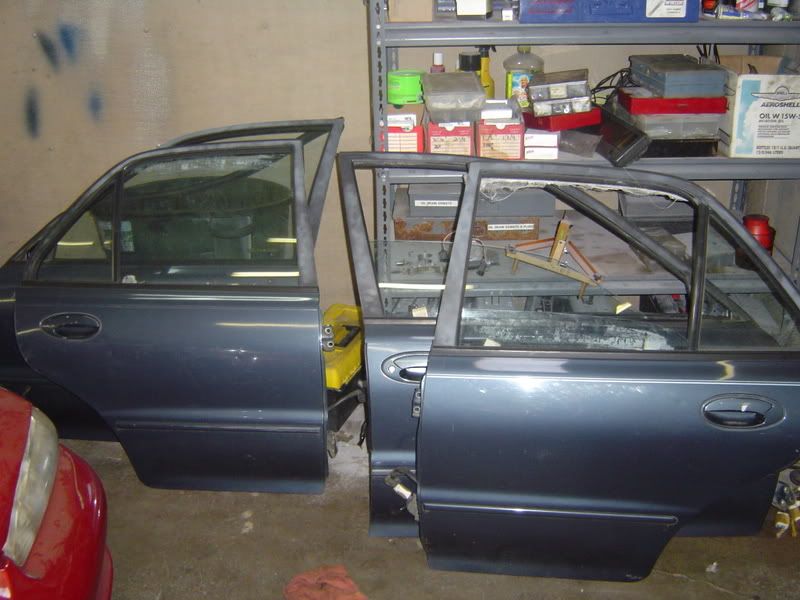

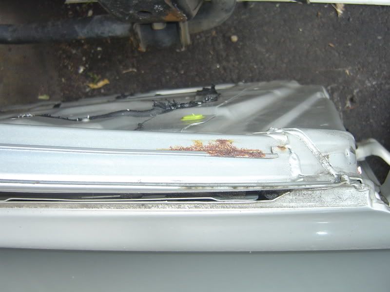

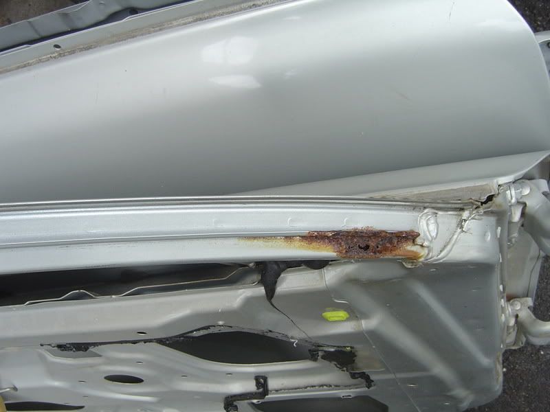

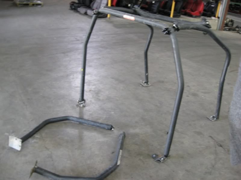

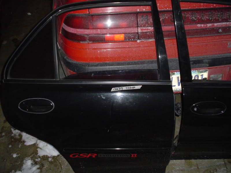

went to u pull it on tue and got a set of 93 mirage power doors from a canada mirage, also got the trunk side carpet and plastic panel, it also had the evo rear reflectiors in it. Would have piced up the roof skin also but had a rust hole all the way though so I am still looking for one.

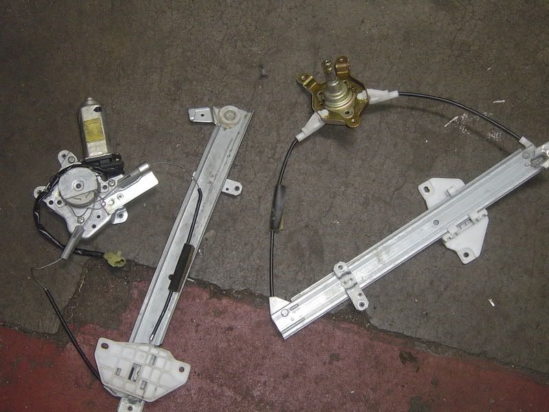

3 of the 4 doors had the windows taped shut and this is why. the cables were broken on the power regulators. So took out my manuel regluators cut them apart and used the cables and track for the power regulators.

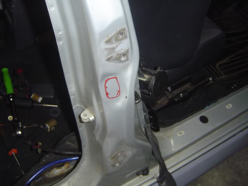

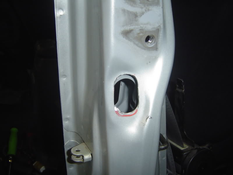

marking out the hole and cutting it for the wires to go into the car for the power

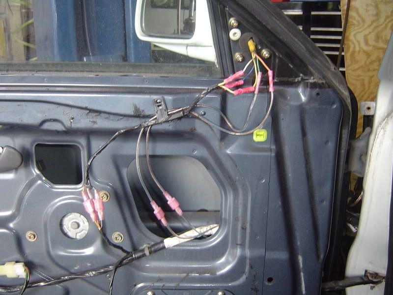

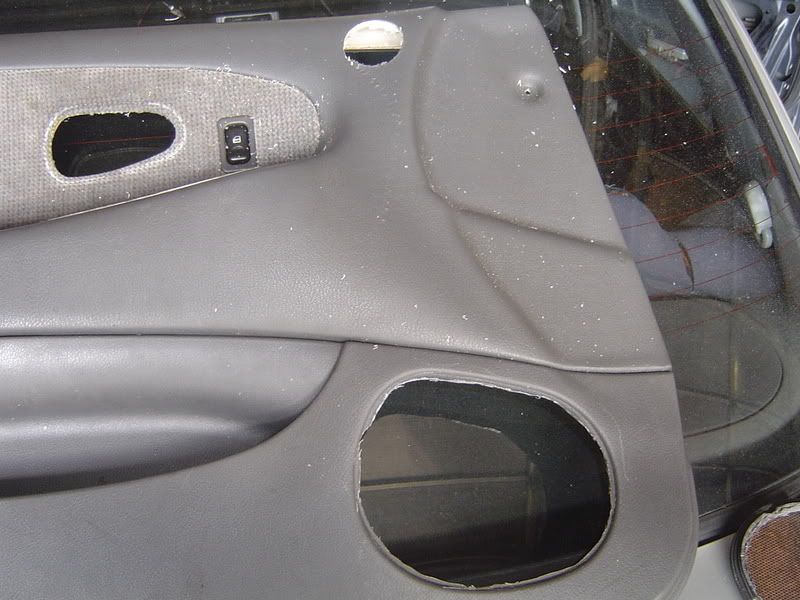

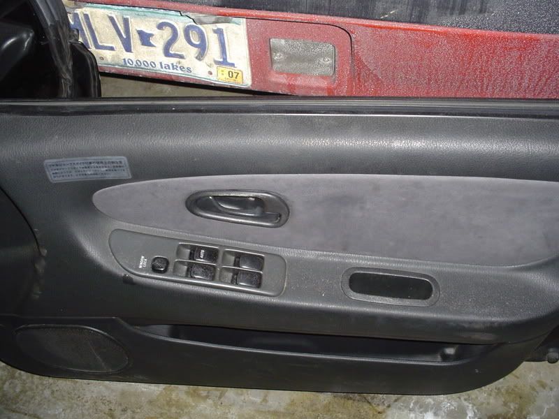

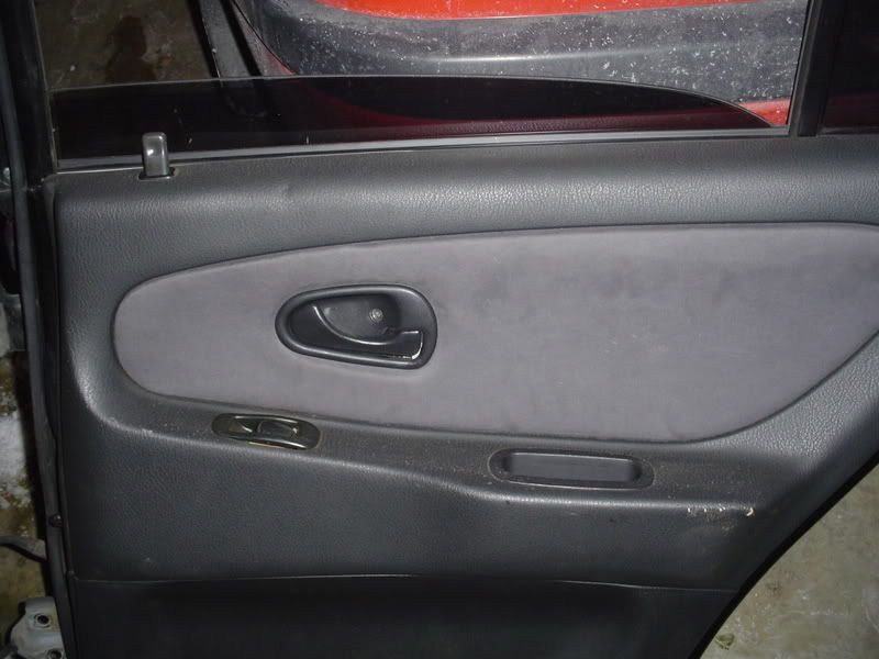

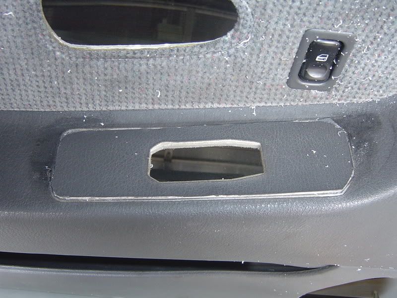

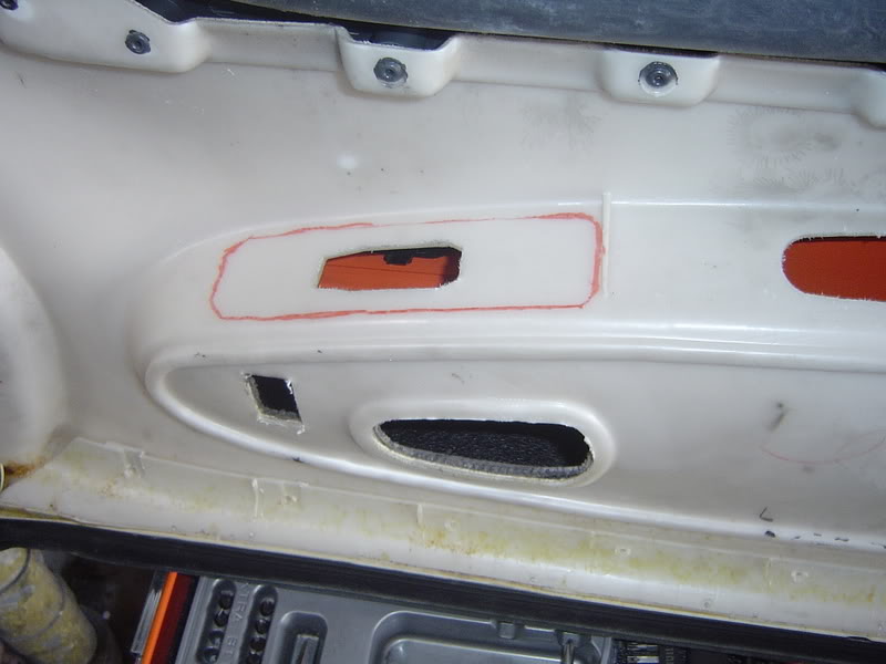

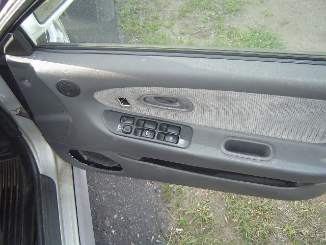

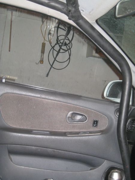

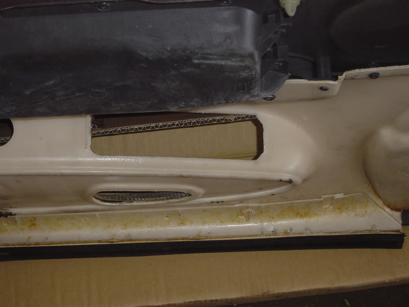

door panels were cut for the speaker holes and tweet holes and the drivers door was cut for the main switch panel and the cut out pice was glued into the pass door for the 1 switch and the door lock switch was put in the pass door also. Got all the wiring figured out for the power folding mirrors just had to add 2 wires to make them fold in and out.

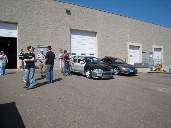

went to the all mitsubishi cook out last sunday (2007)
got a evo t-shirt for know the first year evo made (before they give out prizes they ask mitsu questions for stuff mitsu gives them)

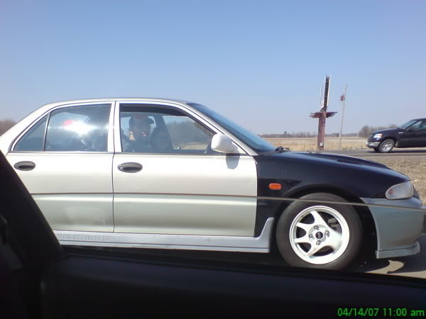

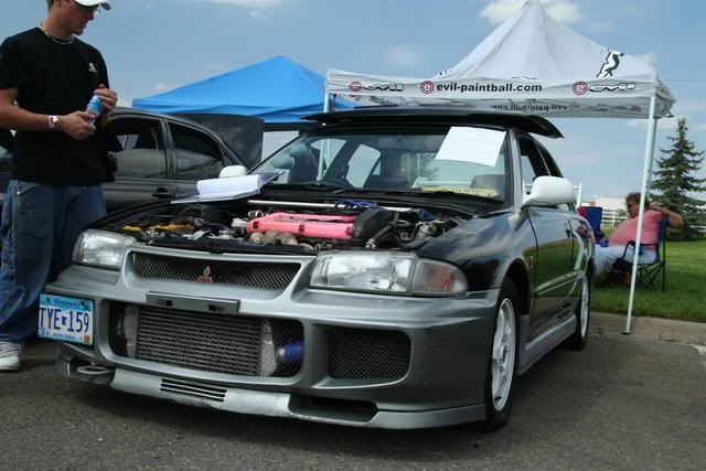

pic of the car at the show

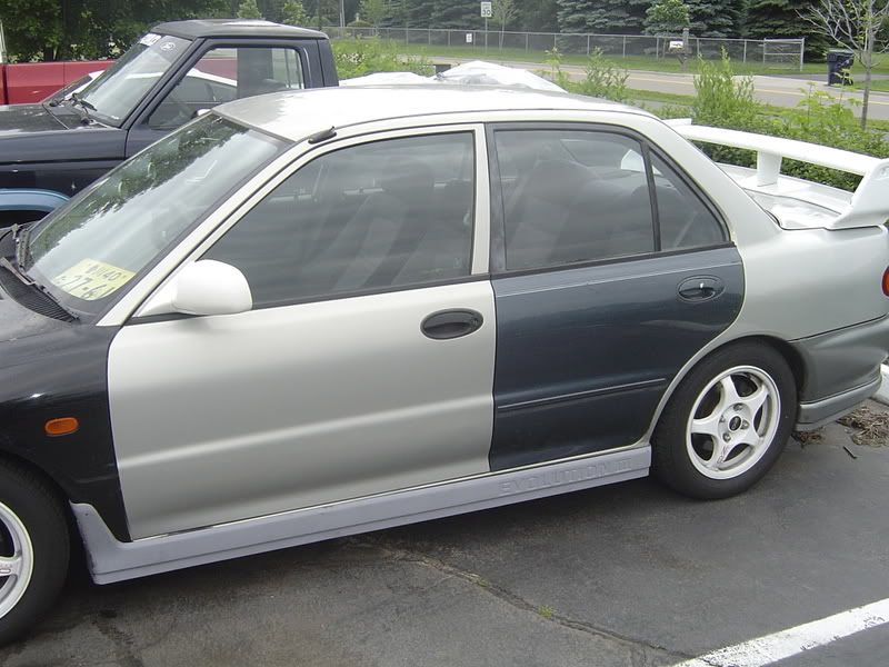

and I ended up getting 3rd place in the evo's not bad for a car that is 7 colors right now

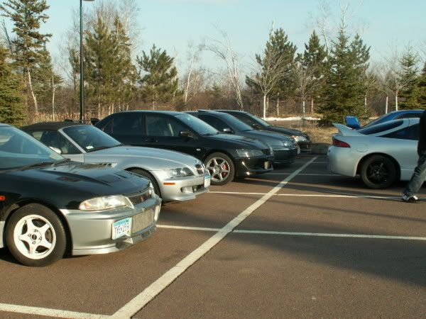

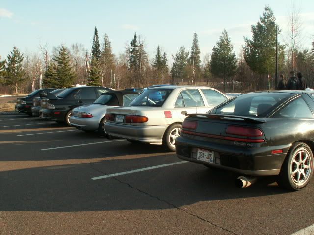

here is a pic of most of the evo's there
