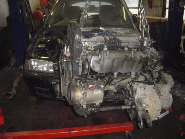

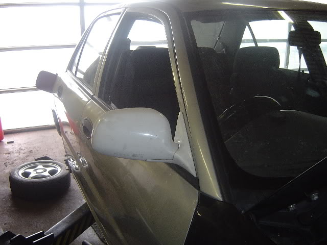

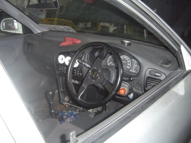

Full on Evo III swap to a 95 Mirage shell, 4g63, AWD, RHD all OEM
Built 1995 evolution 3.

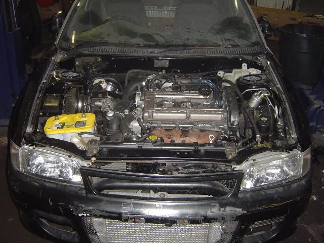

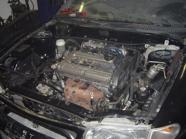

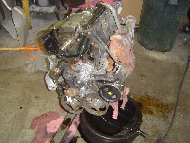

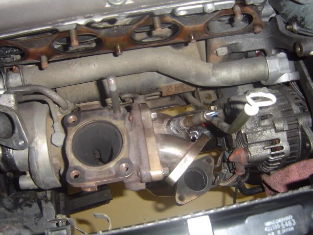

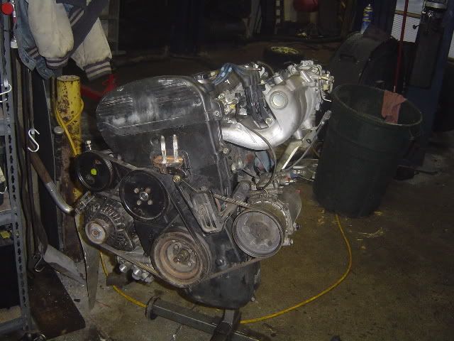

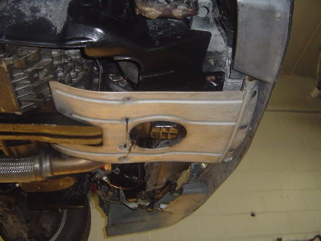

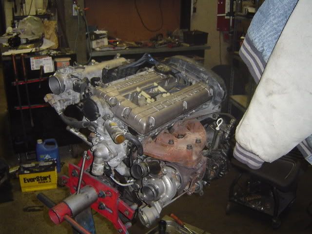

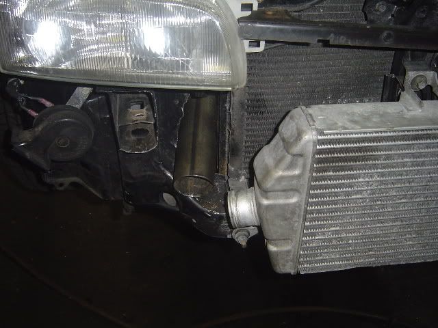

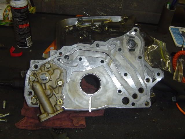

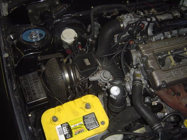

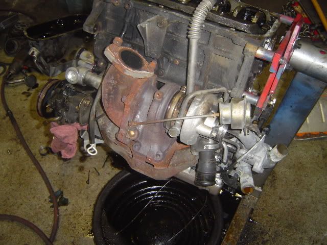

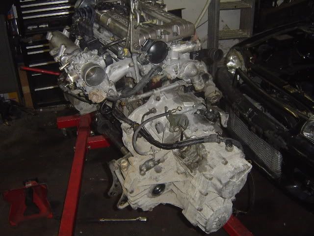

got the motor on the stand and took a look at it also to make sure. put a new water pump on it and a B.S. kit still have to go to mitsu to get the pump gasket and a multi layer head gasket and in stall the arp head studs. Also a pic of the front cip that will be soon cut up and be sold for a rhd swap for a 4g mirage.

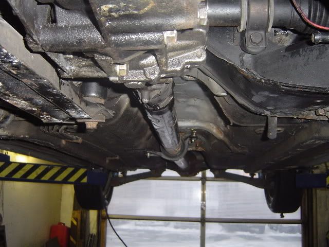

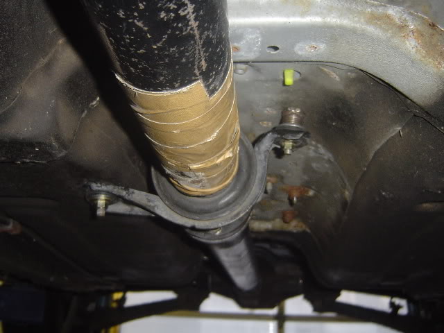

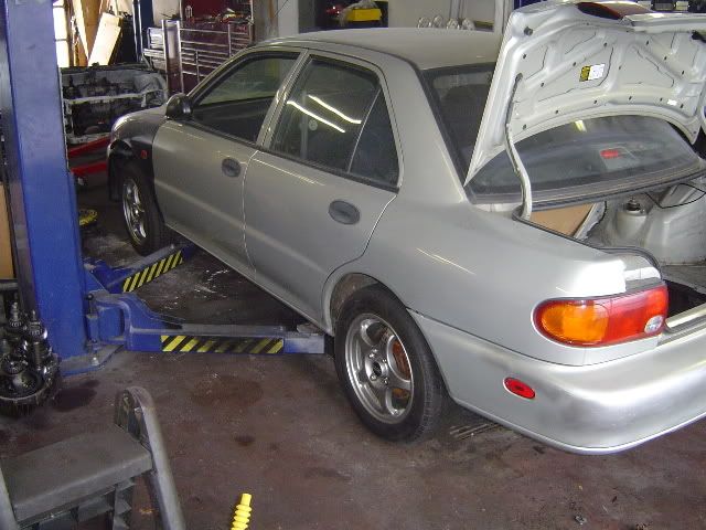

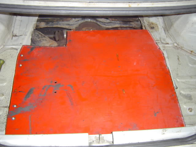

got the drive shaft mounted yesterday and made a lic plate bracket today and worked out the lighting problems. got the city lights working (little bulb that light up the head light when running light are on) also rewired the side markers to make them runing lights and blinkers so I will now be legal. Sence it will have front running lights.

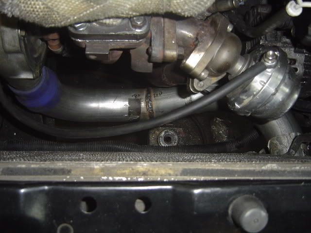

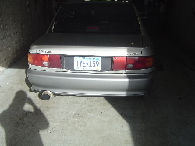

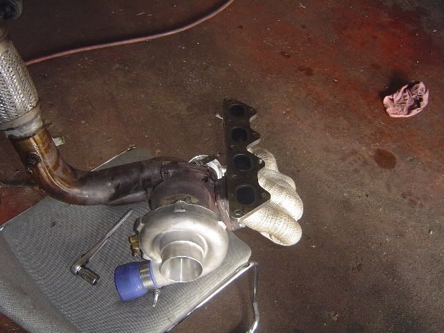

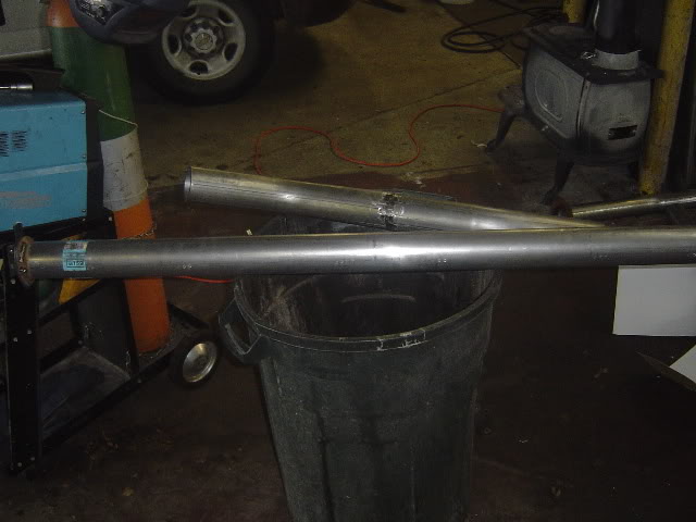

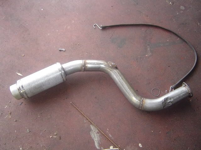

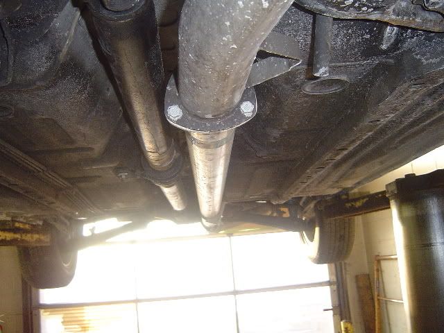

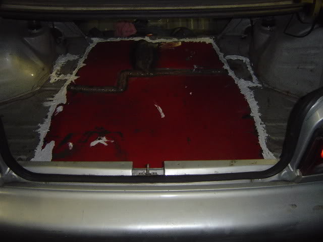

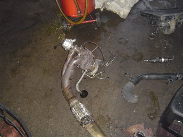

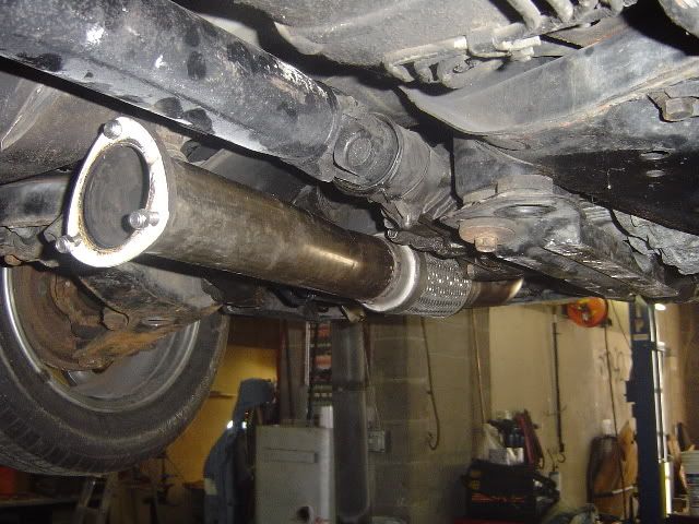

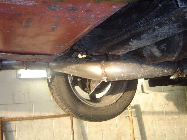

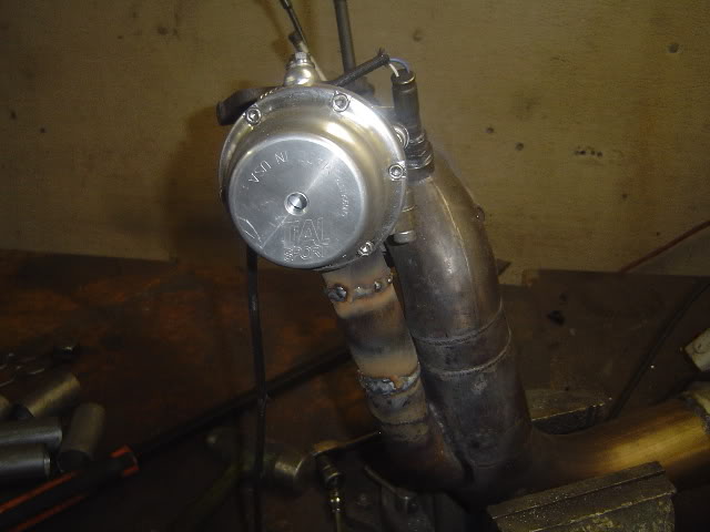

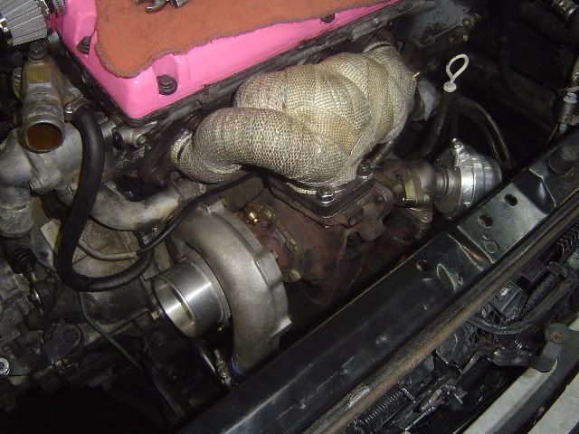

the start of the exaust system 3in almost all straight and the carbon muffler that was taken off a car at work that wanted a stock muffler (had to use it it was free) and the car hit full boost on the tial about 25psi. dad was behind me in the truck and said it had a 3 foot blue flame
here is the pics form today

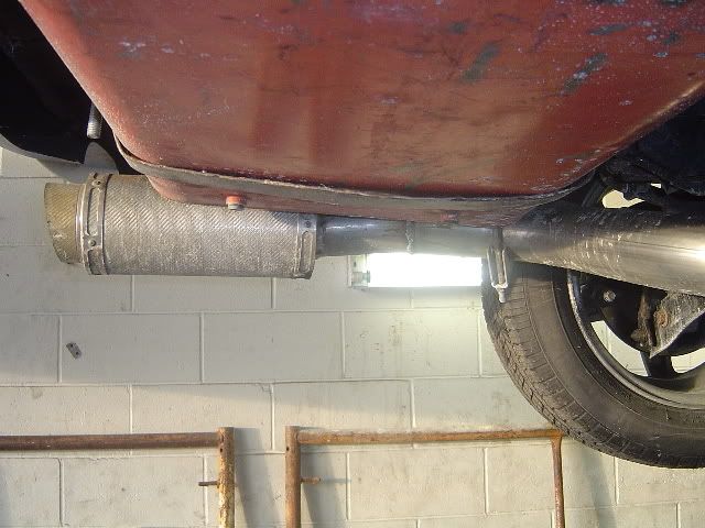

got the exaust full pics sence I never did take any

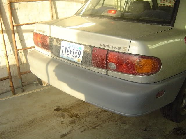

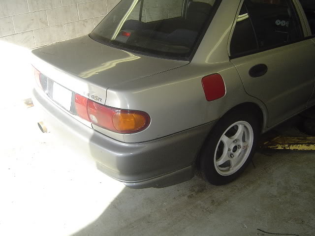

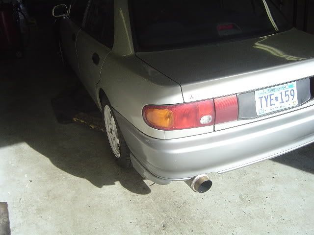

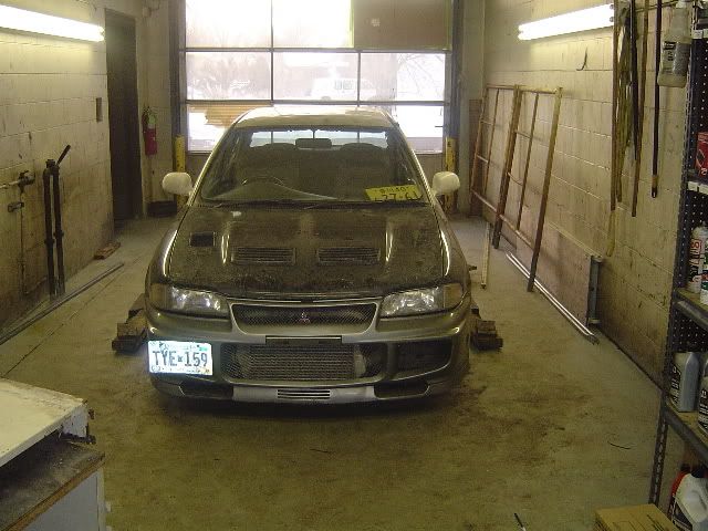

and put on a sorta fit mirage rear bumper sence I am trying to find the evo one still and the orignal was falling off the car and could not be reatached with out alot of work.

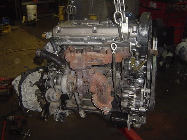

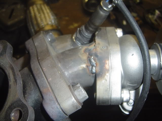

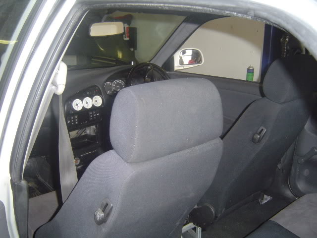

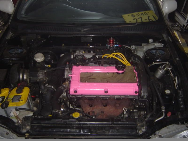

from the outside, i already know its an EVO I , not a evo III :)
you an also see the exhaust manifold, its an EVO I

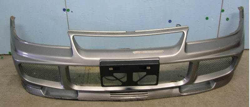

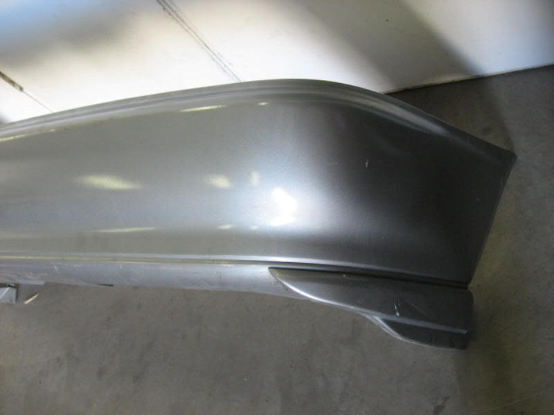

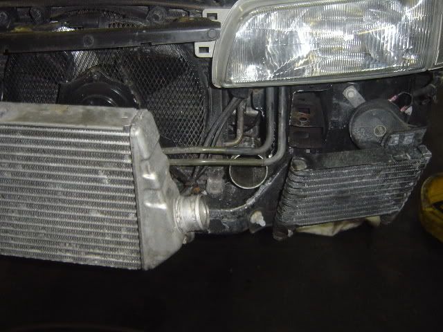

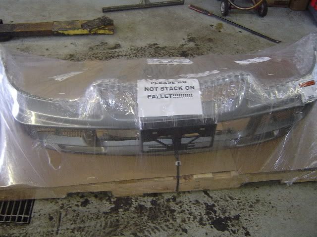

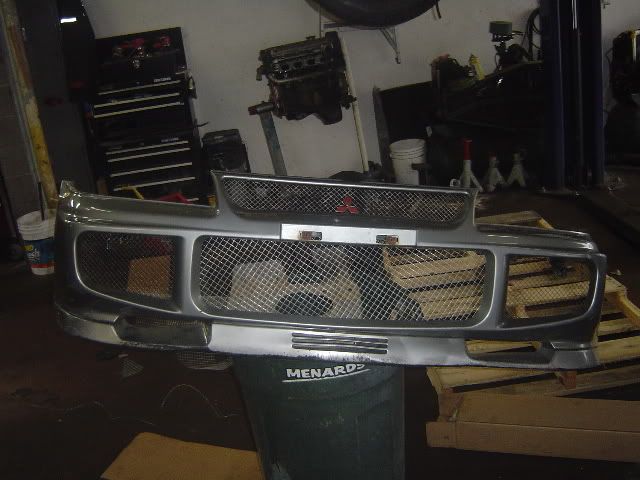

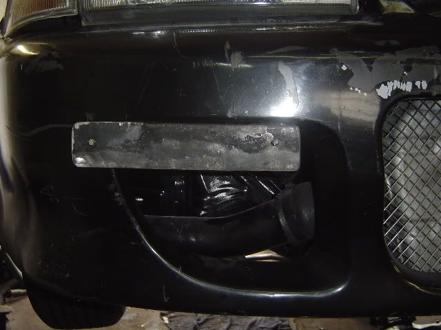

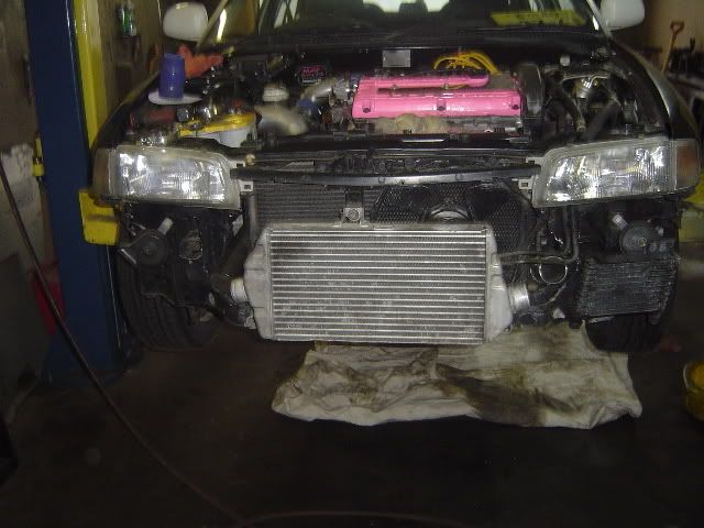

and now the new oem evo III bumper. It had the side mesh in it but not the top or center for the fmic. So went to fleetfarm and picked up some chicken wire same size as what was on there for 3.08 so it has the top and center and I stole the emblem off ar 90 4dr mirage shop loner car. The bumper aslo had a small skid plate on it.

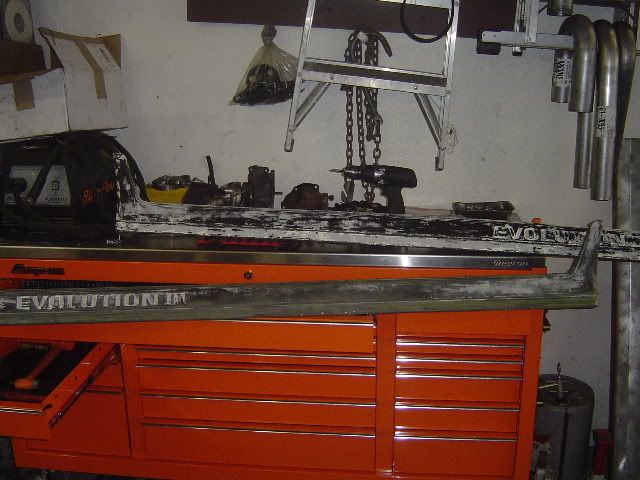

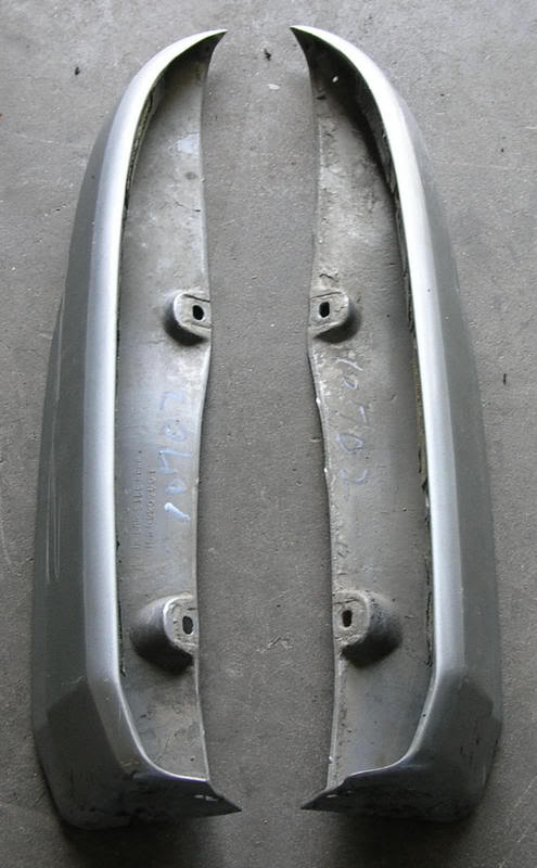

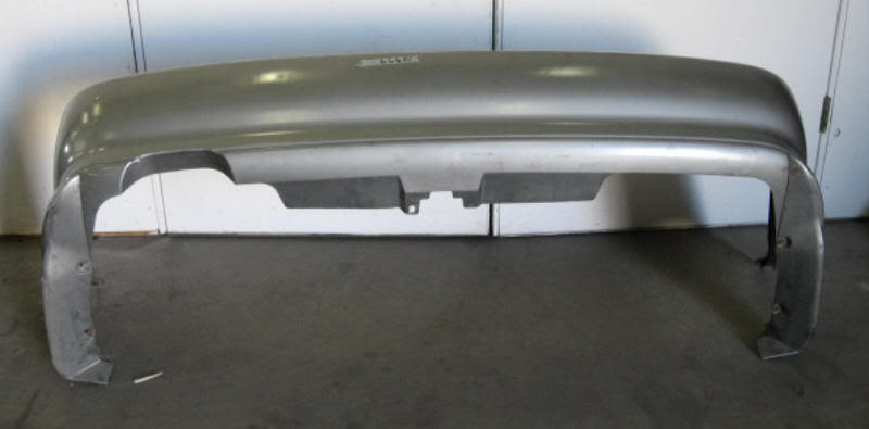

got a set of oem evo III rear bumper add ons cheap should be here this coming week

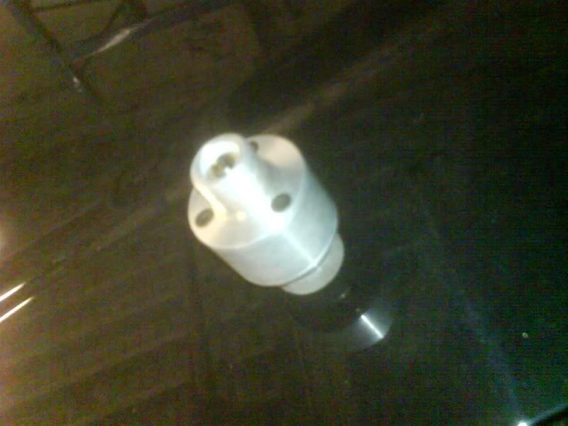

also got the kph to mph adaptor gear set for the evo tranny. Now the speedo will read in mpr at the same spot the kph numbers are at and it also trickes the evo ecu to get rid of the speed cut at 112mph now the cut is moved to 180mph

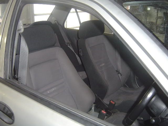

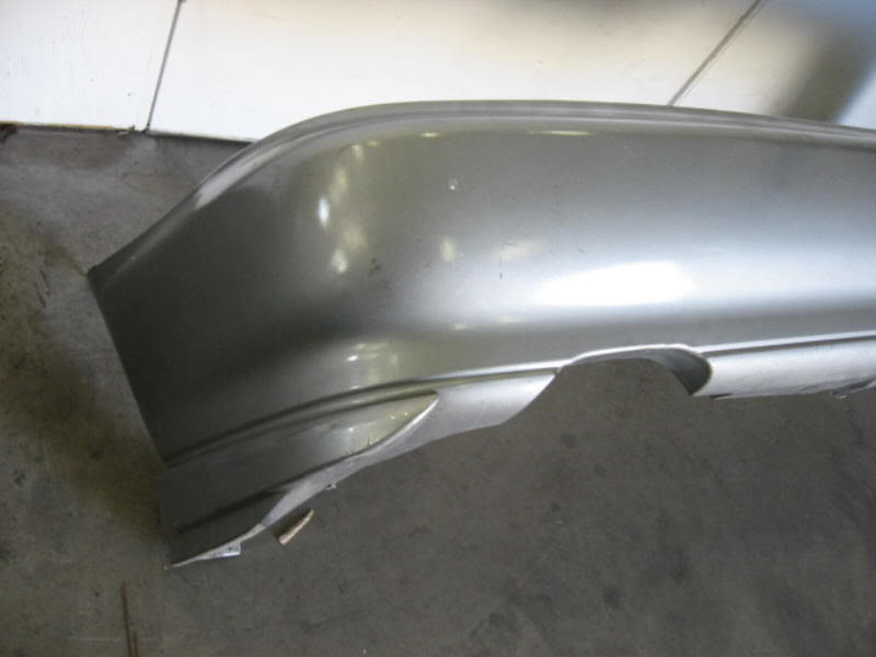

pic form the guy I got it from in the uk
