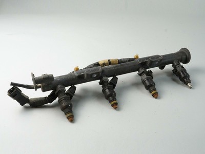

this link has some info on the 95 rail and how to change the regulator
and this is what the return-less rail on the later models looks like, it has a port for testing the fuel pressure.
there is supposed to be a cap on the port but its missing in the pics
yes thats what my fuel rail looks like exactly .I cant find a FPR anywhere on it.Im thinking someone before me changed some stuff around but if so they obviously forgot to install an FPR

thanks !!now is that rail in the picture the correct one for a 95 N/A 420A?There looks to be a plugged line that looks like it runs to the fuel tank,im not sure if thats a return or what?Whoever owned my Eclipse before me obviously screwed some things up.
the 95 rail with the regulator on the side has a return line that goes back to the tank.
seem to me like the 95 rail was replaced with a rail from a 96-99 car so now you have no regulator and no way for excess pressure bleed off.

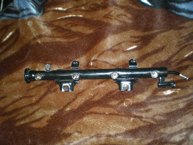

this is what the original fuel rail on a 1995 car looks like
picture-075-jpg.75399

That rail in the first pic is that part number
M04669377?​
now is there a separate regulator that attaches on the end of that or is it integrated with the fuel rail?I know where I can order a rail like that if thats the one I need but unsure if I also have to get a separate FPR.Yes I was looking into possibly installing an aftermarket adjustable FBR but wasnt sure what all parts I would need .Thanks!
so you would need the fuel rail, the regulator and retaining clip
