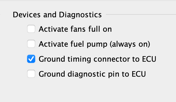

I didnt want to continue starting the car up at 2300 rpms. The shop mentioned that the high rpm cold start could be caused by the IAV. Bought a new one from Rock Auto. Tested the terminals on the old one, They were all within range. Tested the terminals on the new one before install.
Reconnected the battery and set the new IAV to 30 in ECMlink.
After this did not resolve the issue, I decided to block off the FIAV.
Decided to cut my own gaskets this time around. Everything back together and Voila! On cold start we raise to 1500 and then down to the ECMLink set 950 rpms.

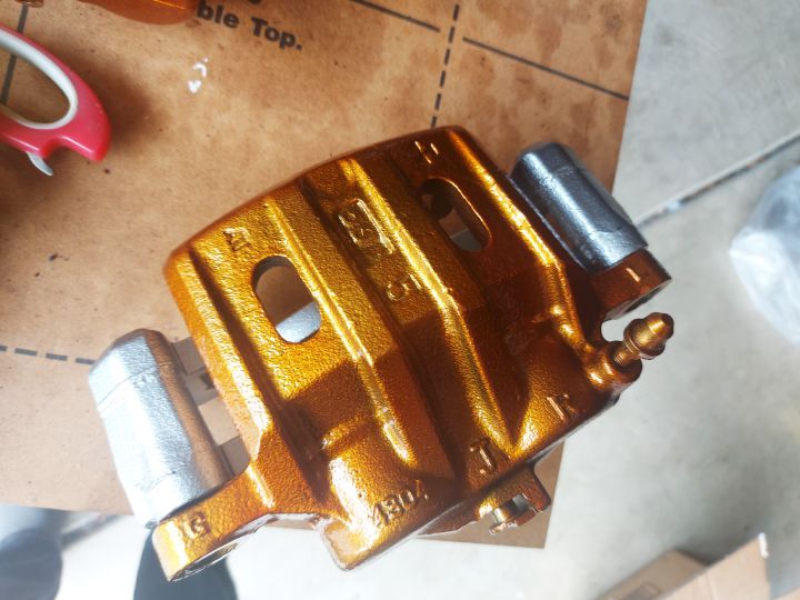

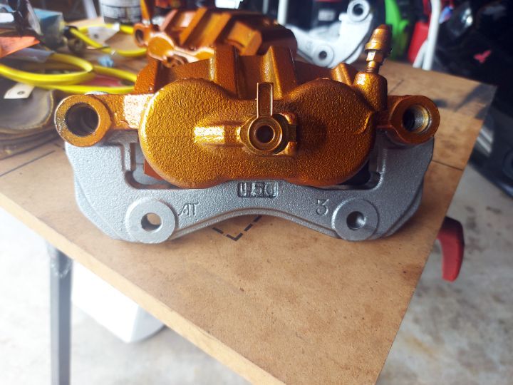

This creaking from the rear is driving me crazy. Whenever I lower it back on the ground from looking around a couple of times, I get about 2 minutes of peace before the rear end start squawkin' again. Thought it might have been the spherical bearings, but with the KYB struts and Eibach springs that have never been changed since Ive had the car, staring me in the face, I had an idea of what needed to be done.
Since I was replacing those, I figured it would also be a good time to install the calipers that I had painted last year and the stainless steel brake lines.
This short intermission is brought to you by this "pain in the ass" moment....
f*** this thing. I made the mistake of trying to take off front sway bar because I just HAAAAADDDD to let my ocd take over and couldnt bare to see it looking raggity while everything else was new and pretty when no one was ever going to see it 😔. Snapped the bottom bolt off on the drivers side 😡. Snapped the bottom bolt off on the passenger side an hour later 😤. Snapped an EZ Out off in the passenger side 🤬 (I have never successfully extracted a bolt with one of those). It was also impossible to maneuver it out of there 🤬🤬🤬. Had to raise the car higher and I eventually was able to pull it from the passenger side by angling it back towards the door. As a useful tip for the future, the tungsten carbide cutter Dremel bit from Menards, chewed right through the hard extractor metal better than anything else i tried. A friend of mine was able to get them out without damaging the threads so I didnt have to Time-sert/Helicoil it.
I found this gem on the vfaq, Stuck Brake Rotors, before I even got started with removing the rears and not only did I magically have the correct size bolt, but it was also the first one i pulled out of the spare bolts can. This made removing the rear rotors super easy and required minimal effort. I dont know the last time these were changed
The rear brakes still had padding, so couldnt have been too bad.
Picked up these Fortune Autos for super cheap some time ago. They were supposedly never installed before. Dont think they did because the preload was way off on one of them. So i reset them all.
The install was fairly easy. As expected, nothing was seized since most of the hardware had come off while at the shop getting the other suspension work done. Trying to push the rear hubs down far enough to slip the bottom of the rear coilover onto the spout mount on the knuckle was about the hardest thing.

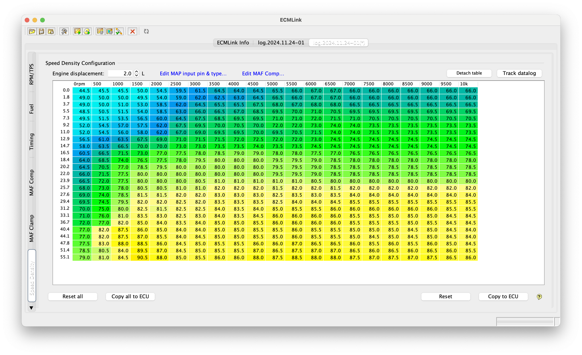

Im well aware that this tune is most likely half-assed considering the inputs (especially my AEM wideband) were never set up to log. I think that not understanding why the RPMs were hanging was one of the reasons the shop blew up at me that day...just wanted to give me the car back and not deal with it anymore.
So adding an idle log from right after fixing the injector boost leak. All that I really want to know at this point is whether something in the tune could be causing the cold start issue, whether that should be considered a normal cold start, or if I should be looking elsewhere. Id rather get these rpm issues resolved before I focus on fixing the tune itself. Anything past idle tuning might have to wait til Spring since its suppose to snow today and theyre gonna salt the roads. 😞 Vehicle profile is up to date.
Throttle body stuff...
900 RPM is your target and you get close. Your log shows low coolant temp (145deg). You can't evaluate your idle targets and ISC position until after the engine is fully warmed up - 180-200 deg.
Normal cold start is a high idle point up to 2000rpm, and then the FIAV slows things down as the temps warm up. You modified the FIAV start point to close it down so you may not hit 2000rpm cold anymore. The FIAV start point needs to be open enough to start without dying. Usually people close down the FIAV after all leaks are addressed and when you still get cold starts higher than 2000rpm. Closing down the FIAV start point too much will cause you to need to hold the throttle plate open when cold.
Setting up your TB.
The ISC (when the ECU is in closed loop mode) will try and hold your RPM target, but it has a narrow range, so the BISS and FIAV need to be close.
When the temps are warm, your ISC target position should be about 30. Adjust your BISS when warm until it holds 30 at your target RPM. I recommend enabling the diagnostics feature in ECMLink that holds the base timing at 5deg when setting the BISS for ISC position 30.
Also note - the Throttle Position Sensor (with close position switch), Throttle Cable, and Throttle plate full open stop - play a roll here.
I like to have all the cable slack on the closed side of the throttle plate range. Do this by loosening the throttle cable position, and then jam the accelerator to the floor. Set the throttle cable position to hold the throttle plate open against the full open stop with the accelerator all the down. This will prevent you from breaking your throttle body jamming the accelerator to the floor.
Letting off the accelerator, the TB plate should go full closed. The closed position can be adjusted - but if it closes all the way without sticking - then you are good.
After this - you can set the Throttle Position Sensor position so that - the TPS closed switch is closed, and you see about 0.63v in link.
Thanks for the reply
I included another, more recent log. This one was while the car was warm. The throttle activity in this log was just me pressing the accelerator / revving at the butterfly trying to determine the criteria for what is causing the hang, but should be enough to see the car idle while its warm. I had also set some inputs, but couldnt get the voltage for the wideband. It reads 0.00 despite physically working in the car.
I closed it all the way (I did not use a block off plate) because I think the walkthrough I followed says that it would create a boost leak if I didnt. I did also reroute the coolant hoses from the throttle body. Havent had any problems with stalling and havent needed to give it gas to keep it running.
1. I thought the need for holding the throttle during warmup was only if both the fiav and the isc were both blocked off, no?
2. The car still seems to warm up as usual, but does starting the car at a lower rpm eventually cause other issues? Seems like it is being given more gas on start up to run rich, without the RPMs to justify it. Not sure if or how much that matters.
Setting up your TB.
So i did follow this method. I disconnected the battery so that the lrndidleadj would be reset to 144 and then turned the BISS til it was around 30 while the car was at operating temp with no electronic or the fan running. Cant remember if I had done that for the previous log, maybe it will be reflected in this new log. If not, I will try again. I remember I had some problems with trying to get a steady 29/30/31 because it kept wanting to dip down towards single digits. But I didnt do the base timing lock that youre recommending so i will try that. But I did actually get it to hover around 30, so i thought i was alright.
3. How do you tell in the logs that the ISC isnt set correctly since that number seems to move around constantly when i look in my logs? Is it suppose to settle at 30 for an extended amount of time during idle when it is set correctly and just move around when you give it some gas? I dont know that ive ever viewed the logs of a properly running car to know what normal looks like.
4. Is this the setting that you are referring to that holds the base timing at 5 deg
Are you removing the coolant to the FIAV? I've never heard of someone needing to close the FIAV all the way to prevent a boost leak (unless the valve is broken and leaking coolant into the intake) If you are not going to control the FIAV with coolant, then - yes - closing the FIAV to prevent uncontrolled air (vacuum leak) from bypassing the throttle plate is correct. This is a workaround to a good FIAV, but not ideal - see below.
Removing the FIAV from the system this way will not always work. The ISC is only working in closed loop, so there is a time at the beginning of a start that is open loop (no ISC) and that will not work for all ambient temps. Your start today was with 47 deg ambient temps - good dense air. This may stay running without holding the throttle open today, but when it's HOT out you will have a different situation.
Yes - when the idle is stable, the isc stops moving around
4. Is this the setting that you are referring to that holds the base timing at 5 deg?
Yes that is it

I looked at your speed density map, and I have questions.
Did you make this map? How did you get here?
Same question for your direct access timing table and your Max oct table - How did you decide on these maps - they are really far from stock maps. Other tables in your DA are modified as well.
Nope. Not I
Ive mentioned a couple of times through the build thread with the more recent posts, that my car was at a shop (One that actually deals with DSMs/Evos frequently) and they screwed me over for reasons unknown to me. Their tuner was suppose to come back out and do a few more things, but the shop got frustrated with the car breaking on the dyno (clutch and fuel pump), interactions between me, them and the guy they have tune all the Mitsubishis. I showed up one day to supposedly pick up my car because they told me i would be ready, but instead they blew up at me for coming there after keeping my car for 7 months. I am unsure as to how far the tuner actually got which is why I have the #7 description of problems that Ive started all of these post with 7. Unsure how much of the tune was actually finished. That is why Ive been doing all the work myself to get it running well again.
Only things Ive ever really done in ECMLink is view logs and set the idle in the past, but even I can tell that there were some questionable things going on with it.
-None of my inputs were set
-My wideband works in the car, but wasnt set up to log in ECMlink.
-My airperrevs are high at like 0.40+ while idling
-Fuel trims look to be running rich
This is why I was trying to focus on fixing the low start up rpms and hanging rpms before i start asking people for help with tuning it. Because frankly, I dont understand how they did any tuning at all with all the boost leaks Ive fixed so far or with the rpms hanging between shifts, especially getting anywhere near boost.
Nope. Not I
Yeah - its not tuned. Whatever they were doing with ECMLink, it wasn't finished. I can help you get reset.
