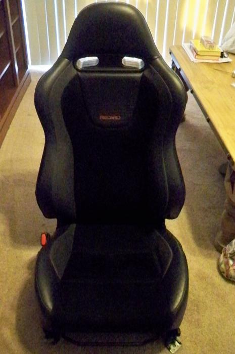

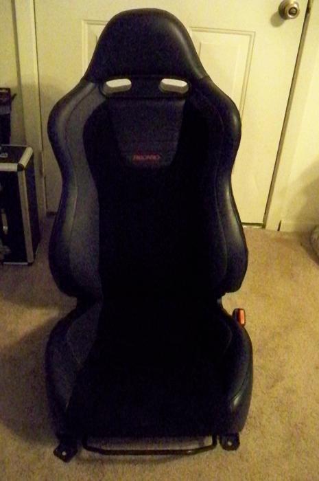

Got my Evo 9 recaros today! Going to call wedge soon and get some brackets.
No more words... Just pictures :hell yeah:

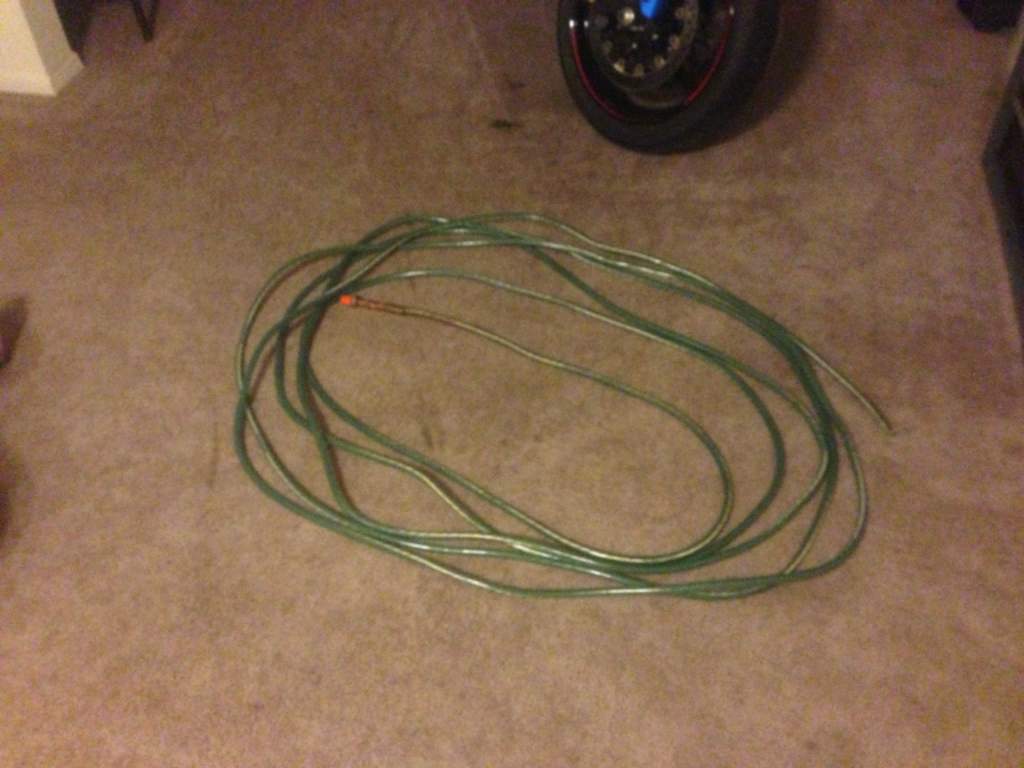

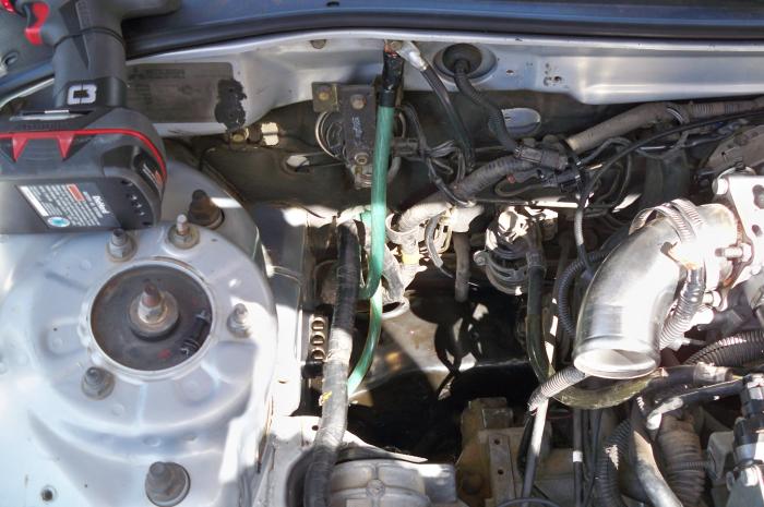

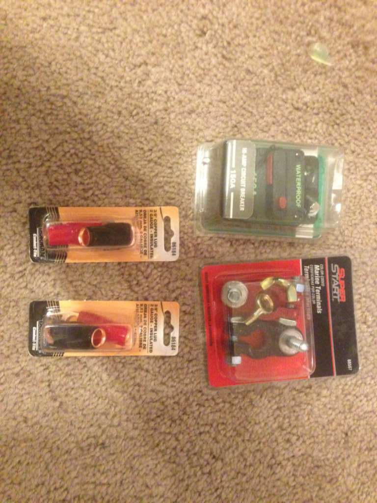

Got hooked up with some 2/0 copper for my battery relocation project. Preparing everything to install this weekend.
Jayson

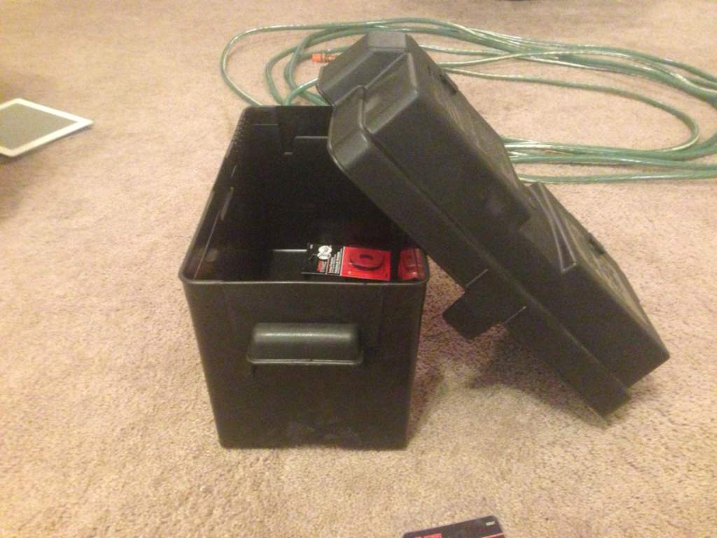

Picked up the majority of things I will need for my battery relocation project today, still need to hunt down the correct distribution block.

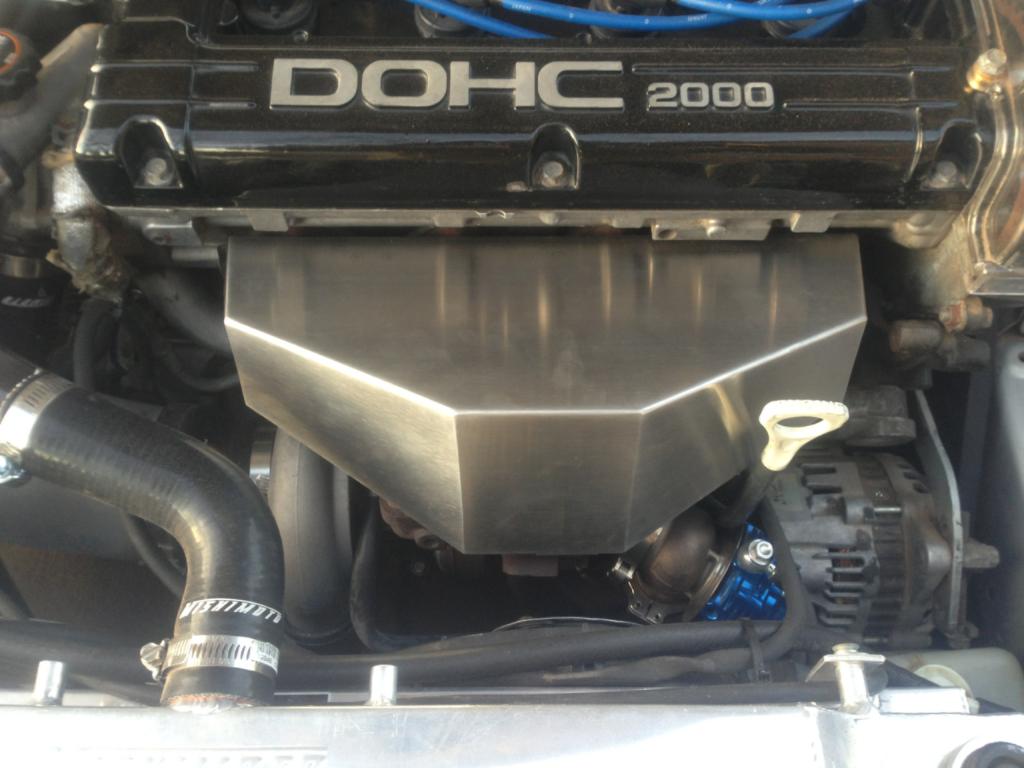

Also got the FP exhaust manifold heat shield installed and must say, I am very impressed.
Jayson

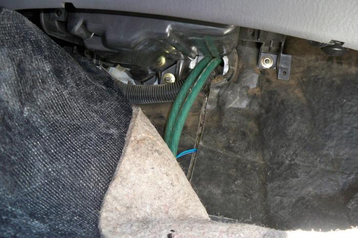

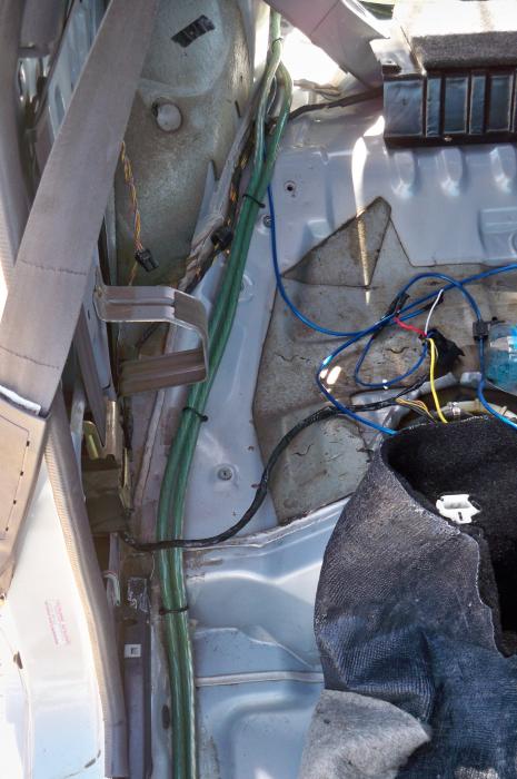

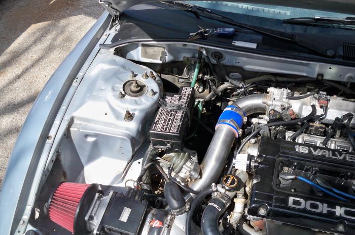

Finally got some time to complete my battery relocation today. Everything went smoothly, car fired right up when I was through. Decided while I was cleaning/clearing things out of the bay that I would do a simple relocate of the fuse box due to the available space where the battery was. Going to do some research for a cleaner way to mount it but overall and for now, I am happy.
On to the pictures. :thumb:
Jayson

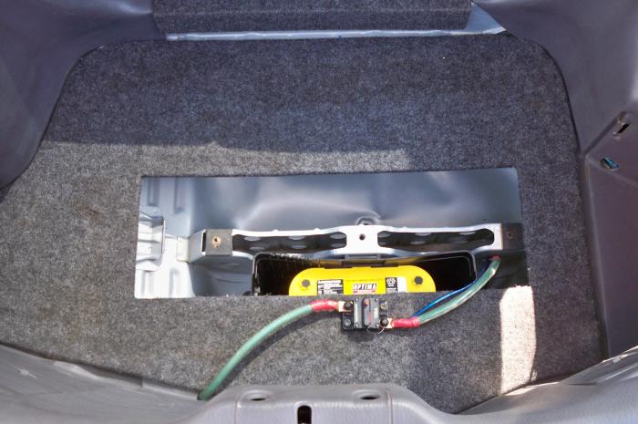

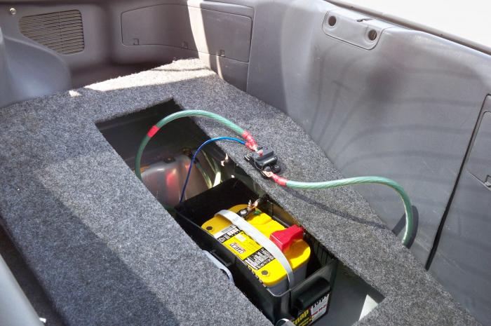

I actually decided to redo the trunk piece that had been in the car since I bought it. The amplifier used to show through the hole in the old piece, but I have since removed the entire sound system.
I've got the new piece cut, now to make a new hole to expose most of the battery but cover up that brace in the trunk.
Jayson
Finished up the trunk piece today, got it mounted and my battery hooked up.
Finished product..
Jayson
Awesome job so far! I am tossing around the idea of relocating my battery to the trunk as well. I am assuming you removed the windshield washer reservoir? Are you also going to install a kill switch?
Yes the reservoir has been been removed, I never use the rear wiper anyway haha. I do plan on installing a kill switch eventually, I'm told you have to have one to be NHRA legal.

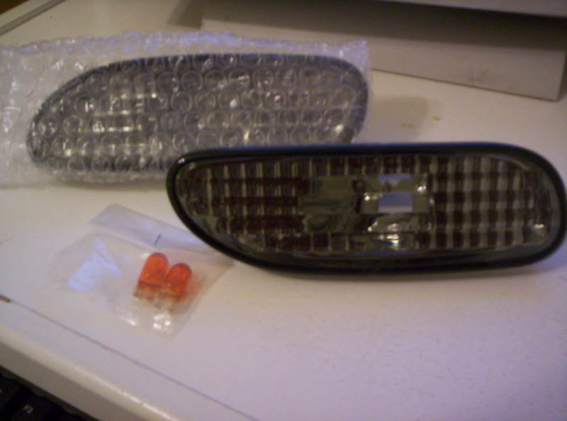

Yea - I am in the same boat. I really don't use the rear wiper sprayer anyway. I might snag this idea! And yes, you have to have a kill switch in order to participate at track events. I also went with smoked side lenses for the bumper. Since my car is black it meshes really well. Not to sound omega girlie, but I also like the pattern in the lens -
LED those markers..T10 led, get it in amber to be legal.
