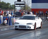

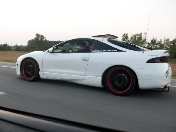

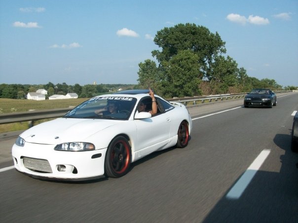

Street car. Full exhaust, full interior, all glass, no nitrous, street tires. LOL
To be competitive in Q16 I would have to gut the car, carbon fiber hatch, no exhaust, ect. Just not me yet.
I'm setting the bar high. I don't hide my build from anyone. I am going to be running against Zimmer, Bowers, ect. Shoot Zimmer has went 9.50.
