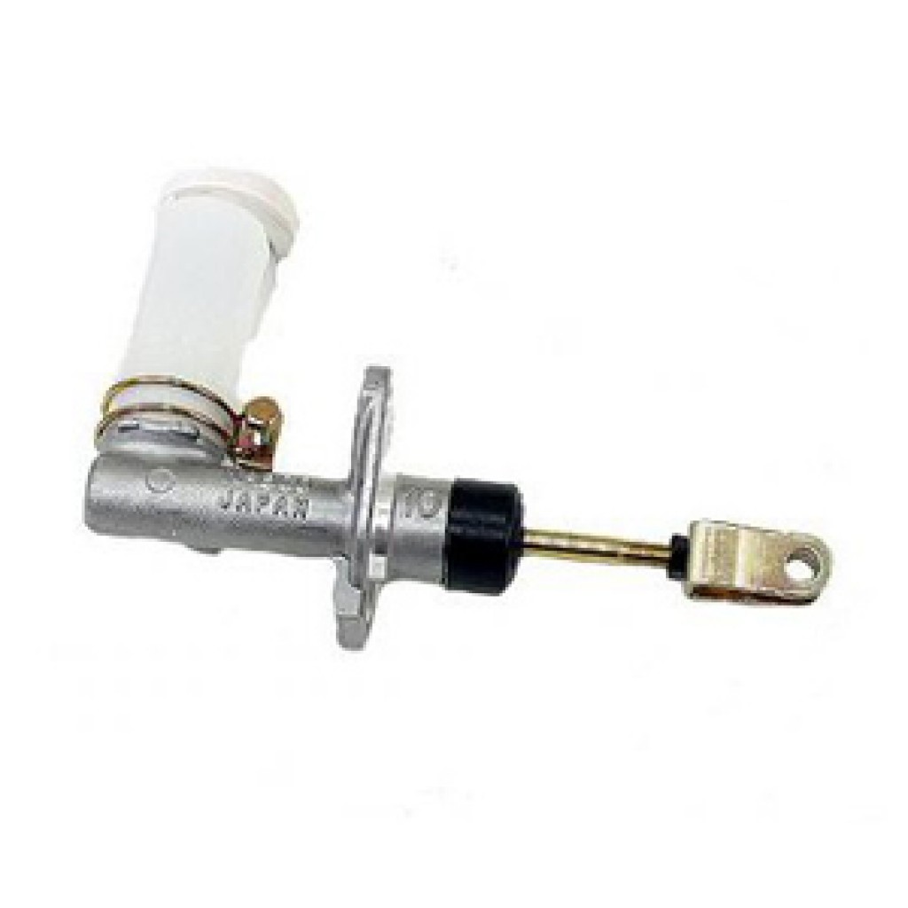

Hi, I am planning on replacing the clutch master cylinder and slave cylinder on my car (97 GSX). I found the OEM slave for sale on Extreme PSI, but the OEM master is discontinued.
STM does not offer one either. I found various options for clutch master cylinder on RockAuto, but I'm not sure if those brands are trust worthy or if they are junk.
If someone has had a good experience with a specific brand or knows where I can buy a good option please let me know. Thanks
Once I select option for a 2g it shows as out of stock. Same thing for the rebuild kit. I think I will go with Exedy one since it shows as the popular option on rockauto.

I'm not certain if this is the original on my car but it's a familiar brand. There's a few mentions on here about Nabco being the OEM supplier for 2g CMCs.
DSW also said "I don't see an issue buying one of those or the Exedy" :p
Are we sure about that?
I see what youre saying. Thanks for the visual. Looking at the blow up picture of the Luk... its actually a Sanyco unit. Any chance there were multiple OEM suppliers for the master cylinder before I put this quest to rest and go sit in the Corner of Disappointment :D ?
I would source a good oem core from a junkyard and buy the rebuild kit for it. I'm not gonna dig up the parts number either for ya, just know they're out there ready to source.

I have a duralast one in my current gst and its been fine for about 3 years now as a daily driver. I also purchased the last OEM one that extreme psi had in stock 3 years ago. I was in a spot that I needed to absolutely move the car the next day and ordered the oem one with anticipation i would need it eventually but I couldnt wait on shipping
long story short, the duralast one was identical to the one i removed and it was about $100 less than the oem one. I think I paid $130 for the OEM one.
the aftermarket ones work, but I will tell you that it took forever to find and adjust the engagement point of the aftermarket one. it works but I remember adjusting it every day for about a week after I put it in
im not advertising one brand over another, im just saying in my situation the aftermarket part has been working just fine. (and no im not selling the oem one I have on my shelf that is new in box LOL)
When I first changed the master and slave cylinder 10+ years ago I went with Tokico. Doesn't look like they make those anymore. Found out it was leaking last week and went with Beck Arnley, mainly because they seem to be OEM equivalent. Haven't installed it yet, so the only thing I have to report is that it's made in Taiwan.
Had a Duralast on another car and it failed in less than a year.

Exhausted all google searches for MB870511 so going with this Luk LMC339 from ebay: https://www.ebay.com/itm/2564652894...m3BeJC1agSfN+P5txsoxTC/ED9Qd|tkp:BFBMwISmiuhk

I went with the LUK option off of rock auto. Replaced both the master and slave cylinders (both same brand). Have been using them for a little over a year. Use my car every day since its my daily. Have not had any problems. My clutch line on side that connects to slave started leaking but I don't blame the new parts. I think it just started leaking due to it aging. Got new flex line from master to slave from stmtuned for $50 and car's been working great. Car is mostly stock. Only have act streetlite flywheel and act 2100 clutch. 97 gsx.
