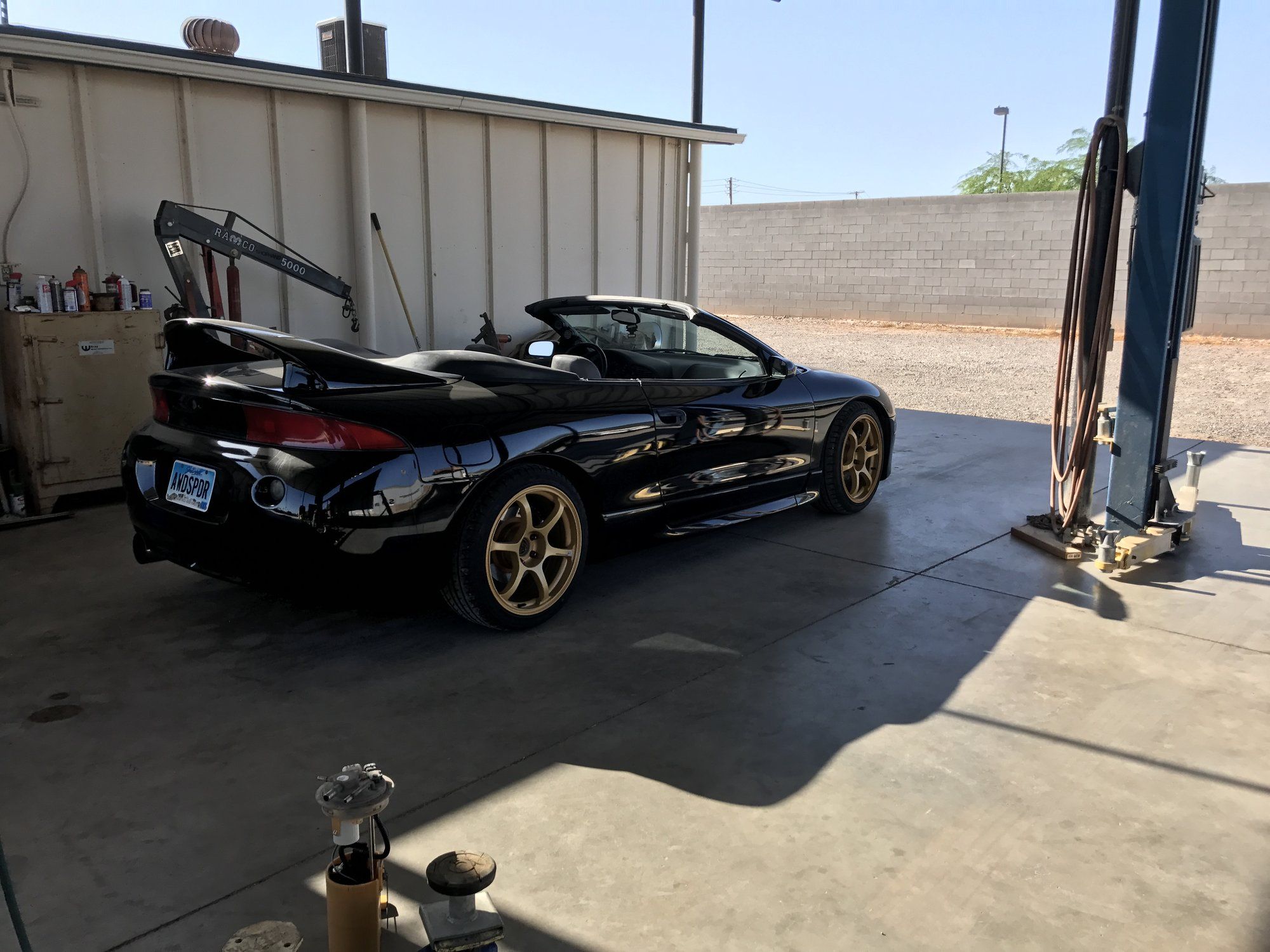

I had a long drawn out opening post but my computer shut down before I could post it. I'll try updating this back to when we first bought the car almost 10 years ago. For now here's some progress pictures of what the car has turned into.
The Red car is a buddies car that I AWD swapped and built as well.

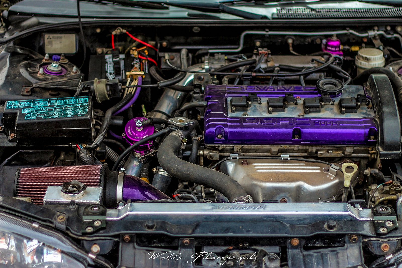

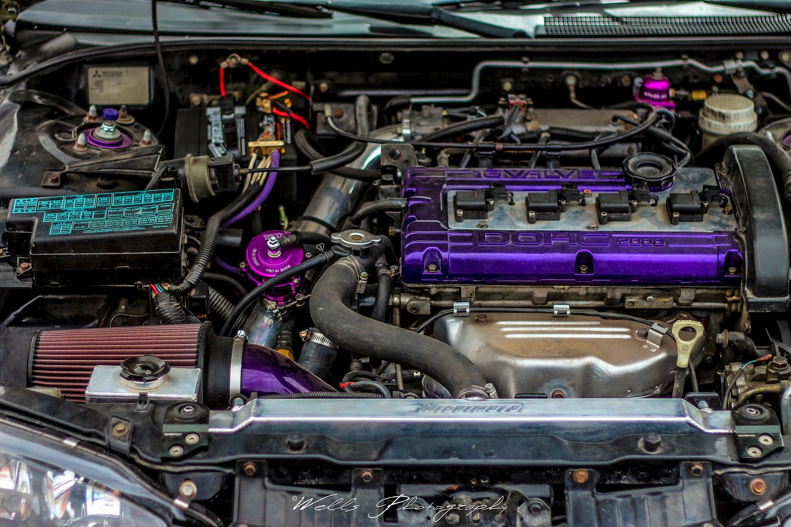

The black car is/has always been an autox/daily. It's currently on a s16g, VRSF, 1120CC FIC's, thermal R&D turbo back exhaust, with an FP intake and speed density on an evo ecu. The suspension is D2 coilovers, poly bushings throughout, with 18x9 +29 Advan RG2's with a 235/40 tire, it also has evo brembos front/back and a 3g master cylinder. My girlfriend autox'ed this car for 4 years stock before we decided to AWD swap it. It hasn't been out for an event since the swap, but I'm hoping this year the car will be in a place that I feel comfortable/confident in it's race ability. We've taken the car to west coast MOD 2 times now since the AWD swap. It still has all the creature comforts- cruise, AC, full stereo system, and a full interior. It's a very comfortable cruiser that we're hoping with some better coilovers, wider tires, and some chassis improvements will be a very competitive SM car in our local NASA/SCCA groups.

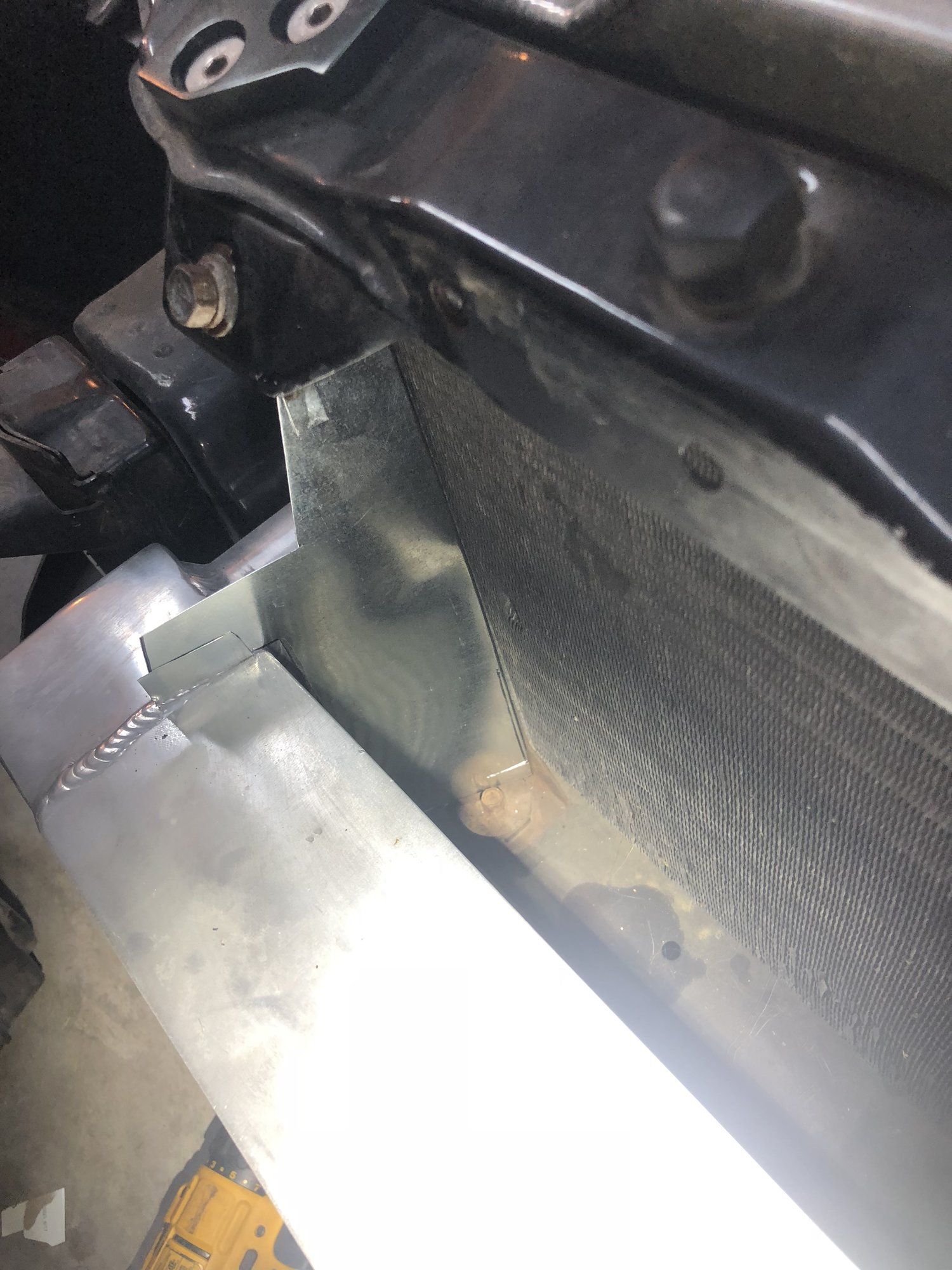

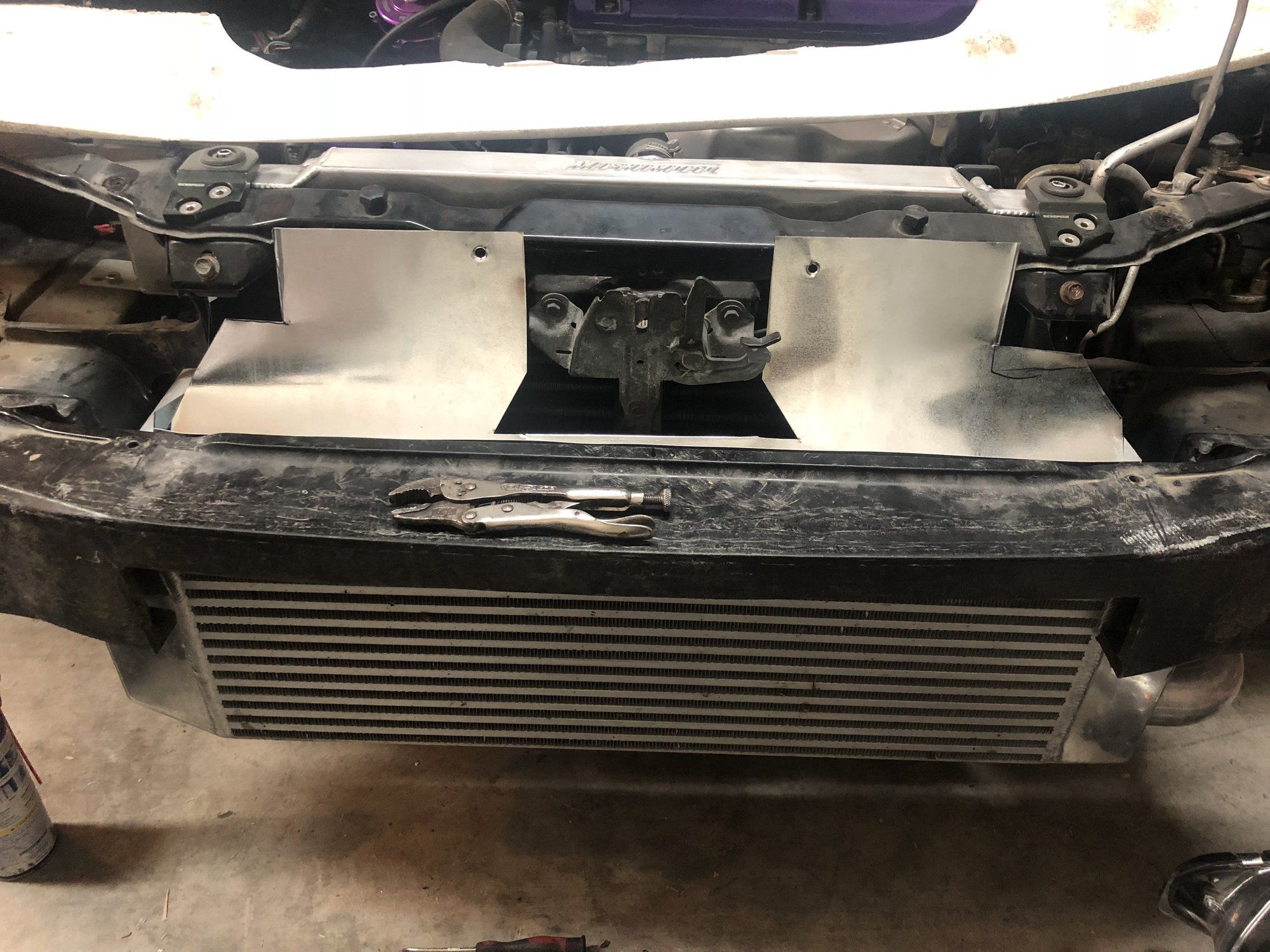

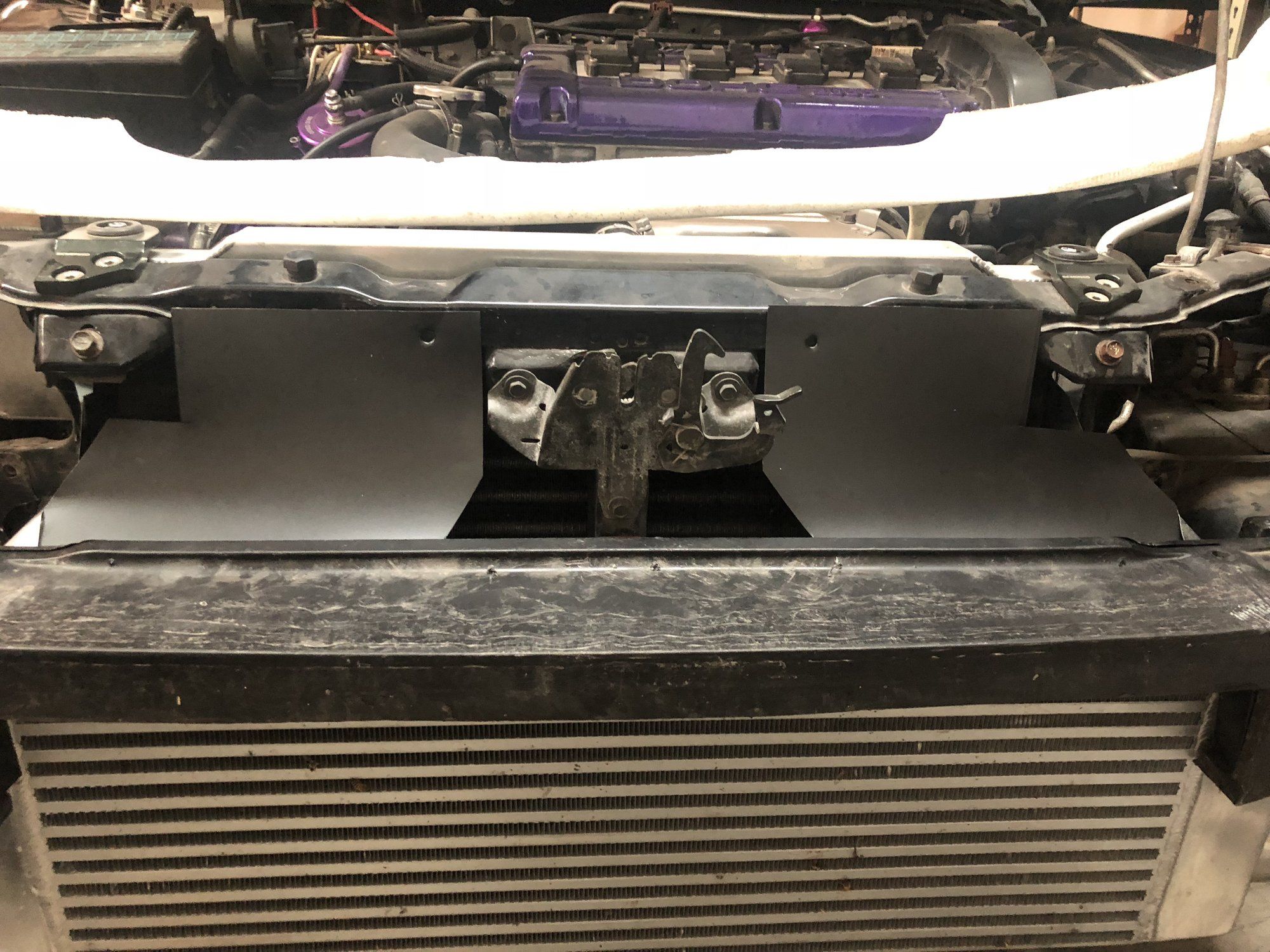

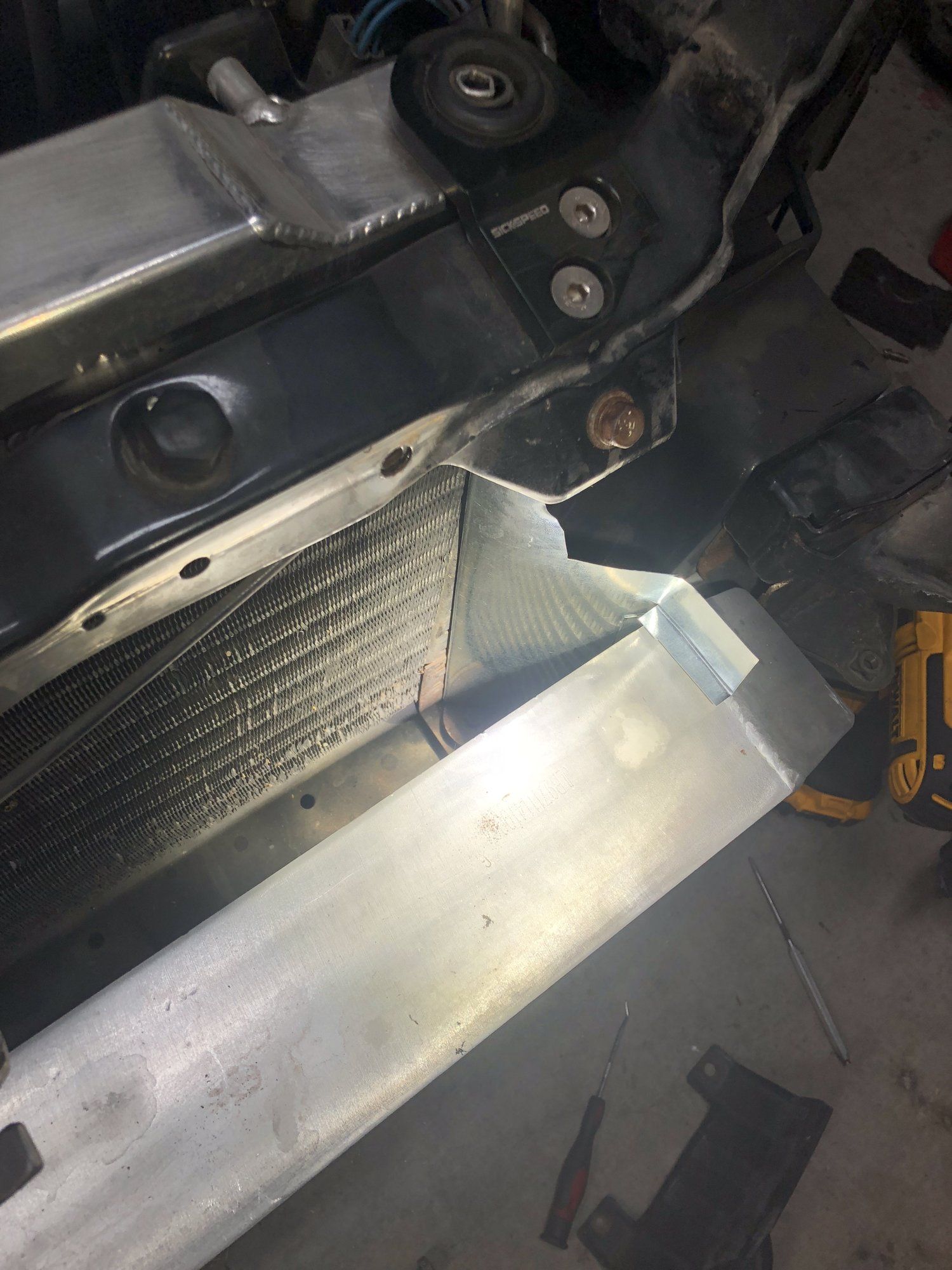

I don't normally get a lot of time to work on this car, but I had some free time this weekend. We've never had problems with the car overheating even running the VRSF with AC and 115F temps, but I knew once the car is back on the track airflow would be an issue. I've been wanting to duct the front end for quite some time and finally got around to doing so this weekend. The front bumper is completely sealed off to the intercooler. No airflow can go around the inlet without going through the intercooler, but behind the VRSF was a large opening on the bottom, sides, and top. This took about 6 hours in total to build, but the intercooler is not completely sealed to the AC condenser which is completely sealed to the radiator forcing all the air coming in the bumper inlet to go through the radiator. The only spot that air can escape from is between the hood latch where I had to notch the top cooling plate. The area is small and its technically above/in front of the path of air coming out of the intercooler so it should have a minimal effect at worst. The plan is to put a vented hood on the car sooner than later and the hood latch assembly will be deleted for hood pins anyways, allowing me to seal it off completely. I don't have any completed pictures as it's pretty much impossible to see with the bumper plate bolted in, but the raw pictures are a good representation of how its fitted.

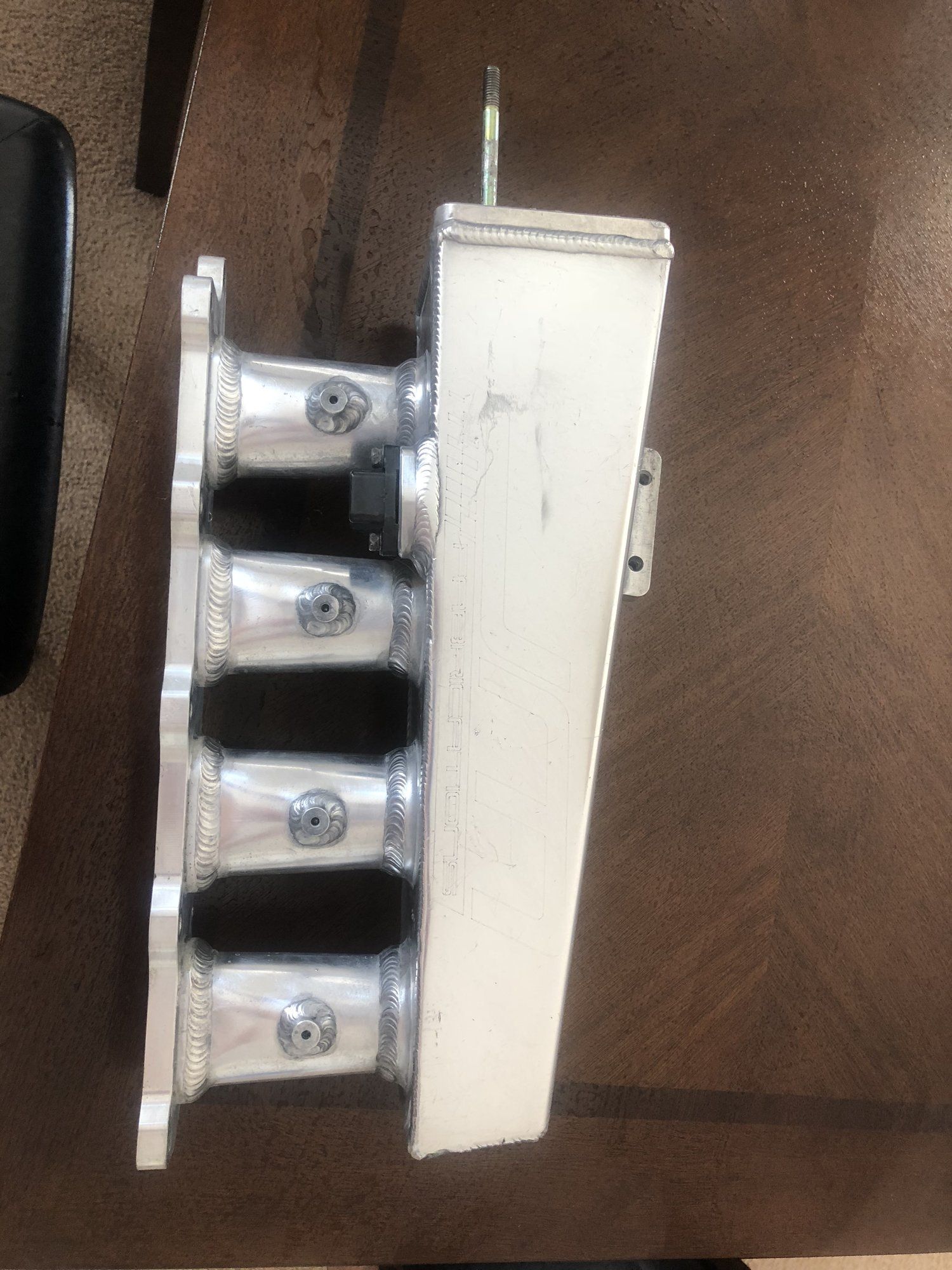

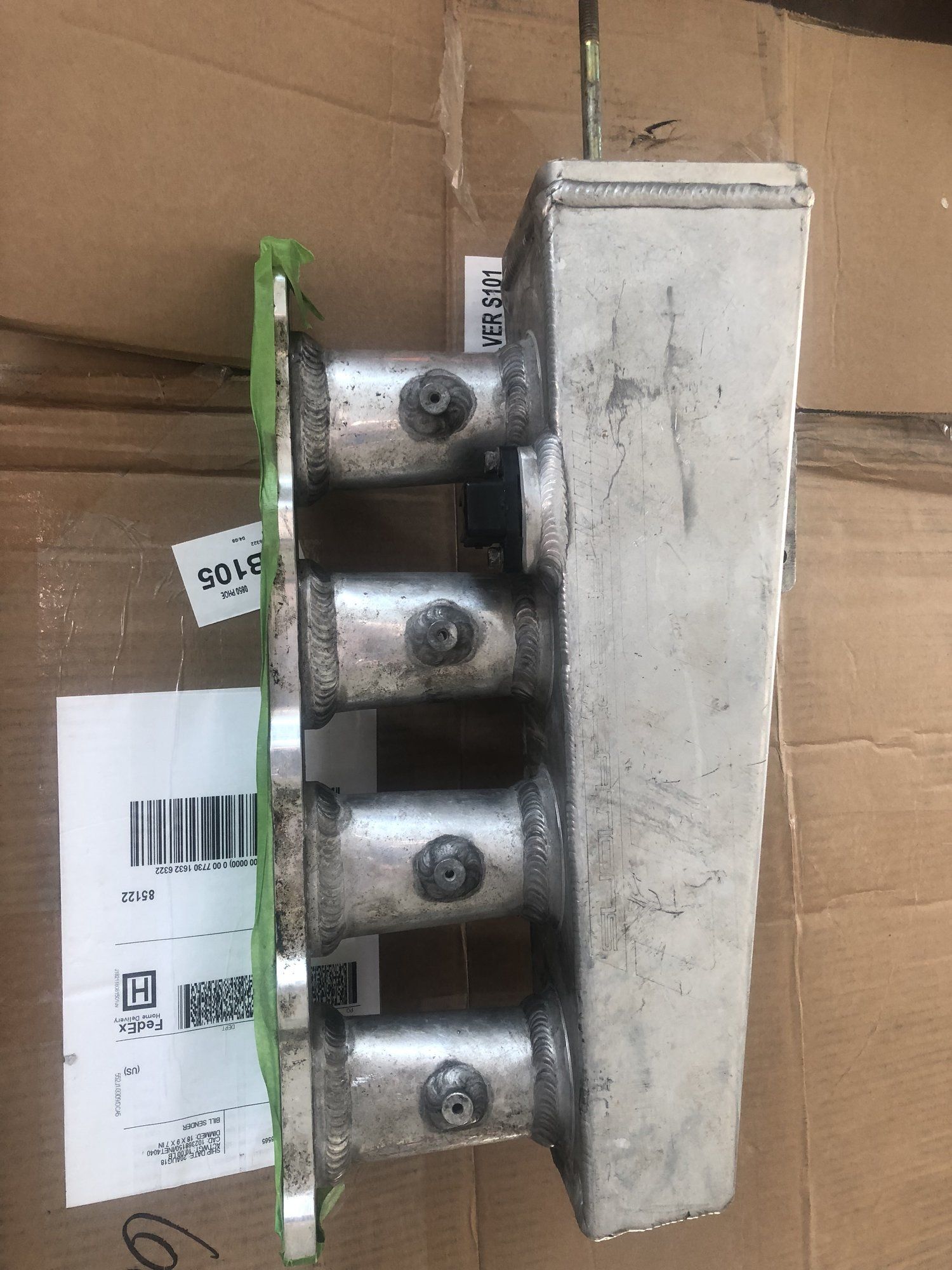

Ordered some more parts for this car. Picked up a super cheap JMF street SMIM. I was looking for an evo 3 mani when this popped up for a great deal. It was pretty beat up cosmetically. Spent some time polishing it and it turned out a lot better than it started. We’re going to have the JMF logo engraved deeper/wider and then color fill the logo to match the car. Once that’s done, on it goes!

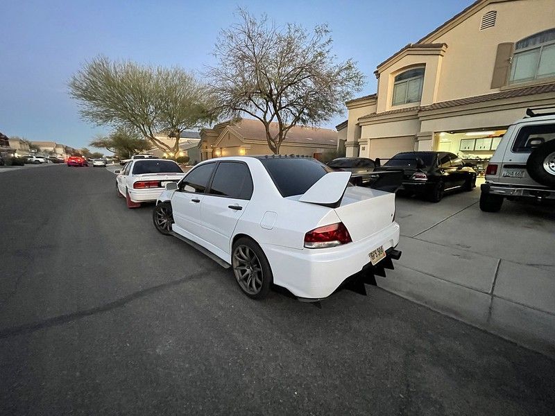

Put a set of HKS 264/272's in the car a few weeks ago. We're in the process of retuning my evo 8 right now and then this goes in for it's tune. Looks like we're probably going to miss out on this years race season before summer comes and it's too hot to race. Hopefully come fall we can start racing this car again.
Untitled by Tyeler Andersen, on Flickr
I've been having a blast in my new to me evo 9 though. This things an absolute weapon on the track

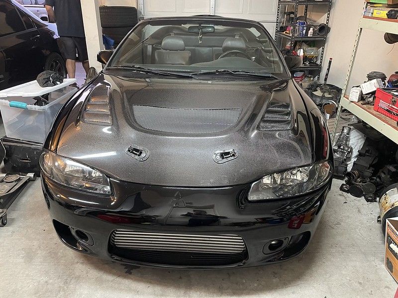

We picked up an AWD donor for the green spyder over the weekend and it had a carbon evo style hood. I told my buddy I'd buy some parts off the donor to help recoup some cash back, the hood being one of them. It was either this or an AB hood, and I just couldn't bring myself to pull the trigger on an AB hood after trying to get fender and bumper gaps aligned on the last one I installed.

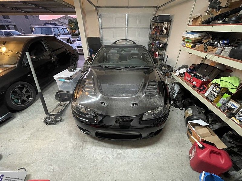

Wow it's been a while since this has been updated. The car hadn't changed much for a few years from the last post outside of having it tuned on the evo 8 ecu. This is just a s16g car so I wasn't expecting much but at 28lbs it made 323hp on e85, 294hp on 91 octane. I drove the car for around 2 years like this, but I honestly hate the dual maps and while I was switching the other cars over to haltechs we decided to just saw screw it and swap this over as well.
The new setup is an S2 haltech, mitsubishi endeavor DBW throttle body and a lancer DBW pedal. This let me ditch the entire cruise control assembly in the bay and while in there I put the fuse box up under the headlight to clear out the entire passenger side of the bay. The cruise works flawlessly with the DBW and stock cruise switch and I repurposed the set button to set the cruise and also engages the rolling antilag. Everything about the driveability is better, it's full flex now so no dual map switching and I have put more miles on the car in a month than I have in the last 10 years.
Before an after, it's not wildly clean but way less cluttered now.
My buddy did a convertible conversion on his mazda truck so we had to get a shot together.
I'm finally confident enough in the ability of the car to actually track this thing again. 2012 was the last time this car was actually raced and it was built with the intention of tracking it again. My gf has been a lot more involved in road racing over autox so it may get a bigger turbo swap since this s16g is a little under powered for the tracks we road race at.
