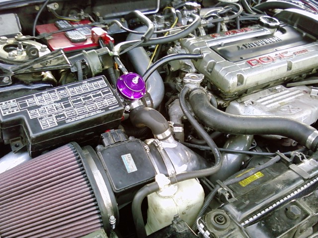

heres the best pic i have.
<a href="http://s295.photobucket.com/albums/mm125/joat099/?action=view&current=tsi_engine_bay.jpg" target="_blank"><img src="http://i295.photobucket.com/albums/mm125/joat099/tsi_engine_bay.jpg" border="0" alt="Photobucket"></a>
If thats a picture of your car then you DEFINITELY want to recirculate that BOV (they sell the piece on ebay to recirculate it for like $15-$30) If that isn't your engine then never mind. Make sure you do all your maintenance also( Boost leak test, comp. test, check belts, etc.)
If thats a picture of your car then you might want to recirculate that BOV (they sell the piece on ebay to recirculate it for like $15-$30) If that isn't your engine then never mind. Make sure you do all your maintenance also( Boost leak test, comp. test, check belts, etc.)
