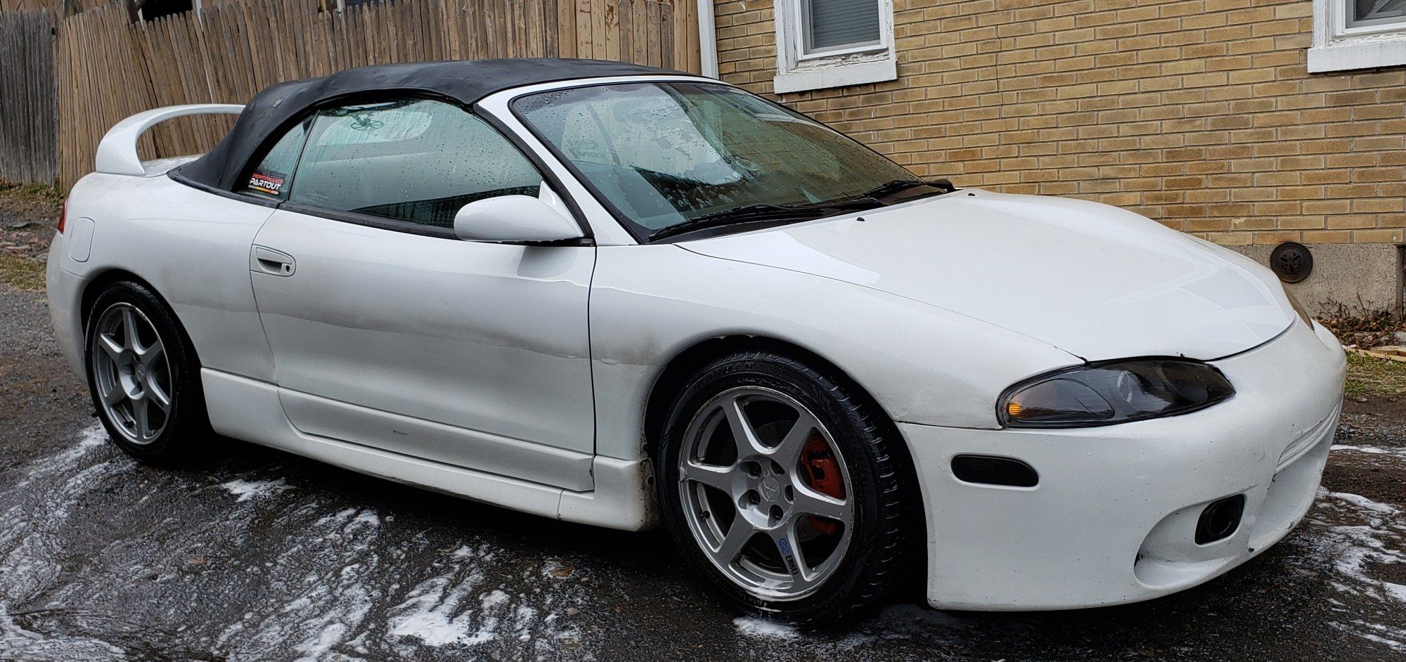

99 Spyder GS.. working on the 'T'
Picked it up for $750 as a beater and my first DSM, let's see what it becomes!

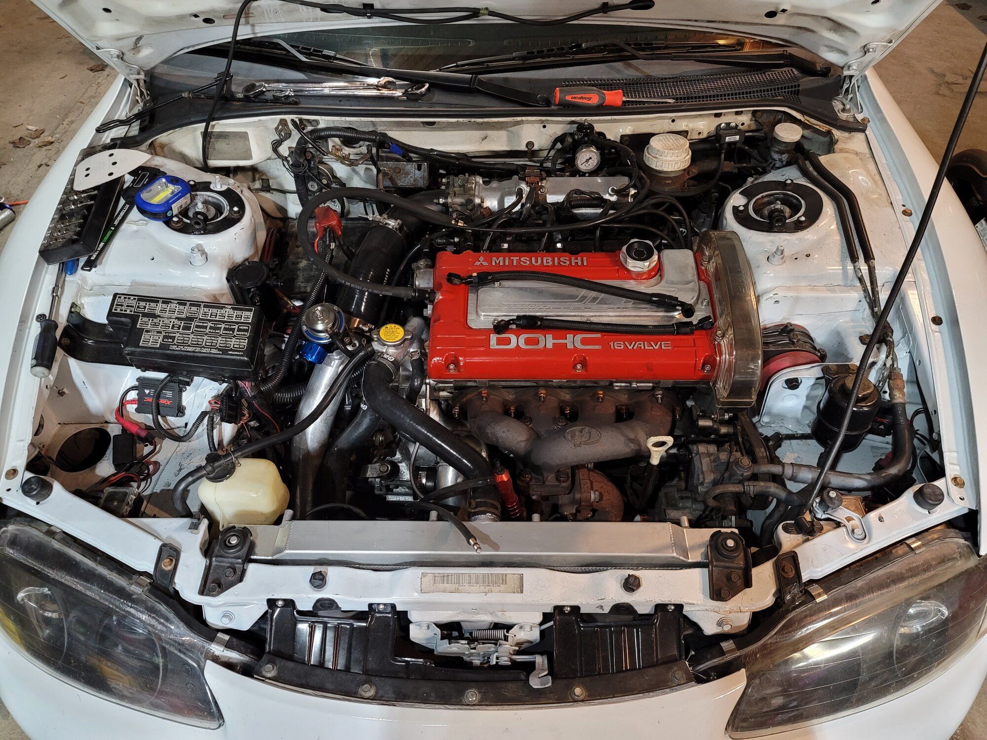

New parts in to complete the final few touches on the car. I inadvertently made the engine bay patriotic without even thinking about it.. red valve cover, white body, blue blow off valve..

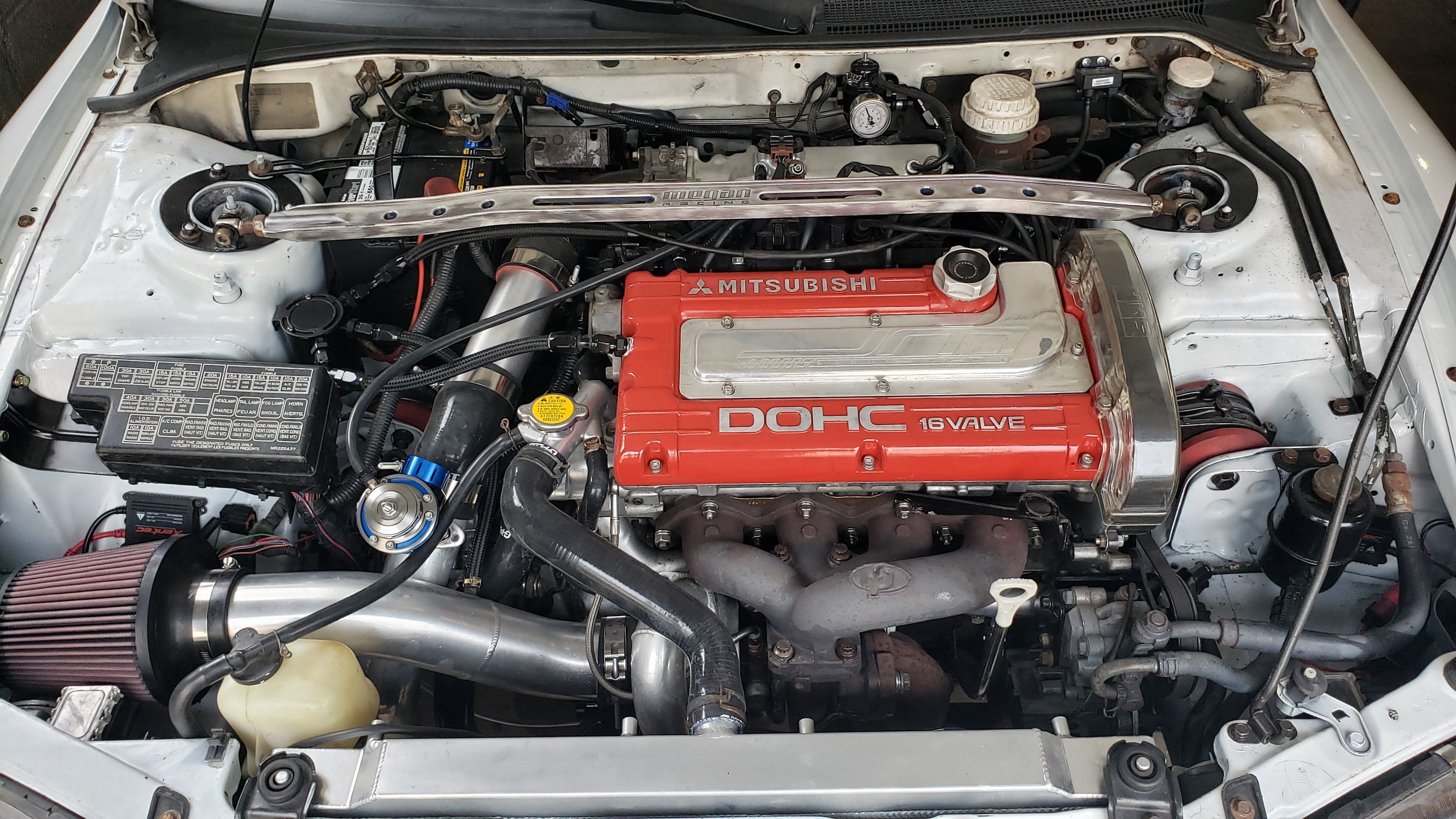

Swapped out the 1G BoV, I just couldn't deal with the whistling sounds it made at 1800 rpm. In it's place went a GReddy Type FV. I never realized just how big of a difference a BoV could make.. but the car builds and holds 23 psi with ease now.
I also swapped out the dipstick tube o-ring to fix my oil leak, and dropped in a new wideband sensor as the old one had intermittent dropouts while logging.

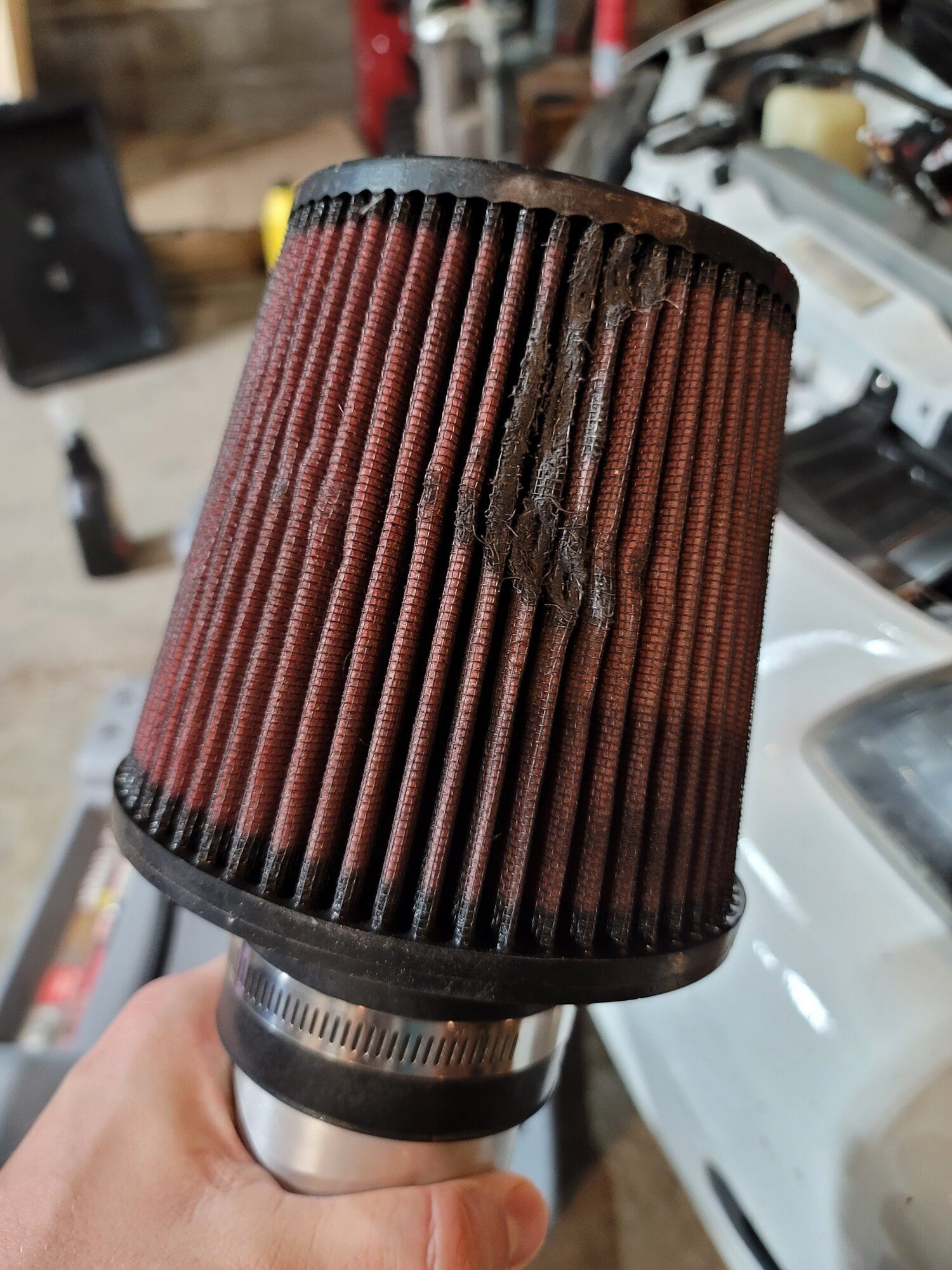

Also found some carnage on my air filter.. apparently it was bouncing against the headlight bulb cover and wore through the filter.. ordered a replacement (glad I found it.. was impossible to see until I pulled the intake pipe..

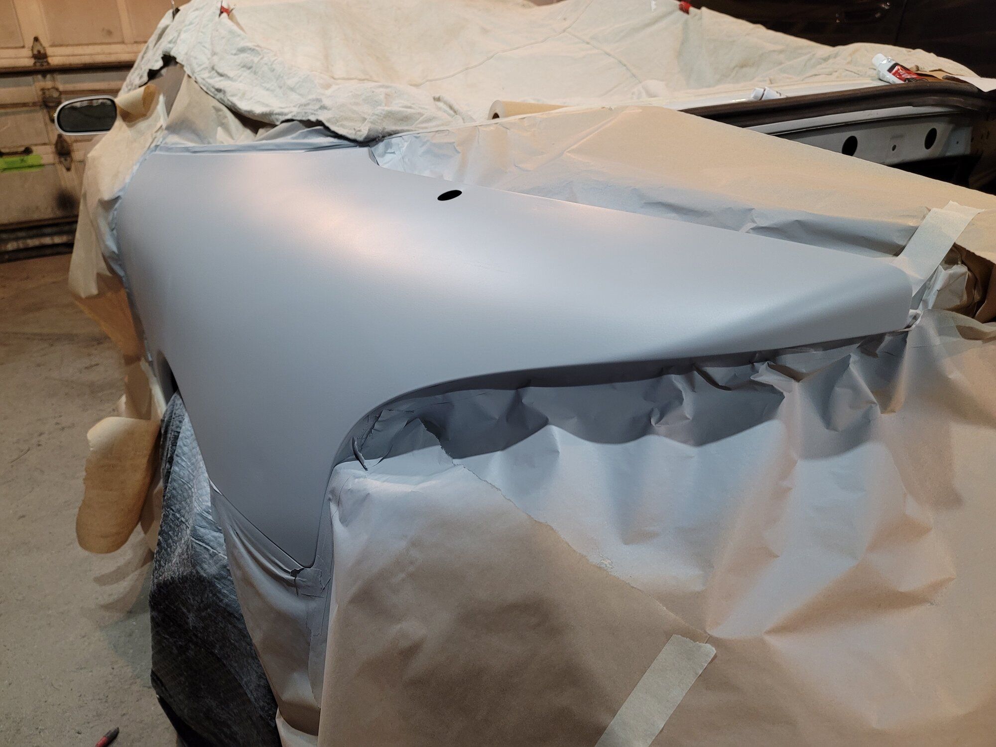

Now that the drivetrain is situated, I decided it's time I deal with the overdue bodywork. When I originally bought the car, the previous owner had installed a primer black hi-rise spoiler (half assed installation...) and the factory mounting points for the stock 3 piece spoiler were just left open to the elements. I was indifferent on the hi-rise at the time, so I painted it to match the car, and did a quick and dirty body filler job on the stock mounting points for the three piece spoiler.
Fast forward to while I was doing the 4G63 swap, by that time I realized that I didn't like the hi-rise spoiler. The Spyder has limited visibility through the rear window as it is, and the hi-rise blocked all of that visibility. Not to mention, the half-assed installation the previous owner had done always bothered me. So, the hi-rise came off and I threw yet another quick and dirty body filler job to get us by for a while. The front of the vehicle received a proper body-work treatment at this time, so the front half of the car looks significantly better than the back half.
Well, it's time to fix it right. I spent the day today working on the driver's side rear quarter and the trunk lid. I stripped it back to the bare metal, popped out the quick and dirty body filler, and prepped the surface properly. I dented in the sheet metal around the factory mounting holes for the spoiler, and then put down a layer of bondo-glass to fill the holes with something structurally sound (I considered welding them shut, but I have very little experience with the welder and my attempts on some scrap sheet metal did not go well..). Once that was dry, I spent a few hours sanding. Once I was happy with the smoothness of the surface, I threw some glazing filler down, and then did some more sanding. Once all of that was done, I taped off the rear quarter panel and hit the panel with some primer so I could see the hi and low spots a little better.
There's still a few minor imperfections that need to be addressed.. but holy shit did that come out 1000x better than I had anticipated.. OMG

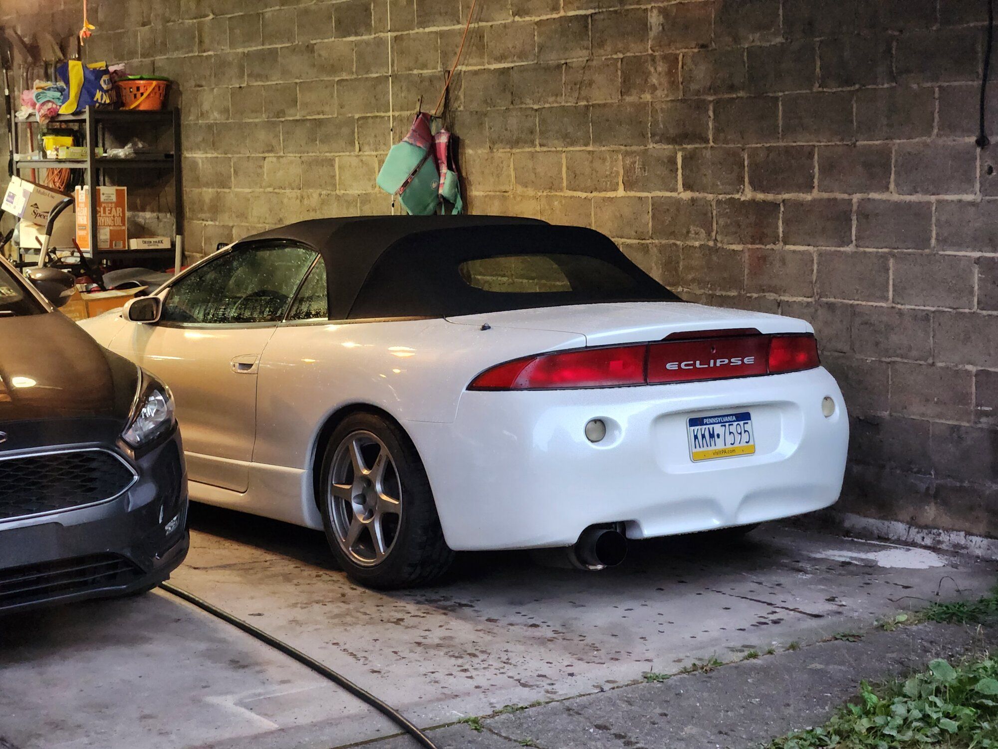

Haven't posted in a LONG time since there was nothing to say. Car has sat mostly idle for the past few years since work went 100% remote and I rarely drive anymore. Unfortunately, my update today isn't a good one and I'm looking for some advice from the community.
Since the weather is starting to break in the northeast, I decided to take the car up to the local inspection station and get a new set of annual stickers slapped on for the ~100 miles I may or may not put on the car this year. What I had expected to be a simple visit turned into a nightmare scenario. Apparently, time caught up with one of the rear brake lines and brake oil had been seeping out and sitting on the frame for the past few months. This seems to have been the straw that broke the camels back, as the frame rail is starting to fall apart now.

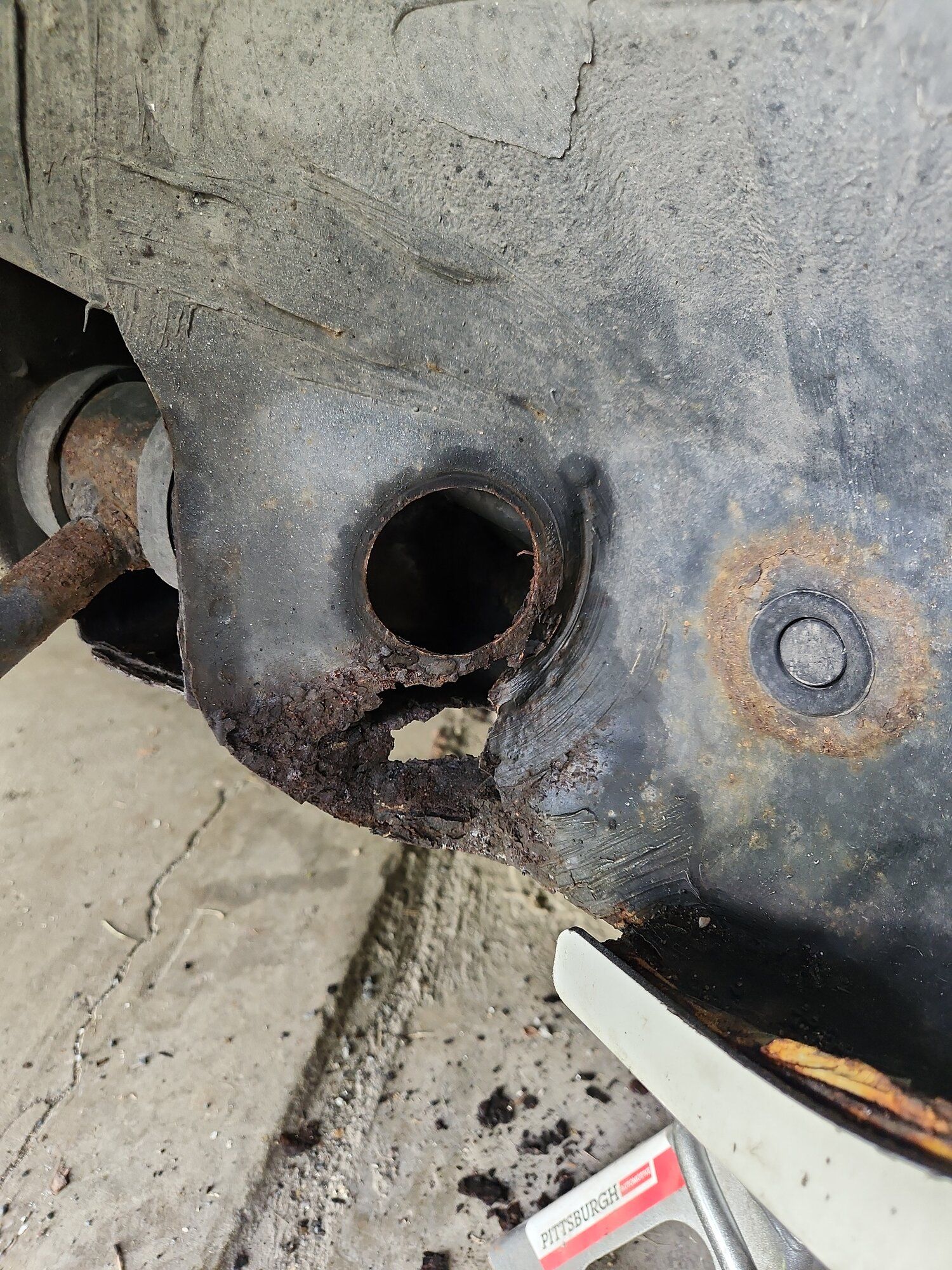

This is the passenger rear wheel well, i barely touched the metal and my finger went straight through. How bad off am I? I know this is beyond my abilities to fix.. is it possible to fix this? How absurdly expensive do we think this will end up being?
My gut is telling me to let her go.. but my heart won't let me.
So sorry to hear about the rust issue. Brake fluid didn’t cause the corrosion; road salt and time caused it. In the upper midwest, we recognize the signature.
Unfortunately, for any rust you can see on the outside, there is double the rust on the backside.
The good news is that it is repairable, but will be a project. There are enough 2G chassis around at places like Kannapolis @steviemiller for them to cut out sections for you to weld in place.
We’ve found locally that welders are willing to weld most anything we ask, but are not thrilled about fabricating. So if you already have the part to weld in, chances are much higher that you’ll find someone to do it.
Now is the time to put the car in the air and check all other places on the chassis and frame and see if there are other rust spots. Sadly, likely there are. If there are more advanced rust areas, skip the repair and swap your parts to a rust free chassis.
@DogWhistle i appreciate the positive feedback. I'm extremely unfamiliar with body/chassis work, and unfortunately dont have a lift available to get the car in the air properly to inspect this. Are you suggesting that this is an area that can be cut out entirely and a new section welded in?
Any body experts in the forums that may have a roundabout idea on a cost to have a body shop do such a thing?
This is less bad than the one I'm getting ready to start repairing right now. I'm probably going to need to get some large chunks from a donor for this area on both sides of mine.
I've been looking for 420a shells with minimal rust because I really hate the thought of chopping up a rust free 4G chassis.
I'm not well versed in bodywork either and it's been so long since I used a welder last that I know I'll not remember much. I'll offer any insight I can along the way once I get the metalwork started.
Yes. There have been project cars here that have done major rocker panel repairs using grafted metal from donor chassis. Having a conversation with a welder will let you know how big an area is affected once they look at it. You may need to get a referral from some speed shops on who will handle custom welding for you.

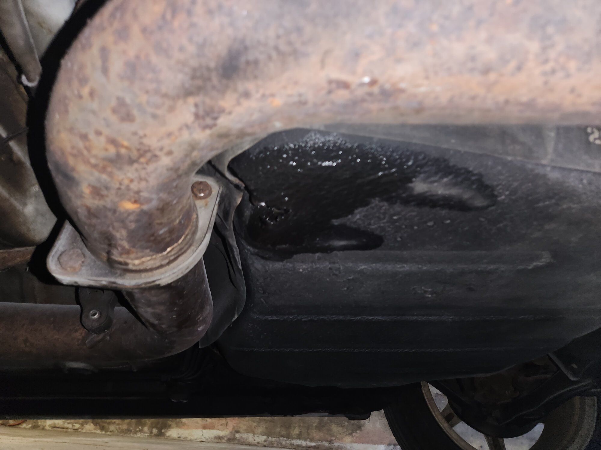

Ugh.. two steps forward, one GIANT leap back.. something wasn't put back together right and long story short, I've got a giant hole in my gas tank. Waiting for the shop to send a tow truck out so they can fix whatever the hell broke.. and put a new tank in :cry:
Man that's really shitty, sorry 2 hear about that. What do u think wasn't put back 2gether properly? It kinda looks like maybe u hit something

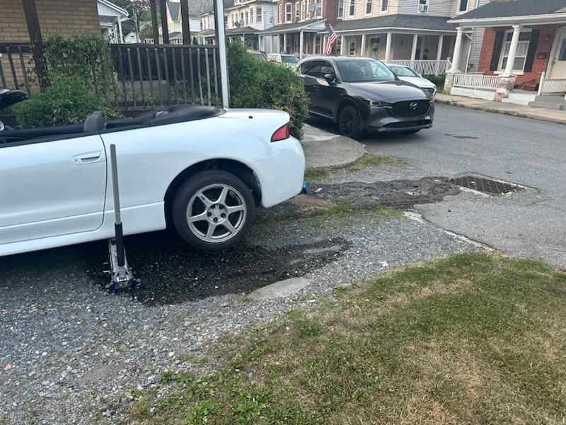

The exhaust is pushed back a good 2-3" and isn't seated properly right now. Here's where it happened.. about 20 feet from my garage while pulling into my alleyway.. as you can see from the pic, there's nothing to bottom out on..
We turned into the alleyway, I heard a LOUD pop, then smelled gas and immediately killed the engine. Ran into the garage to grab some speedy dry to stop the gas from running into the sewer drain.
I'm convinced at this point that I'm cursed by an unhappy DSM that was parked for too long.
So, the hole in the gas tank is now resolved. It was caused by an improperly secured exhaust hanger from the body work that allowed the flange before the tank AND the muffler to hang a bit too low and catch on the storm drain that can be seen in the picture posted above. Due to the "he said / she said" aspect of the issue, and understanding their perspective of "we don't know that you didn't bottom out - and there are very CLEAR indicators on the exhaust that you did".. I opted not to get into a useless back and forth argument with them and found a happy middle ground with them. I'd buy the parts and pay for the tow, they install the new tank and re-hang the exhaust properly.

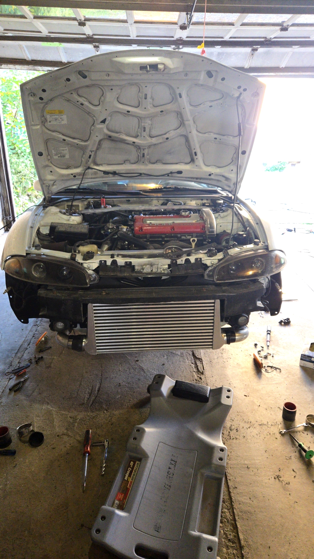

Made some calls and paid John over at Performance Partout a visit.. he had a NIB front mount that matched the dimensions of the one that was smashed near perfectly. While there, i got a nice look over what he's been up to since taking over the business from Nate. It's exciting to see him partnered with some of the vendors on here and maintaining a stock of their custom parts. Now that I've seen the boosted fab front cross member in person, ill be picking one up sometime in the next few weeks. Those things are extremely impressive.
So, with the parts in hand, I'll be pulling the bumper and swapping the crushed FMIC out over the weekend.
@techboy once i finally get this damn thing back together we'll have to sync up at a cars and coffee. While my car is still nowhere near as clean as yours, now that it's got some fresh paint I can justify parking it and letting people get a closer look ROFL.. and it'll be a nice opportunity for you to see the motor I picked up from you all those years back in it's new home. :hellyeah:
Ive been bitter about the car ever since the gas tank debacle. Seems like every time I look at it, I find another flaw in the body work and remind myself I paid way too much for it to have been so half assed..
But, i put my big boy pants on today and decided it's time to start making it right. Pulled the bumper, swapped the intercooler, and started to repair some of the shortcuts the body guy took (seriously.. how hard is it to use the right f'ing body clips and 3M adhesive for the side skirts... 😒)
And yes, for the astute viewers out there.. that IS electrical tape temporarily in place instead of a coupler on the driver's side - turns out, the replacement intercooler has 3" inlets and not 2.5" like i needed. I had one 3" to 2.5" reducer.. but, new couplers and T-Bolts will be here tomorrow. I just needed confirmation for my sanity that the intercooler was 100% of the issue and the electrical tape "coupler" gave me the confirmation I needed and will be gone for a proper fix tomorrow.
