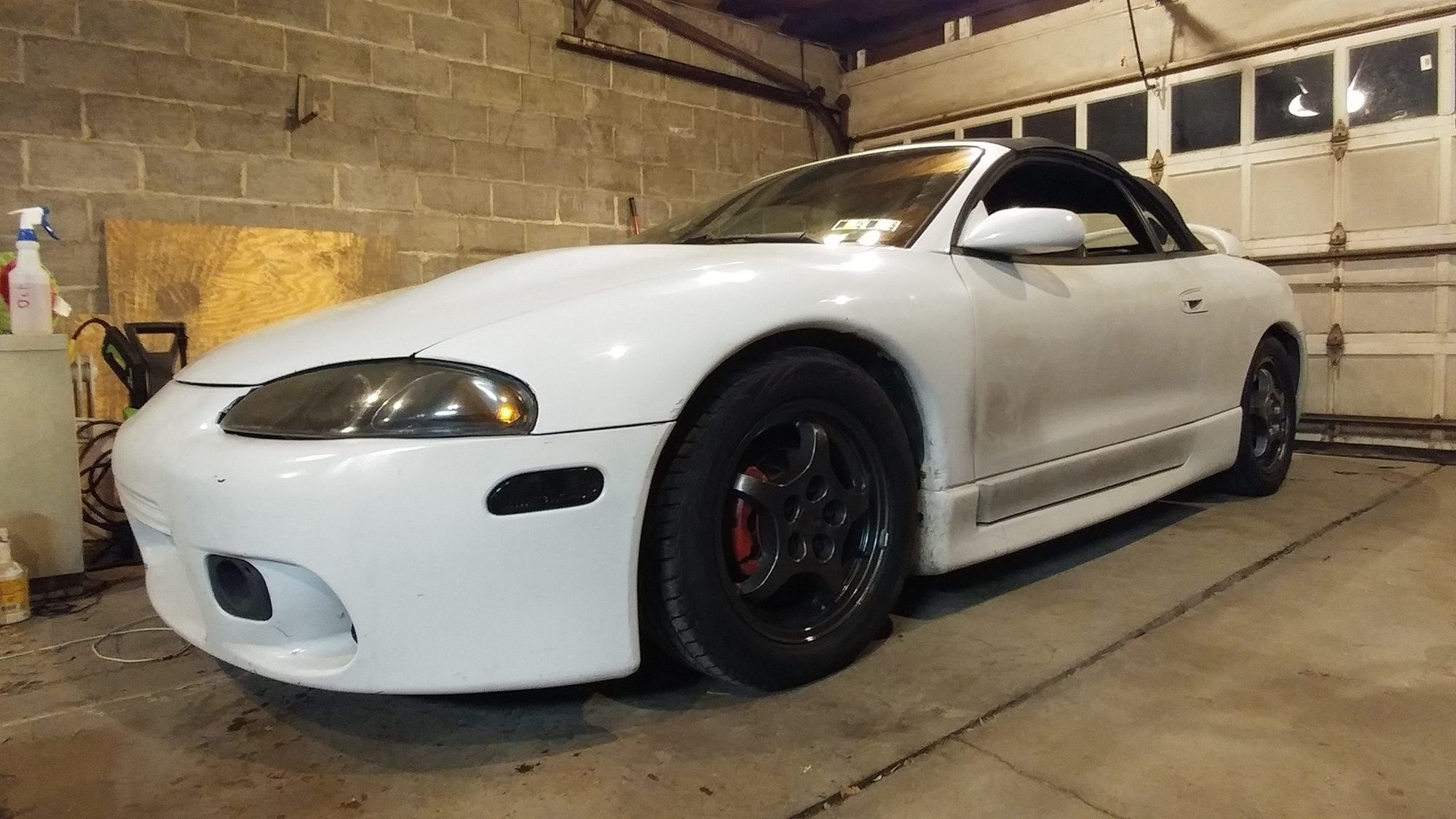

99 Spyder GS.. working on the 'T'
Picked it up for $750 as a beater and my first DSM, let's see what it becomes!

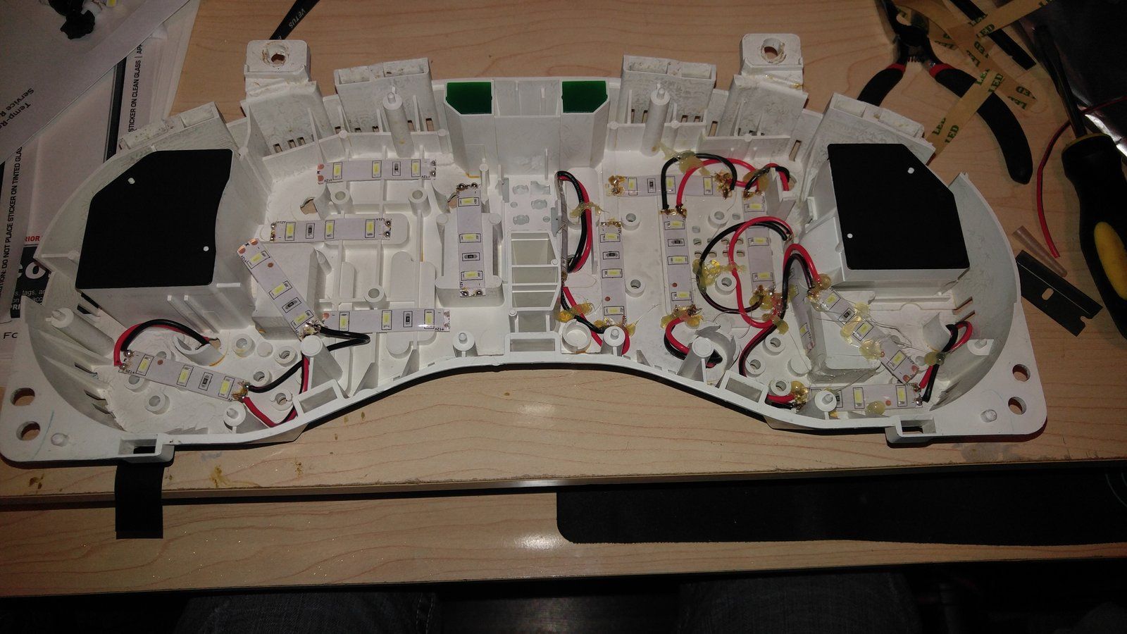

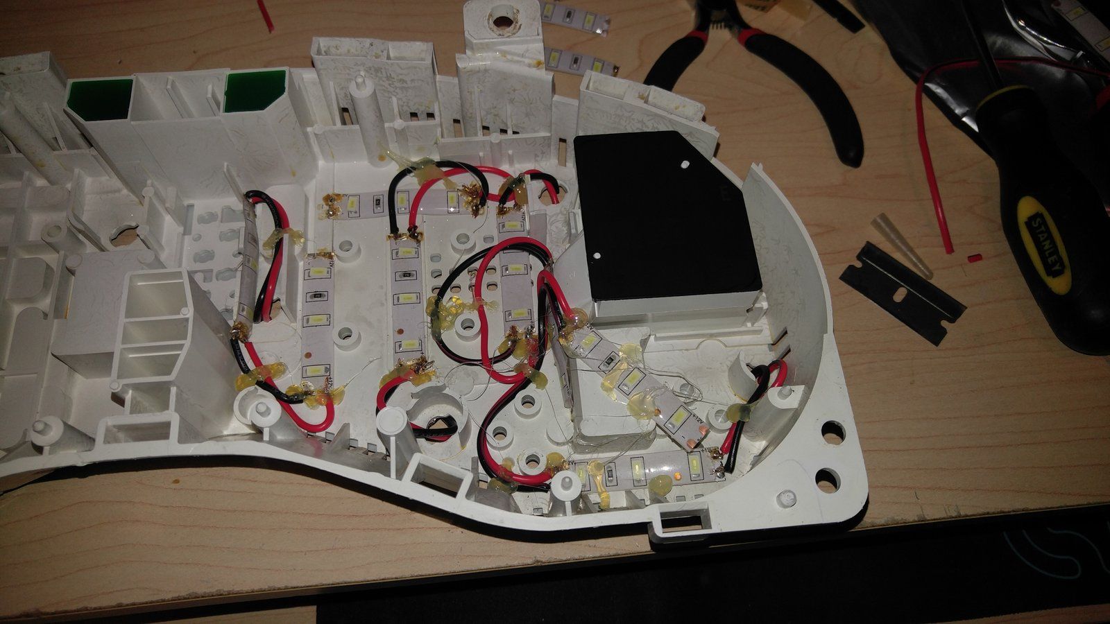

I never realized how much I would miss a modern gauge cluster until I started driving this car at night. Between the 'orange' tint to the backlighting and the overall dim look, it just couldn't last.
I tried going the easy route of just popping LED bulbs in, but that just wasn't going to cut it. Since I had a few days of downtime with the car over the holidays, I picked up a reel of LED's from ebay and went to work. Took quite a bit of planning to make sure there are no 'hot spots', but we're well on our way to a bright cluster again!
Once everything is wired in and glued down, I'll start working on the needles (painting the backlight coloring bright red) and sanding down the back of the gauge faceplates so we get rid of the orange glow. Can't wait to see this thing lit up!

My week-long project has finally come to a finish.
Car has new Koni struts and Eibach springs. (buh bye Manzo springs... $60 ebay junk)
Installed a shim kit for the rear camber so I could bring it back into alignment.
Replaced the power antenna mast so it retracts all the way.
Gutted the interior and cleaned up some surface rust on the floor-pan.
Patched the holes I found in the trunk under the washer fluid bottle (worst design ever).
Installed a Megan Racing front strut tower brace.
Installed proper 2G leather seats (got rid of the aftermarket leather that was in the car).
Installed a 3G steering wheel.
Installed a K&N MAF adapter and high-flow filter (replaced the ebay junk).
Converted the rear drums to disc brakes.
Got it put back together and ready to go for the first day of spring... just in time for another Nor'easter to roll through the area :banghead:

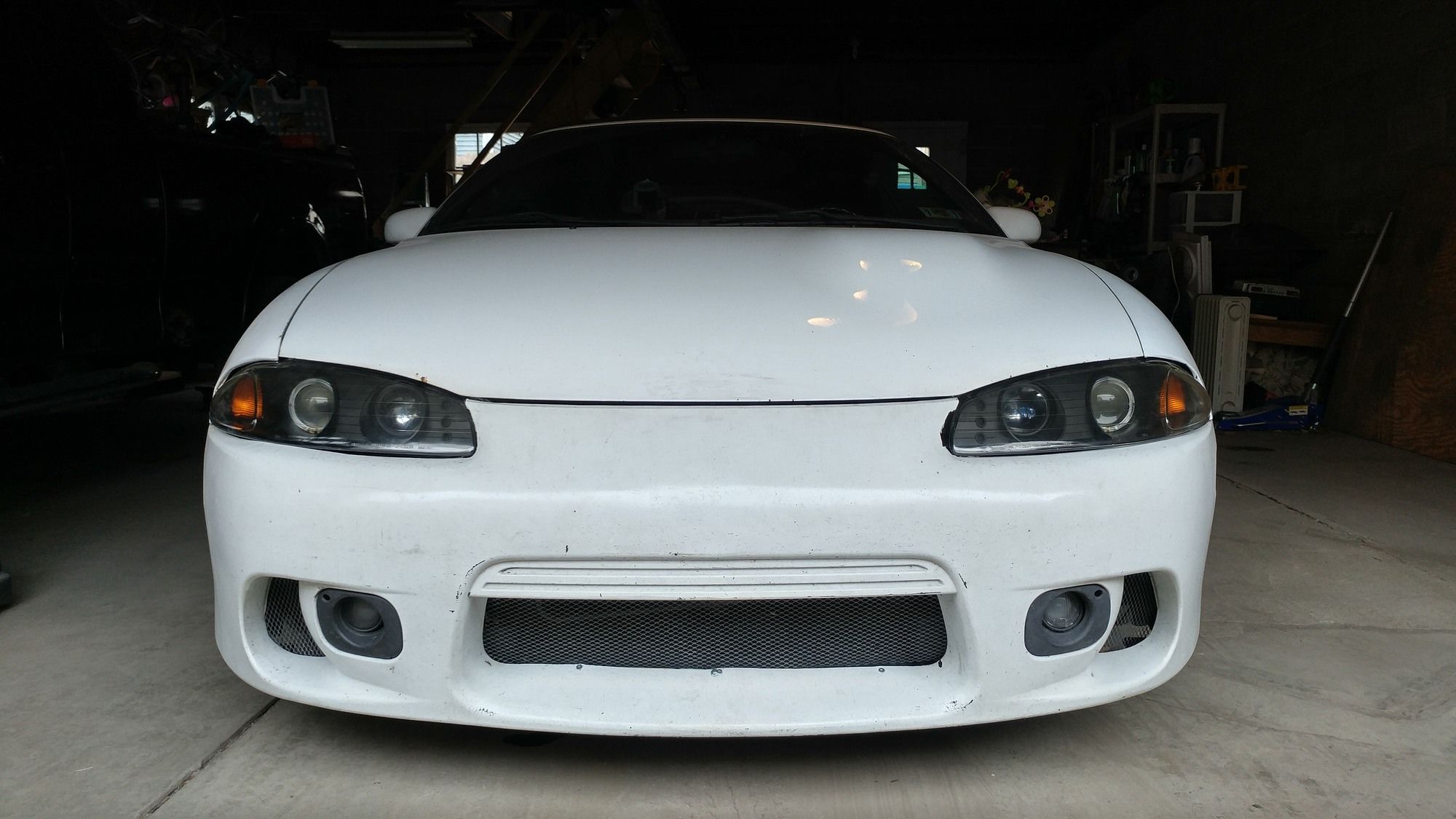

Minor update of things I forgot to add last night.. I also gave the car a facelift over the weekend:
Skipped wiring in the "Halo's" since the passenger side started smoking when I tested them.. decided the electrical fire risk wasn't worth the lights I'd probably never use. I mainly wanted the projector style lenses to go with a new set of 6000K Ultra-White HID's so I could get rid of the blue HID's that were absolutely horrible at night. Did I mention I scored these for $10 for the set since they had a broken mounting tab on the driver's side lens? Nothing a little JB Weld plastic epoxy couldn't fix :thumb:. Shoutout to the guys at Performance Partout for letting me score a great deal on them!

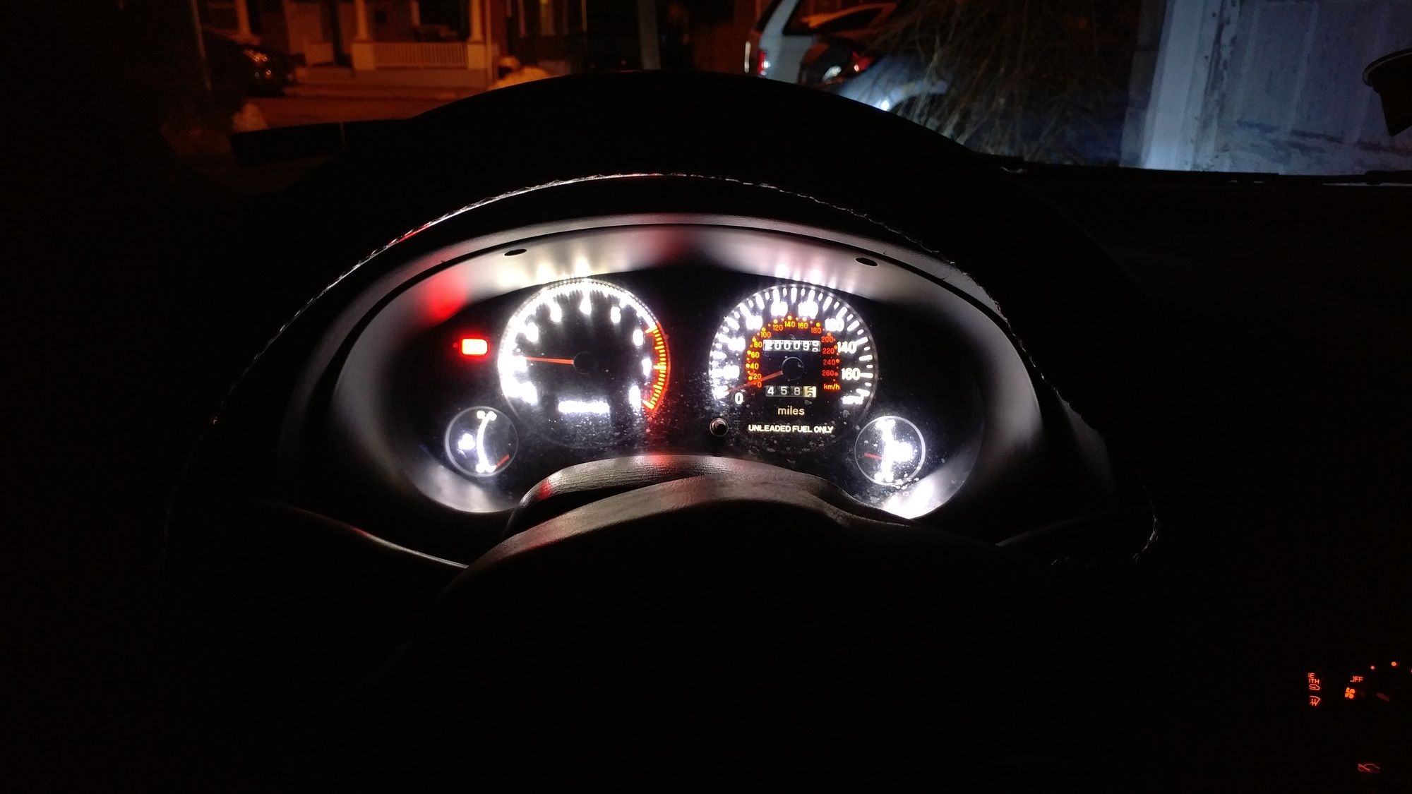

Also realized that I never posted an update of the LED gauge cluster mod. Here's full brightness at night, I usually run it at 50%-60% brightness which is perfect. (ignore the scratched up cluster, still trying to find a replacement that isn't completely trashed at my local U-Pull it yard... and yes.. it DOES have 200k on the clock :hellyeah:) -

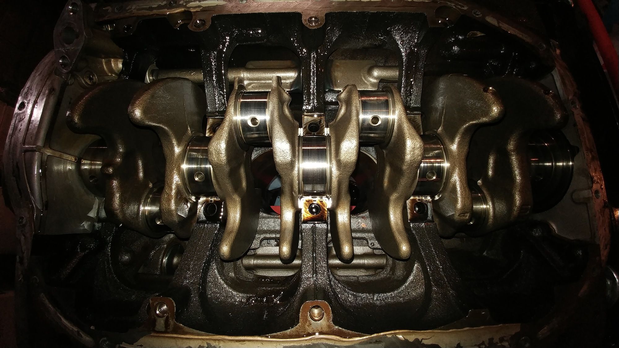

Now that the head is completely torn down, it's time to turn my attention to the block. @techboy already had the oil pan off before I purchased the motor, and everything looked to be in solid order from a quick inspection. Let's hope I catch a break with the bottom end. I really want this motor swapped out so I can enjoy some boost this summer :hellyeah:

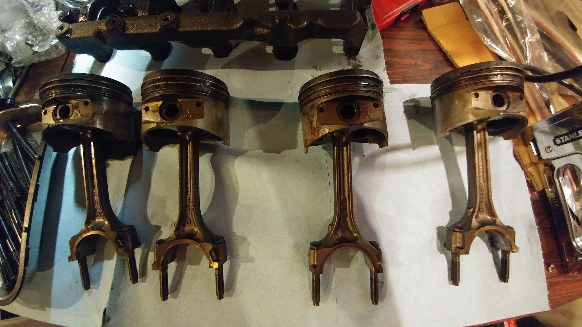

After finding all of the bent valves in the head, I was seriously expecting to find damage to the pistons. Fortunately, they were in perfect shape (other than carbon deposits).

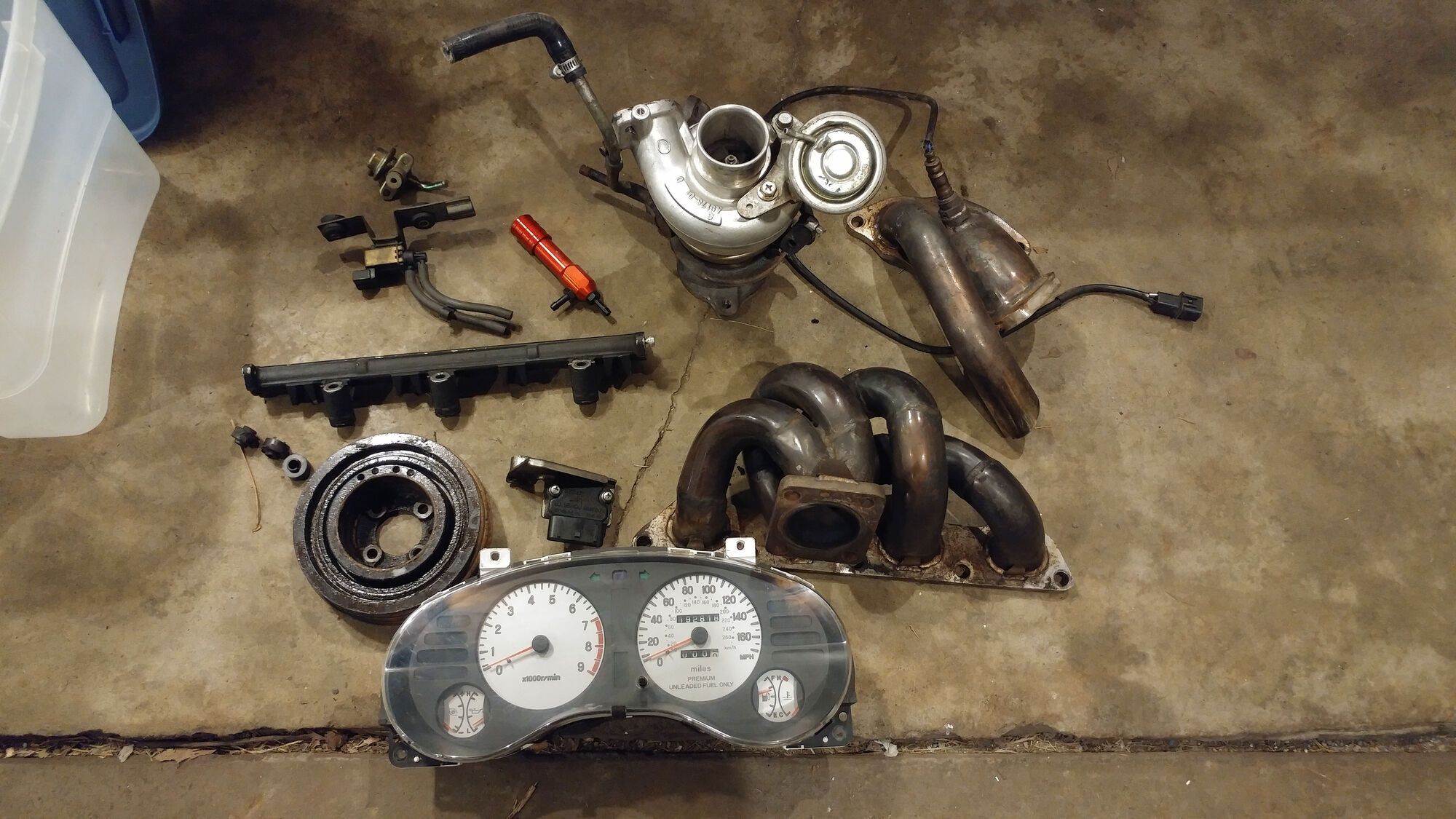

I took a trip over to Performance Partout today to pick up some goodies the guys have been gathering for me, and to see what they had in stock for replacement valves. Unfortunately, no luck on the valves... but I still came home with more than I went there for :cool:.
I was originally thinking of just going stock on the turbo.. already had a t25 laying on the work-bench and everything. But I couldn't pass up the deal they gave me on this MHI Evo III 16g! ZERO shaft play, thing is in excellent shape. Before you say anything, yes that is a stock BCS sitting next to the Hallman MBC... I got it for the mounting bracket and have no intentions of using the useless thingLOL.
The manifold is likely an eBay junkbox, as well as the o2 housing, but they were dirt cheap and by saving a few bucks on that stuff now.. it can free up some cash for the valves I still need to find. Grabbed a spare igniter, fuel rail, and also grabbed a stock Harmonic Balancer. The motor had some cheap looking aftermarket solid crank pulley.. no way in hell I was leaving that on.
Finally.. no GS-T conversion can be complete without the proper gauge cluster. Likely going to give this one the same LED treatment before popping it in.

Started to blueprint the block and so far, so good!
Checked the deck for flatness, perfect.
Checked the main bearing oil clearances, .002" all the way across.
