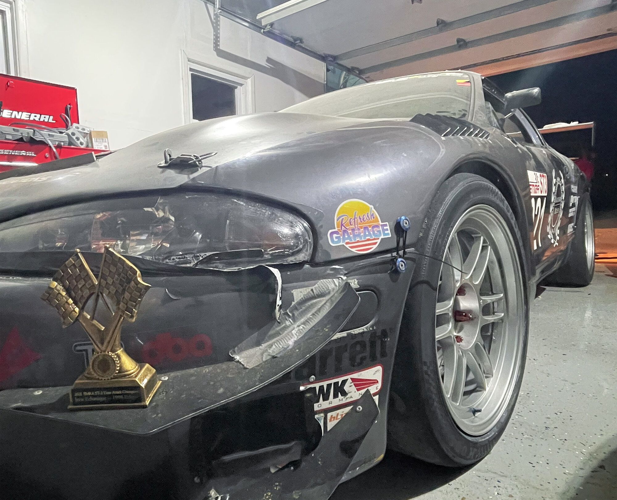

Been a minute. Got the car back from the cage guy. Came out great. Really happy with it. Just about one week out from the season opener at Lime Rock. Still got some things to finish. Made a sunroof plug since the sunroof isn’t going back in. It came out ok. Didn’t want to just rivet a plate over the hole. So I made some brackets and made plug to fill the hole. Also got the car balanced and and aligned by my buddy that came to the house and took care of the car. Fired up the engine this week as well. Everything fine on that end. Getting close now.
